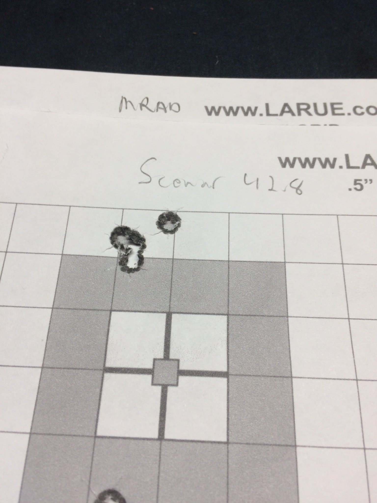

Load development today for the .260 with 130gr ELD-X and 139gr Lapua Scenars.
Not the best group of the day, but would have been without the flyer.
42.8gr H4350, 139gr scenar at 2.800 OAL, Prime Brass, Win WLR primer. 5 rounds at 100 yards....these things can shoot.

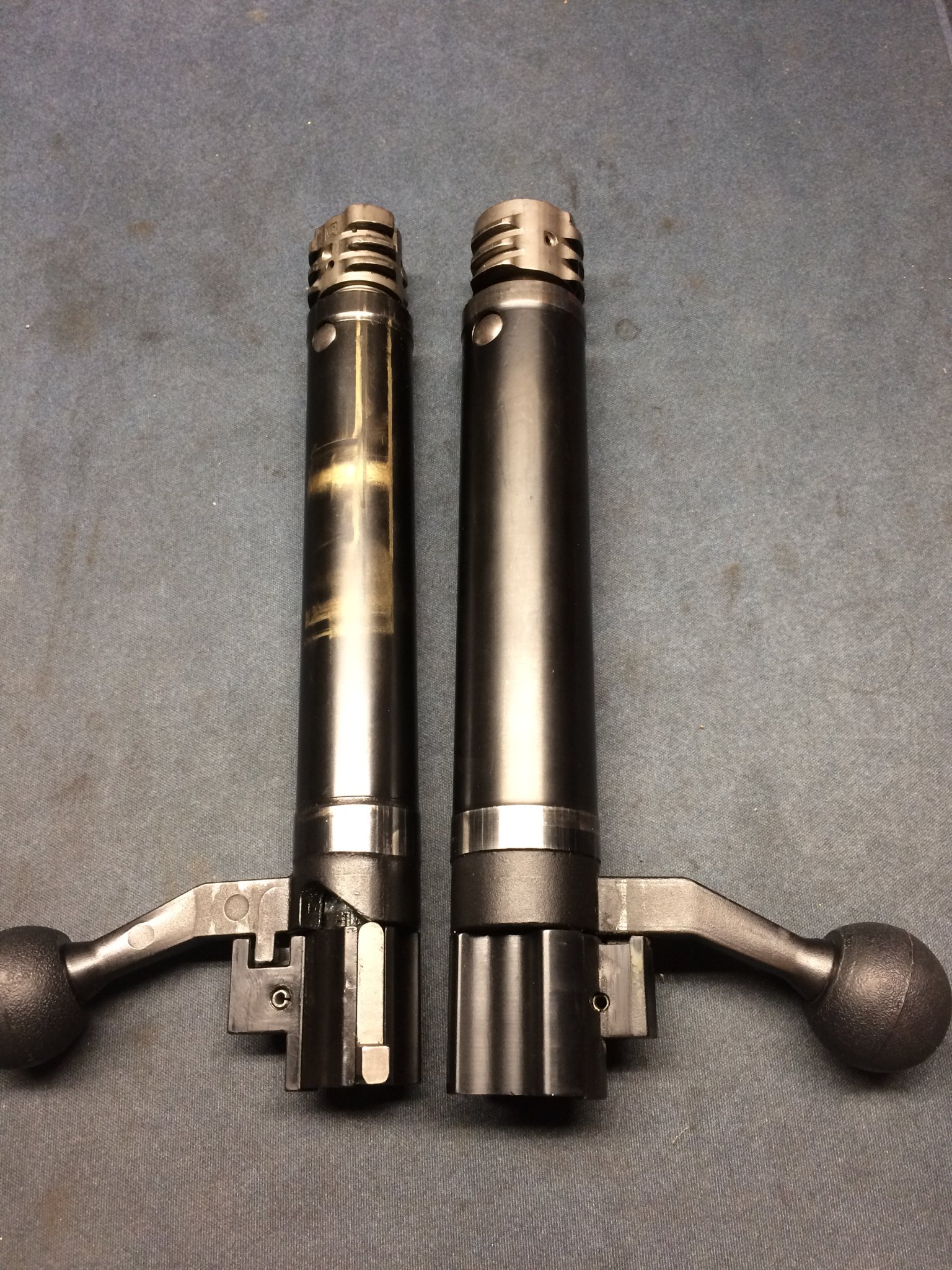

For those who have recently purchased a new MRAD, what size breech are they? I was never really clear on this and a call to Barrett CS was not much help.
For discussion's sake, I have both here:
Large bolt face (.338lm) and body: ~1.1" diameter bolt body
Small bolt face ("C" marked, .308 family case head) and body: ~.95" bolt body
On factory replacement barrels, It looks like the non-CF barrel kits are ~$1250 at the usual retailers. You do get a matched bolt head, barrel bag, and magazine at least.
I Have bought my MRAD May 2017. My breech size is 0,95"

Thanks, and that is a .338?

Yes, sure .. its .338 LM

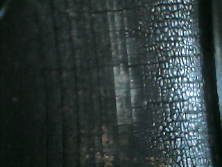

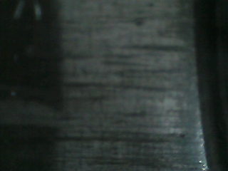

Today, from the boring world of bore scopes:
MRAD .338 at estimated 350 rounds
7046389
Here is what a thrashed .338 looks like (Not from an MRAD, and carbon steel erodes a bit differently):
7046390
