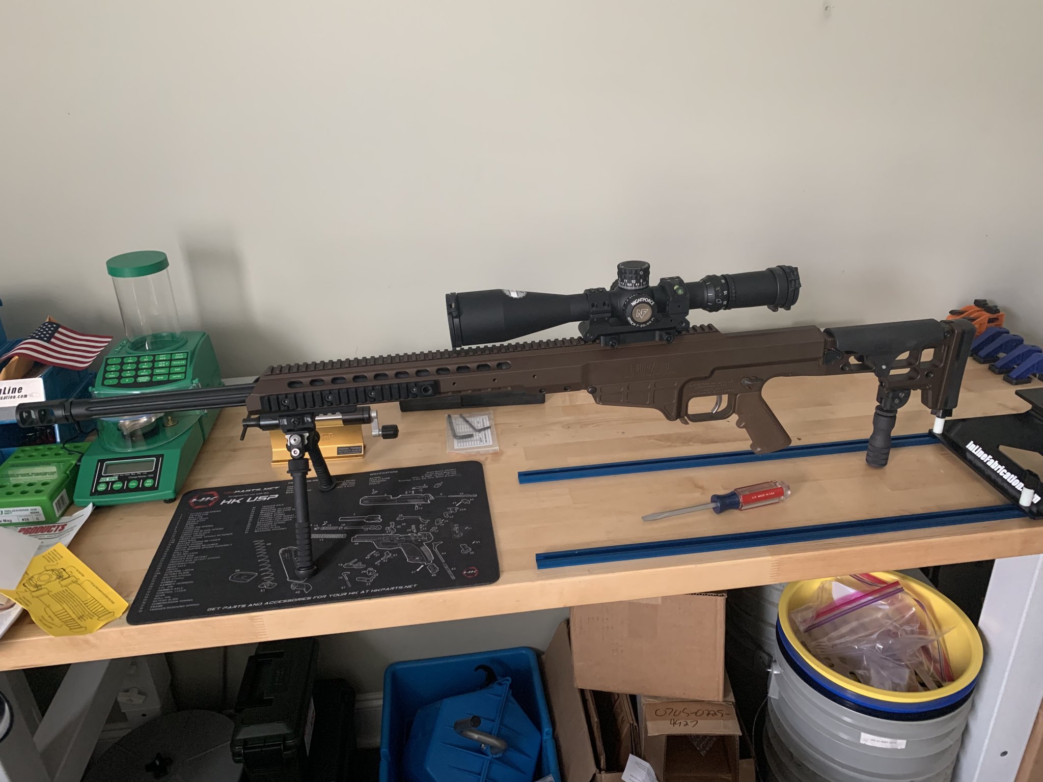

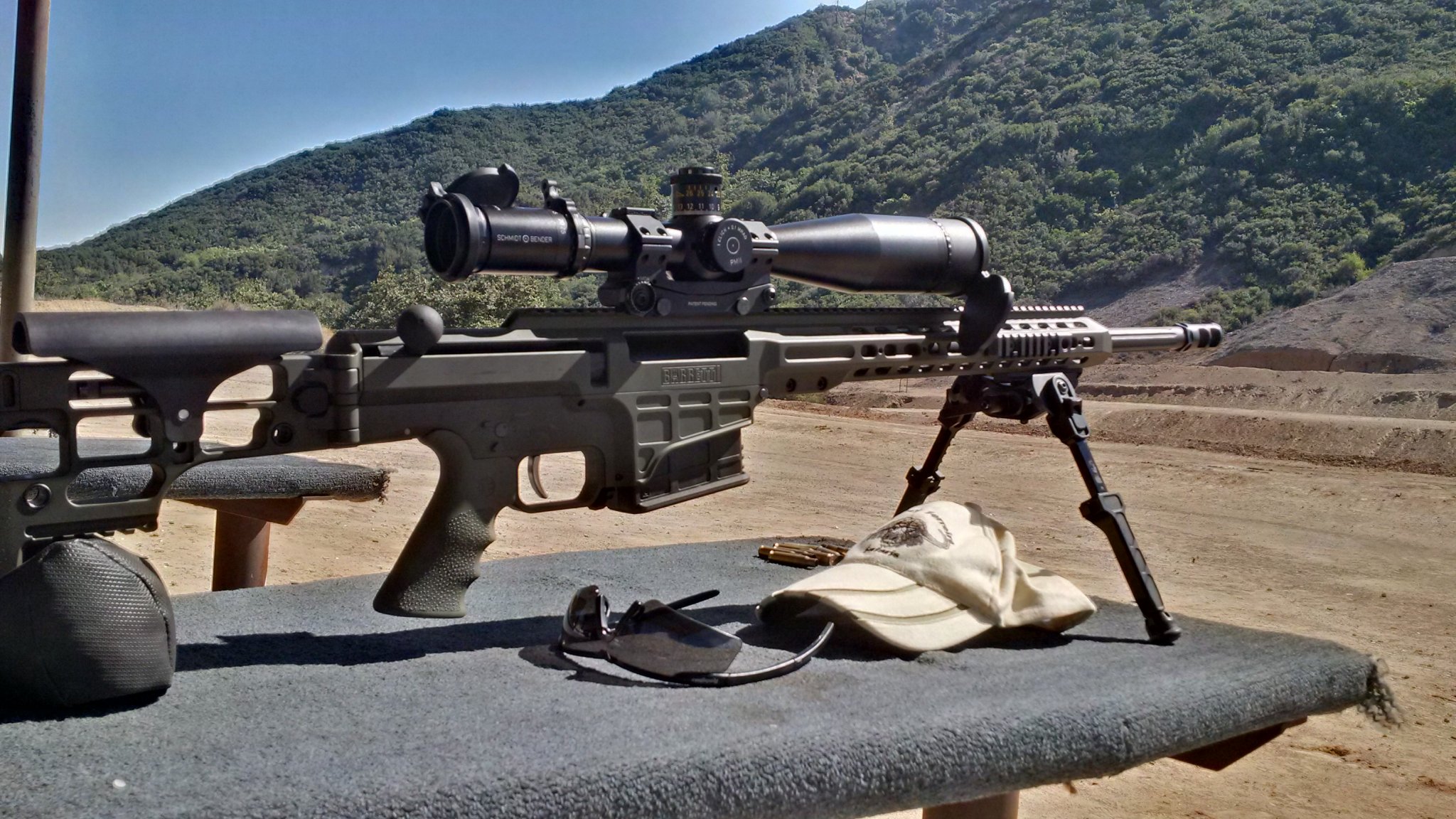

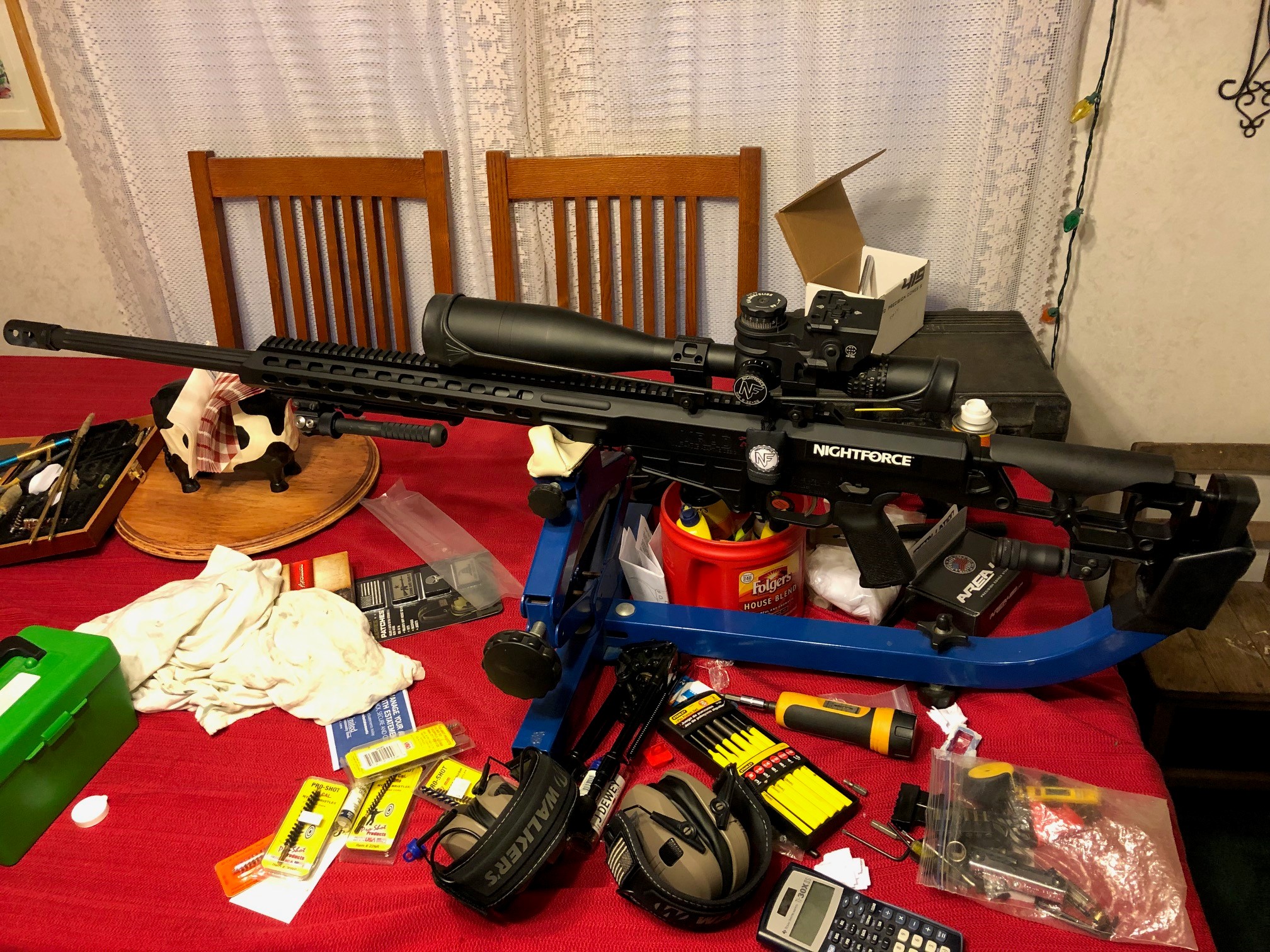

Sharing my MRAD. two barrel set (338 LM 24" /308WIN 22"), OD green. Running two optics a PMII 5-25 in a ERA-TAC and a newly acquired Razor HD (with Barrett Ultra High 35mm rings) temporarily until I can figure what I want for the 308 setup. Have worked up two decent loads for the 338 with Hornady 285 ELD's , standard 308 Target loads assembled with 168 grainers for practice. Not much to add to this knowledge base here but blessed that I can get out and shoot twice a week.

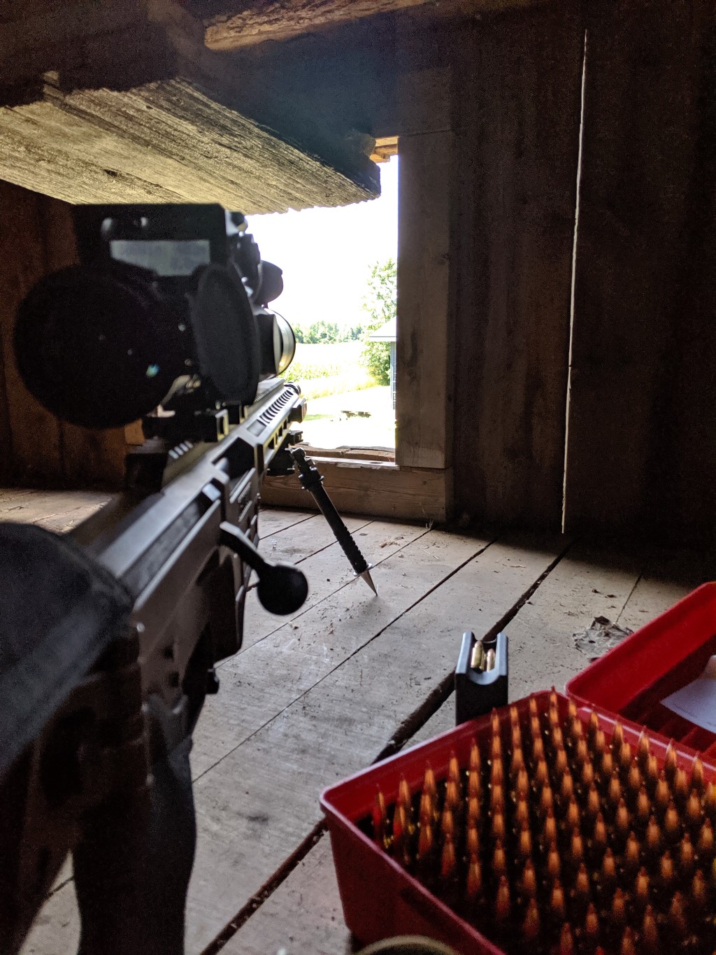

Managed to make it out yesterday to a friends place. He has a small shooters nook from the top of his barn where we can clear the corn and get 670M (about 730 yards) I managed to tag the 2 MOA gong on the first shot and very consistently with the 308 setup. Considering the wind conditions, I am super happy with the results.
How loud was it firing inside like that, what type of pad do you have on your cheek rest ?

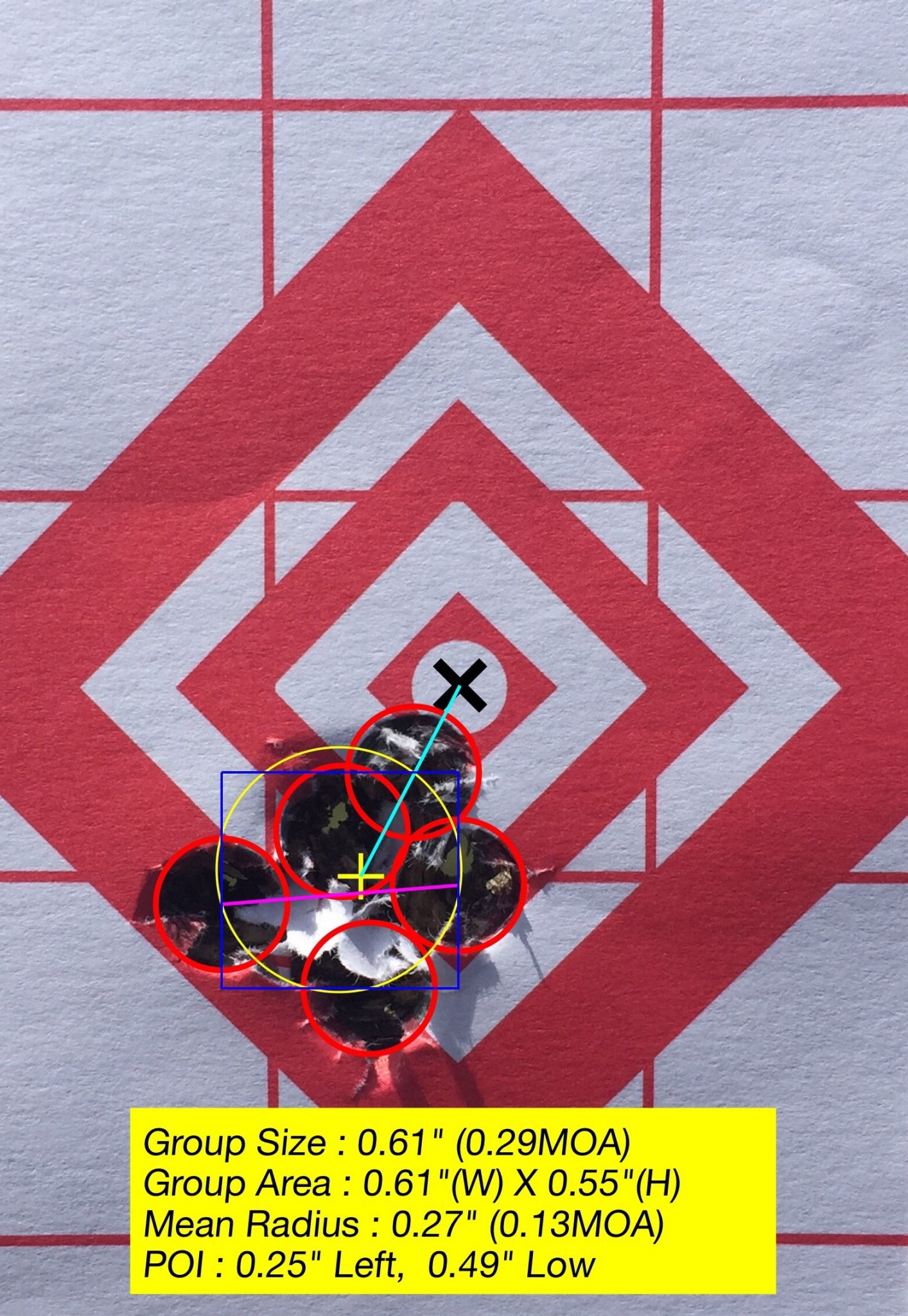

Overall I’ve been very impressed with it after I got my load all figured out. I’m relatively new to “precision” shooting, but even I managed 0.29MOA 5 Shot groups at 200yds during testing. Easily my best group I’ve ever shot... and definitely my first attempts at shooting prone. Lots to work on as far as my shooting ability and fundamentals of long range but this gun is just easy and has made learning a lot of fun. I’ve only been able to stretch out to 1000yards, but I can generally place 5/5 shots into a 12” plate even with a little wind...
Barrett MRAD Gen 1 338LM 24” Fluted
Nightforce ATACR 7-35x56 F1 Mil T3
ERA-TAC 34mm Adjustable Inc Mount 42mm/1.65” @ 30MOA (60MOA w/ rail)
Atlas PSR Bipod/Mono
TBAC 338 Ultra SR (In Jail)
Hensoldt Spotter 60
Current Load:
(2705 MV and < 5 STD w/ Lab Radar)
Berger 300gr Match Hybrid OTM Tactical
(CBTO 2.873” and OAL approx. 3.724”ish measured w/ Forster Datum Dial)
90.2gr H1000
Lapua Brass
CCI Magnum 250 Large Rifle Primers
It's actually not as bad as you'd think, but I typically double up my ear pro out of habit from when I shoot the 338lm barrel.
The cheekpad is made by wiebad if I remember correctly and I like it quite a bit. I have been able to stay on the gun on hot days without getting sweaty and sliding off the riser.

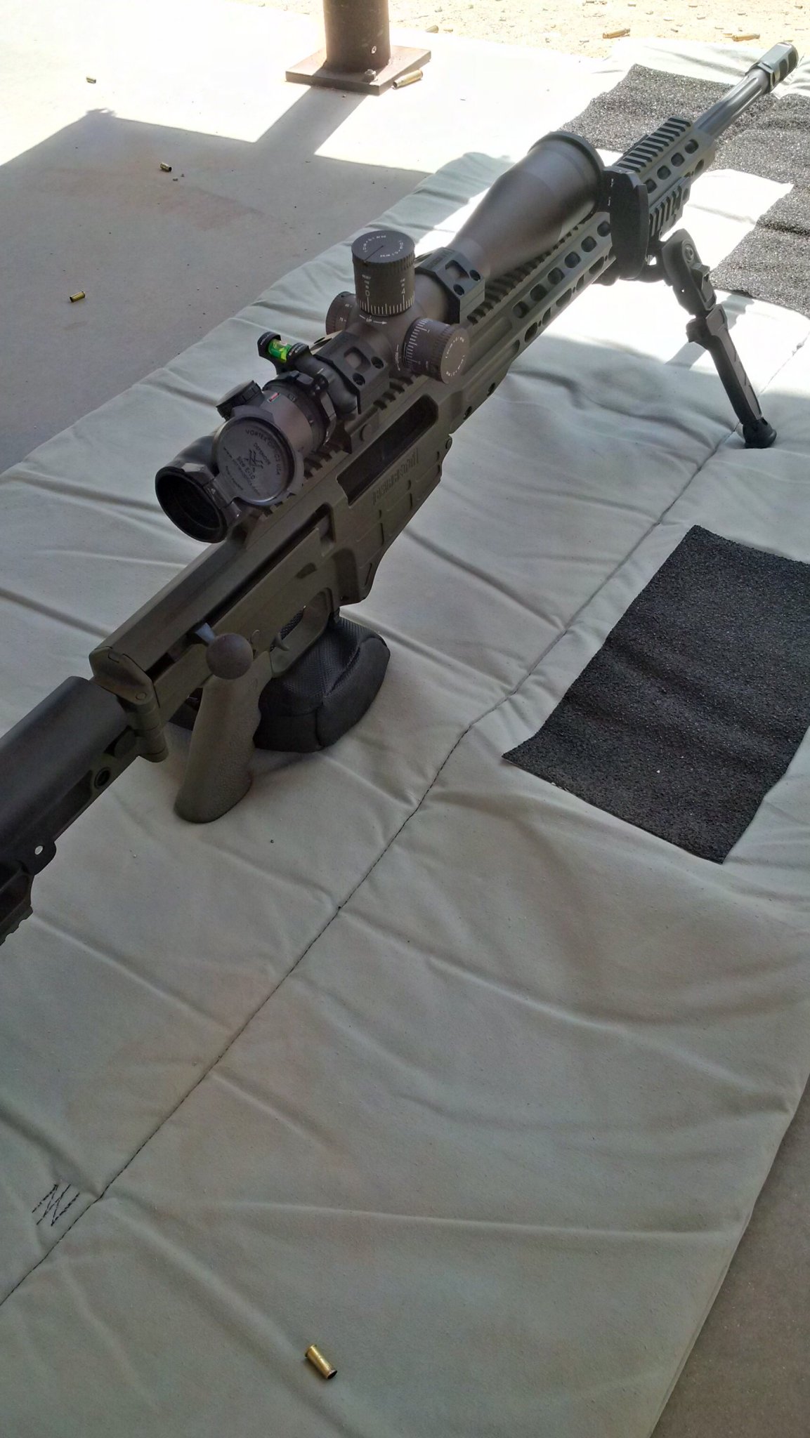

Right now I'm using 3 of my barrel kits and running one scope. I have the scope turrets set on Zero for elevation and windage (100 yards) when running the 338LM 26". when I switch to the 308 22" my zero for 100yards is at 2U/3.5R (MOA) and with the 6.5 creed 24" carbon, zero is at 2.5U/2.75R (MOA). I have multiple scopes available but i'm too lazy to switch them out - easier for me to just add the 100 yard setting to the kestrel.

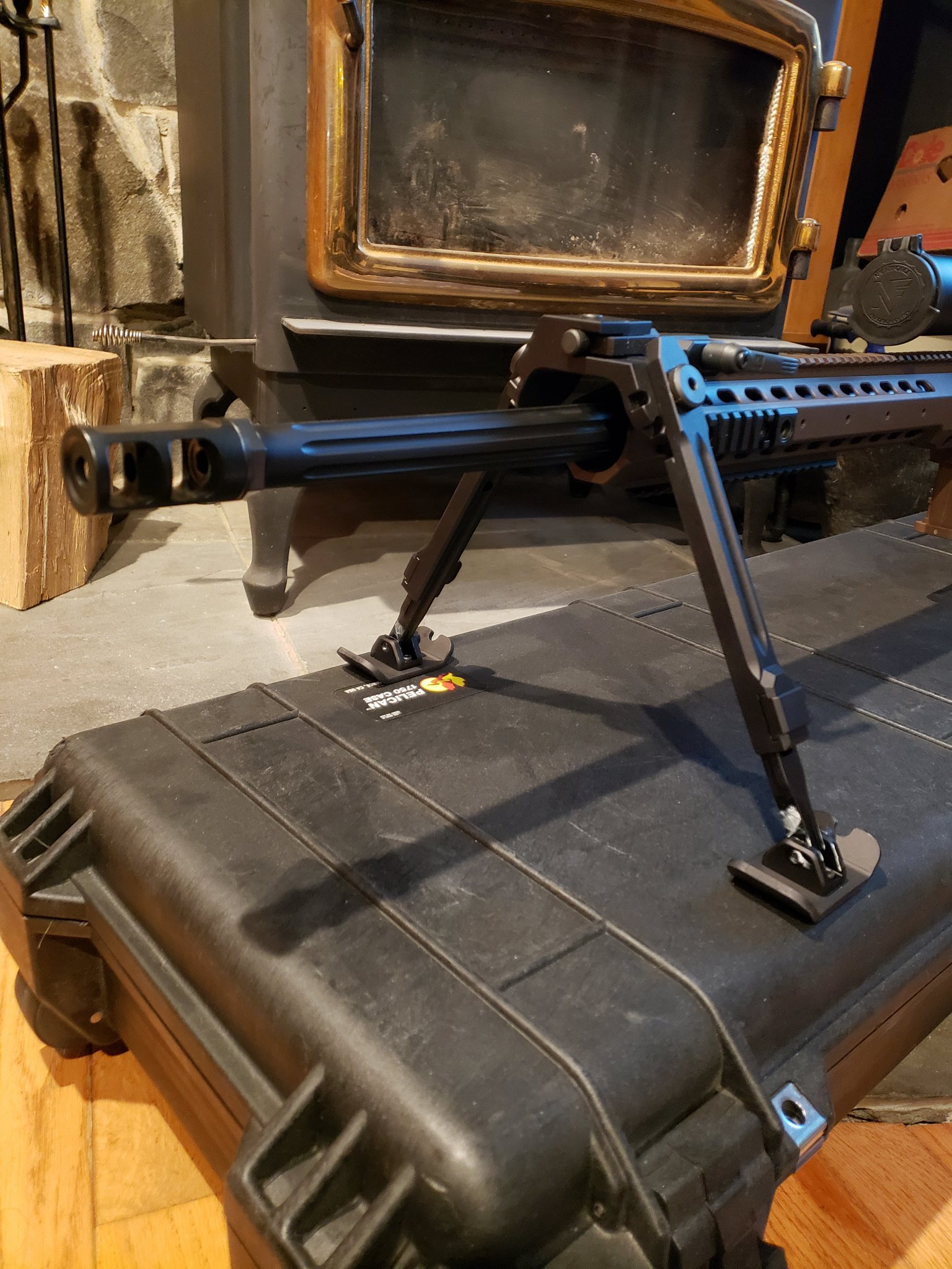

Got my new TBAC break all mounted up for the ol’ 338 Ultra SR, but unfortunately now the wait begins. Good thing my SOT supports conjugal visits at my outdoor range occasionally though. Was really worried the 3/4 x 24 wouldn’t fit since I had a Gen 1 (possibly needed a 3/4 x 20?) but it worked perfect.
Also in jail...
