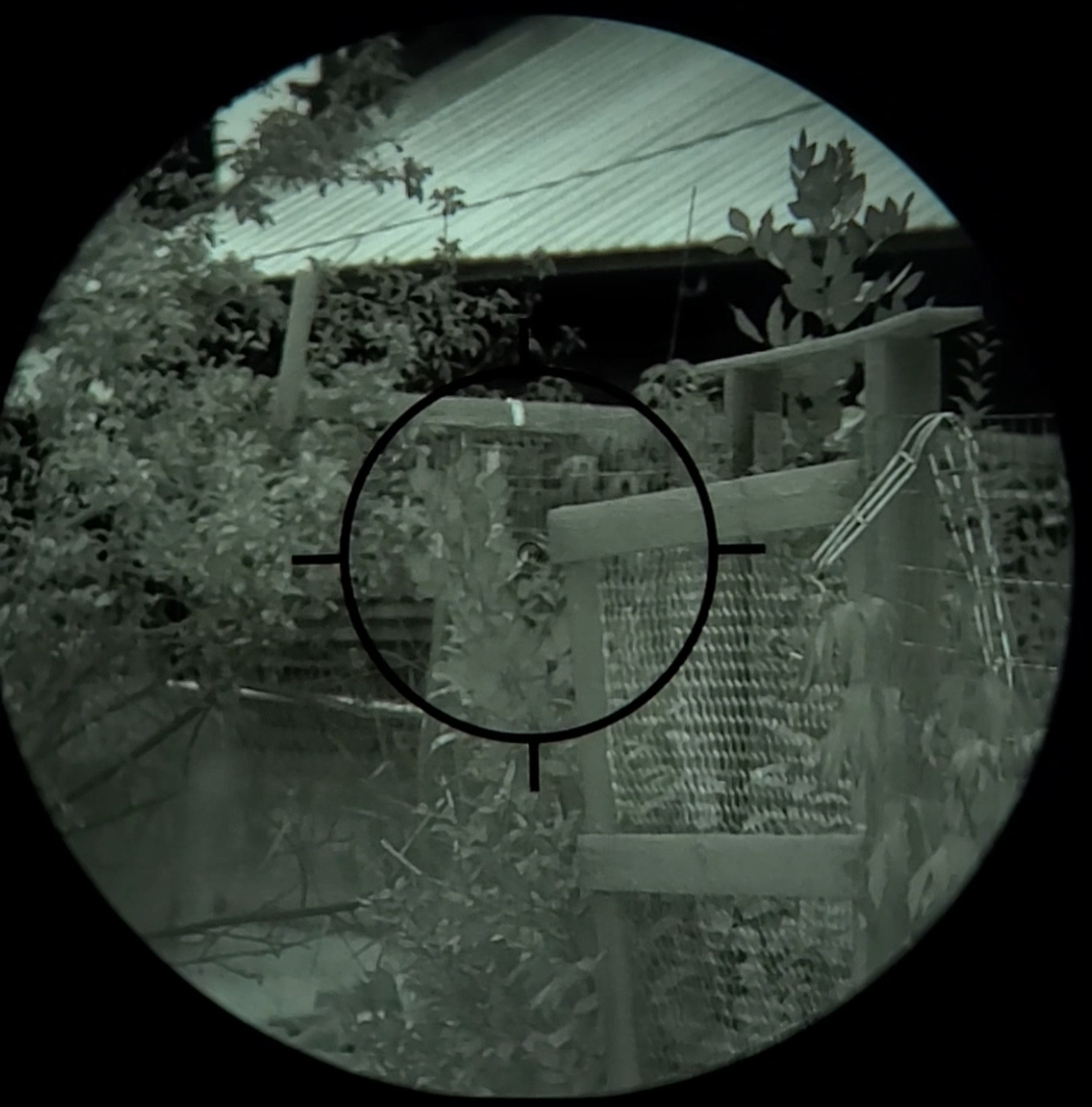

Is it possible for you to get some through the reticle video footage (side shot/phone scope/tactacam/etc...)? With your footage and mine I could put some really good side by side comparison juiciness together. Direct comparisons with split screen would be helpful for new entrants into the NV/Thermal game.
Thats what I specialize in actually. For example:

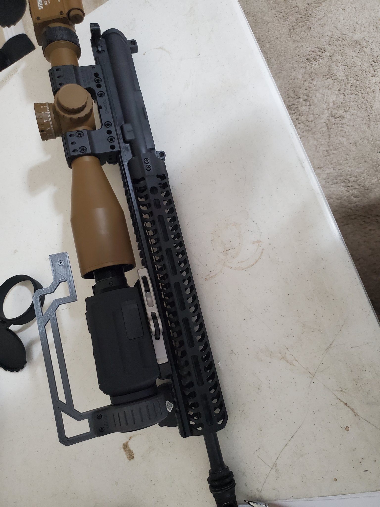

I'm right now making an M-Lok mount for 4k mAh skinny flat battery packs. I've been velcro'ing to the side of the C35 but I want to move that to the left side rail. There are battery packs shaped like a flashlight and at least one company makes mounts for those which you could put opposite an actual flashlight.
