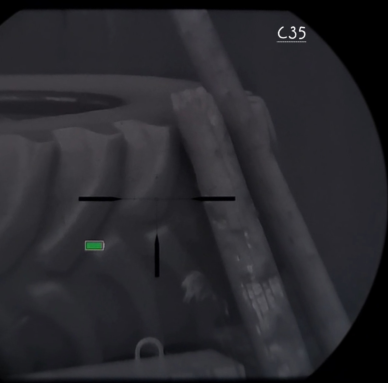

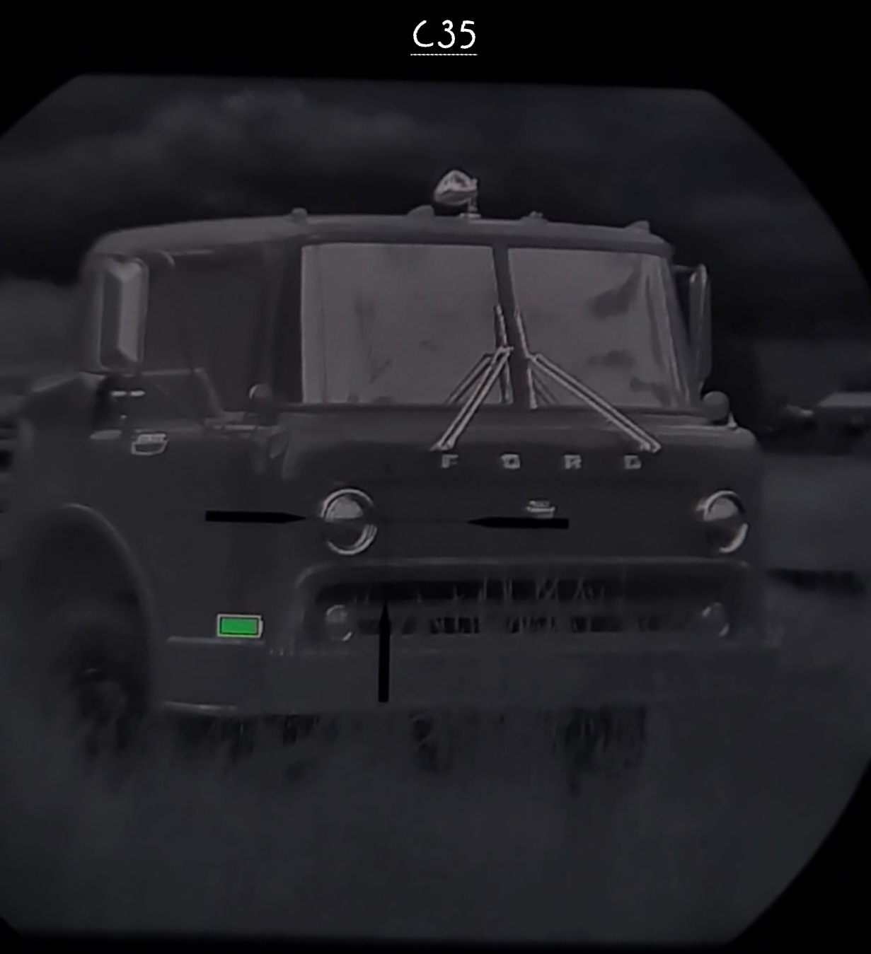

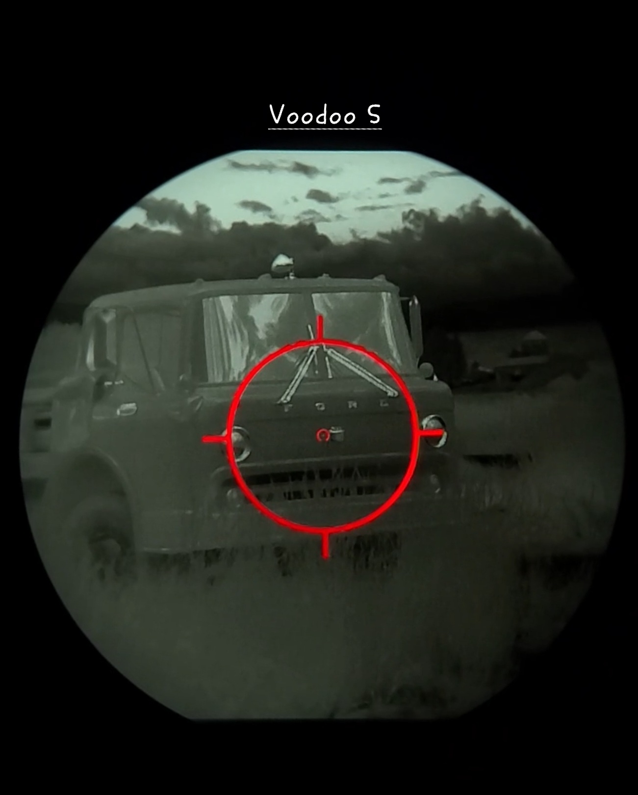

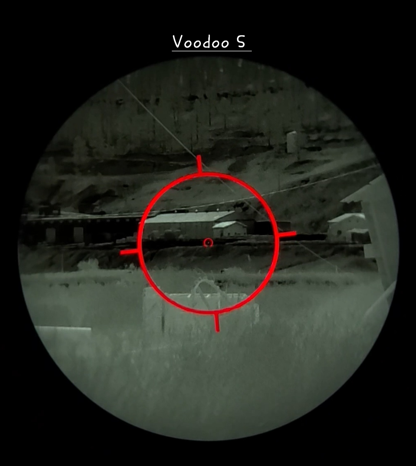

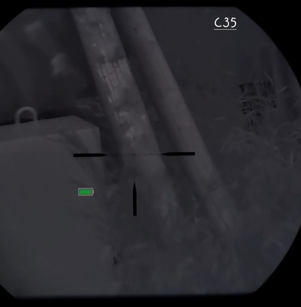

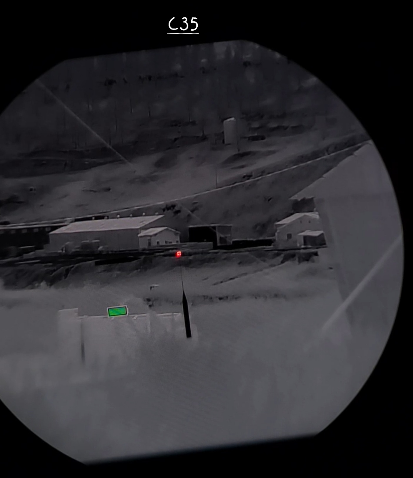

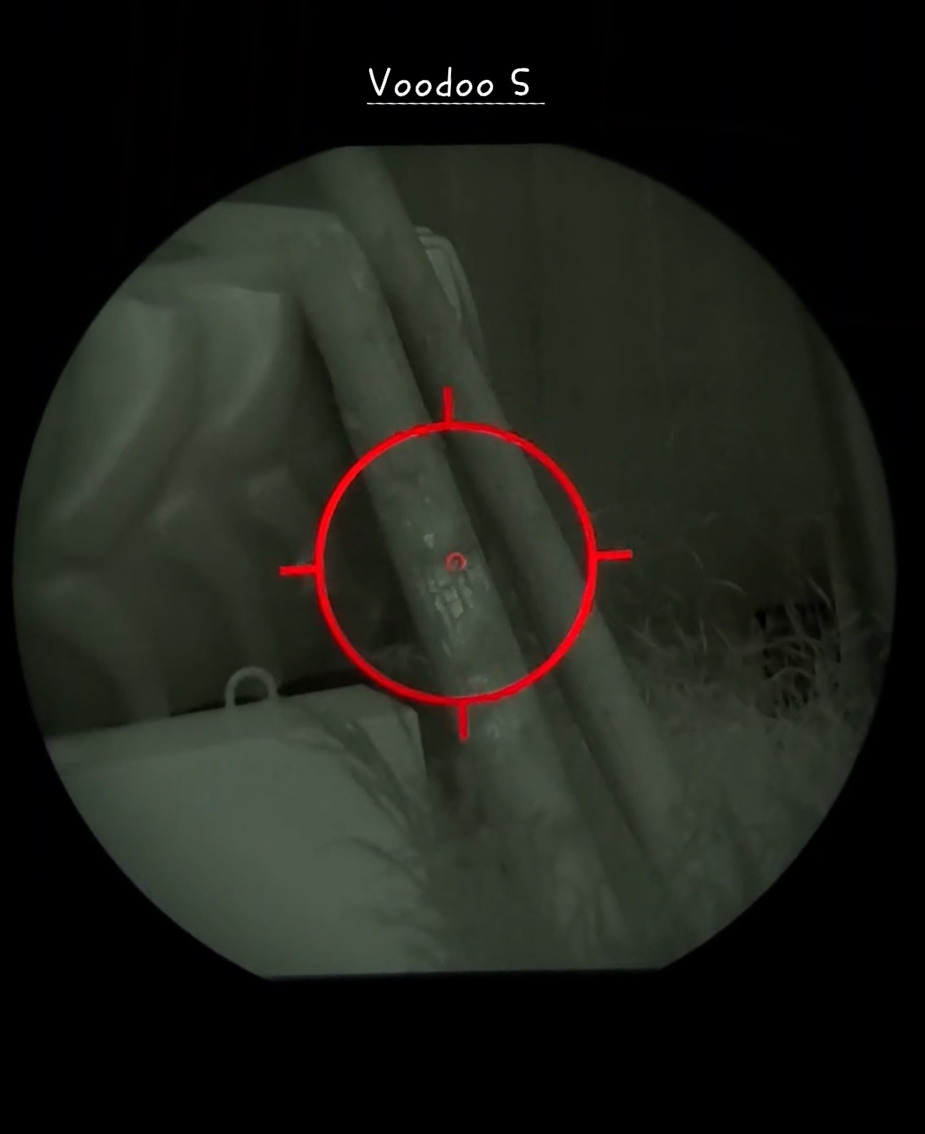

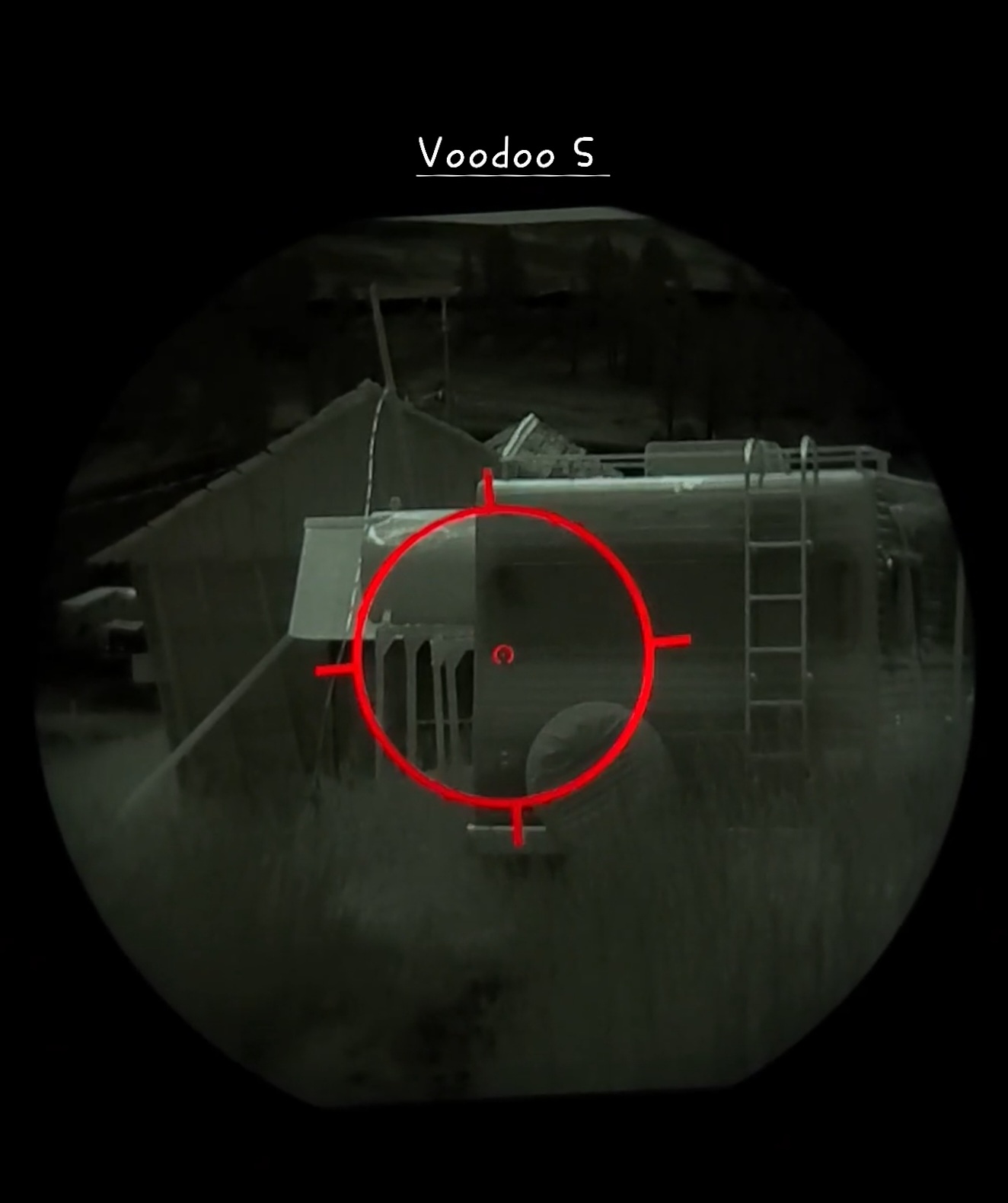

Here's a little comparison of the Voodoo S and the C35. I wanted to use the same day optic, but didn't bring an extra wilcox FTS mount with me. Voodoo was using the EOTech Vudu 1-6x24 and the C35 with the Vortex 1-10x24.
Will the voodoo is much smaller, lighter, and has more realistic image...the cost is high. This C35 is a lot of thermal for the price.
Thermal conditions today were unfavorable with high humidity, rain, wind, and 36⁰ at the time of these photos being taken. I'll post the video this weekend.

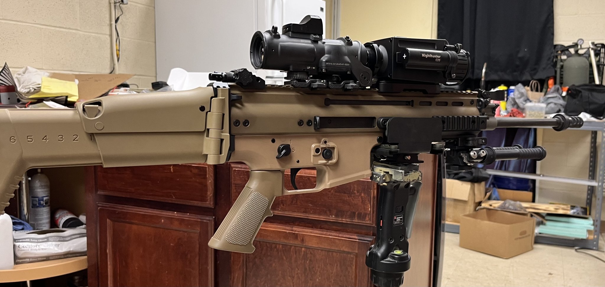

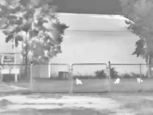

Played some today. Kinda humid and rainy so didn’t do much. Had it on my 10.5 sbr, and the Scar16 just for playing sake
Chickens are 36 yards
White wall is range backstop at 200 yards
Little white speck on bottom left is a rabbit at 150 yards

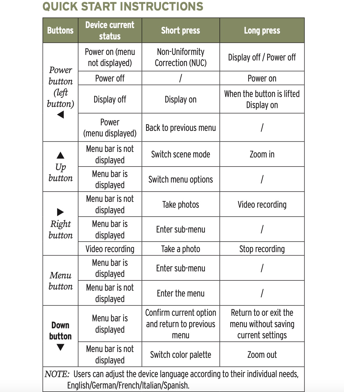

I kept thinking that having a digital zoom function on this would make it a lot more useful for handheld scanning (even though that was not this model's intended use), so I was thrilled when I accidentally discovered this today. I will be keeping PIP on from here out. This just keeps getting better, everyone needs one of these :love:
you can also hold the up button to digital zoom the screen if you want -
The manual is a lie. I thought the same thing a few pages back.
Yeah you’re right. All the other functions from that chart seem to work on mine, but not the digital zoom. Must be for their scope version, not the clipon.

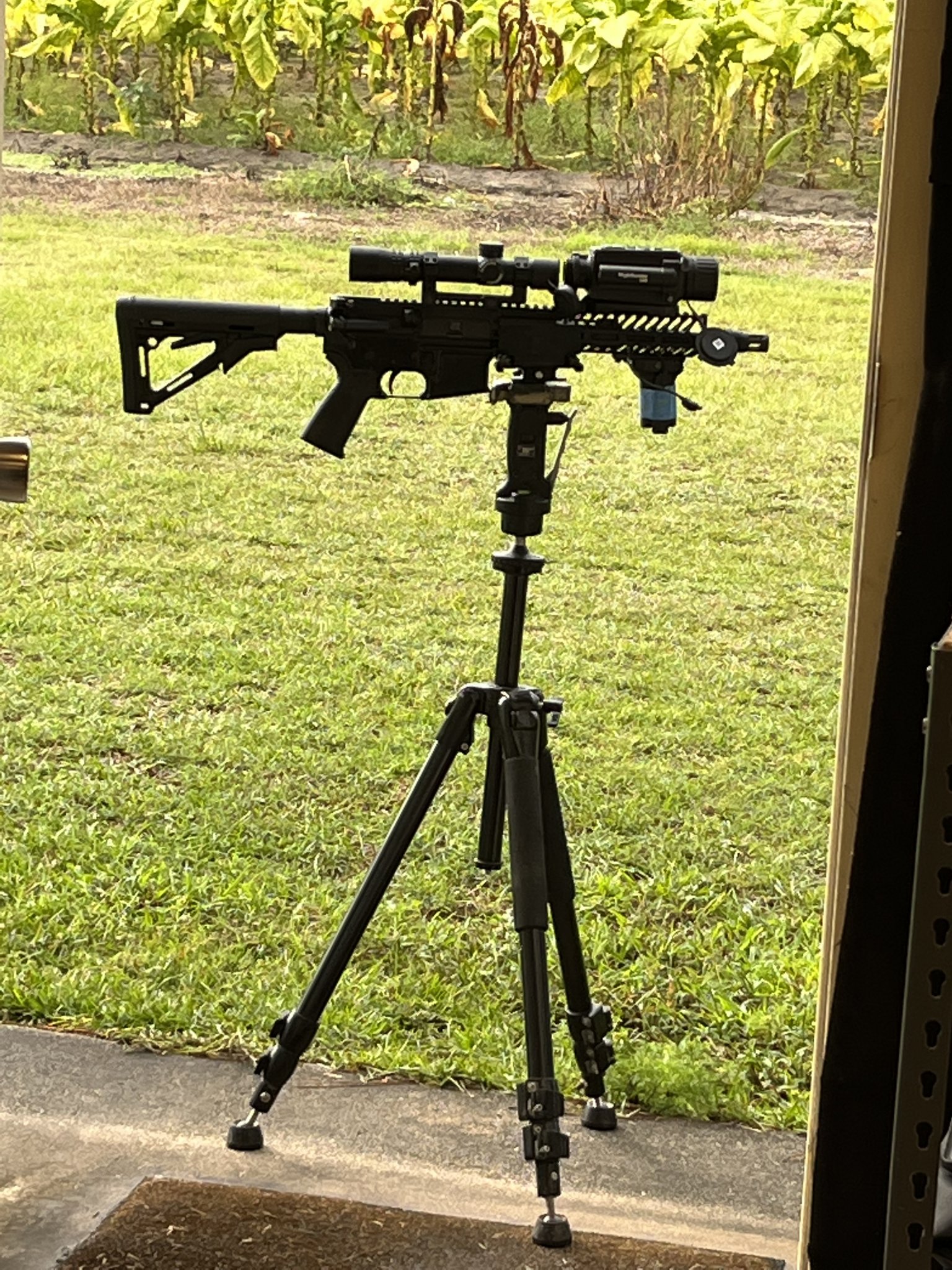

Take this as an initial perspective from someone who has dedicated thermal units and has used i2 clip on units
I was thinking about buying a thermal Clip-on (albeit I was looking at larger objective units), but I couldn't resist what steiner did here...
I did with this as I do with most things...
Open and try to use it without reading the manual, just to see if it's intuitive enough I can hand it to a buddy that tags along
Seems very functional and relatively straight forward to use. Nice that it has a shutter given how far out front the objective sits, and that's one less thing I have to explain to a new buddy.
Seems to have enough depth of field to cover making shots over any distance I'd be in a hurry to make... so I imagine this will be a set it to a range that I can manage shots from 25-200 and just forget it's up there... it won't be in perfect focus by any means on the close or far end of the expected range but if a helmet unit / spotter had already made positive id that its a "shoot" then initial impression would be that there is enough image to put shots on target across a wide range of distances.
I find the PiP function more functional than expected even when on the rifle. At 1x it gives me a little window to help id and if I zoom up to 4x or better it basically disappears from view
I threw it in front of a Burris 1-8 just to look around, and my first thought is I'm not sure I need more than about 4-5x to do what I plan with this thing.
Now I need to find / purchase a super short 1-4 / 1-6 scope for a couple rifles and this should be a nice fit
I will say my dedicated thermal night rifle does handle better to me than this thing but it does make for an easy cross over rifle from day to night

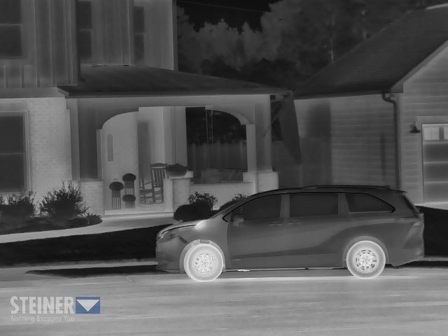

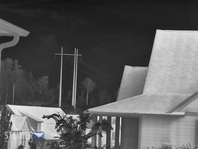

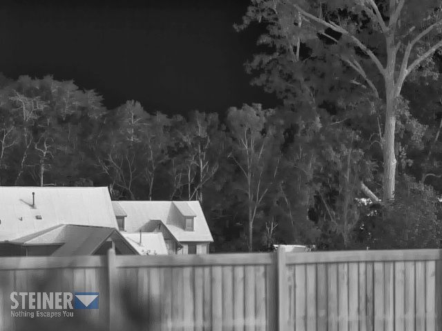

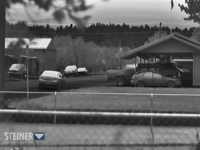

I thought I recorded a video last night, but I must not have held down the right button long enough. I was observing some does at 300-350 yards. I felt comfortable with the resolution for identification and recognition (to make sure it wasn’t someone’s dog or dogs) to take a shot on game (hog/coyote) at that range if needed. I backed up to about 375-400 and still felt confident. I honestly think with x4 you can identify and recognize game at least to 400 yards, if not further.
I will admit that the photos do not do the actual resolution justice.
House and Toyota Tundra ~65-70yards
Furthest Rooftop ~205yards and tree line ~230yards
Tree line ~295-300 yards
Three power lines poles ~412-415 yards
Three pigeons about 112-115yards on power lines
Humidity and rain really change the pic quality. Seeing your pics here, I can’t wait for our weather to change so I can get some good clear views like this.

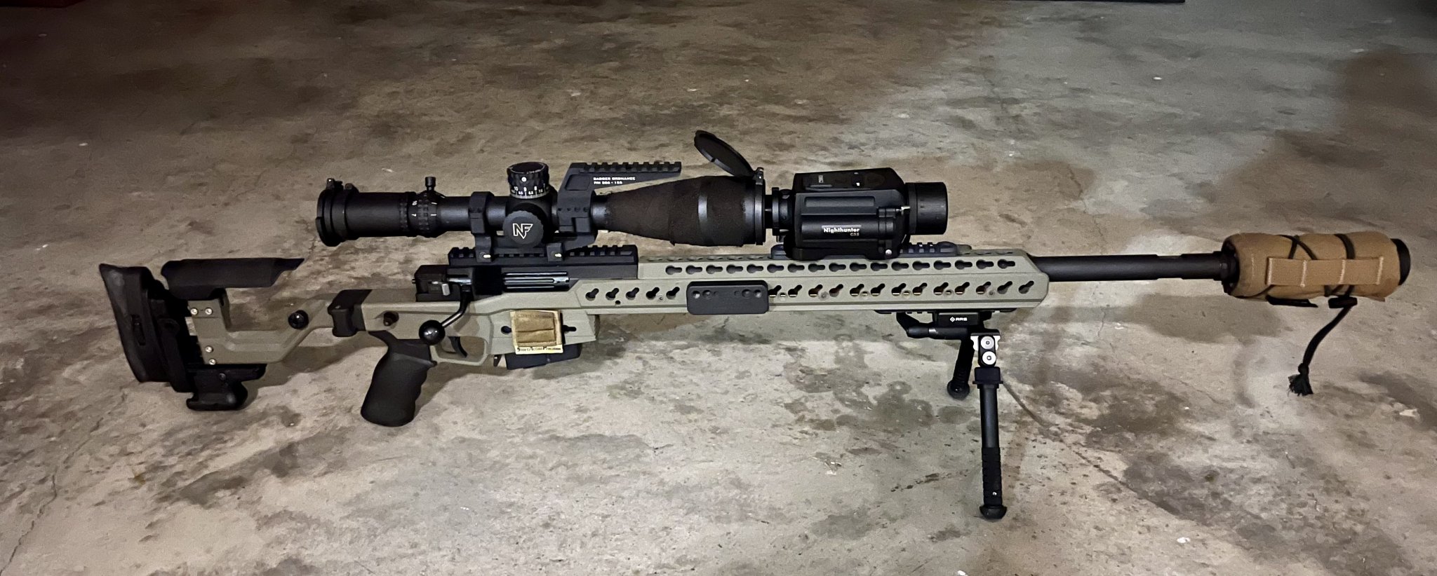

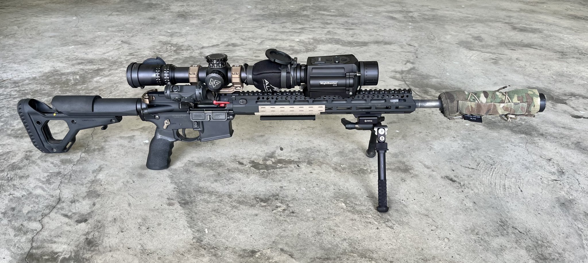

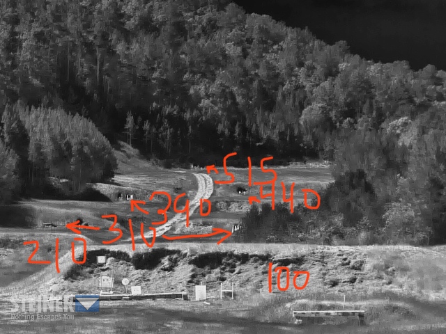

Alright, I tested out the C35 on two (2) different rifles today. An ATX in 6.5CM with NF ATACR 7-35 and a SPR in 223 with a NF 4-16.
When I arrived at the range it started raining heavily and the humidity was bad after. There were some bad photos during that time but I can’t tell if they weren’t in focus or if there was movement. I am not going to post those, because they certainly weren't indicative of what I saw through the scope.
I checked zero without the C35 with three rounds. Then put the C35 on and sent 2-3 rounds downrange at 100 yards. I used aluminum foil for the thermal, which did not work well in the shade but worked really well in direct sunlight. Anyway, my zero with the C35 was 0 windage and 4 elevation in both the ATX and SPR. It was kinda a crude zero and could use some further fine tuning.
After zero I sent about 10 rounds downrange with the ATX from 200 - 310 yards. That’s as far as I got. The seven (7) power on the low end really hinders you.
Next up was the 223 SPR. I was able to consistently make impacts at 210, 310, 390, and 440 yards on 2moa targets. I was able to clean the plate rack at 310, but had issues on the plate rack at 390. I got hits on the 1moa target at 440 but it was difficult. I ran the ATACR from 4-6 power and was really impressed. I had problems seeing the 515 yard targets and did not attempt to engage. Those targets were in the shade and I assume were the same temperature as the background.

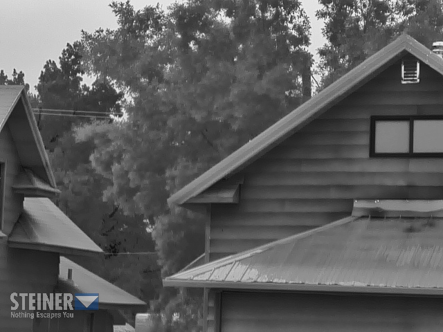

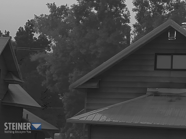

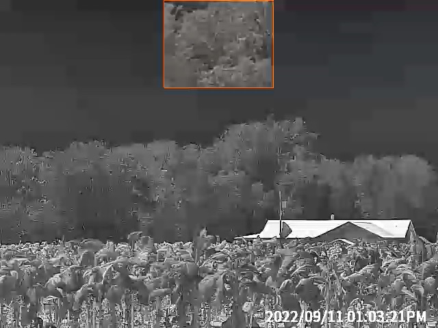

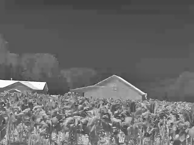

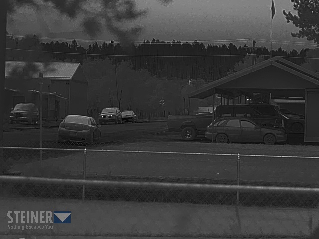

Took a bunch of video and images through the unit (the internal recording feature is damn nice).
What I have found is that you need to modify the image settings to get an optimal image. From all footage/images that I had seen in the past, I was not at all impressed with the image quality. Now that I actually have one for myself and have played with the settings to see what the dynamic range is, I am thoroughly impressed.
The settings for my environment that I have found to be ideal are: display brightness at 40%, brightness at 60%(this is different than the display brightness), contrast at 10-30%, and the sharpness setting in the "off" position (I find that it degrades the image). I have also discovered that the contrast is indirectly proportional to the sharpness...so as you increase contrast you decrease how fine the image is. When you decrease the contrast to the lowest level (10%), the image gets VERY sharp and produces an aura around objects that are producing/holding significant thermal signatures. All of this is done without actually changing sharpness setting.
Anyway, here's some images comparing how the unit came (contrast at 100% for reference), and my modified settings. I'll let you decide which one looks more functional. Oh, and then one taken of a deer at a contrast of 10%.

Thanks for that...I'll try messing with the contrast on mine. It's always been pegged at 100%, and when I quickly lowered it I thought "that's not good" and bumped it back up. Never occurred to try messing with the other settings to bring the contrast back in a different way.
And yes, I've found the same with the sharpness. Not worth using.

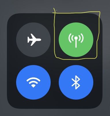

Bluetooth or just the wifi connection? My Bluetooth is enabled either way but there’s only a wifi connection for the C35.
Keep getting this:
In case anyone else runs into the same problem, found a solution: Turn off cell service.
Remembered a wifi drain cam that I bought and turning off the cell service icon from the drop down screen was the only way to connect. Not sure if it’s particular to my iPhone but works like a charm now.
Guessing given the C35 isn’t providing internet service the phone keeps using cell service. So it ends up quasi connecting to where I could adjust settings but video streaming would not work.
Turn this off:

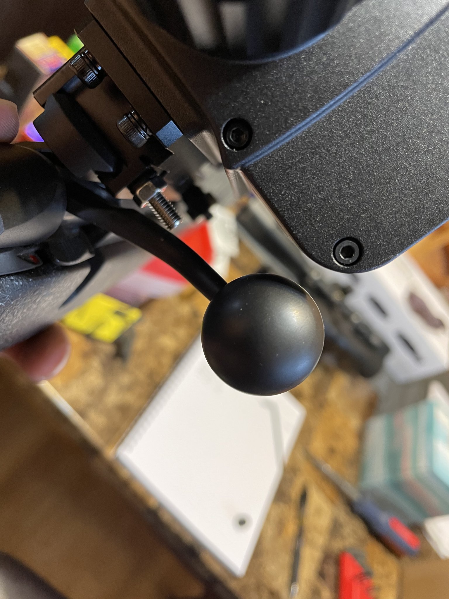

FYSA, my mount was loose when I received my C35. I noticed it was moving around when I got to the range. Probably just a fluke but something that happened to me.
Did you figure you mount out. Mine is loose as well. The four screws on the bottom are tight though

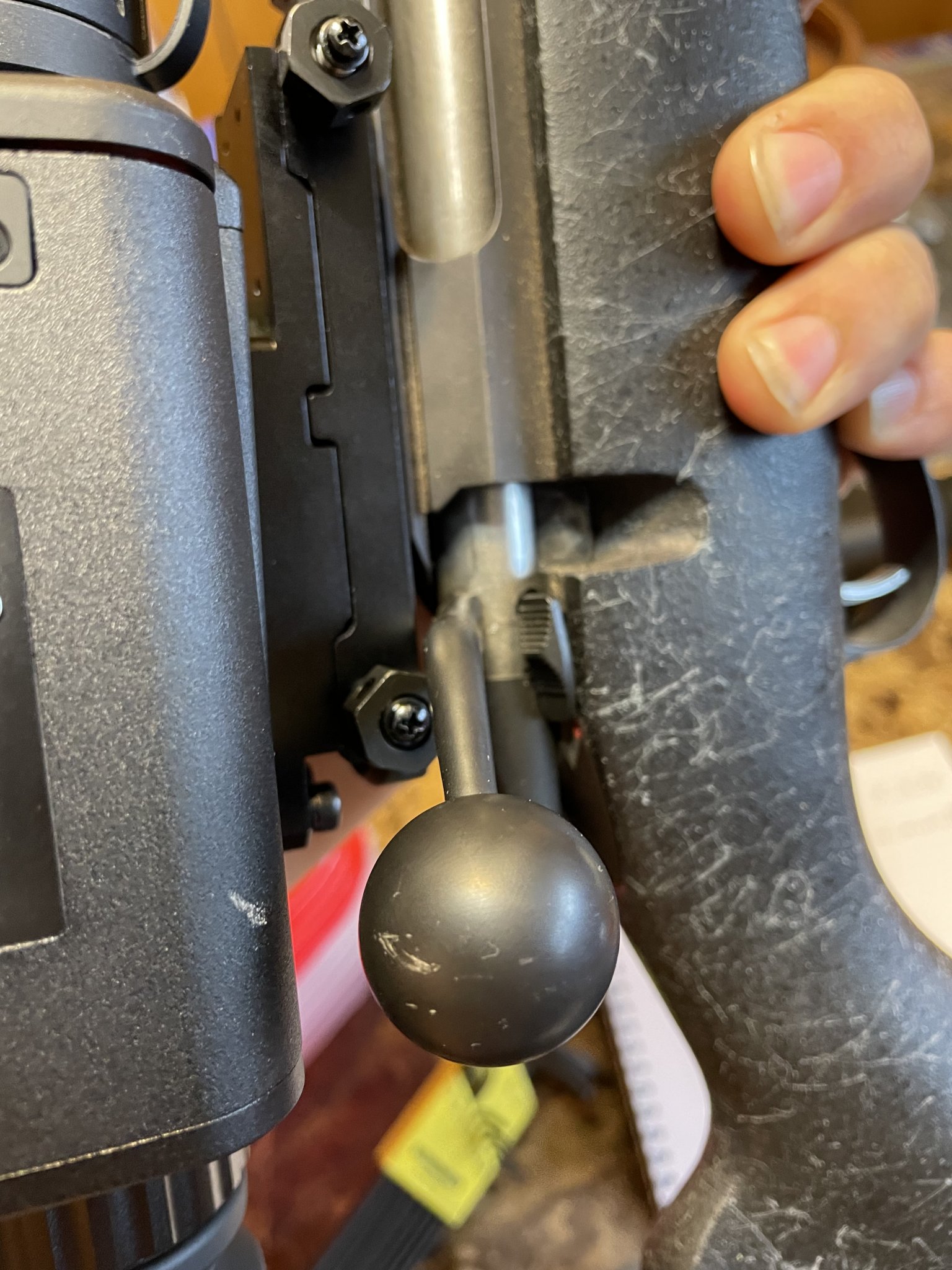

Mounted the S35 on my tikka with a extended rear base from mountain tactical. And my bolt was hitting the nut, couldn’t cycle it reward so I had to take it off and put a standard no5 0.5 nut on to get it to clear. Still hits the bolt slightly when running it fast but works fine. If the nuts were on the left side or I had it mounted farther forward with a standard rail it wouldn’t have it issues. Anyone know if there is a quick release mount that will fit this, it would be a lot easier and might clear the bolt. I didn’t see one on the website or google?
