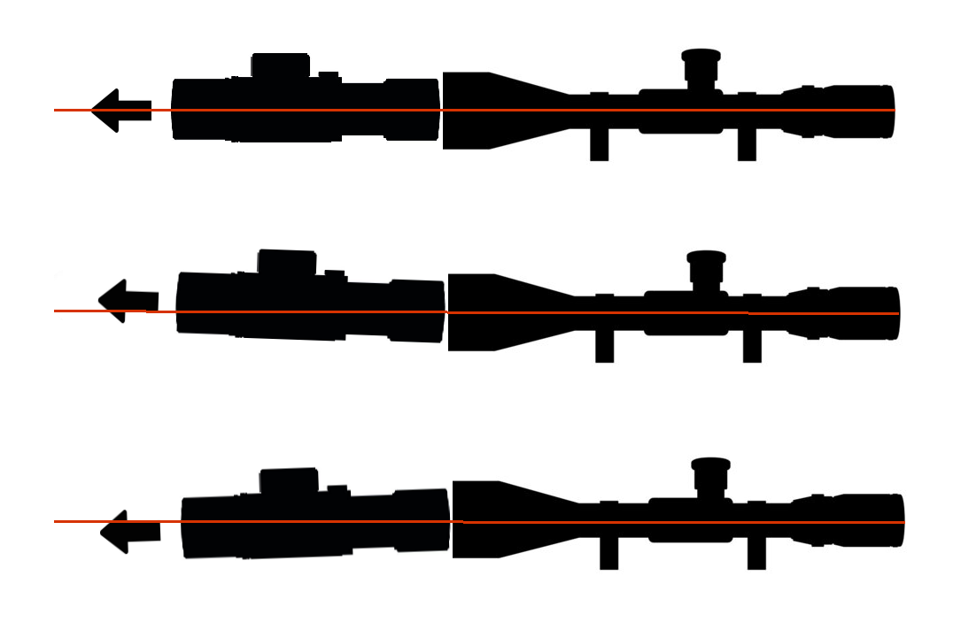

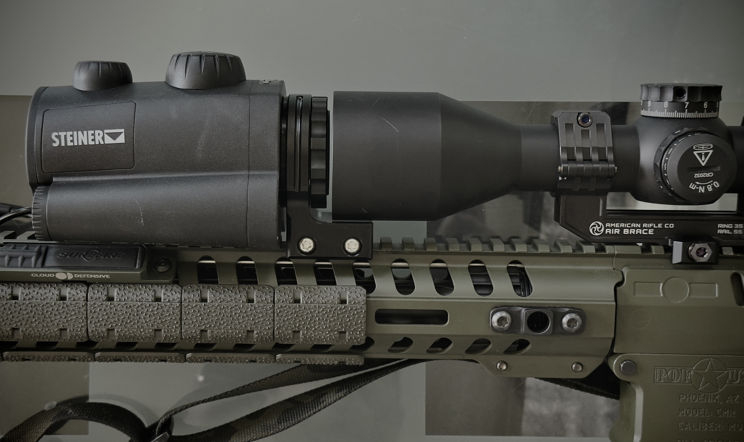

Even if the screen on the back and the camera/lens on the front of the thermal were perfectly aligned, the thermal would also need to be colinear with the scope. It isn't just the up/down/left/right position that matters, it's the angle the thermal sits at. Non-repeatability with clamp mounts is likely caused by inconsistent angular alignment during installation. The attachment point is at the back of the thermal, which is far away from it's front lens. You have a long tube being held out at one end. A very small angular misalignment will cause an offset.
Here is an exaggerated depiction:
I use it with a clamp on with a 3-18x50 with great success - and medicore repeatability. Its essentially a confirmation of zero and tweak almost every time if you're expecting precision. Its a shame because it is capable of 8-10X resolution due to the screen having better than typical resolution.
When you install it, is the rifle oriented horizontally or vertically (muzzle to the sky)? It might be more repeatable if installed with the muzzle pointing towards the sky since the thermal won't be putting any torque on the mount. If there is an internal face on the mount, make sure it's shouldering on the end of the objective bell.

Referencing a pixel isn't going to give any indication of angular alignment since the screen is at the back near at the mounting point. I think the only way to get consistent angular alignment is to have the mount shoulder on the objective bell squarely when the clamp is tightened. Think of it like a suppressor. If the suppressor is loose, the entry hole is still aligned with the bore, but the exit hole may not be. Tightening the suppressor against the shoulder squares it up so that the exit hole is aligned. It's the sensor/lens being inconsistently aligned that is causing the lack of repeatability.

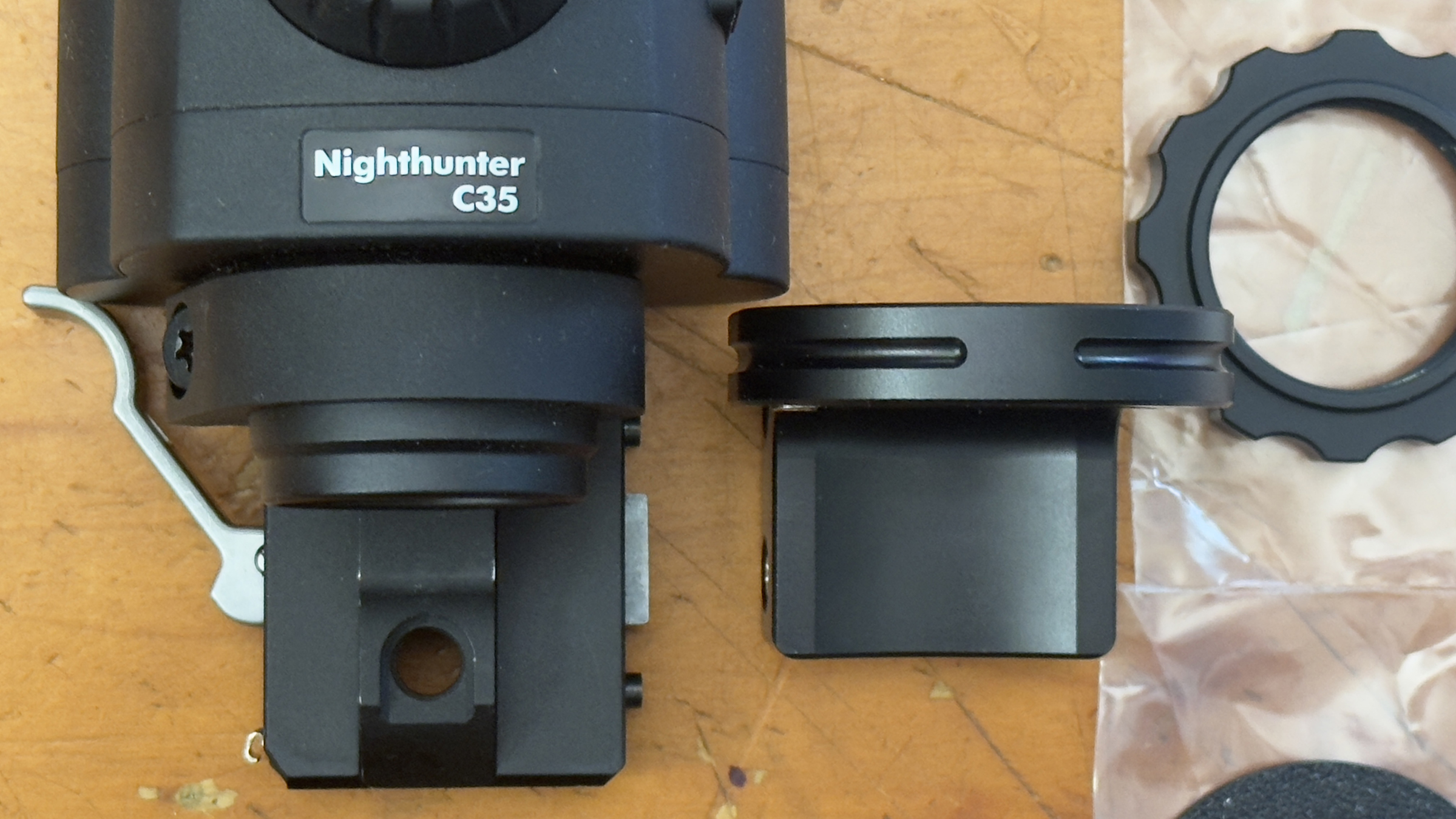

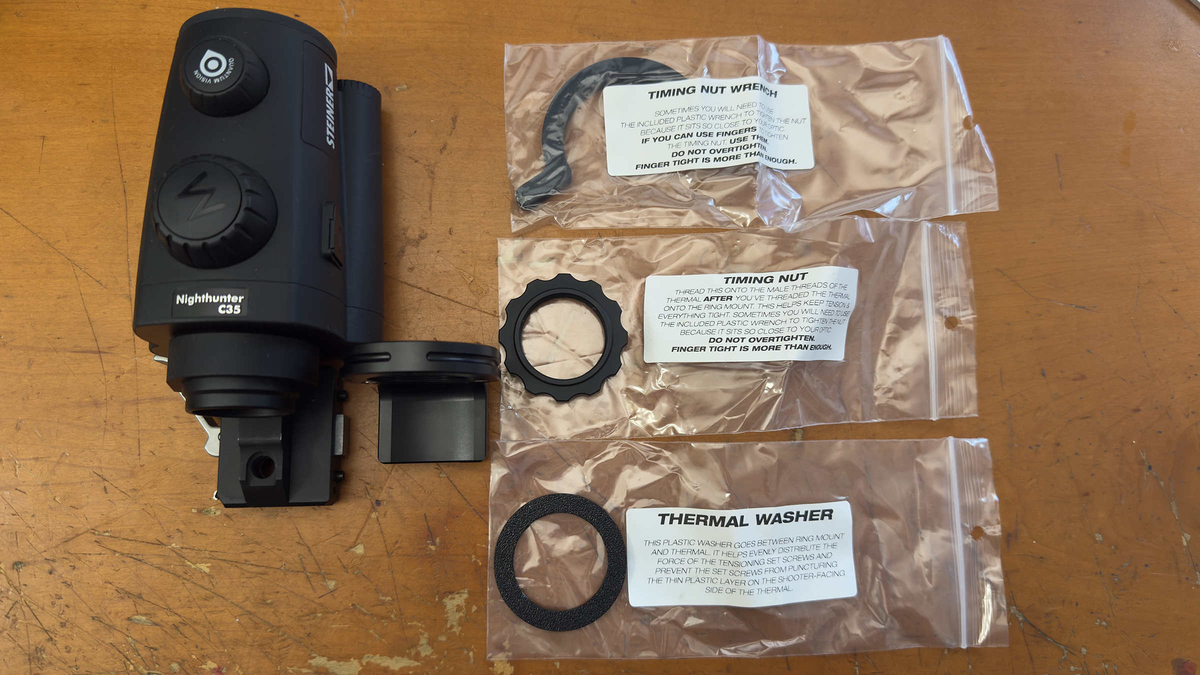

The C35 gen 2 is able to be consistently mounted to the scope bell using the Praezise-Jagen mount, at least according to @35L4S SOTIC
https://www.snipershide.com/shootin...ed-9-30-with-third-hunt.7214576/post-11994270
He also has a short review on that page.
I found that you can use a Praezise-Jagen adapter to turn the unit into a scanner in 2 sec here:
https://www.snipershide.com/shootin...ed-9-30-with-third-hunt.7214576/post-12011542
That vid also gives a great overview of how the Praezise-Jagen mounts work.

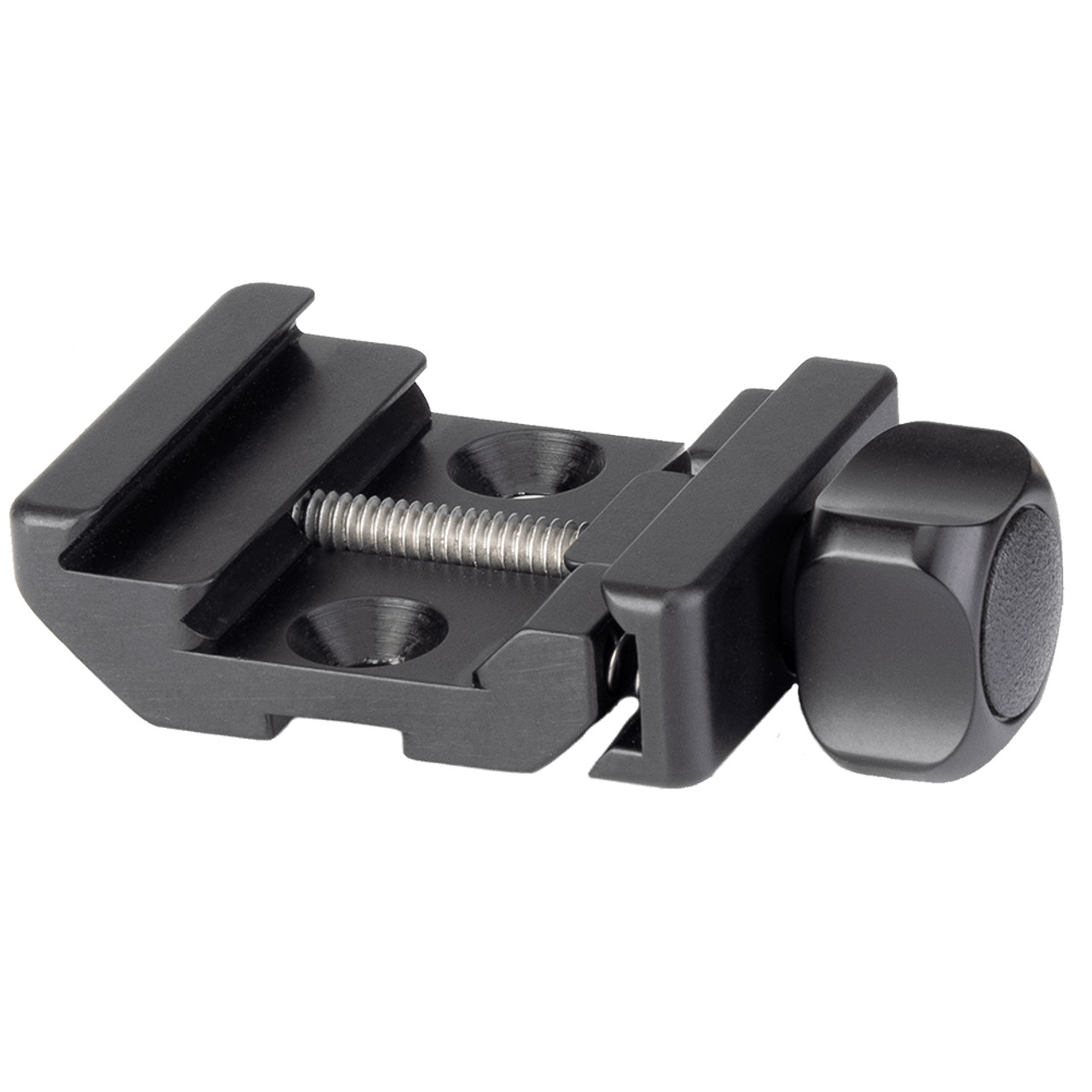

Even a screw knob would at least make the Annex picatinny mount QD.
Or maybe this kind of lever:
You can index them, they're like a small pod-loc.

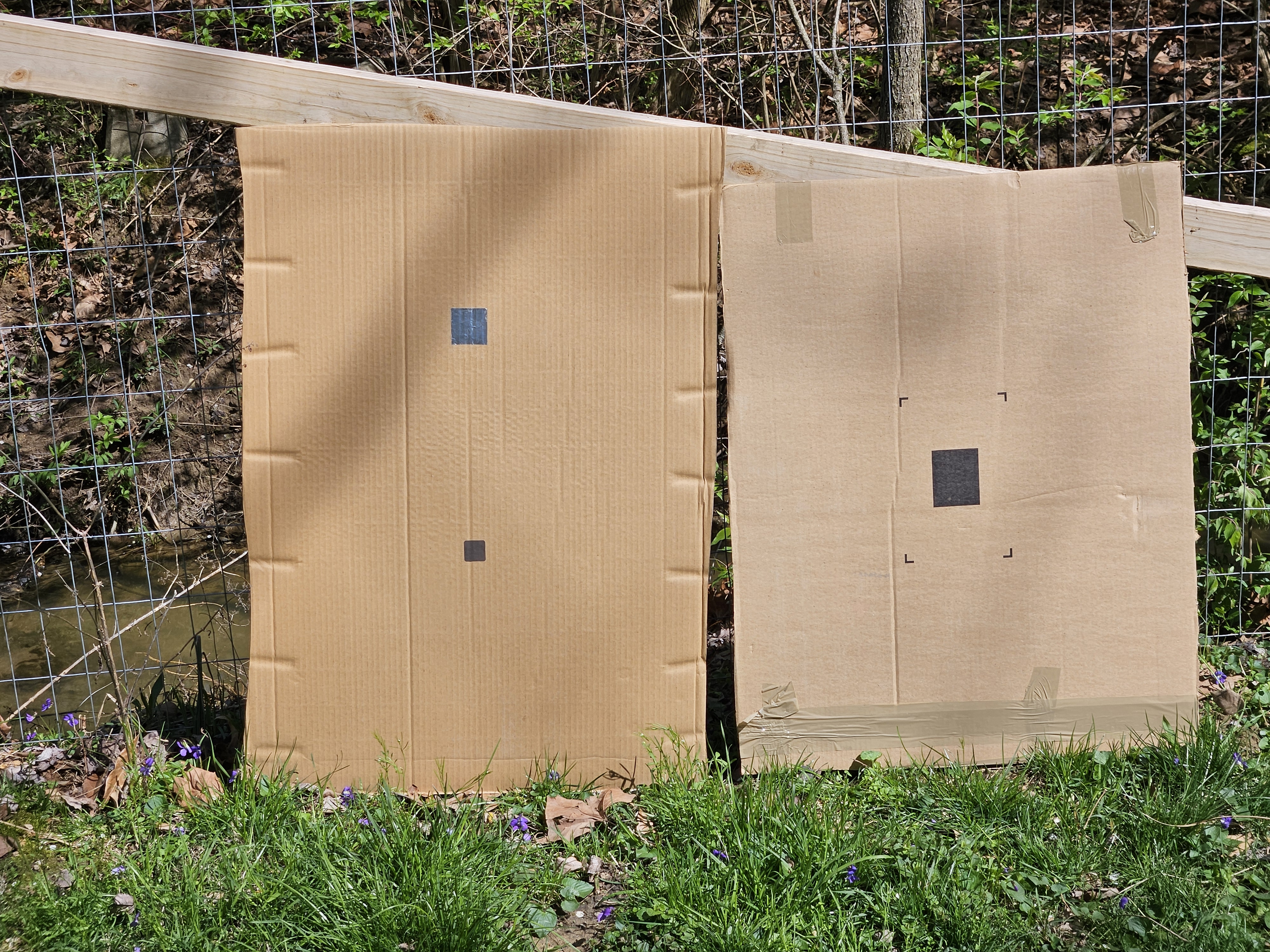

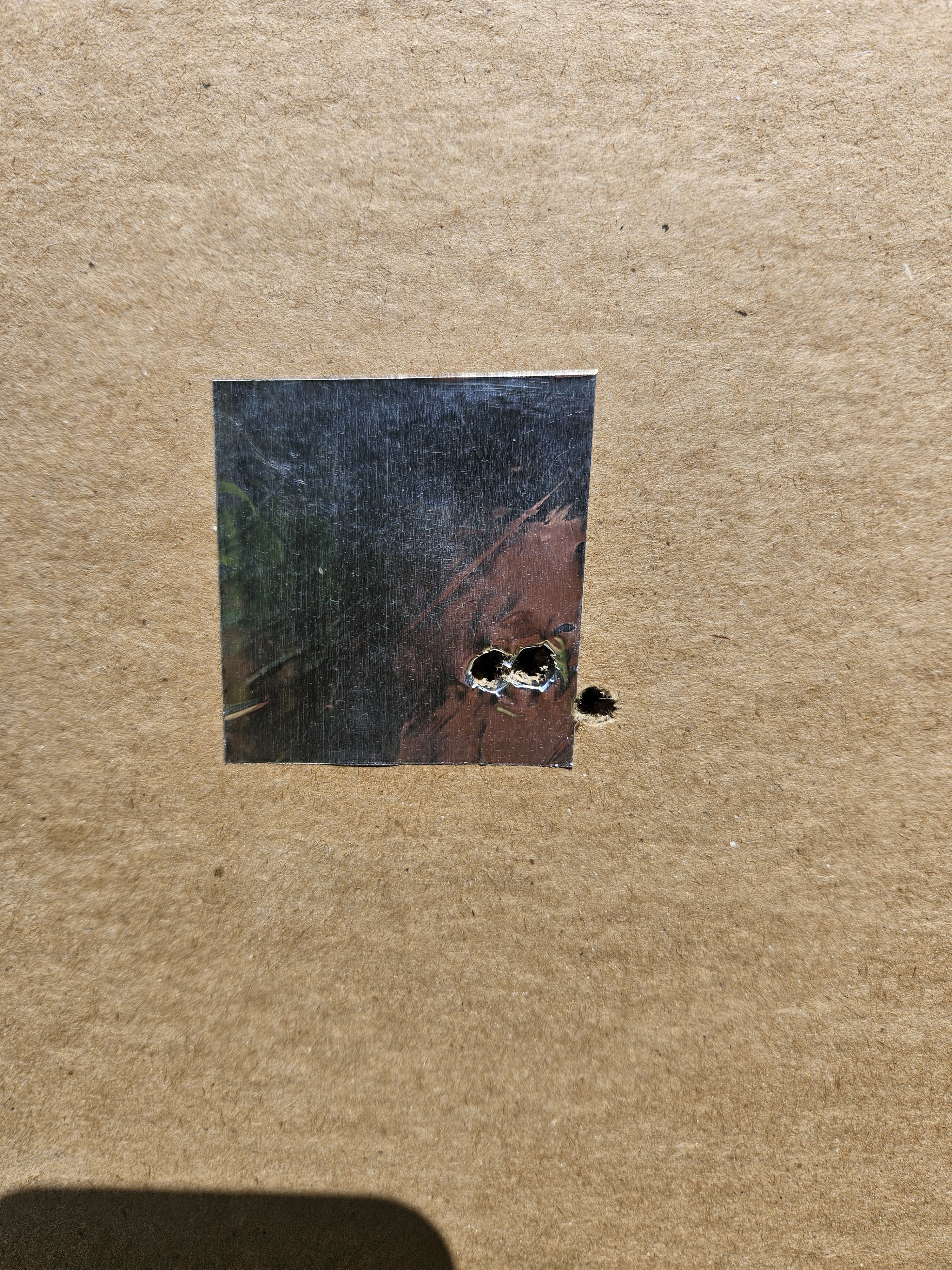

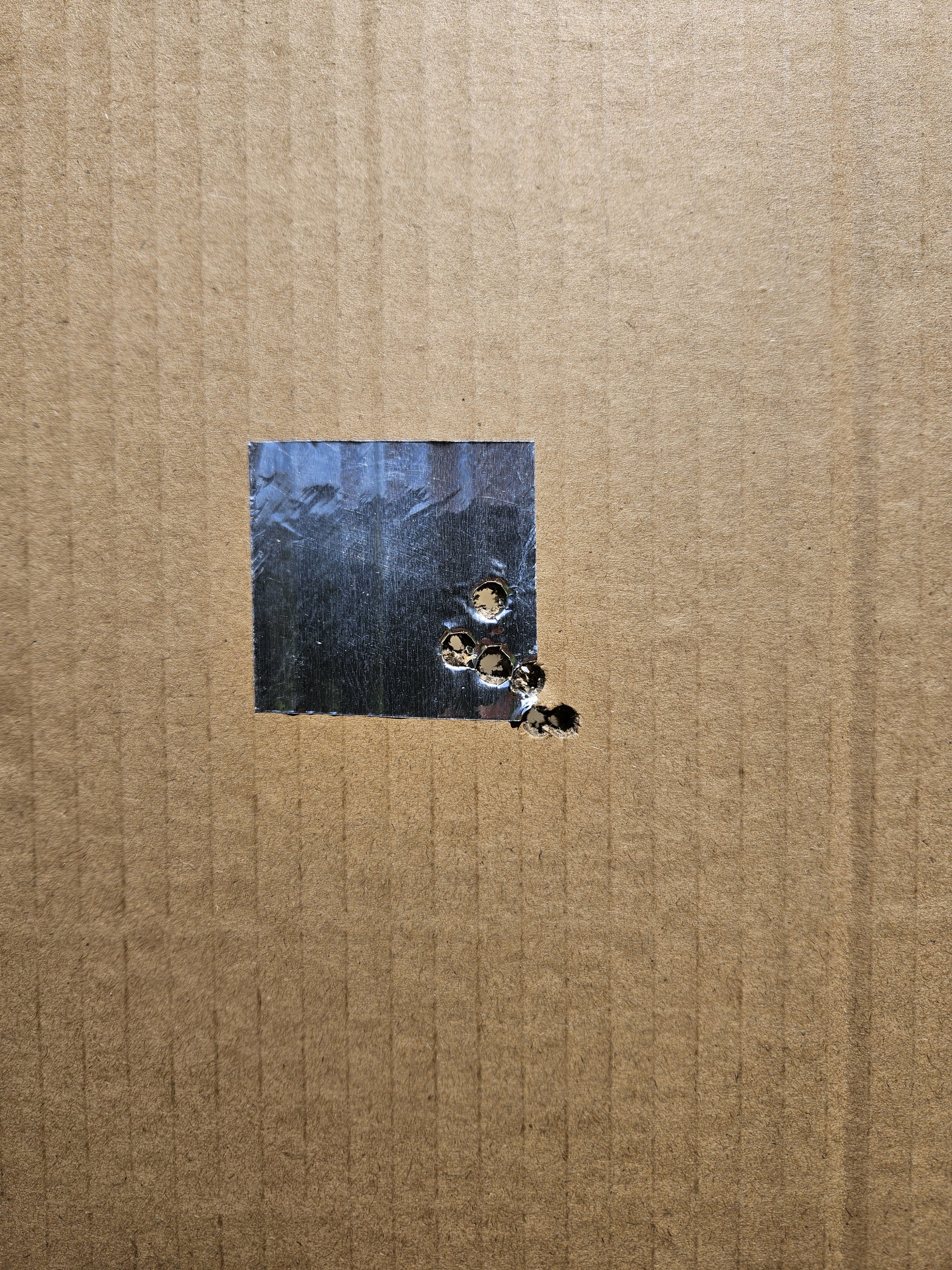

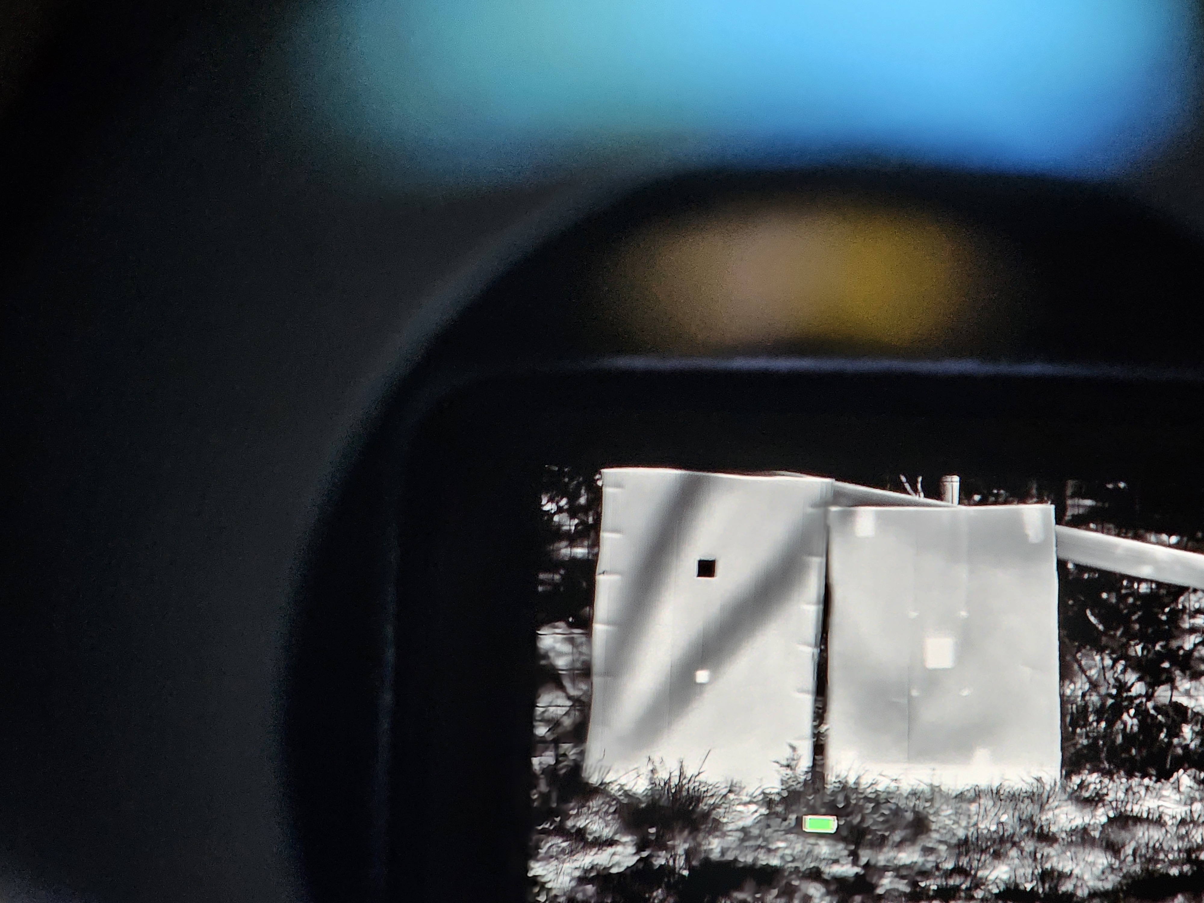

Got back from vacation yesterday and finally got to try it. Two groups on my 223 boltgun at 100 with and without the C35. Same offset I set it to for my AR.
Took it off, put it on the AR to bang some steel, then put it back on the boltgun.
The image is photo-like! These don't do it justice at all!
The NV bridge picatinny is at about 1.25" below optical center. Still worked. Could only see half the menus. If I moved my head around I could actually see around/under the thermal. AR scope I set the offset for was a standard 1.5x" height AR mount.
