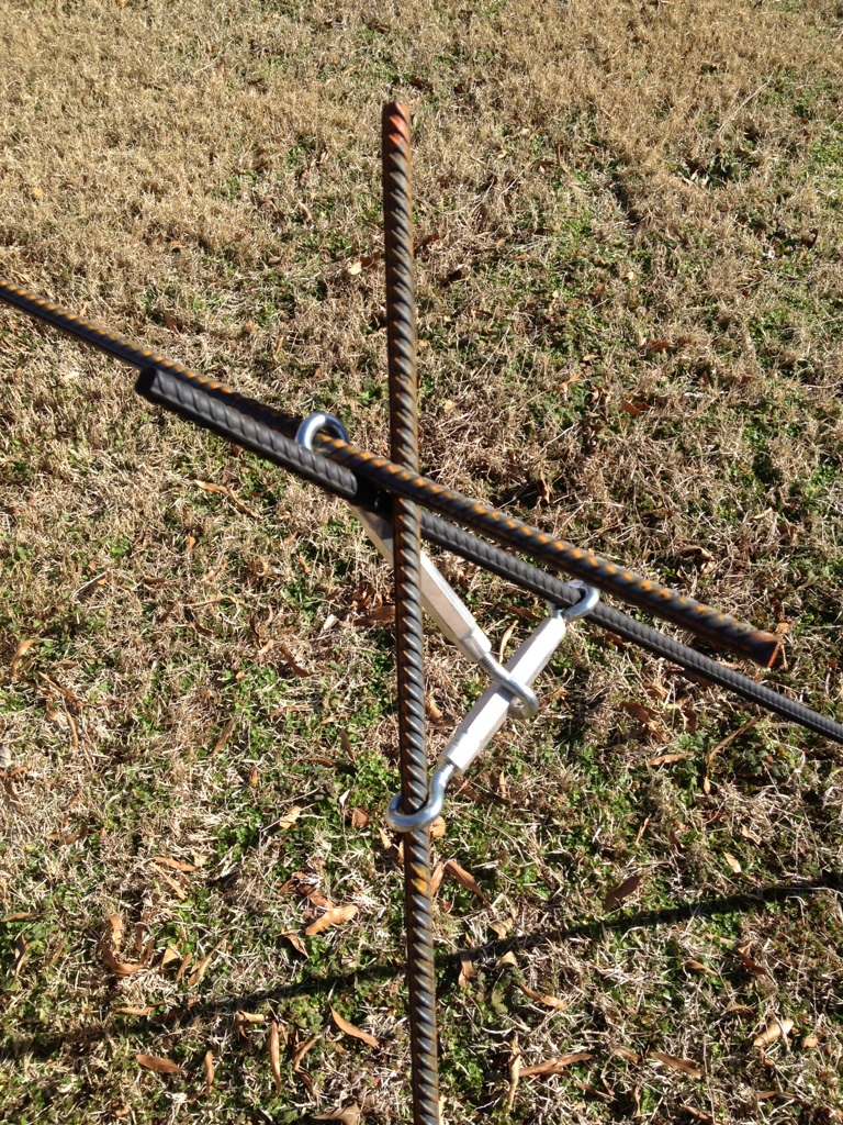

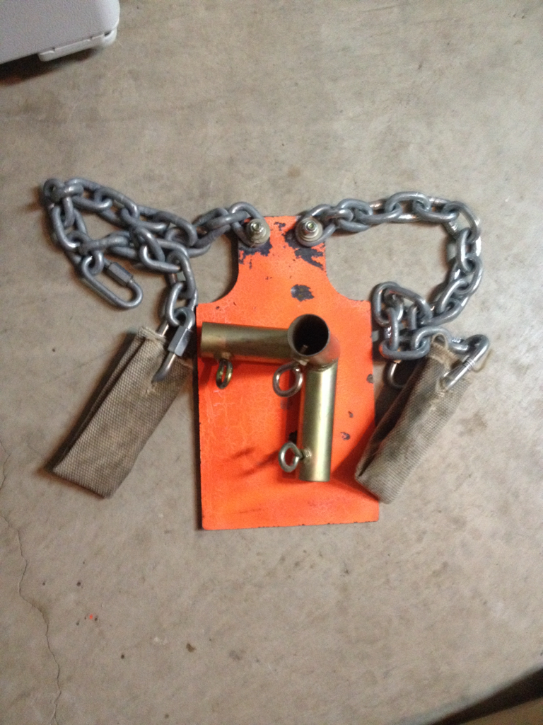

I've been using the brackets for tarp covers like you see at the local bazaars. My neighbor was a distributor and hooked me up. I just run 1" conduit for the legs and center section and then run fire hose loops with chain to the targets. works great a distance. up close I have been using the t-post targets from jc steel.

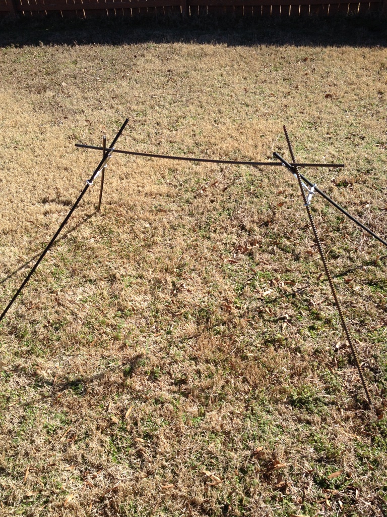

I looked at the last stand and didn't want to pay $80 for two of those things. This is what I came up with. About $30 and collapses completely and is very shrapnel resistant. With a 1/2 scale ipsc on it it will handle 300wm at 200 yards no problem. The top rebar bowed slightly after about 40 shots on mine but bends right back. Here is an album Trunk Ready Target Stand - Imgur

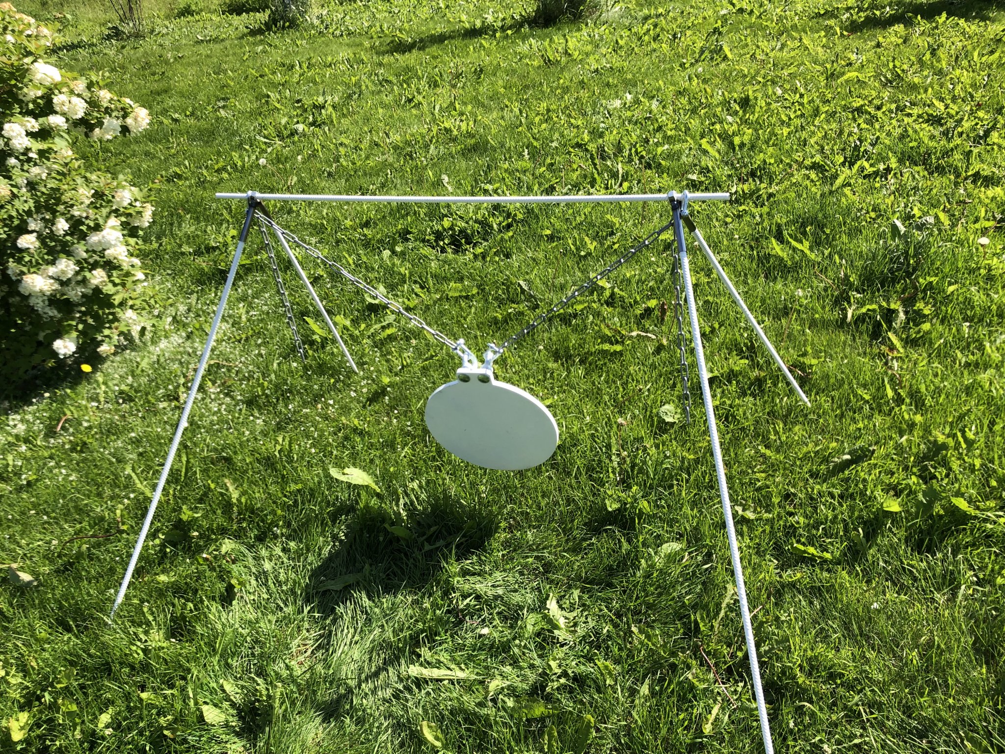

I have been developing my own brackets from two piece of pipe and big nut to be used with a 10mm (#3<10mm<#4) rebar. Nut will make the leg angle to 60 degrees. It seems to be solid and heavy.
I might share when I get weldings done.

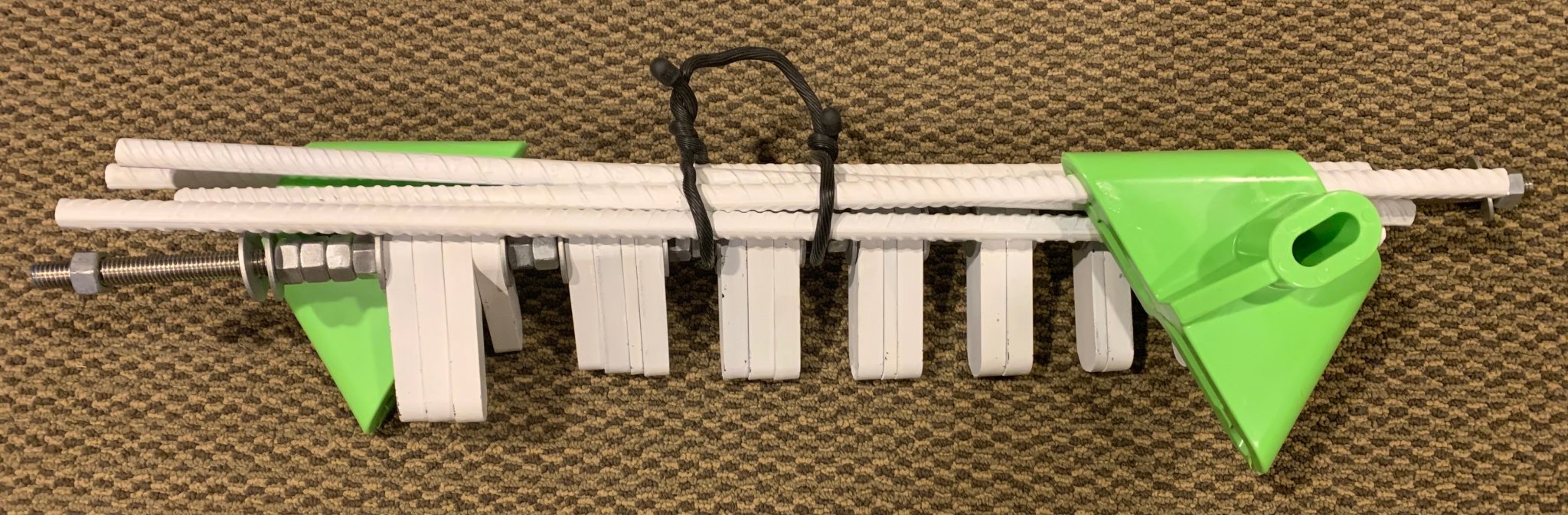

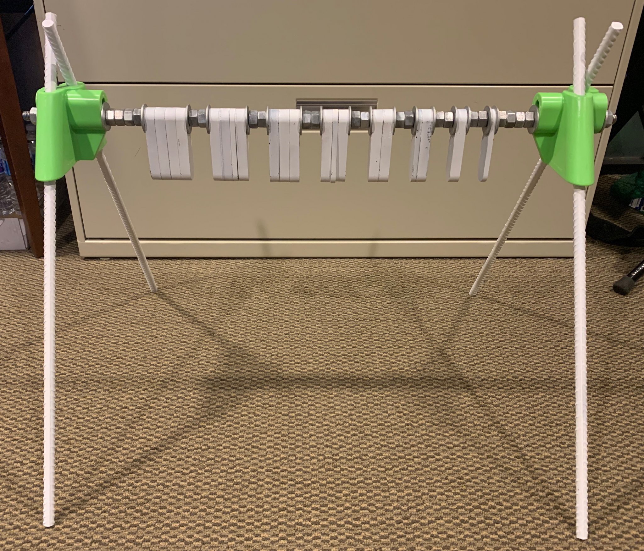

Just finished my DIY/Buy (Last Stand/Shootingtargets7/Home Depot) highly portable KYL rack. Intent was to have a KYL rack that is more compact and will easily fit in the car for range day - all with out a welder and with easily replaceable parts.
There's ~1/8 inch of space/play between the sets. I'll know tomorrow how they spin but by hand, they spin great. I know that I have another wire/flex tie around here somewhere and I'll likely find it next week after the first range session. :)

That's pretty cool. Great use of the LastStand kit. Have you used it yet? How did it hold up? What calibers/distances?
I might have to copy as I already have the stand. :) Do you have a parts list for the KYL? I'm sure I can reverse engineer but if you have it handy, can you share?
In particular, which Shootingtargets7 parts did you use?

16x 1" wide x 1/2" thick AR500 gong targets from shootingtargets7.com.
4x 1" wide x 1/4" thick AR500 gong targets from shootingtargets7.com.
*36" threaded stainless rod (cut to size after putting together the nuts, washers, targets, etc.),
*4x 24" long by 1/2" thick pieces of rebar
*bag of 25x 2" wide galvanized washers (with a 1/2" hole in them) - from Home Depot
*bag of 25x galvanized nuts for the 1/2" stainless rod - from Home Depot
The Last Stand target stand ends - be sure to put a washer and nut on both sides of the target ends
I use Rustoleum (SP?) white primer as the paint. The "*" items are from Home Depot.
FWIW, I've only used it for 22LR from ~40 to 200 yards. It's AR500 steel, so the targets themselves should hold up to just about anything that normal AR500 steel would take (probably more) - durability for the galvanized parts are a maybe.
Lastly, it works great. I've totally shot the heck out of this target with my 22LR and after each repaint, the target still looks new.
After hitting the 1/4" targets at 50 yards (consistently) one day, I moved it to 100 yards. 2" down to 3/4" at 100 is almost too easy. Shooting the 1/2 & 1/4" targets at 100 yards is addictive.
Total fun. :)

That's awesome John. Thanks for the parts list and the report. I bought my kids a .22 (CZ 455 Scout) last Christmas, they would love this.

FWIW, while the KYL rack really has been great. However, I think that I’ll soon suffer buying a bunch more steel. Frankly shooting steel is addictive - in a good way. :)
