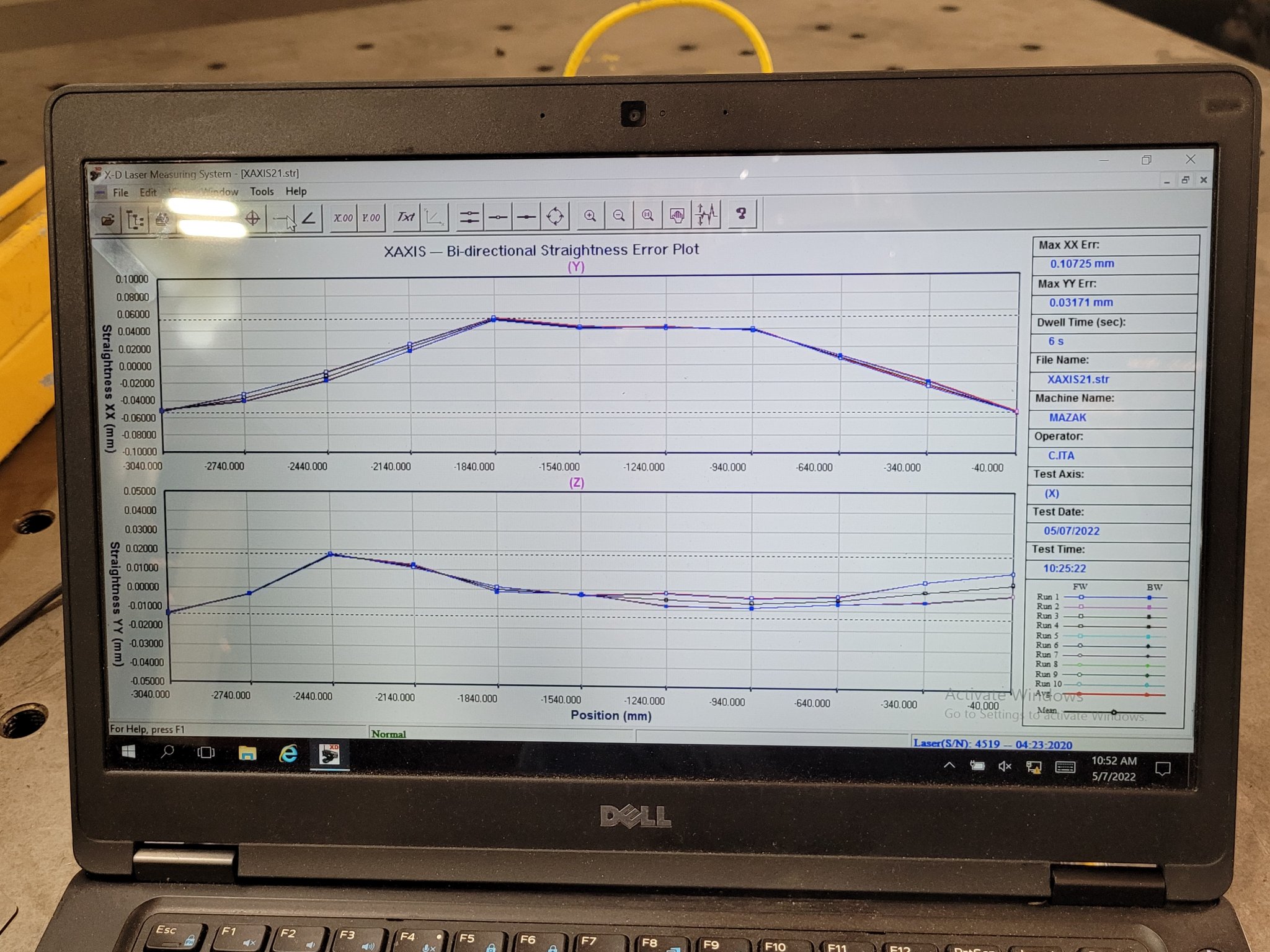

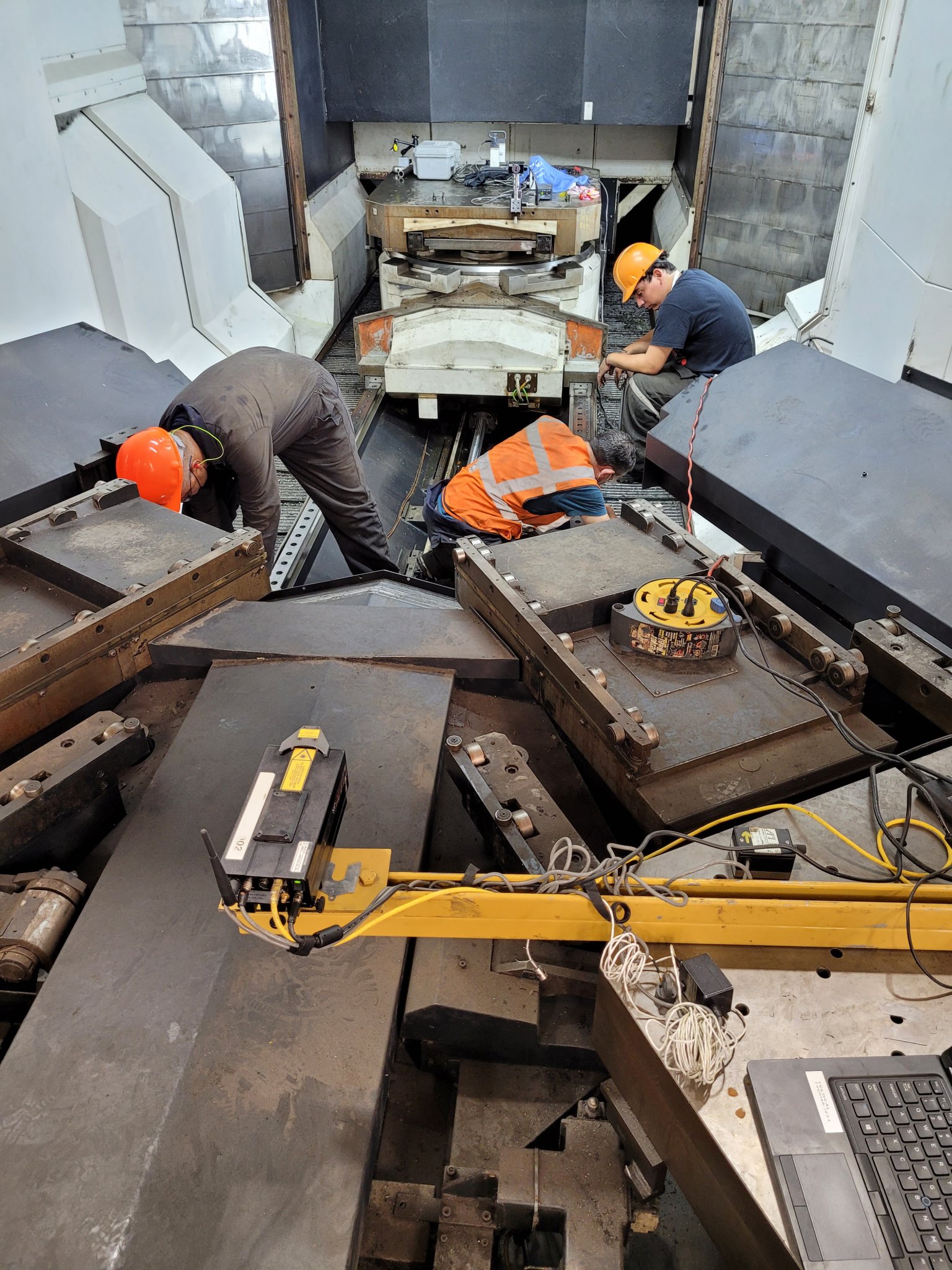

Mazak 1850 V II after being relocated to another facility.
The top graph shows .1mm (.004") error over the 3m length in the side to side direction (XX) We are shooting for considerably less.
My normal job is as a machinist, my additional duty is to inspect installs.
When they fail inspection its been up to me to help them get it right. There is a bit of a language barrier occasionally.

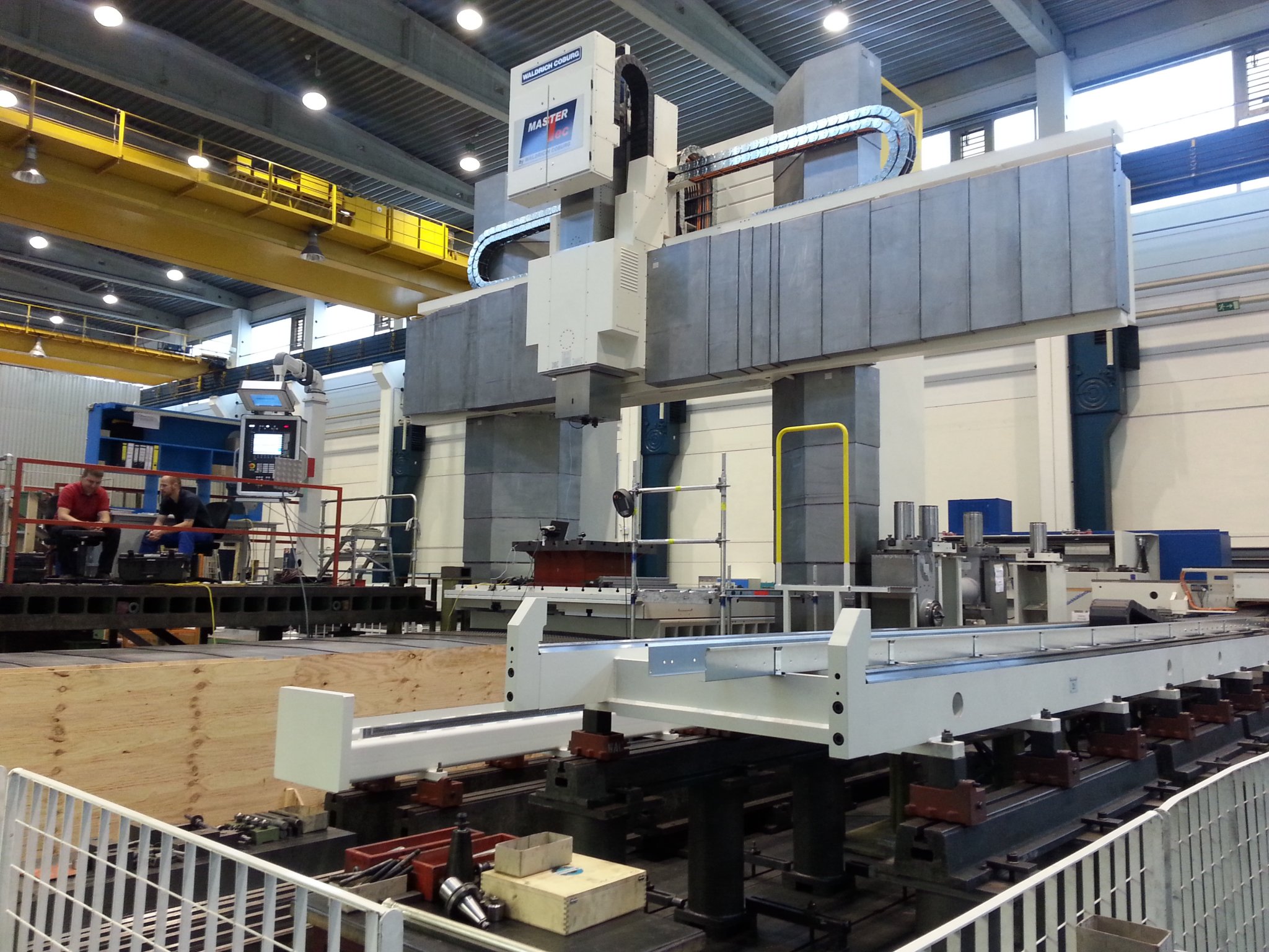

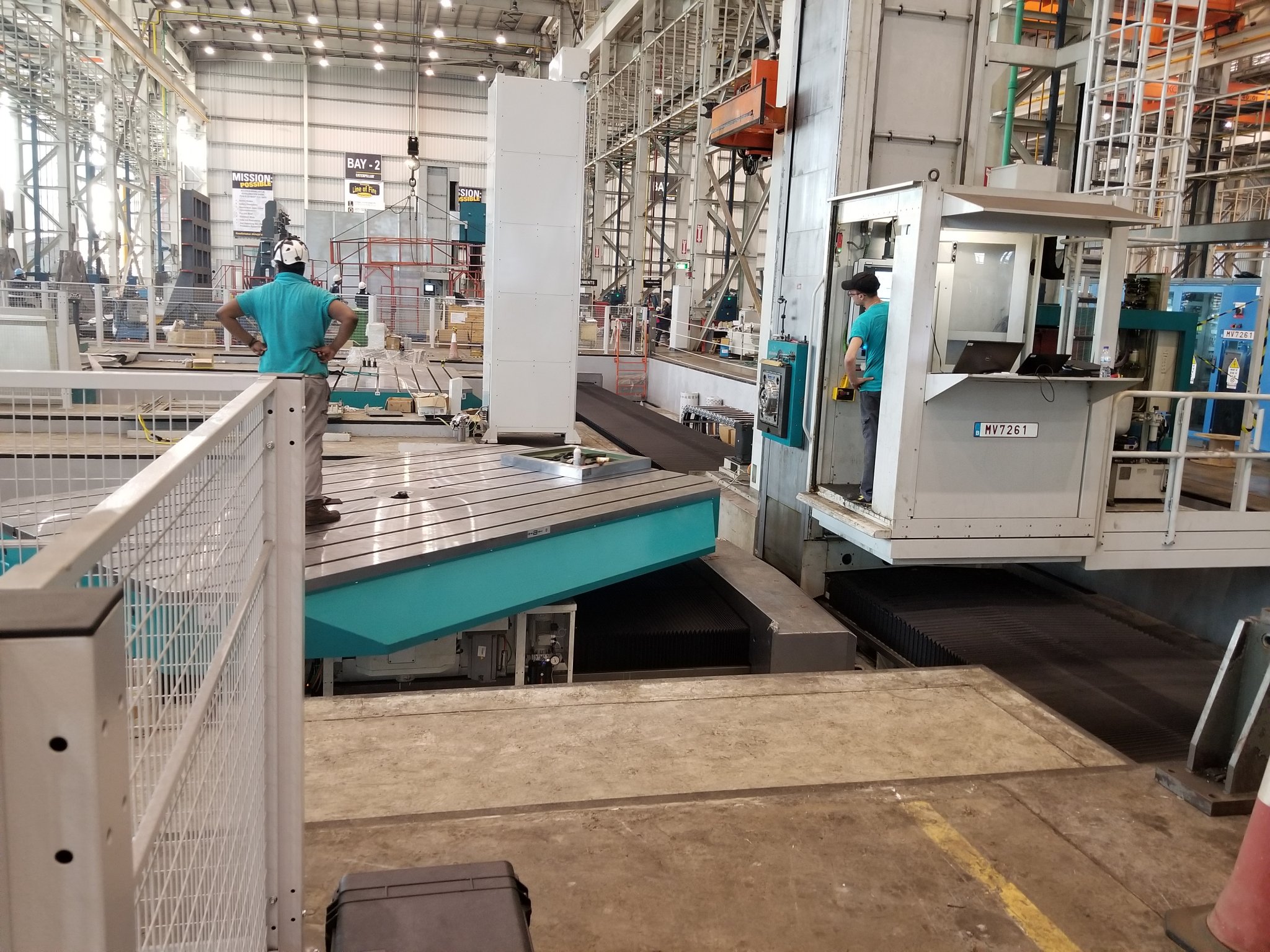

Sometimes they aren't the smallest.
Ist pic is Waldrich Coberg in Germany. The second is a Pama from Italy. Some times you have to be a contortionist to reach, the last one is a multi spindle that kicked out parts every 11 seconds give or take.

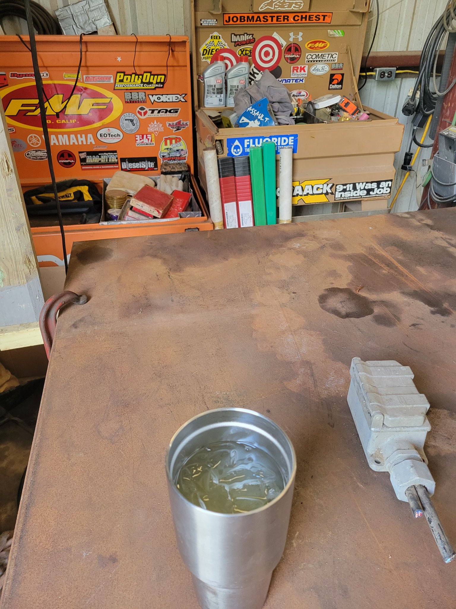

Any Rust 911 users? https://www.rust911.com/
Tried it on a whim a few months ago and was surprised at how well it worked. Much cheaper than Evapo-Rust, etc and is concentrated so 1 gal gets you 17 mixed and works faster/better/longer life than others. Haven't tried to test it but assume it's a mild acid, maybe citric, but not much detail available about it.

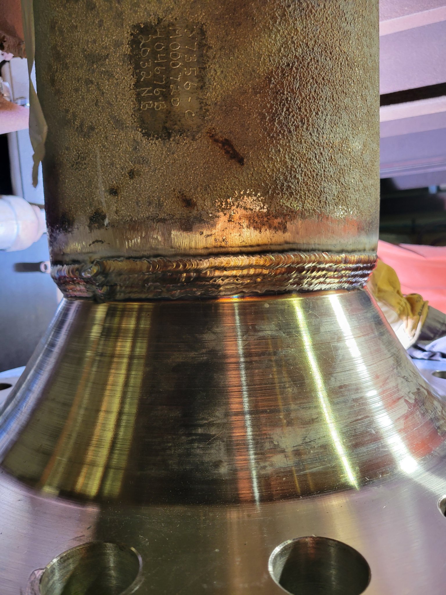

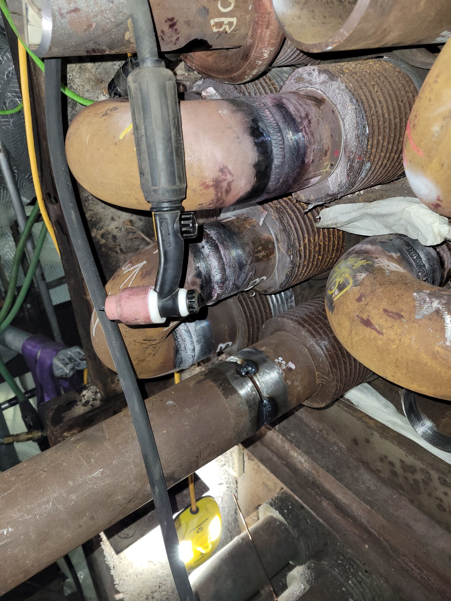

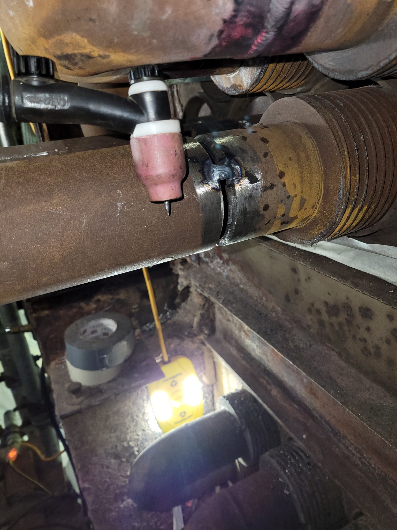

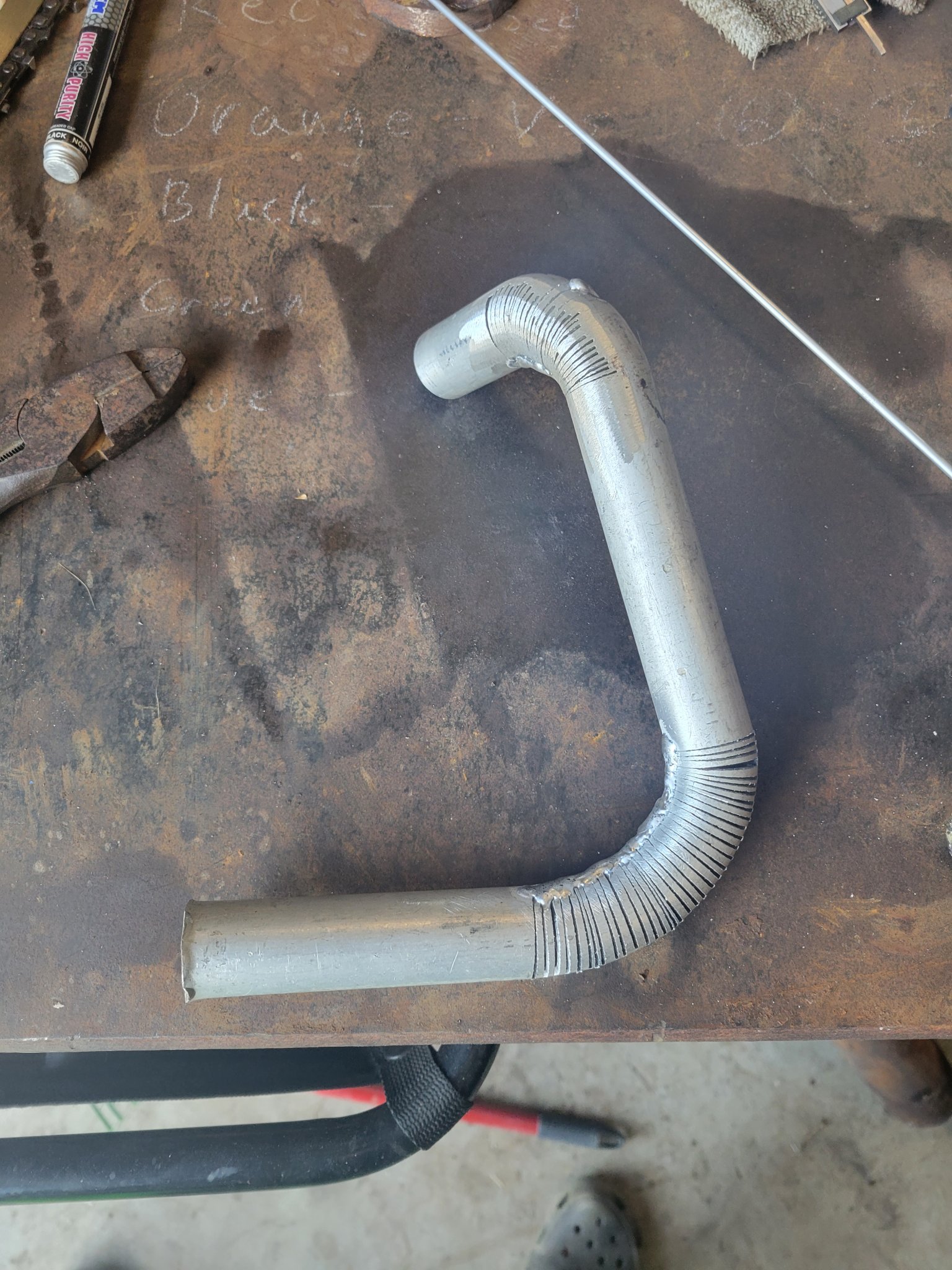

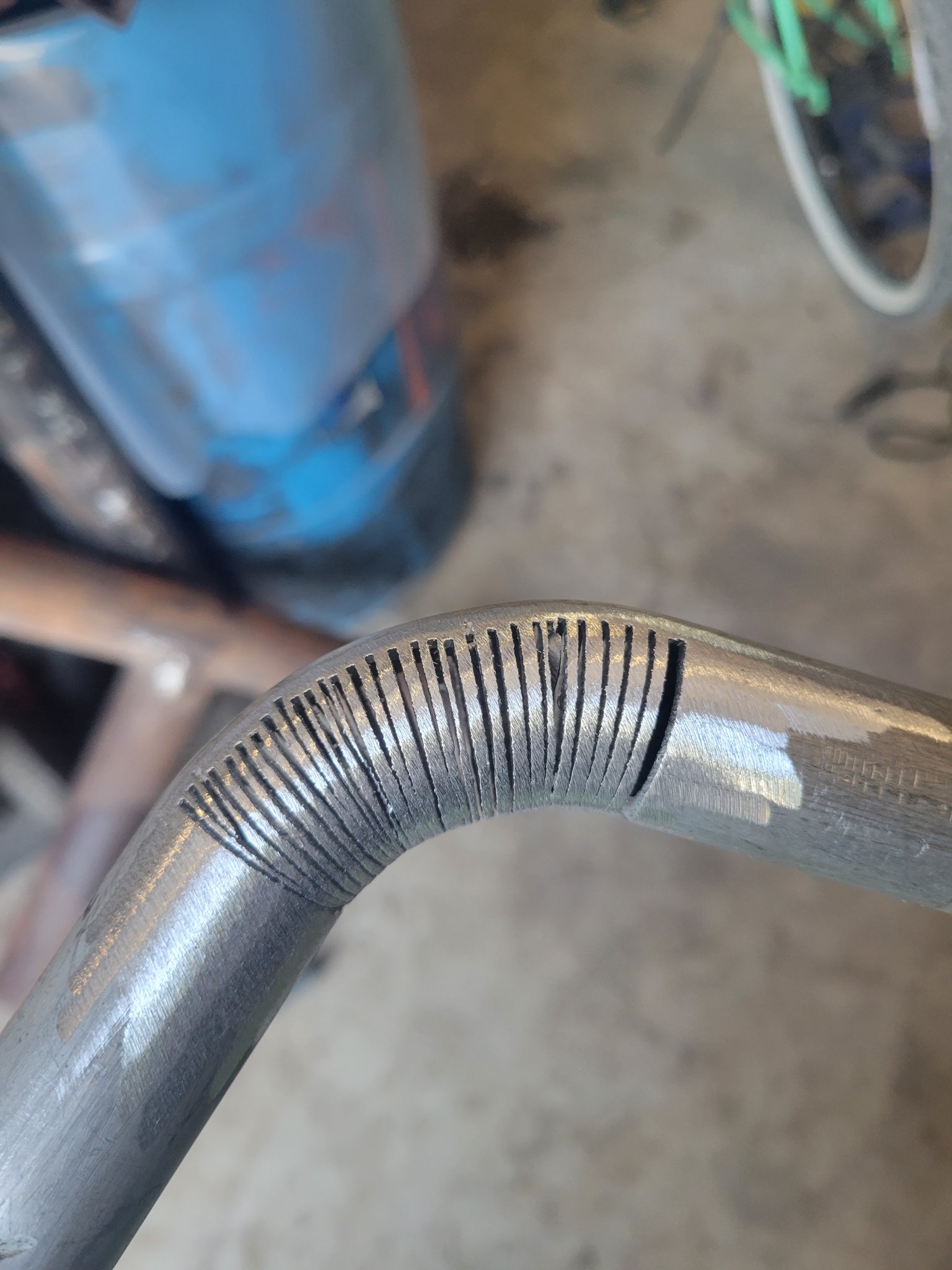

I keep finding myself in these situations. I've got just about as much cut out of that 150amp rig as you can get. And it's still too big.
I believe I would have to be getting set up for a 20 series water cooled torch with a flexible head for those tight spots. Kudos to you for sure in all those challenging positions. See if this CK Worldwide flex loc water cooled 250A torch would be of interest to you: https://www.ckworldwide.com/products/flex-loc-250-water-cooled-torch
I absolutely love my Dynasty 210 for its portability and power. I find that setting it up for pulsing at about .7 sec intervals with a 25% background amperage helps to keep heat buildup minimized in the work and in an air cooled torch. I run a stubby consumable kit with my 17 series flex loc air cooled torch it that lets me run series 9/20 gas lens and consumables for those tight spots.
I absolutely love my Dynasty 210 for its portability and power. I find that setting it up for pulsing at about .7 sec intervals with a 25% background amperage helps to keep heat buildup minimized in the work and for an air cooled torch. I run a stubby consumable kit with my 17 series flex loc air cooled torch it that lets me run series 9/20 gas lens and consumables for those tight spots.
I always seem to run into porosity issues with the really small torch parts. We don't exactly weld in very controlled environments. Water cooled would be nice but setting it up in the environments I work in would be a pain. I've seen them on big boiler jobs but on these heaters you just don't see it.
Rig in the pic is a 17 series flex head thats been chopped up. I'll have to post some pics of my different setups that we use in these places.

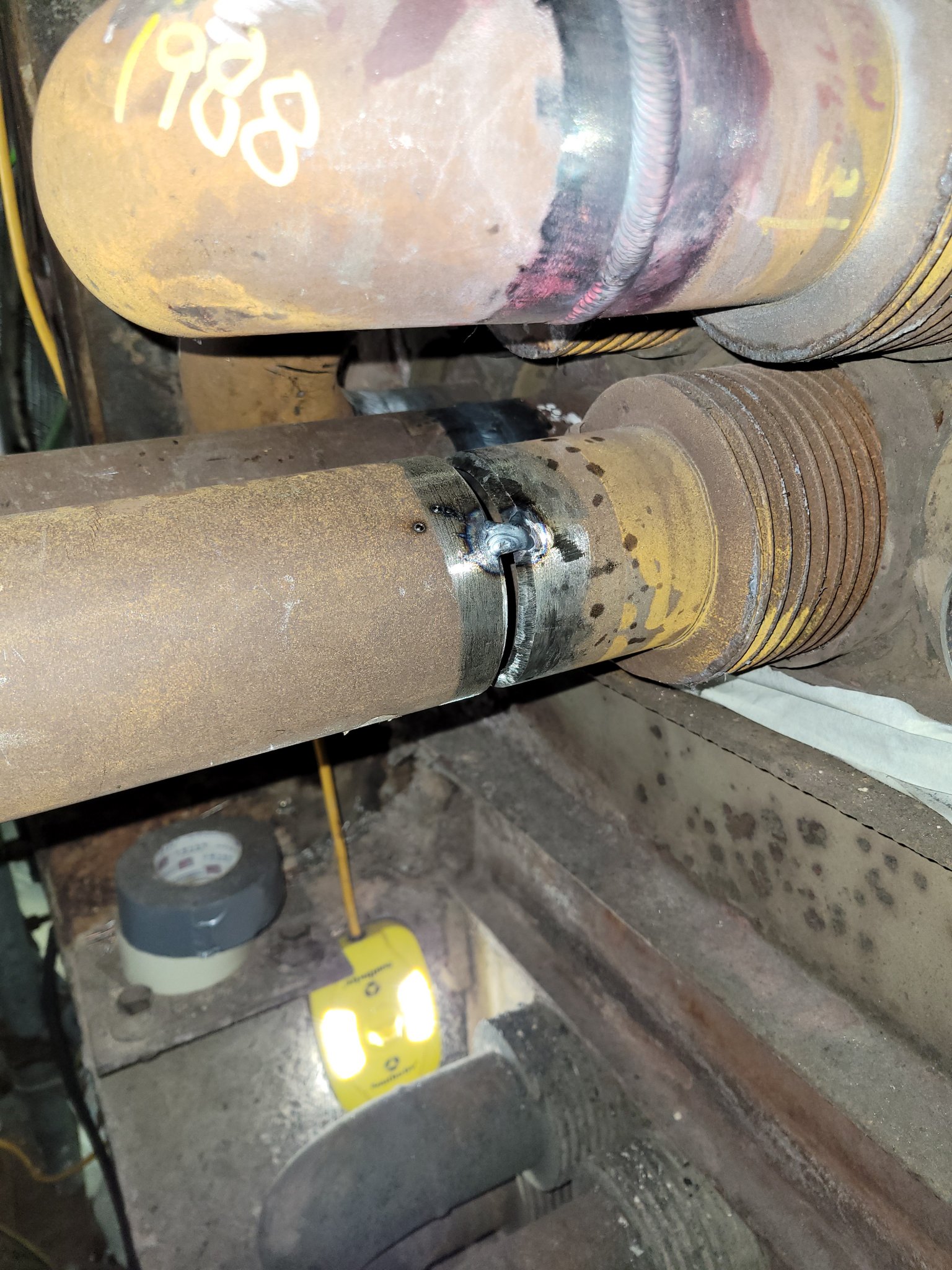

That is some impressive TIG work especially in such a confined space. Put myself though college as a welder working on a large ranch then in the oil fields in northern NM. Back then the only thing we used was stick and oxy/acetylene. Didn't weld for may years after college but got the bug again after needing to make some fixtures for my home shop. Picked up a good MIG machine and was intrigued by TIG so bought and traded several machines and now using a Fronius 230I. Being self taught on TIG has been a challenge but after lots of practice gotten to the point where I can consistently run a decent bead.

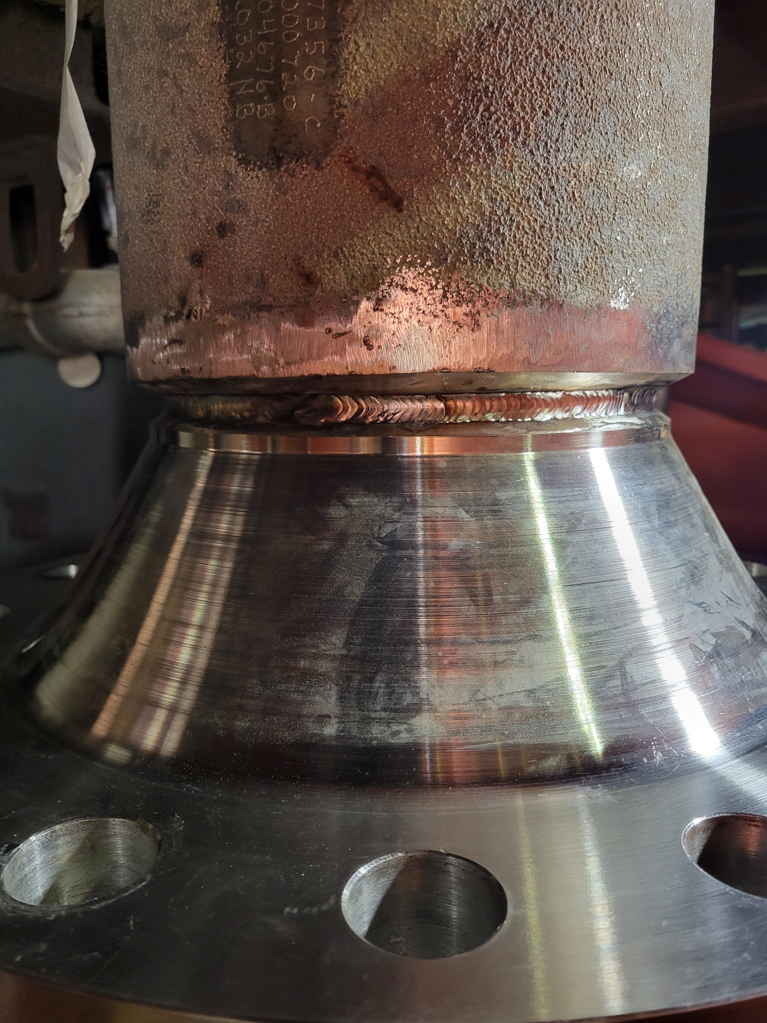

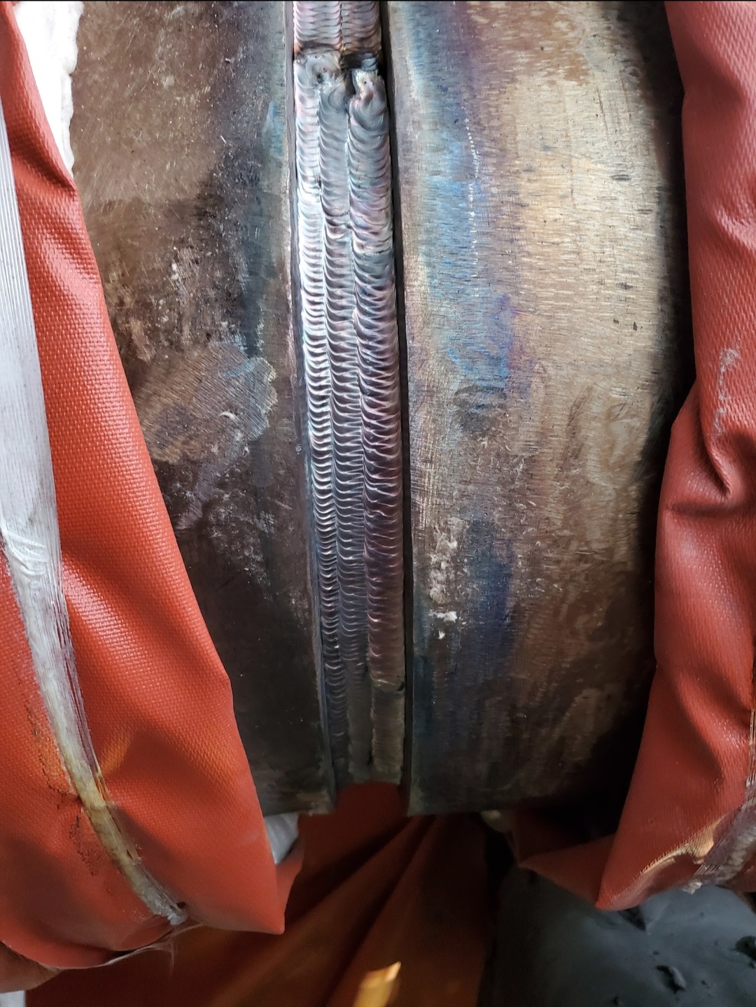

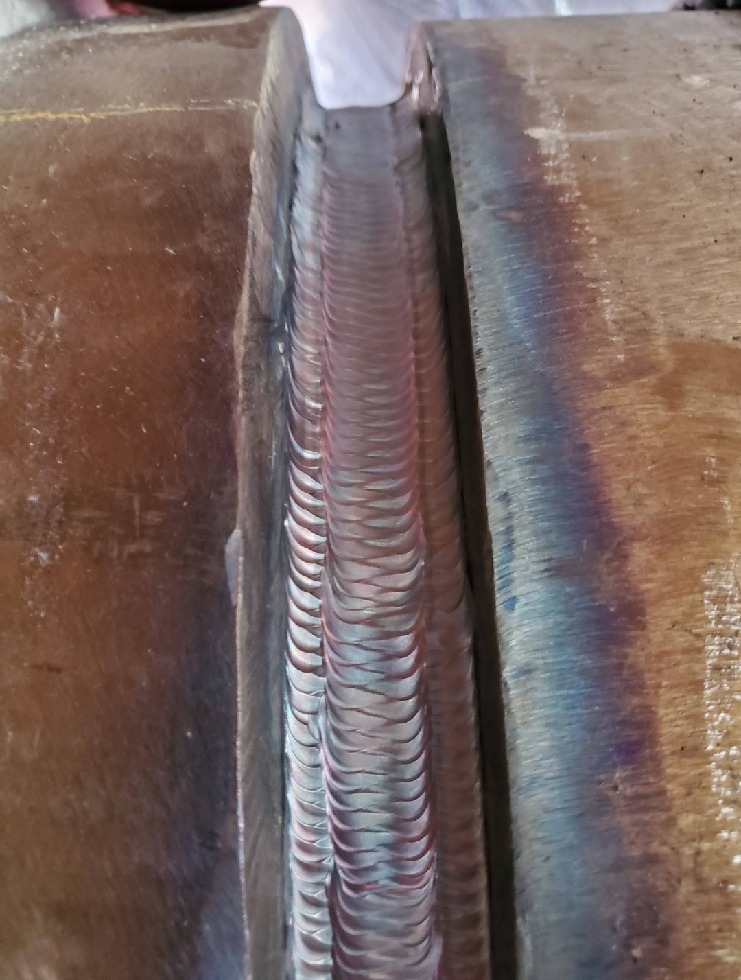

This one was a while back. 20" 2¼ chrome, 2½" wall. Took three shifts to weld out. We were supposed to fill/cap with stick but the rods were no good. Got porosity like mad so we ended up going tig all the way out!
This job I had a miller big blue 500. I'm starting to prefer the big blues to the Lincoln vantage or rangers because the miller's will give you everything they have on lift arc tig. The lincolns max out about 255 on the tig setting. I had the big blue sitting comfortably at 335 amps on this one. About half way out in the pics.
View attachment 7852622View attachment 7852623View attachment 7852624

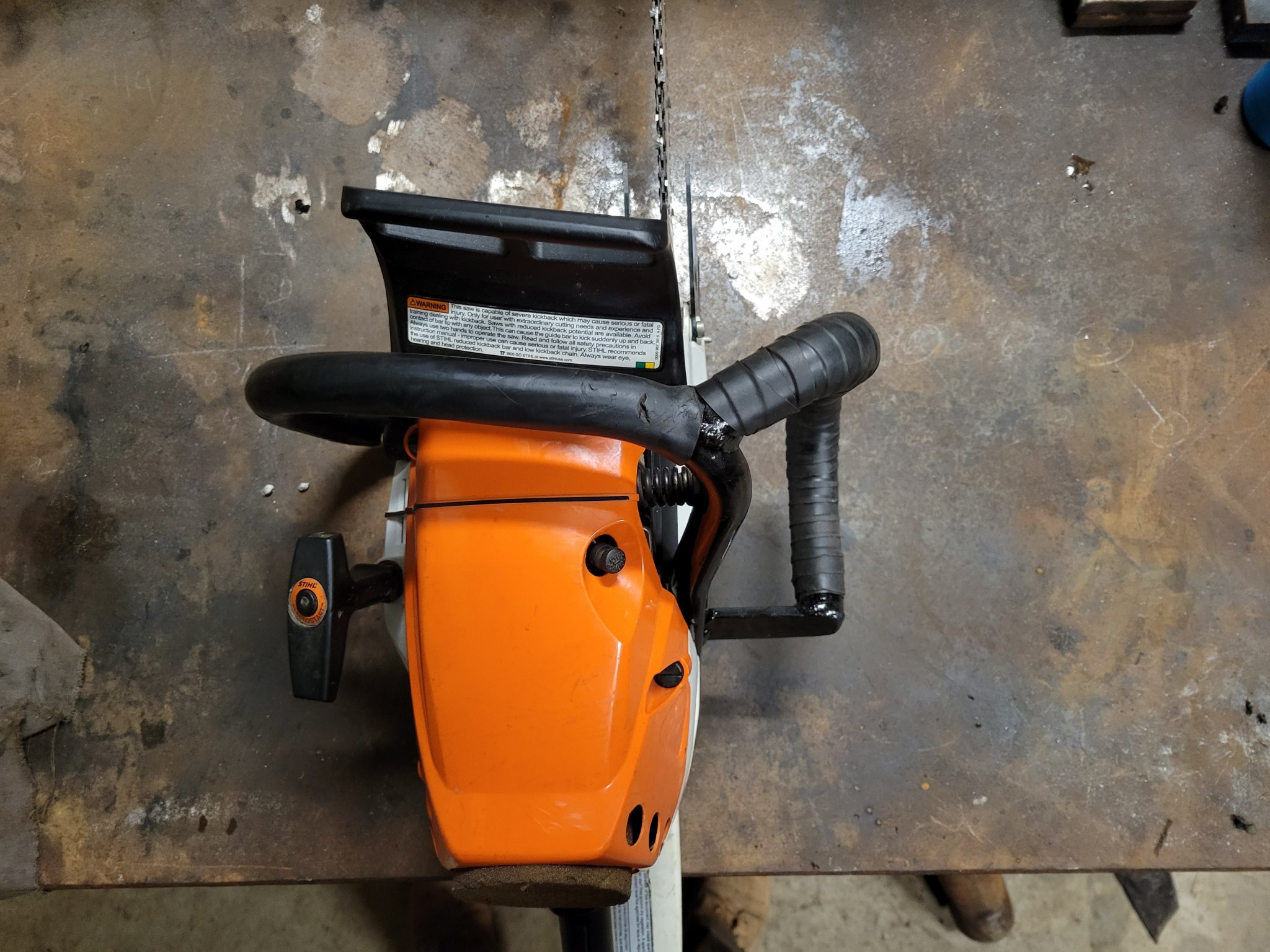

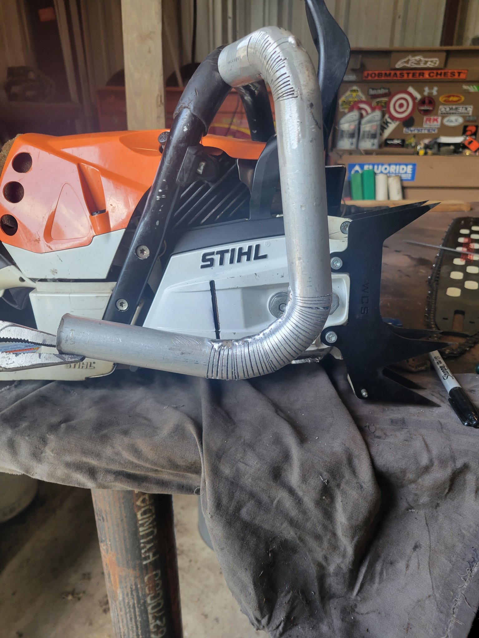

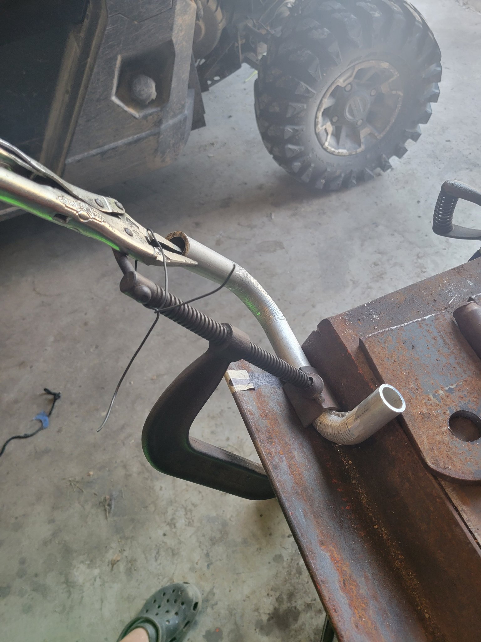

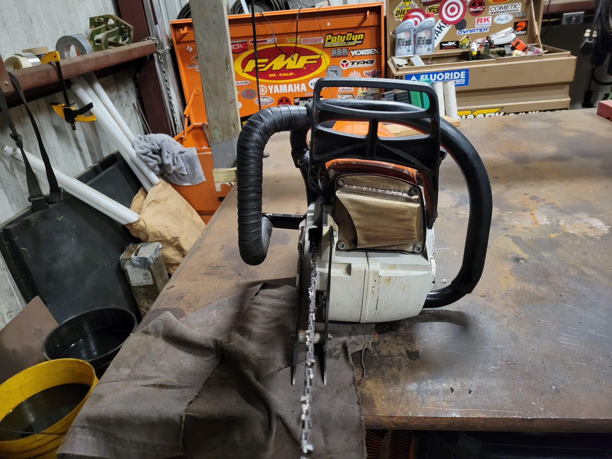

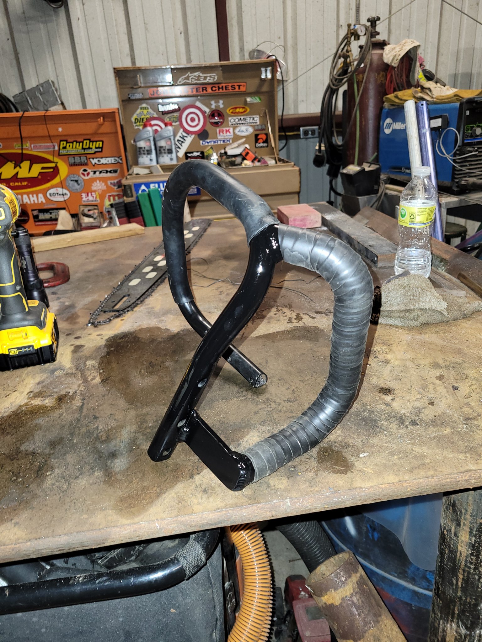

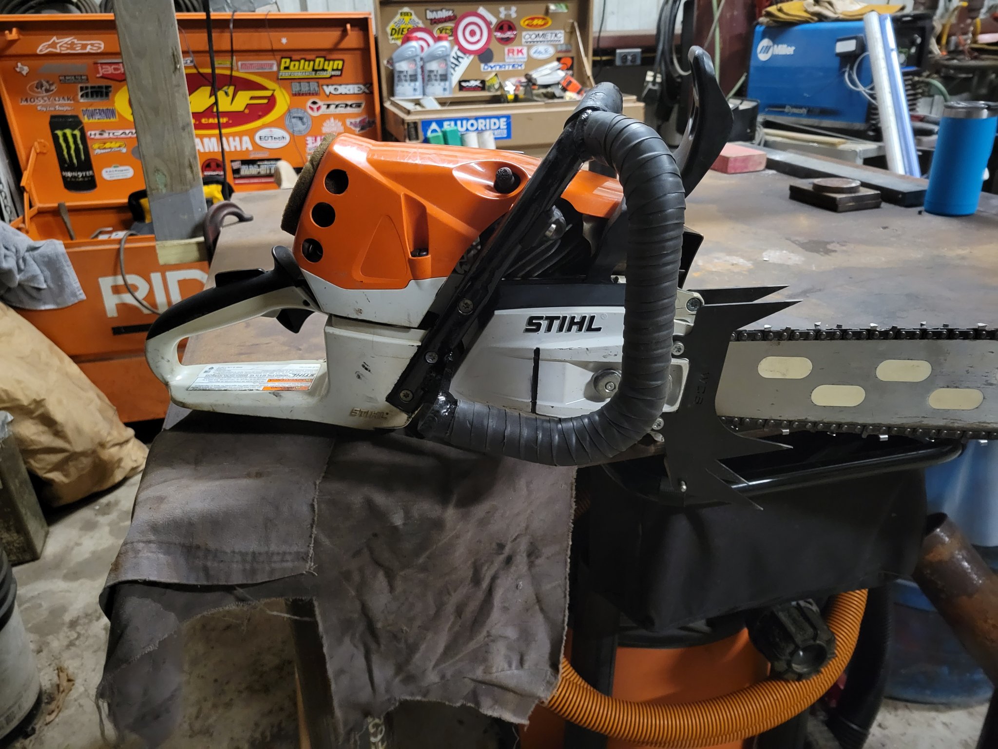

So I wanted a wrap handle for my saw but stihl is mighty proud of them. About $160 plus shipping. The husqvarna equivalent runs about $50. Wtf stihl. I'll probably still order one. Maybe. In the meantime I've got some 3/4 aluminum pipe and a bandsaw and a welding machine.
Dig that fixture lol. Vise grips and tie wire.
Now to figure out how to weld it to the existing handle without completely smoking the rubber.
Wrap it with a wet rag maybe?
Guess it's time to rely on the wisdom of this bunch.

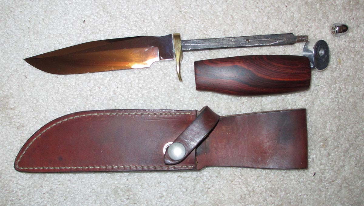

Might as well drop this in here too.

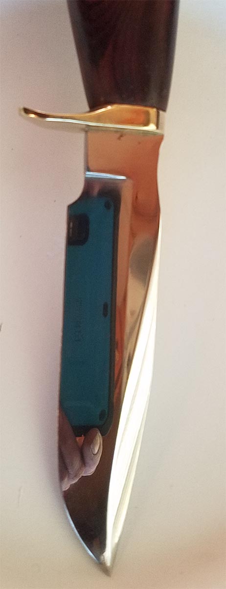

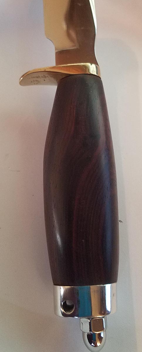

It's a custom BlackJack "skinner" knife in 52100 ball bearing tool steel.
She's from the 80's....the sheath should tell you the age.
I took the blade out to 2000 grit and then white jewelers rouge to polish her out, tossed the laminated wood handle and made a new one out of cocobolo (shit is not cheap).
It will shave you, very easily.....I have honestly shaved with it on campouts when hunting.
I'll have to grab her and take some assembled pics.
It's better than anything you can buy off the shelf these days....BlackJack did some nice shit.

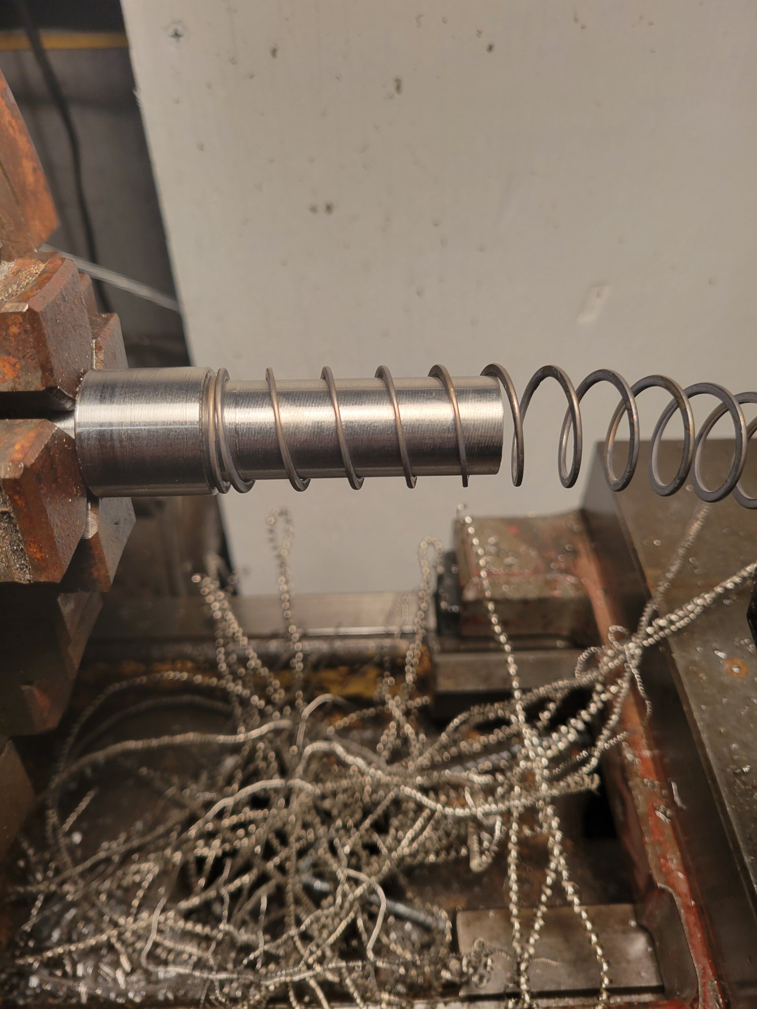

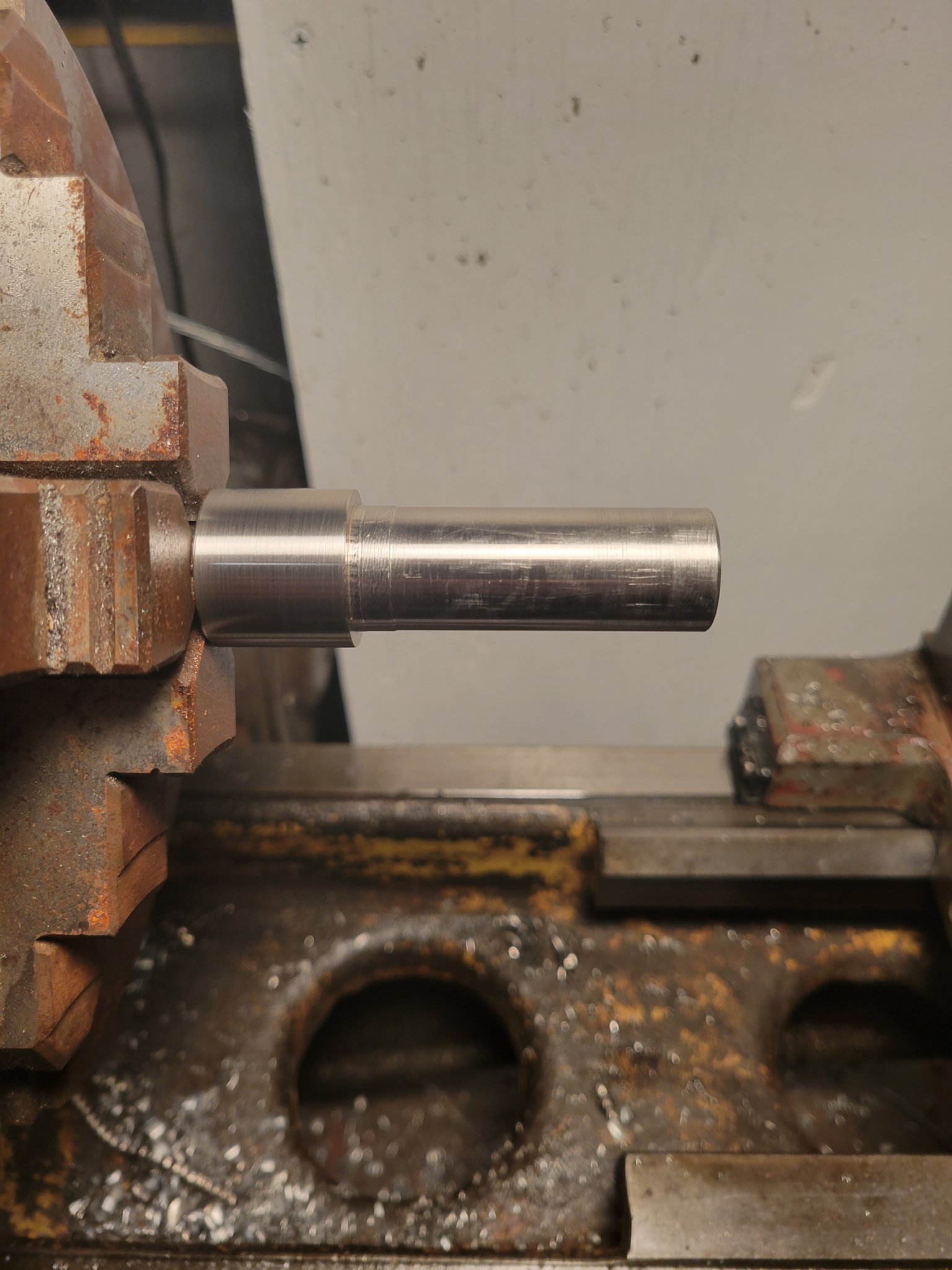

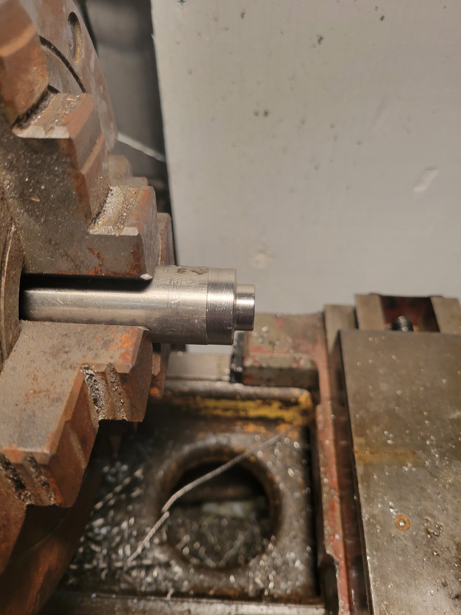

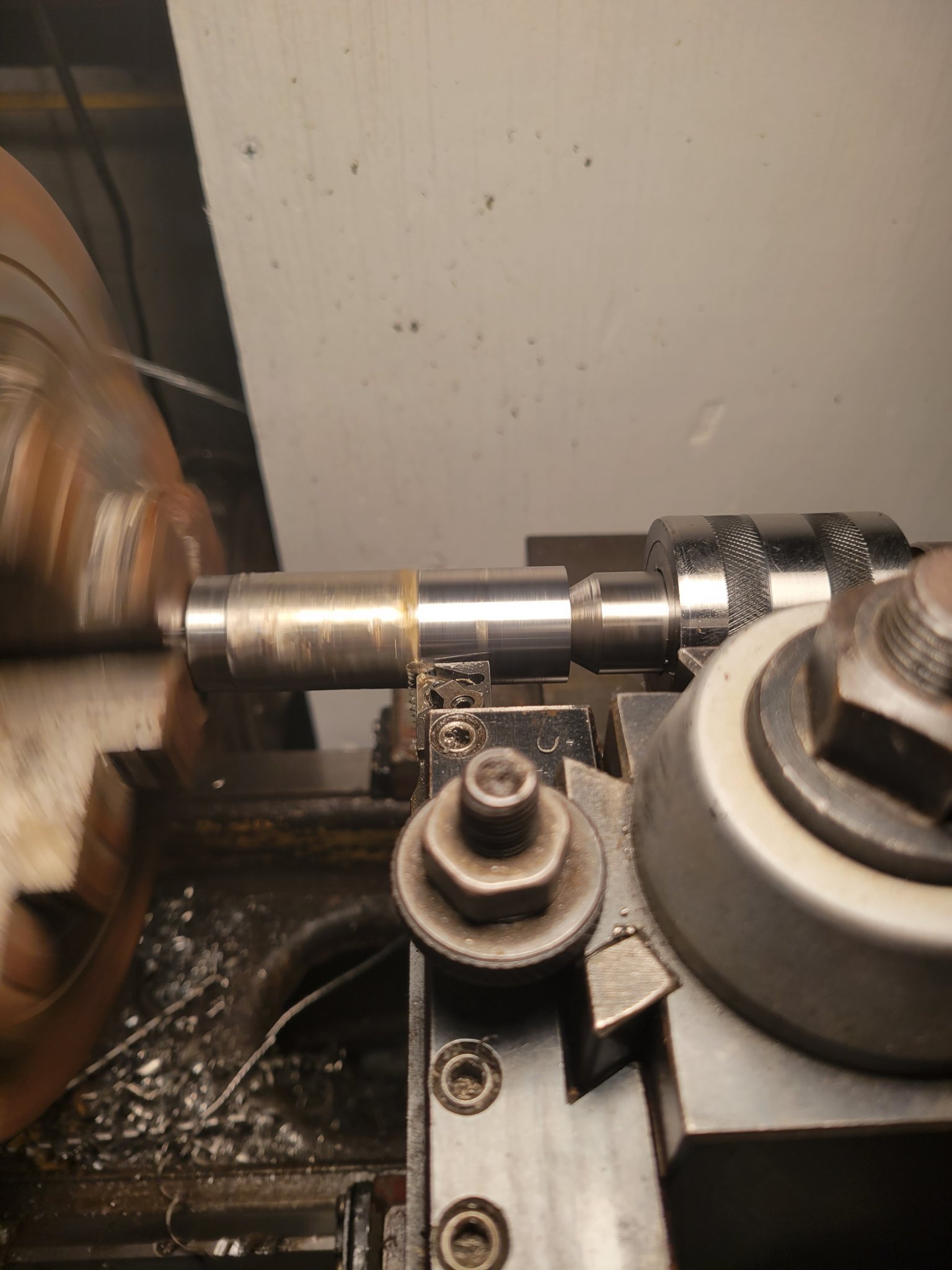

Working on a heavy buffer for a large frame ar that has been problems since day one.
Yeah I could get one from slash but I had a piece of roundstock and a lathe so why not turn my own ?
Here's the front end. That smaller section will fit in the back of the carrier. Supposed to be anti tilt. I can always turn it off later if I don't like it. If nothing else it's more weight.

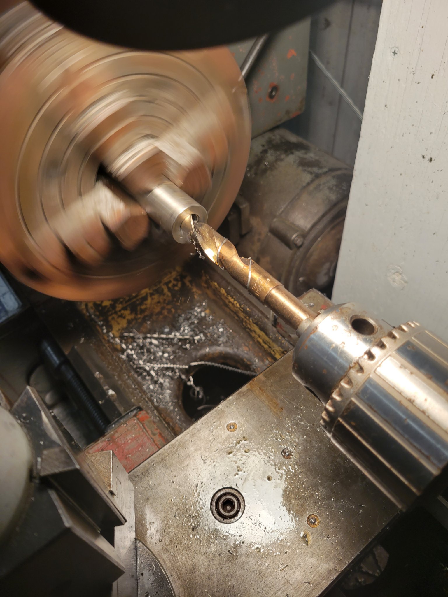

Drilling out the back end for the weights. Started with a 1/2" drill finished with a 9/16"
Made a pretty clean hole.

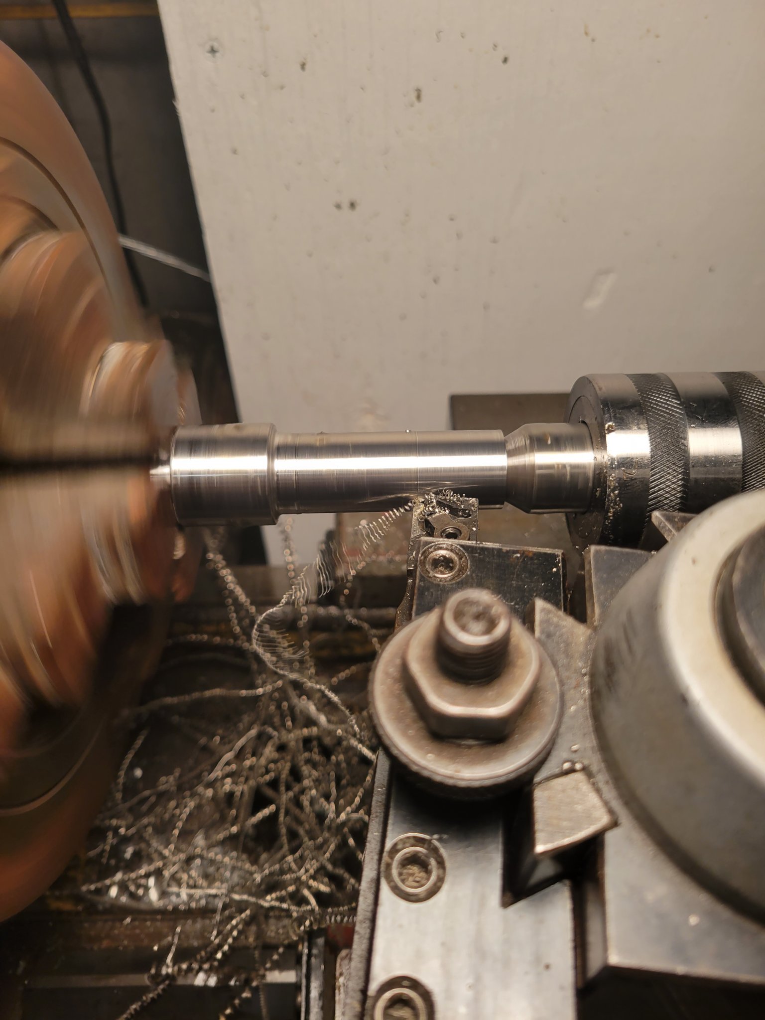

Light cut to clean up the od. The second cut I cut down to the finished od for the main body.
Finished major od.
Light cut here to finish the minor od on the tail end. I left it heavy on the front end for now. Again, I can always turn it off later. The tail is the same length as my car-xh from slash.
Test fitting the Tubbs spring. Fits nicely. Not much shoulder where the spring grabs. I left as much on the body as I could.
Shined it up with some emry cloth and tried the spring on it again. It was pretty until I scuffed it up with the spring.

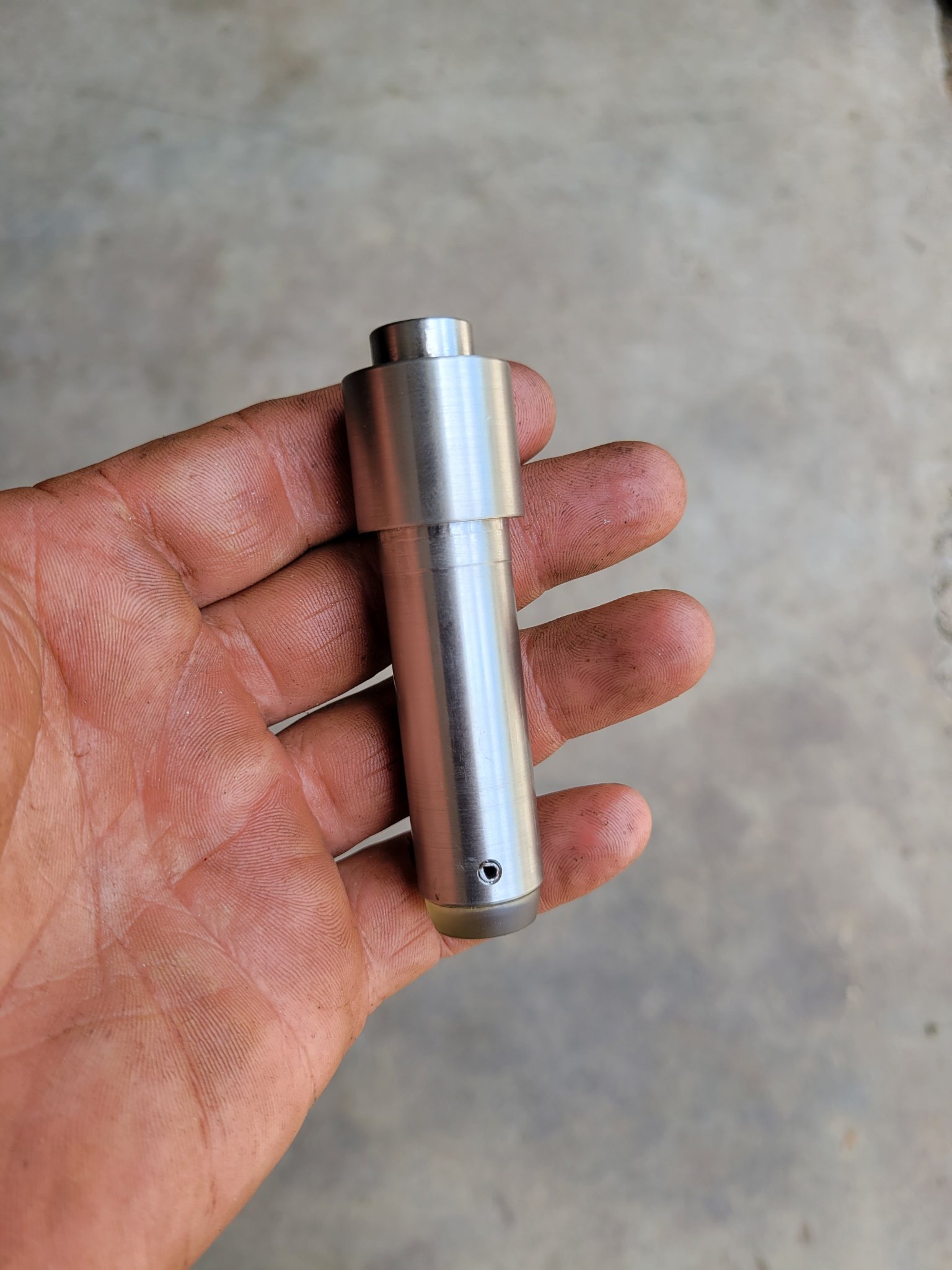

Have to locate and drill the hole for the rubber buffer in the end but that will be tomorrow's job. I've got to go to bed.
This will let me get three tungsten weights in it instead of the 2 in the carbine version. I cannibalized my car-xh and pws buffers for the weights. A5 tube came from lmt today. Hopefully have it all together tomorrow.
