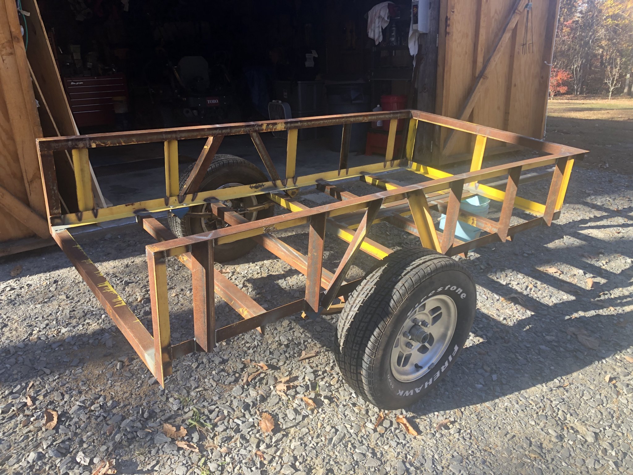

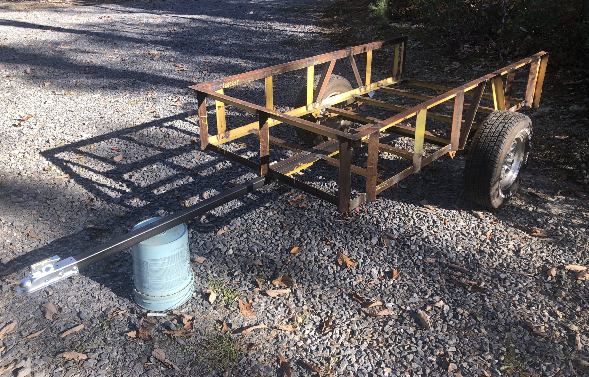

Added the rest of the uprights and the tongue. The angled uprights over the tires will be where the fenders go. Tongue is 54” to tip of coupler so it’ll back well. I decided to double the amount of uprights from the original plan so the spacing at each end is a little weird but it all should be really stiff.
Next is the sides and floor.

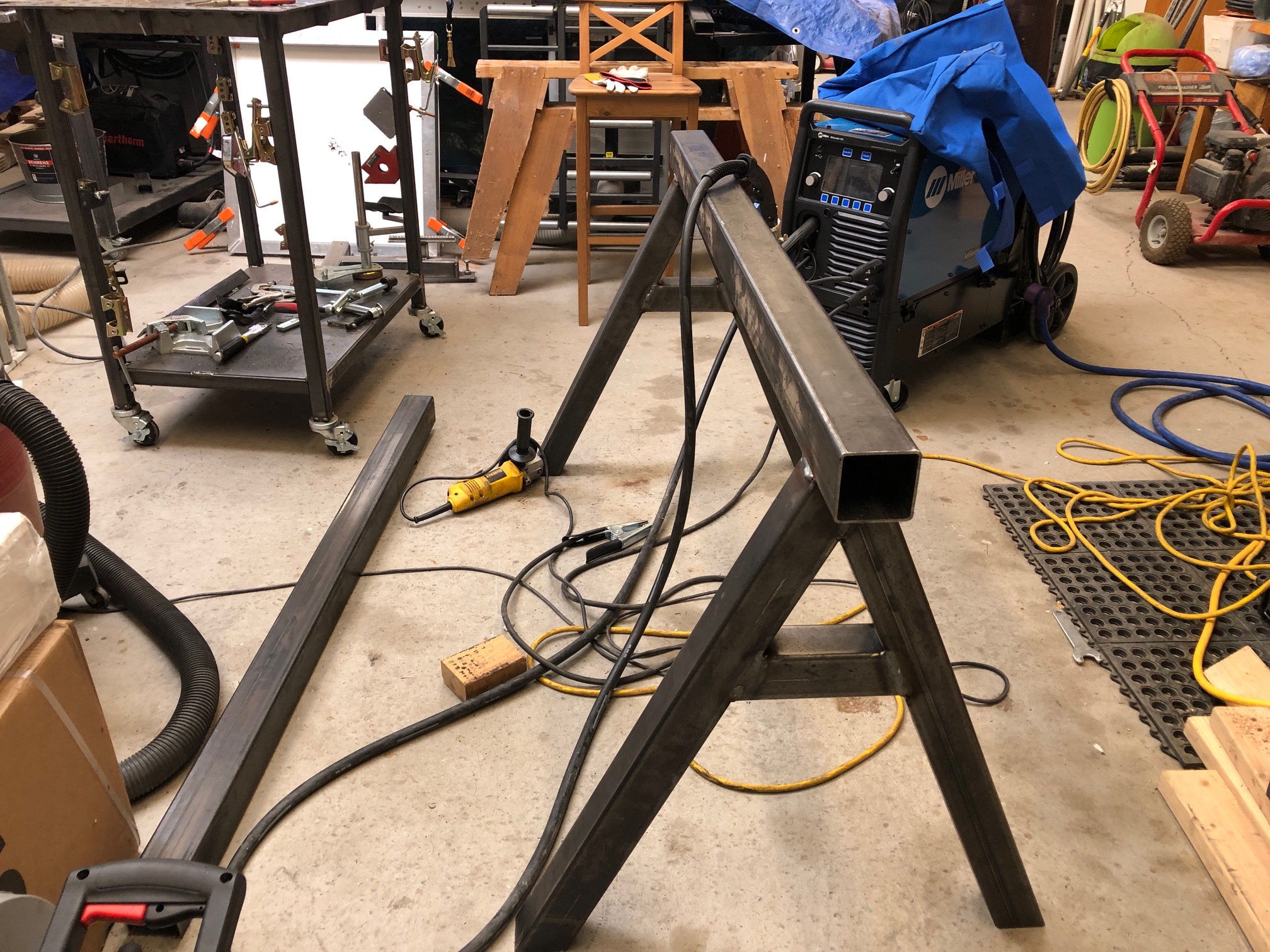

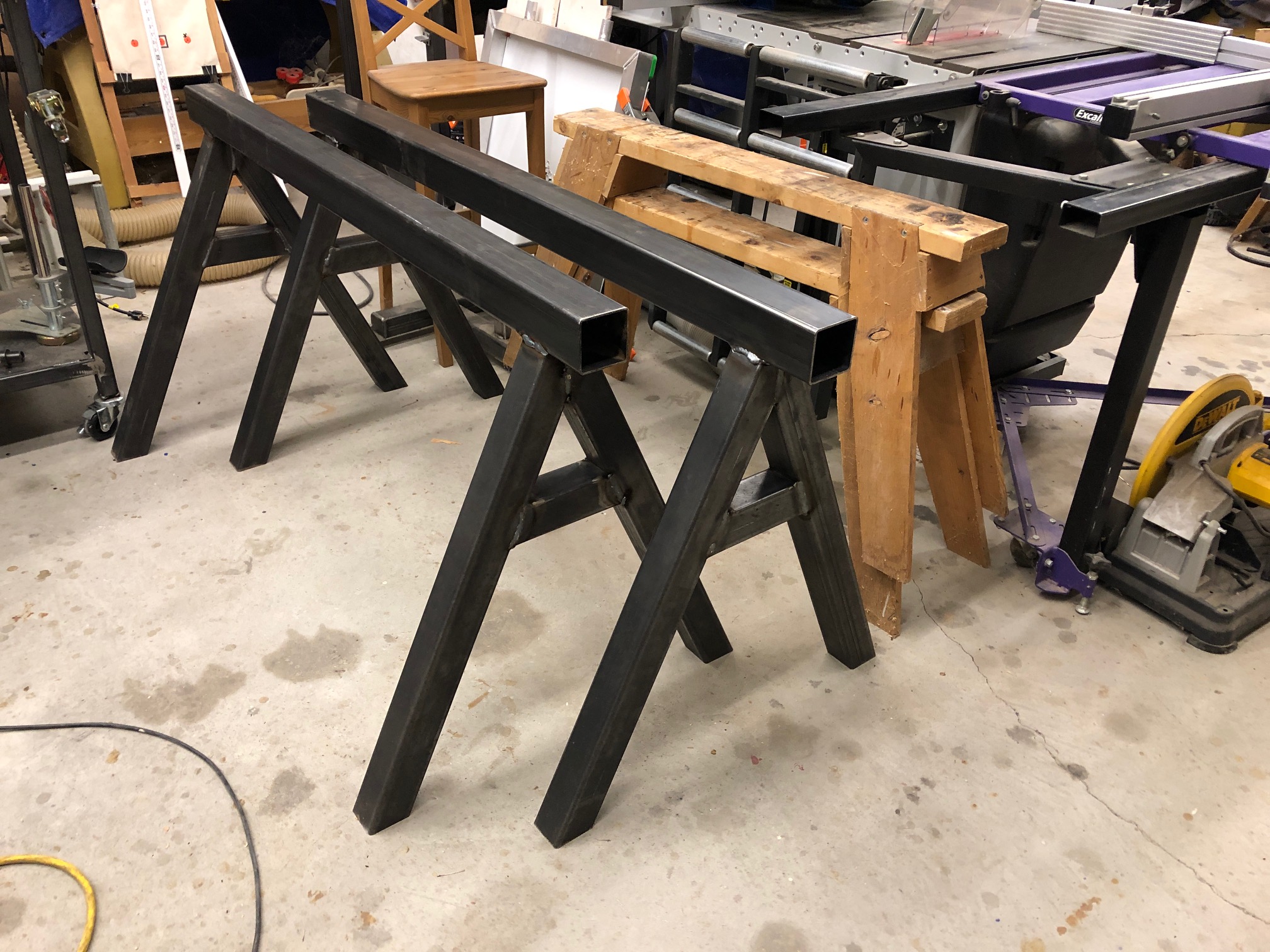

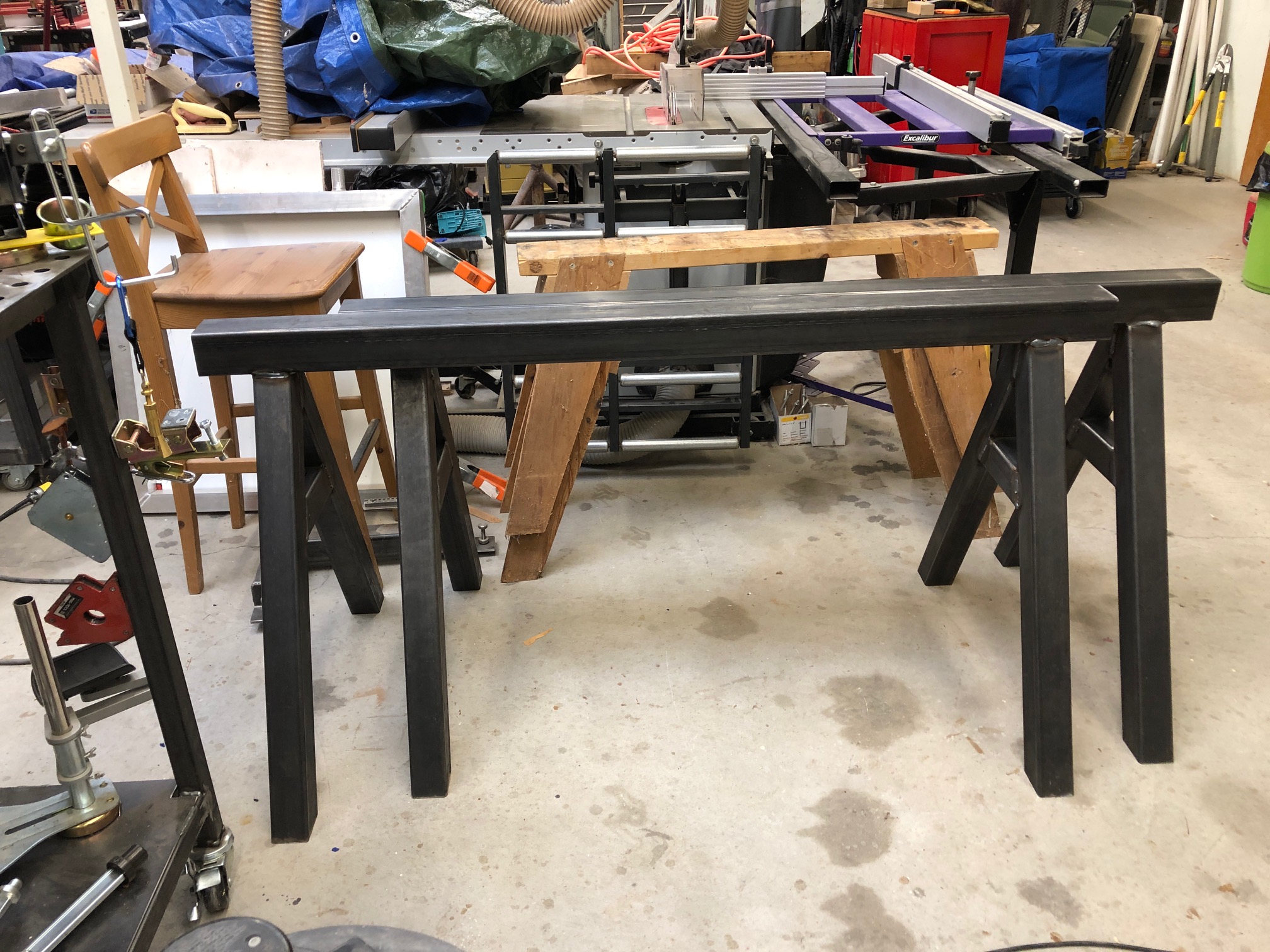

Building new target frames for our 1000 yard BR matches and needed something to get the off the floor when welding them together. Put these stands together on Thanksgiving. Little bit over engineered but no doubt will find lots of use in the shop. Made with 2.5" and 3" 11ga square tubing. Stackable so they take up less space.
View attachment 7748458View attachment 7748459View attachment 7748462
You can never have too many good trestles.
I'd add hd lockable castors.

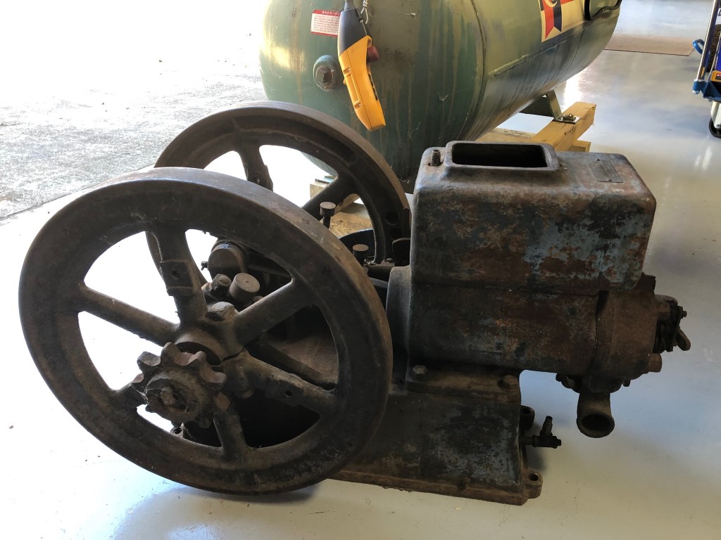

Just be careful of the Babbitt when you take i
t apart. Those are wicked fun to work on and beautiful when all painted up! Cool project!
Love the chain drive cog, too! Those engines are under-rated as emergency “tools.” They run forever on very little gas. Run on anything… crap gas, benzine, alcohol… and can power anything. With belts and chains. Way better than high revving Honda generators for long term use around a farm or homestead.
It's metal and I'm going to work on it so figure it can go here. First venture into hit and miss engines - Hercules 3HP.
Needs new fuel tank and some other bits and pieces. Read plate wrong - it's 3 1/2 HP and ran a cement mixer back in the day. If serial # source is correct, was built in 1925. Magneto is firing but not putting out enough juice to fire a plug so I've sent that off to someone that knows mags vs trying to analyze/fix on my own.

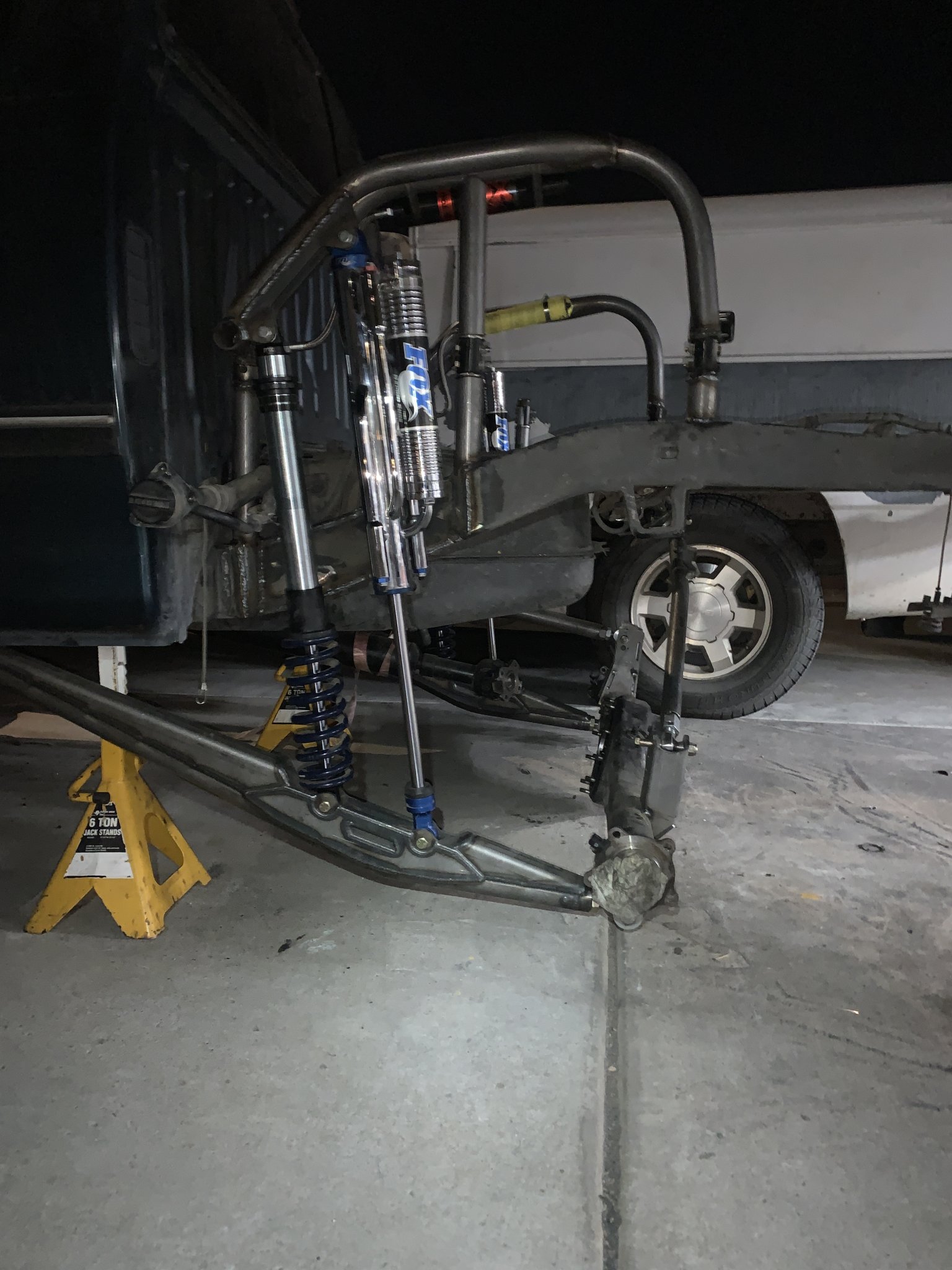

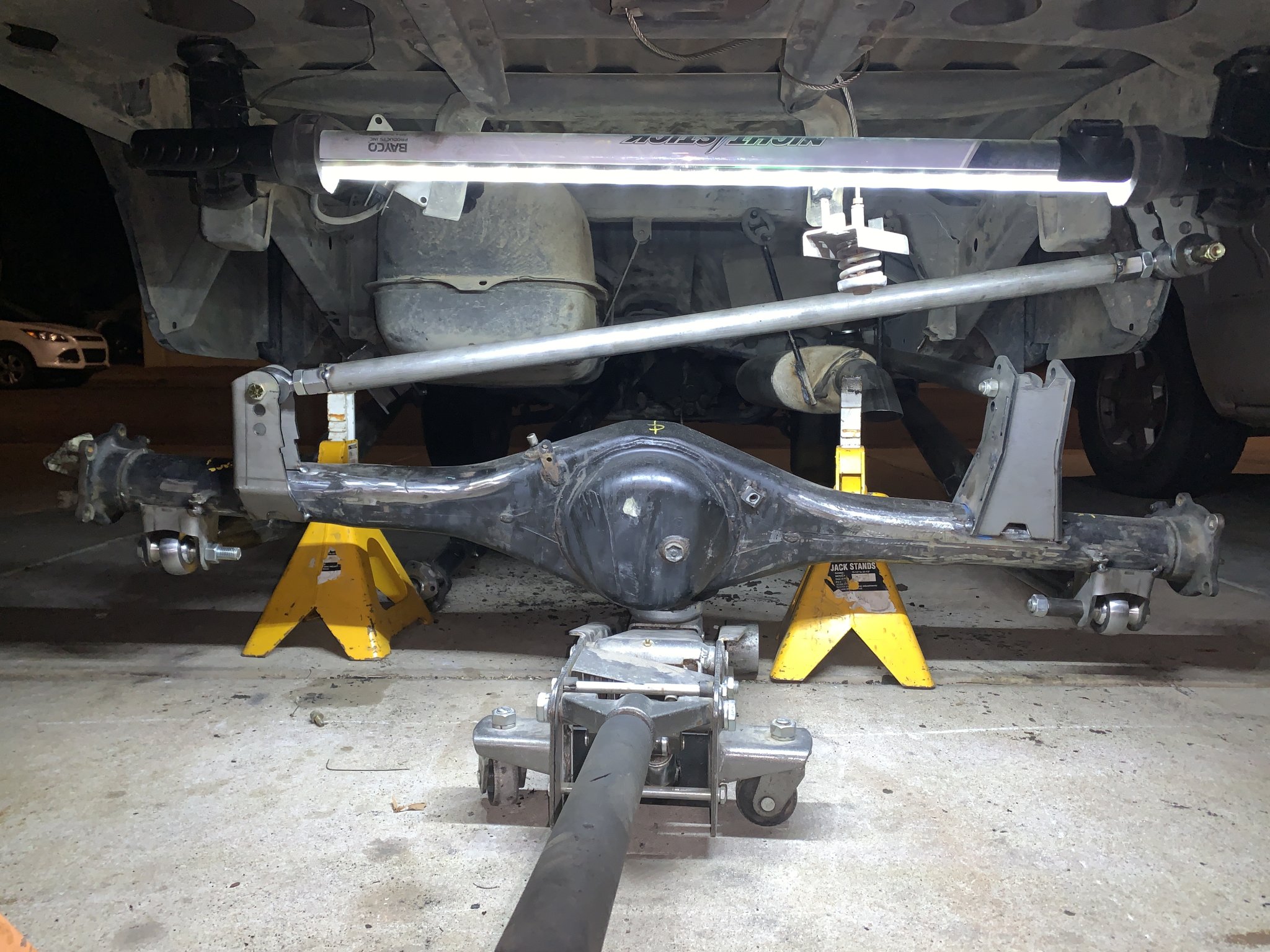

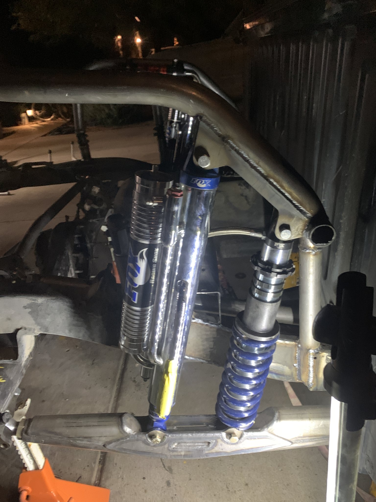

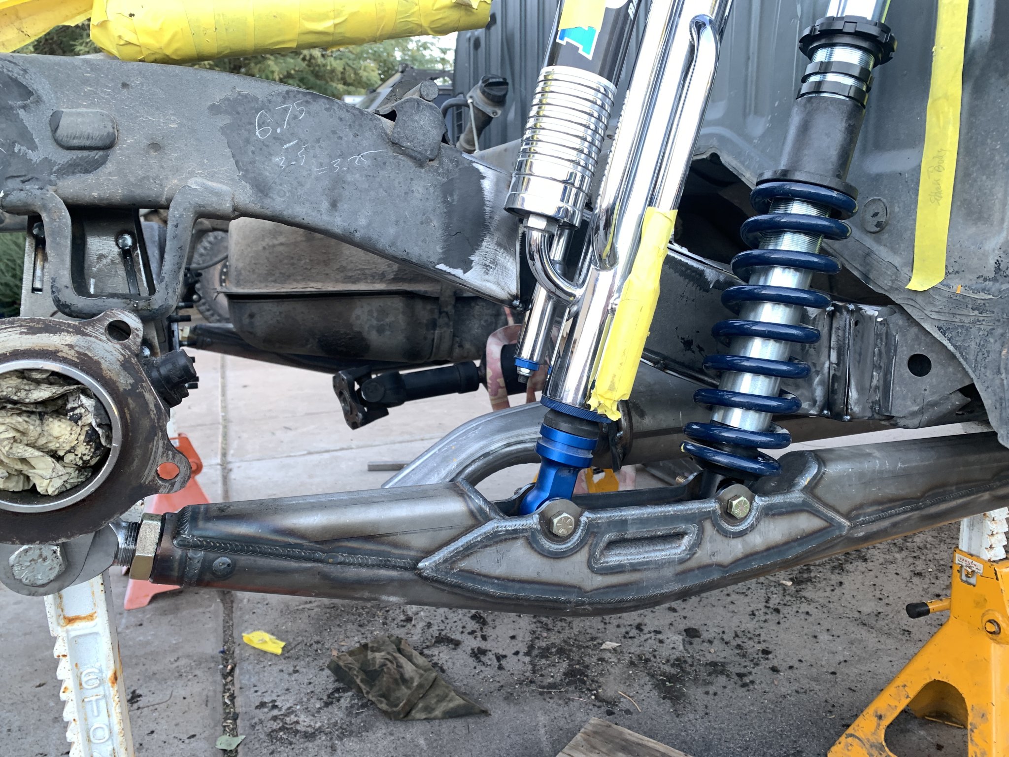

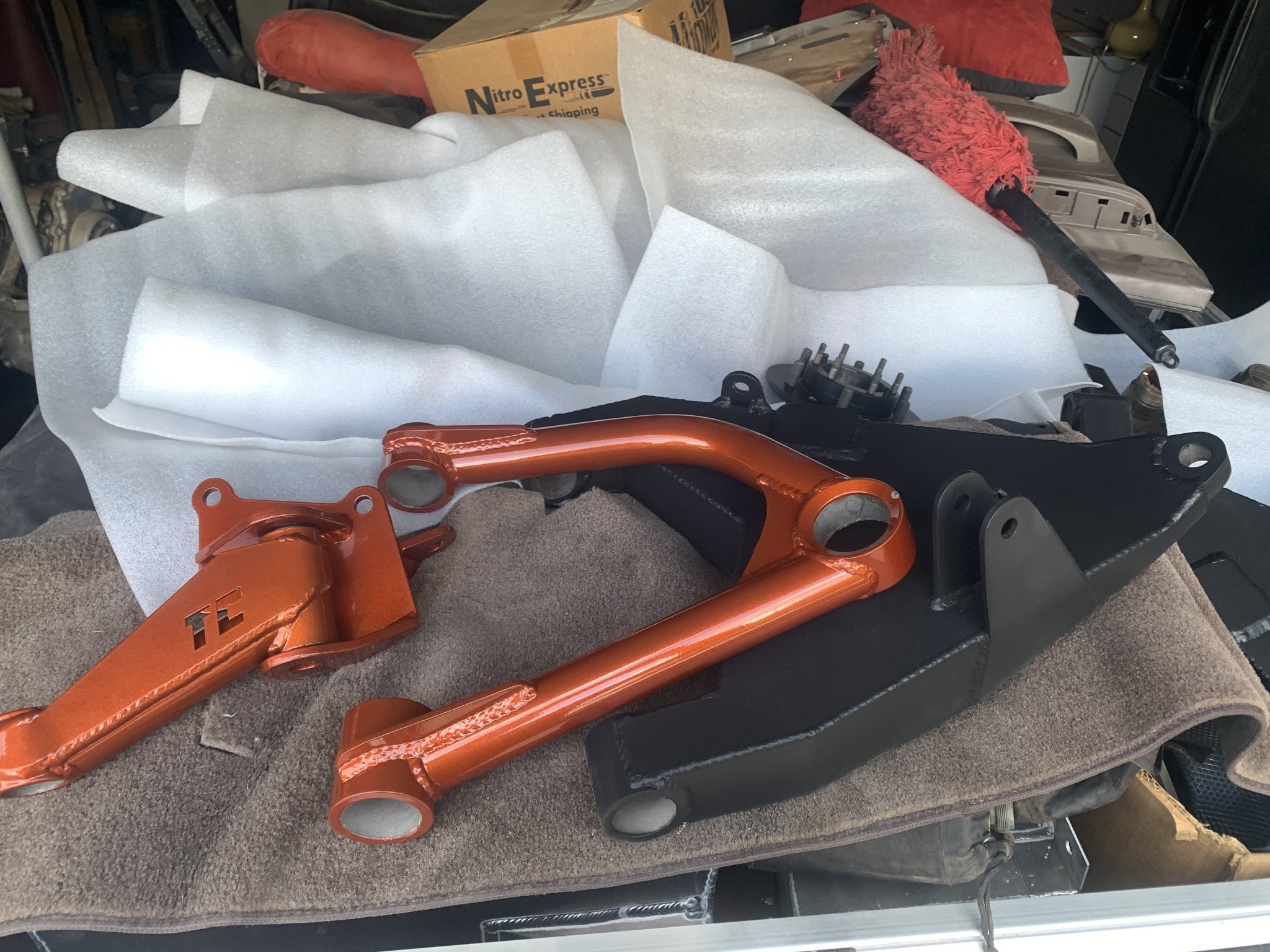

Building a parallel 3 link. Its from parts from ruffstuff, it should net me 20” of rear travel, front will be a jd fab 3.25” over long travel with working 4x4. Its a toyota t100, manual trans 3.4 and will be supercharged and 5.29 gears. Doing 99% of the work myself.
Not my sexiest work, but i ran out of patience on how many bends to do and make it fit. Its bolt on so i can change it later if i desire. 20” of travel with 1” left on the coilover. Panhard moves the axle 2” over entire range. More than i would like, but its how it goes. If i moved the gas tank to the rear and turn it 90* i can easily do a triangulated 4 link and lob off the panhard. I feel like that will happen, just not right now. I need to get this pos driving as have another project to do. Ill put it into my shop at that point to do the front. Its mostly bolt on, except the hoops and engine cage. Ill loose the ability to borrow a bender, so ill buy a jd2 model 32 and their notcher. Bout 1k with 1 die.
Nice work. What are you using to weld fabricated parts? Have the JD2 notcher and is a good piece of equipment. Hope to get the bender in the near future but a Siegmund mobile table is next on the list.
Reactions: Jgunner
I have the largest hobart wire feed they make. Which is just a miller with a different sticker.
I had my settings off on some of my welds and i am pissed about it, not sure why I didn’t think to correct it, but it will all stick. Just not as pretty as i like.
Once my shop is up
And running i will be needing a table as well, although i might just put a thick steel top On my current table and call it a day. I have had 3 tables pop up for free or cheap but nowhere to put them. One was a 4x8 with 1/2” top and heavy duty casters that locked. Very sad about missing out on it.
If it were me I would tie the corners into the tongue, like an "A-Frame".
It will really stiffen it up and take any radial twist out of it.

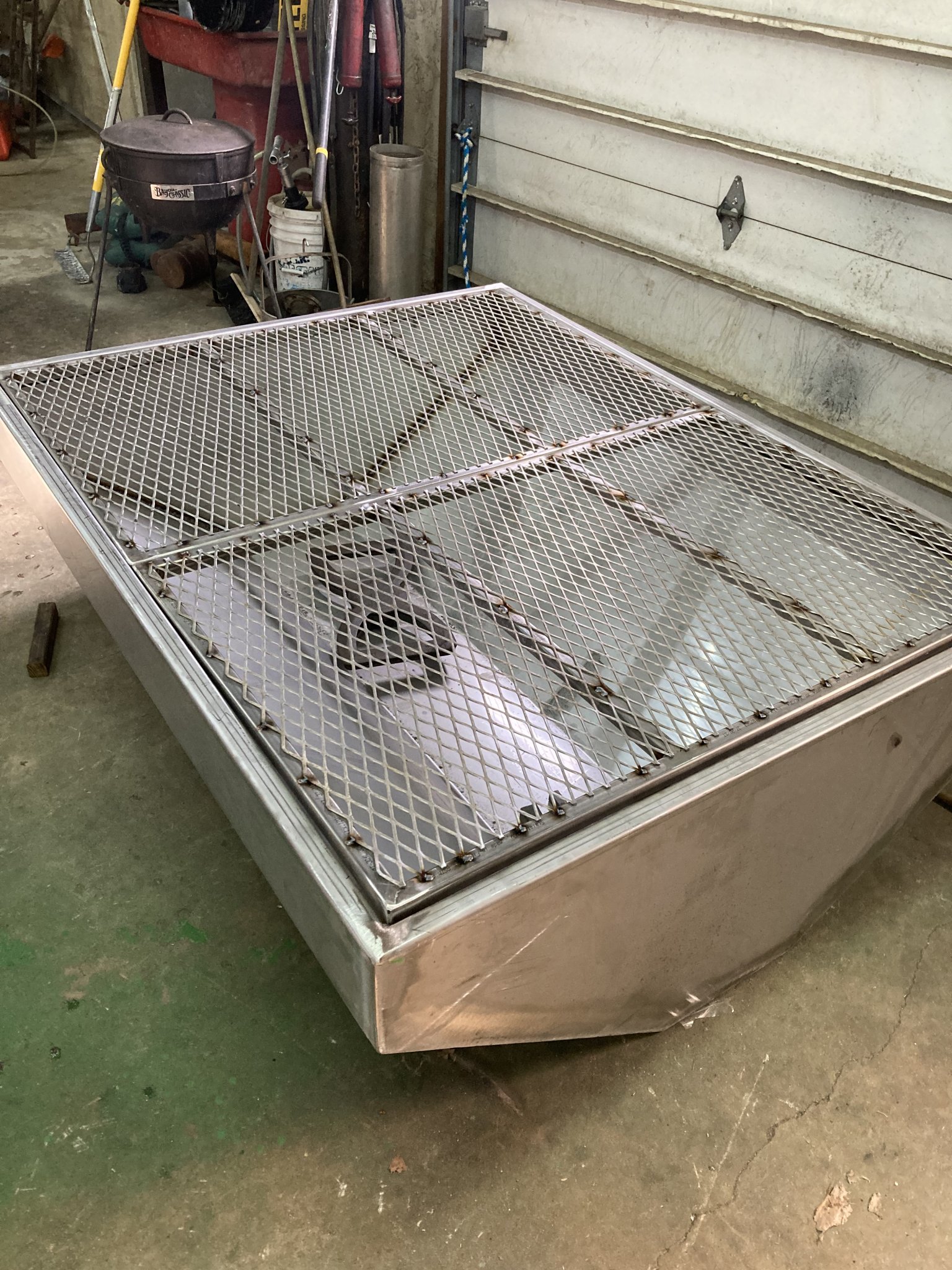

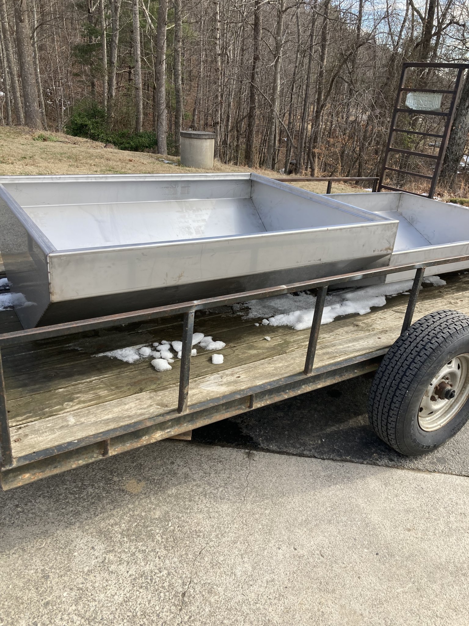

Started a new cooker … will be all stainless except axle & trailer coupler .. cooking area is 5’ x 4’

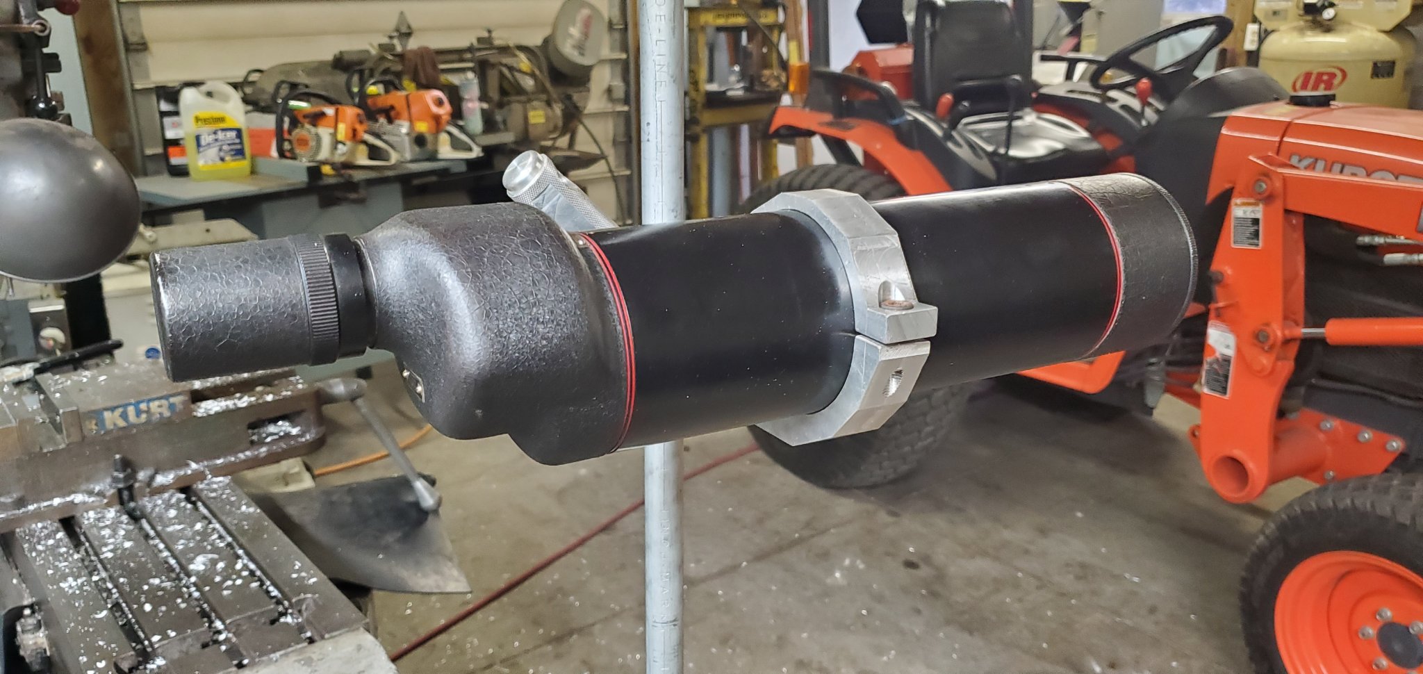

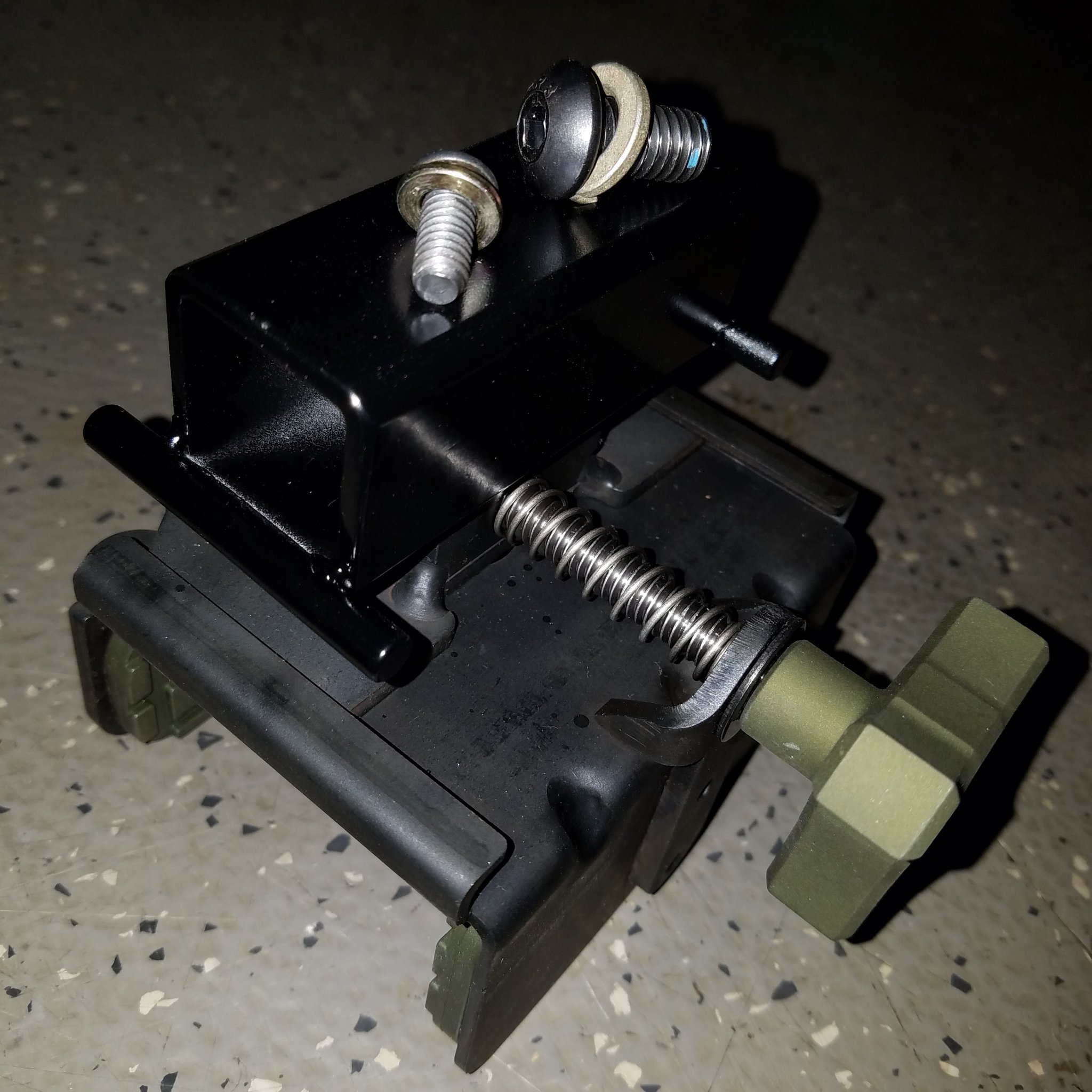

Fabbed a vice adapter mount for my new Pig Saddle rifle tripod clamp, figured I'd make it a dual purpose unit to also clean and service pew pews in the shop.
I restored one like that years ago.
Was a 'famous hopper' 1 horse rated at 550 rpm....we got it up to about 1100 rpm.
Maybe it is only a low horse rating but the torque is very high, maybe 35 ft lbs ?
We had to take a old set of VW points and screw one contact to the base and the other to one of the flywheels, worked a treat once you get positioning right for timing to be *close*. Used a VW coil too (hey had plenty of that crap laying around).
Be careful, once running it will try to walk all over the place going thump thump :)

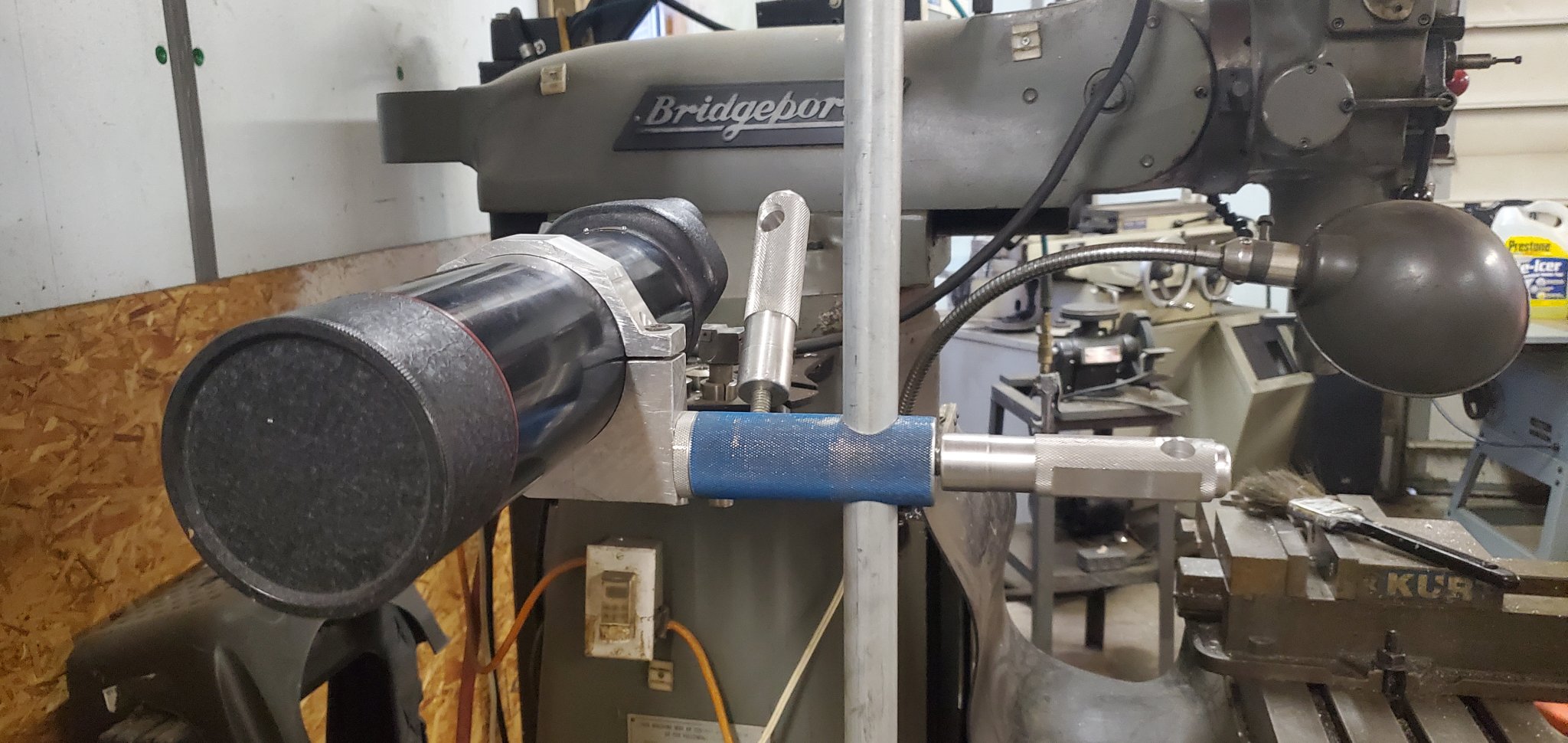

Well got it all finished up
Finished machining the tool holder....still needs an oring and to grind the set screw down...
And all assembled
And......it will cut!....gonna be coming for your Holland and Holland next.
Needless to say, I'm a better machinist than I am an engraver.
now just need to build an engraving vise. I have a Lindsey palm drive engraver and its awesome. I still suck with it.
Are you using a foot pedal to control it ?
Reactions: sirhrmechanic
foot pedal is on order....i was just raw dogging it for the test cuts....

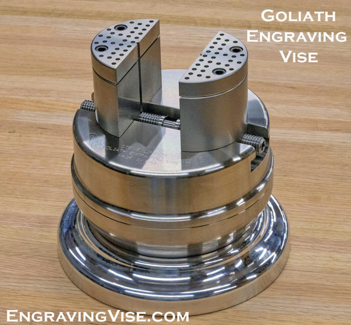

and thinking about building a bowling ball vise next
My engraving vice is kinda a cobbled piece of shit, old bearing for a base, I had a section of a casting that I had machined as round as I could ( damn I need a five axis...) Then mounted a little tool makers vise I had on it. The balance is not like it needs to be and it's a pain to center up a work piece.
One of my buddies has Lindsay Goliath and smaller vise. They are extremely nice, self centering vice, pretty balanced... I want to build mine, I have the dura bar sitting in the shop waiting for me. I just can't get the time and I'm still not set on how I want to do it. There are times I think that something like a 5 axis trunnion and rotating table would be awesome especially if the pivot axis height of the trunnion could be adjusted to fine tune the balance.

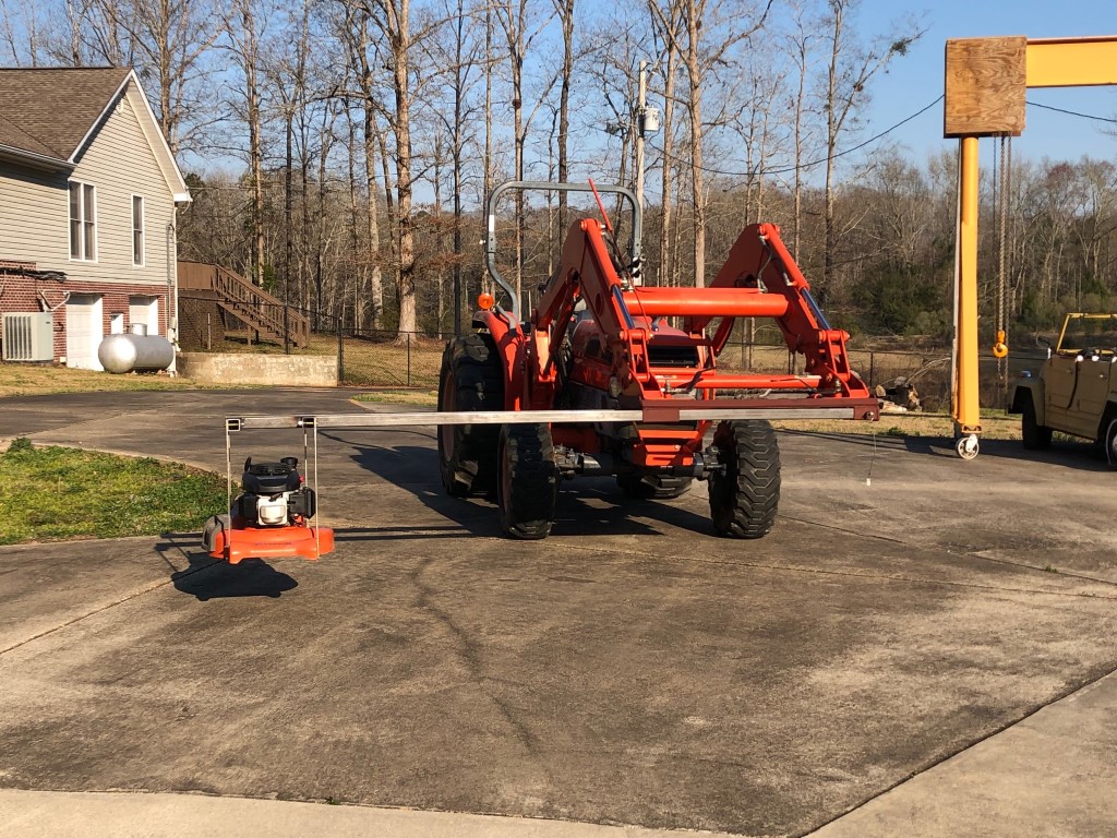

Been trying for years to buy a Mexican to keep up the place (apparently you can't do that!). I particularly hate weed eating, and now at new place, especially along edge of pond where I can’t get to it w/ the mower. Introducing the -
Pond Juan MK I
Juan - get it (yuk, yuk) and MK just because MK anything sounds cool. Trial run went well but I need to keep looking for a wider deck (= MK II).

Boom mowers exist.
