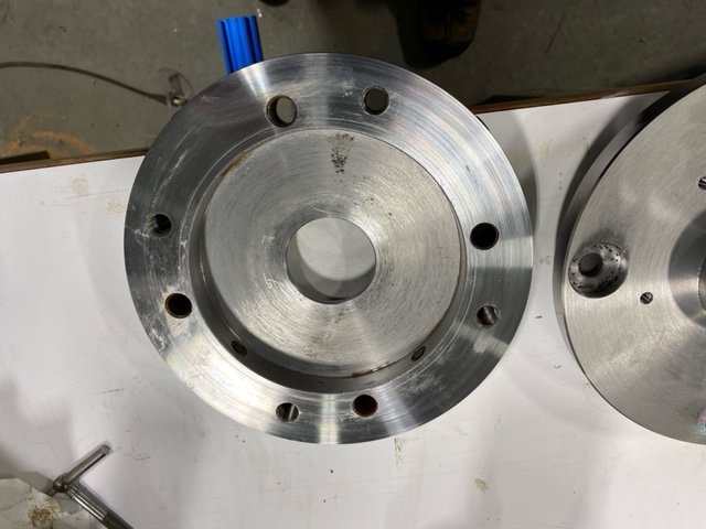

On some similar situations it's been heat / cool / heat / cool, etc until the fit loosens up. Just moving metal to fit the situation.
You going to "dry ice" the race to install it?
Easy to just press in the new race. The challenge was how to get the old race out with limited access to the back of it.
Reactions: Hobo Hilton
These are for that.
Simple job, 15 seconds if it's really tight.
I have those axle bearing pullers. There was nothing to grab against behind the bearing race that I removed, thus the alternate method of removing it without cutting it out.

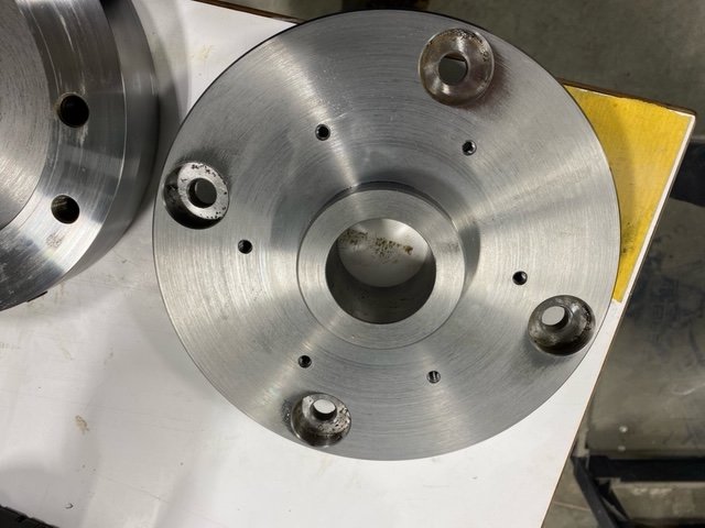

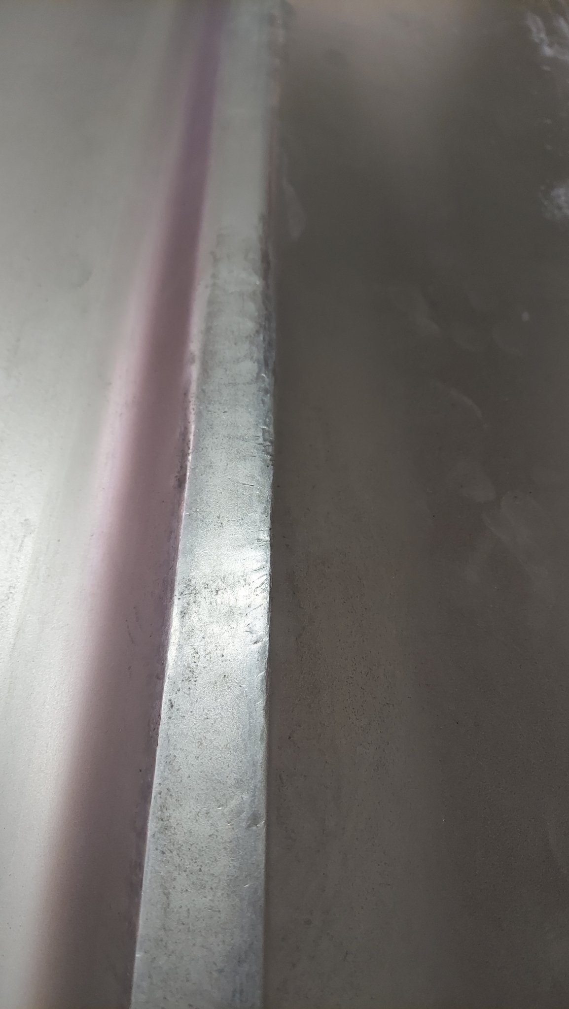

Ever need to get a press fit bearing race out of a blind hole? On this NV4500 input bearing race, I fired up the TIG machine at 140 amps and just arced a 360 degree line around the inside of the race. After it cooled and shrank, it practically fell out. I probably could have gotten more shrinkage if I ran filler metal. It measured .002-.003" smaller than the new race I was putting in.
A zig zag pattern shrinks them even more

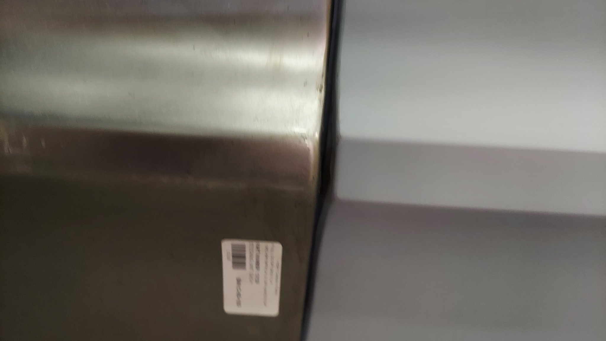

Kooks Headers, 3" stainless (304) tubing. Borla XR-1 mufflers and resonators. Purged and welded on my little Lincoln 225.

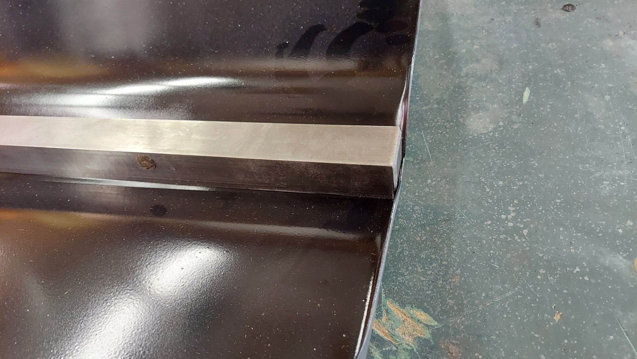

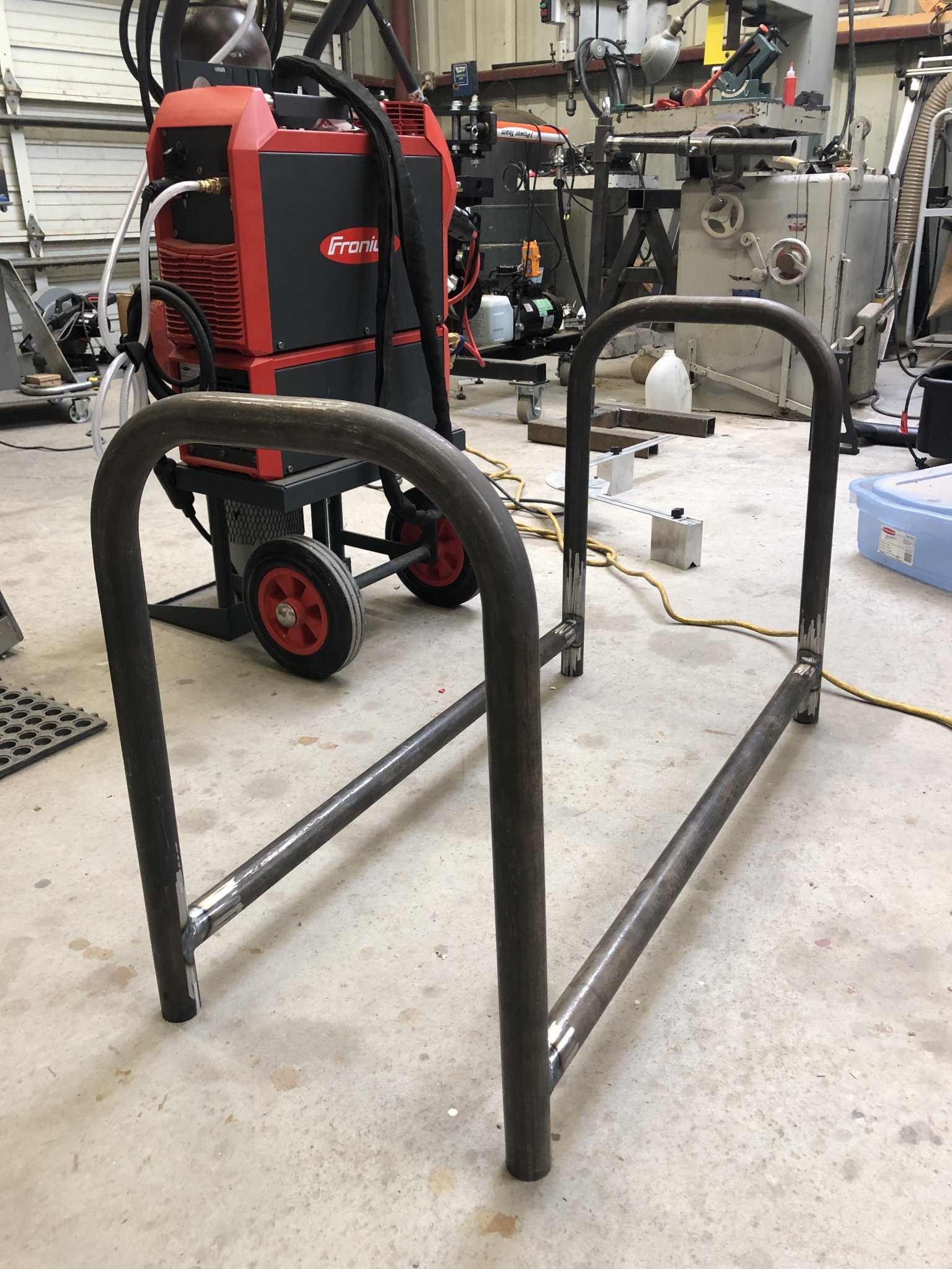

Finally got the last of my dies in for my JD2 bender and calibrated them with Bend Tech software. Decided to do a little project today to test the calibration. Firewood rack built with 1.5" 13 ga metal tubing and the bends were spot on per the software. Stretchers notched and tig welded. Just need to add some 3" round plate as feet and paint it.

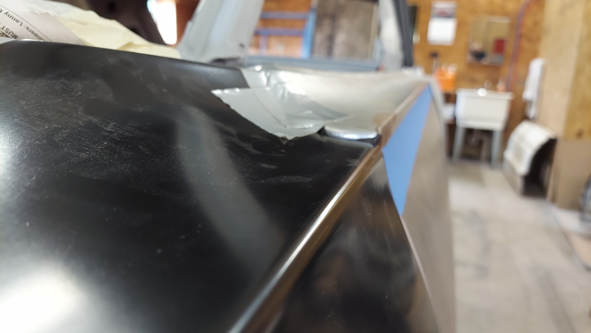

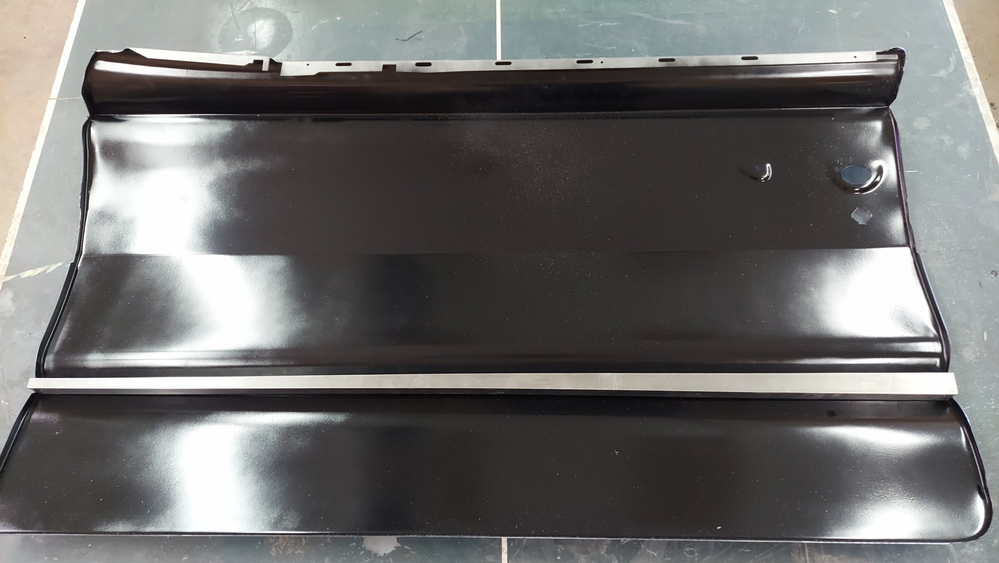

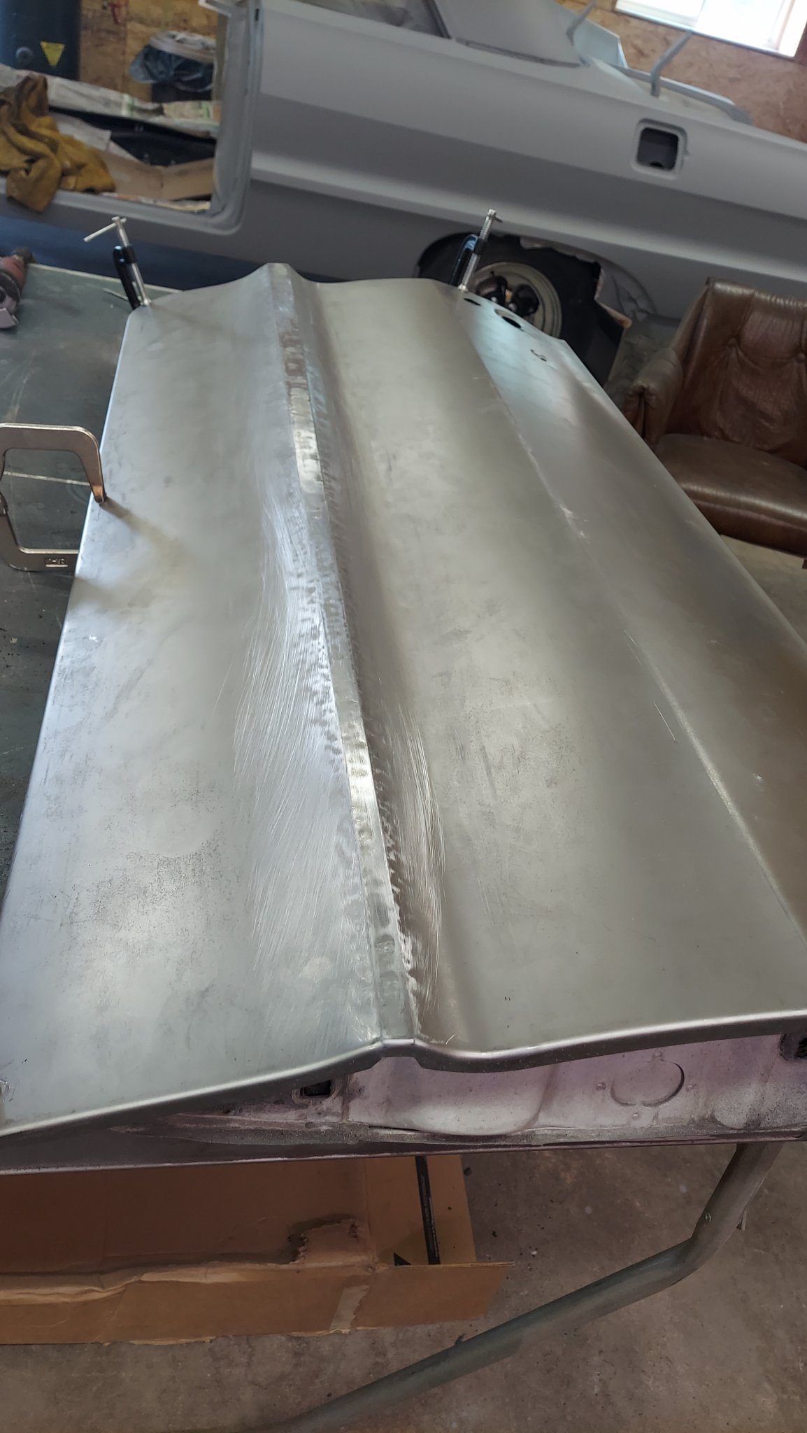

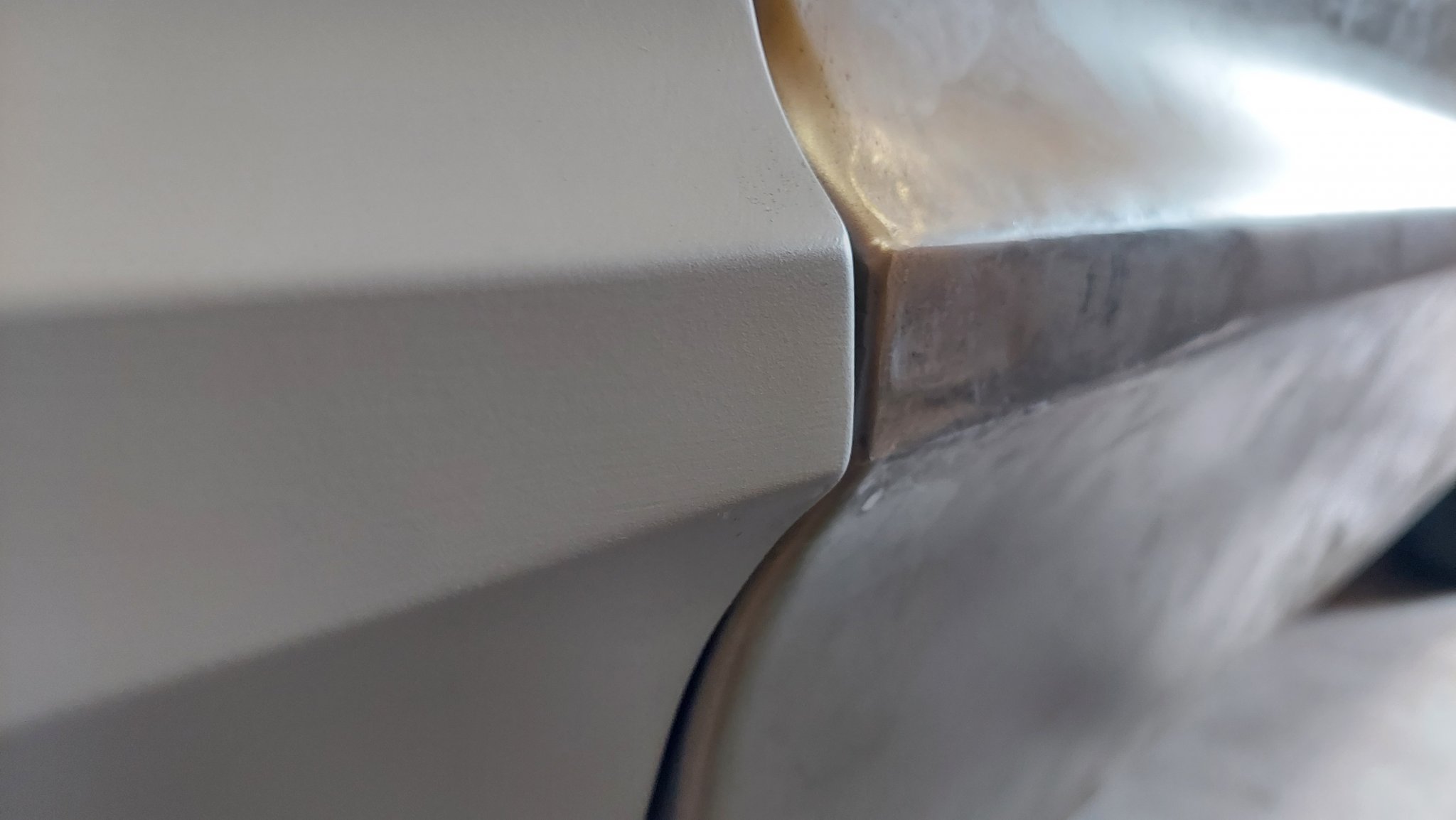

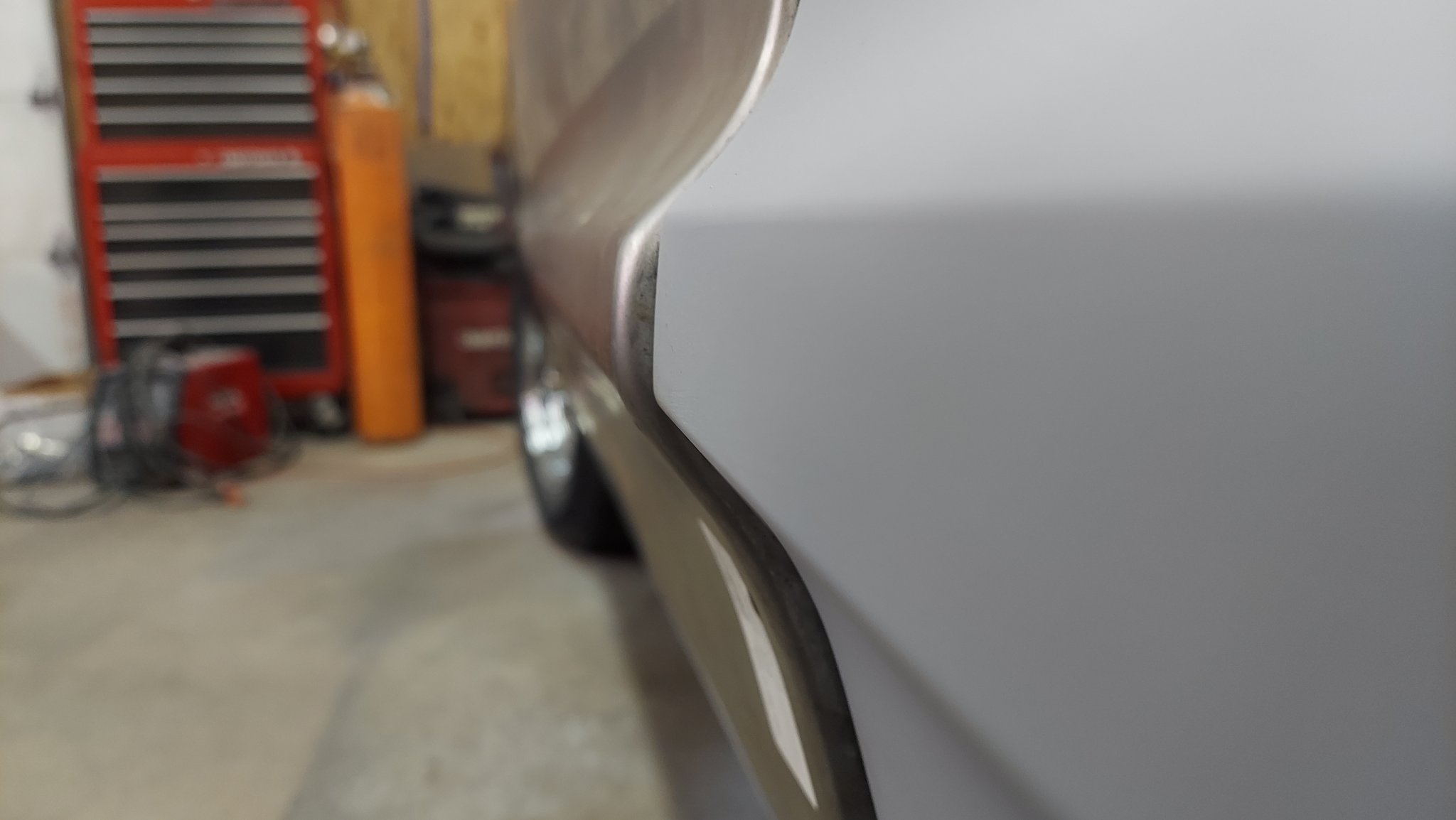

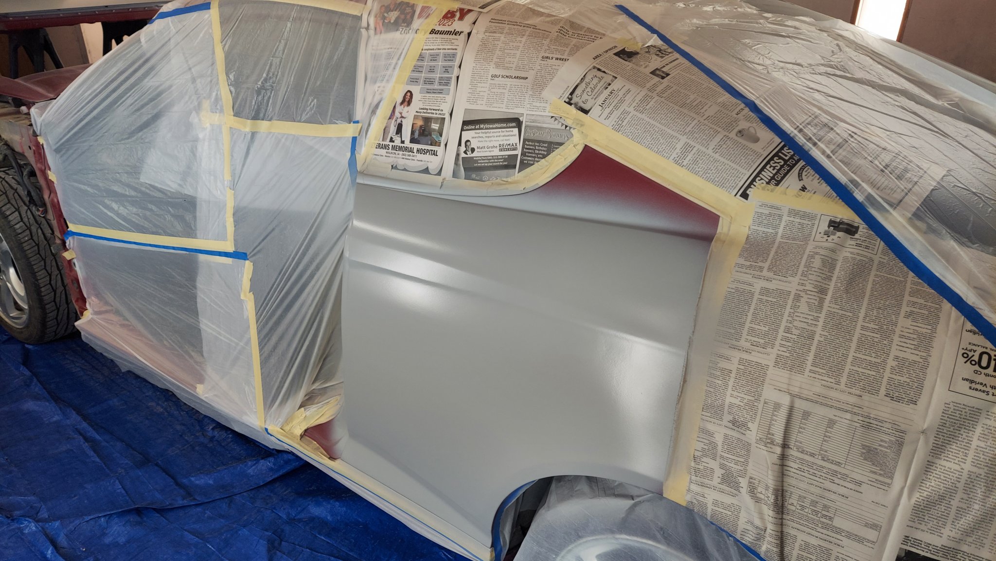

I am especially proud of this one. This reshaped far better than I thought. We figured the stamping was probably the last before they got out the new dies. The door pannel is still to tall but that fix will be easy while skinning in comparison.
My bro took the measurements and the owner had a backer machined out
Lots and lots of pounding. My forearms were on fire but it matches the car now.
I figured it would work, but I didn't think it would go so well. Hopefully the driver side shapes as easy.

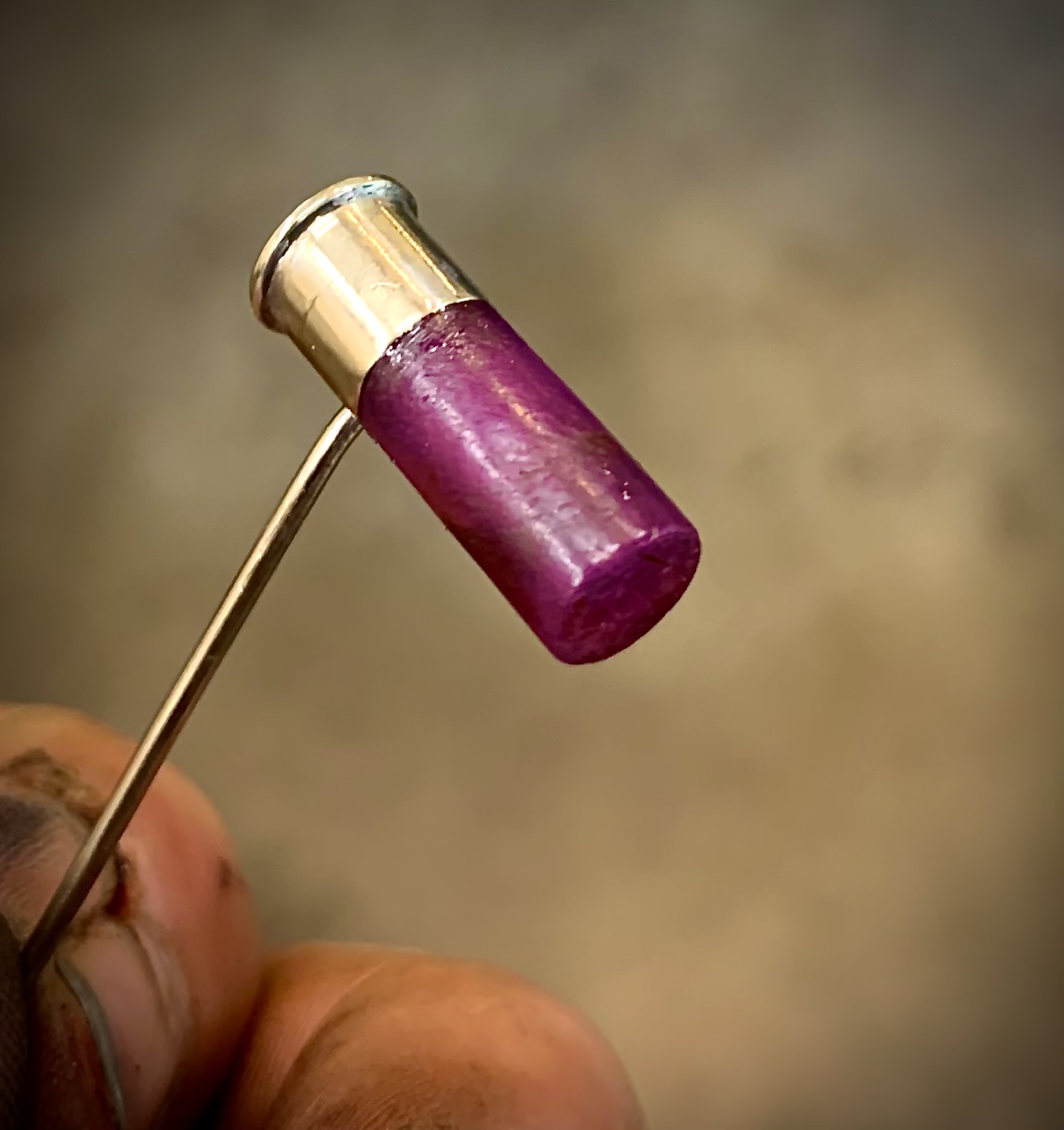

Lapel pin project coming along after long hiatus. Made three more “prototypes” and gave them to some folks who supported a fellowship I am spearheading.
This one is to keeps. Ruby turned on lathe with diamond cutter. German silver head. And a tiny Diamond for a primer. More pix
Tomorrow. Will get a tiny ivory “card wad” end with shot size scrimshawed on it .

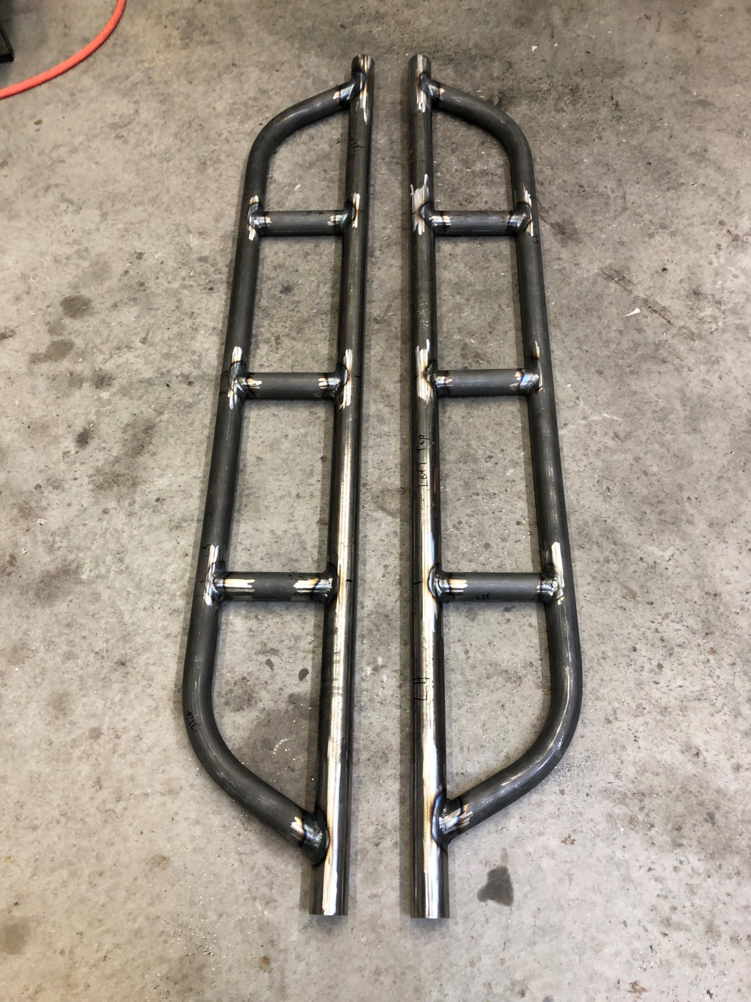

Spent part of this past weekend making replacement sliders for my 4Runner to replace the ones that were torn up on my recent trip to the San Juan's. Main tube 2" 11ga. DOM with the other being 1.75" .095 DOM tubing. Next step is to fabricate frame attachment and powder coat.
View attachment 8220482View attachment 8220490
That is about what I want to make for my FJ. I want the kickers at the back also.
I'd paint rather than powder coat - touch up is easier and can be done with a paintbrush. Hammerite goes on easy, and seems very durable on my sliders, 3 years later - unlike the powder coated bumper..
One thing for sure about sliders is they will get dinged up, and the finish will get damaged.
Reactions: BLEE and ZiaHunter

The Bendtech software has slider templates that have a kicker but decided to go with the straight rail. The outer rail acts as a step but to some extent as a kicker because it extends beyond the outside of the rear tire and terminates just in front of it. Next pair I build will include a kicker. Plan on trading it in for a new TRD Pro within the next 6-9 months so decided to bolt to the frame rather welding it.

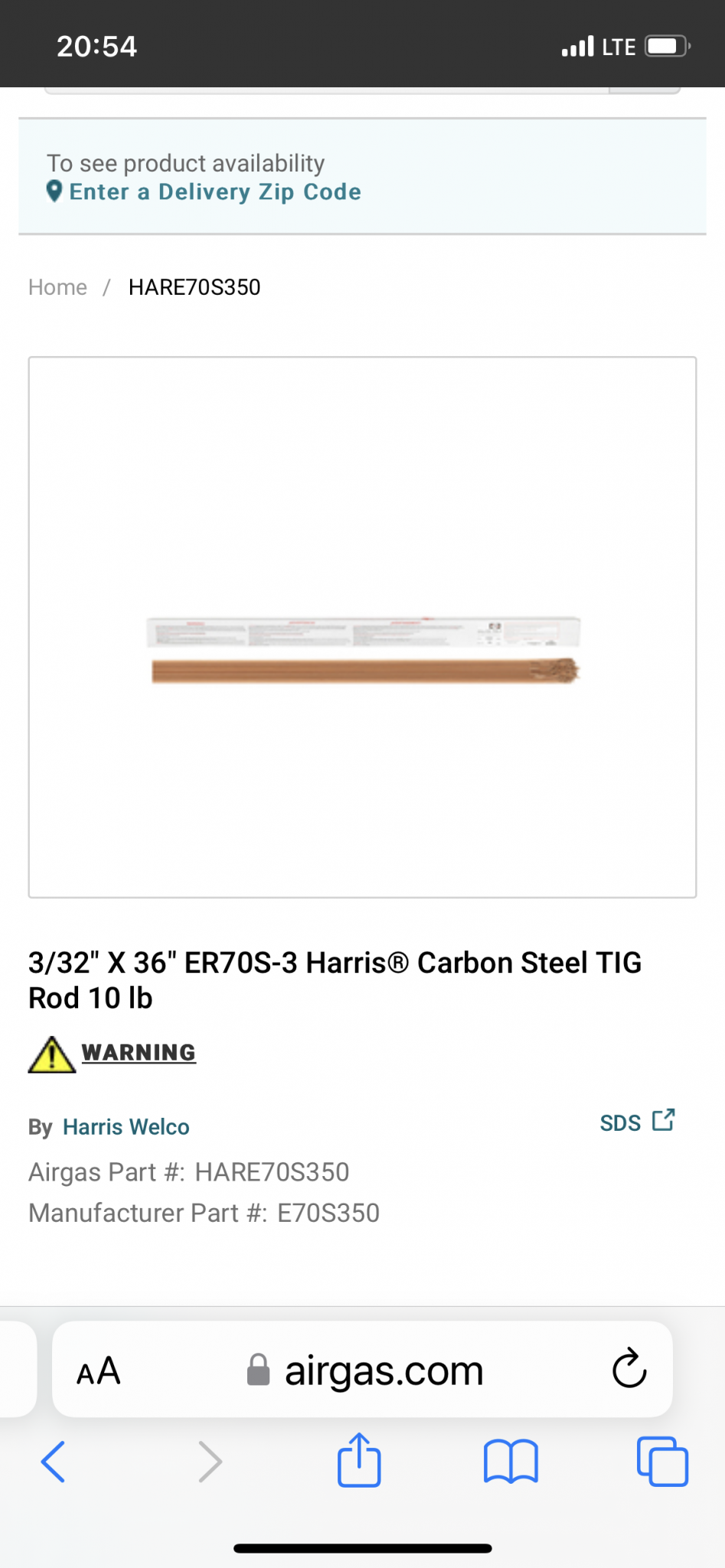

It’s what I use for TIG welding if I don’t have any S6.
I get it from Harris Welco
Have you ever used it?
Well I'll be. Been welding professionally for ten years and that's the first I've heard of 70s-3. It's just s2 or s6 for us for plain Jane carbon. We did have some 70s-2+ one time from a German manufacturer, boehler I believe. It ran way better than regular 70s-2, which I rate just one step above coat hanger wire. You really do learn something new everyday.
