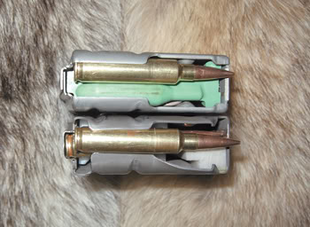

A 6x45-long with a tad extra free-bore and from a VLD magazine (Single stack loading) @ 2.46 COAL one can get to 2690-2720fps form AR15 and 50fps more from a bolt action using 105's. G1 are around .510-.530.
The nice thing about the AR one can go from 75gr (2950fps) thorugh 90gr (2750fps) in regular magazines to the 95gr and 105gr in VLD setup all in the same package using many times discarded brass form the recycle bin. Nato LC plant, WCC is great for that. Amax and nosler have great values in bulk buys vs. lapua or berger. The berger 95gr is a very good one though.
The downside is one has to reload but it is a very forgiving round inherently accurate and ideal even for beginners to get right. Corbon and Blackhills sell 6x45 ammo but it is expensive an designed for hunting/defense anyway. The only modification for the lower is the bolt catch that needs to be slightly rebated for the VLD magazines. A 5 minutes deal piece of cake.
Who makes these VLD magazines?
Google sez DPMS made some but no longer...probably others too?
Yes DPMS made them but then they stopped so they are very hard to get.
I make my own now. I also use the same in the Rem.700.
This allows me to replicate M118LR type of trajectory and even better but on a fraction
of the budget.
Also find the max COAL of your chamber with the bullets you want to use.
That you can start right away. Ideally what you want is the max coal you
can chamber to match the max COAL from the VLD magazine. That
way you can maximize the use of your equipment.
I am at work now. More later.

Hi, Yes,
I explained the magazines on this thread in post #55. http://www.snipershide.com/shooting...recision-rifle-my-daughter-2.html#post2799323
They are centerstack magazines. Also the freebore has been increased to the needed length. A significant improvement in the performance in any loads, even the regular COAL when using PRI/ASC/H&K that all load at 2.30-2.32 and stack perfectly just like the .223. I think the TCU wildcat can be loaded to NATO type pressures too vs .223 using hard/match primers and w/o any issues. 90gr FMJ in std magazines with same 20" barrel do 2725-2750fps spreads depending on rifling and brass. ..LC plant or WCC vs. winchester or remington for example. The extra space in the case and freebore makes an improvement assuming folks are ok with centerstack in single column.

Hi, Yes,

Hi, It is not single feeding. The VLD magazines stack on the center using the center rib in the back but the last round moves into position to be taken by the bolt in autoloader mode just like any other AR magazine. 5,6 or 10 round mags are more than plenty for this type of use. The nice thing is there is no modification to the lower other than the bolt catch so the lower can take a regular defense magazine with 30 rounds as well as the VLD mags with the long special rounds. I use the same mags in the Rem700 that also takes both types, standard and VLD single feed. This is nothing new and whether some like it or not it doesn't matter. It is a nice and flexible option the .223 case has due to the diameter of the rim/head that can be accommodated. 6.8, 7.62x39, 308 bolt face based casings do not fit.
Okay, I see what you're talking about. When I first measured my lowers' mag wells, I used face to face. When I measured fwd point groove to rear groove, that is 2.600" So I see how 2.540" is doable.

Hi tubes can be of any length if you need them to be. there are extra long ones and also nice couplers. I have not had any need for the couplers other than special projects and barrels cut to specific unconventional dimensions.
Regarding the magazines the PRI, H&K and even ASC give 2.3 to 2.32 that is more than plenty for the 6mm BR and 6.5mm BR. Getting the most out of the BR cases has not been a problem and they stack well and feed flawlessly in e 6.8 and LBC mags. Brass is 6mmBR norma lapua. Simply the best.
