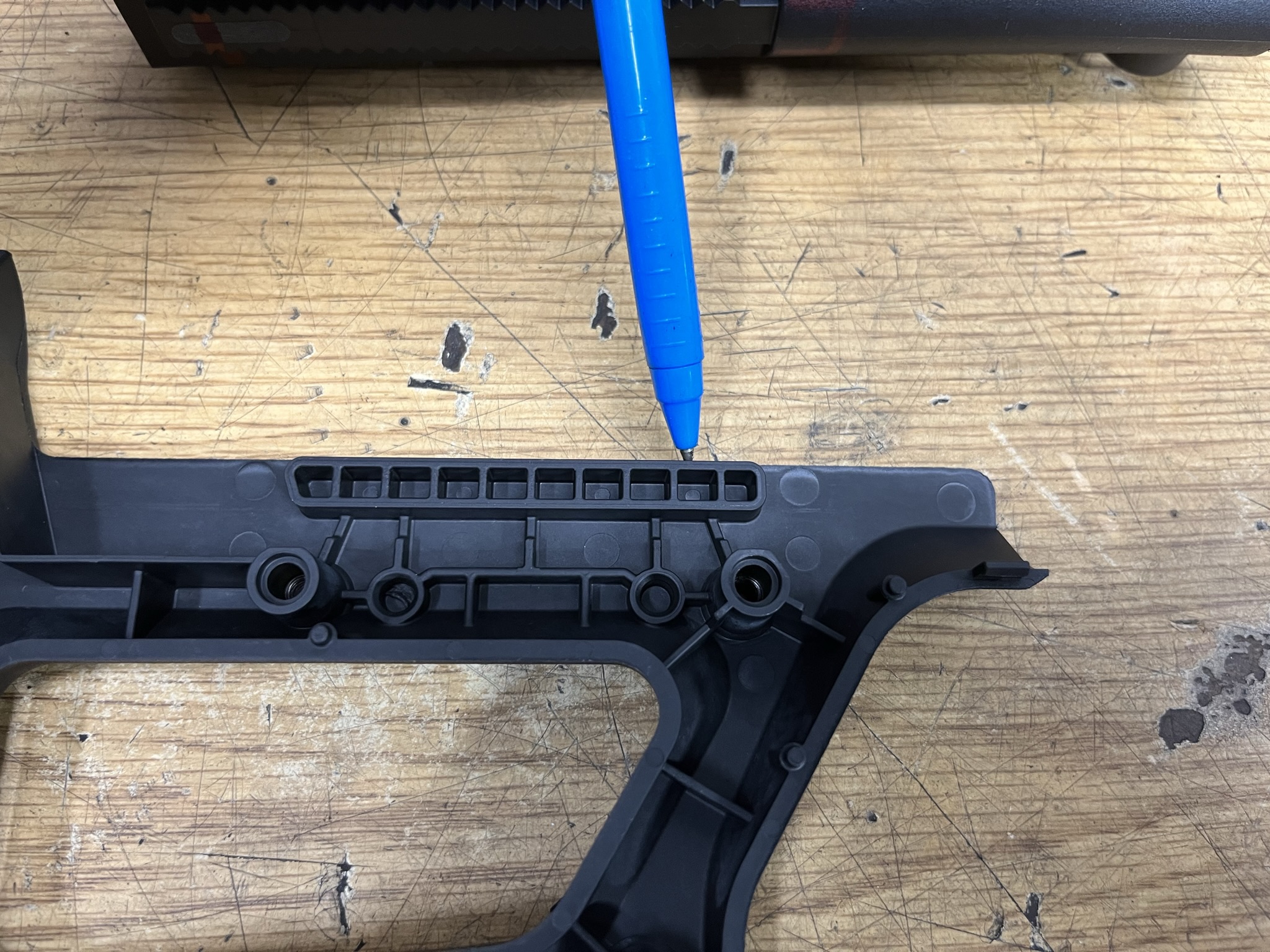

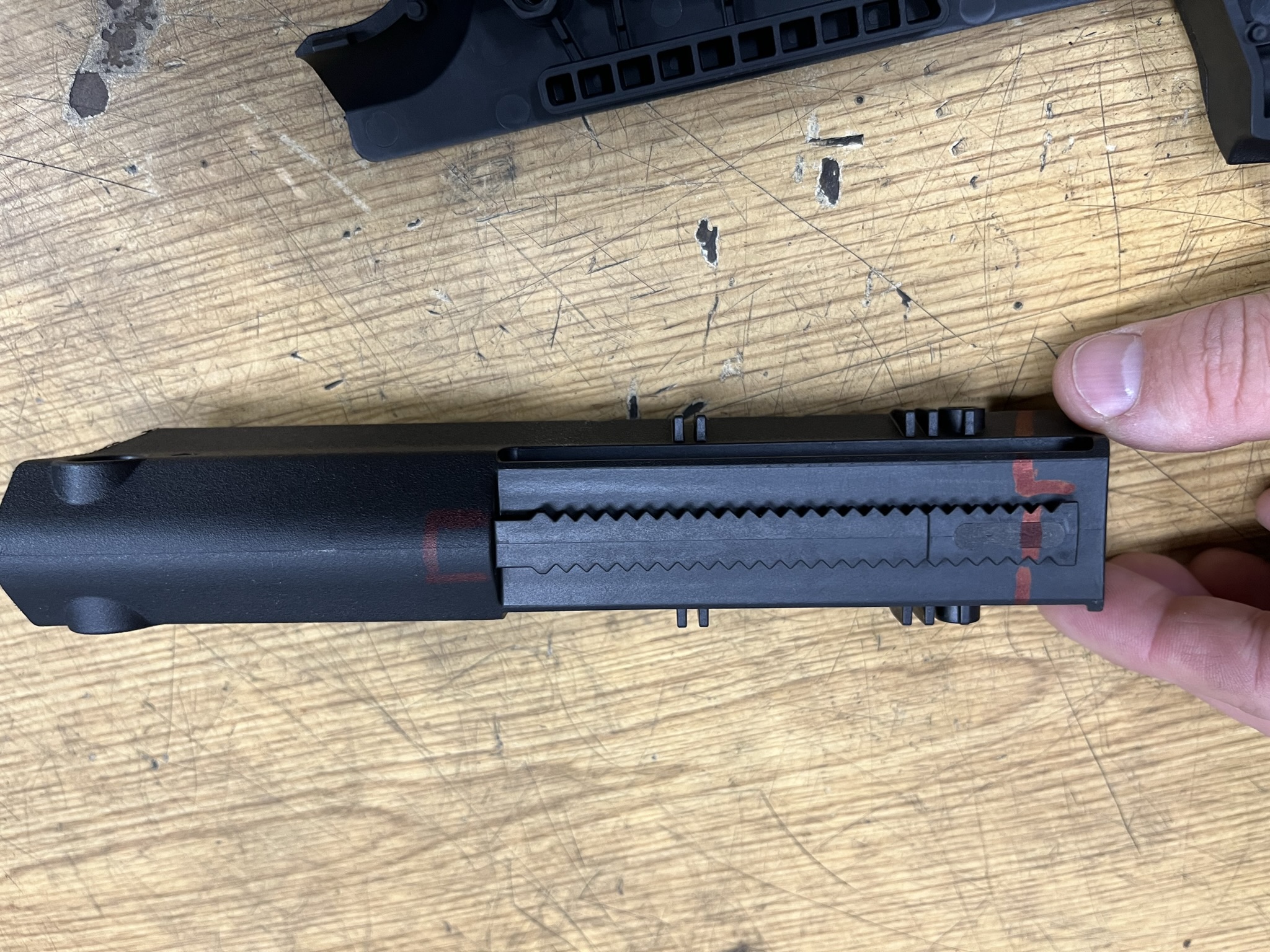

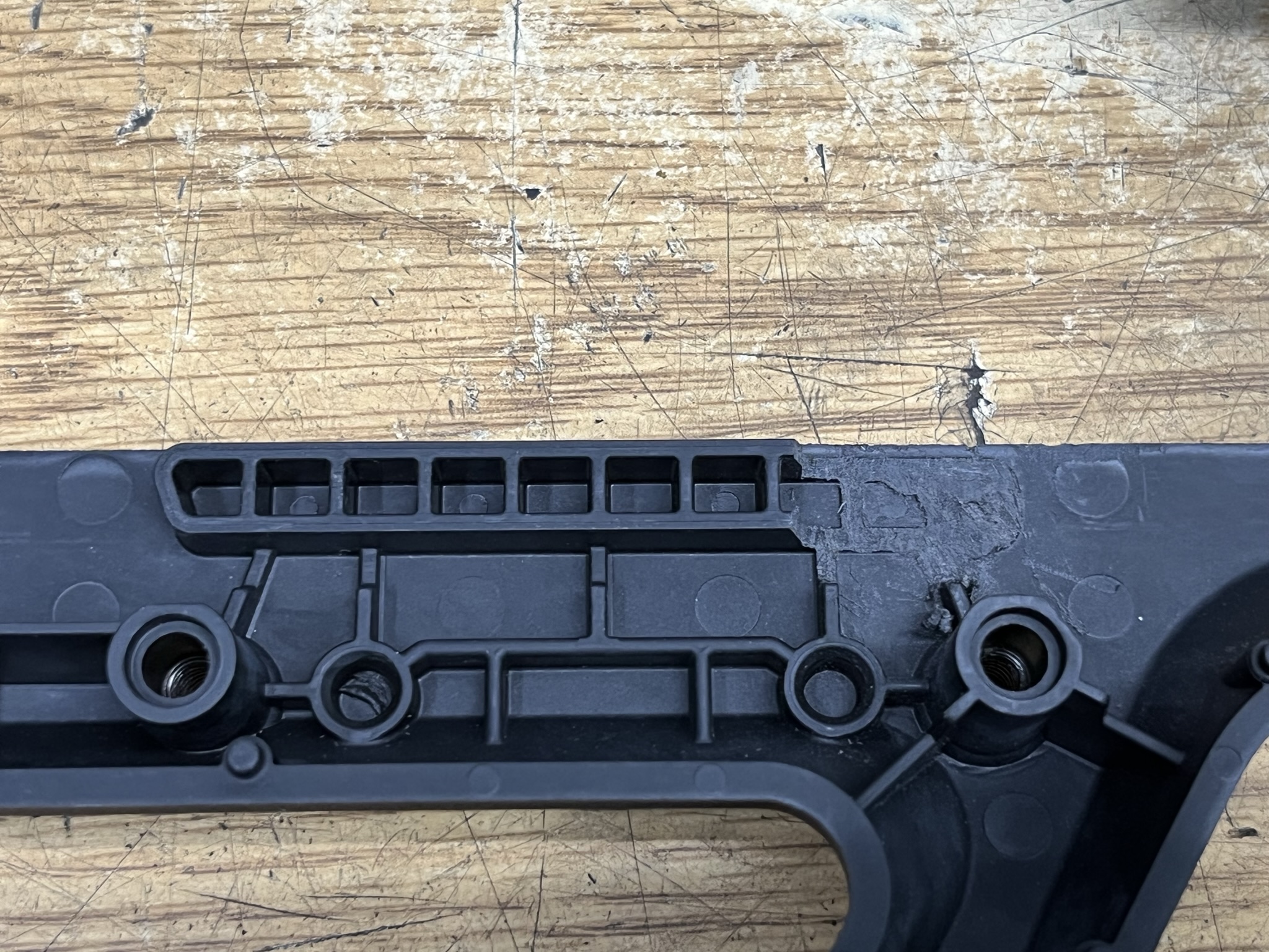

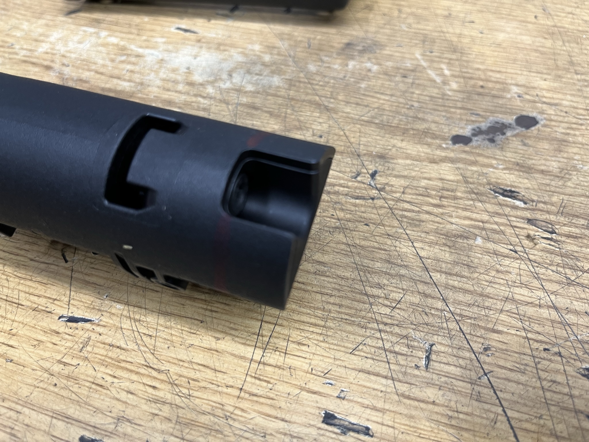

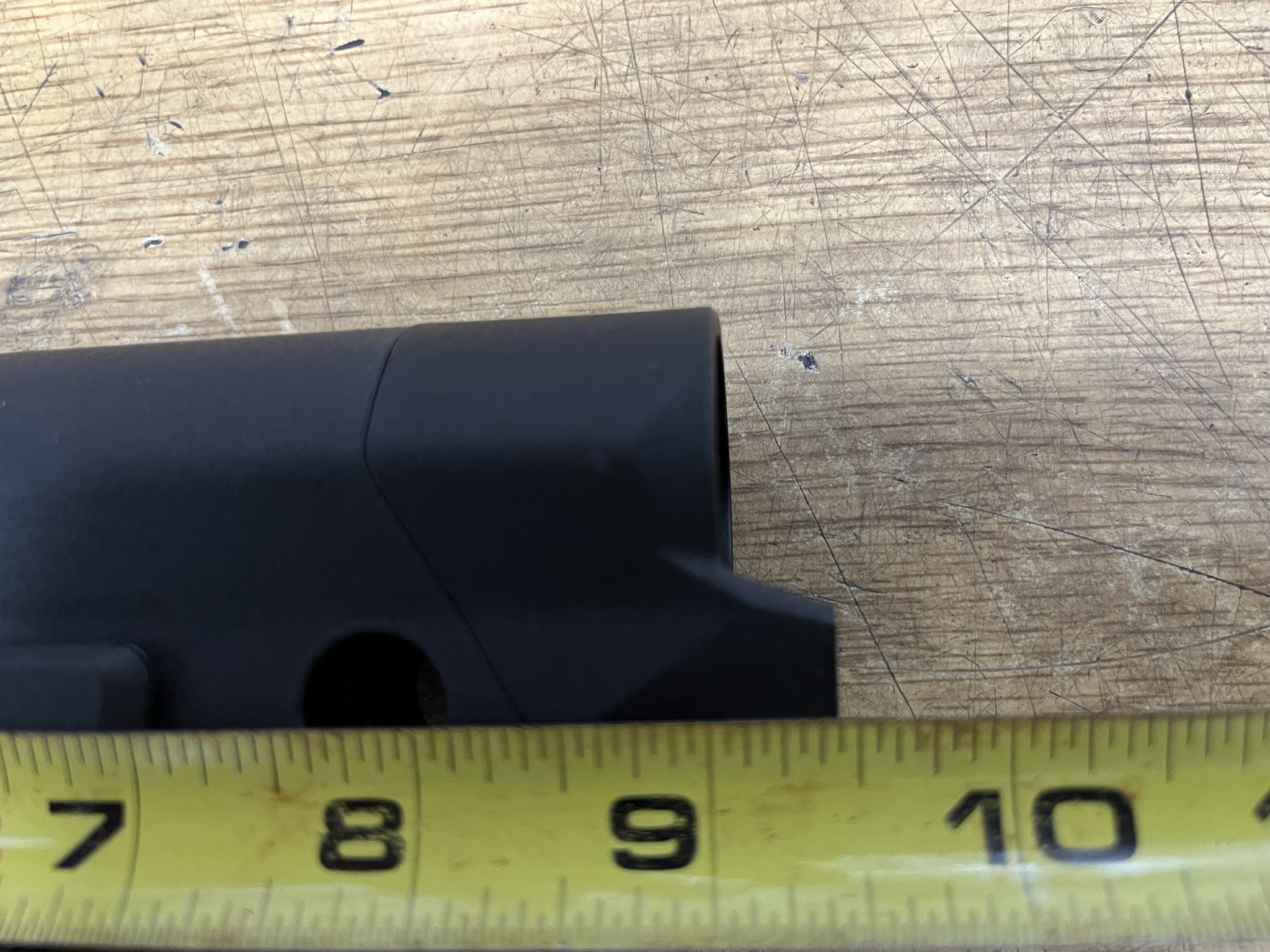

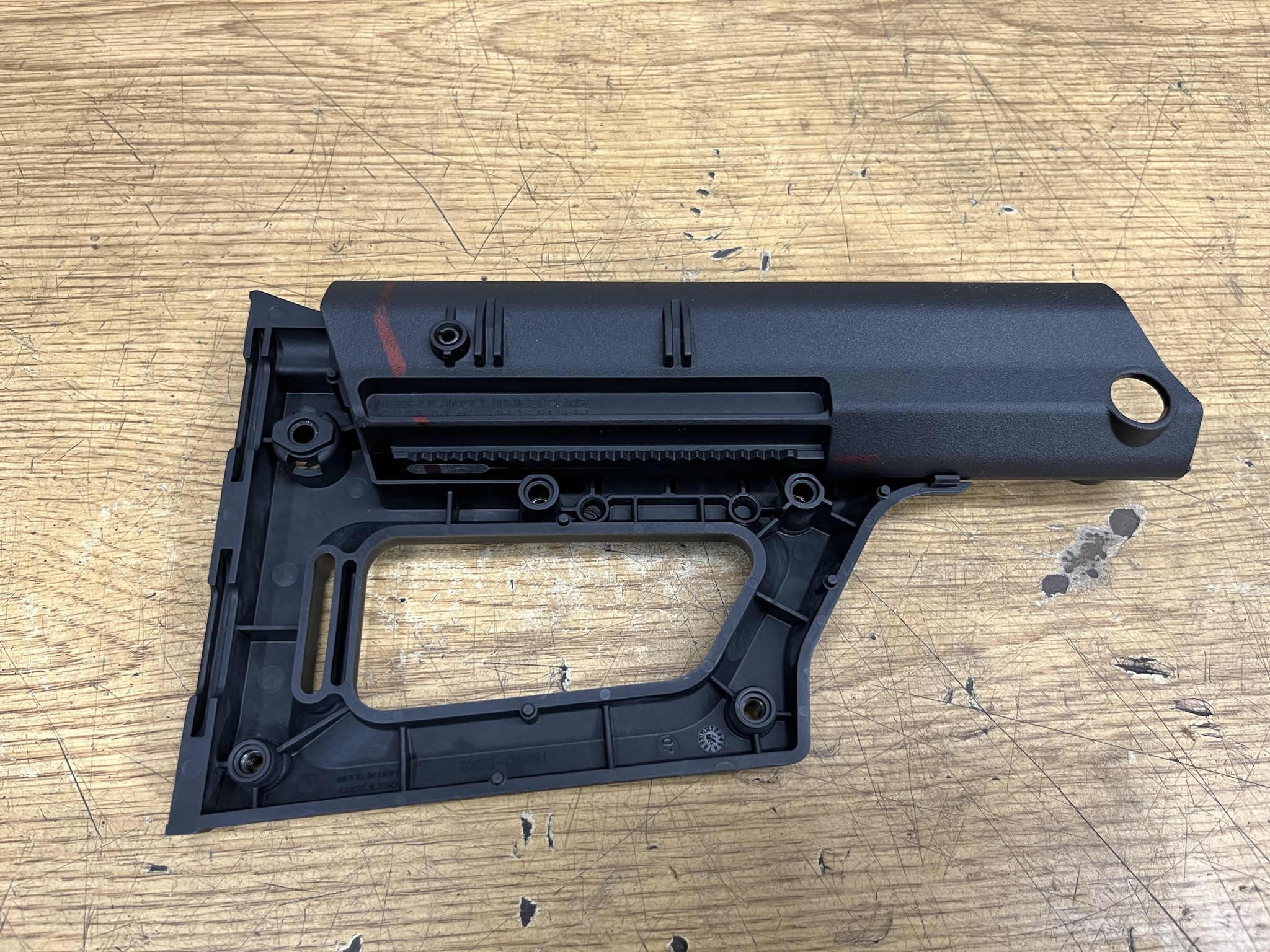

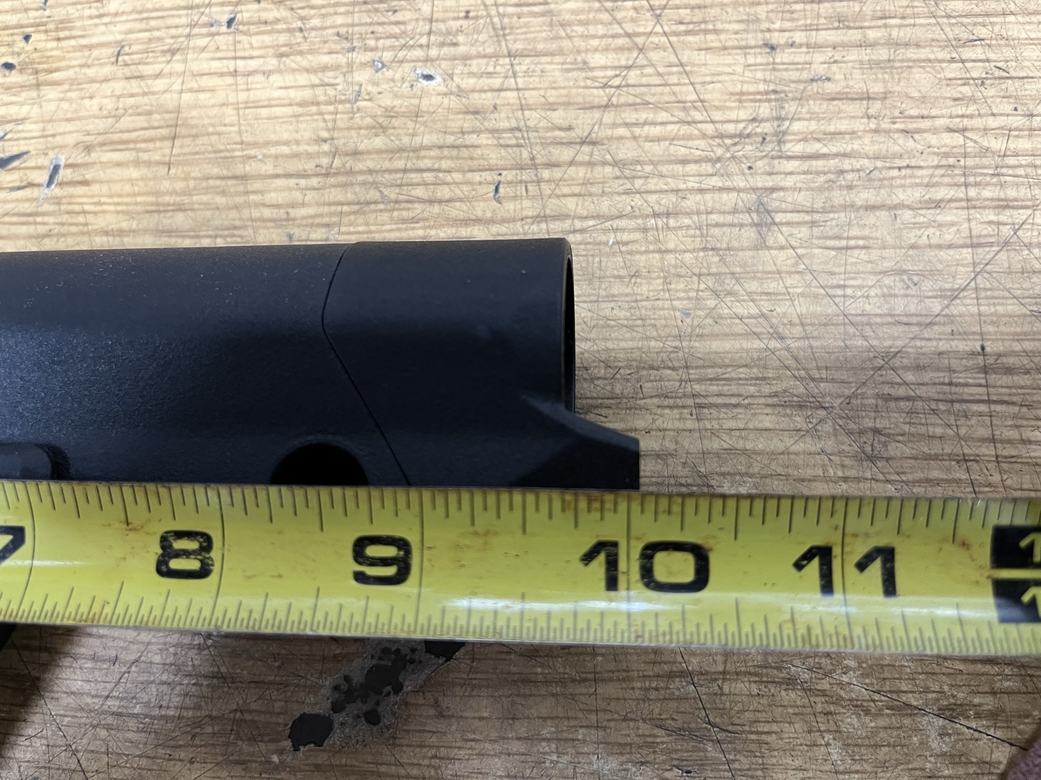

I'll do my best to describe how I went about shortening the length of pull. Not difficult, just a little tedious and worth the effort for me. Yes, the work does look a little crude, but when complete an reassembled, none of the cuts can be seen.
First step is to completely disassemble the stock. In the next 2 pics you can see an overall length measurement to show for reference where the stock started and where it ended up.
and the next pic you can see where I have marked the sliding section to be cut to get 1/2" - 5/8" reduction in LOP. Notice where I marked it with a sharpie....
More to show where I cut the sliding piece.....if you look closely you can see where I marked with a sharpie.
View after cutting the serrated part to length to allow it to move further inside the stock body....
Next pics show areas on the outer stock halves that need to be removed to allow the sliding part to move further back...
View attachment 8011175View attachment 8011176
Hope this helps.
Thanks for the pictures. I would have guessed you took it off the front end, moving the front QD cup closer to the lower receiver.
It wouldn't work that way because the receiver extension bottoms out inside the sliding part of the stock, so I had to shorten the far end.

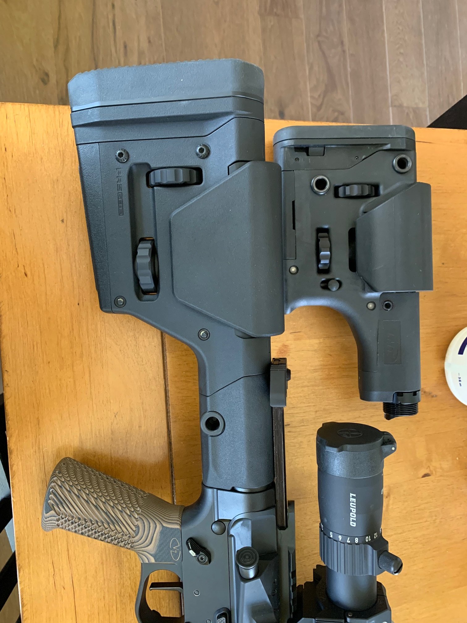

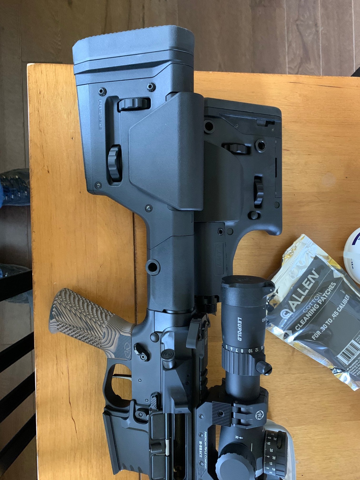

Did you have to trim the front of the cheek piece to clear the charging handle?

I forgot about the cheek piece. Yes I had to shorten it.

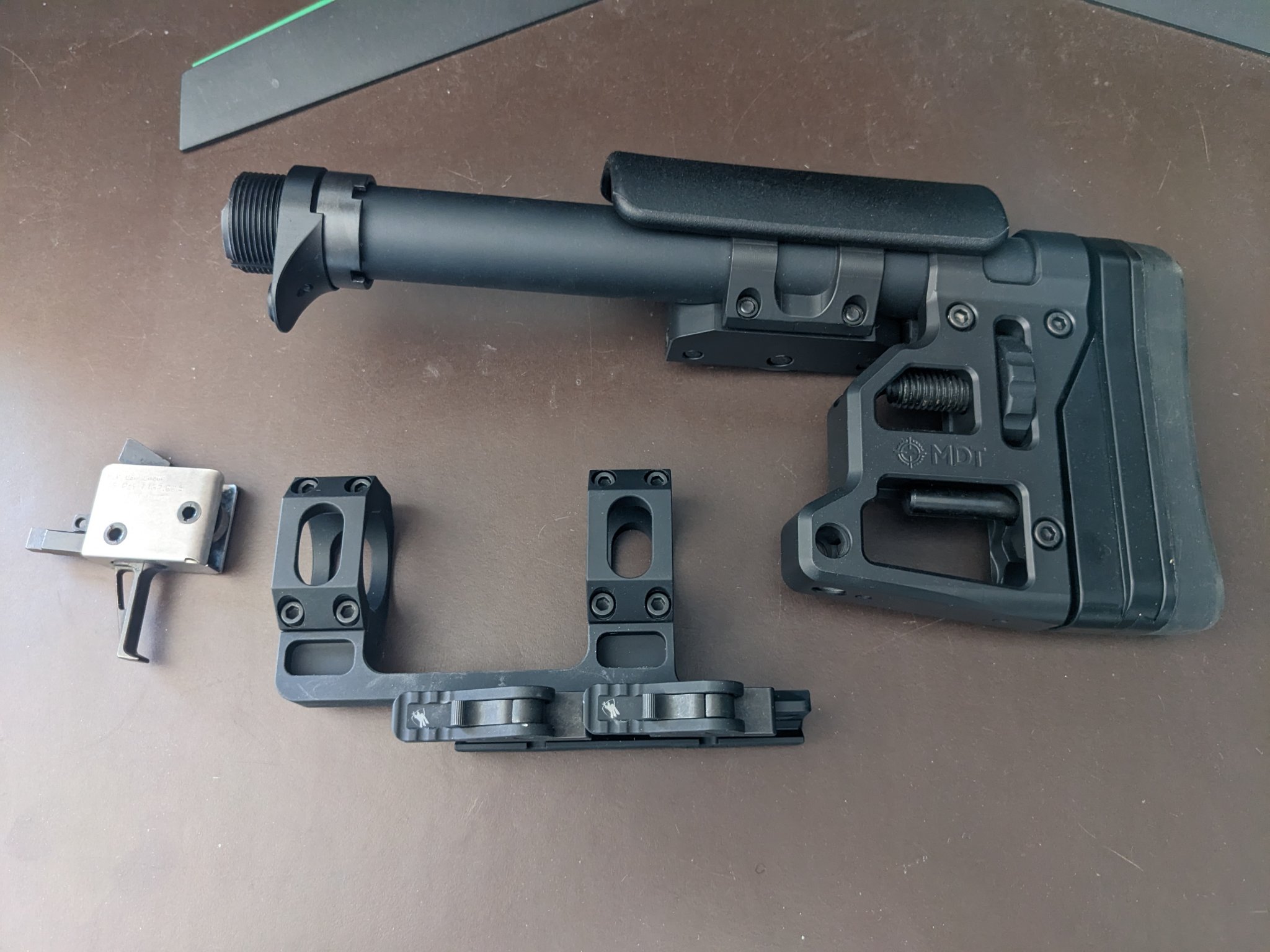

I've had a MDT SCS on my AR for the last couple years and it does have a functioning buffer tube. With the cheekpiece all the way back it does clear a charging handle. It is just a little rear heavy. I posted earlier in here about modifying multiple pieces to shorten the magpul prs lite and that works for me, and am now getting rid of the MDT SCS. I don't believe they make the buffer tube as long on the SCS as they did this one.
That’s good to know. I actually just heard back from MDT who said it wouldnt work for an AR. The cheek piece clearing the CH is a non issue for me as I run folders on all my ARs (except my current 308 due to the LOP of the prs lite). I’m guessing MDT is not allowed to say that their products will work on gas guns due to the laws around “assault” rifle components?
I would guess the SCS lite would work as well then if the regular scs will take a buffer.
The SCS lite won't work as it has the 2 rods going thru the buffer tube for the cheekpiece. They also said the one I posted a picture of wouldn't work, but wouldn't say why so I bought it and tried it. It worked and cleared the charging handle. You could move it closer if you had a side charging handle or even put those clamp on pieces on a shorter buffer tube for a bolt rifle.

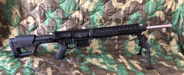

My AR10 SASS with the PRS lite is very comfortable and in my case doesn't seem punishing with the adjustable GB. As far as LOP I only shoot from a benchrest position whether bipod or bags but don't feel it's a problem. The plus is you can remove it and put a collapsable if you need to which is a plus over the PRS Gen. 1-3 which I used to have but sold due to the weight I didn't need.

My AR10 SASS with the PRS lite is very comfortable and in my case doesn't seem punishing with the adjustable GB. As far as LOP I only shoot from a benchrest position whether bipod or bags but don't feel it's a problem. The plus is you can remove it and put a collapsable if you need to which is a plus over the PRS Gen. 1-3 which I used to have but sold due to the weight I didn't need.View attachment 8101435
Nice rifle.
