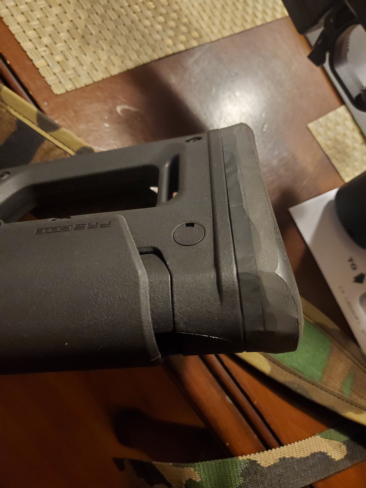

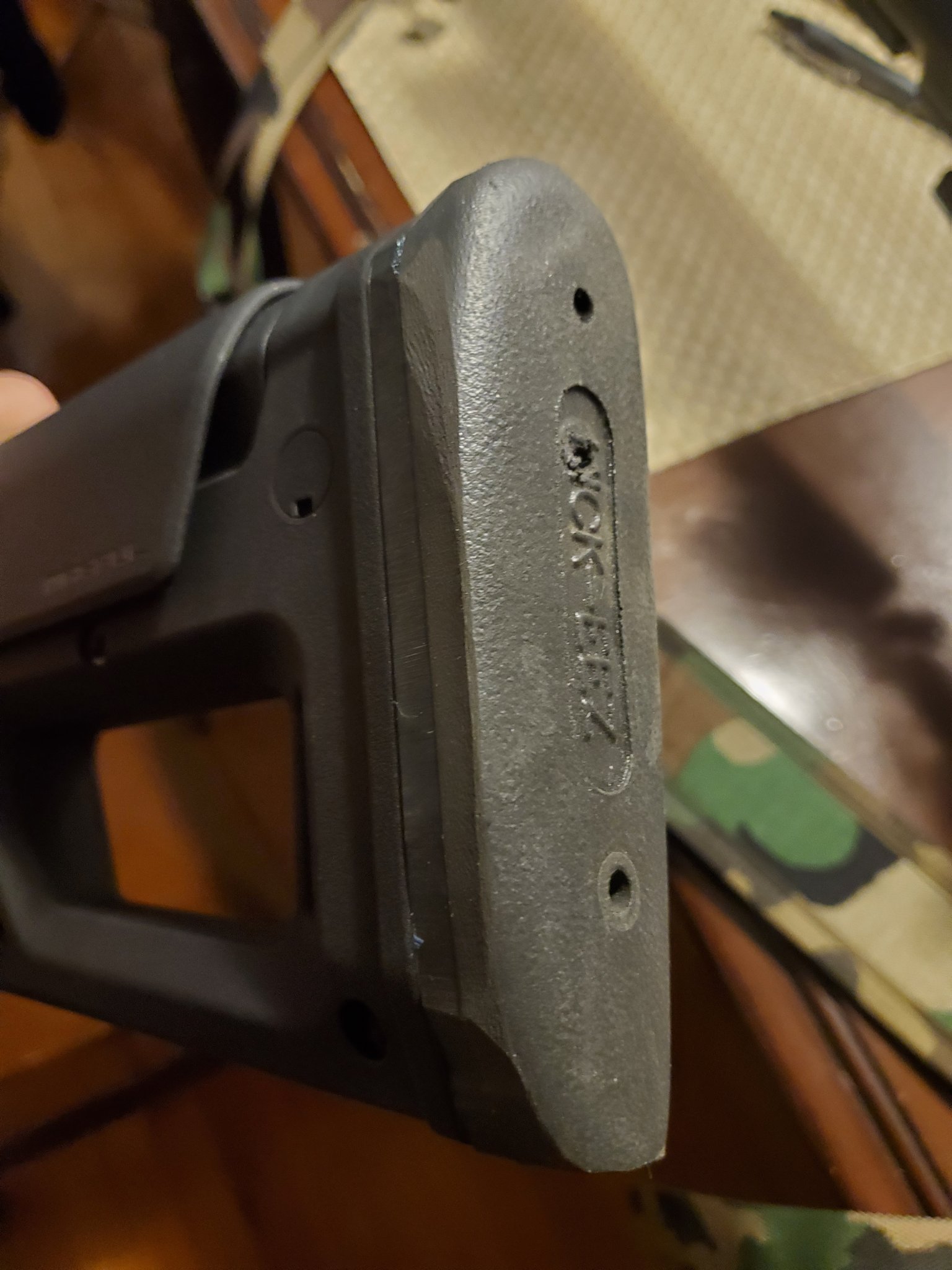

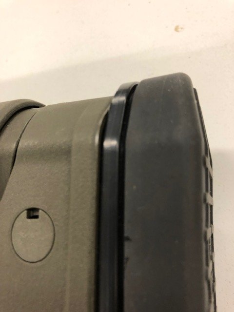

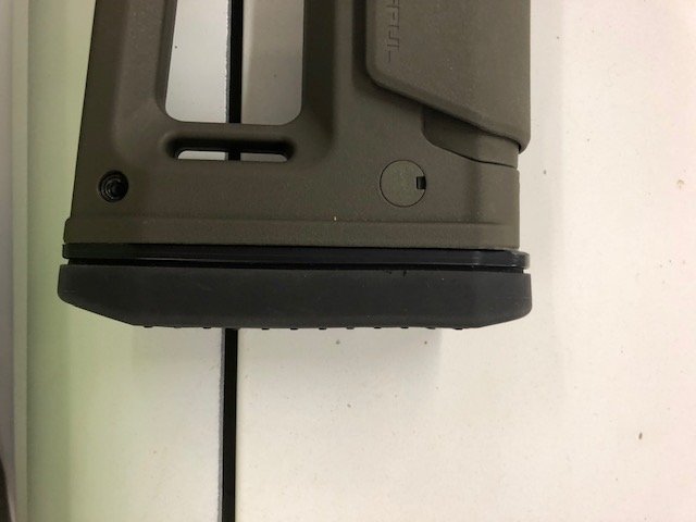

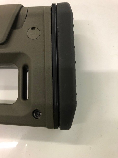

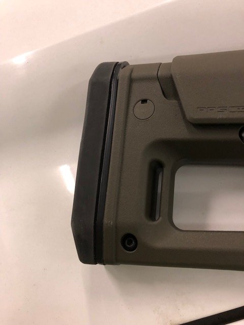

I guess it depends on how good you want it to look. I'm ok with it not being perfect so this is what I did. I'm really happy with the way it feels. Obviously I had to drill a new top hole and grind it to fit

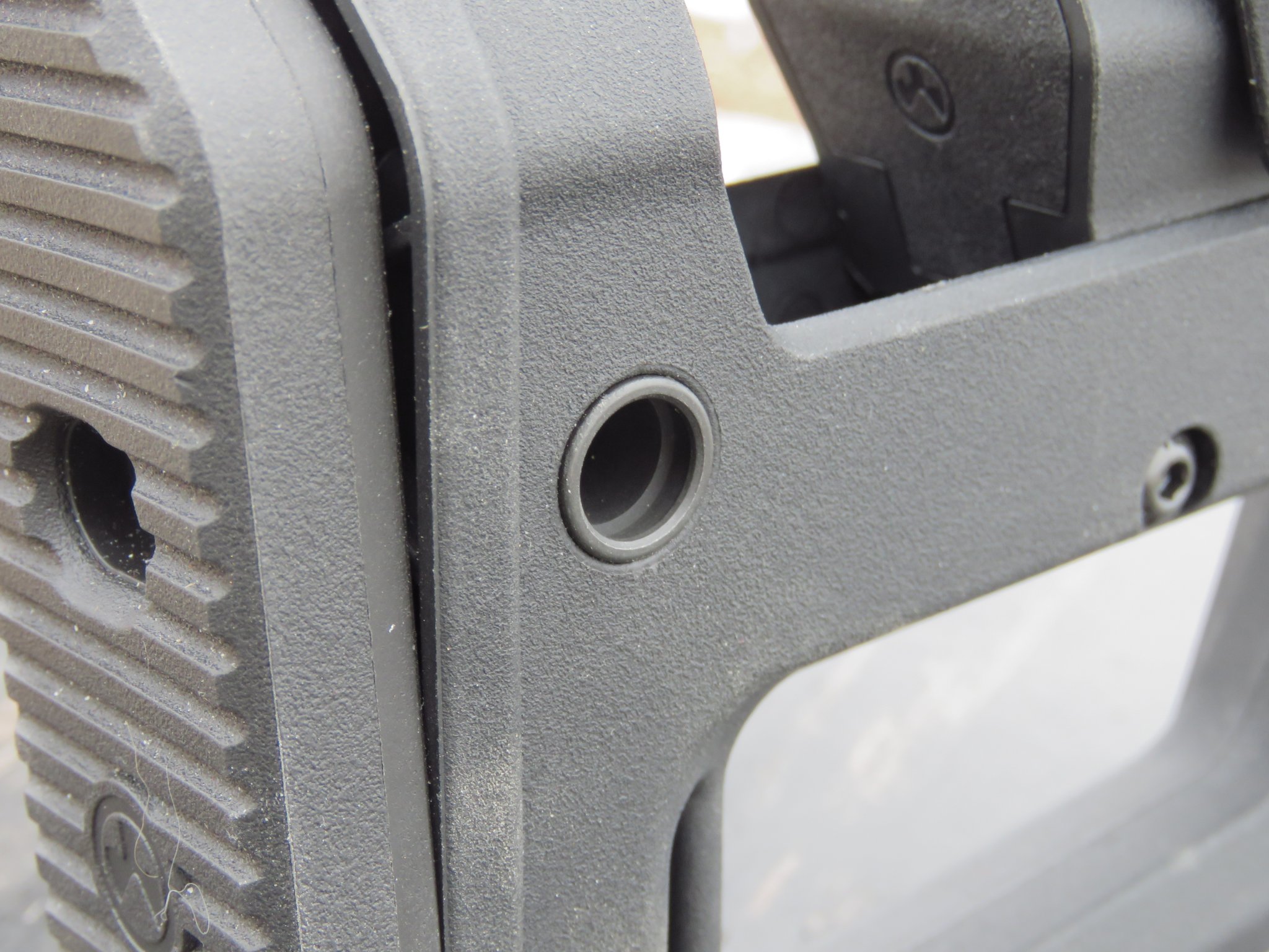

took a few pics in case it helps anyone here. One thing to note for KAC owners, sorry if its been covered already. Due to the KAC hardware thickness if you go with the PRS Lite it will leave a gap and expose threads on the buffer tube. The pic (SR15) with no gap is taking the KAC hardware off and throwing on a base plate and mil-spec castle nut.
any questions let me know, hope this helps.

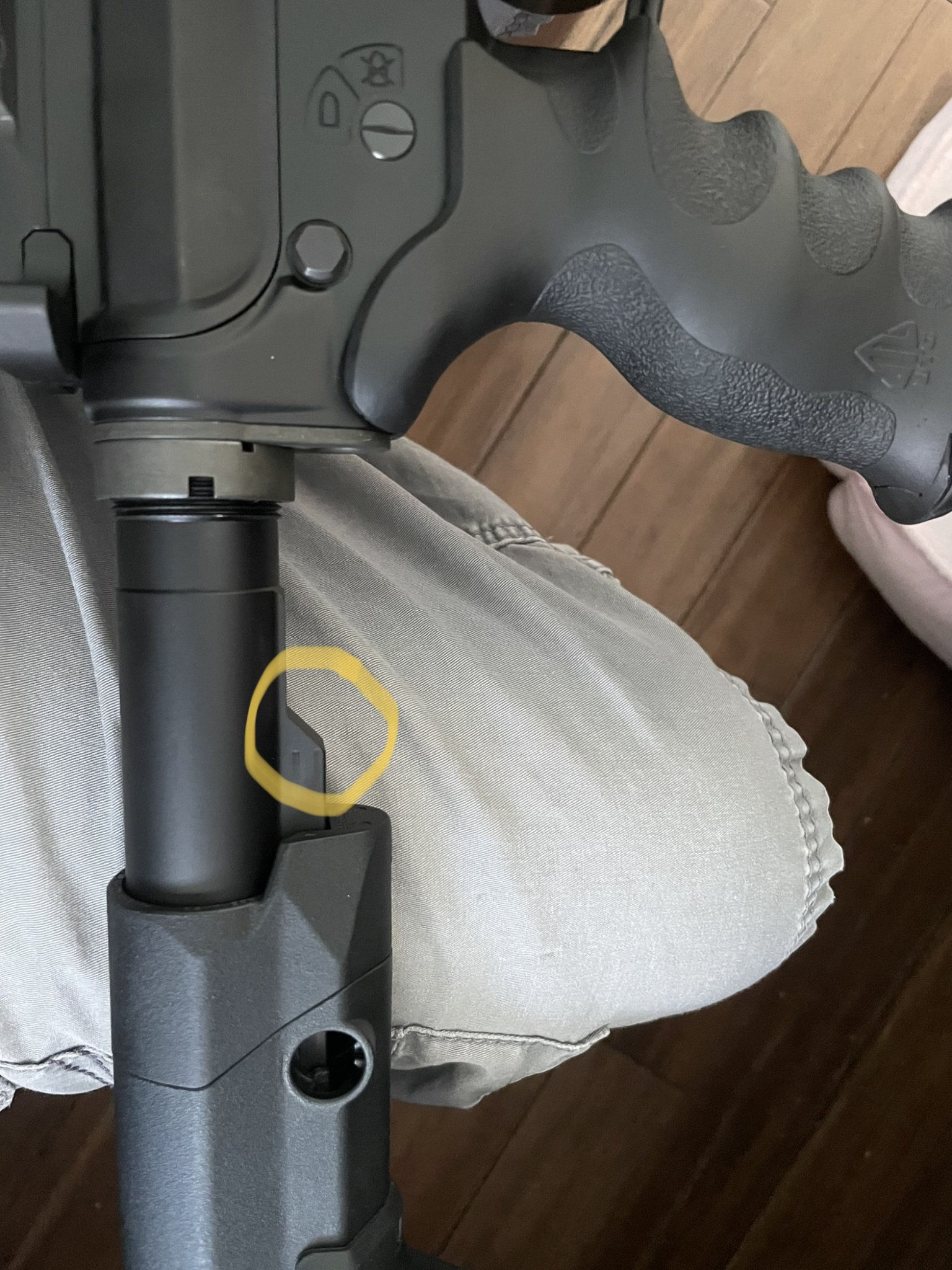

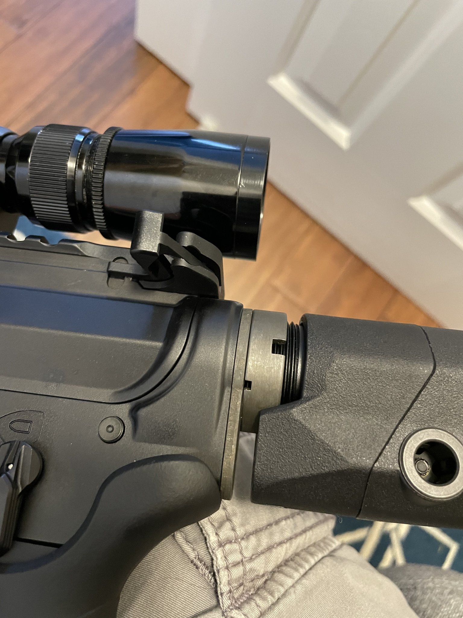

Has anyone had an issue with this stock sliding back on the buffer tube? I have the bolt tight but I was cleaning the gun today and the stock kept sliding back on the buffer tube.
I am using an aero enhanced buffer tube, not sure if that would make a difference.

I was thinking my buffer tube wasnt screwed in enough but if i screw it in any more the detent pin wont be able to slide through the slot on the enhanced buffer tube.
Yeah that's excessive. My first step would be to disassemble the stock and inspect it for any broken pieces, then reassemble it. I found it helped to push the stock forward into the castle nut and hold it there with my hip while I tightened the mounting screw to spec (20 in/lbs IIRC). If that didn't work, I'd switch out the receiver extension for a traditional mil-spec unit and see if it was indeed something with the enhanced buffer tube.

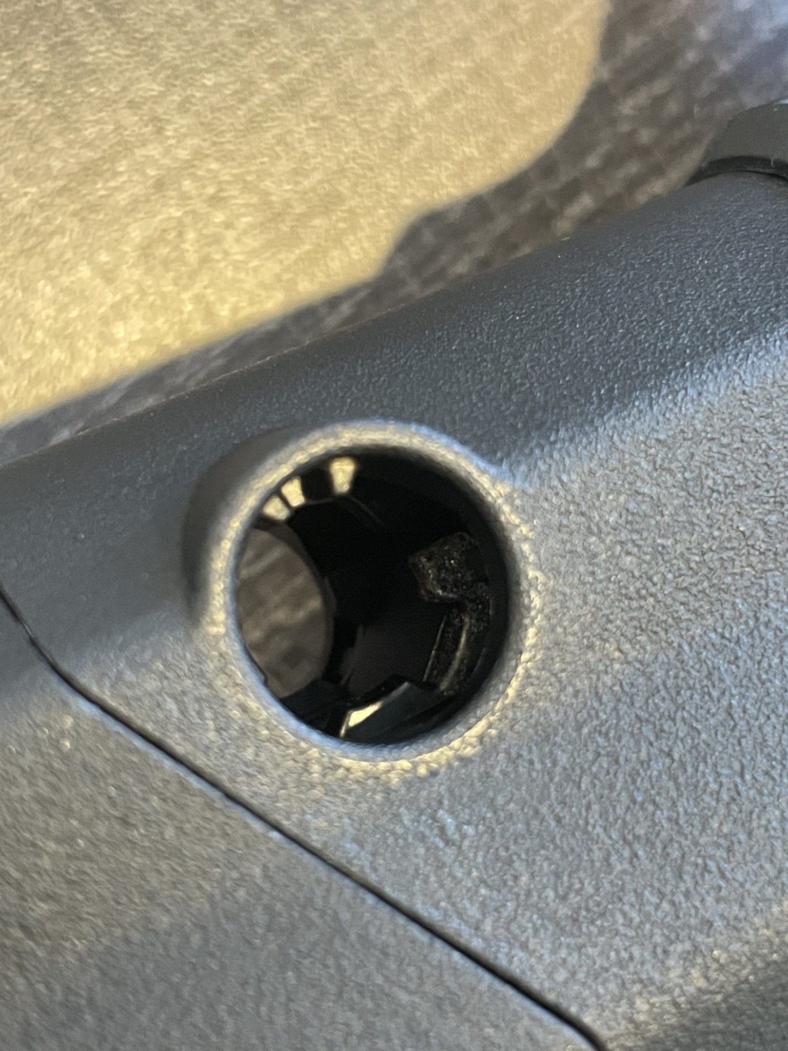

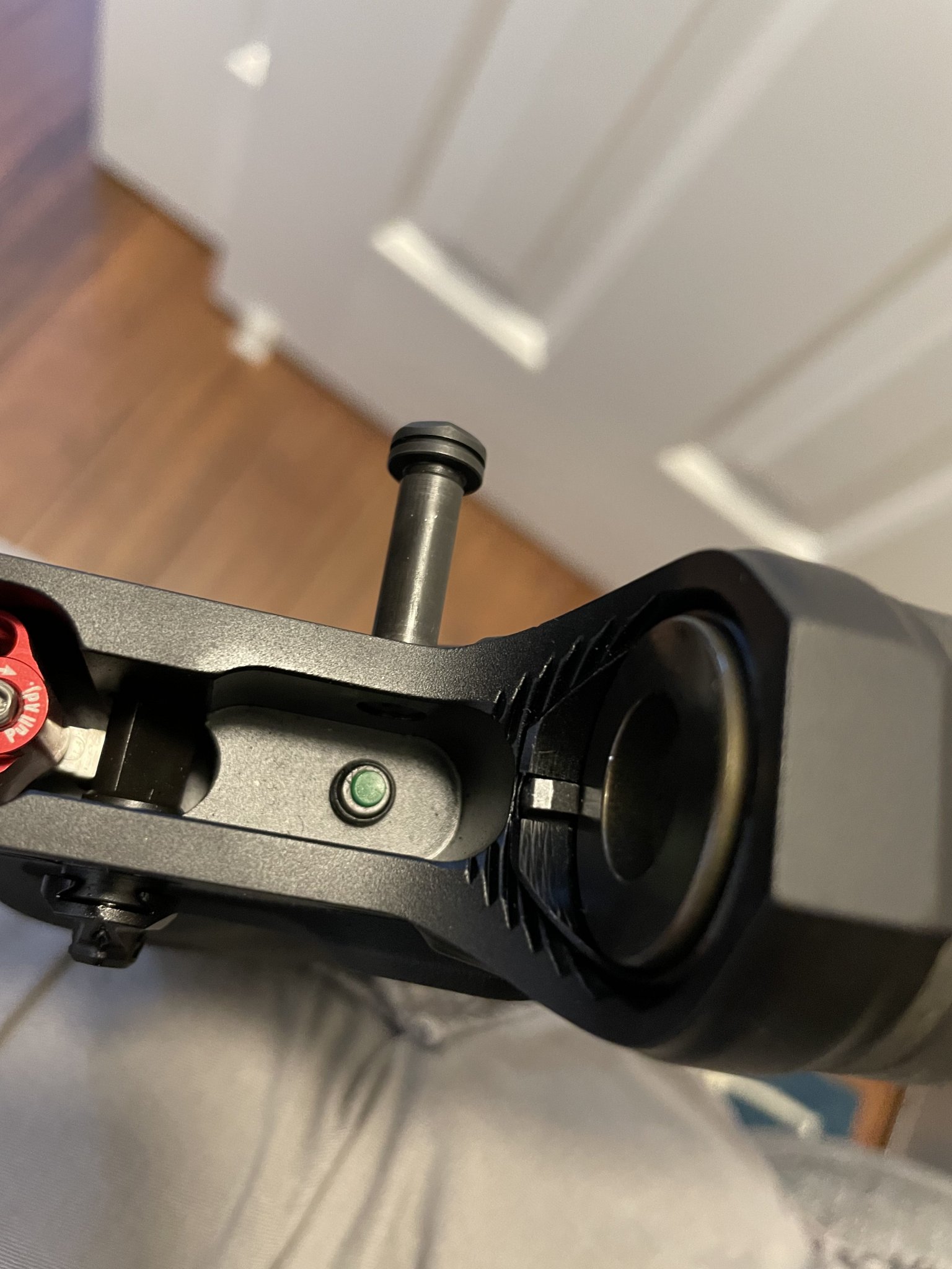

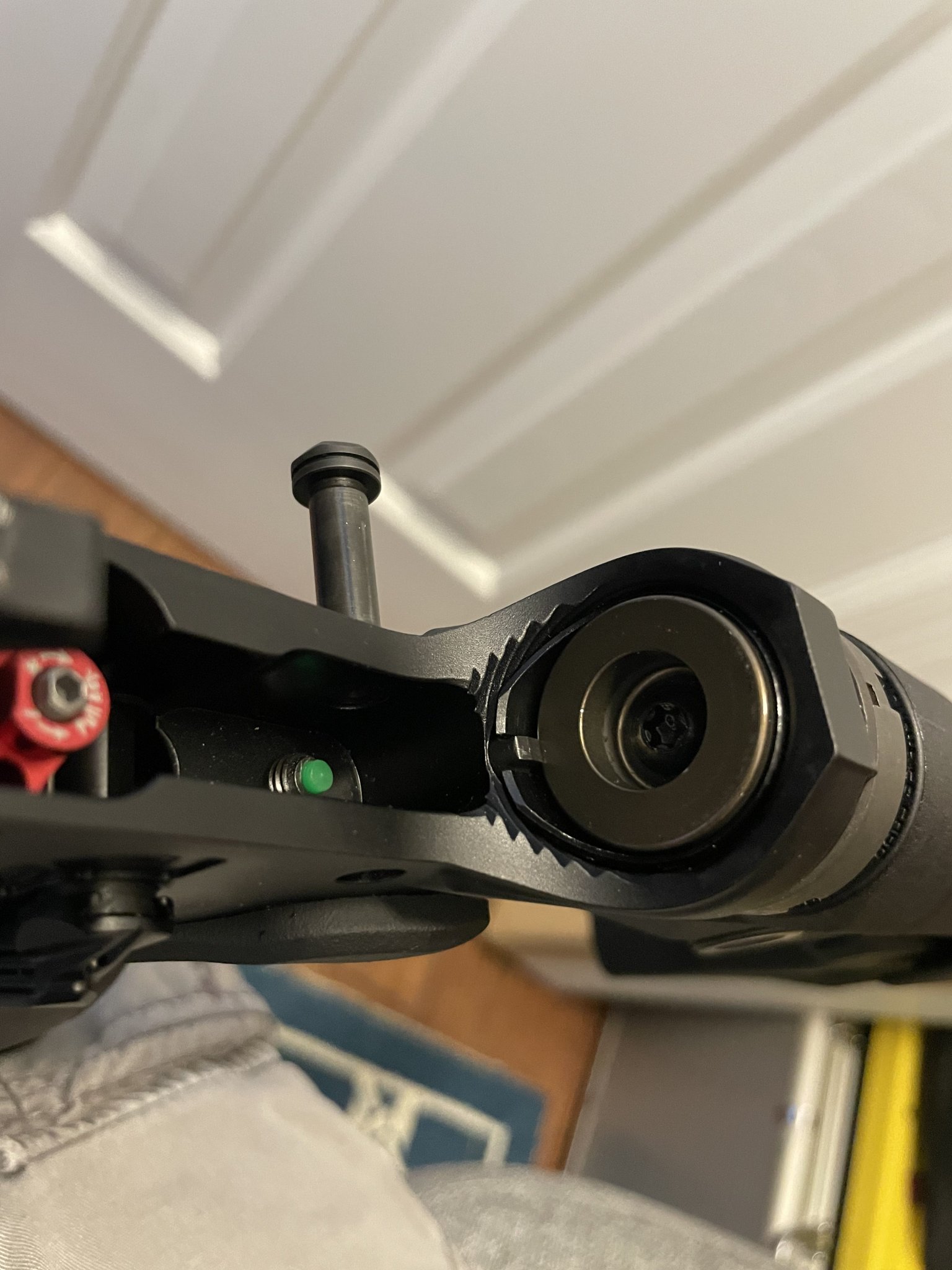

Yeah, the issue is the buffer tube is not in far enough for the bushing and screw to rest agains the part that I circled. So i can pull the stock back and then it hits that part.
I have a silent capture spring, so I don't really need the detent in there, Im going to try and remove the detent and screw the buffer tube in more.
You can see in the second pic i lined up the angled part of the buffer tube to just touch the hole where the bushing and screw go, if I look at the stock I can see it is pushed back the same amount, so that tells me I need to push the buffer tube in further into the rifle.

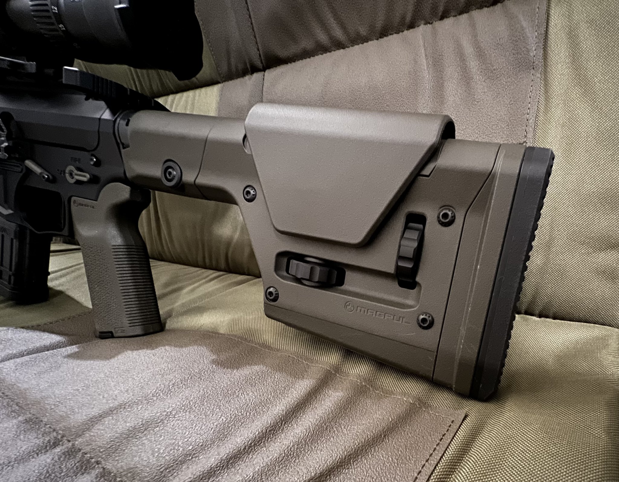

I got ahold of one of these and I’m really liking it, the only downfall is no tool less adjustment but the weight savings is worth it, if you want an adjustable set it and forget it then you will like this stock.
Reactions: lash
Is it a perfect fit? Looks amazing and for some reason I figured it would have a different profile?
I’d say it’s a perfect fit. It seems to be the exact same profile. The back edges do seem to have a slightly larger radius which makes it look not as flush as the original, but to me that’s boarderline nitpicking.

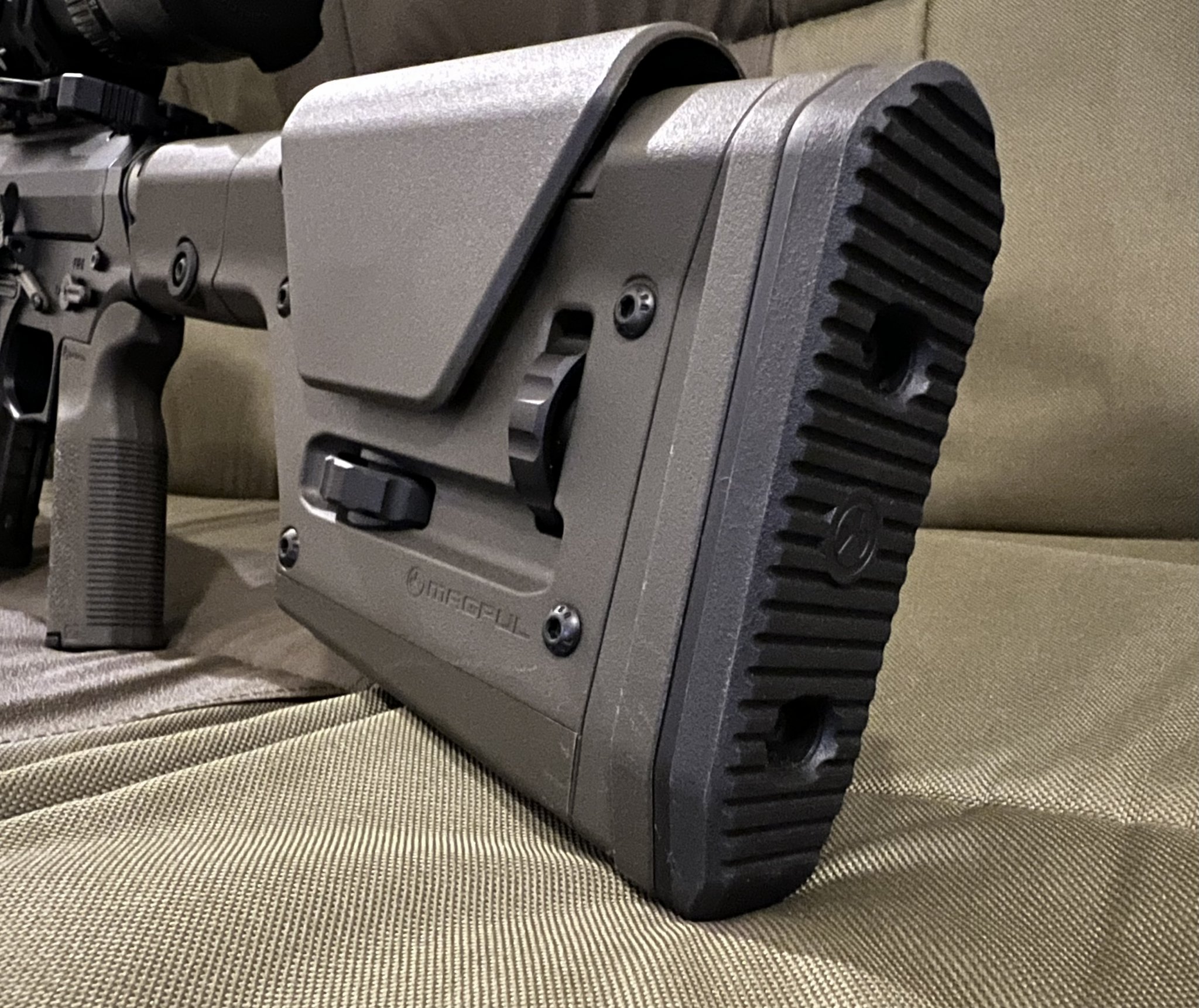

One other important note, the Lite pad is not “squishy“ at all, in fact I’d say it’s more plastic than rubber. But for my application, an 11 lb, 20” heavy barrel, 5.56 recoil isn’t an issue...

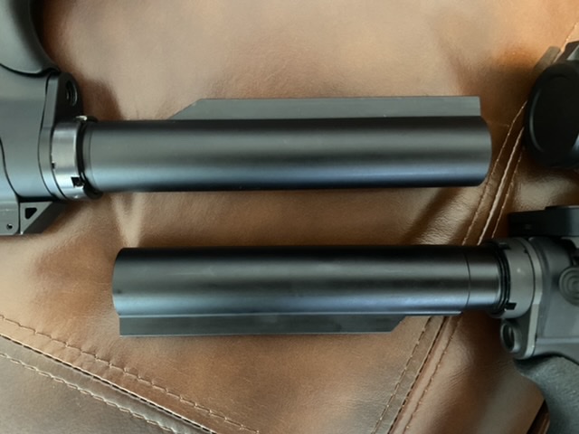

Yes, I just got mine, and it slides back about 3/16” no matter how tight the screw is dogged down. It takes a bit of effort to slide it back, but it’s definitely not confidence inspiring. There is a gap between the lock screw and the adjustment track (?) on the receiver extension which defines the amount of potential slop in the system. I’m thinking about shimming it, or sending it back to Magpul.
I do have a couple of other receiver extensions kicking about. Maybe I’ll try it on them and switch things around for the best fit.
I’m generally a fan of Magpul products, but this stock is a let down.
I’m going to amend what I said above. I do have a couple of other carbine receiver extensions kicking about, so I tried the PRS lite on them. The top is an Anderson Mil Spec RE. The bottom is an Aero Mil Spec RE. Note that the slope on the adjustment track differs between the two. As was noted above, the Aero RE has a steeper slope which doesn’t interface well with the magpul PRS lite stock. Also of note is the thickness of the receiver end plate mated to the Anderson RE. This also impacts how the stock fits. Too thick and the locking hardware doesn’t fit. Too thin and you get a sloppy fit.
With the Mil spec Anderson RE and a Mil spec end plate, I was still getting more slop in the stock than I found acceptable. I was able to take up the extra slop by grinding in a recess for the buffer retainer into the RE, and threading the RE one extra turn into the receiver. While I haven’t shot the rifle yet, there is enough travel in the bcg that it still clears the bolt stop, so I don’t expect any function issues to arise from my modest RE modification.
So, the stock fits and I’m not sending it back. It doesn’t work well with an Aero receiver extension. You may need to play around with bit and bobs to get it the fit you want. The stock is not plug-and-play in my experience. That said, it is lighter than the PRS stock. And, while the adjustments are not tool-less, it maintains much of the adjustability of the heavier and more expensive big brother.

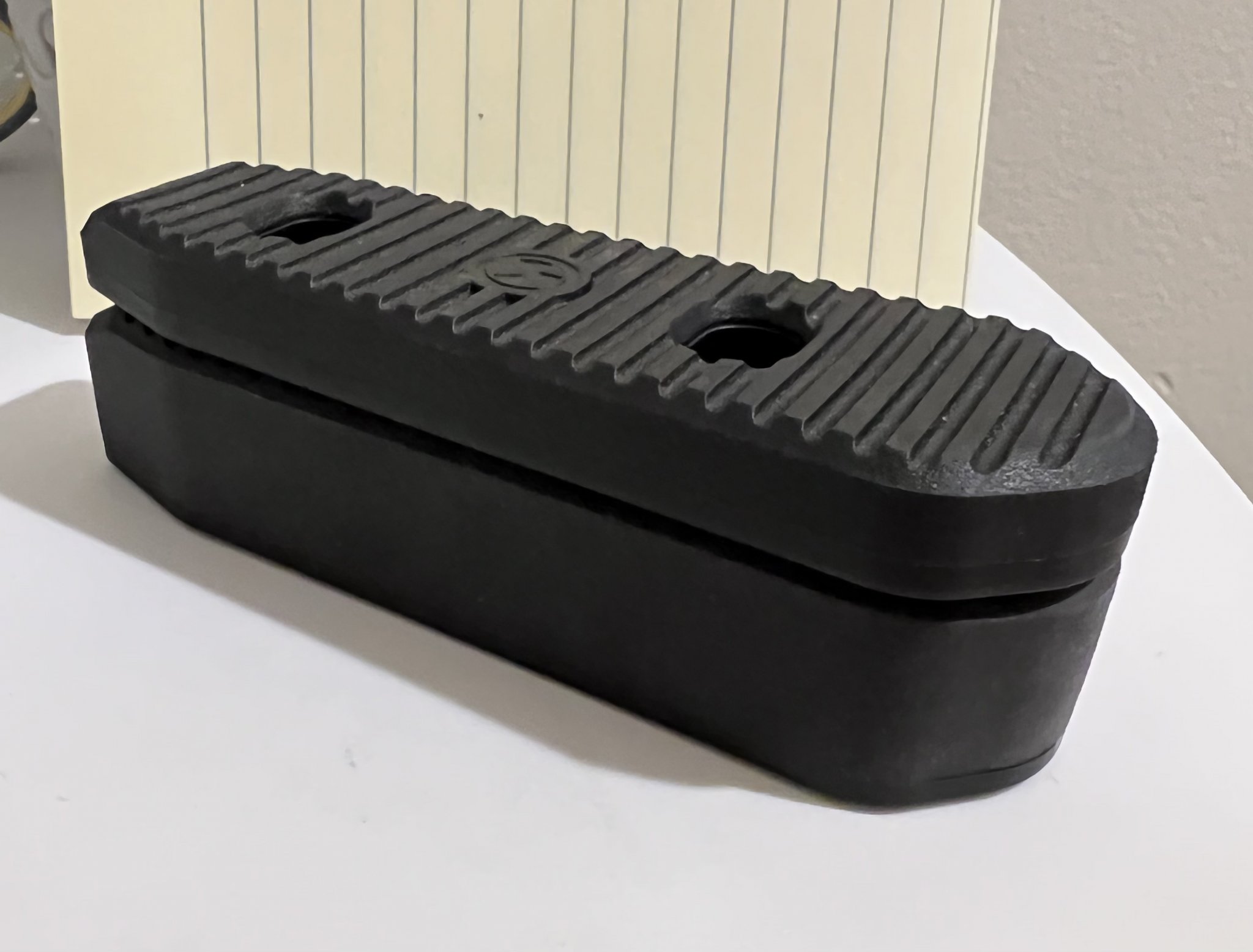

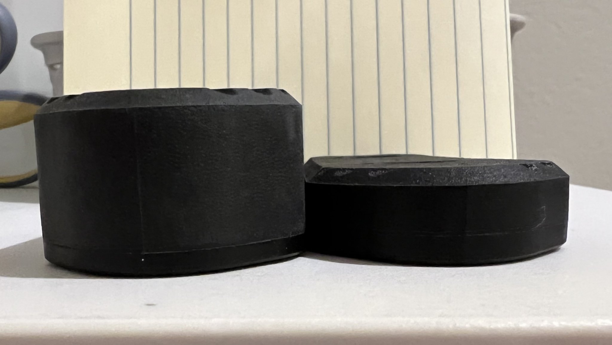

Right! It is not a recoil pad…just hard plastic. If anybody finds a real recoil pad that fits, I’ll buy one.

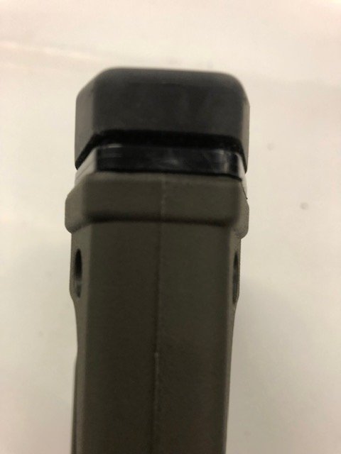

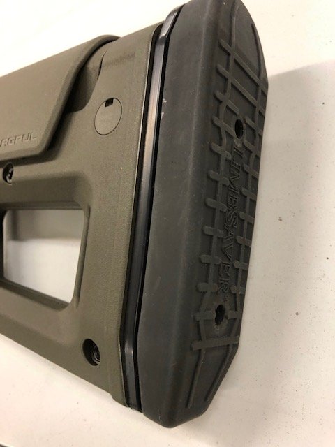

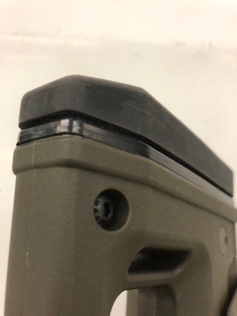

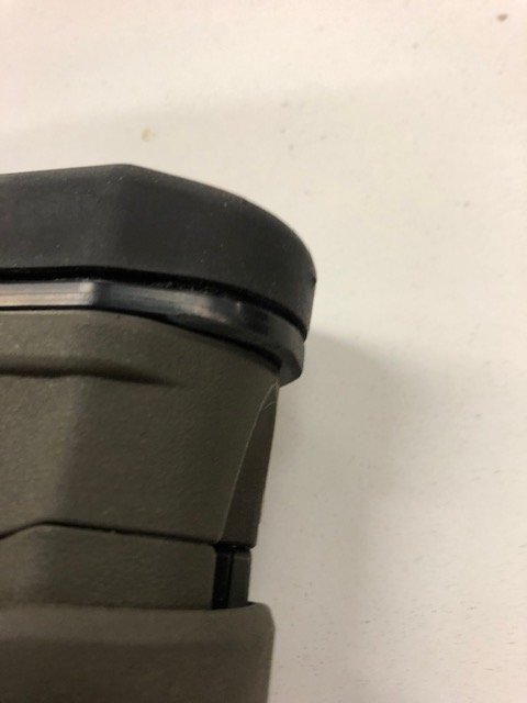

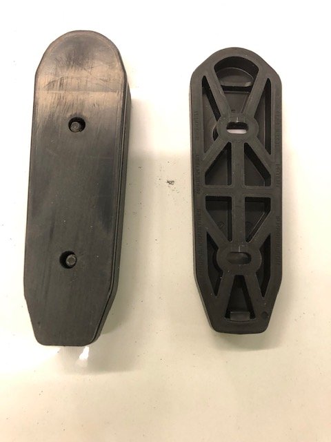

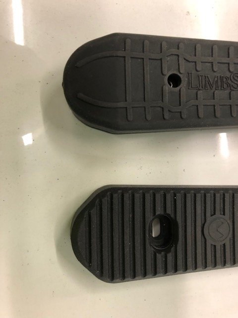

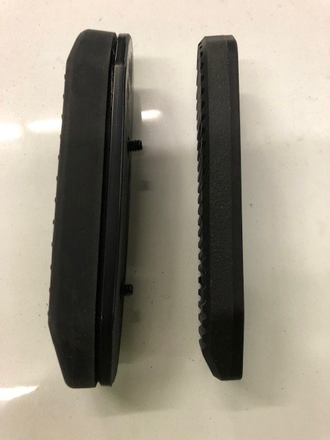

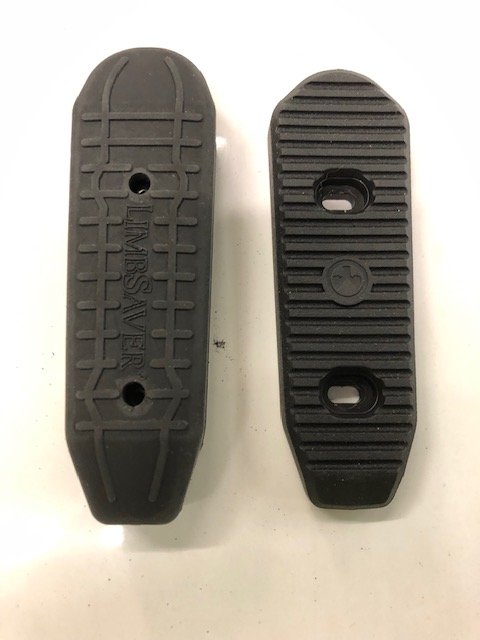

I just tried a Limbsaver Recoil Pad ( Quite soft , and durable ) for a Magpul SL / UBR Gen 2 stock. https://www.nokick.com/limbsaver-recoil-pad-for-magpul-sl-stocks.html
I had to sand down flat ( took about 3 minutes, sheet of 100grit and sheet of 180grit ) the angle on the bottom of the hard plastic, and the fit is pretty danged good IMHO.
The screw holes matched, and I used the OEM screws.
The top is slightly to high, but the rest of the profile matches good enough for me. As seen it the photos, the various angles match up pretty good.
I just quickly slapped it on... so if the alignment isn't perfect, I am comfortable I could adjust it side to side.
However, the top part that is high will take some messing with to get it flush'ish. As it is.. I could easily use it.

Side to side pics of the Magpul OEM hard-ass plastic "pad" Vs. the Limbsaver SL / UBR Gen 2.
The last pic shows the sanding marks at the bottom inside.

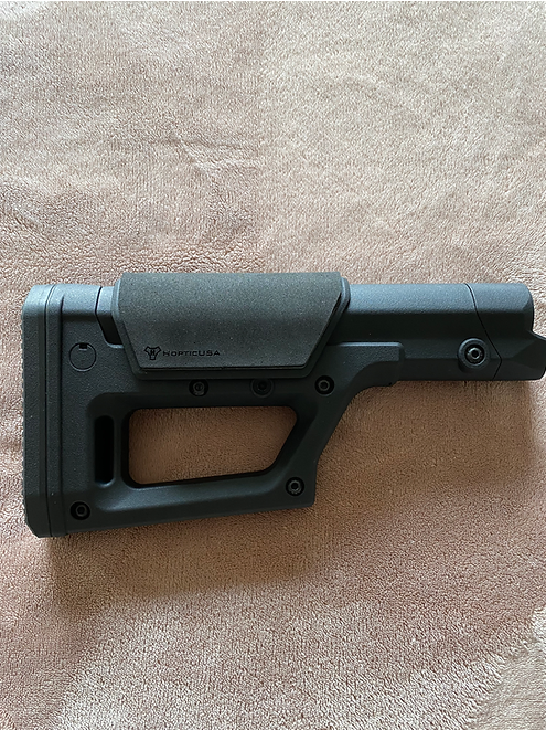

And... because I am a pussy. Hoptic USA makes a die cut adhesive backed "Saddle Blanket" ( cushioned cheek pad ) for the PRS Lite.
https://www.hopticusa.com/product-page/magpul-prs-gen-1-2-3-saddle-blanket
I have ordered some... and will post here about them after they arrive.
1/8 inch thick... Hoptics pic
FWIW... they make quite a few cheek pads for various Precision rifle stocks... I have no affiliation with them, but I was surprised the about the variety of cheek rests offered.

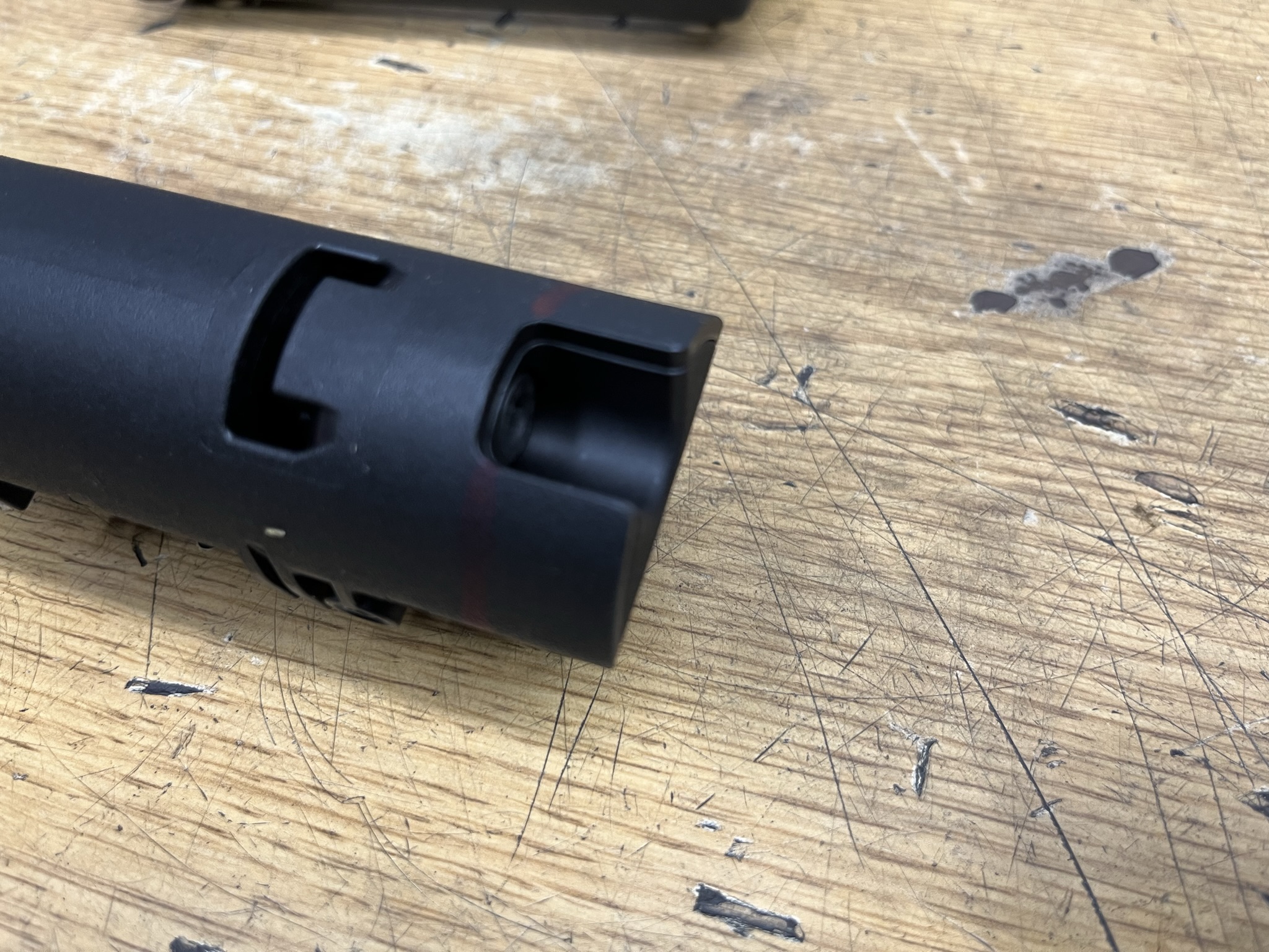

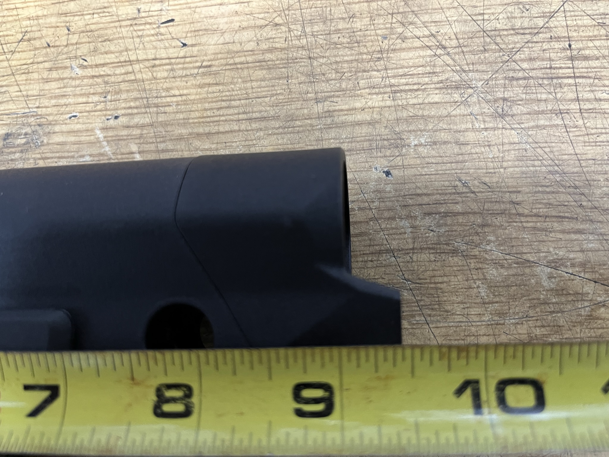

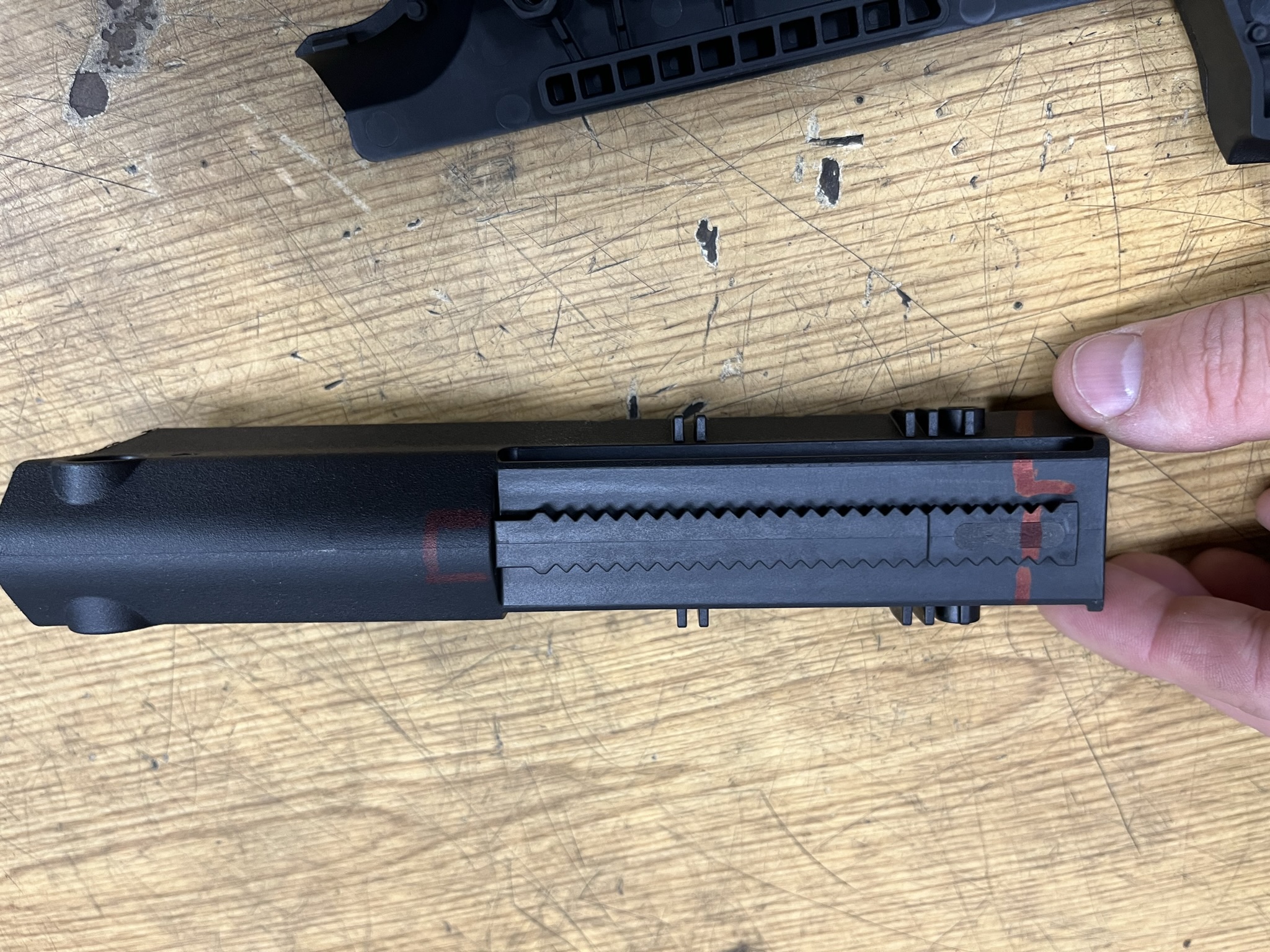

I'll do my best to describe how I went about shortening the length of pull. Not difficult, just a little tedious and worth the effort for me. Yes, the work does look a little crude, but when complete an reassembled, none of the cuts can be seen.

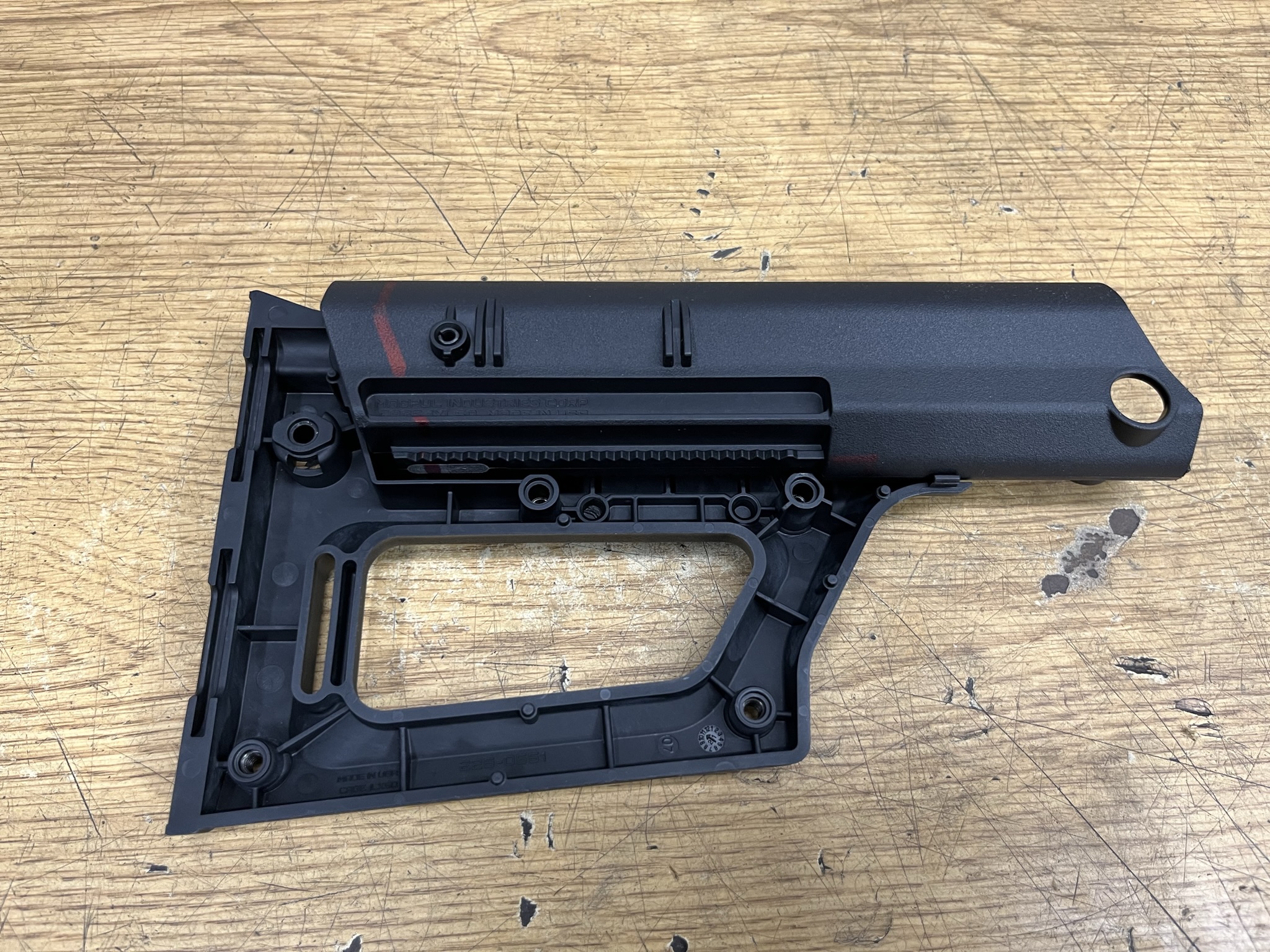

First step is to completely disassemble the stock. In the next 2 pics you can see an overall length measurement to show for reference where the stock started and where it ended up.

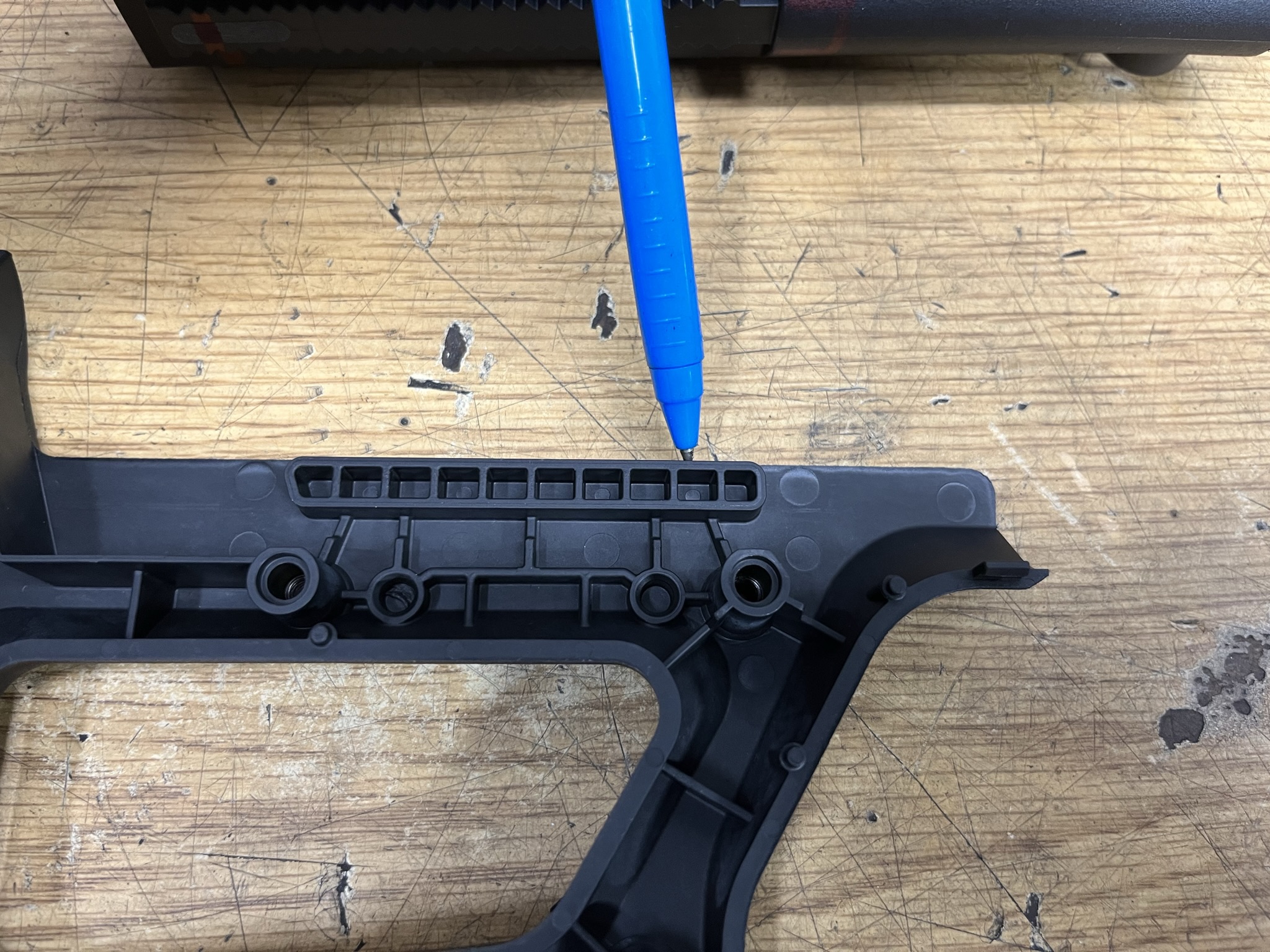

and the next pic you can see where I have marked the sliding section to be cut to get 1/2" - 5/8" reduction in LOP. Notice where I marked it with a sharpie....

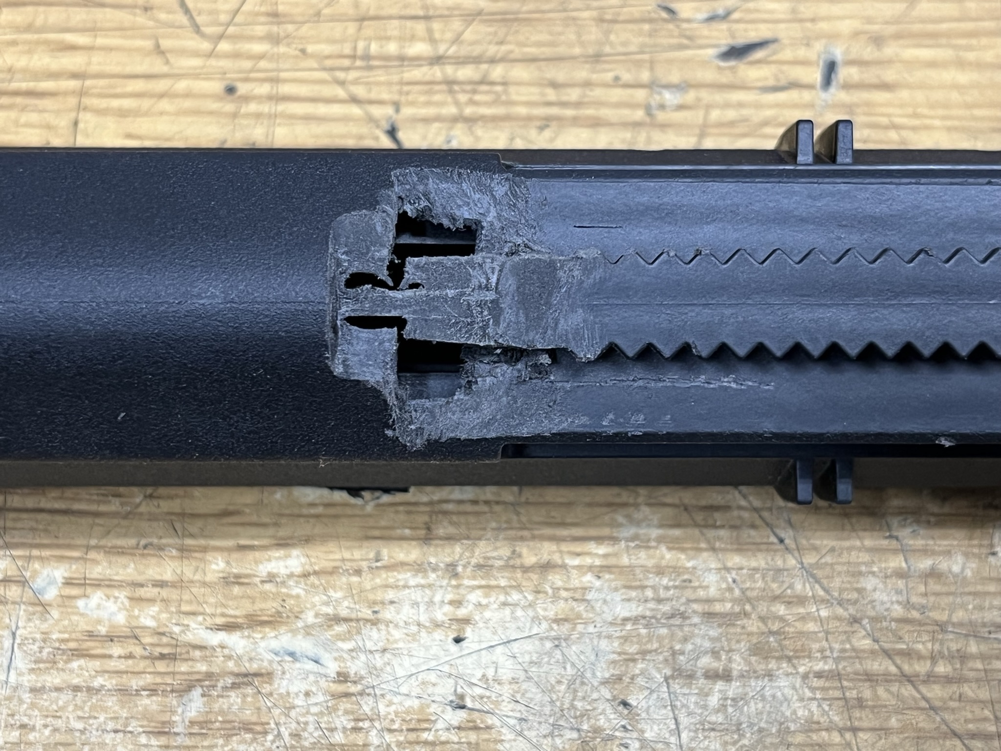

More to show where I cut the sliding piece.....if you look closely you can see where I marked with a sharpie.
View after cutting the serrated part to length to allow it to move further inside the stock body....

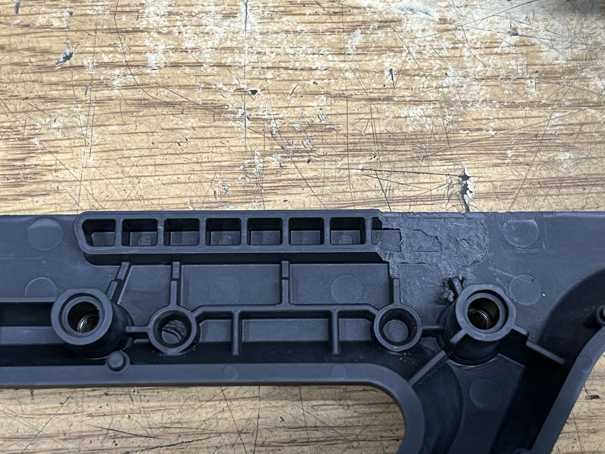

Next pics show areas on the outer stock halves that need to be removed to allow the sliding part to move further back...
Hope this helps.
