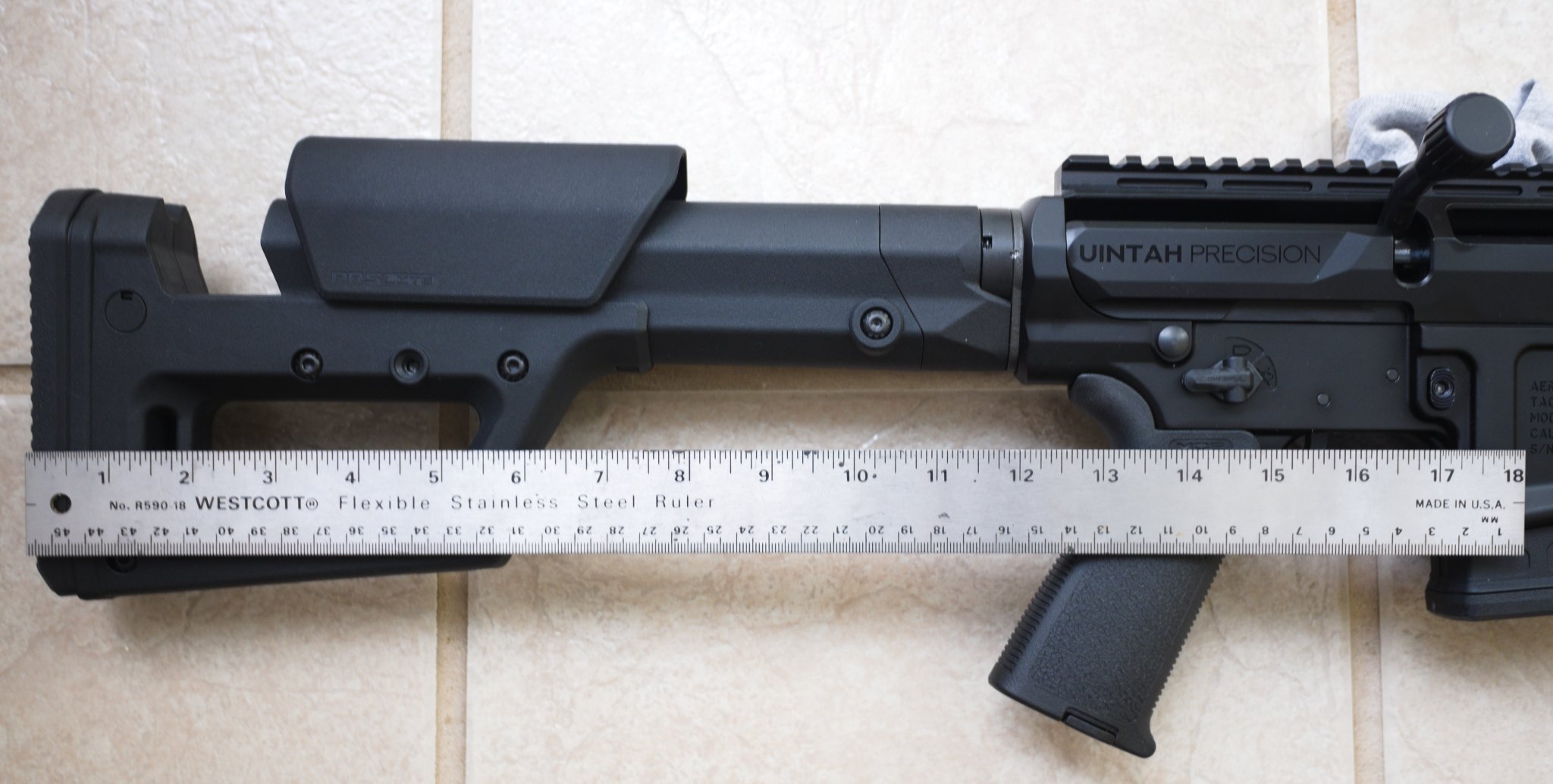

With the PRS Lite fully extended, the distance between the edge of the recoil pad to the trigger is 15.75-ish inches on my AR308. Kind of hard to see in the photo, since I'm leaning to take the picture and not directly over the ruler and the stock.View attachment 7773256
Thanks. That's what I needed to know. the Magpul PRS Gen 3 stock L.O.P. on my Ruger Precision Rifle was 15-1/8" at the shortest setting and 16-9/16" at the longest setting when I first installed it. I had to cut 2" off the front of the stock and 1-1/2" off the back of the receiver extension to get it in the usable range for me.

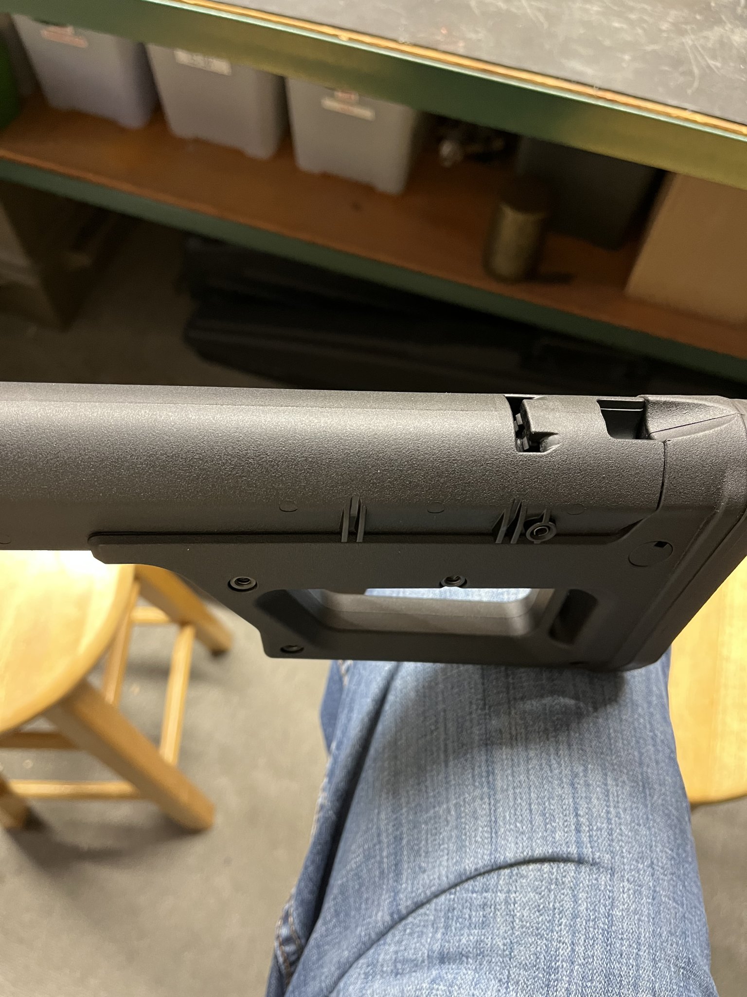

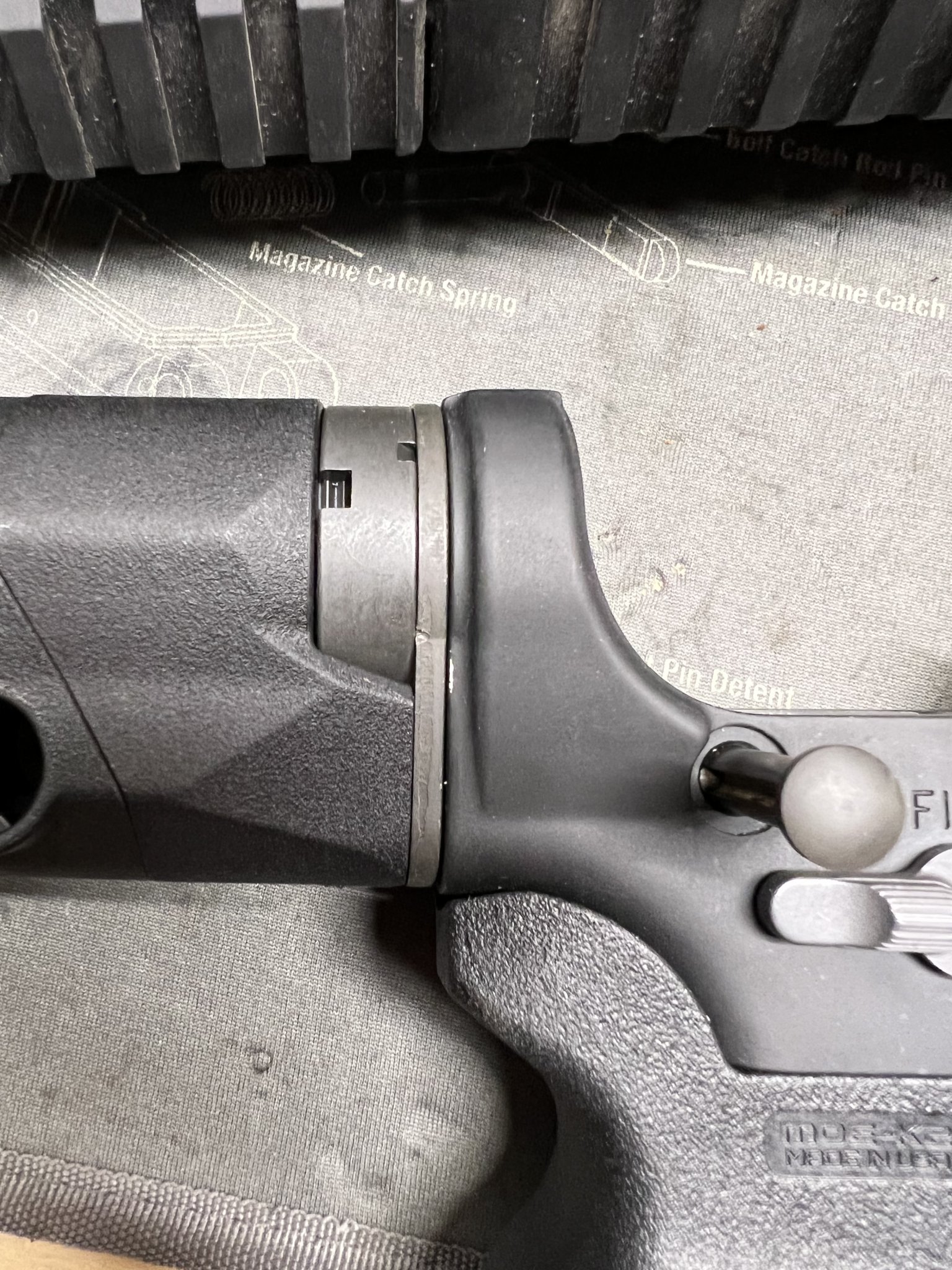

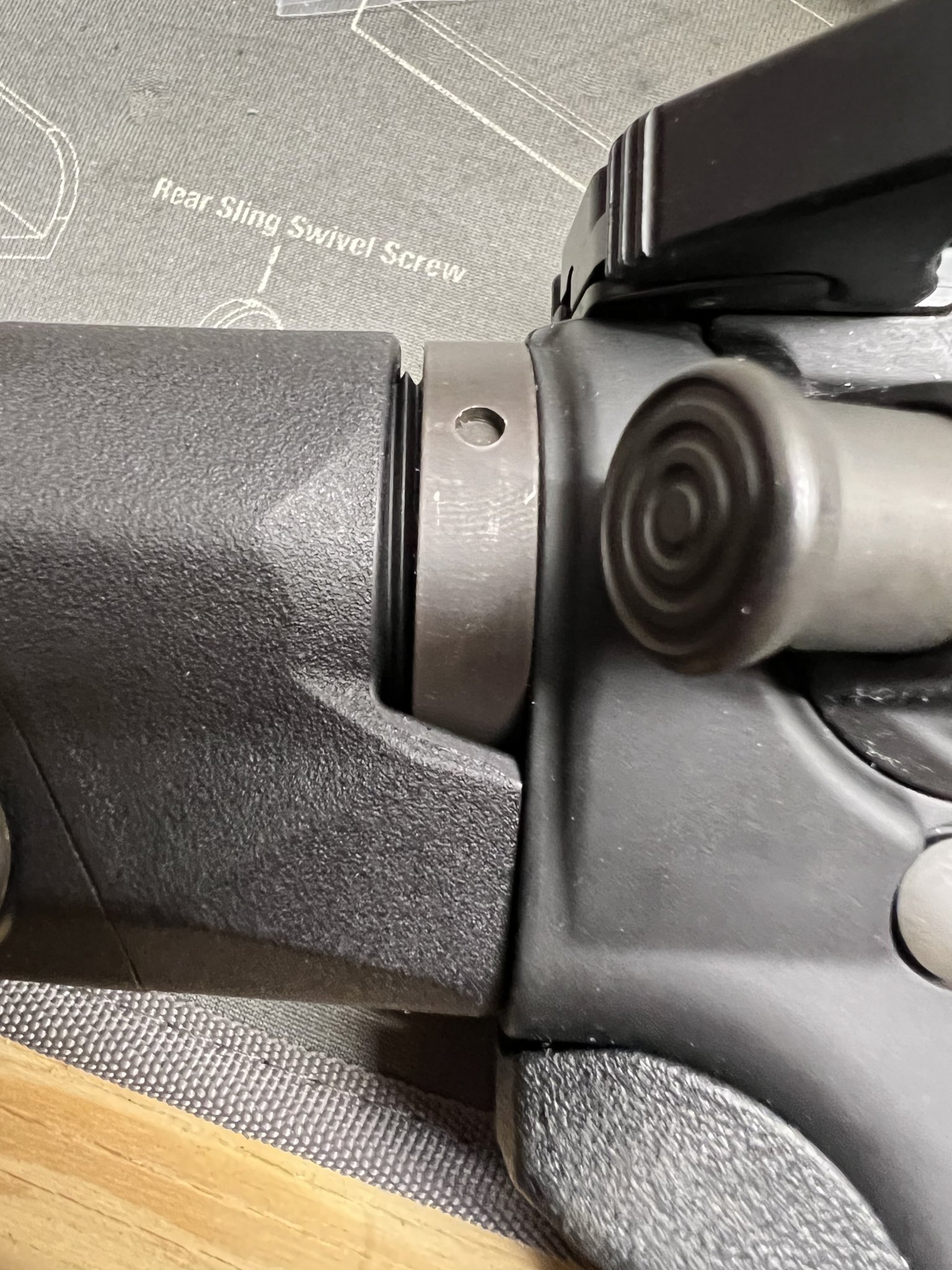

took a few pics in case it helps anyone here. One thing to note for KAC owners, sorry if its been covered already. Due to the KAC hardware thickness if you go with the PRS Lite it will leave a gap and expose threads on the buffer tube. The pic (SR15) with no gap is taking the KAC hardware off and throwing on a base plate and mil-spec castle nut.
any questions let me know, hope this helps.

Gotcha. Reason I was asking, KAC sized that castle nut for their proprietary QD end plate (hence the spanner inteface instead of a GI castle nut interface), it works out to the same thickness as a GI nut and plate more or less (~0.535"). If you run that setup, the quick math is to bob a PRS3 or PRS Lite front cap back so its flush, then it will fit the factory KAC setup with their QD plate.
Obviously, there are a lot of different end plates and a few different castle nuts out there and they're different enough you can't comp for them all. The keyway on the receiver extension is what keeps it from rotating, and the cross bolt keeps it from sliding back so mechanically it won't hurt anything to trim up the front if you need to.
Gotcha. Reason I was asking, KAC sized that castle nut for their proprietary QD end plate (hence the spanner inteface instead of a GI castle nut interface), it works out to the same thickness as a GI nut and plate more or less. If you run that setup, the quick math is to bob a PRS3 or PRS Lite front cap back so its flush, then it will fit the factory KAC setup with their QD plate.

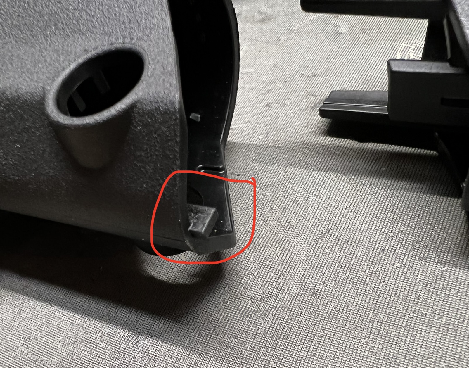

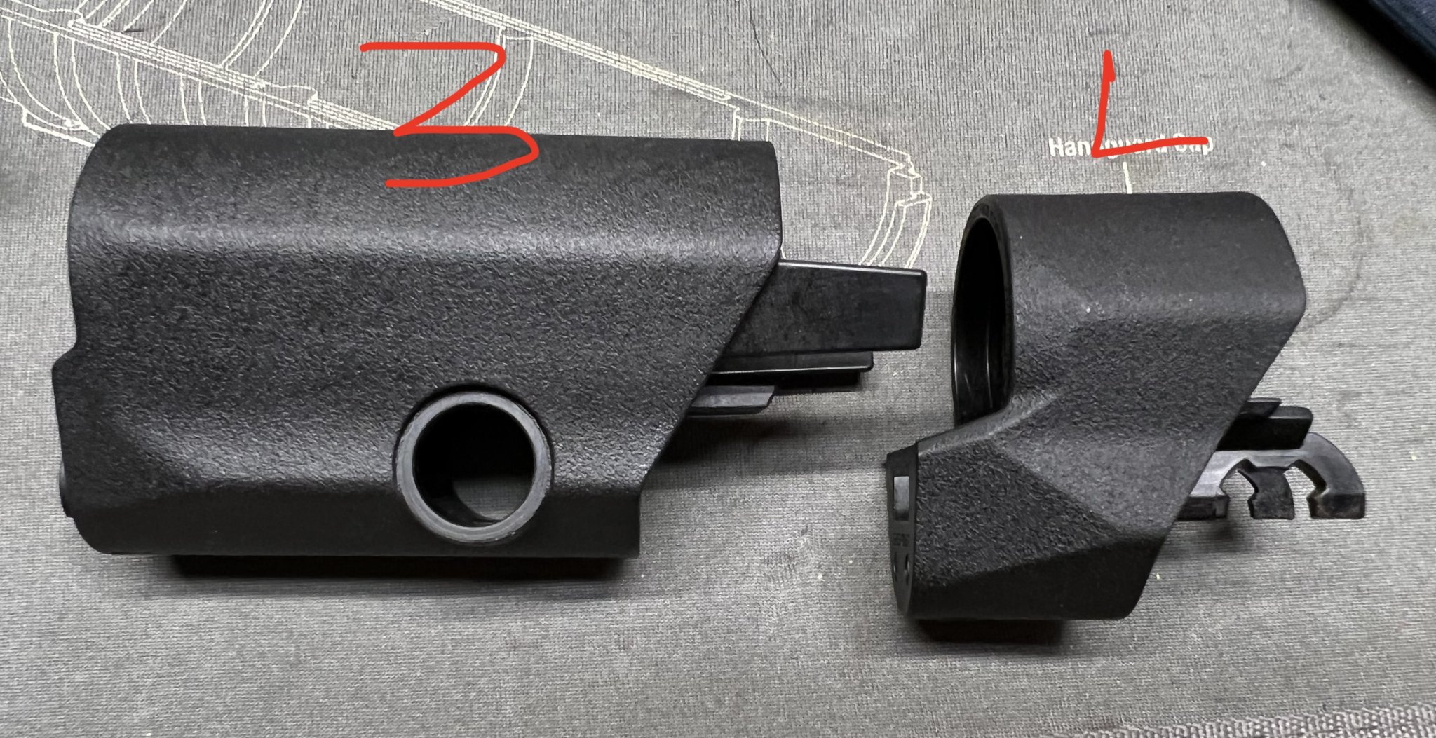

that makes sense, this SR came with the QD endplate which is much thicker, almost flush to the castle nut. I have spare prs 3 parts but can’t get them to work with the prs lite. May be messing something up but there is a tab on the front of the lite that doesn’t allow the prs 3 adapter to fit. The prs adapter (3) also seems to attach different and be a little wider than the Lite(L).

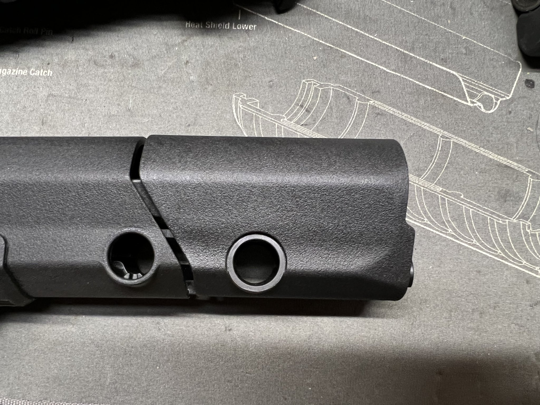

Good question. Here’s what it looks like.
I would say it is useable without the cheek piece…unless you have dangling ear rings. 😆

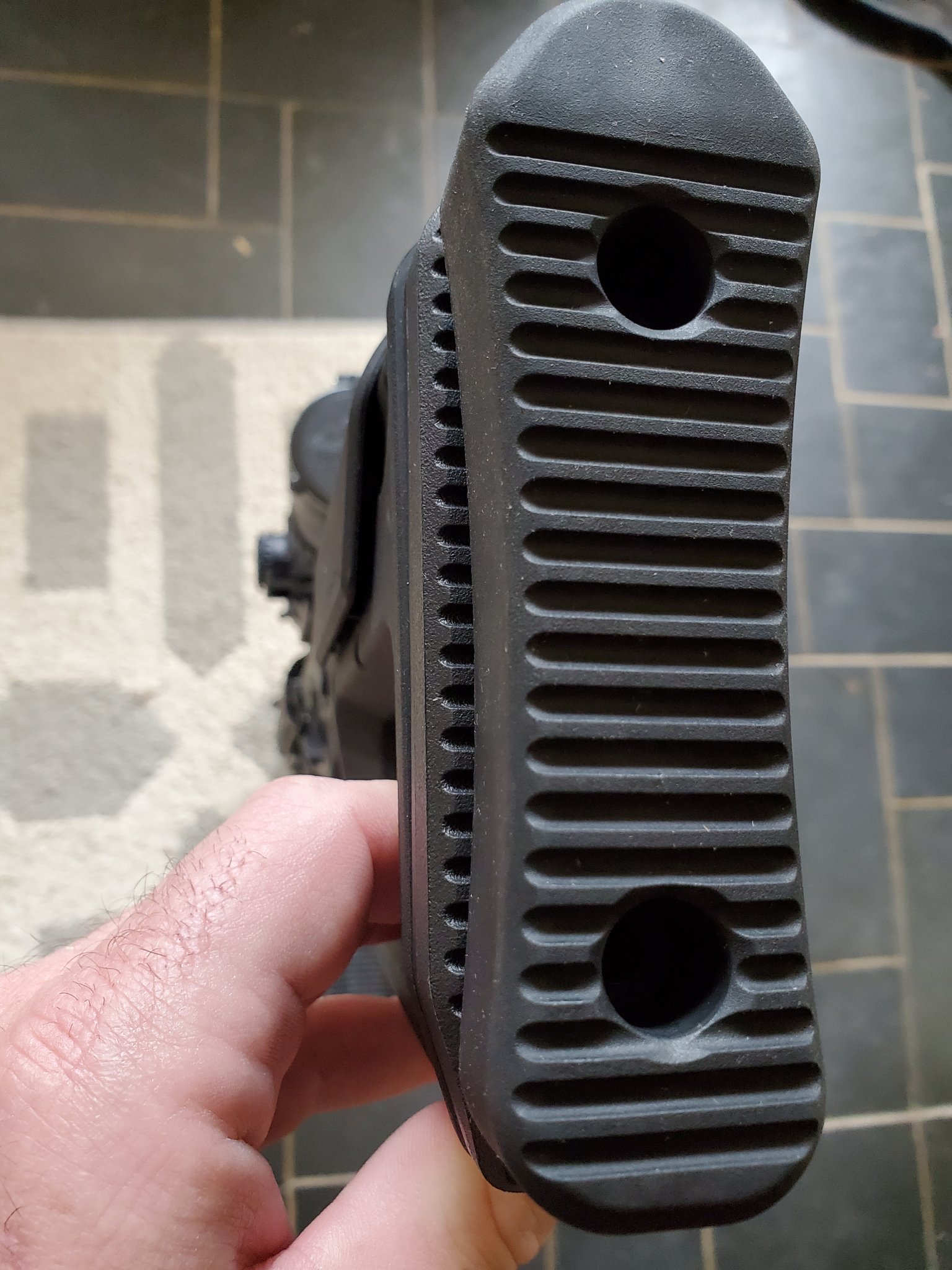

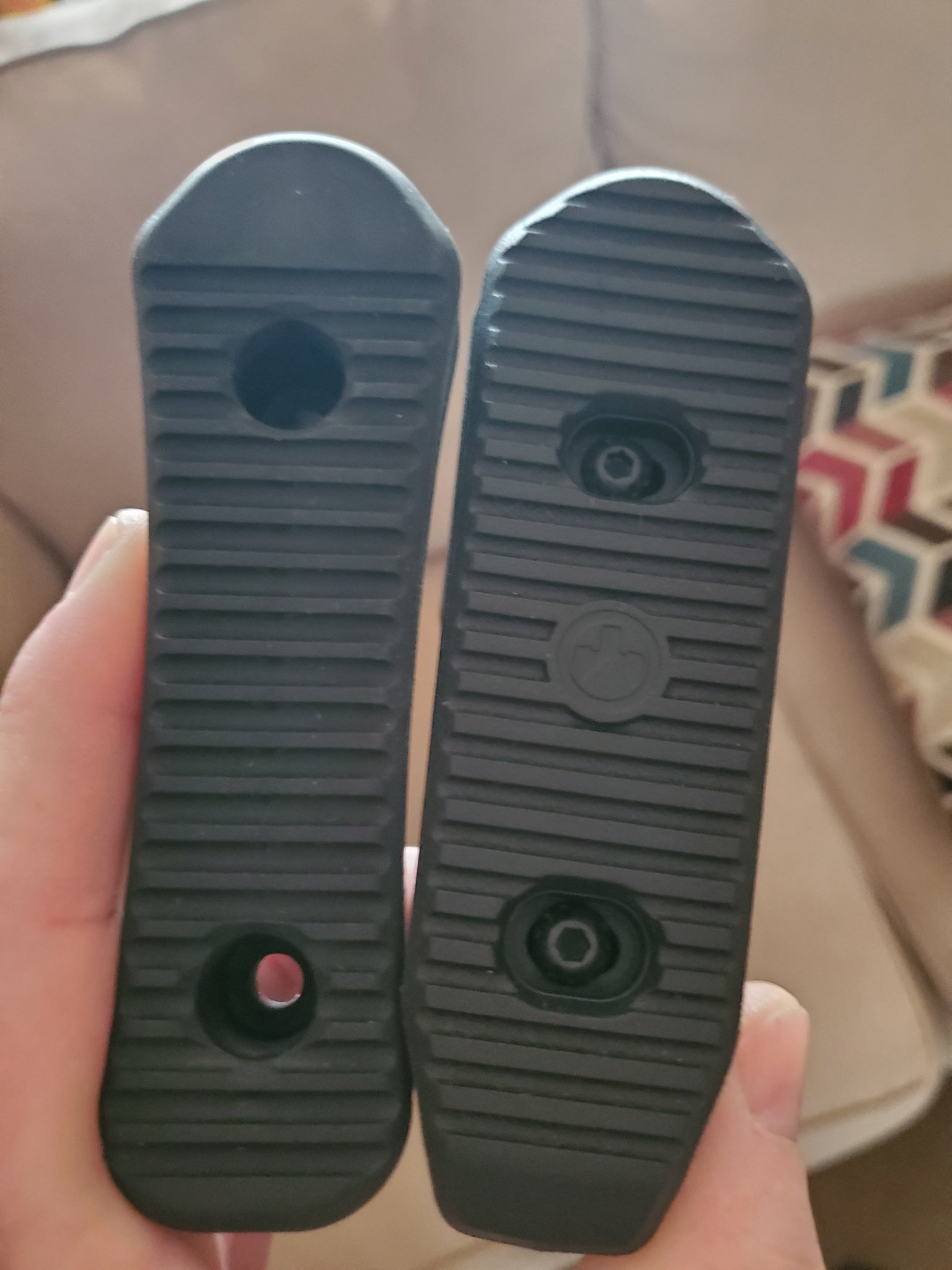

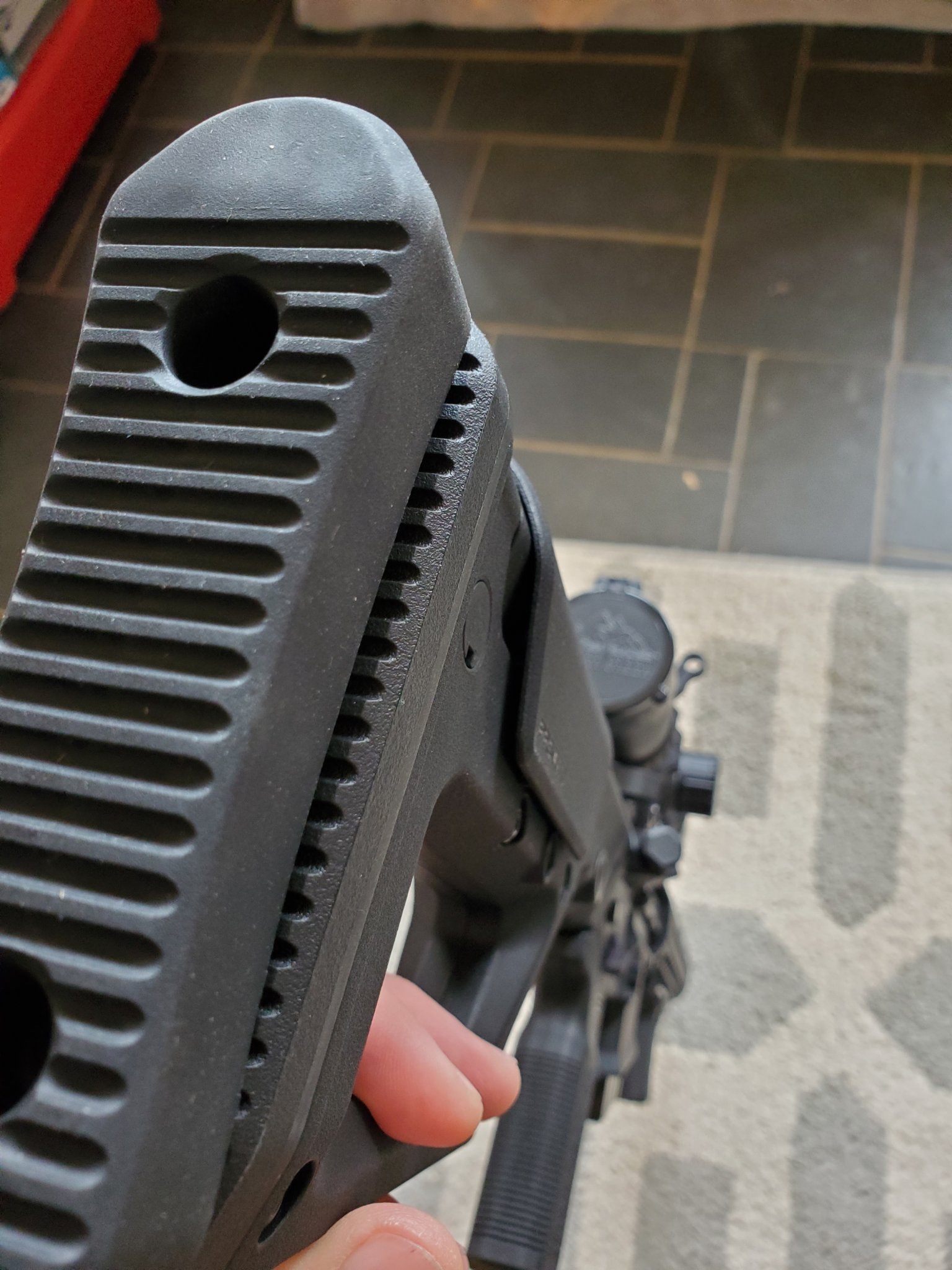

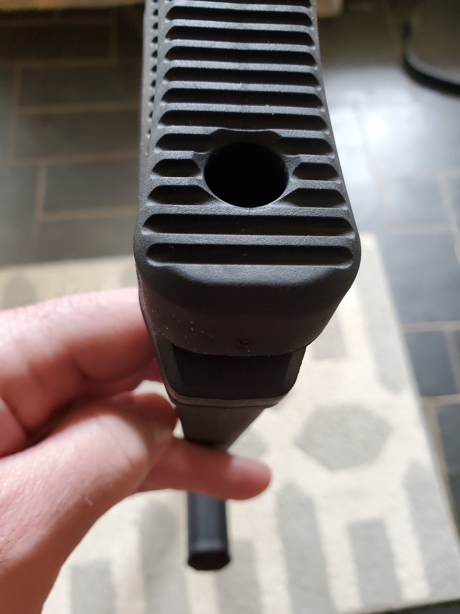

You can attach the gen3 pad to the lite stock. But the two are different in size. The lite pad is wider and I believe the height is slightly off as well. I will snap a pic later so you can see what I'm talking about.
Gen3 pad laid on top of the lite pad. The lite pad is wider and a little taller.
