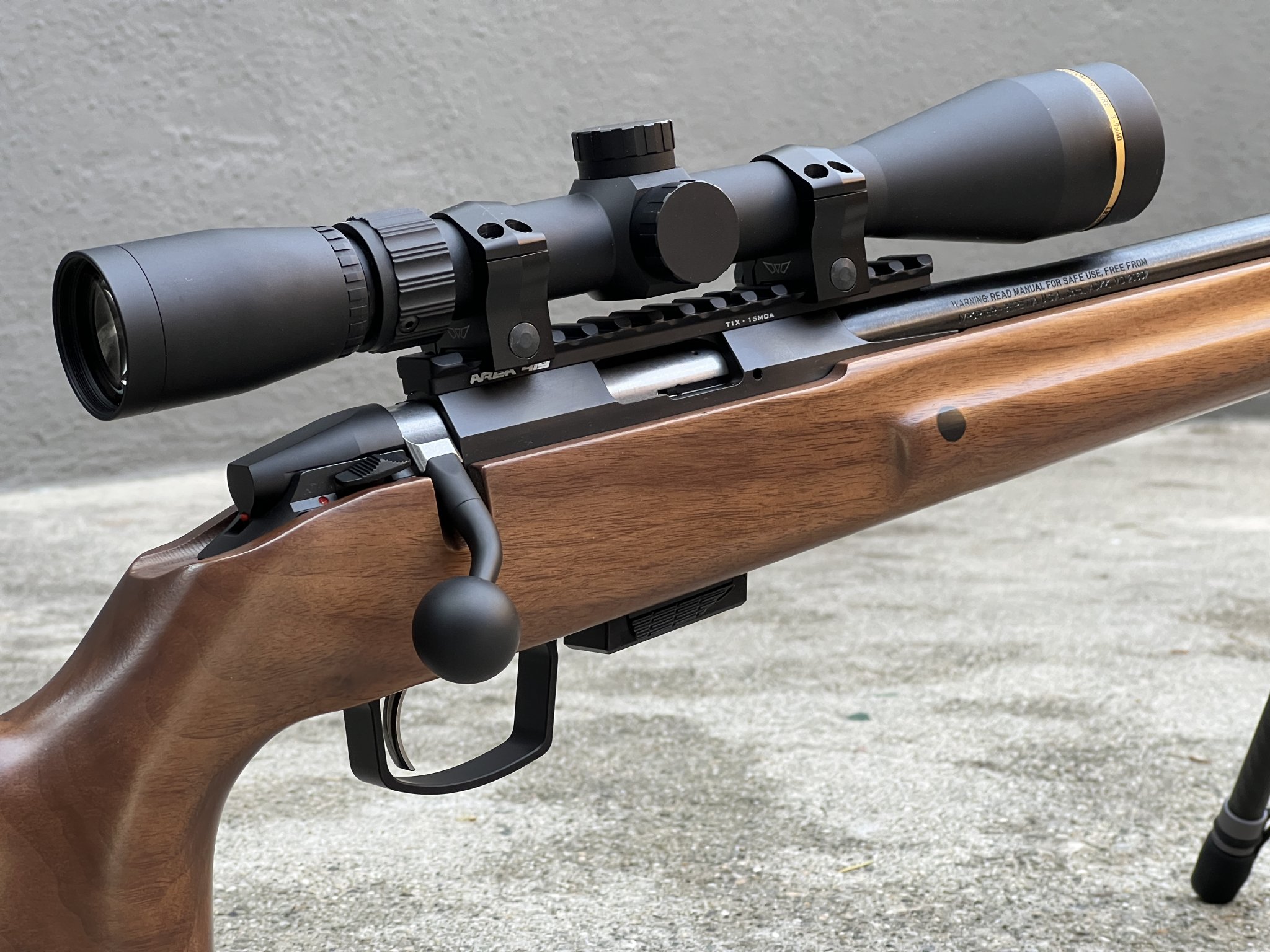

anyone know if there are any arca rails that mount to the factory stock preferably with (but w/o is okay too) a beavertail forend that dont require any additional holes to be drilled?
I know mountain tactical has the 9" one that should work okay, im wondering if any of the longer 10 or 12" Area 419 ones will install without any more holes needing to be drilled.
The Area 419 weighted rail will mount without any additional holes being drilled. It is 14.25 inches long so it will stick out past the end of the forend a few inches. It attaches easiest directly onto the factory stock without the beavertail forend, although you will have to find an extra rear action screw (the longer one) as the front action screw will now be too short). A couple small washers or a spacer then is needed to get the action screw to the proper depth. Then the front of the rail will attach using the sling stud mounting hole and one of the small bolts that comes with the rail.
@Buckhead Thank you for the reply. Do you use the middle screw in the stock at all? The one between the action screw and the sling stud.
Bore guide suggestions,seems like everything is out of stock?
I got one here:
I didn't use the middle screw at all. One would have to drill a hole in the ARCA rail and I didn't want to do that.
It seems to be solid like it is. I have the action screw torqued to 30 in/lbs and the sling stud screw at 20 in/lbs.
okay thanks for all the info. so you just take a regular length rear action/receiver bolt and used some washers? any specific washers or spacer height i should go for?
One needs to space it out far enough that it doesn't bottom out in the action but not so far that the head of the bolt sticks past the surface of the ARCA rail, then it will interfere with sliding the barricade stop on and off. Sorry, I don't take measurements for small projects like this, I just modify as I go and when it fits, it fits. I just pulled it apart and got the measurements. I just used a small piece of some stainless tubing I had kicking around, .382 OD and .295 ID. .179 thickness.

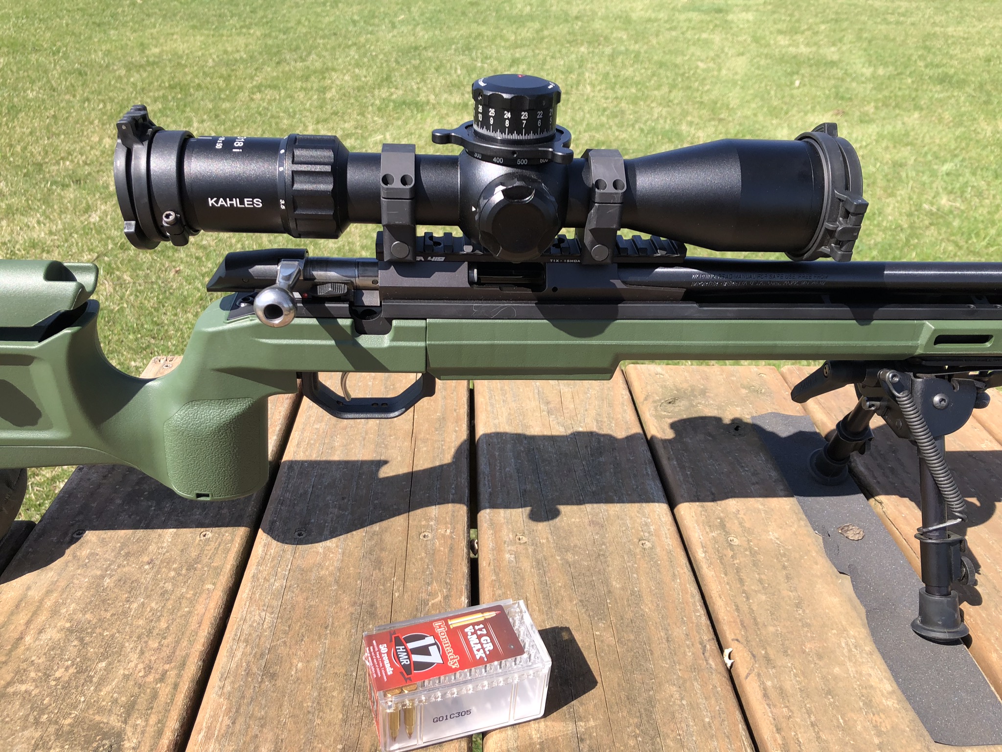

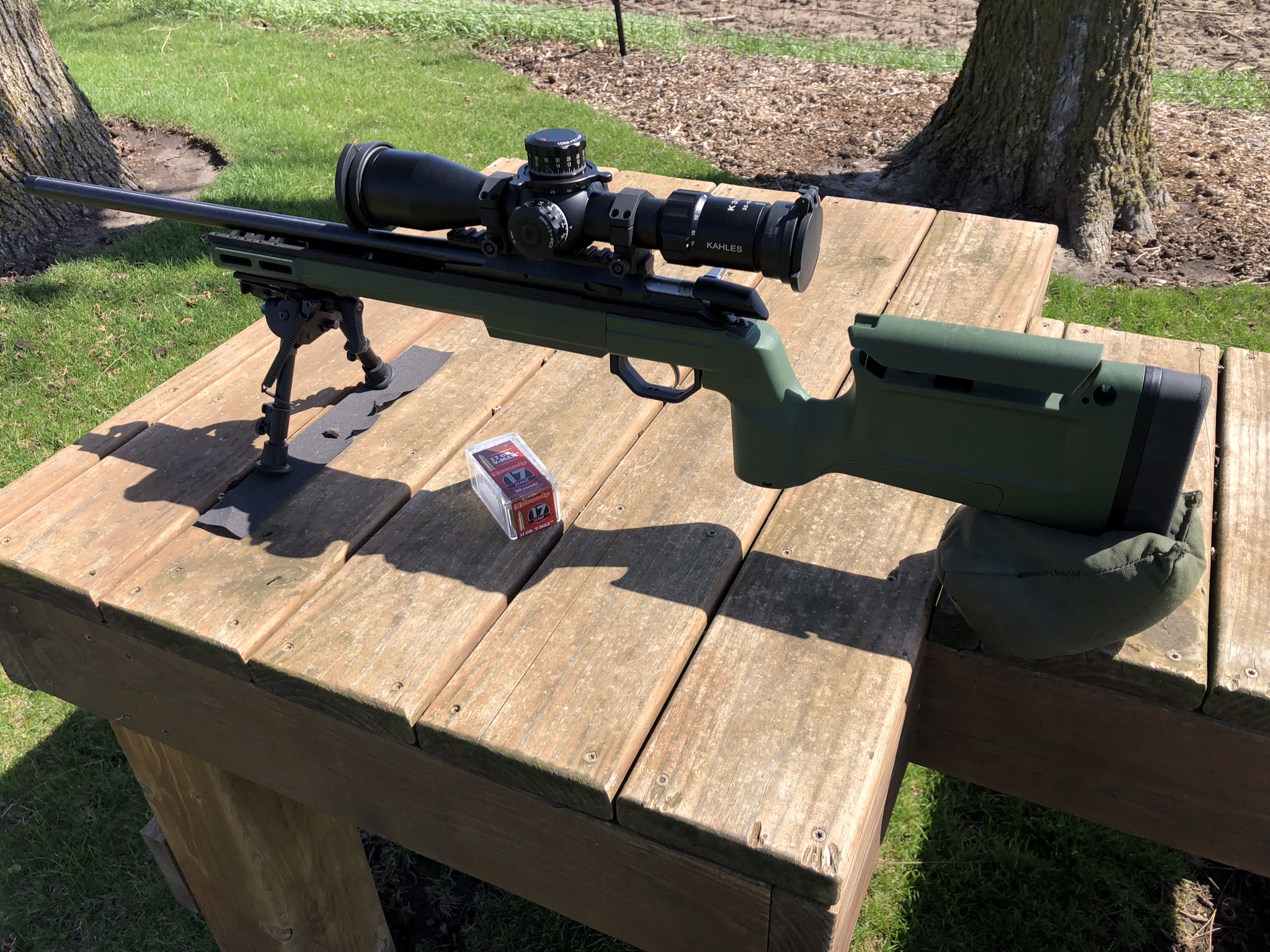

T1x purchased in August 2021. Threw a spare USO 5-25x58 on it to get going. Came across a gently used Kahles 318i here on the Hide. Seemed more fitting for an inside 200 critter getter. Mounted this afternoon with a rough 100 yard zero that I’ll fine tune when the wind backs off (was 30+ today).

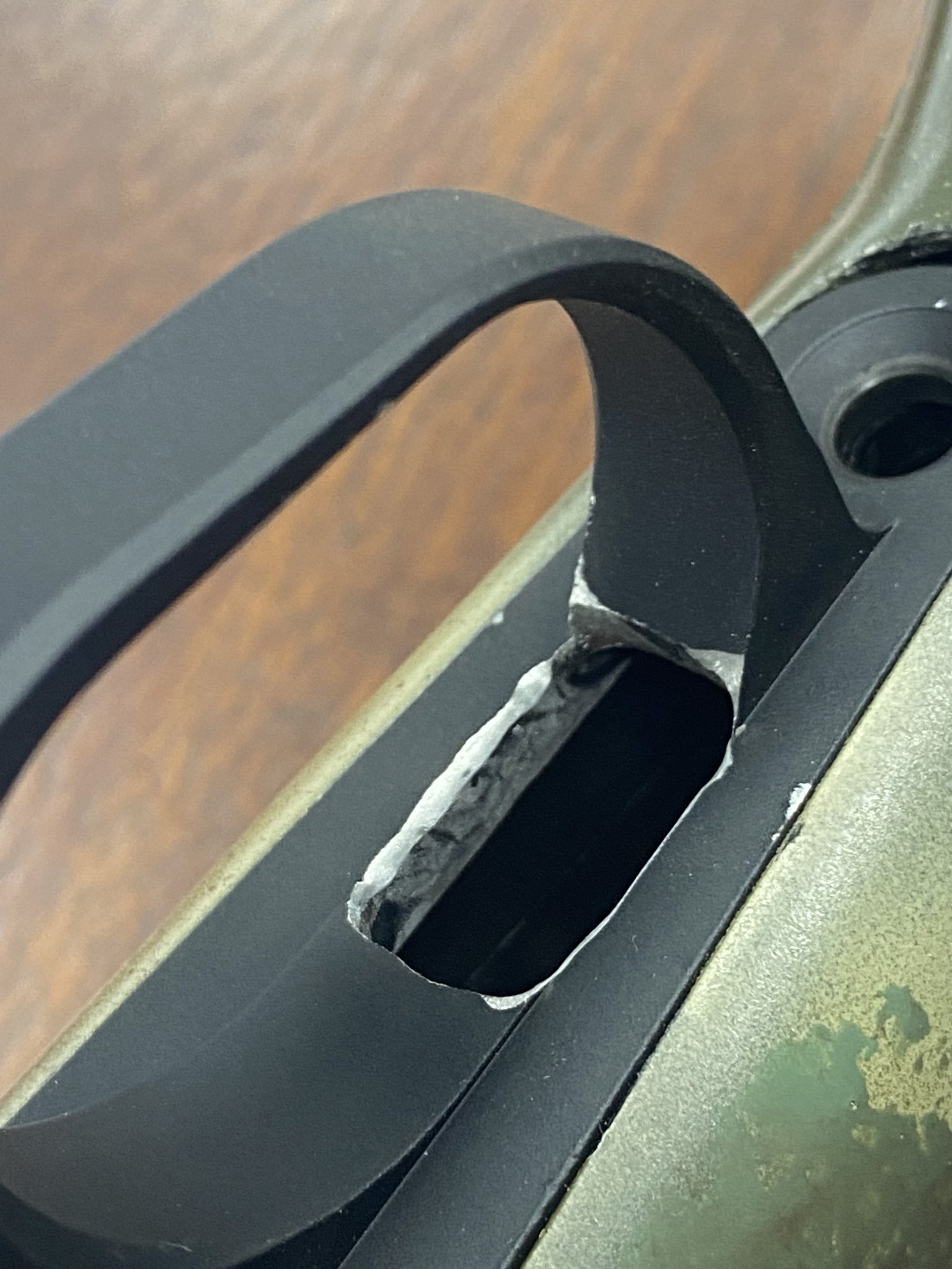

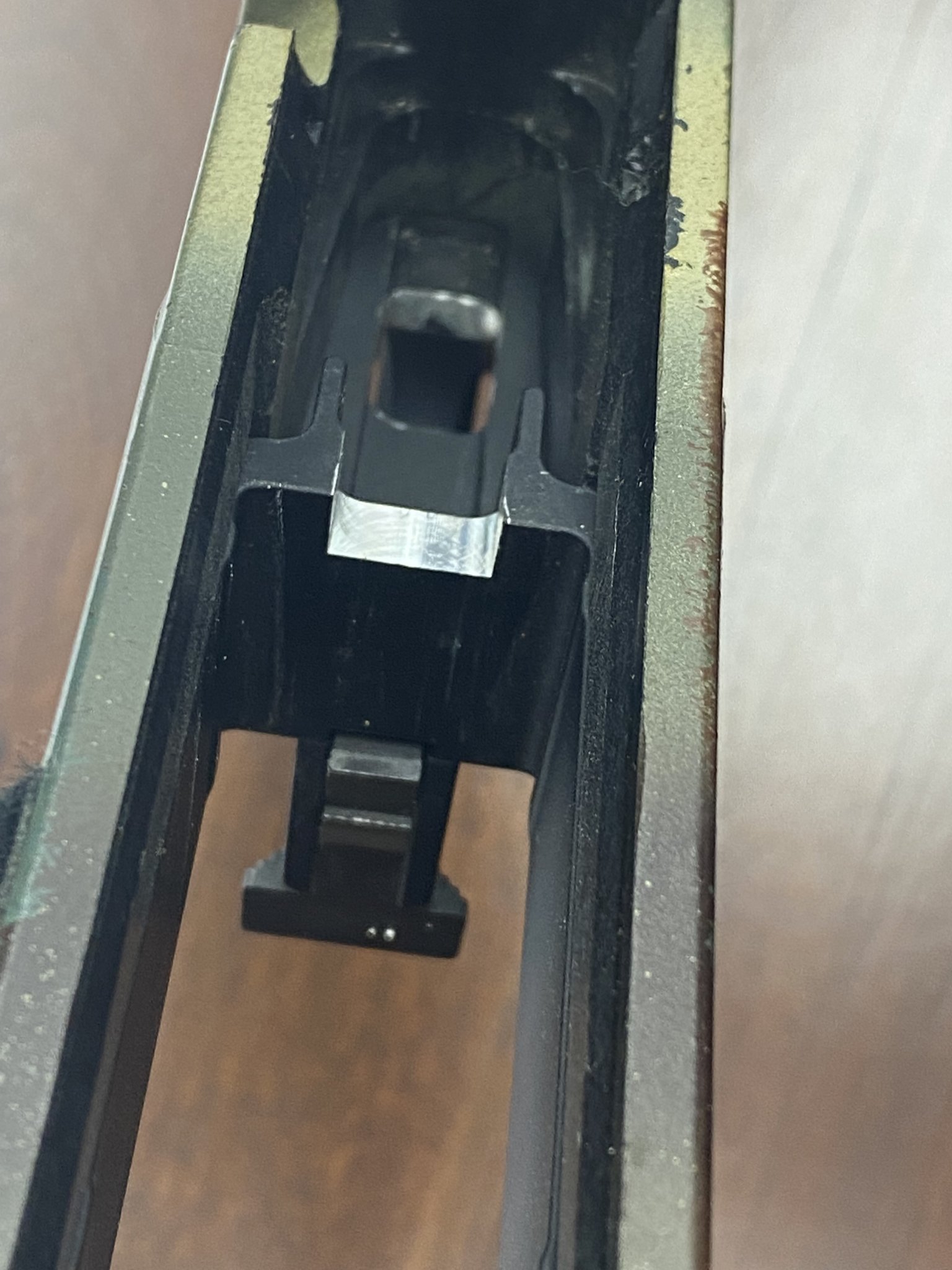

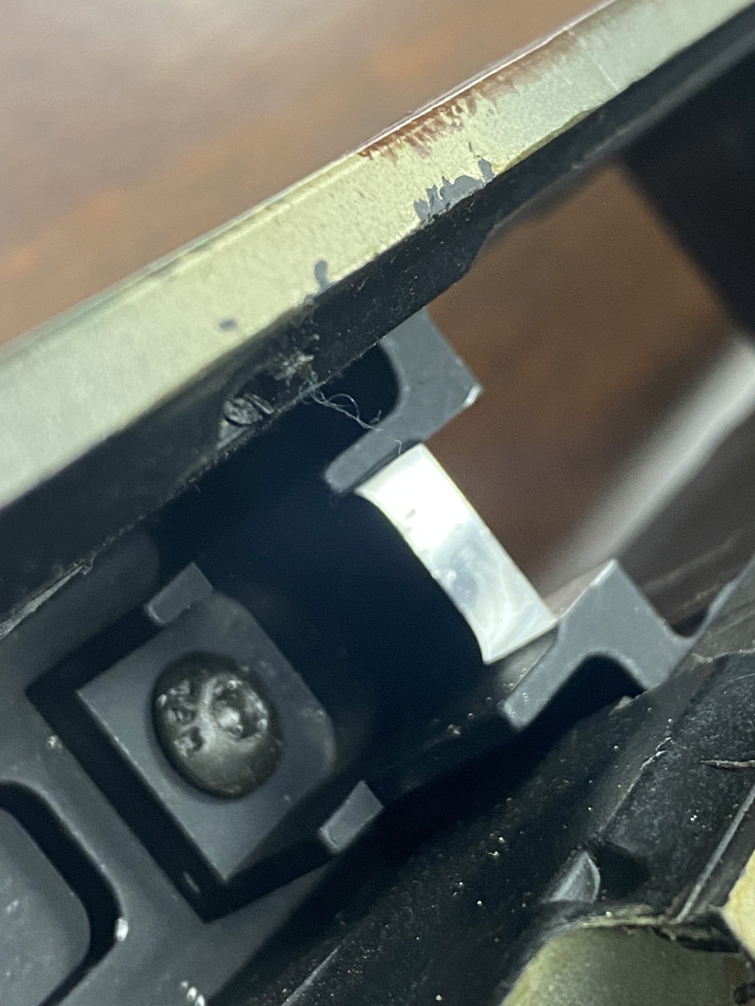

I finally got around to modifying my T3 KRG Bravo to suit the T1x.
Pictures should explain it, but it involved a short head cap screw for the magazine well, drilling/counterboring 2x holes in the top of the Chassis to suit M3 screws (will probably change them to hex drive pan head - zinc philips were all I had on hand).
Drill and Tap M3 into the trigger guard due to the existing screw no longer being used.
Remove/Drill/Mill/File material to allow for Plastic Tab on Magazine and Cap screw.
I've checked it all assembled and can still use the T1x magazine with the AICS mag lever in place. The bottom rear of the magazine presses against it, but it means I can swap a T3/T3x and T1x in the one stock. I did make the Thru-holes a little bigger so the 2x M3 screws can slide a little back and forth to get the right tension when using AICS magazines still (original screw did the same).
Next up will be a Sterk handle and shroud ;)
View attachment 7083527View attachment 7083529View attachment 7083530View attachment 7083531

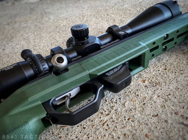

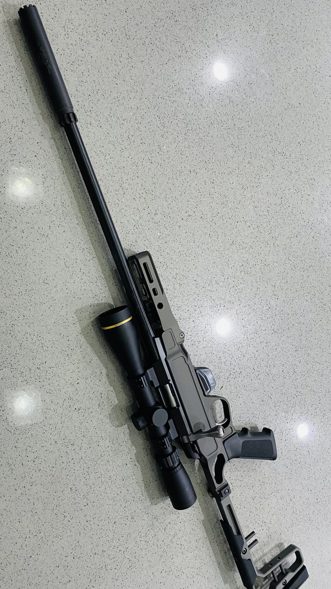

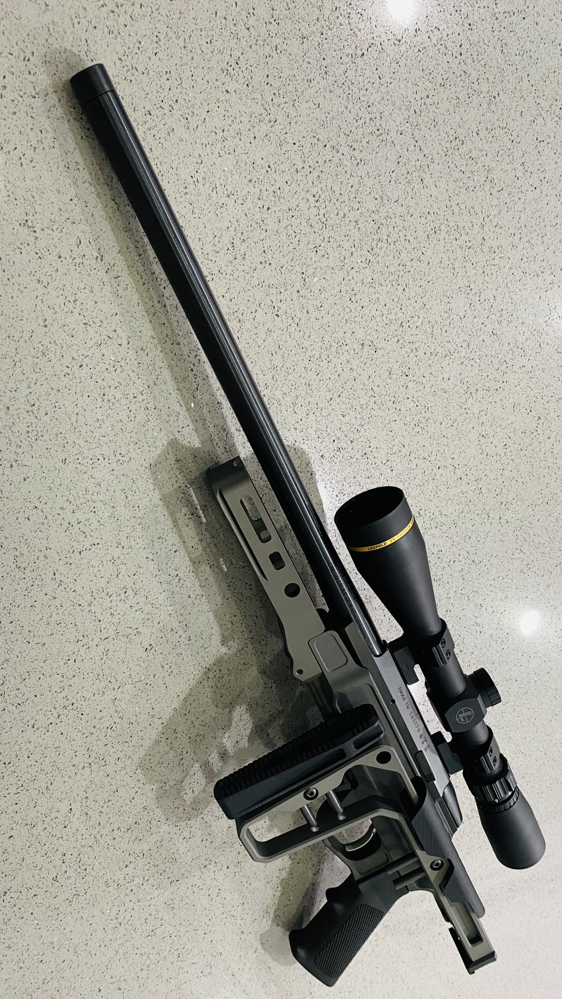

New chassis option from Grey Birch. Got mine this week, range trip soon.
