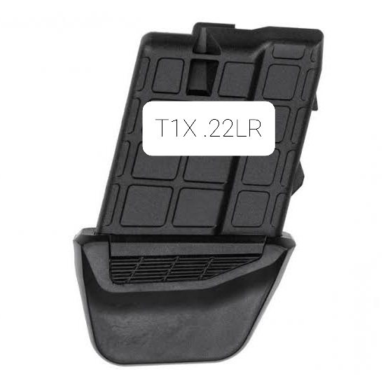

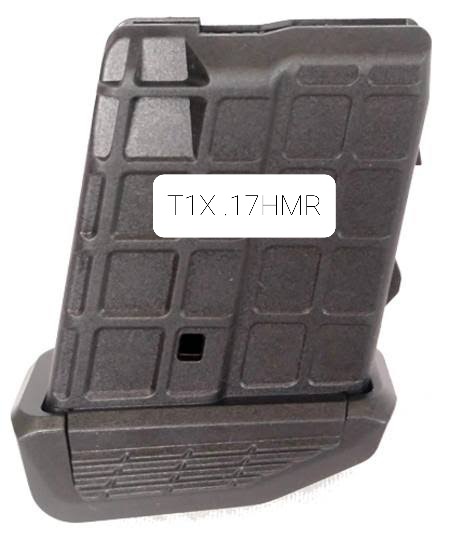

BUYER BEWARE...T1X magazine from Euro Optics... I ordered a magazine from Euro Optics a few days ago based on the talk about new shorter base magazines available. The picture on Euro Optics website shows the shorter mag and I was assured it was as pictured but I received the mag today and it is the same old shark fin style. Doesn't sound like Euro Optics is going to do anything for me, other than charge me $15 to return it. I will update when I get this all settled with them.
havent heard of a 'shorter base' new magazine for tikka, went on the t1x mtr page and their photo does seem like the mag sits more flush, but the beretta accessories page only shows 1 t1x 22 mag for sale as well.
Got a product link for the newer one or anything like that? Im curious now.

I looked for a product description to verify but found nothing concrete, so I called and was told the mag would be the same as pictured. I did my best to verify what I was ordering. I have a 22lr and 17hmr so I know the difference. EVERY picture you see now of T1X 22lr shows a shorter mag. I thought, with all the complaints about the shark fin mag, that maybe Tikka had made a change in mag design. Seems a change would be easy enough. I am sure that I am not the only one that would like a shorter base mag.

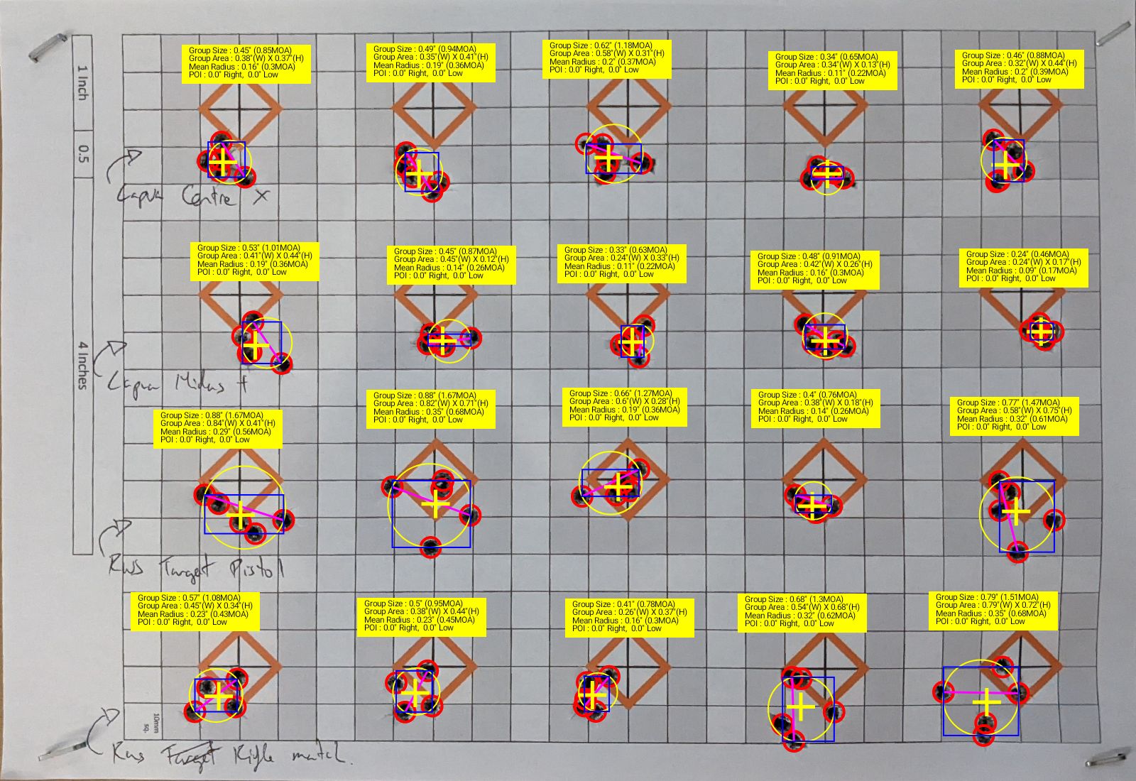

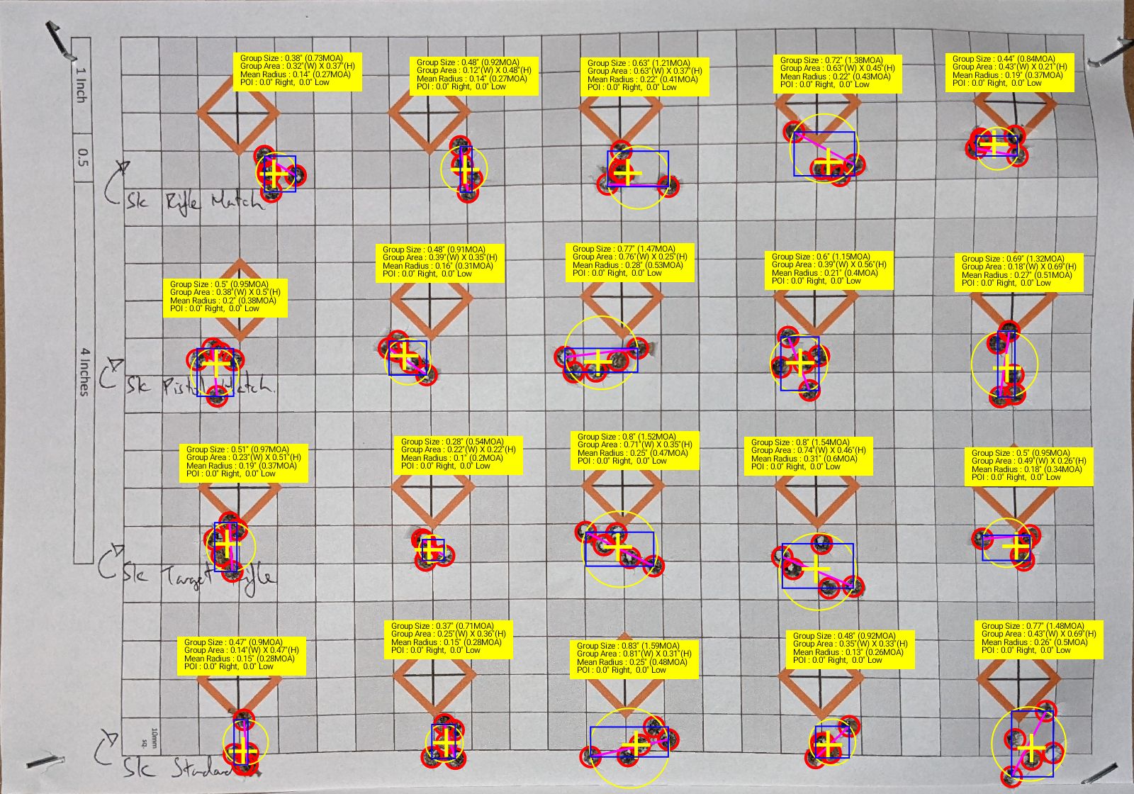

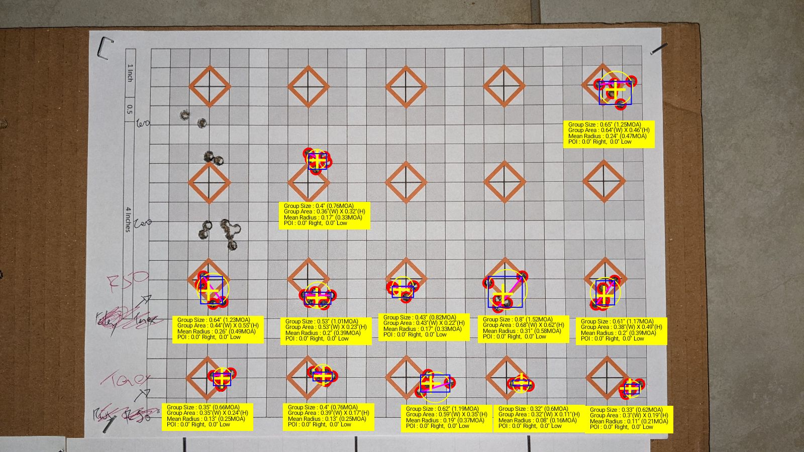

CCI SV works well in Mine for Mid Priced ammo.
The SK Rifle March and Long Range Match ammo is more accurate in my gun at a significantly higher cost and limited availability.

Oddly enough, my T1X doesn't seem to like CCI SV all that much. CCI sub-sonic hollow points work quite well.
My T1X dropped right in to my ACC. CCISV did as well as SKRM in the factory barrel. Average 1.76” 10 rnd groups at 100 over 44 groups. With an IBI 12T the SK stepped ahead to 1 1/4” groups or so. YoDave trigger spring, and it’s done.
Reactions: 260284
I don't have a T1X, but CCI-SV out of several rifles was as good or better than SKRM. Get some of each and see what works for you.
My T1x seems to shoot CCI SV quite well for low end ammo. It does better (usually, but not always) with better ammo. Have had great results with almost everything that I've tried. Center-X, Tenex, Wolf MT, SK Std+ all produce respectable groups. I'm finding that the biggest variable to getting great shot groups is the shooter, not the rifle or the ammo. Since I always shoot suppressed in my back yard, I haven't tried any HV stuff in it, but will try some mini-mags and Fed AM the next time I go to an outdoor range. This last month has been too cold to do much shooting. I'm old enough that I ain't shooting if I ain't comfortable.

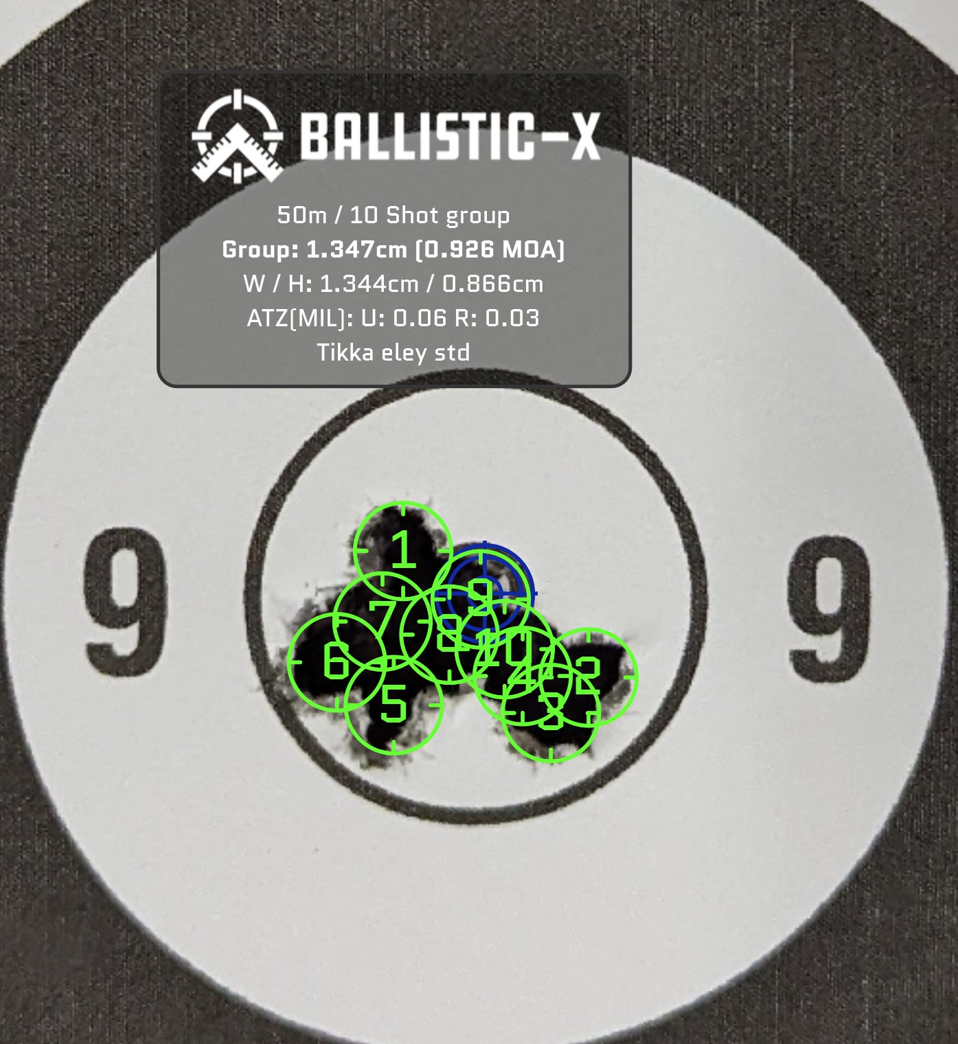

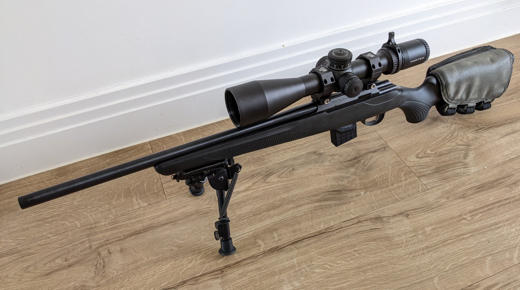

Hi from across the pond,
New to the forum and Tikka, I've shot ISSF style stuff for many years, stop a few years ago but recently started doing nrl22. Really enjoyed it and so wanted to get a rifle specifically for it. Initially wanted to go for a Annie 1710 competition as I have always shot Anschutz but then decided to give Tikka a try after reading this thread and others on it.
So anyway, finally got it earlier this week:
So far only mounted a vortex strike eagle on March/Audere rings. I went straight dovetail as our club doesn't go beyond 100yds and I didn't want to stack tolerances. Also installed a yodave spring, trigger now breaks at 1.1lb with adjustment screw fully out touching the big hex bolt. Not quite the 3oz trigger on my Annie single shot but probably appropriate for positional shooting.
Still waiting for my ACC chassis and Sterk bolt handle to arrive.
Did anyone notice any change in the rifle's ammo preference following a chassis swap?
Was thinking about whether to do some ammo testing before the chassis arrives.
