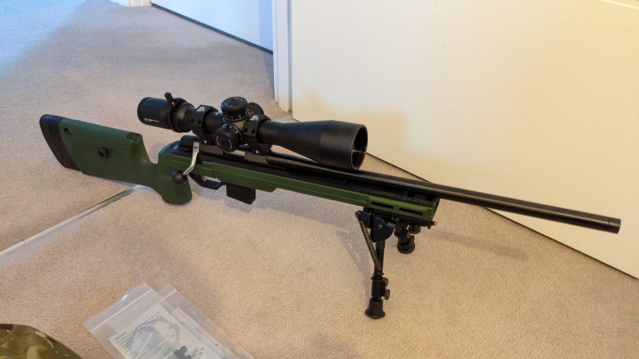

Anything that makes the factory mag base significantly bigger won’t work with the ACC because the ACC magwell is designed for a T3X and a bigger 22 magazine won’t fit.
Thanks I see, well that sucks... I assume this would be the same on both the early ACCs which are inletted for just the T3X and the later ones which are inletted for both T1/T3?
Good news is I just heard from my gun shop and the chassis is supposed to be with them next Tue!
Starting to think perhaps I should have tried the Bravo first! Or I might keep this for the incoming T3X and then just buy a additional bravo for the T1

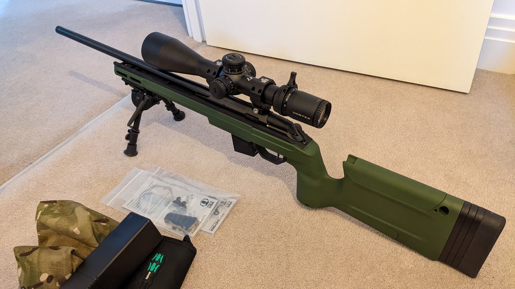

Also decided to buy a bravo chassis to try out which will hopefully arrive on Tuesday. If it works fine then j might save the ACC for a center fire later on.

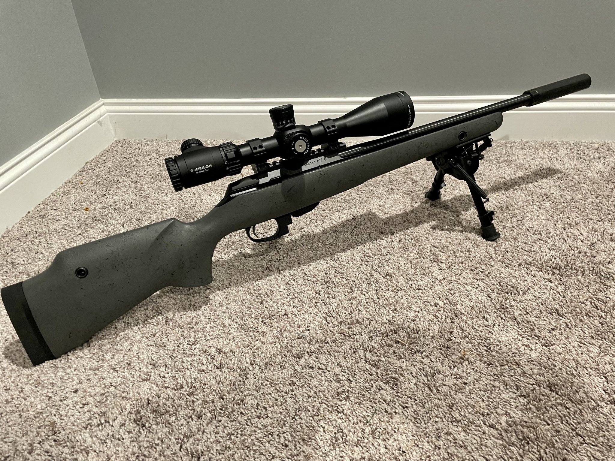

Hi guys. I’ve read through roughly first 50 pages of this thread so far, but have a question.
Picked up a T1X Left Hand 16” 17HMR.
I read about a couple accounts of broken firing pins…. I don’t plan to dry fire practice with this rifle, but what do you do when you put the bolt back in the rifle after assembly or cleaning? Leave it cocked with safety on? Squeeze the trigger and say F-it?
Appreciate the tips.
I’m putting this into a Grayboe Terrain stock (was originally on a T3x), with a Mountain Tactical 20MOA rail, Athlon Argos BTR Gen2 6-24x50 in Warne low rings and utilizing a Dead Air Mask.
I wouldn't close and dry fire personally. I just leave it cocked and store with bolt out.
If you are worried about leaving it cocked, you can actually twist the bolt to uncock. Just remember to twist it back the other way before you put it in next time. On some other rifles, they make these storage tubes you can insert the bolt and then uncock using the bolt handle. I think I have seen a 3D print model for the t1x bolt on Google before.

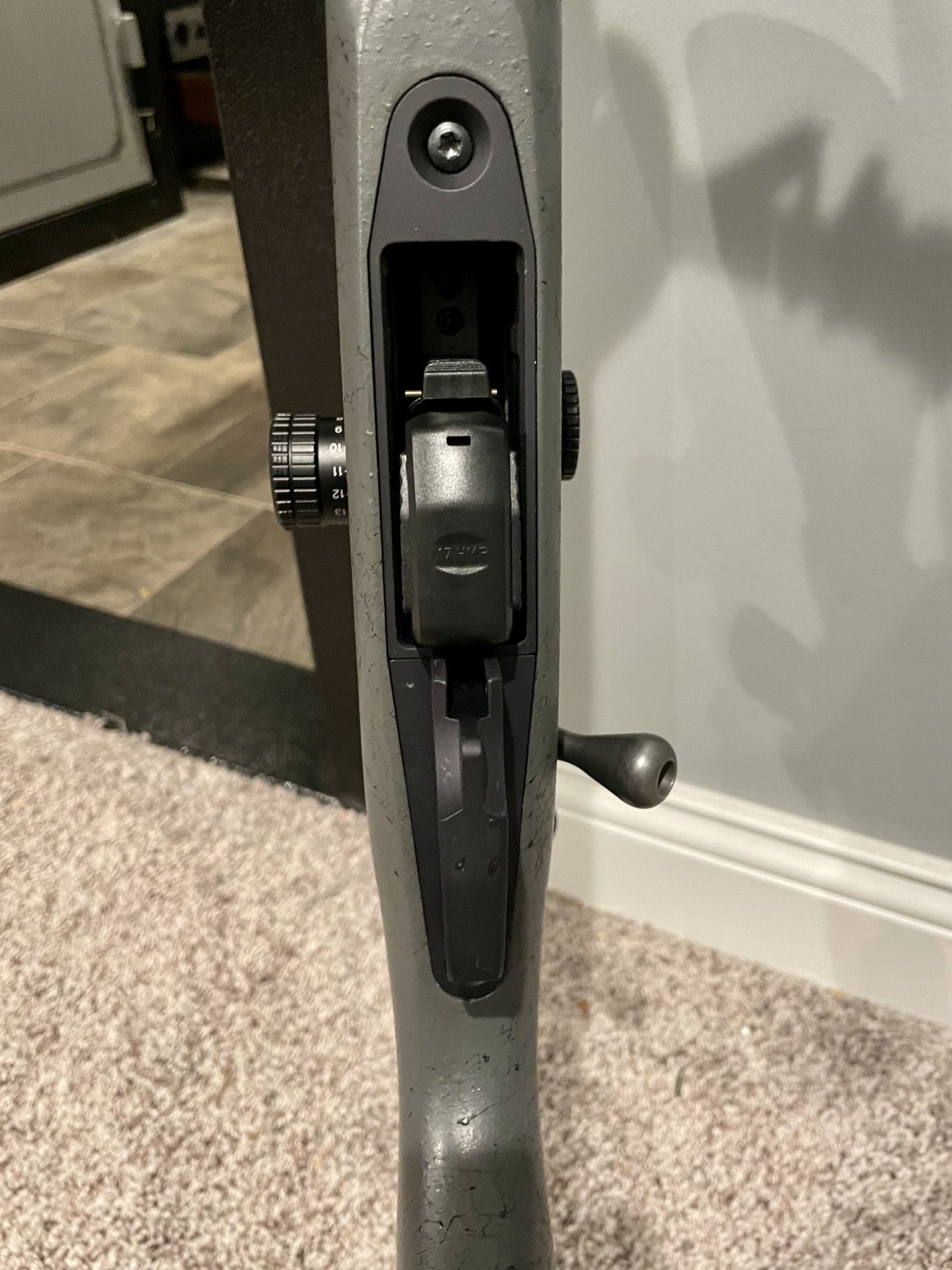

Ensure the chamber is empty.
Press and HOLD the trigger to the rear, then close the bolt and lower the handle.
This will un-cock the bolt/pin without firing it
