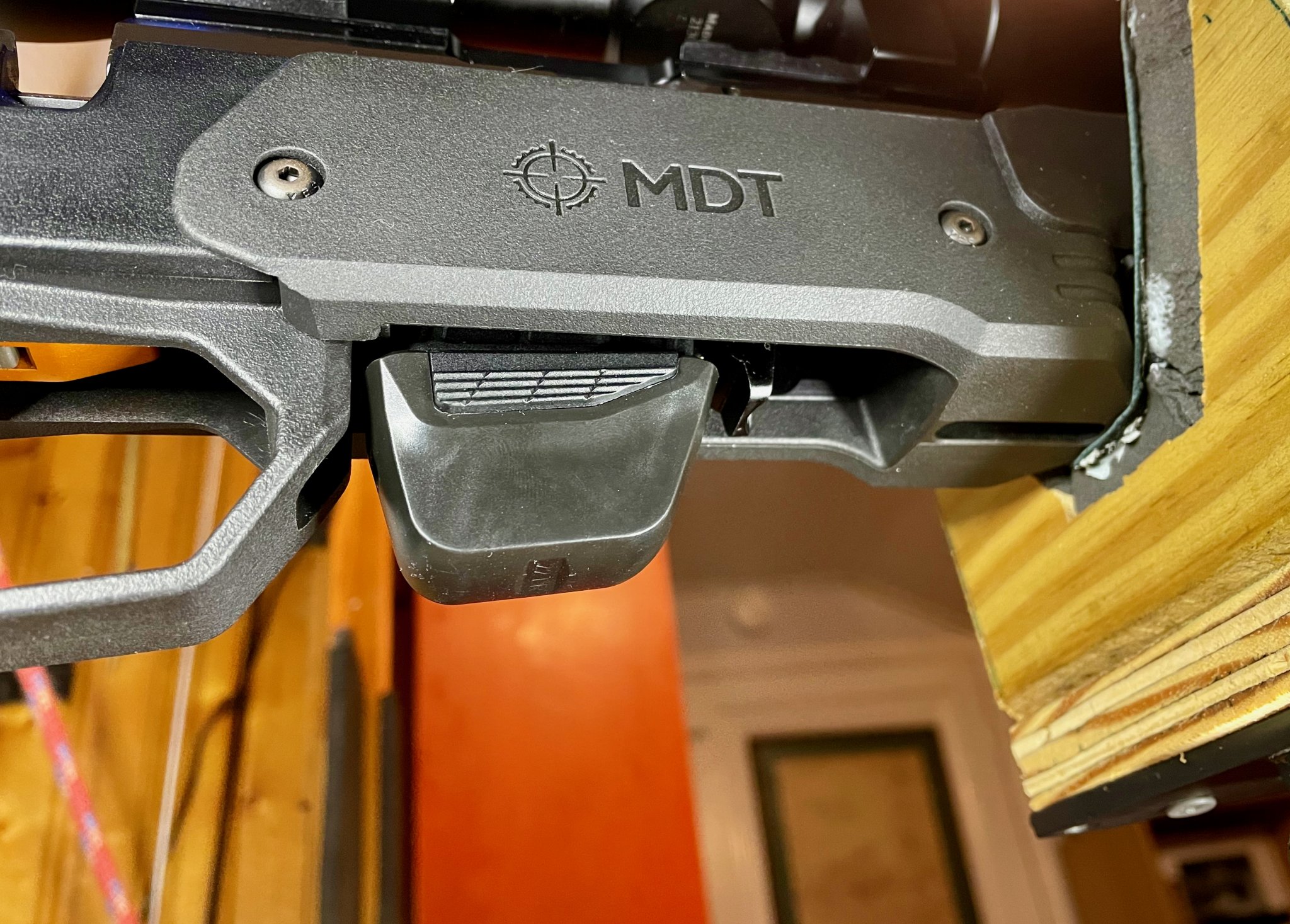

mdt xrs for the tikk1 t1x - does it still use the standard factory tikka magazines?

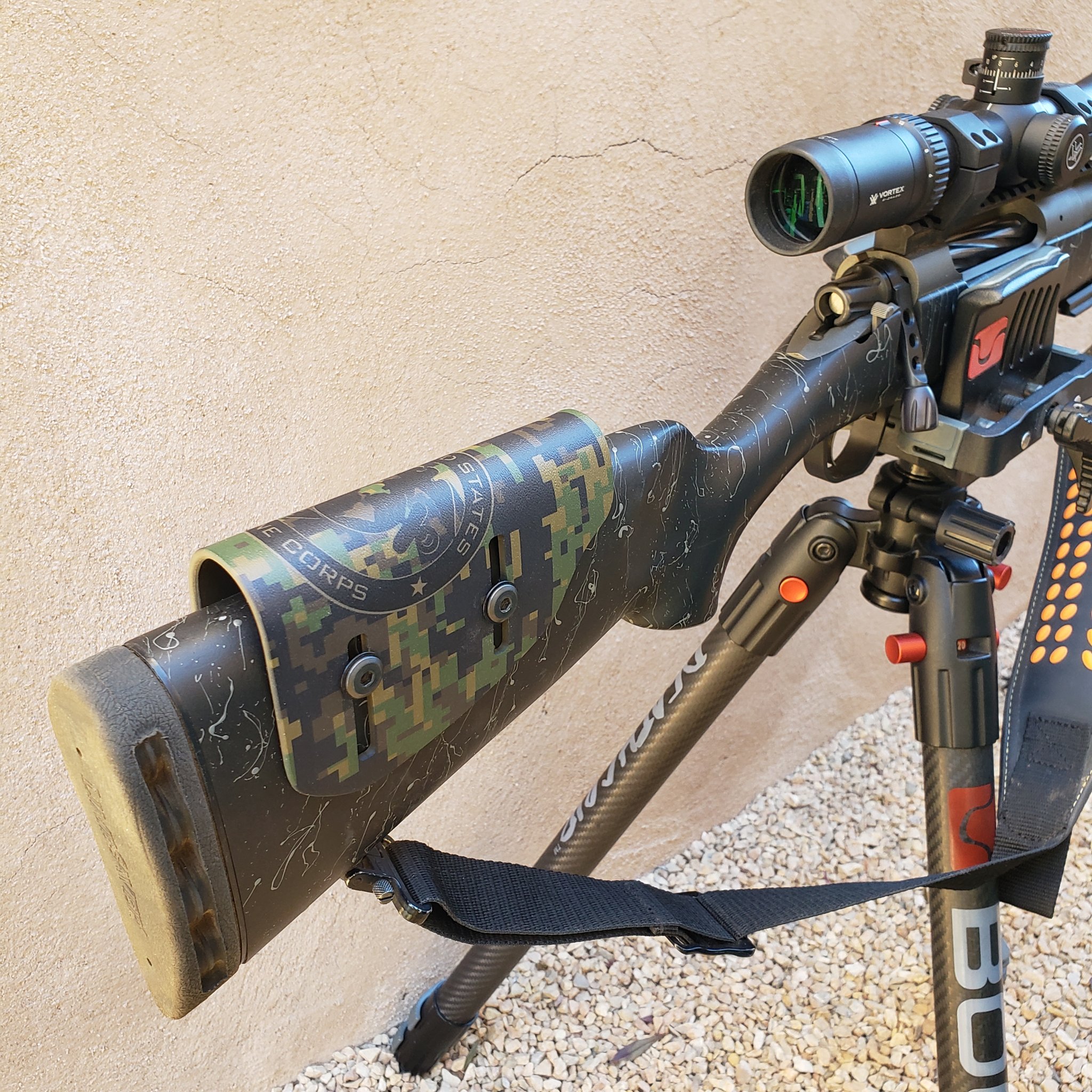

The T1x will also drop right into the Tikka CTR stock. I did this to both my 22lr and 17HMR for the advantage of the raised cheek rest. The bottom plate of the T1x is slightly narrower than the CTR bottom metal but will also bolt right in the CTR stock and uses same action screws. Bolt pattern and length of bottom plates are the same. I did transfer both the plastic horns from the T1x stocks to the CTR stocks. Same bolt pattern there also.
Here is my T1x 17HMR in factory Tikka CTR stock.

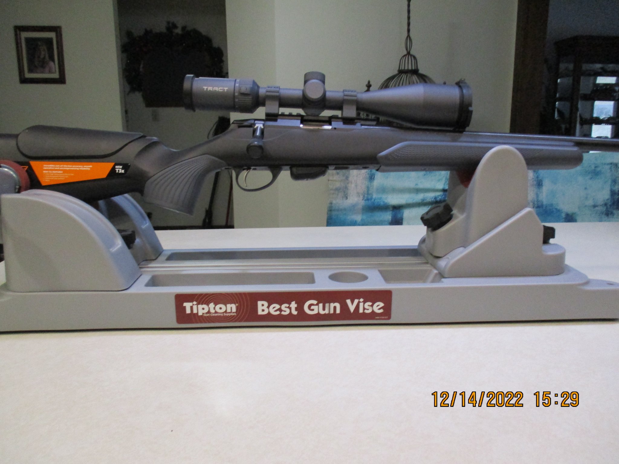

Got the T1x set up with a T3x OEM stock and enhanced pistol grip. The rings that worked for the scope's 50mm objective and still room for caps were the EGW HD lows (0.850" from pic rail top to centerline). With the 3/8" pad in the stock comb kit, it gives a good cheek weld.

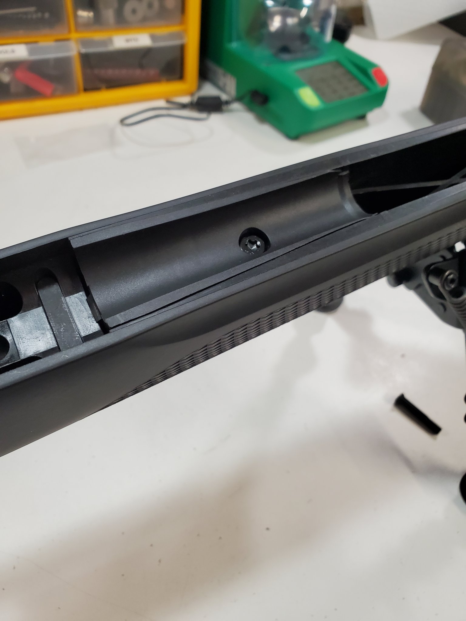

Okay I will bite. What is a "shoehorn". Maybe the plastic recoil lug?? If so, how do you remove it as mine is in there really tight. I have a metal lug from Mountain Tactical that I would like to try if I could get the plastic one out. Has anyone noticed improved accuracy with a metal recoil lug?
ID
This is what I am referring to as the shoehorn. One could have the idea that this is how tikka is sort of bedding the action or take it out and freefloat the whole thing, similar to it being installed in a chassis. I removed to screw with a T25 tourqes bit and it came out fairly easy. My recoil lug is factory and it is metal as well.
