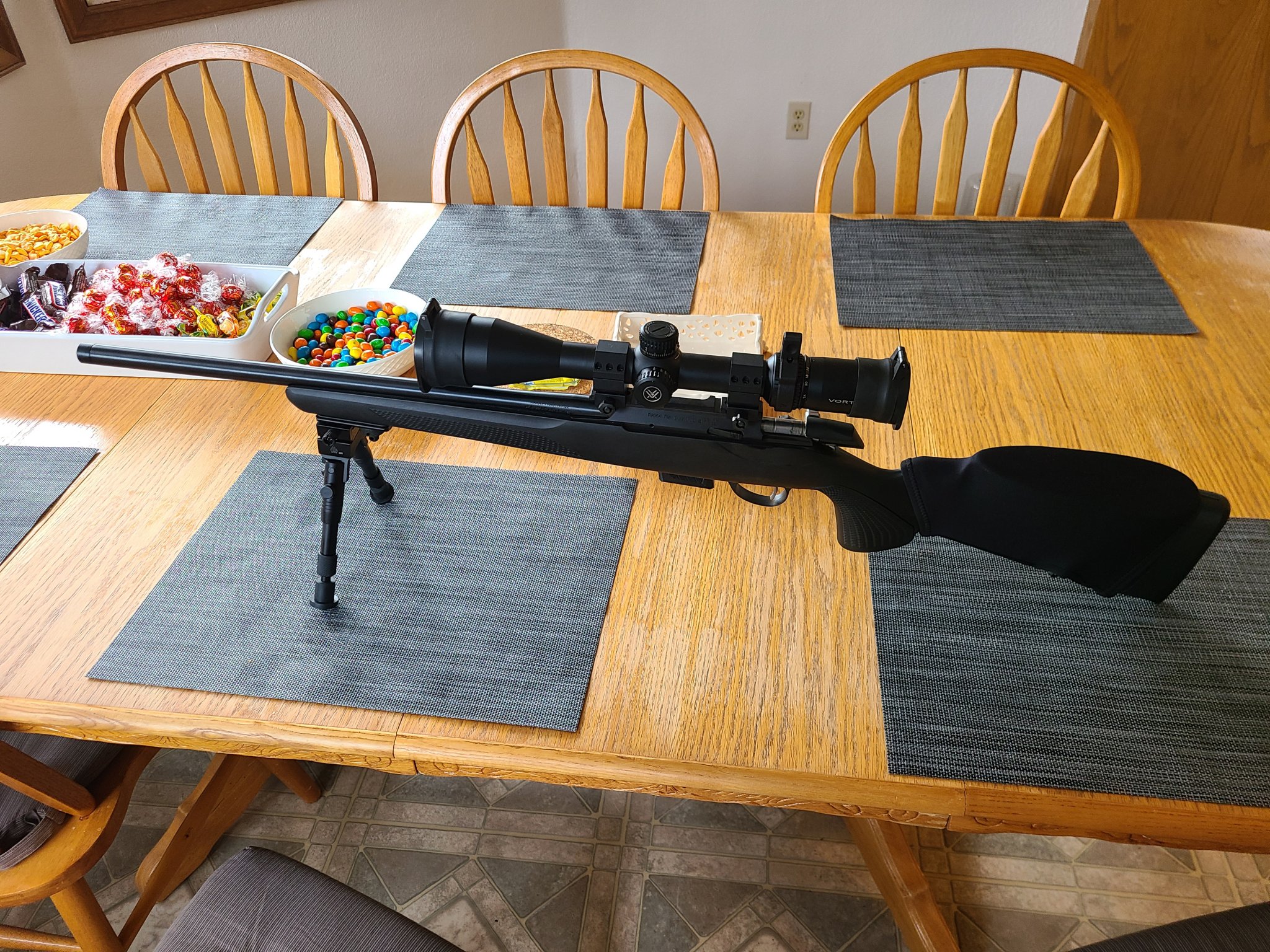

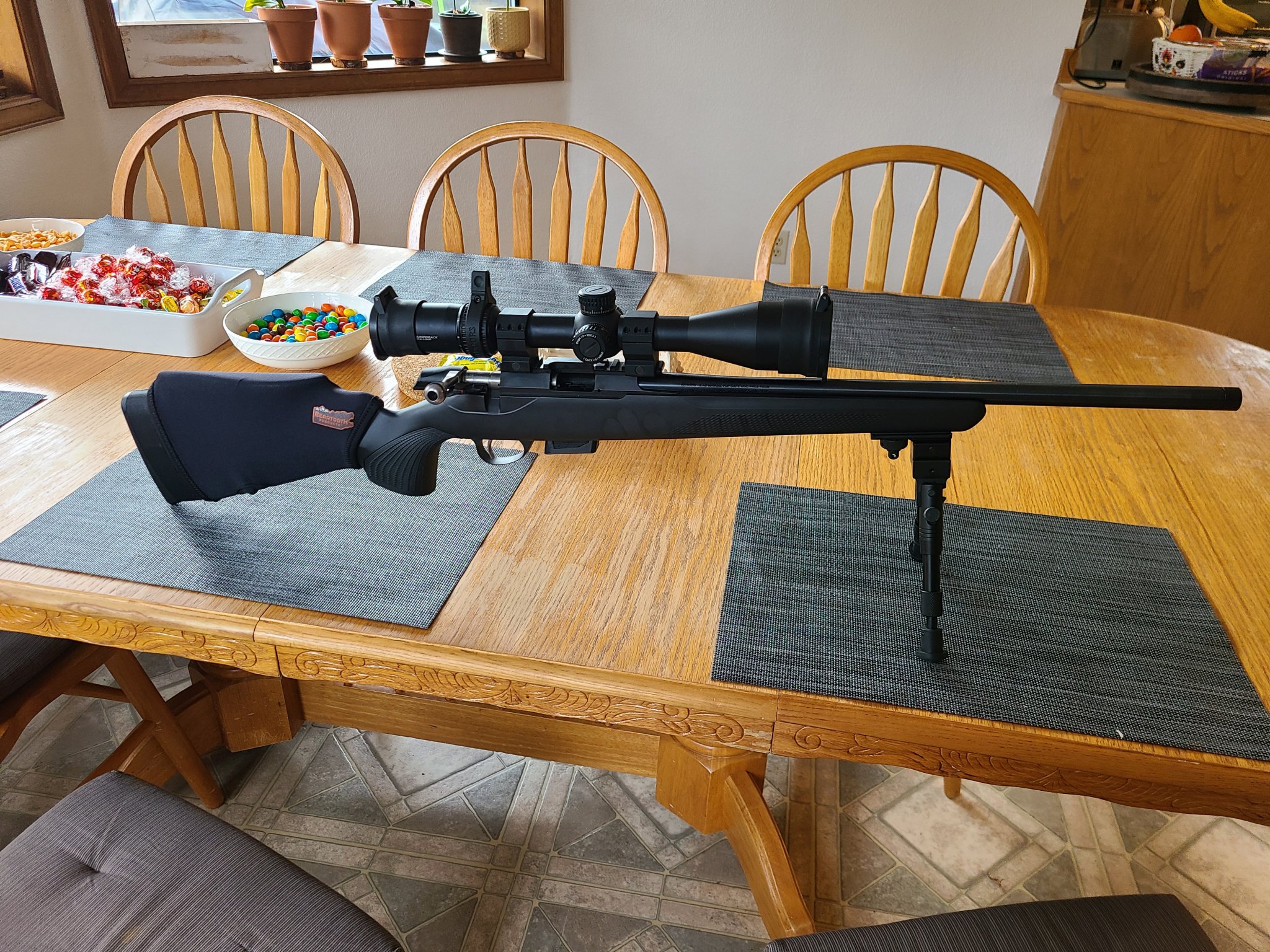

Current state of business. T1X MTR 20", DIP 25MOA rail with 6-24x50 Diamondback Tactical on top, pistol grip, cheep UTG bipod, cheek rest riser, home printed 20mm stock extender and flat mag base plate. First rifle to take me to sub moa at 100 yards, I'm actually surprised how much I enjoy it. I'll probably end up swapping the bolt handle and adding compensator just for looks down the road.
Mmmmmmmmm, peanut M&Ms
What are your thoughts on that B&C stock, DRAGON64? I’ve considered the similar one for a T3 CTR.
I own the Bravo on a Rem 700, and it works well as designed, especially with all of the accessorie options a Bravo chassis can provide. But the Bell & Carlson is an excellent solid stock as well, with a fair amount of heft, I really like it. With the flat bottom forearm, I believe a plate of some kind might work well.
