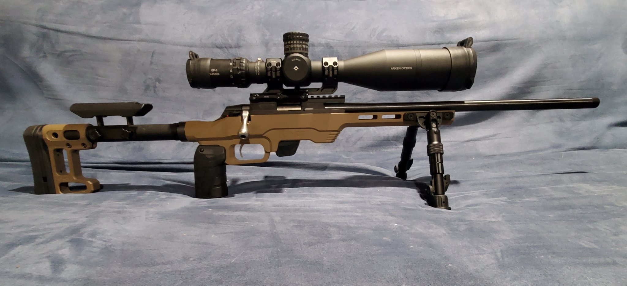

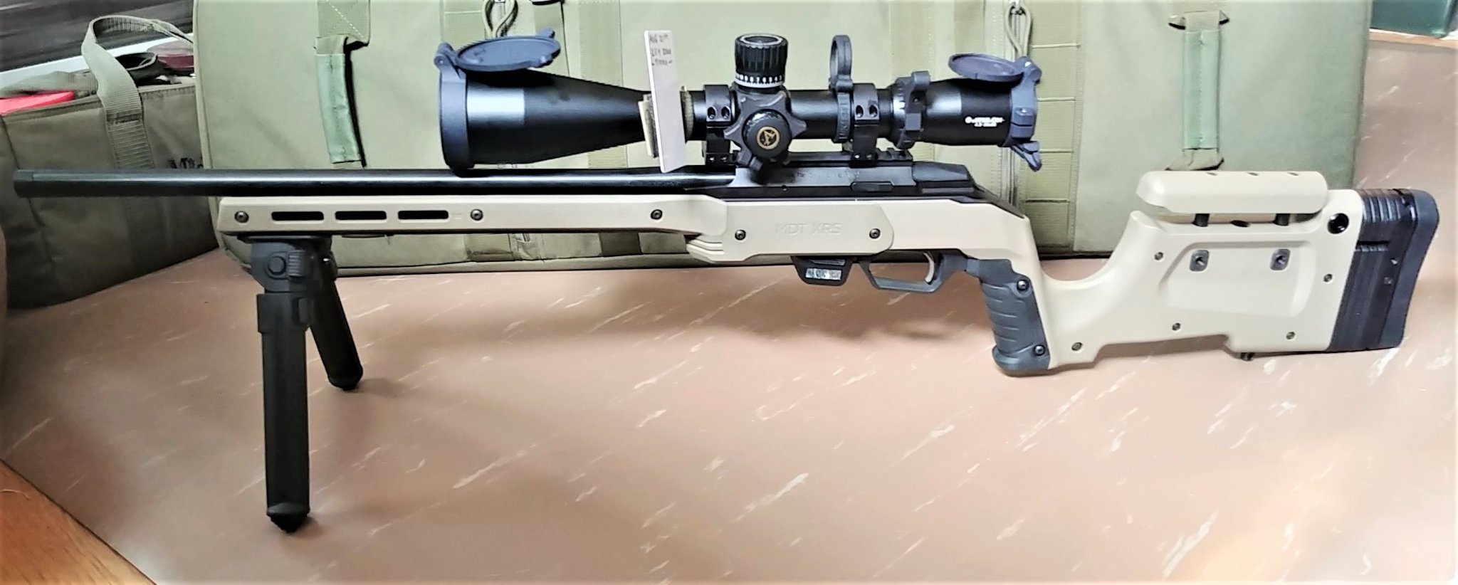

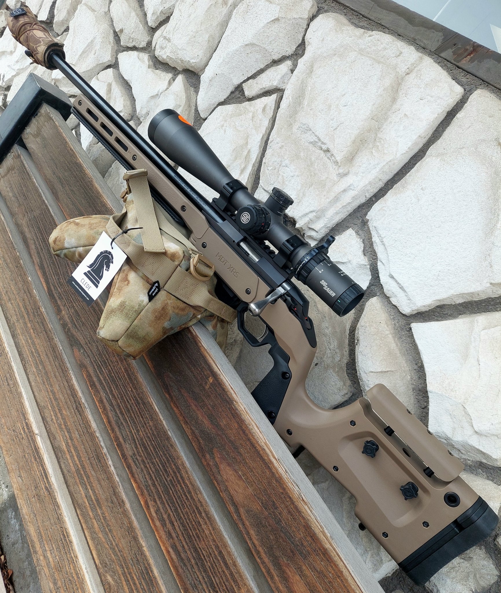

Anyone running an MDT xrs stock on t1x?
Yes... the XRS is too butt-heavy for the T1X with factory barrel, and I'm not swapping barrels. Even with Area 419 weighted ARCA, MDT fore-end weight insert and GrayOps 3-slot Mlok weights up front, the rifle doesn't balance far enough forward. If I were going to do it again, a PDC Customs G5C stock with all their weights would be a better setup at same price. Just my opinion... I have to leave the bipod on the XRS to get neutral balance, and really need to keep a weighted bag attached up front for NRL22X. https://www.pdccustom.com/product/rimfire-g5c/
Dude, you really like those T1x's. Very nice group of rifles. Or are there two different rifles in four different stocks?
Mike

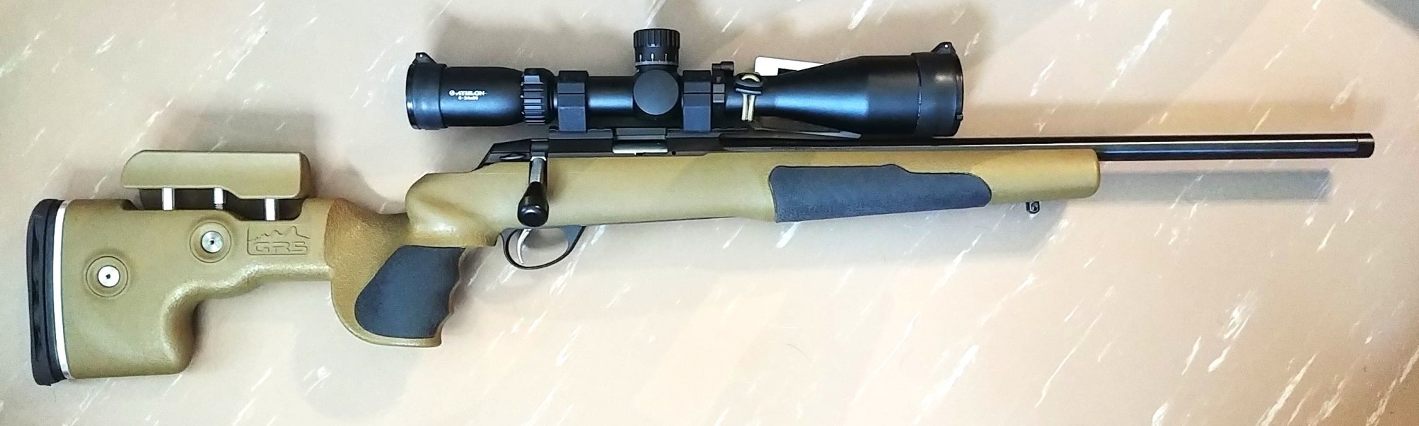

3 Rifles, 4 stocks. The GRS Berzerk is an older T1X wire ejector with older Athlon Midas Tac. The XRS is a newer plastic ejector with Athlon Ares ETR 3-18x50 for NRL22X. The T3 wood stock and T1X OEM stock share a 3rd Tikka plastic ejector with Athlon 2-12x42 for NRL22 base class. Honestly the OEM stock shoots just as well and balances almost as well at the XRS, I wouldn't do the XRS again, too much weight in the butt. The wife thinks the wood stock is a great rifle and will shoot it, so easy swap back to the OEM stock for me. Try some SK Long Range Match in these things, it shoots better than Eley Match for me. The OEM T1X almost makes weight for CMP Rimfire Sporter... its a few ounces over 7.5# and the trigger is a # too light, but at our local CMP match nobody cares, so its a multipurpose rifle. Would be good for Appleseed too.
I guess almost all chassis except KRG Bravo will do this way. My Oryx with MDT Arca and bipod needs 1 kg of weights to be balanced

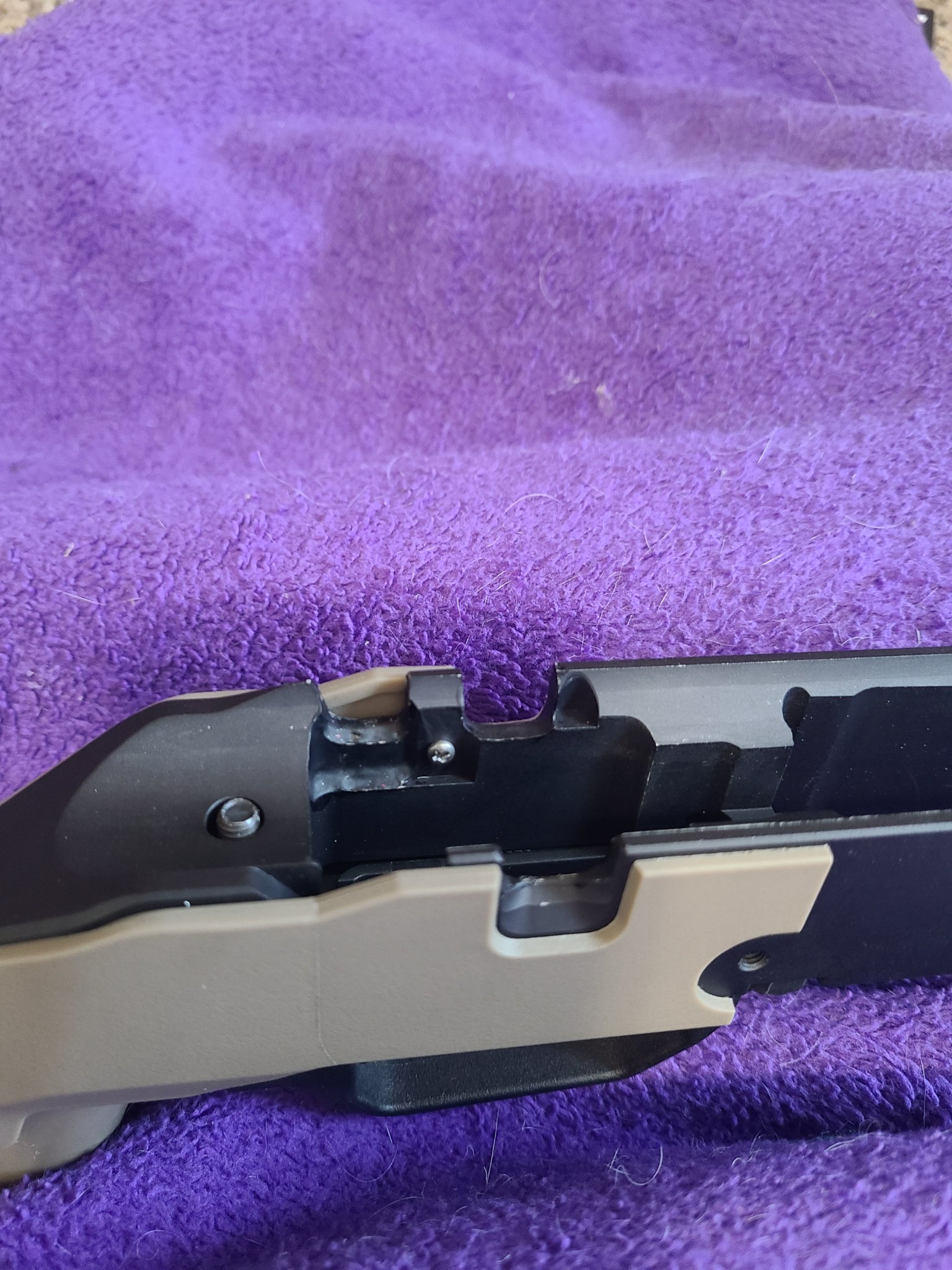

Has anyone put one of these in a chassis that’s cut for LA AICS mags? I’m thinking about picking up a T1X and it would be sweet to be able to drop it in an MDT HNT26 for Tikka LA and be able to swap the chassis to a T3X 30-06 for hunting season. The LA AICS mags are a little narrower than the SA mags so I’m concerned about clearance for the T1X mags to fit and also have room to work the mag release.

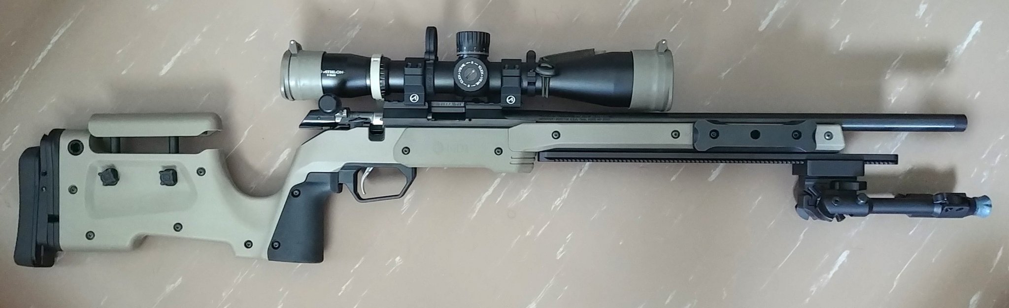

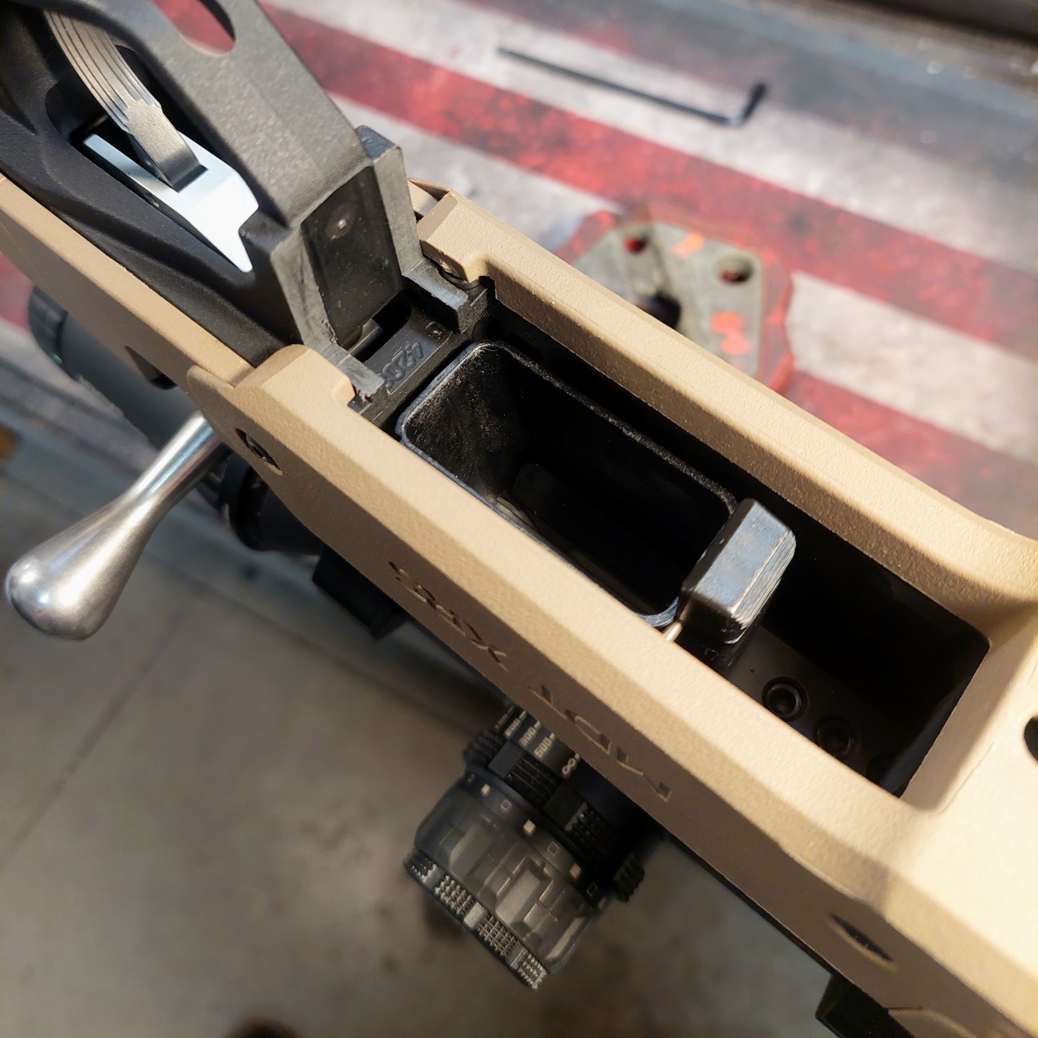

Finished my T1X for now.... And also the mod I did so us lefties can use the MDT XRS Tikka T3X SA chassis.
I just needed to cut away the area from the factory mag catch to clearance the 22 magazine. I cut extra so I can reach behind the mag to strip it if it gets hung up, but not necessarily needed. I'm assuming it does void warranty with them but simplest option for a chassis I found for fellow left handed shooters.
Happy shooting!
-Alex

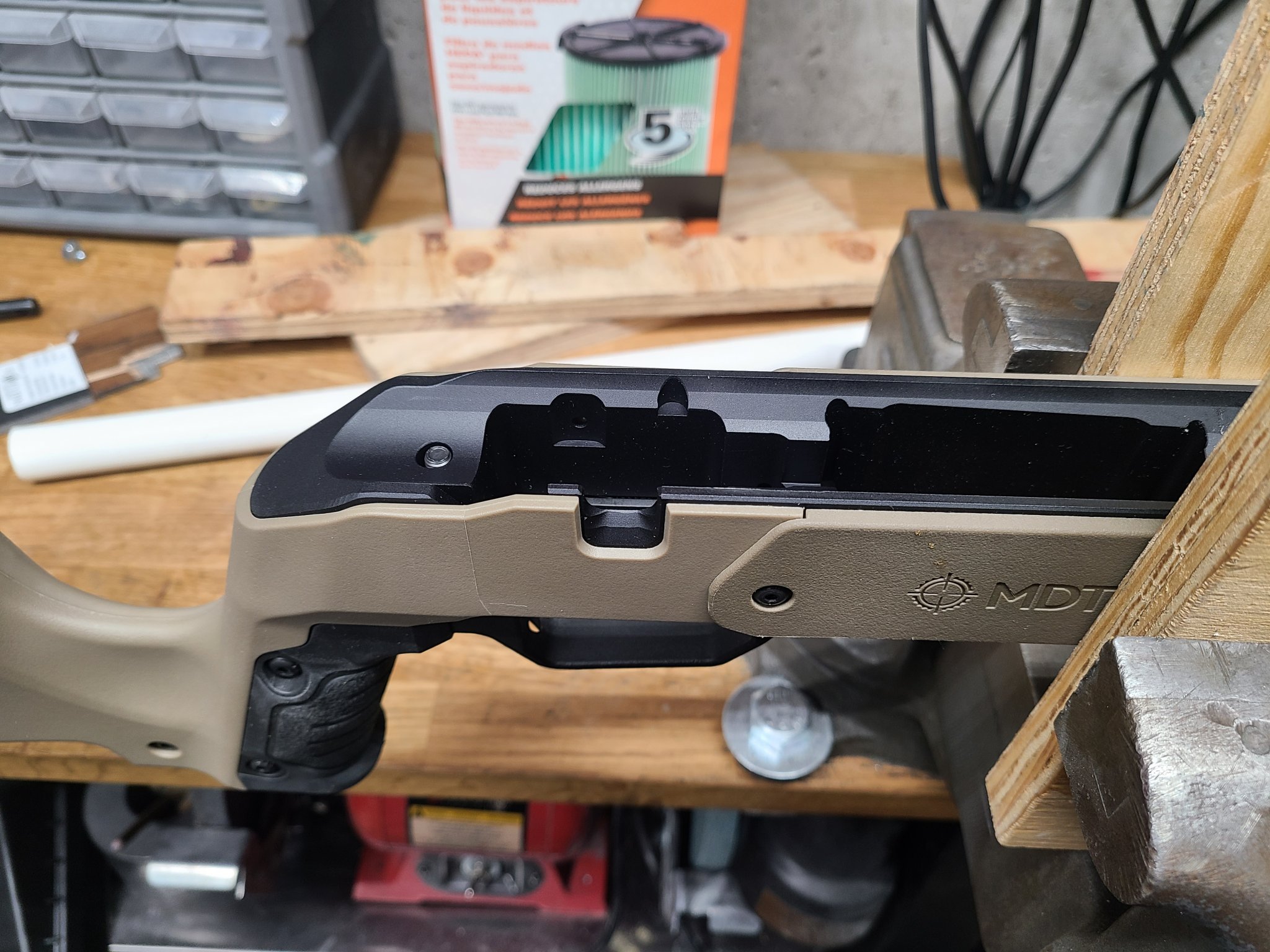

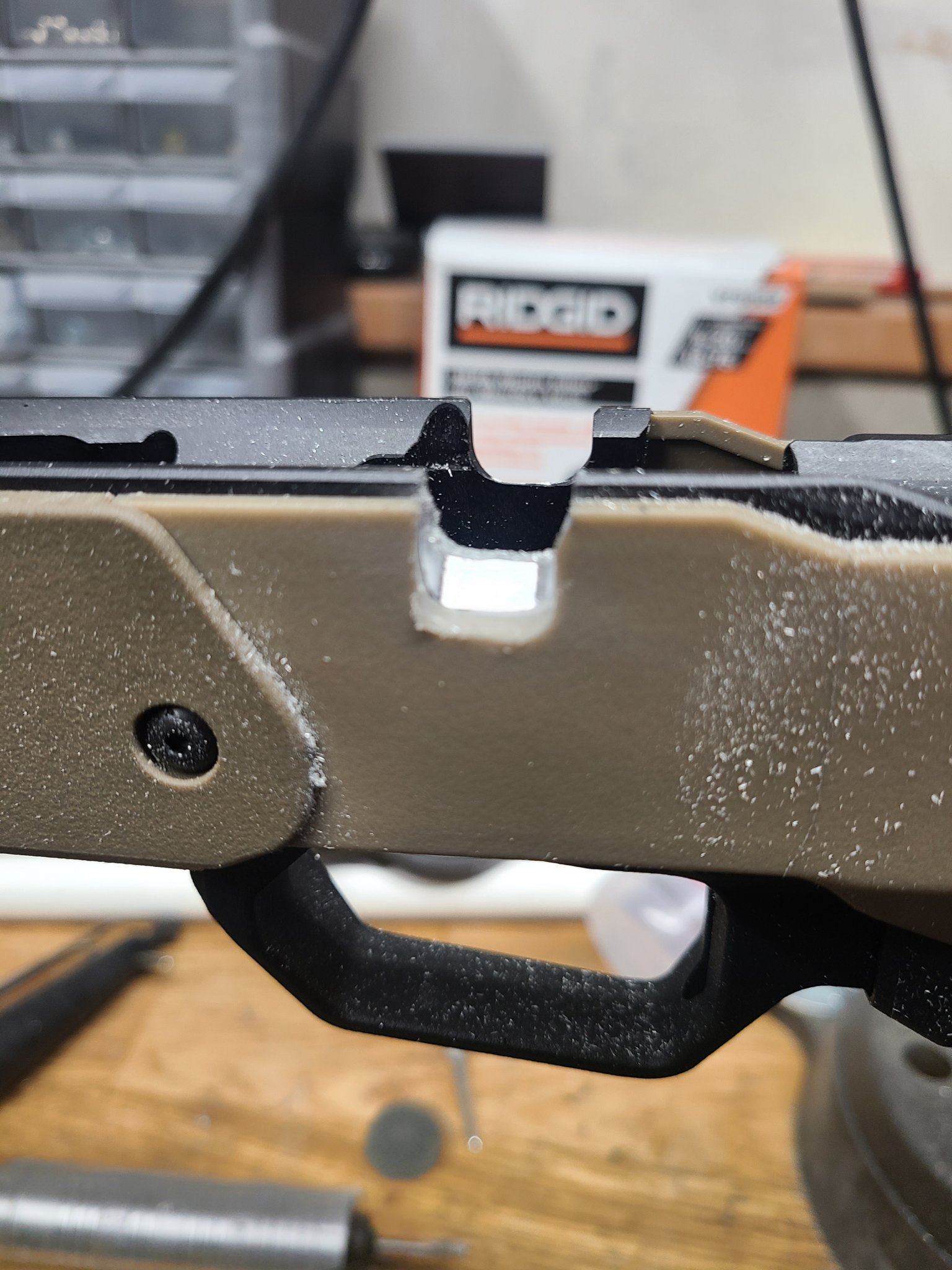

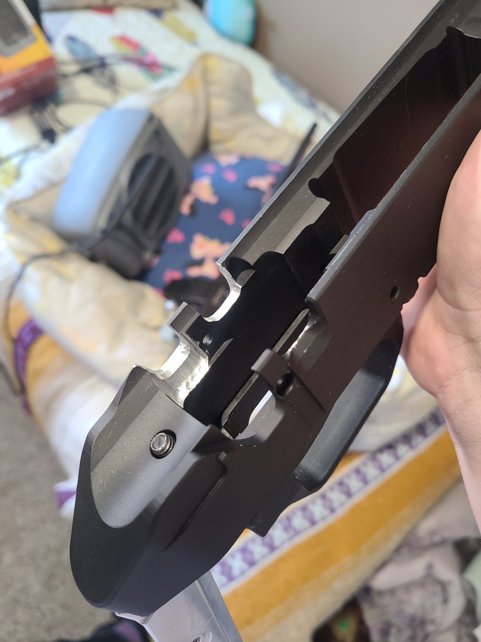

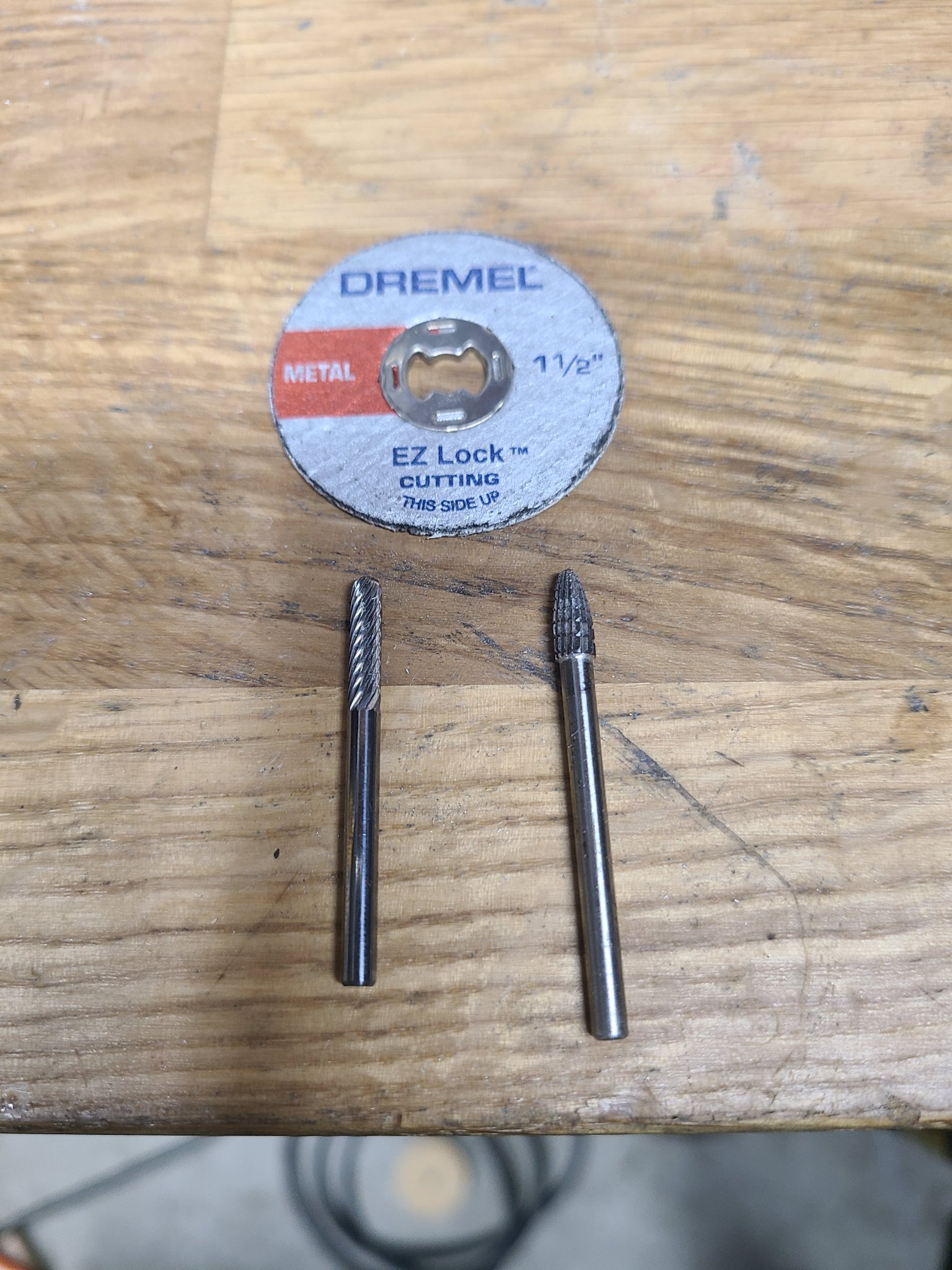

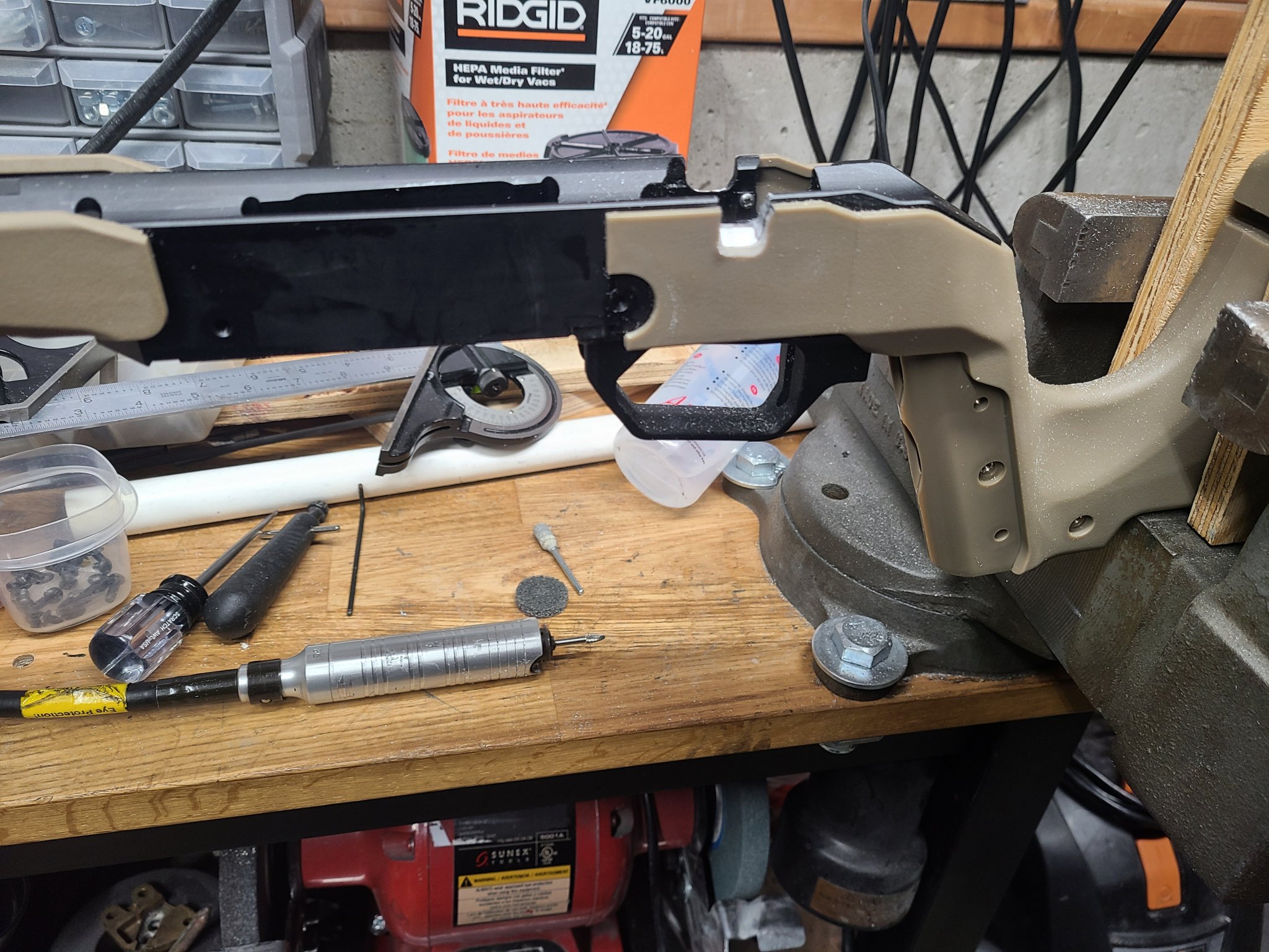

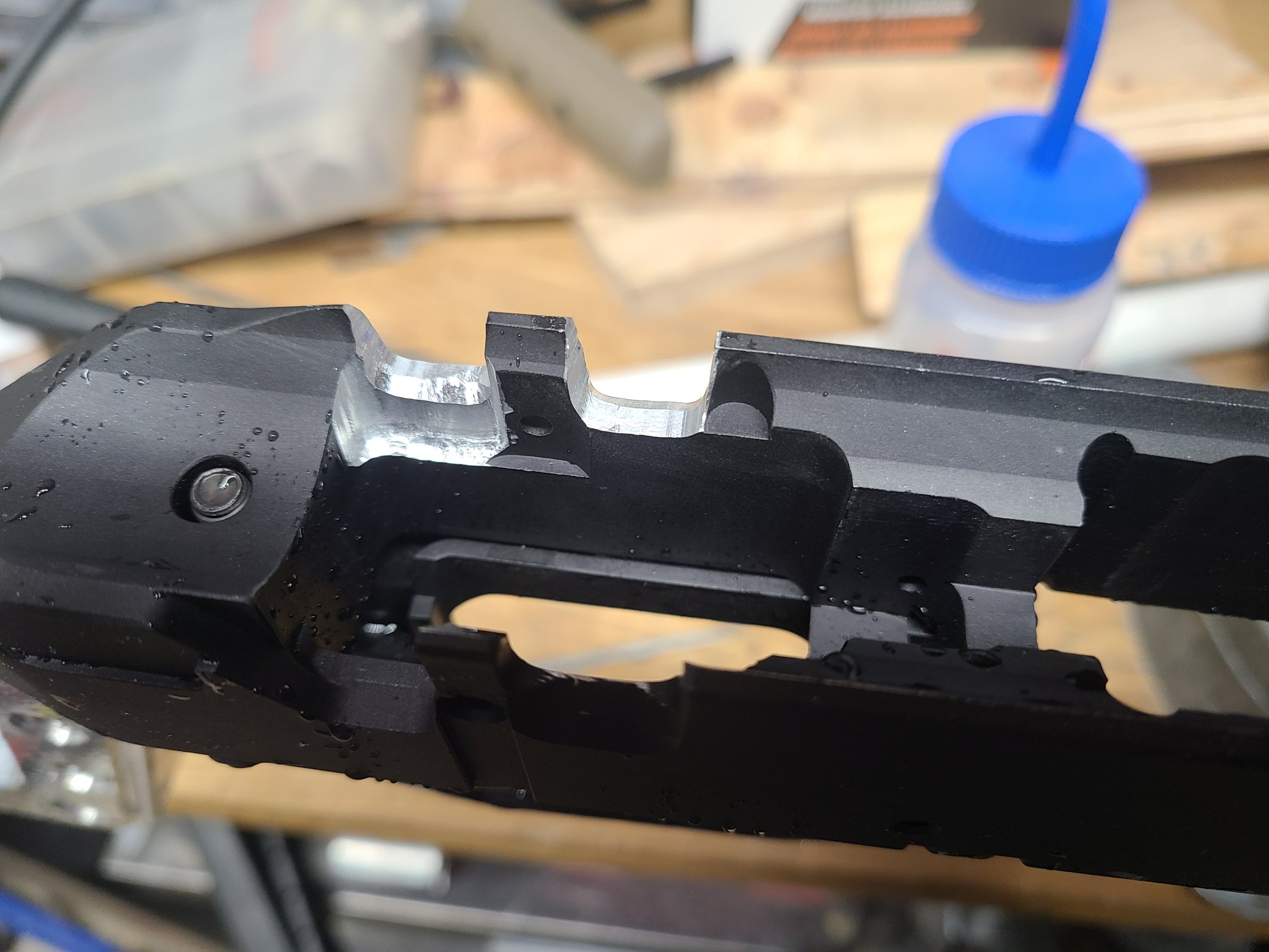

Picked up my left hand 20" t1x yesterday. Did the left hand conversion last night for my xrs I got on black friday.
Before starting
Initial cuts.
Had to take it apart to cut the mirrored relief for the safety.
Most all cuts done with my Foredom SR. Dremel but better. The 3 bits I used. The cut off wheel to try to setup the location of the cuts. The right bit cut the plastic better and was used for most of the hogging. The left bit was used for the inside safety cuts.
All cuts done before nail polish. Didn't take the safety cut as far down as the right side.
After the nail polish. Used my wife's fancy internet nail polish. Holo Taco nail polish by Simply Nailogical. Black polish with a matte top coat. Had tiny bit of glitter in the top coat.
Assembled.

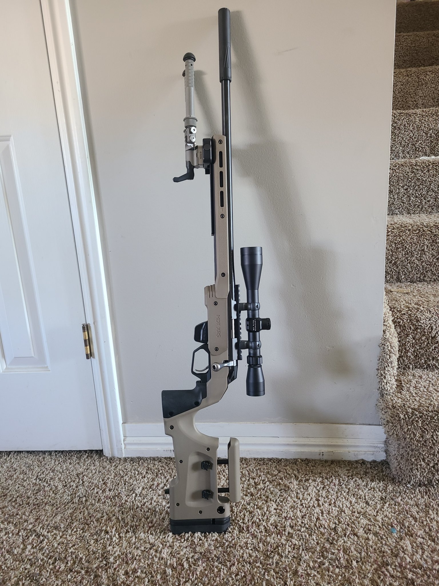

Lefty 20" 22lr T1x from Locked Loaded. Transferred by a coworker yesterday (we're aerospace machinists).
Area 419 30 moa rail
Thunderbeast 22 takedown
Atlas CAL No Dye limited edition bipod (thanks @Kasey) on RRS adapter and RRS lever clamp.
Temp scope is a leupold mark ar 3-9x40 sfp mismatched pos from 2009ish. Only other magnified optic I have is my Razor 2 on my T3X.
Future planned changes
Arken Ep5 mil.
Sterk (@cannoncrossfire) swept handle and Sterk TRG style shroud.
Haven't shot it yet.
Before starting
Initial cuts.
Assembled.

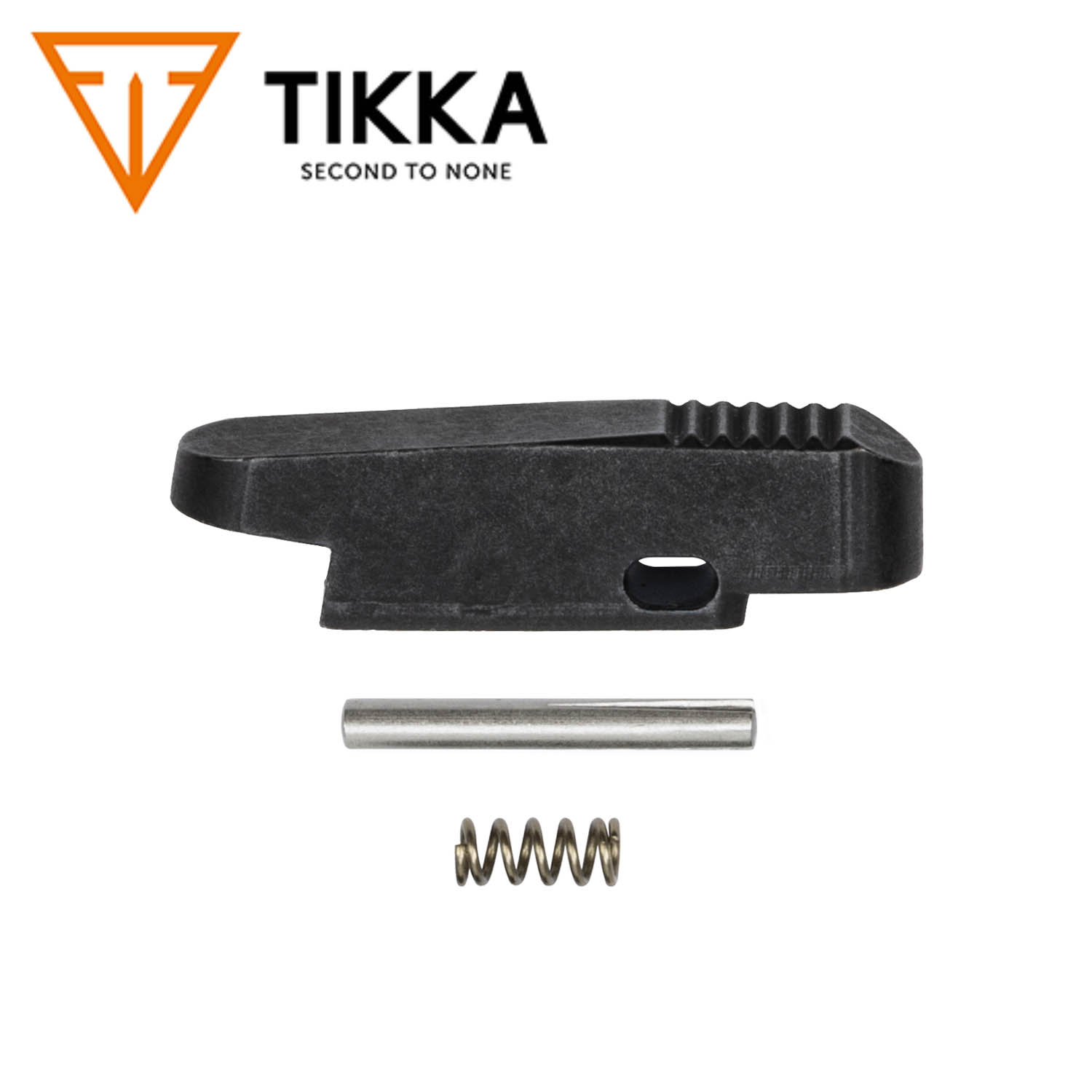

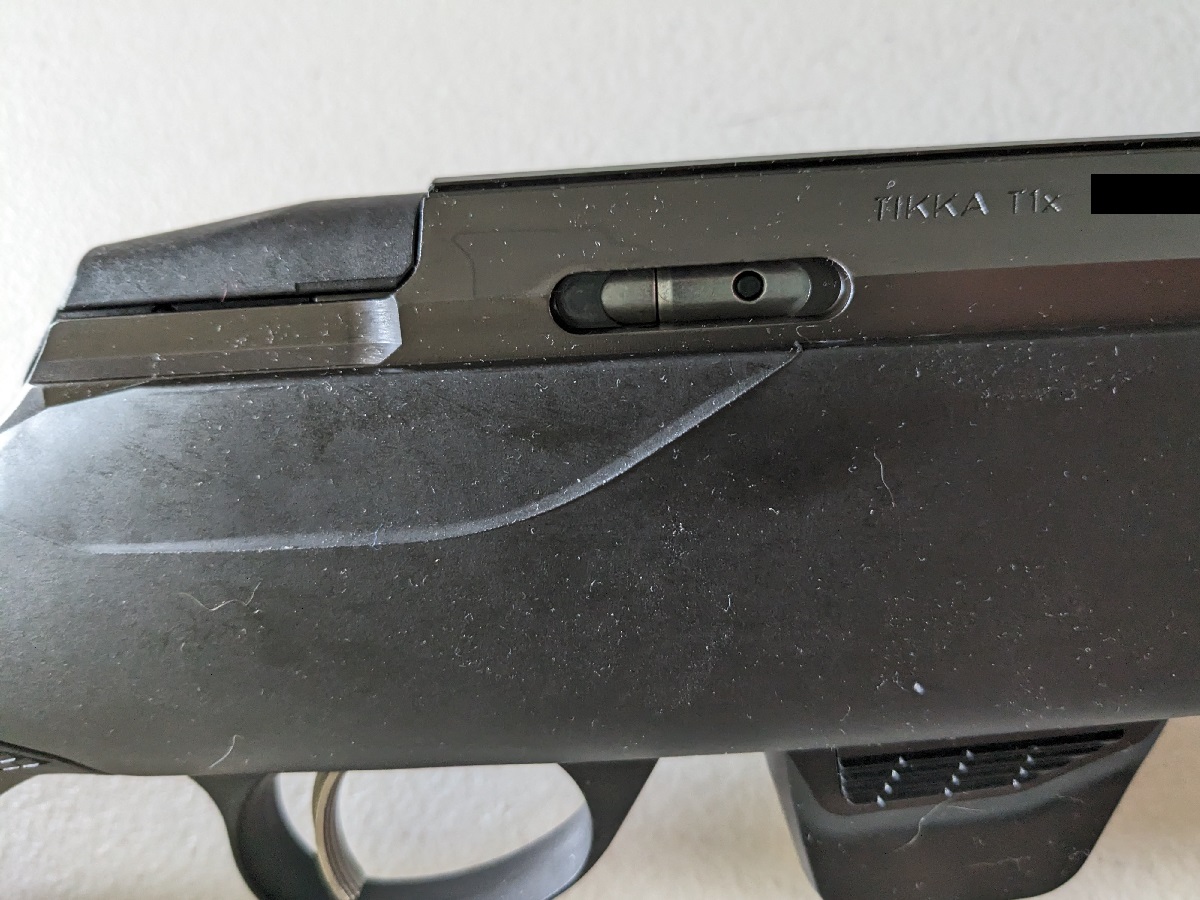

Just picked up my brand new left handed T1X and didn't notice that it was missing the bolt release assembly.. :cry:
Anyone know if there's a difference between the left hand and right hand bolt release assembly? Anyone have recommendations on where I can pick one up? Am I the only unlucky doofus to not notice missing parts? lol
I'd also complain to whomever you bought it from. Sadly it's on you to inspect it before accepting a transfer. While it's possible it left the factory like that the more likely scenario is someone helped themselves to a part for a repair.
An extra $50 just to get the whole gun.. my own fault for buying from a drop shipper lol. Thank you, I'll look around and see if there's some cheaper after market parts, maybe decide on a couple more mags before buying.
Could try and contact Beretta. They might just send you one.

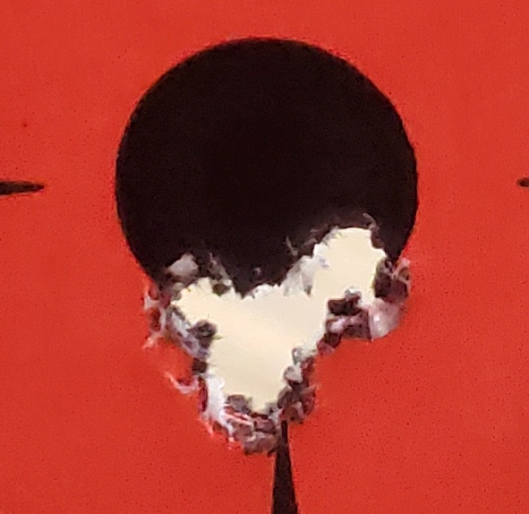

I recently picked up a new T1x w/16.5” barrel.
After a thorough cleaning I took it to the range and put a few mags of CCI sv through it to foul the barrel.
Then I shot 5 round groups at 50 yds with every variety of ammo I had from Center X down to cheap bulk pack. Most groups ran 1-1.5” even the center x was almost 1”.
This seemed like poor performance, so after checking everything else I decided to check the action screws, both were very tight. I would guess 50-60lb. After resetting to 25 front and 15 rear. I shot more groups and saw immediate results. Most groups shrank to half or less of the previous group.
pictures are center x and cci sv before and after changing torque.

Which MDT chassis would work well (including: no need to modify) for a left-handed Tikka T1x ?
To my knowledge there isn't one. I opted to get the LH Tikka T3 XRS stock and remove the mag catch on the chassis to clearance for the 22LR mags. It's not a very had mod at all and IMO looks a bit cleaner in the end.
Also when you take the skins off of the XRS you can see the trigger guard is bolted in, I'm guessing that if I wanted to convert back I could possibly buy a new trigger guard with mag catch from MDT.
That looks like the easier option. Looks great.

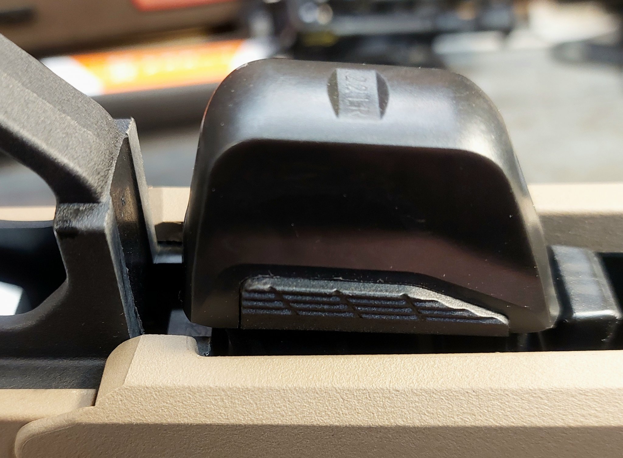

For those that have the Victor Company Cheek Rest have you found any clearance issues in regards to bolt removal and/or inserting a bore guide for cleaning? I like the clean look of the Victor cheek rest but concerned about causing clearance issues. I don't want to be constantly removing it for maintenance. Thinking of getting the Kalixtechnik instead because of this but don't like the look (or cost) as much.
none, and I have maxed out spacers and I think one more than what the official max is
the victor co is slick af, looks good
I positioned mine so the bolt could be removed with the cheek rest in place.
For cleaning I do remove it but I didn't use the drywall screws they included. I bought a pack of threaded rivet nuts and machine screws. I then drilled undersized holes in the top of the comb then placed each rivet nut on a soldering iron to heat them up then pressed them in to each hole. As long as you don't tighten the screws with gorilla strength the nuts hold up fine.
This is what I'm concerned about. I'm not real comfortable putting the drywall screws in to start with and then the thought of having to taylor a solution doesn't excite me either. The Kalixtechnik looks like a great solution but I am starting to think that by the time I buy that and the front grip and vertical pistol grip I may as well start considering a chassis like the Oryx.

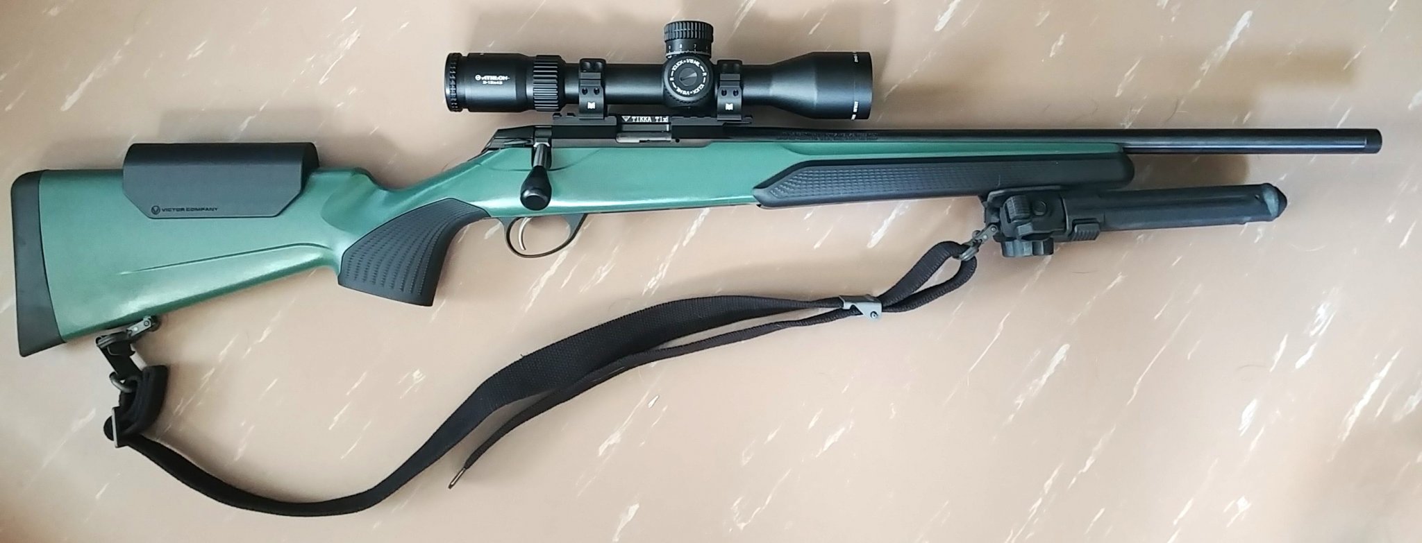

I had the Victor Co. cheek rest on mine, as well as the forend and vertical grip. I like my KRG Bravo a lot better though, so my factory stock pretty much just collects dust in the basement.
Got mine decked out w/ vertical grip, recoil pad, wide front, DIP knob, and trigger spring (just adjusted it till it felt right, haven’t had it on a pull scale yet).
Have it torqued at 25 in/lbs. going to take my fat wrench to the range next time and play with that a bit.
I need to just shoot the snot out of it. Best group I had the other day was .620” for 10 with Eley Target.
Sorta like this setup. I’ve got a Bravo on a Bighorn/.22BR and love it for what I do with it, but I’d still take this rig squirrel hunting.
