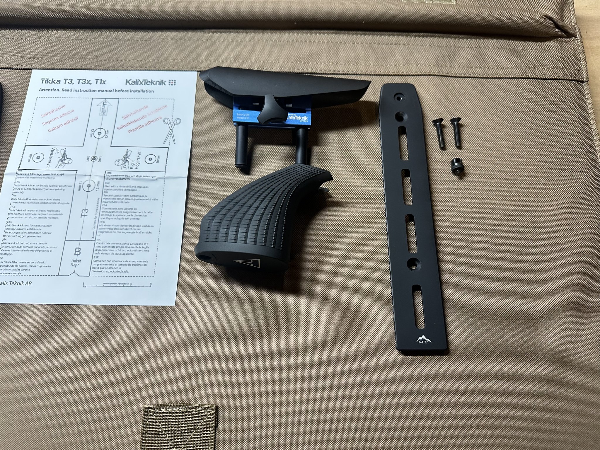

I put the upgraded pictured above on my T1X and it changed personality as well as aesthetics.

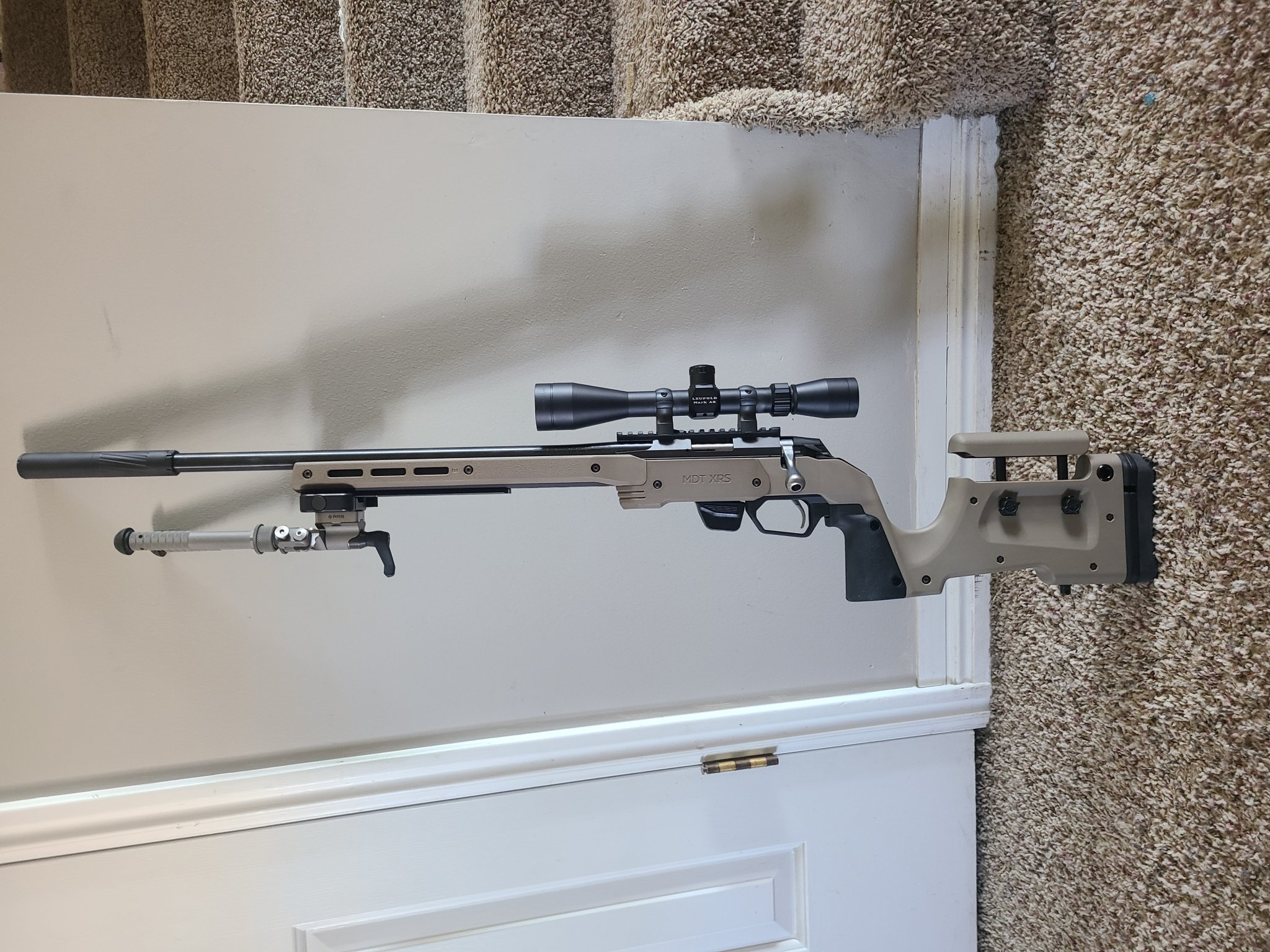

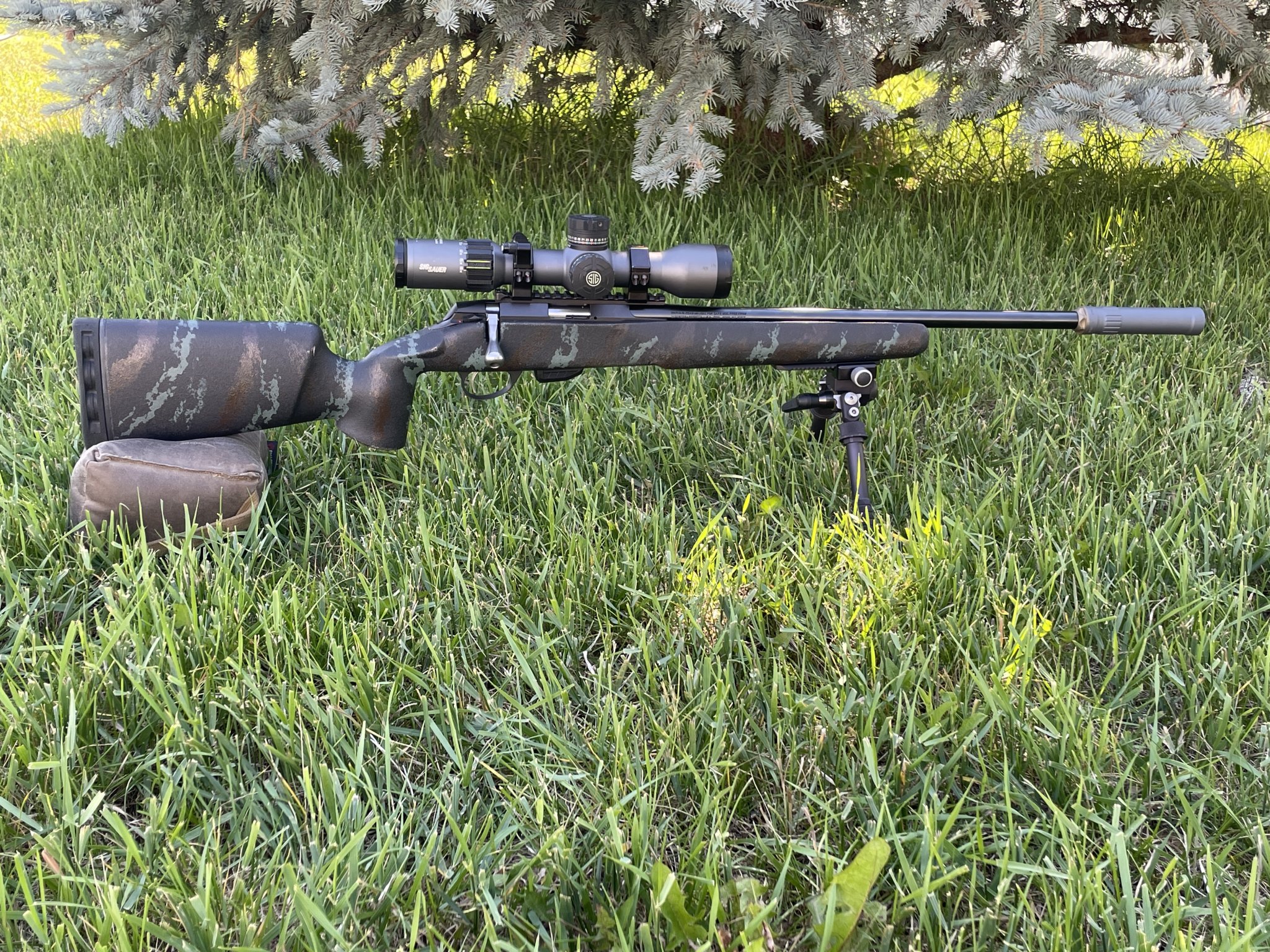

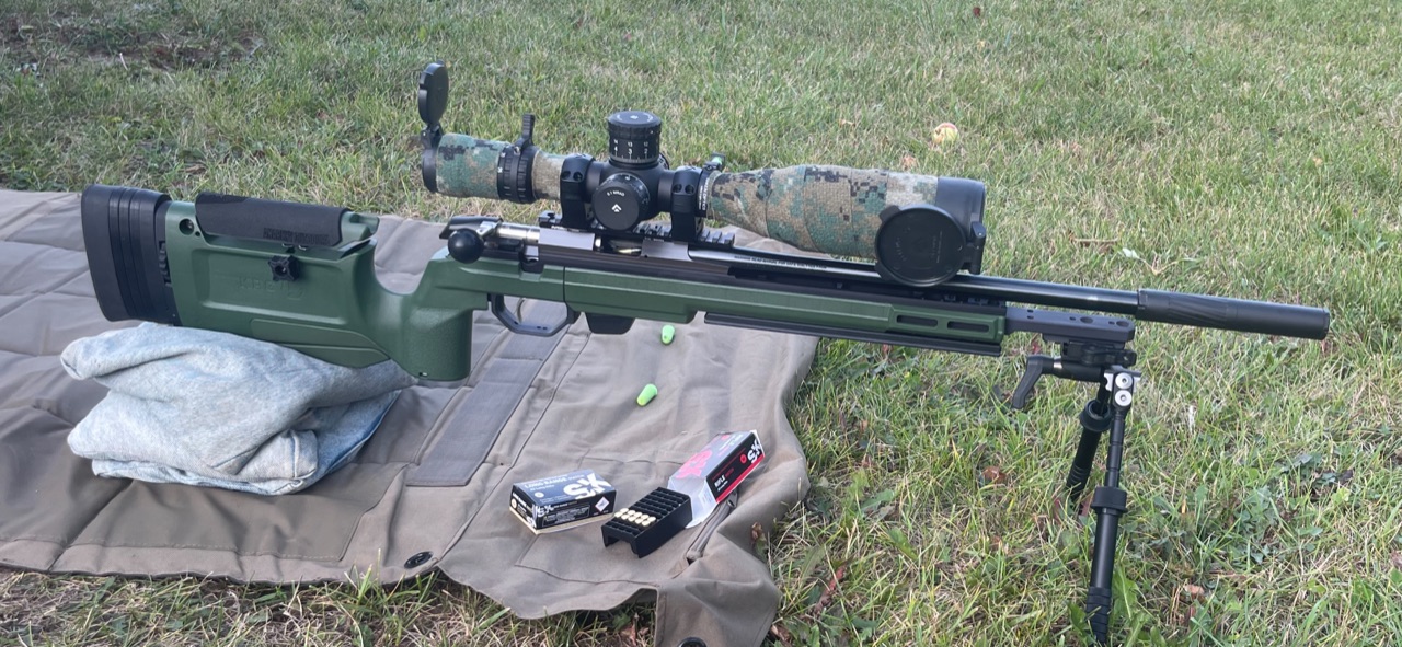

My 20" t1x in the MDT xrs. My can is 5.6" long so you have some scale. Have a coworker that has the 16" in the same chassis and it works.

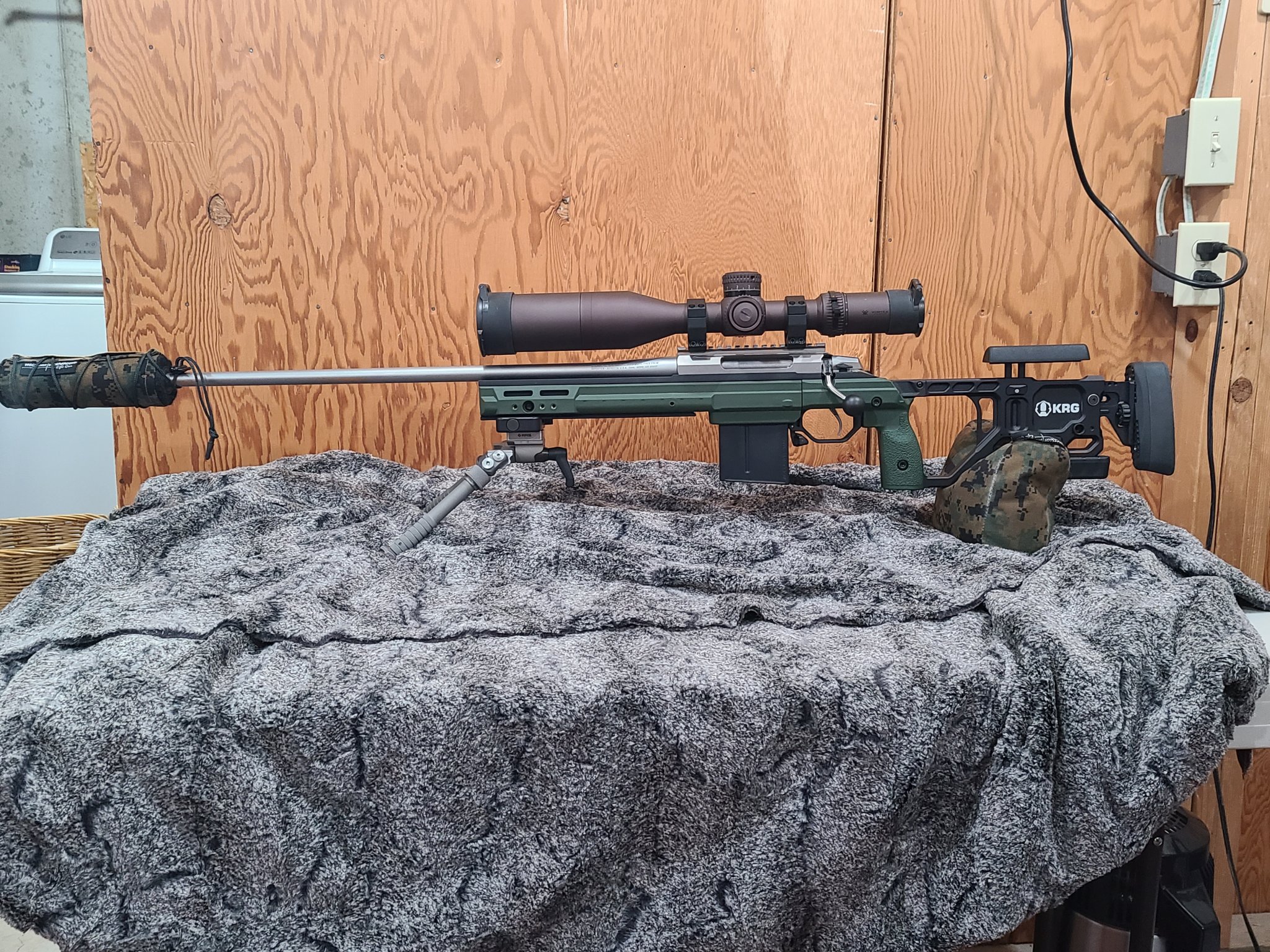

16” in KRG

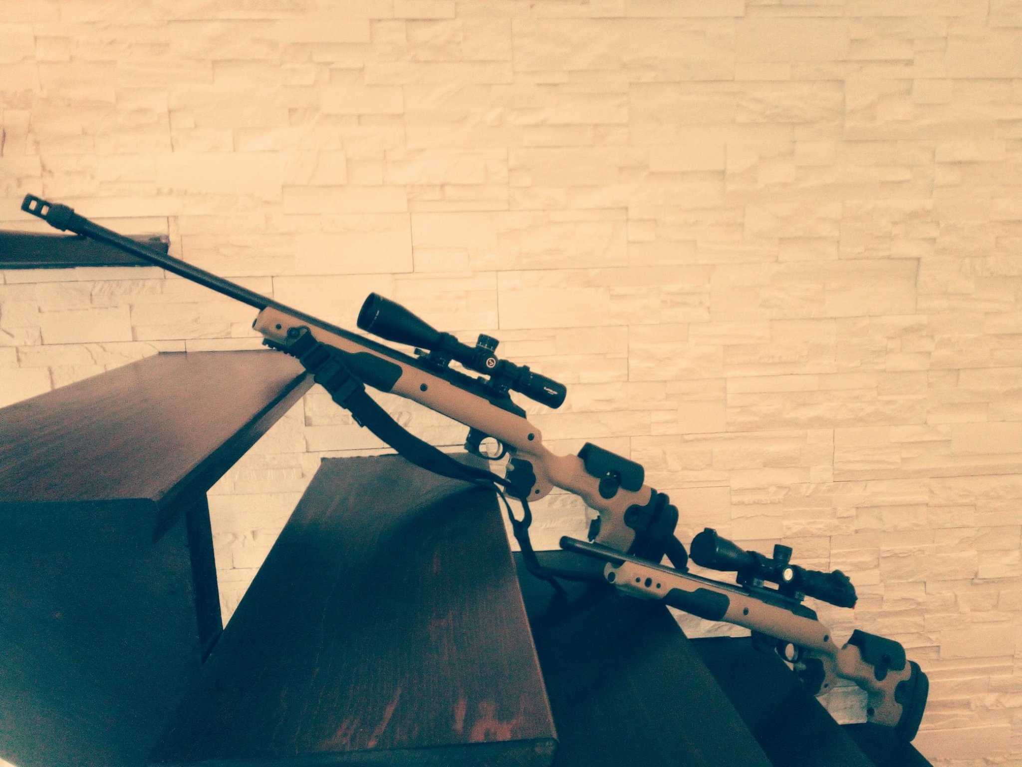

I use a Tikka T1X beside my T3X CTR as a trainer rifle.

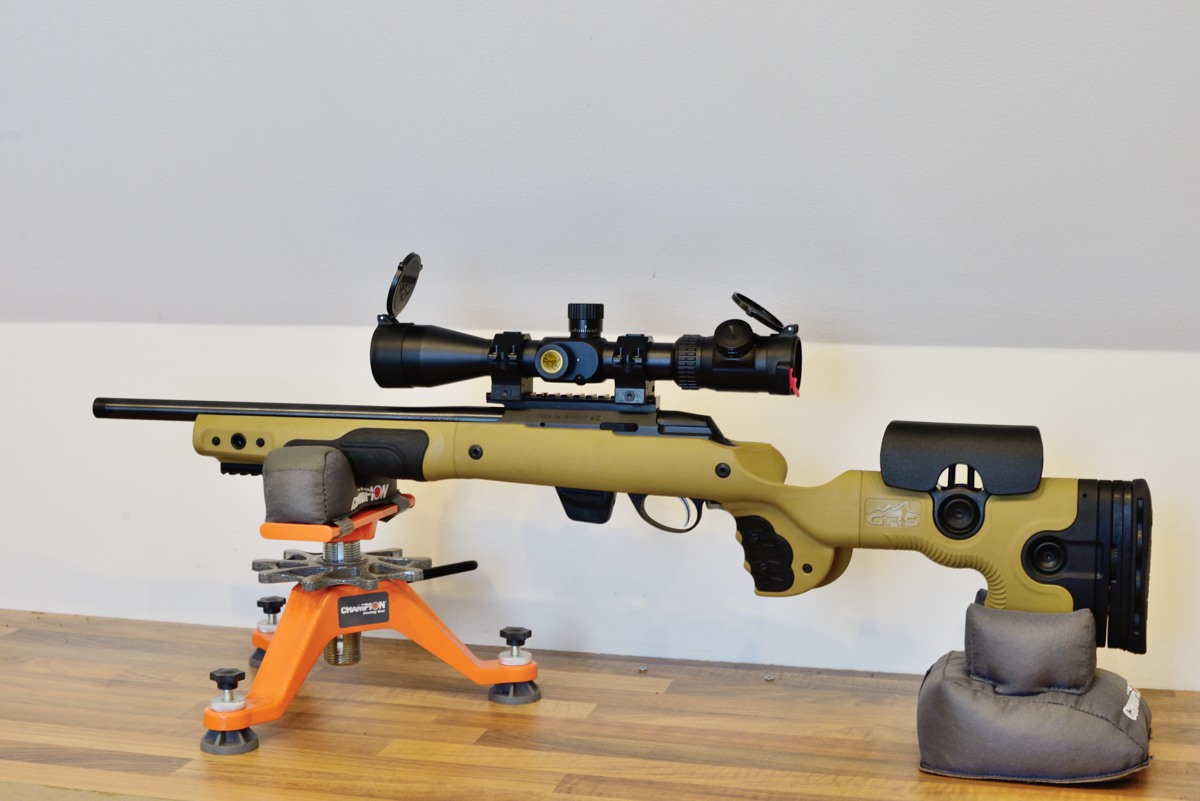

Love the precision combined with the GRS Bifrost ans Athlon Talos 4-14 scope.
Grouping after First shot and then zero in @100.

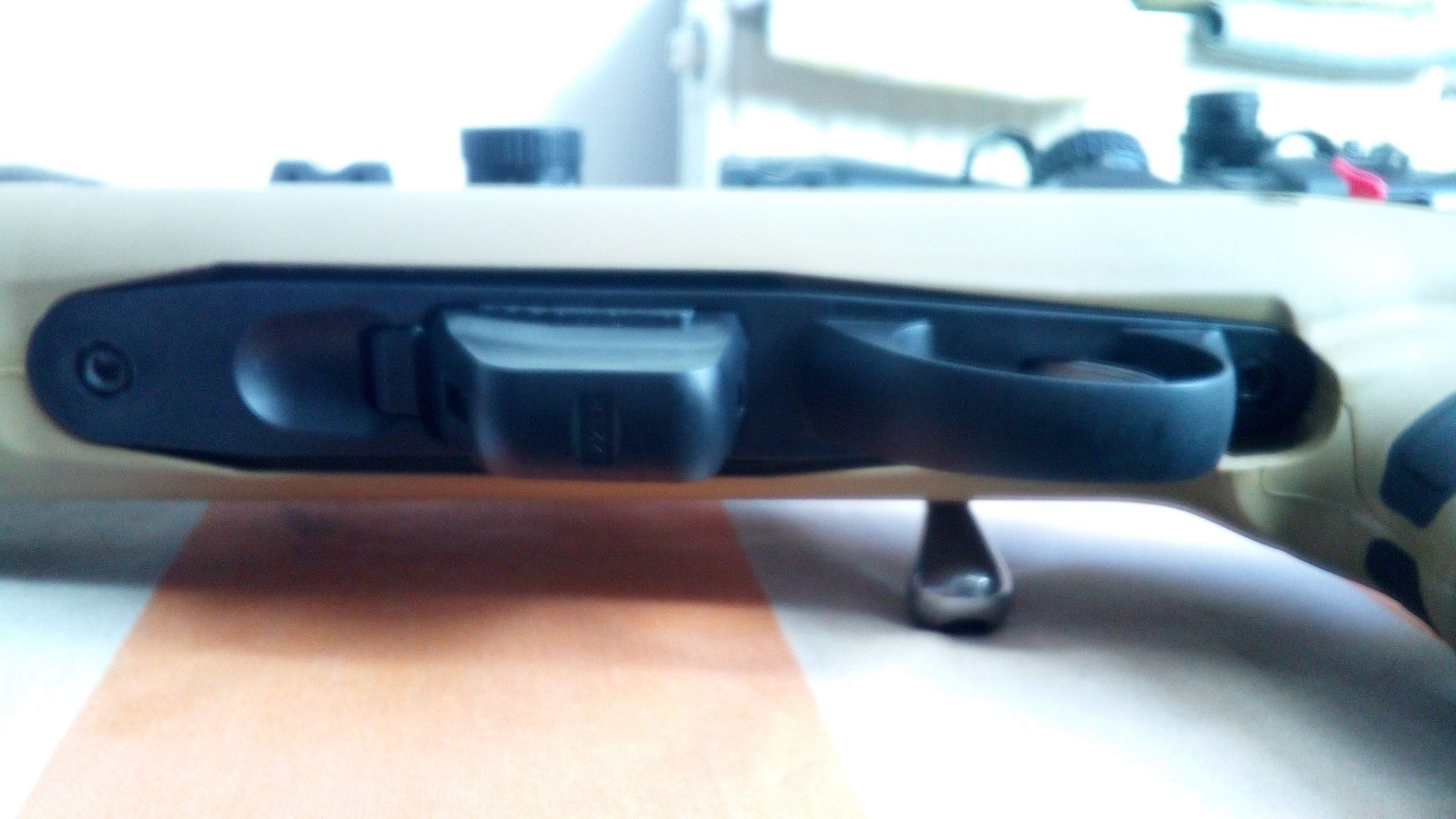

The T1X will fit every T3X ( non CTR ) stock. With CTR stock, there will be a little gap between stock and bottom plate.
German Gun Stock and GRS Bifrost / Warg and MDT's XRS are some I know which manufacture perfect fitting stock's extra for T1X, without any gap
Well, I have to correct myself, you are right.
This is what a T1X with Tikka bottom plate looks in a T3X CTR stock. Ordered a GRS Bifrost especially for T1X and the gap was gone. Maybe the T3X non CTR inlet ist the same as T1X.

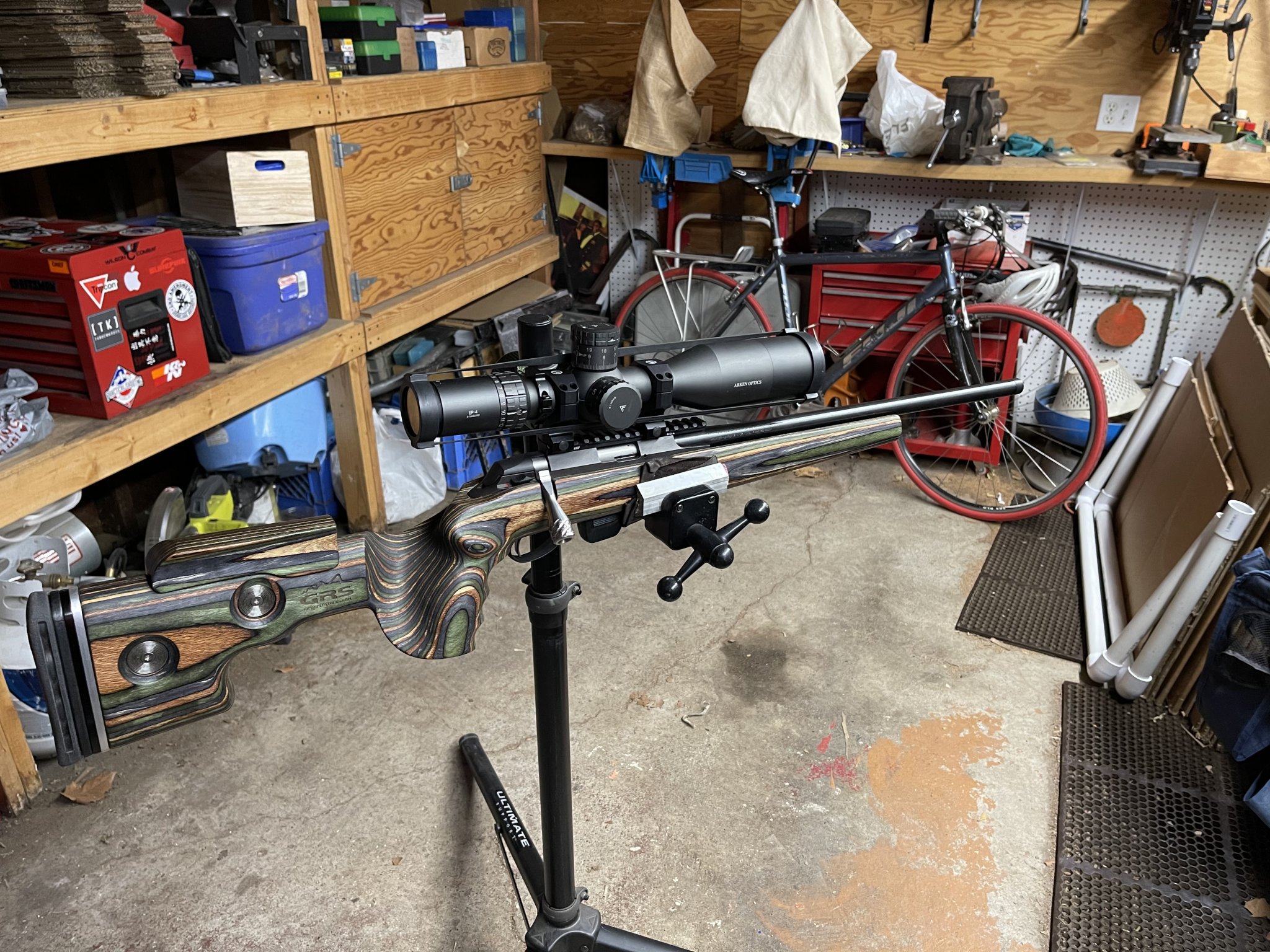

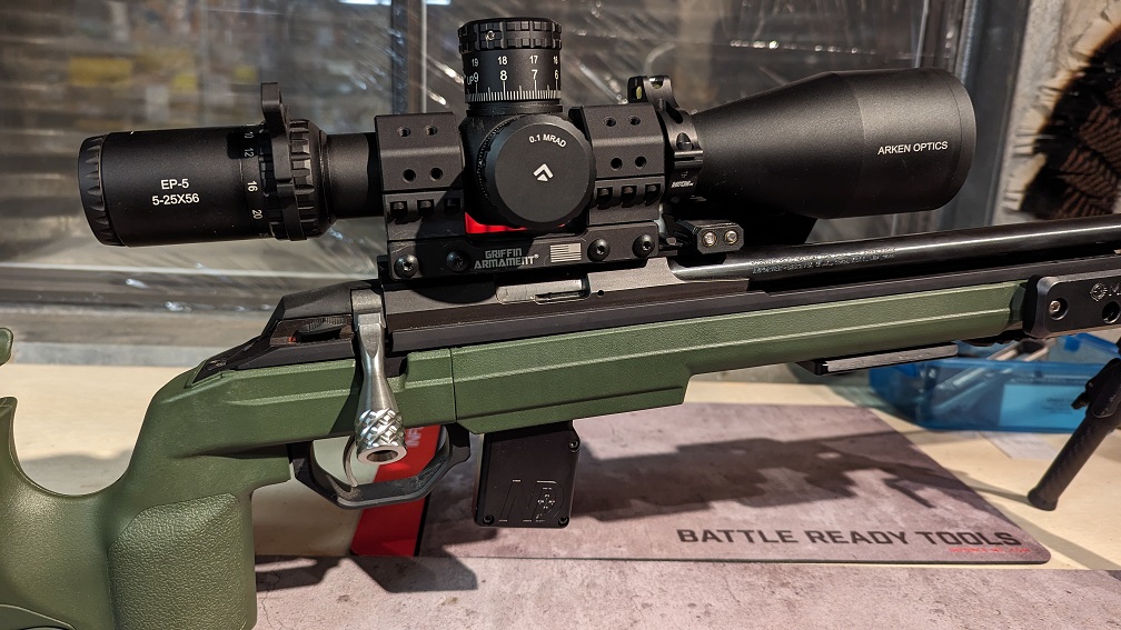

For my lefty t1x in the MDT xrs t1x rh cut inlet I had to do a little more work. Safety area along with the bolt handle cutout. I used my Foredom rotary tool to do the cutting (fancy foot switch shaft dremel).
Used some of the wife's black nail polish to cover. I really need to take an updated picture with my ep5.
I think for some t3 inlets for a T1x (especially for lh) you might have to remove the magazine release, cut out bolt handle clearance, cut out safety clearance, or some you have to remove a little material in bottom to clearance for the T1x mag well. For the left hand parts just mirror what is there on the right side. Work slowly and check the fit multiple times. Left hand converting will leave some more open areas where the right hand stuslff is but that is the cost we have for being left handed.

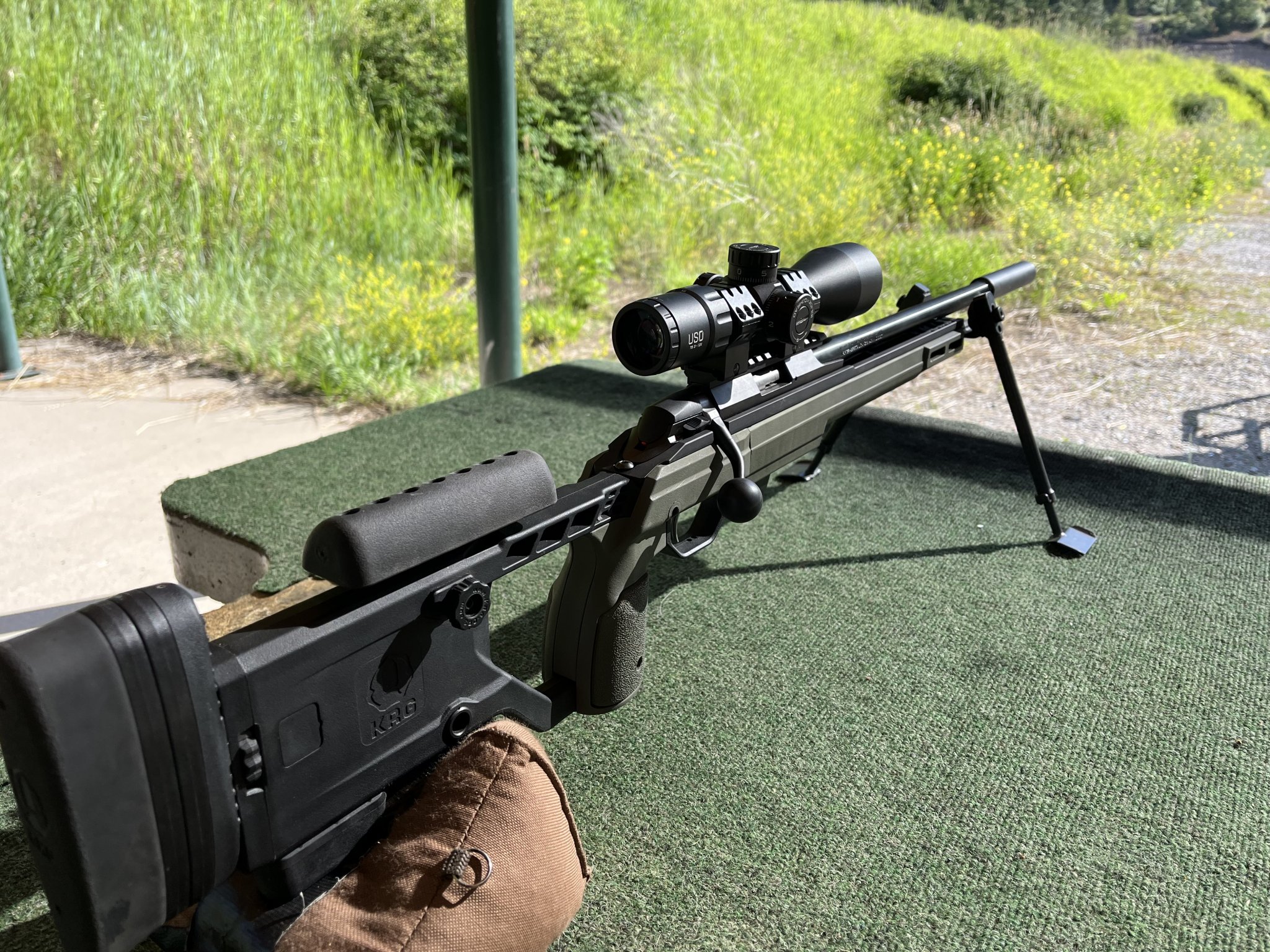

Anyone able to tell me how the balance point is with the T1x in a KRG Bravo stock?? Would the stock need the heavy ARCA rail to balance the rifle to shoot positional off barricades?

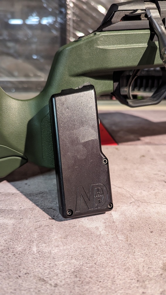

Anyone tried the T1x NDR 15rd mags? Just got mine today, haven't gotten a chance to shoot it yet but I'm pumped to have a 15rd option.

Cool, they added a US website now.
Spendy, but not that much more than a factory mag and add on extender.
I agree, little pricey but I have not had good success with the factory mag and extensions. Had one fall off in the middle of a stage so that was the end of that. If this runs it's worth it in my opinion

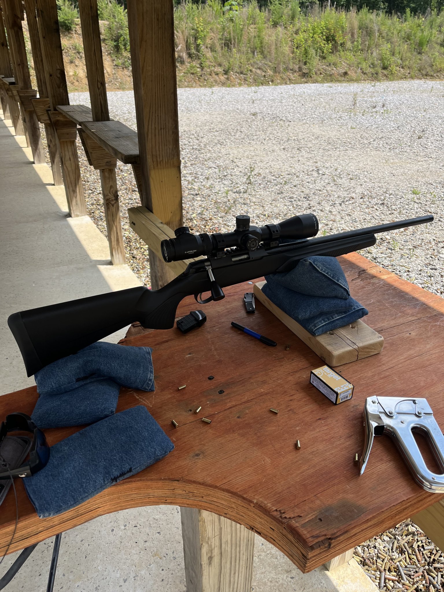

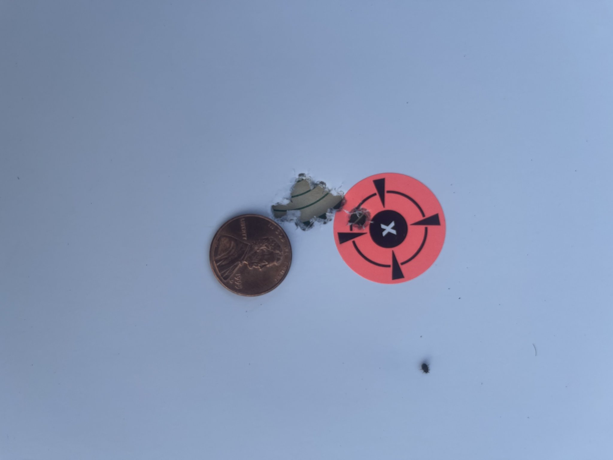

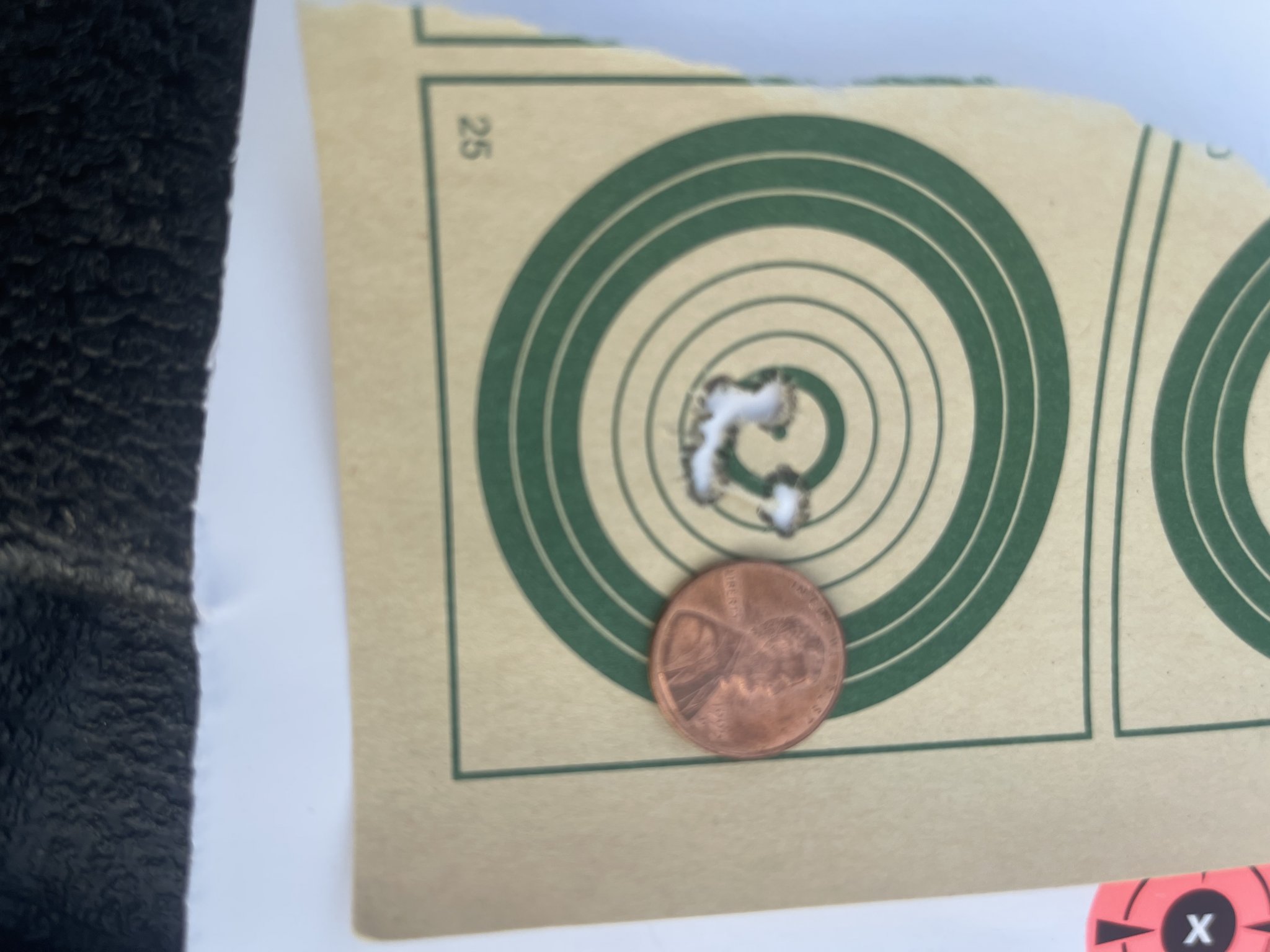

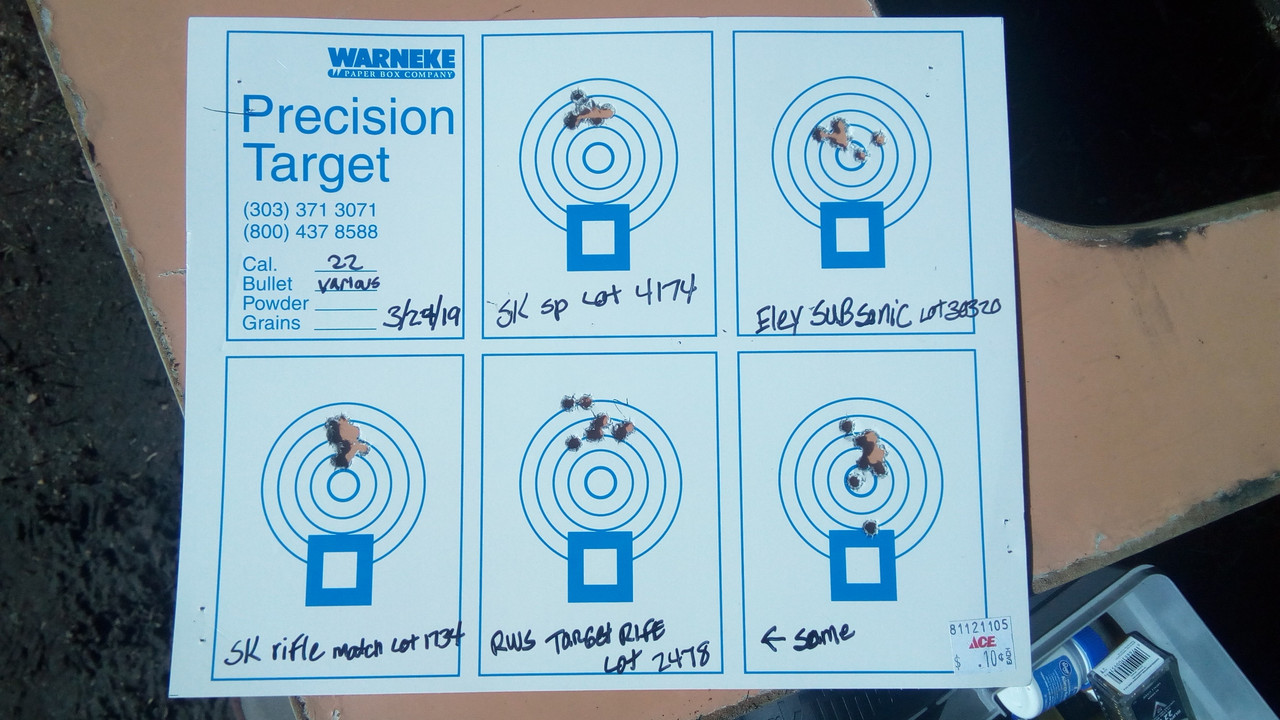

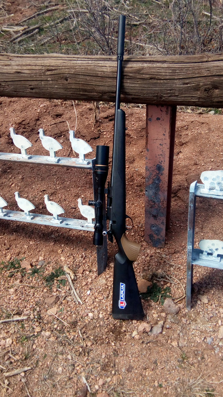

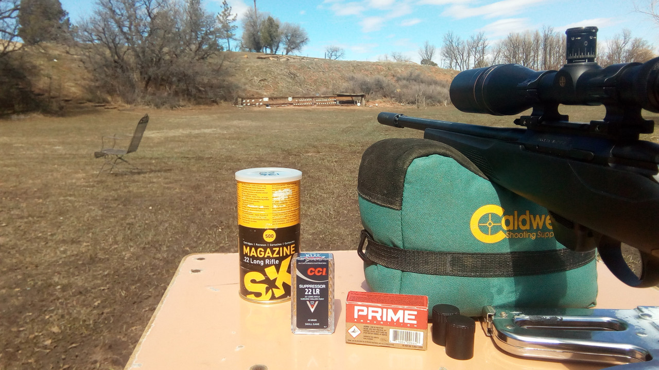

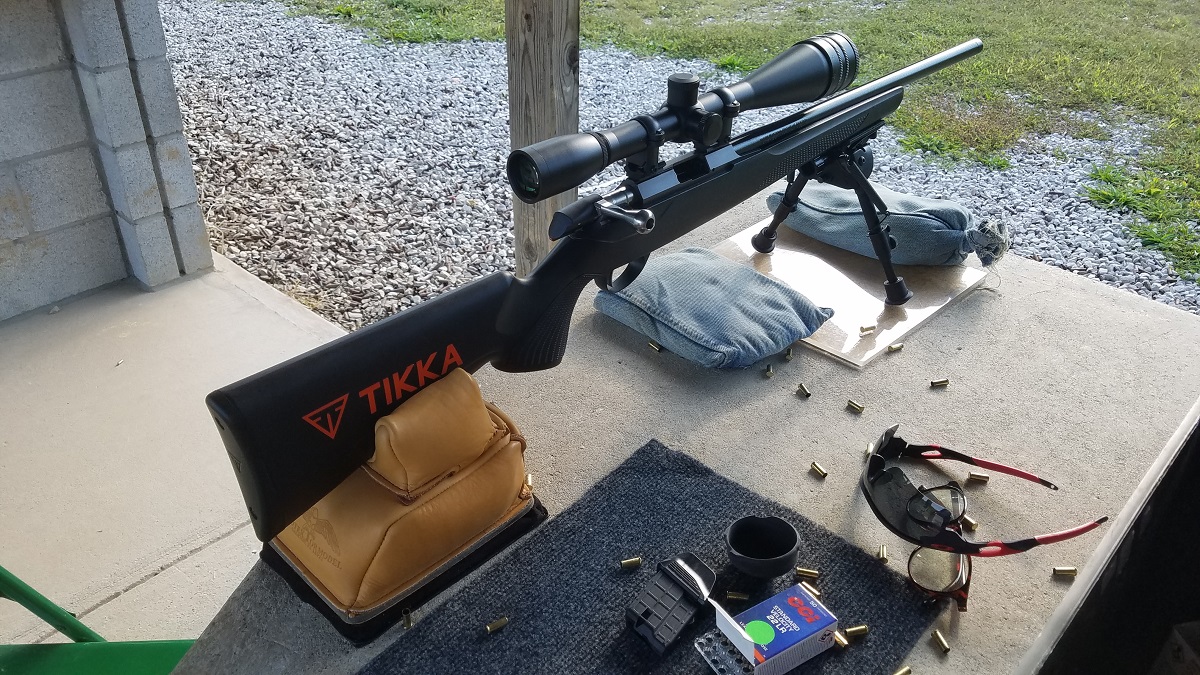

Took my T1X to the range for a little shooting a few days ago, was shooting up partial boxes of various ammo, CCI, S-K, Eley all performed as expected, The Eley Team I used did good as seen on the target, last 15 rounds was Lapua Midas+ which did awesome I fired these after I had shot the other ammos. The rifle has a 36x Sightron, 8 oz trigger, bipod and bag, I was quite pleased.

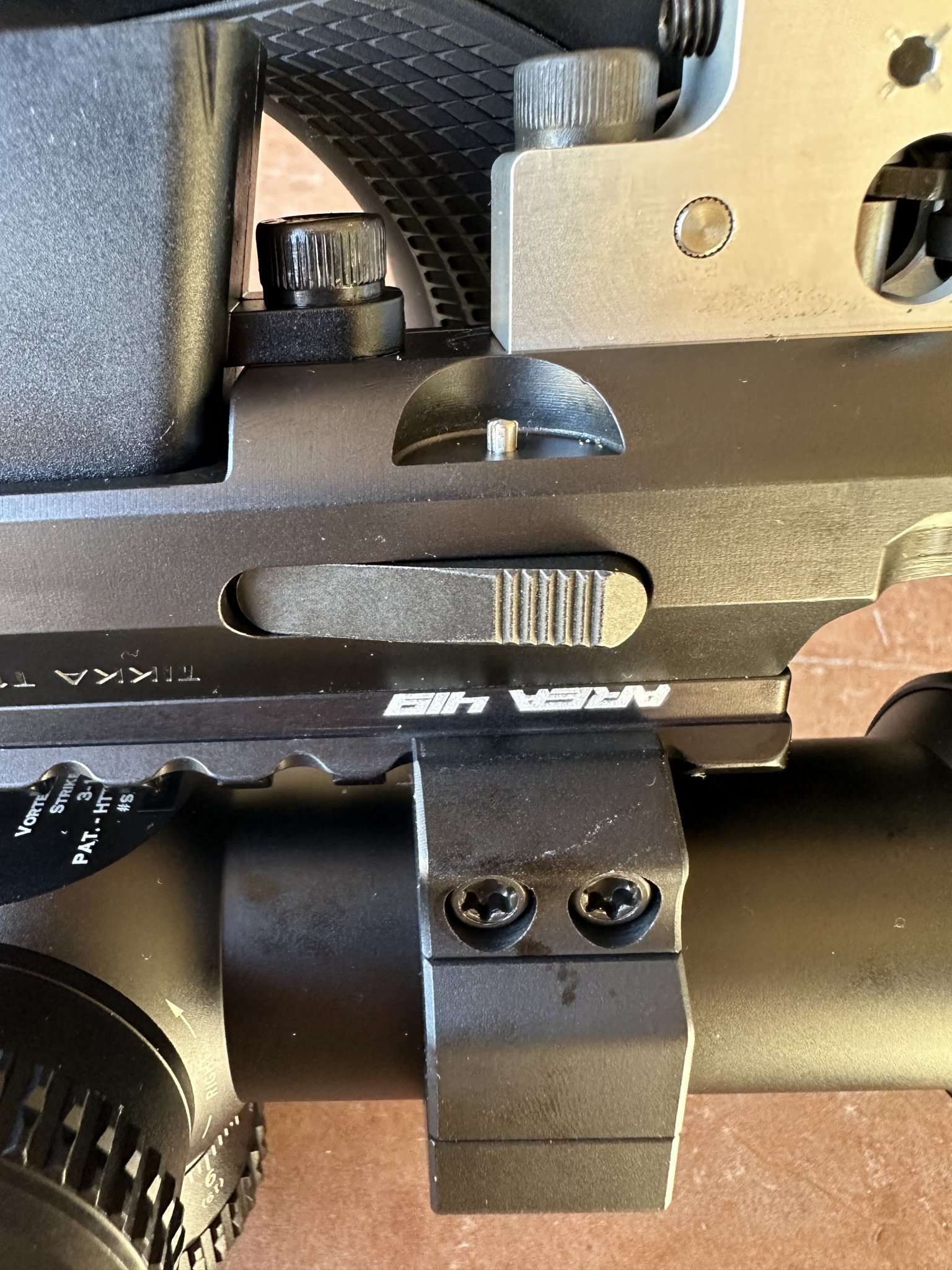

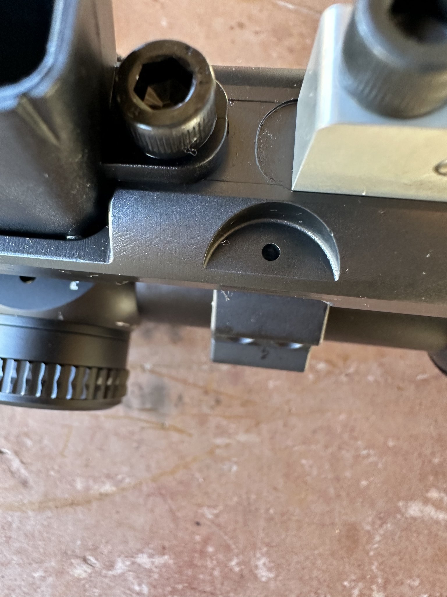

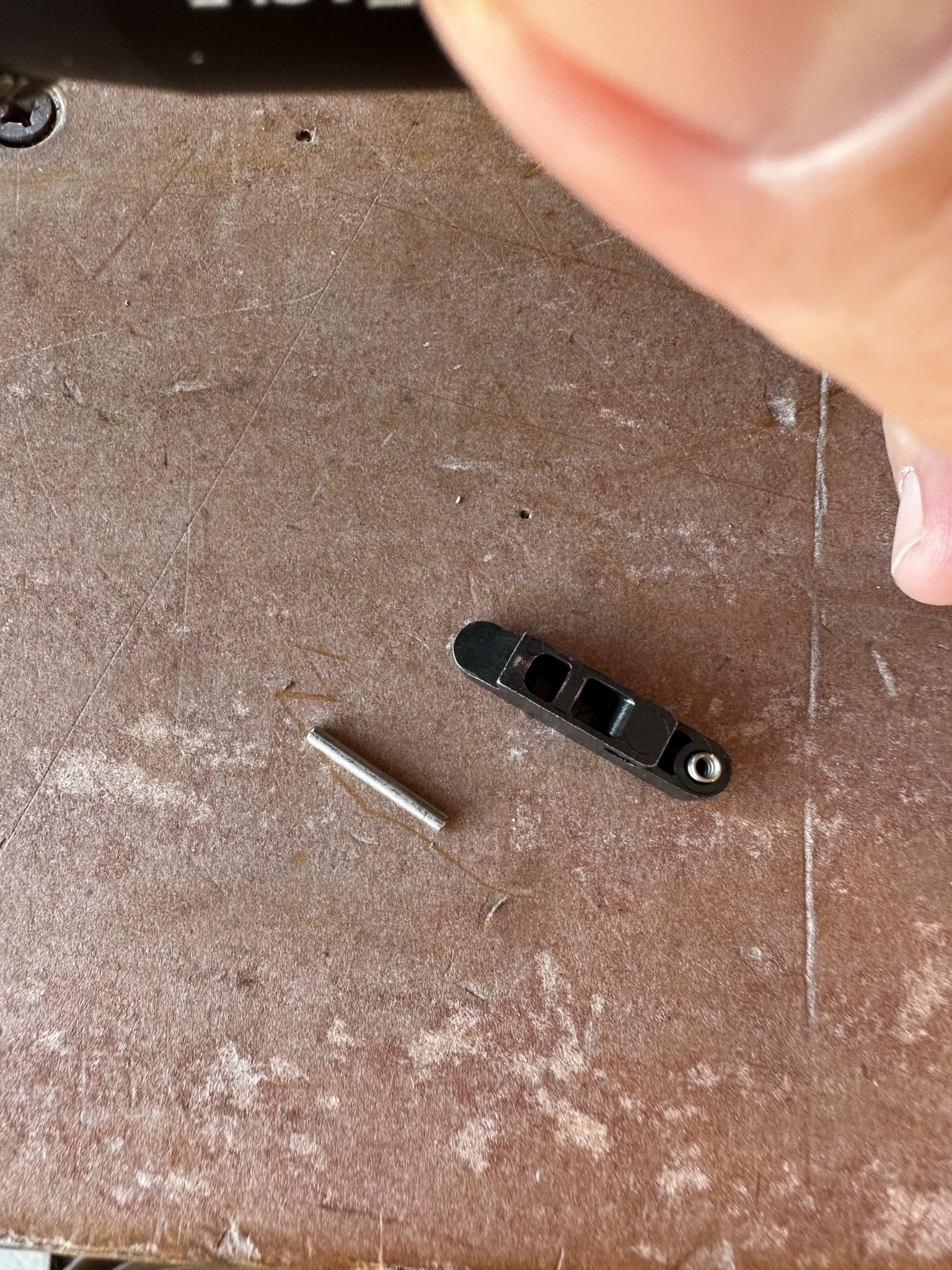

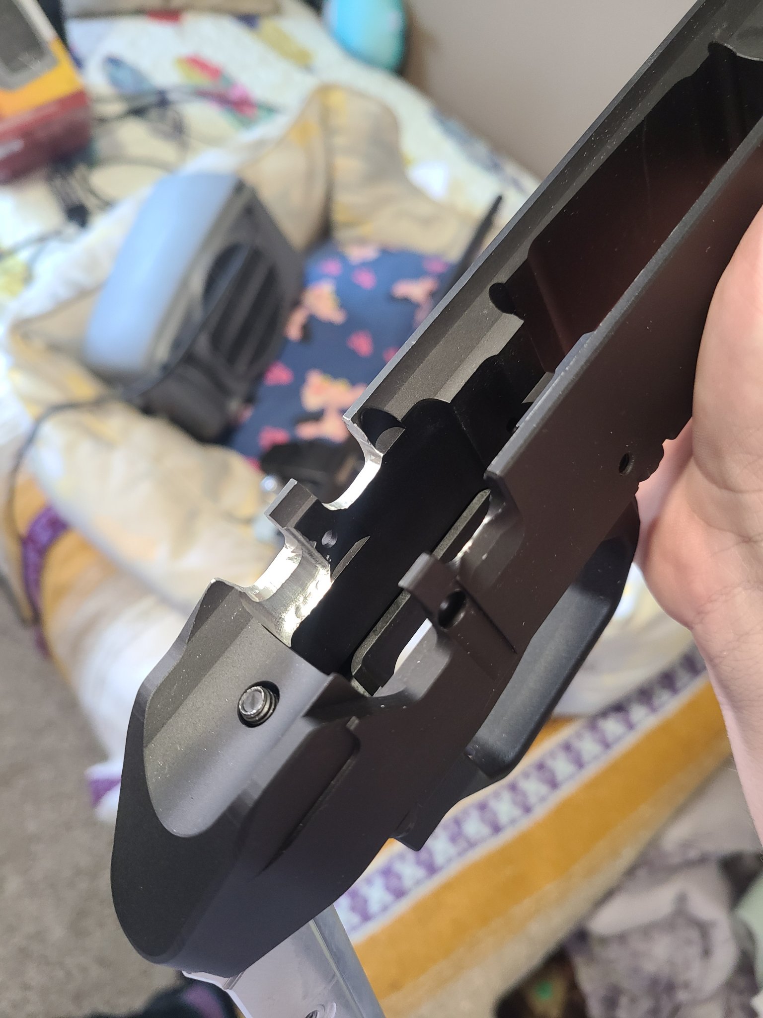

Has anyone had issues with the bolt release pin falling out when cycling the bolt (i.e. when barreled action is installed and cycled you end up with the bolt removed and the bolt release and spring just sitting there not held in. I have to take the stock off to reclaim the pin).
It's supposed to be supported with the stock. It keeps falling out. Beretta says they show '1' in stock and will send it if they "actually" have it.
@6.5SH well fuck me....
@guosim did you get this resolved? Looks like I'm having the same issue...
@USMC22 I feel like a drop of silver solder would keep it in place. Then break it off if you ever need to remove it.

You give that NDR magazine a try yet?
I have, full disclosure it was only 30rds running ammo through it and 30rds actually shooting it. Had a couple sticks when I was just running the ammo through. No issues at all when actually shooting. I was probably running the bolt a little harder then. I have an NRL22 match next weekend I can update after that!
I shot an Nrl22 match yesterday. I only used the NDR mag. 8 out of 9 stages it was flawless. On the last stage of the day the first round took a nose dive into the feed ramp. Pulled the mag, pulled that round out and then it ran great. I've had that happen once or twice with my factory mags too unfortunately. Time will tell but the mag has been pretty good in my opinion so far. It was nice not having to reload on 12rd stages and one 15rd stages.

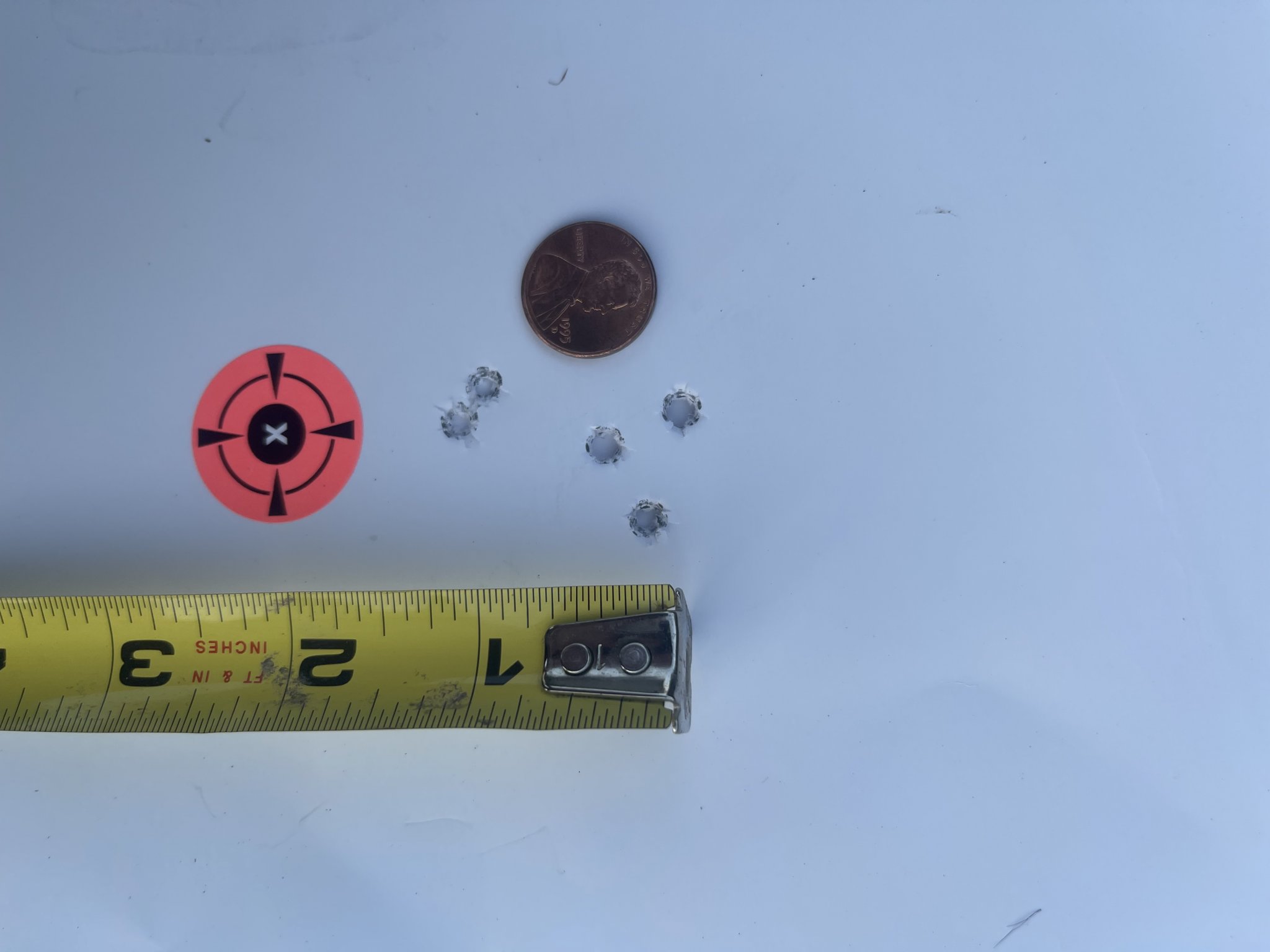

Sk match out of my stock T1x at 100 yards yesterday. Not uncommon to be sub moa. I have never cleaned the barrel in 4 years owning it. Probably 2k rounds through it. I sometimes get bad groups but always have. Just figure it’s me and the inconsistencies of 22lr. Should I clean it.
