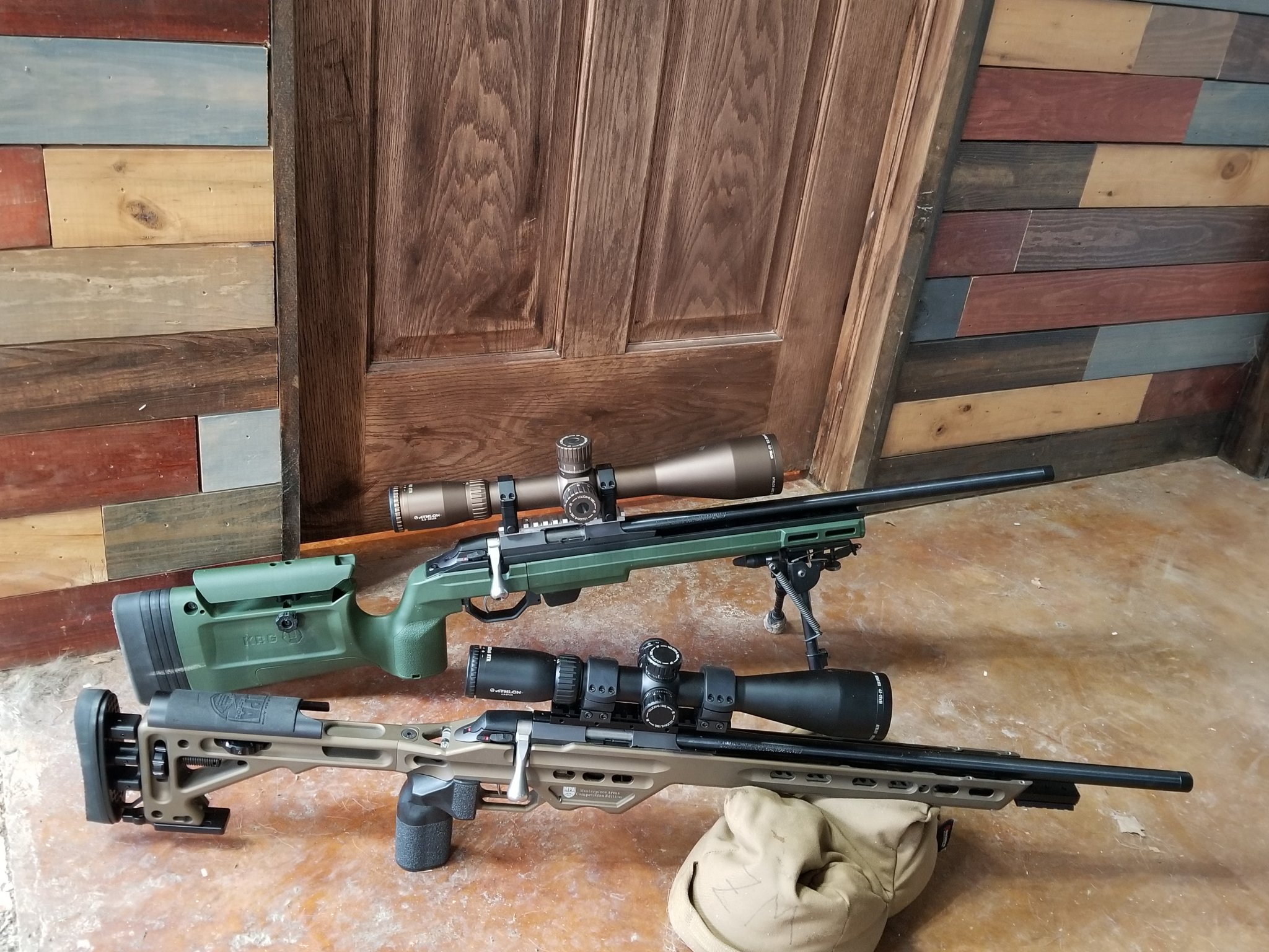

@Prebanpaul I'm still working on my krg bravo for my t1x, but @skinnj1 has done the krg bravo, mpa and tac a1 chassis modifications to fit t1x.

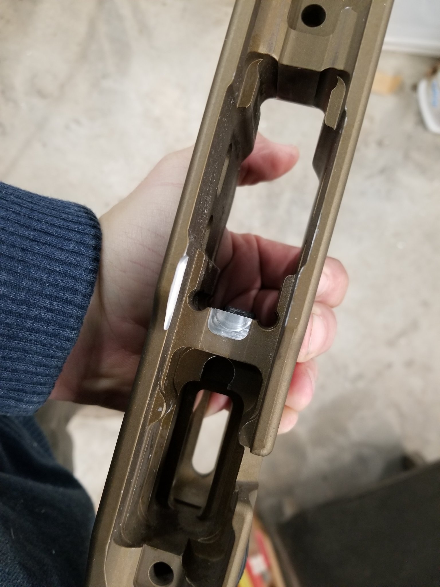

The issue is the cap screw holding on the t1x magazine well. Most composite stocks don't have any material in the way or it's easy enough to remove the fill material. Chassis type stocks using Aluminium seem to often leave material in front of the trigger because up until now it didn't matter that there was material there. I'd say many stock/chassis companies will easily add the machining of the small amount of material to their cnc inletting. That way it's suitable for t3/t3x and t1x tikkas.
Would it be possible to replace the Socket head screw with a button head screw to reduce/remove need for inletting? or is it just my lack of machining/engineering skills showing and there is another reason for the socket head screw?
I have trimmed the head of the shcs to a minimum hex that would work on a low torque situation to minimize what I cut into on the triggergaurd of the krg-the mpa and tac1 chassis one piece designs are not as problematic and you can run an end mill a little deeper without concern if you so choose. There is still enough projection from the plastic housing "tab" alone that inlet modification is necessary this pic shows the "tab" vs screw head- rectangular vs circular inlet cuts

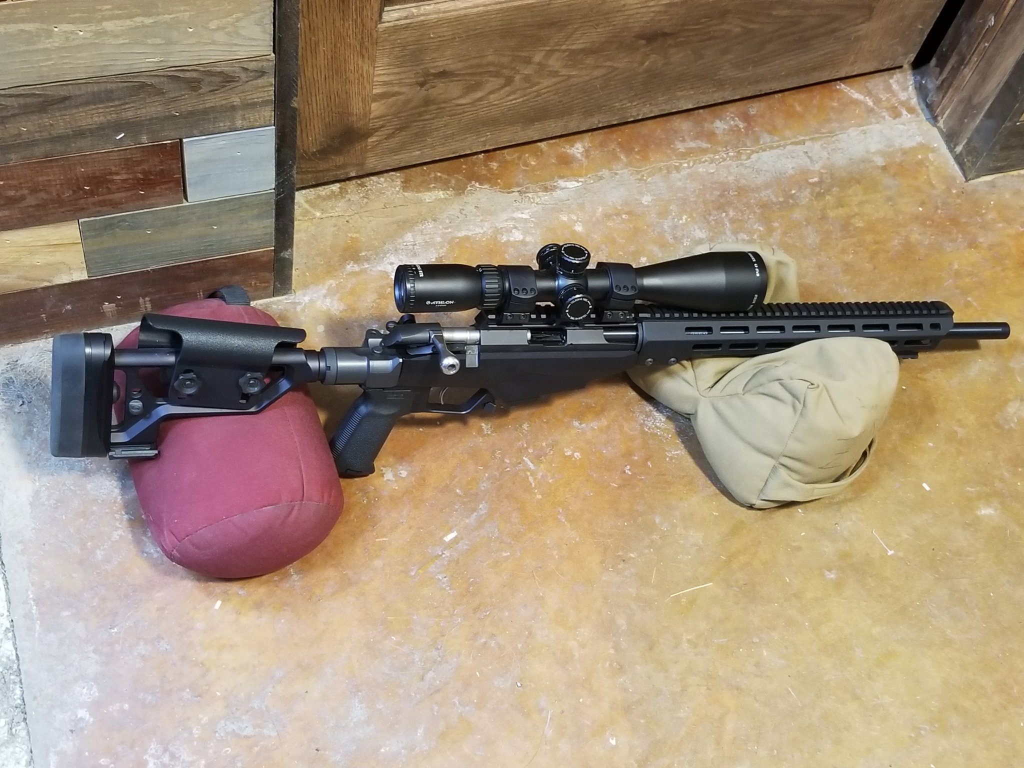

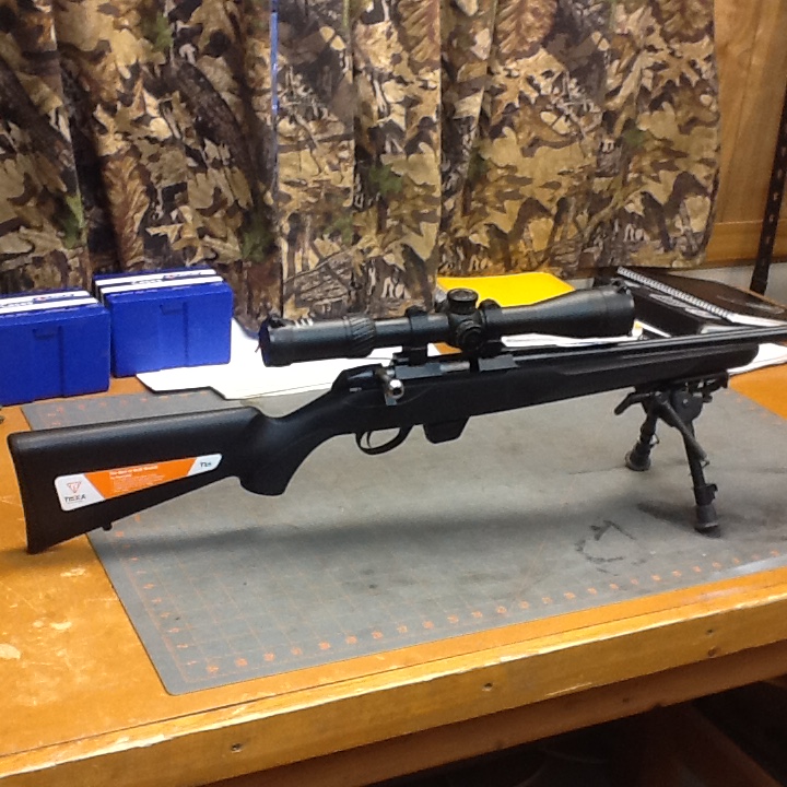

Got mine set up, finally. I have my concerns about the optic holding up, but fellow hiders here say it’s good to go.
-T1X 22lr, 20”
-MCarbo Trigger spring
-DIP 25 MOA rail
-Vortex PMR low rings
-Athlon Midas Tac 6-24x50 with the new APRS3 reticle

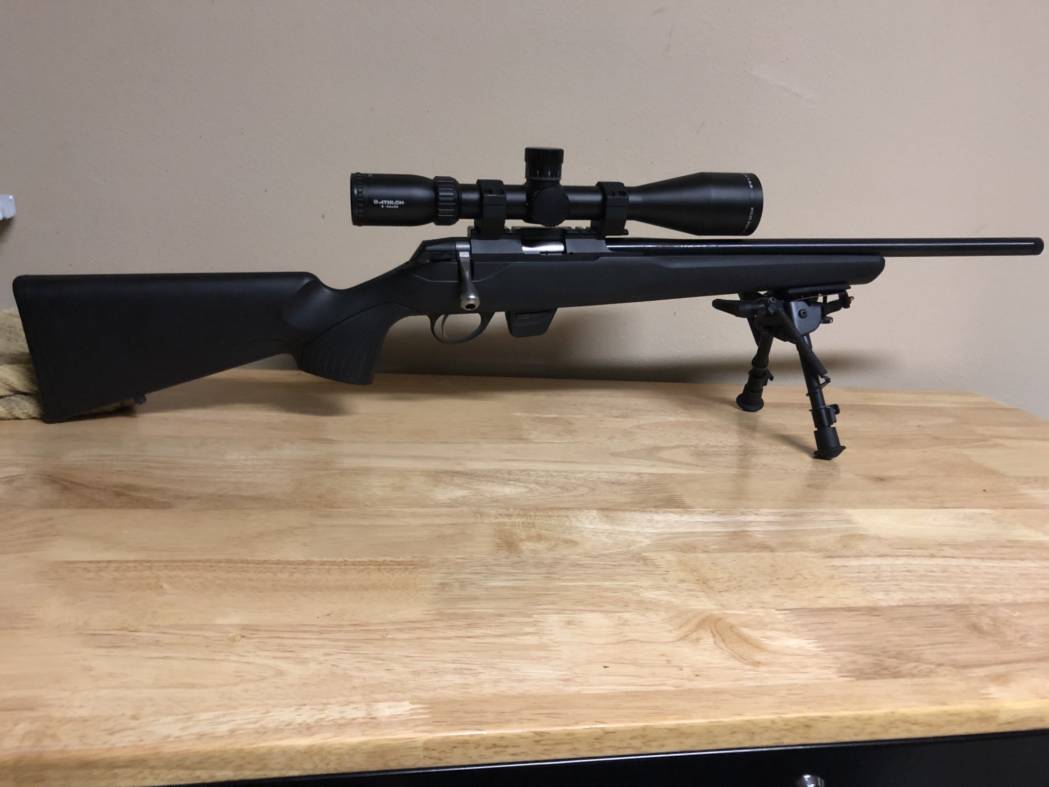

Installed a YoDave spring, 25MOA DIP rail, rings and the scope. Waiting on a KRG stock (hopefully next month) and some decent weather.

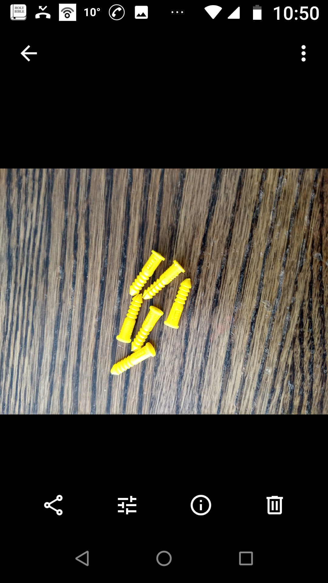

Does any one know if these are safe to fire ??
. I wouldn't dry fire any rimfire...It will do damage to barrel and chamber because they hit on the edge of cartridge....go to hardware store and get yellow wall anchors....they are dirt cheap and feed from magazine chamber and eject in my T1x.......
Does any one know if these are safe to dry fire ??
I meant firing pin not barrel.....
Well these snap caps don't work with this magazine. So will revert to "cocking" practice. Mostly want to run the bolt the de-stiffen. Need about 10,000 cycles or so :D
Yup, I read that ... now I have a snap cap in the chamber and I can cock and fire. Just can't run the bolt all the way back. The snap caps won't cycle in the mag.
