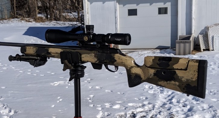

I also dropped my T1x into a Manners stock cut for CTR bottom metal. I used the factory bottom plastic and cut off the nub on it. There is a slight gap around the plastic, but it works well and if I sand the plastic to contour it to the stock lines and maybe use a filler, it would definitely pass the looks test.
Outside of that, it is a great and easy way to get a rifle setup for some legit shooting.

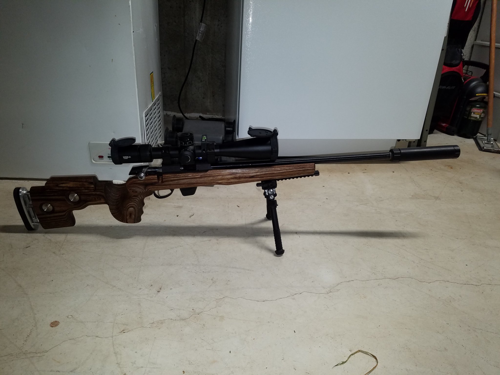

Here's my T1x, grs sporter stock, dip 25moa rail, pst gen2 5-25, trigger spring, flush cups and rail. I've been using Lapua polar biathlon and it's a true one hiker at 50yds. It's holding about an inch at 100 so far. Rifle has about 300rds so far.

got it from eurooptic this last summer, they had them half off! this one is the GRS sporter 103510-GRS . I knew I would want the T1x as my trainer NRL22 rifle, so I bought the stock for it 6mo before the rifle even released. I run a GRS Berserk on my 260 match rifle, so this is a direct copy for training.
That's funny, I was just looking on eurooptic but you'd already answered before I hit refresh. Thank you sir!
yes, that's the brown color, it appears to have more gray brown in person, definitely less red brown than the pictures.
