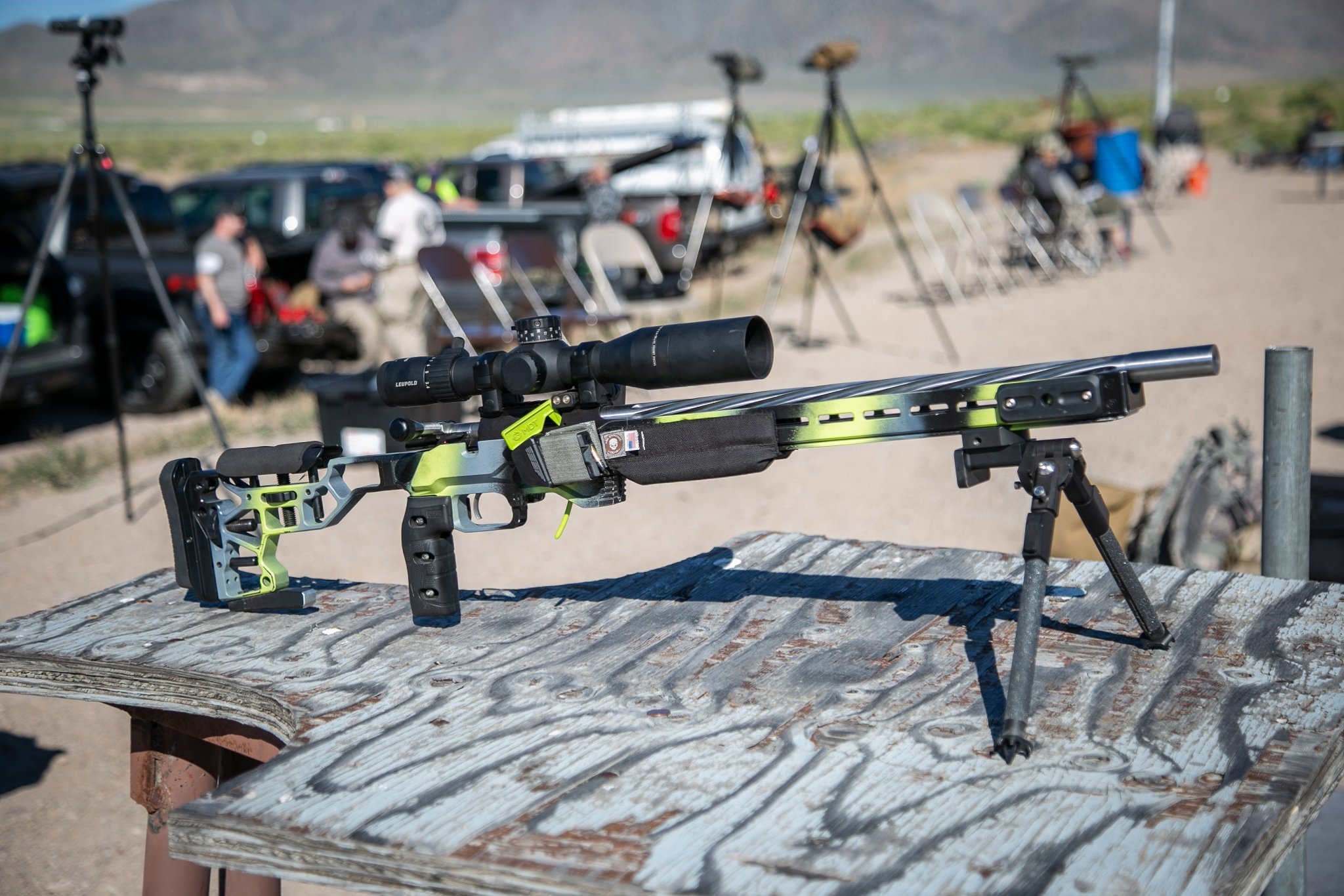

The only upgrade left for her would be to get a McMillan A5-22, that'd be pretty nice overall package.

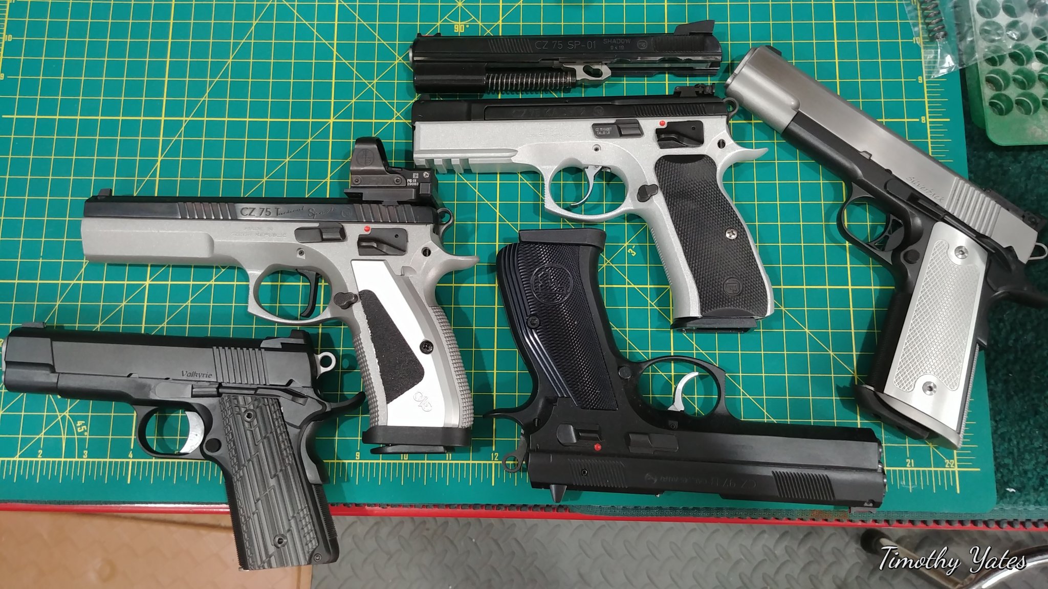

Ahh, that's my Sig P220 Match. It's all Stainless Steel with Aluminum grips. Very very nice pistol but, in all honesty the CZ 97B is just as good at half the price. Ask me how I know. ;) 97B is the all black upside down pistol.

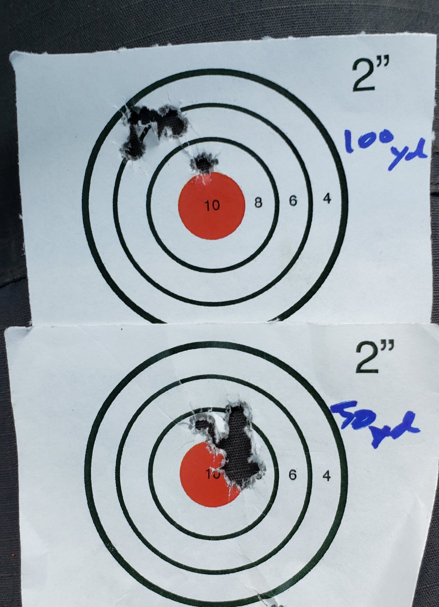

Got a chance to put some rounds through the International Barrels T1X prefit barrel.
This one is a 22" with the Eley EPS chamber (which is a new chamber for me)
these arent for sale yet in the states but will be soon.
shot some test groups through it (pictured) and it really liked SK rifle match, which is awesome because i have a ton of it.
I heated up the factory barrel and removed it, set the headspace at .042" with feeler gauges and away we went!
the Failure to Eject is becoming a real headache. Was hoping the new barrel might miraculously help that issue but sadly, no change. Bent the paper clip ejector, hoping that will do the trick...again.

The more I see this MDT ACC chassis, the more I want one! @3guns2hands are you still shooting your TIkka? I was digging in this thread to find this picture for the last 15min. It also answered my question that it looks like the IBI Barrels are Eley EPS reamed.

I was going to get a shorter barrel, but then I noticed that with the MDT ACC chassis, I'll want at least a 20" barrel to clear the chassis. Though I guess if you're running 16" + a Suppressor that would work also.
