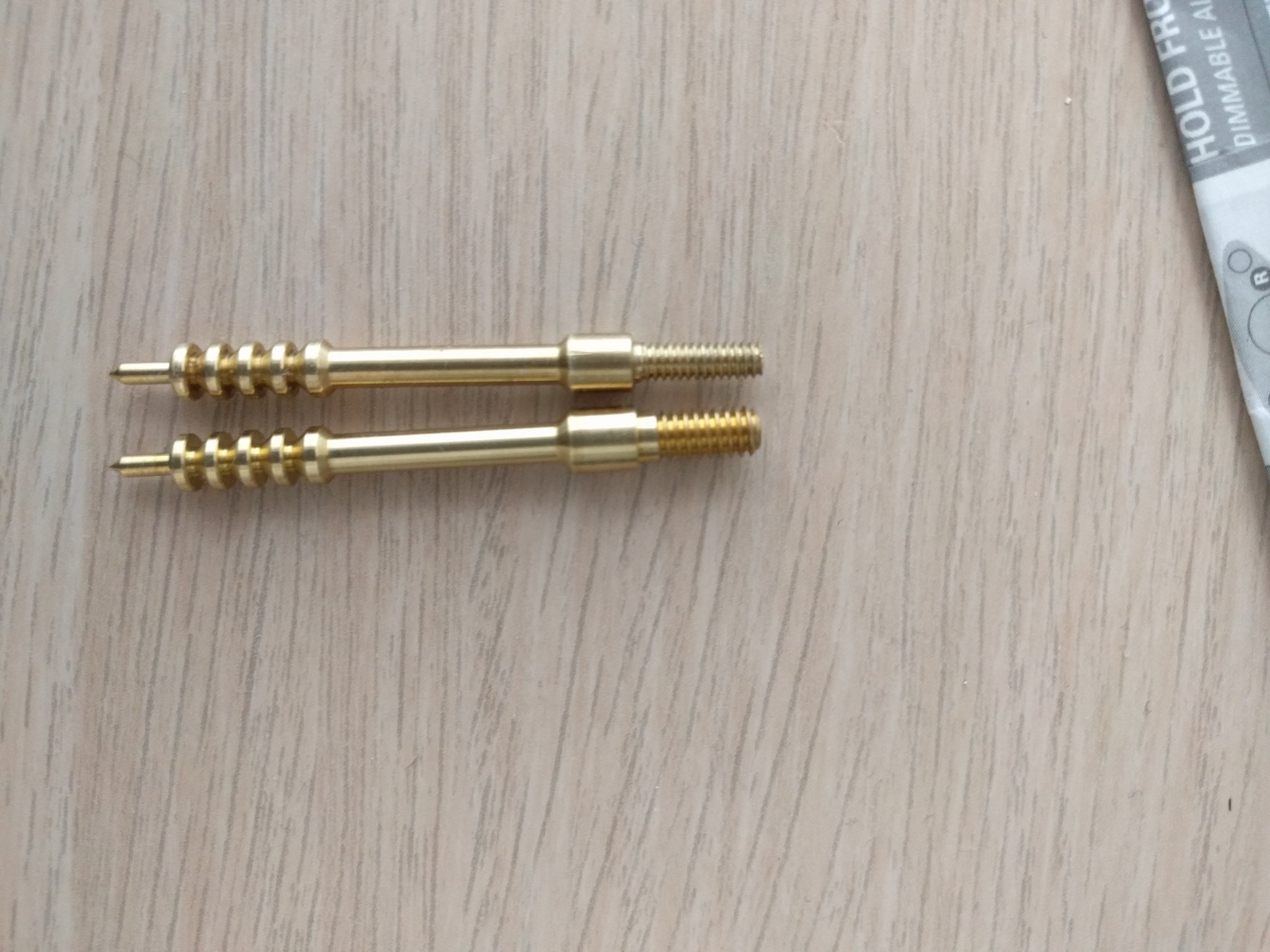

I use 20 cal rods. The thread issue is a bit of a pain.
You can get 5/40 - 8/32 adapters.
You can also re-thread the fittings.
Here's a 22 cal jag that I re-threaded to 5/40 shown next to an unmodified example. I chucked it in a drill, turned down the thread with a fine file and then re-threaded with a 5/40 die. I also turned down the base of the jag to match the diameter of my cleaning rod.

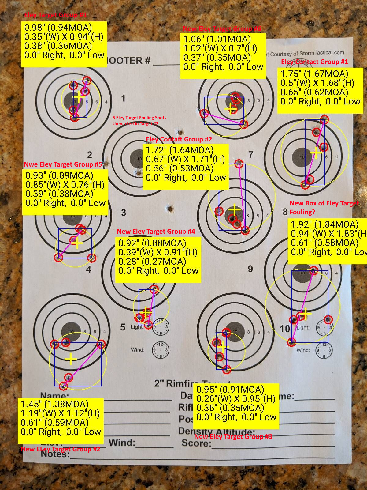

Went out today to test out Eley Contact & a new lot of Eley Target. Got my Atlas bipod back so I was happy to get back in prone and shoot. Shot around 1.1 to 1.5" @ 99 yards. Seems to be the going rate for my $5 a box ammo.
Tested out to 200 yards, and averaged 5-6" groups, shot 10 rounds groups as I was testing out the zero. It was a 6" vertical stringing, with a 2.5" L&R. This matches up with what I'd expect given the vertical deviation at my 100 yard groups. My 100 yard groups are generally .5" left & right, with a 1.5" vertical up & down. They usually say multiple it by 3-4x when going from 100 to 200 yards.
The worst issue was a ton of FTE even with cycling the bolt diligently. In the 75 rounds I shot, I got 5 FTE. After the session I looked in the chamber and running the action is super smooth, like the ejector spring is not providing very much friction. It doesn't protrude very much nor spring all that much either. I tried to bend it with my finger and ended up popping it out so I had to go home and use some pliers to put it back in. I need to try to bend the wire more, but overall, this ejector design is pretty flawed.

I shot about 100 rounds today, Eley Contact, Eley Target, and a new lot of Eley Target (Shiny Gold Packaging). Zero FTE, even with weak extractions, that little bend to the ejector wire really flies those rings out. It's exciting! Here's a mixed sheet of Eley Target/Eley Contact. I shot 5 fouling rounds after going from Eley Contact -> Target. Overall Eley Target shoots better. My adjustment from my old lot of Eley Target is 0.2 mil up.
That little marring on the round doesn't seem to effect the precision. I cycled 10 rounds, and then reloaded 10 rounds so it'd be double marring and no drop off in precision.
Eley Contact @ 200yards, 10 shots.

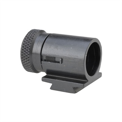

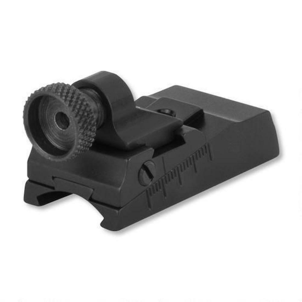

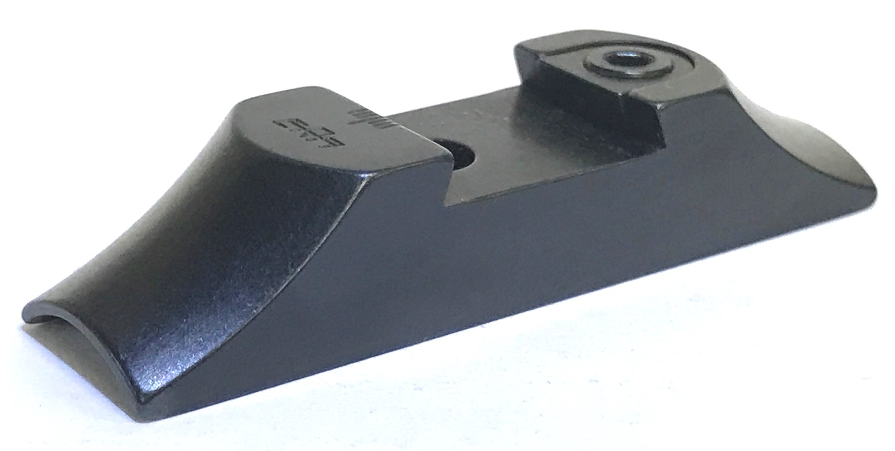

Does anyone make iron sights for the T1x? I really would like an iron sight trainer.
I would bet Williams makes one for the dovetail on the rear, it would be a universal type sight. For the front I would imagine you would have to find another universal type sight in the right diameter and sweat or glue it on.
That would be a good project, I like shooting with peep sights and that's what I would get. That's actually a good idea and gives me a reason to keep my other T1x.
My interest has peaked. So far I have this rear sight that may work.
Here is another.
Reactions: Rant Durden
For a front sight I would get something like this Lyman front globe peep sight. You will have to find a base to mount the peep sight to the barrel. That shouldn't be hard to find, either the sweat on or drill type would work, whichever you felt comfortable working with.

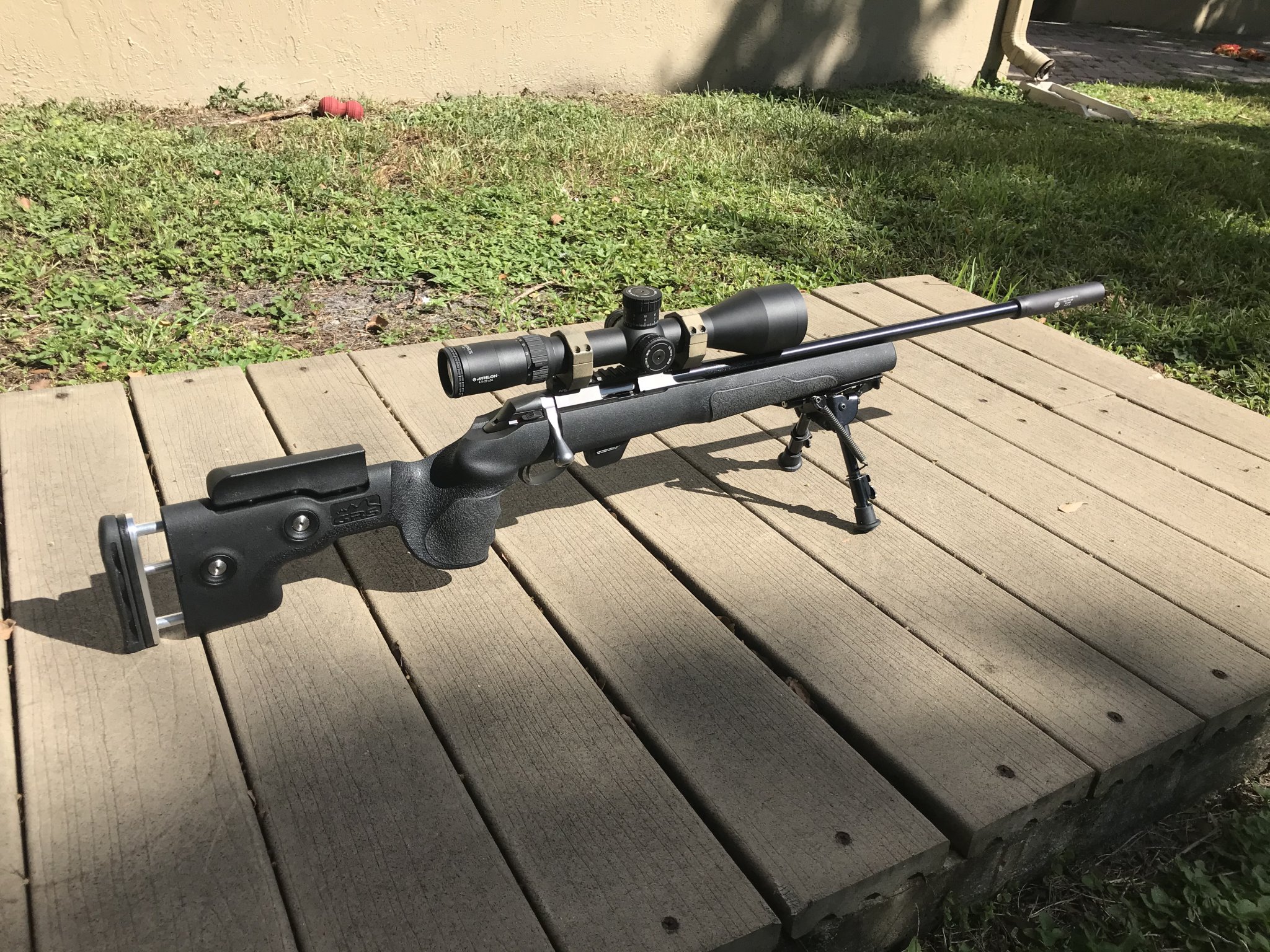

My TRG-trainer:
Tikka T1x 22lr 16"
KRG Bravo T3
TRG-trigger
TRG-bipod
Ase-Utra Eco
DIP rail
TRG-mount
Vortex PST2 3-15

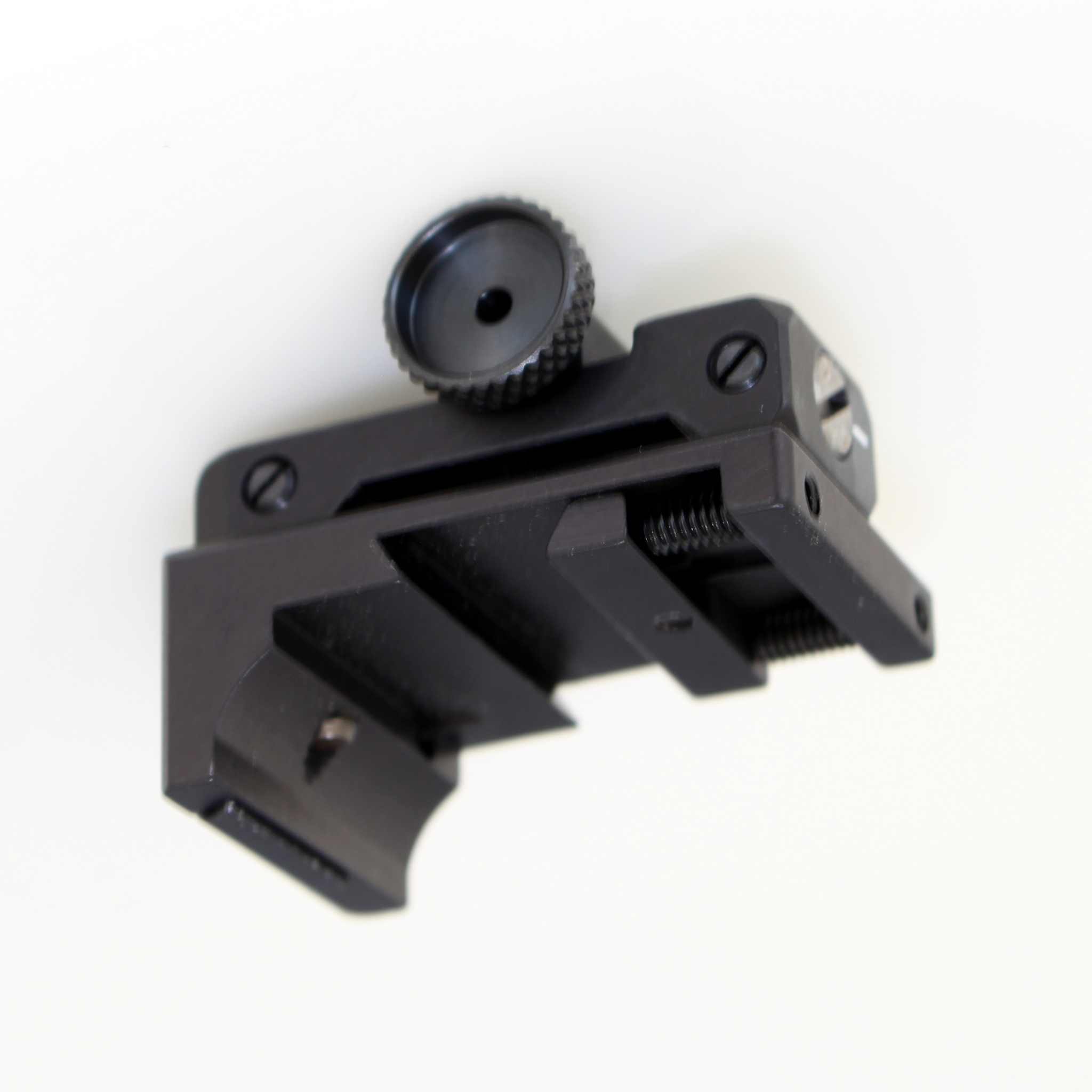

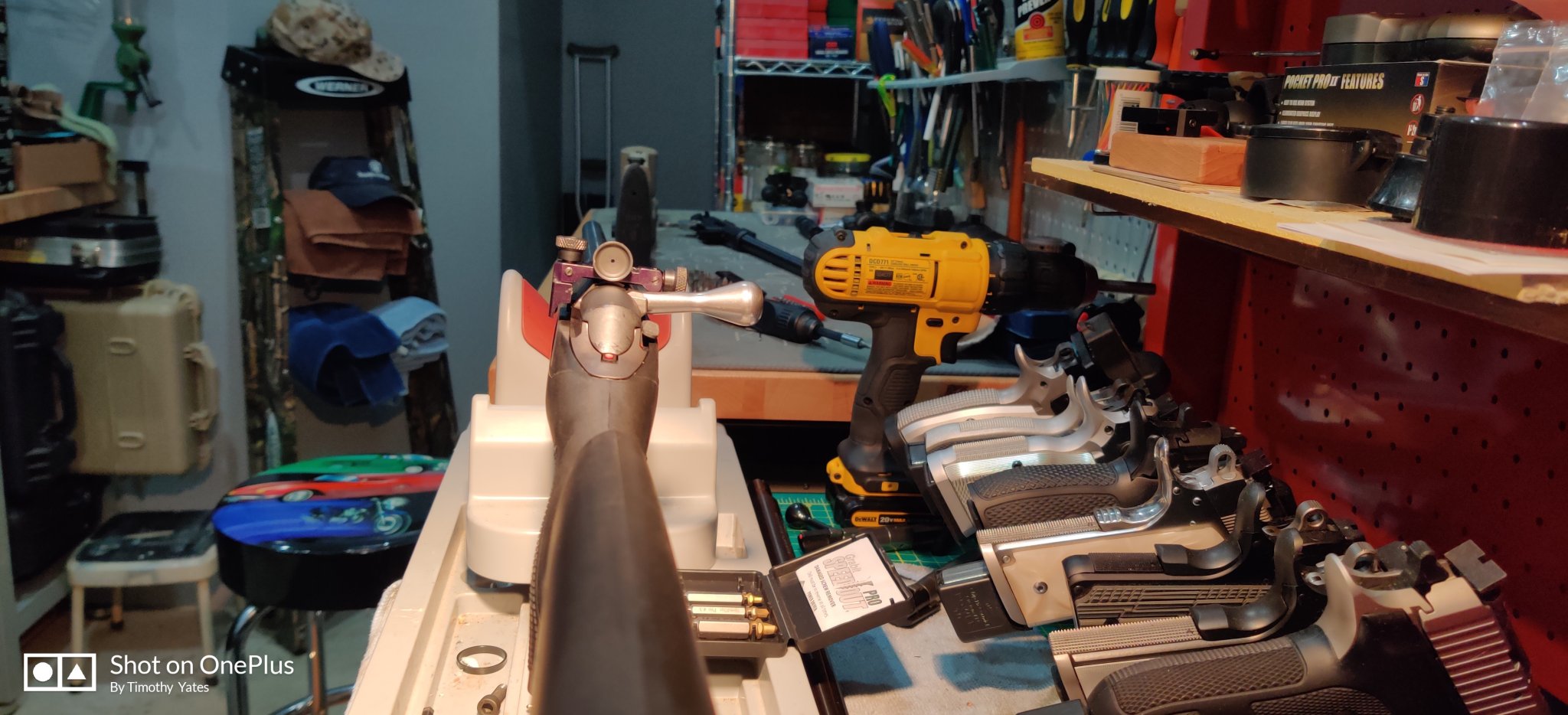

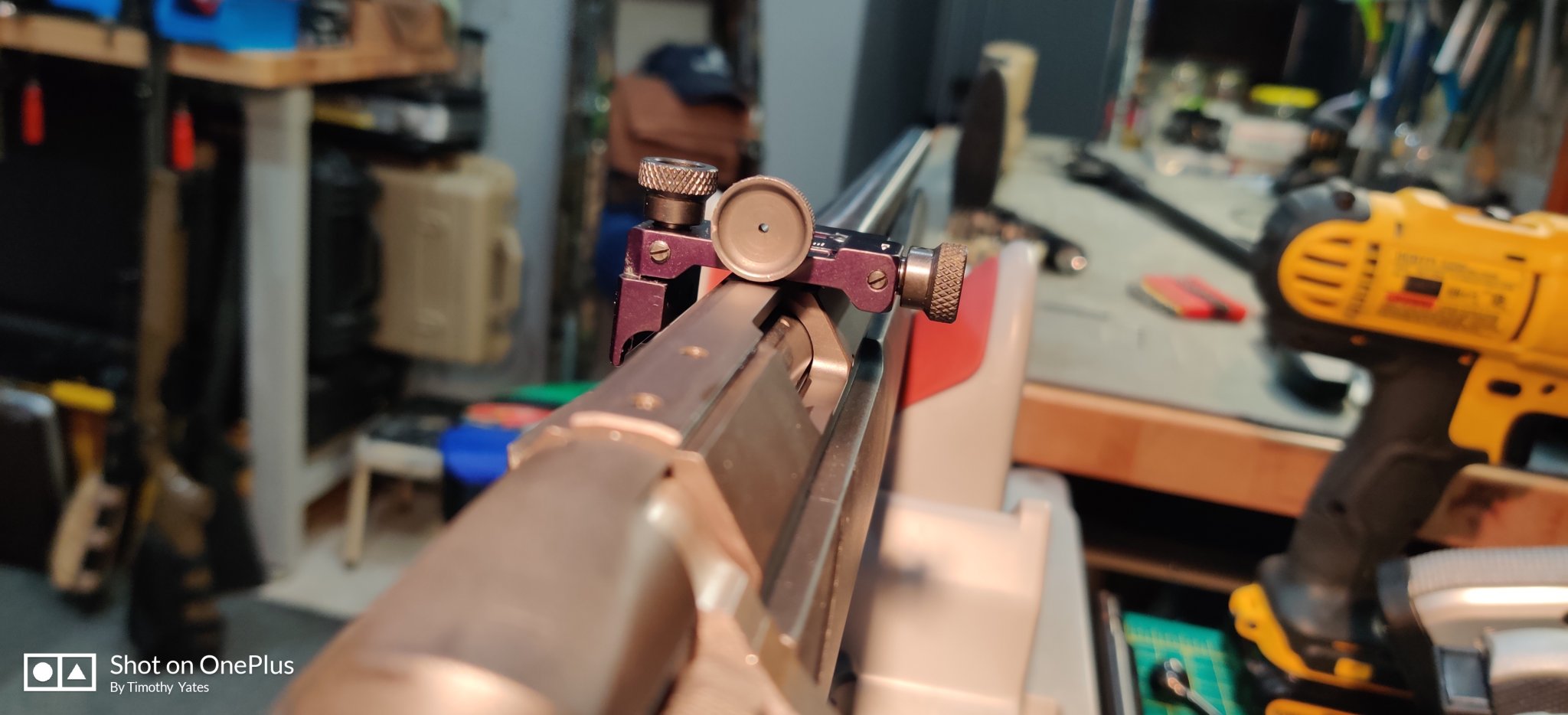

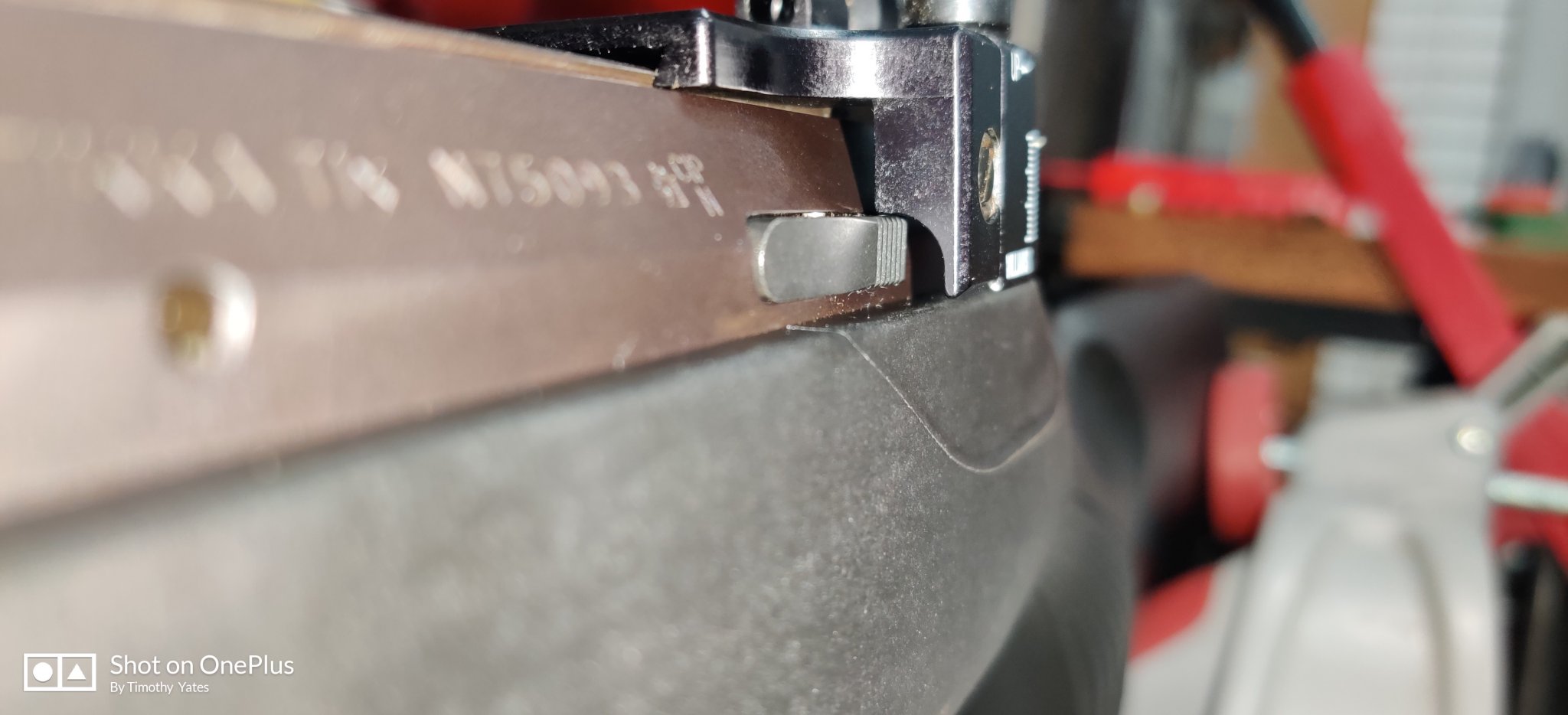

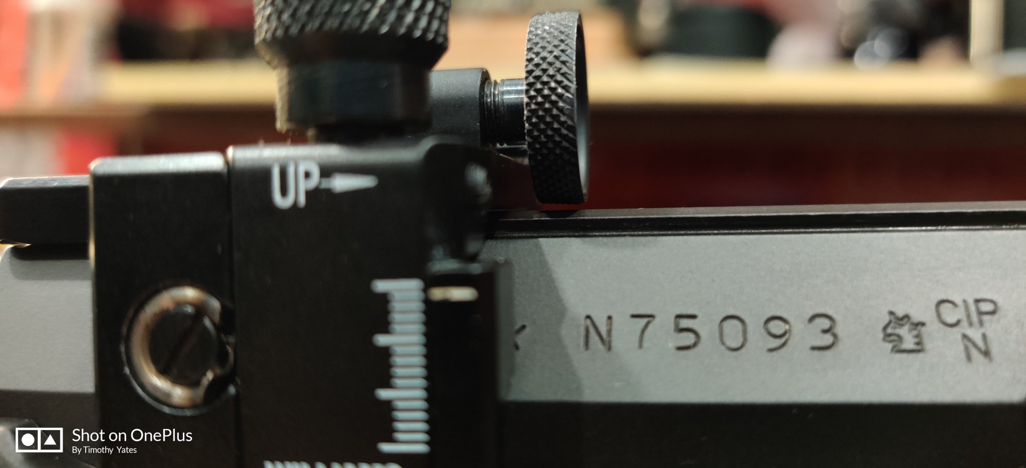

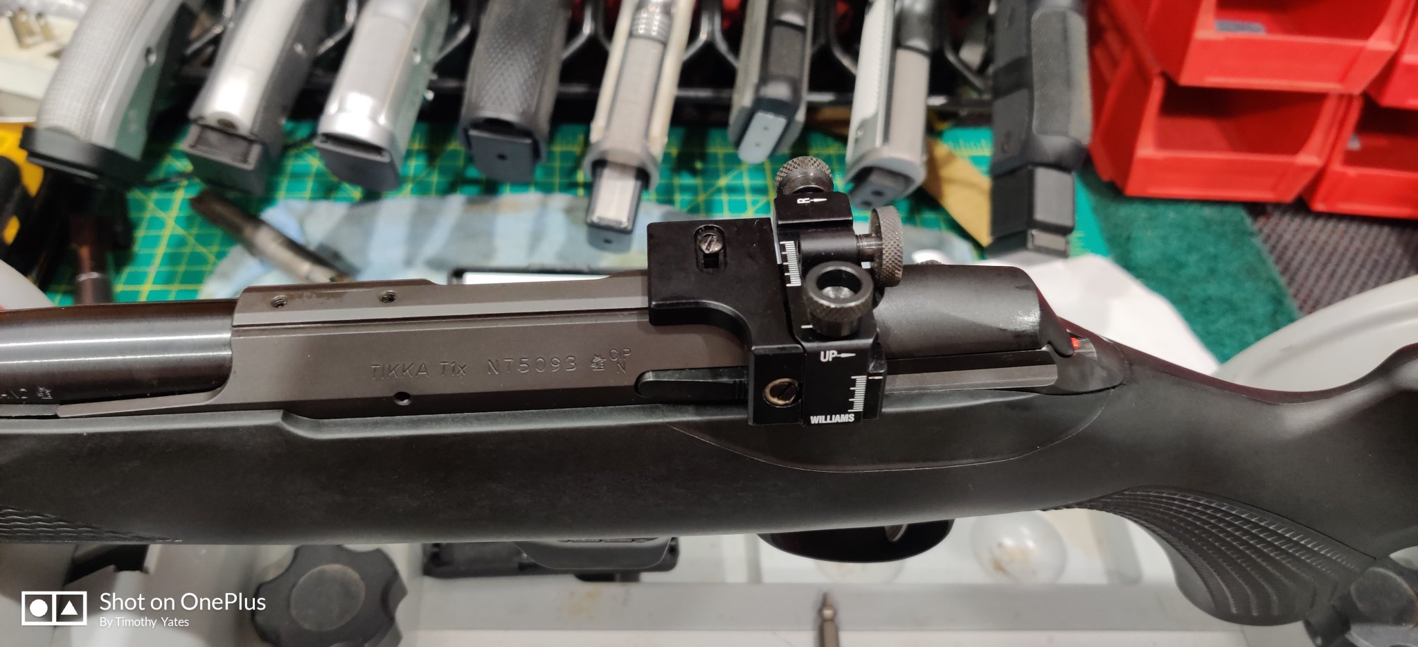

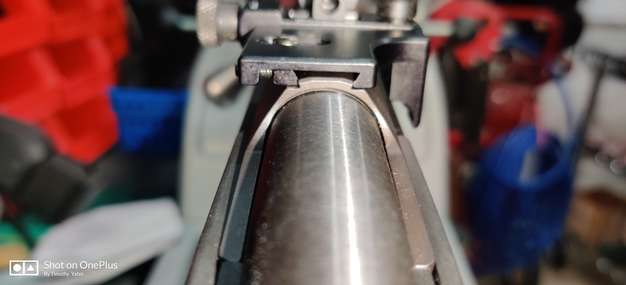

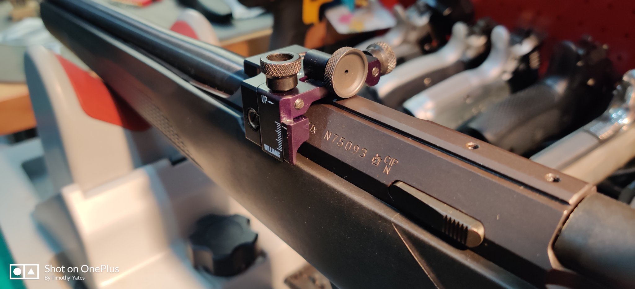

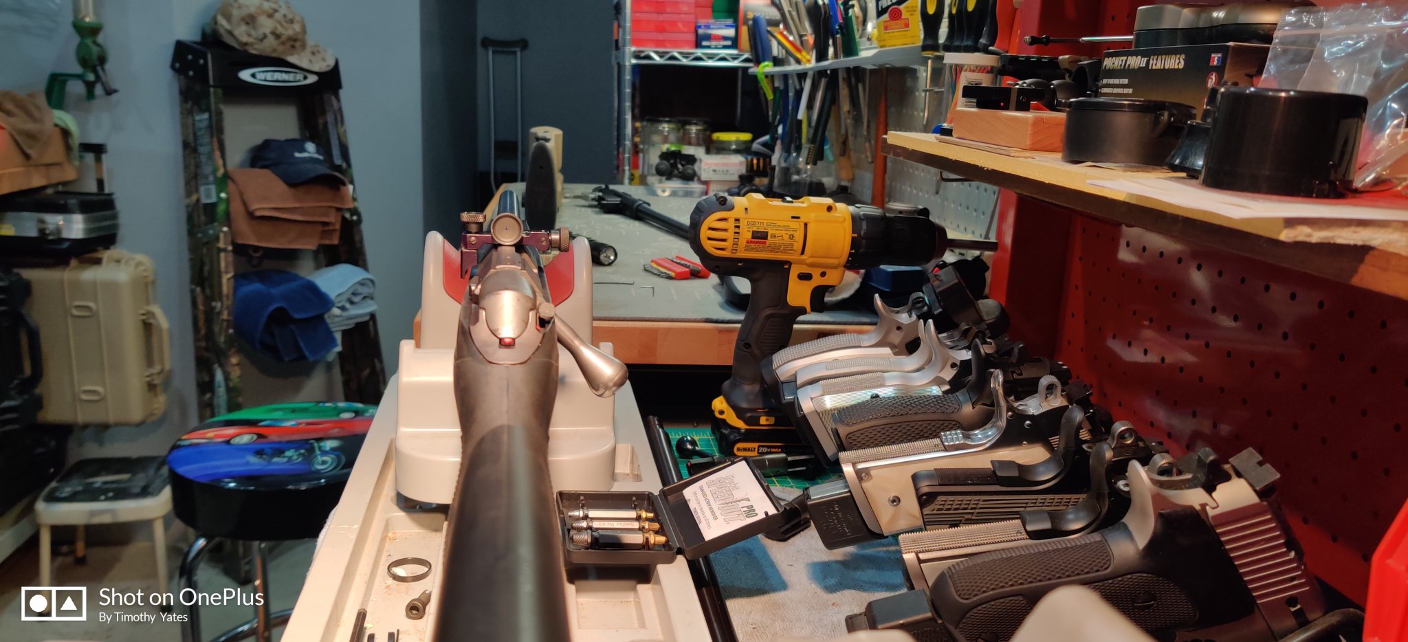

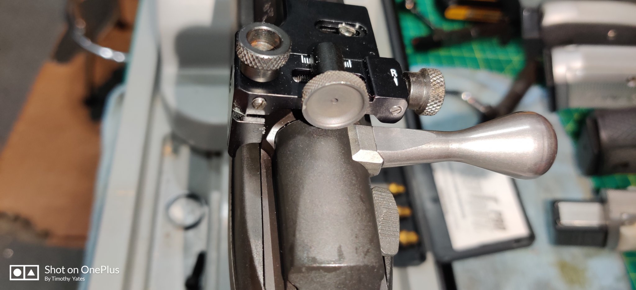

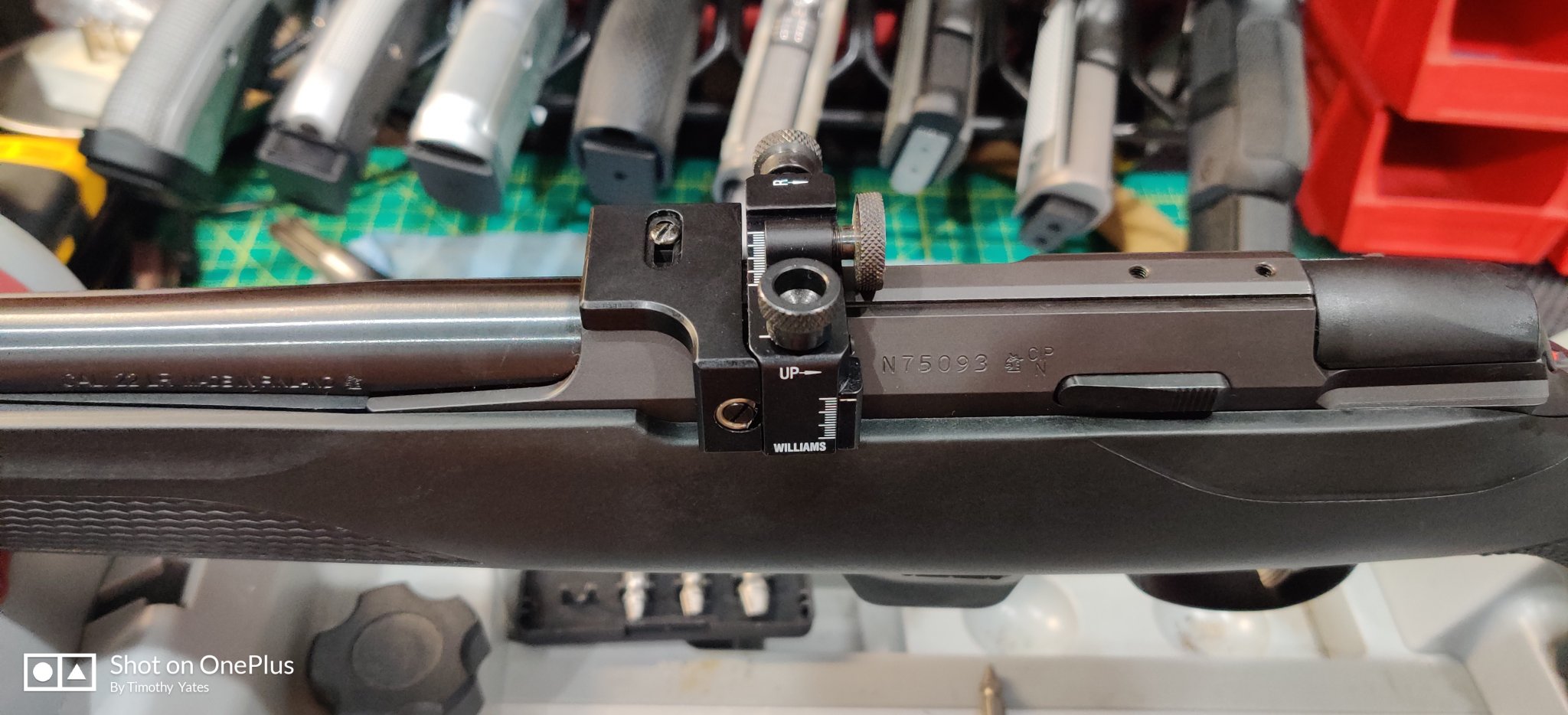

Rant Durden, this is for you.
Here is the Williams rear peep sight I have for my CZ 452's. It will work on the Tikka if mounted on the forward section on the dovetail rail. It can be mounted on the rear but a small portion would need to be removed with a dremel tool so as to not make contact with the bolt release. I prefer it in the back for the longer sight radius but it really depends on how my eyes see the sights. Here are a few photos showing what I have. I measured the barrel and it's the same diameter for at least a couple of inches back from the threaded section. This makes it a lot easier to mount a front base.
Here are a few photos with the sight in the rear position and showing where it hits the bolt release.
Here is the contact area, very very minimal and could easily be removed without affecting the integrity of the sight.

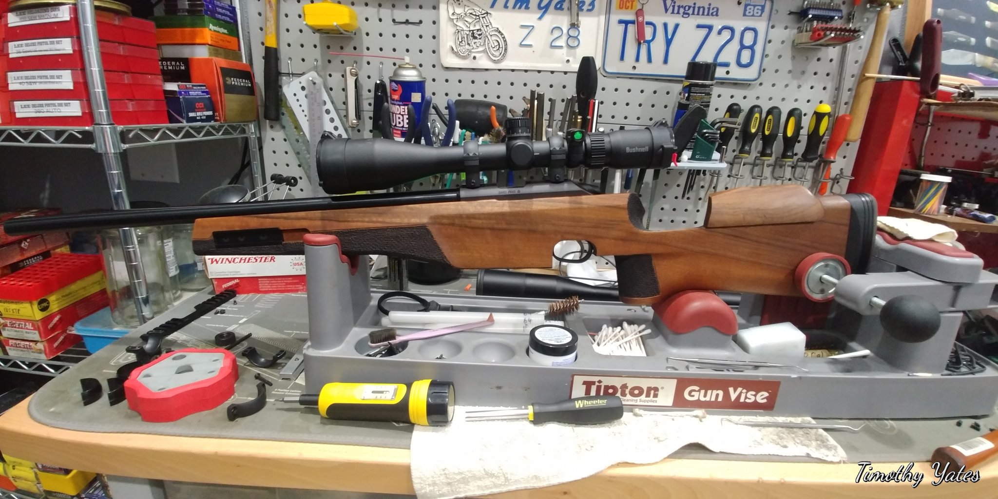

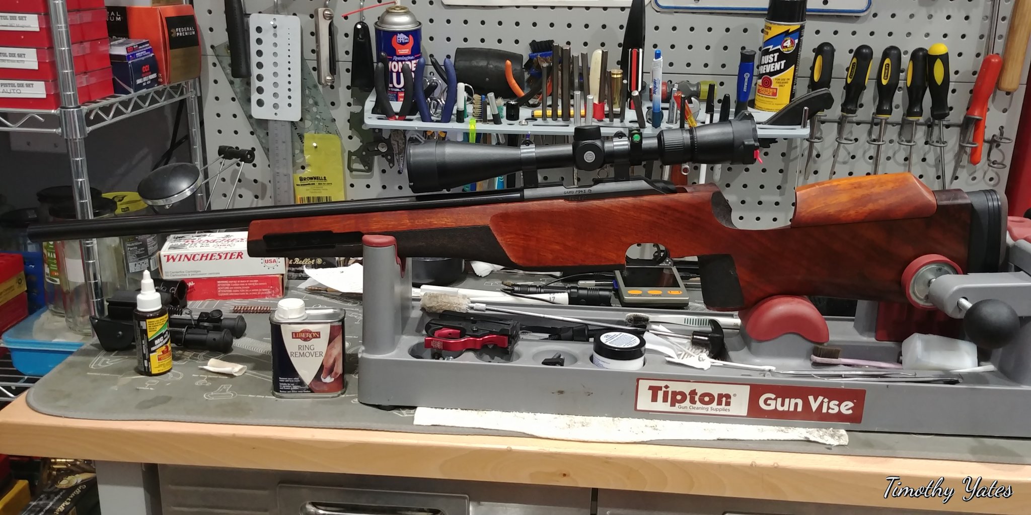

After seeing how this gun's barrel is retained (the set screws mashing the barrel) I think it explains the very different accuracy some people are experiencing. I think how heavy handed the factory assembler is could vary how the bore is constricted at this most critical place on the barrel...ie...at the throat of the bore.
If you slug a quality barrel you can feel ANY outside constriction (even a slightly over torqued tuner on the muzzle, or if a threaded bbl is over torqued to the receiver) in the bore. This is not as critical in a gun using a jacketed bullet, as brass has "spring" and will not be as affected by a tight spot in the bore.
BUT...pure lead (.22 RF) is "dead", ie...it has no "spring back" and ANY deformation of the bullet in the bore stays deformed after the constriction.
If it was me, I would not use the highly torqued set screws to install a new high end barrel (I would even fix this on a FACTORY bbl).
I would do the following:
1. Remove barrel, make sure ALL old adhesive is removed from receiver. Temporarily install new barrel, set headspace (.042 feeler guage), and LIGHTLY torque setscrews in proper location.
2. Check function, go out and shoot a couple boxes of shells and make sure everything works properly (fix/adjust as needed).
3. Tighten/loosen the REARMOST (the one only over the chamber) setscrew several times as to make a little divot in the barrel...just so you can put the bbl back in EXACTLY the same spot on reassembly (you'll be able to see and feel the setscrew go back into the divot upon reassembly).
4. Disassemble everything, clean everything with brake cleaner to degrease. I'd use Rocksett (or one of the proper Loctite compounds) and coat all mating surfaces, then install the barrel, and replace the setscrew (just to locate the bbl.). I like Rocksett, as you just have to soak overnight in water to remove, no heat needed.
5. When cured, loosen the setscrew.....I would probably reinstall the three setscrews with blue Loctite at very low torque (ie...only use short end of allen wrench to tighten).
This would relieve the bore mashing stress of the three setscrews. Might even make a factory barrel shoot better!

Several questions were brought up over the last two pages of this thread - thought I'd throw out some info/opinions in reply. On the cleaning rod - I bought a 20 cal SS rod several years ago after building myself a CF rifle in 20 VarTarg, and since the hammer forged bbls on the two CZ457s I bought have very tight bores, decided to use the 20 cal rod I already had. I did buy a 5-40/8-32 thread adapter from Pro Shot to allow me to use .22 jag & brushes that have 8-32 threads on this rod. ProShot's p/n is: 17AD, which cost $2.99. I still use this rod, even after removing & replacing both OEM CZ bbls with Shilen select match ratchet rifled blanks.
Lilja offers 'drop-in' replacement bbls for CZ 455/457s, but they cut a pretty deep set of 'divots' (for lack of a better word) for the CZ grub screws to bear against, which is what locks the bbl into the action. I didn't want to mill those cuts in the shank. For one thing, I'm lazy, and didn't want to go through all the work to set the bbl up in my mill to get the cuts in the right place. More importantly, I didn't want those cuts removing so much steel right over the chamber, and possibly letting the bore expand a bit at the deepest point of the cut. I used Loctite #609 retaining compound to glue the bbl into the action, which was not only simpler (once I'd gotten the shank cut to length to insure proper headspace), but also means there's no stress on either the bbl or action created by torquing the grub screws in place. I mention all this because a person could use the same method of bbl retention on a T1x. I should mention that #609 can be softened with heat - it's supposed to soften/break-down at 280*F, but after having to remove the Shilen that I'd glued in on my 457 American due to having set headspace too tight, I found that you'll see a little puff of smoke and the bbl will pull right out when temp reaches about 265*F (was checking temp with an infared temp sensor as I heated the 457s action with a butane torch). Perhaps this is what you guys need to resort to while trying to remove a T1x bbl?
Yes, the Vudoo V-22 has 90* bolt throw - that's what you get with a 2-lug bolt, no way around it. I've built myself repeaters on Stiller 2500XR, a couple of jelrod-converted 40X repeaters, and three V-22s, plus another V-22 for a customer. All these actions have 90* throw, which is all I ever ran until getting the 457s, so I was very used to it. Bear in mind though, that spreading the throw required to cock the firing pin over 90* means the cocking effort is easier than when cocking a bolt on an action that has 60* throw. Simply stated, the angle of the cocking ramp is steeper on a bolt with 60* throw than it is on one with 90* throw. My V-22s run so smoothly that there's almost no comparison to how easy it is to run their 90* throw bolts vs. the 457s' 60* throw - even with extended bolt handle knobs on the 457s (which, if you didn't already know, have threaded handles for easy changing of the knob).
Lastly, I've chambered all the bbls I've used on all the above mentioned rifles with a PTG EPS reamer. They all handle & shoot SK/Lapua ammo just as easily as they do Eley, even though SK rim thickness averages .041", while Eley is .037". I typically shoot for .042" headspace. Mike Bush's RAVAGE reamer is designed to be optimal with Lapua Center-X; since I've not seen a reamer print for it, I can't say how or where it's different from my EPS reamer. I do have a Bartlein bbl w/RAVAGE chamber on one of the V-22 bbl'd actions purchased last year, so have compared accuracy out of it to that of the several bbls (Benchmark, Krieger, Lilja, Shilen) I've chambered with my EPS. Either I'm not a good enough shooter to tell the difference, or there isn't that much difference. I wouldn't worry about getting a special reamer ground for use with SK/Lapua ammo, at least, not based on my experience with my rifles. BTW - I've shot several recent lots of Eley Match (with the EPS bullet form) through my rifles, and they all shot it about the same as the best lot of Lapua Center-X I have. I don't run the EPS ammo in matches because it doesn't feed as smoothly as round nose ammo.

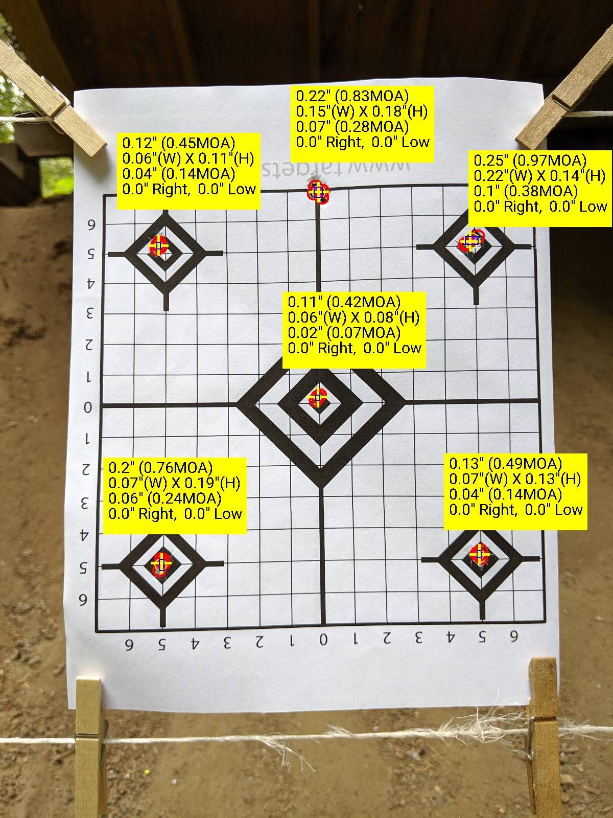

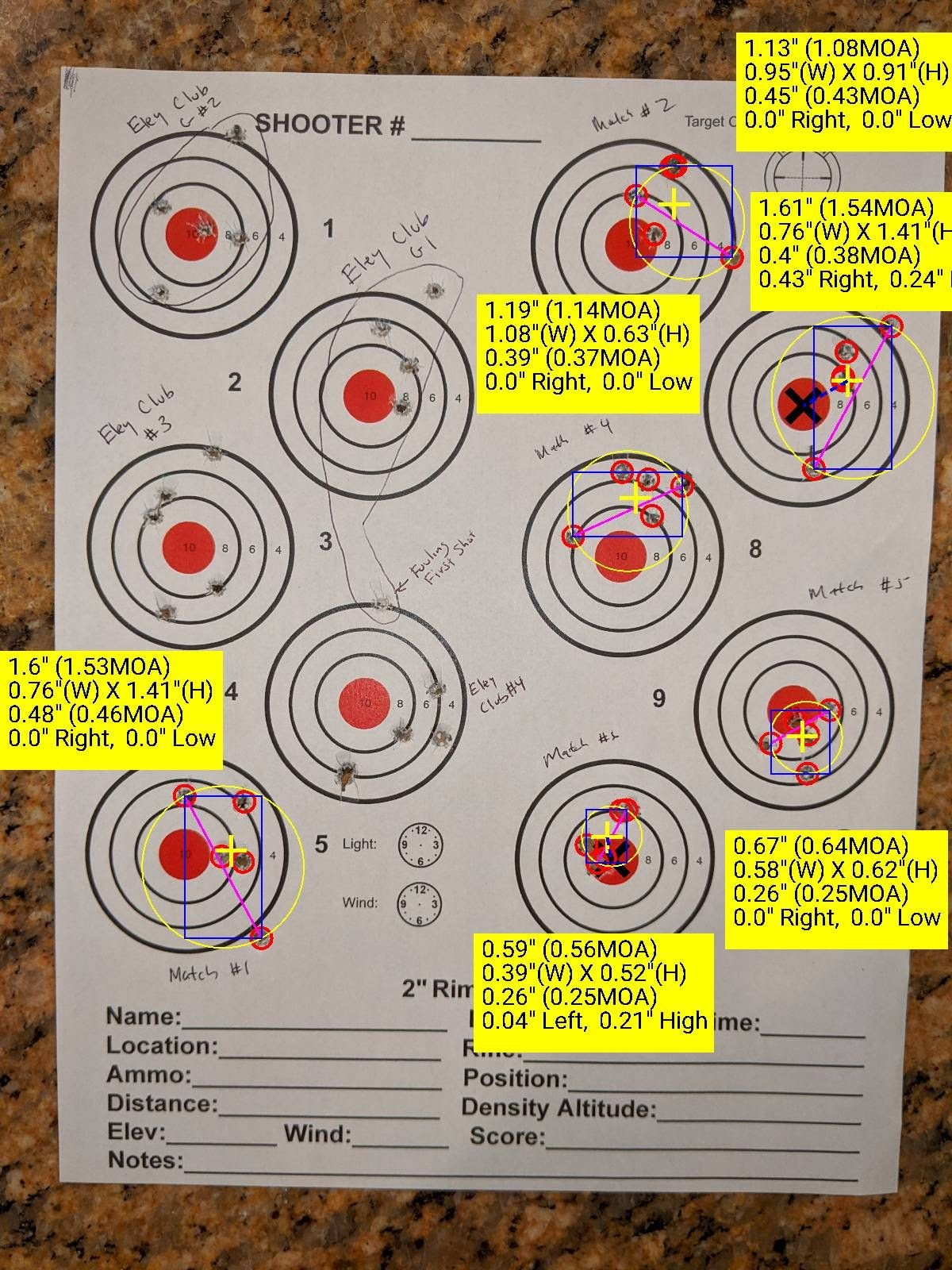

Tried out Eley Club and Match Pistol again today. Previously fouled with Eley Target, so knew I was going to be having some fouling groups as I switched to Club and Match. First shot of Club was way low, but the rest grouped as well as Club generally groups for me.
Eley Match Pistol got tighter and tighter as I did my 6x5. Didn't send out any fouling rounds in between Club and Match. I do notice that Match has a different lube than my Club does. Goes from bottom left, then top right and down.
