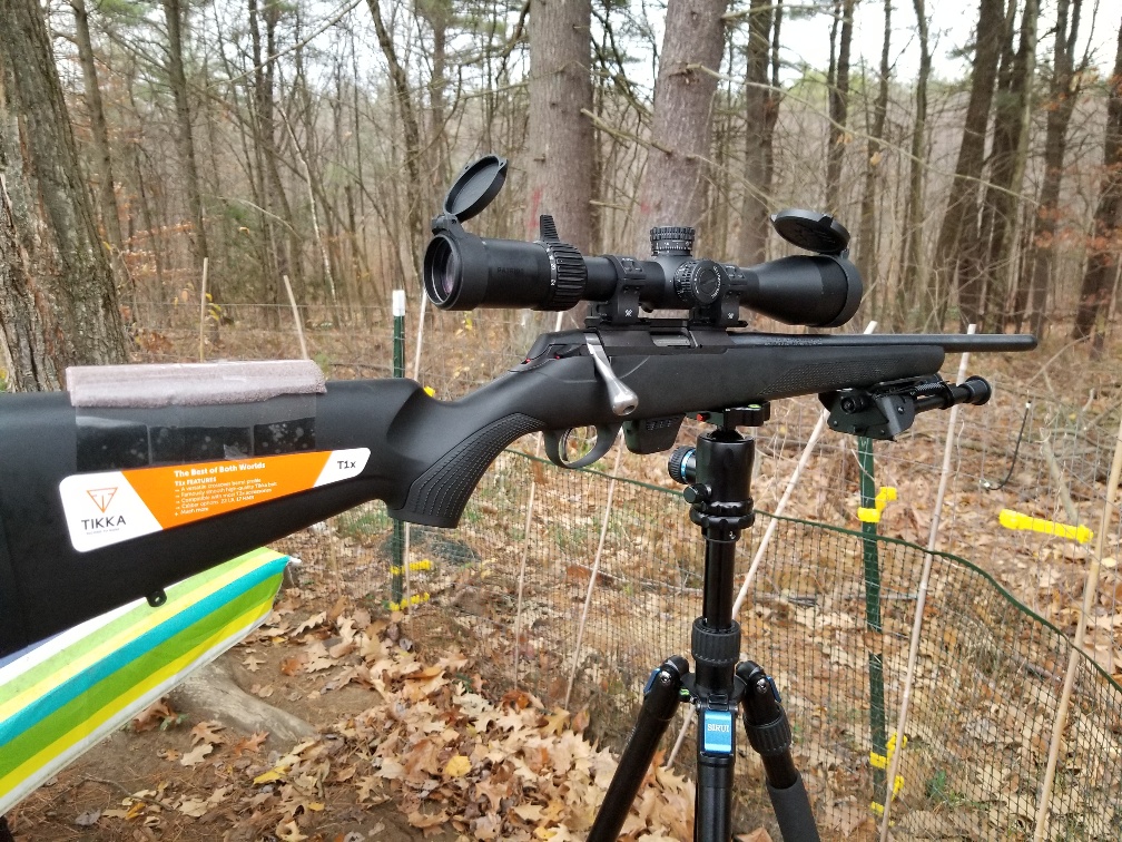

Beat the rain today and got out for a little practice this afternoon! Wind wasn't bad but it was a little shifty, was able to get hits out to 300 after figuring out my adjustment...15mils.

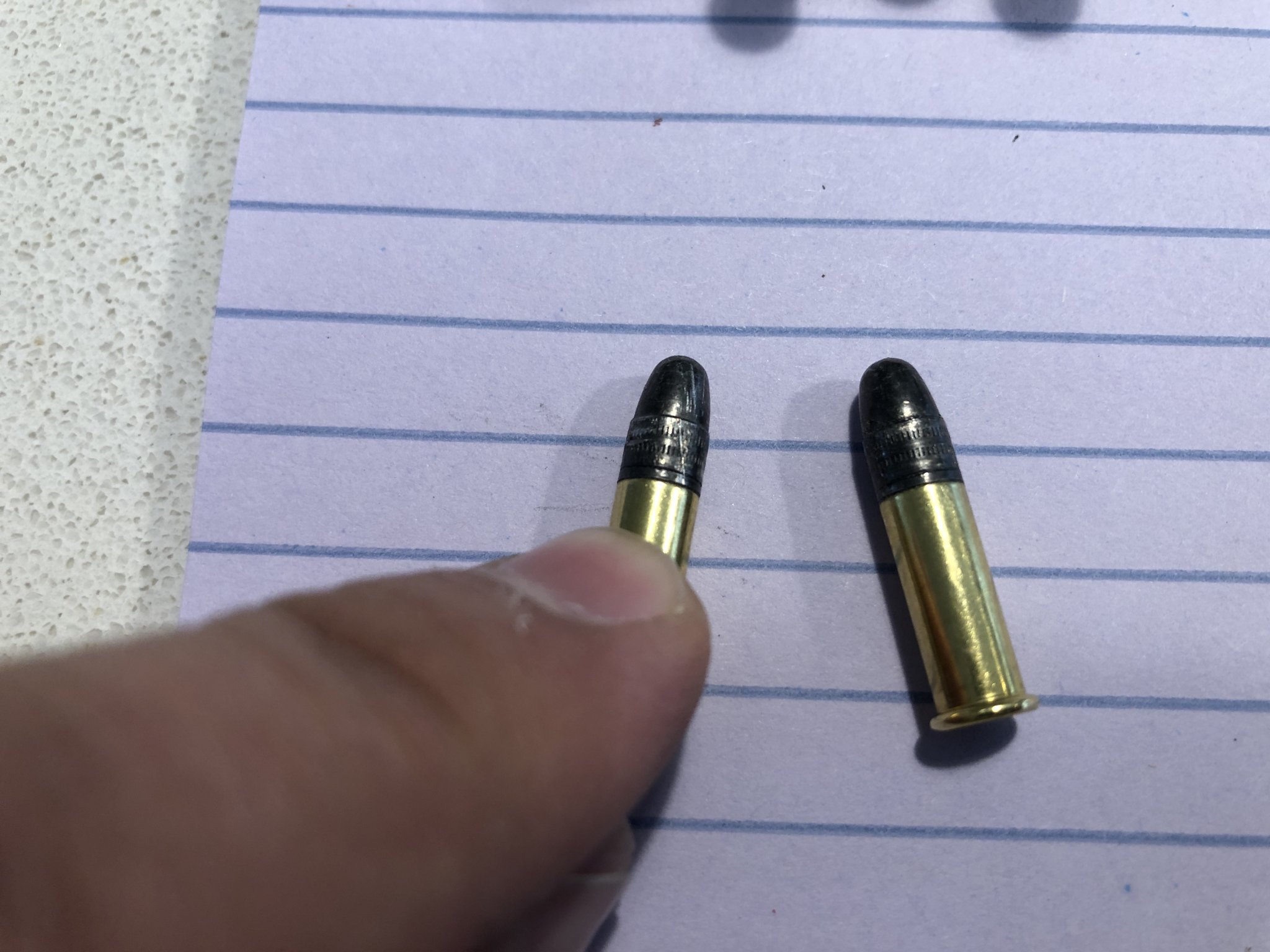

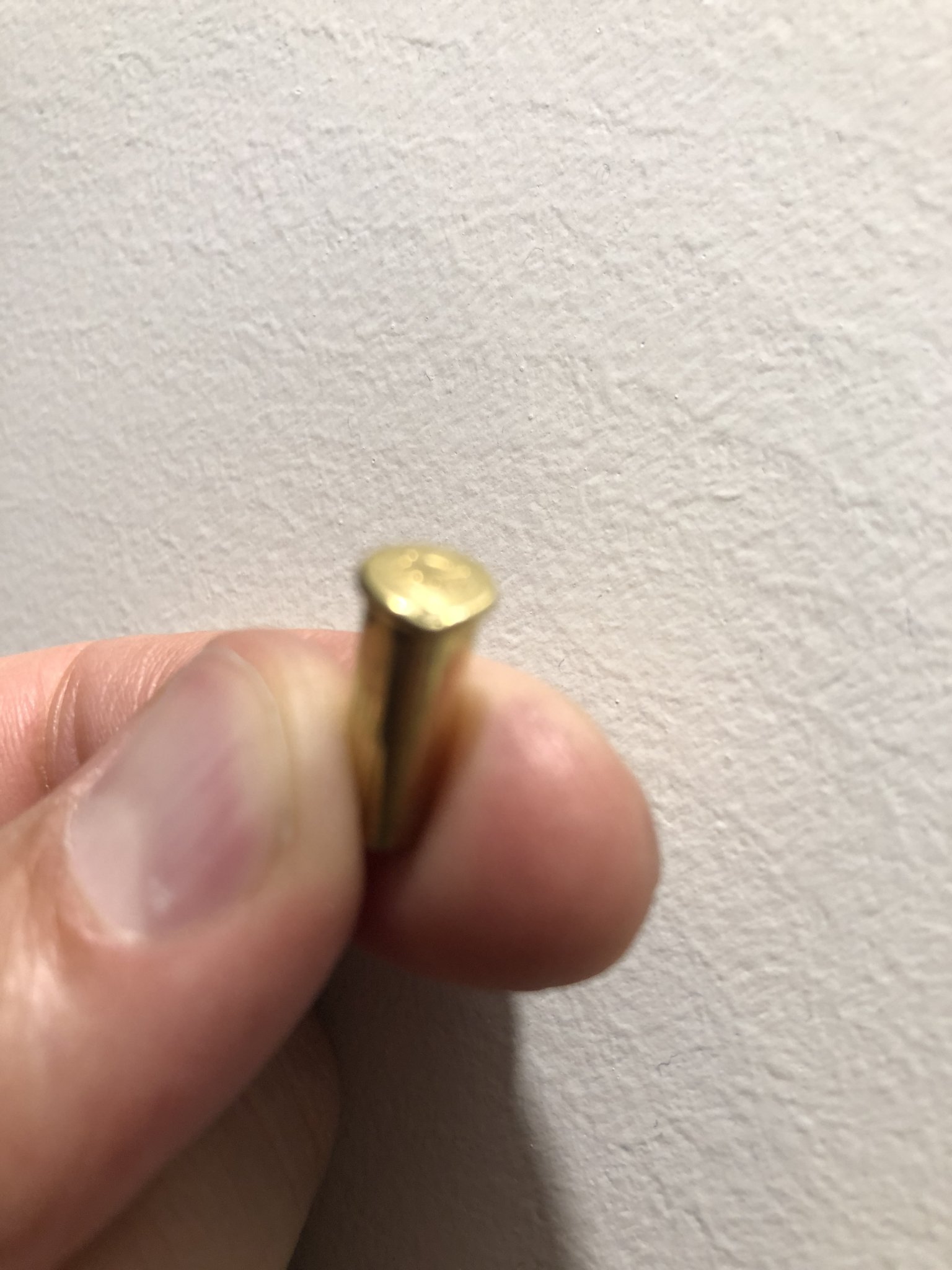

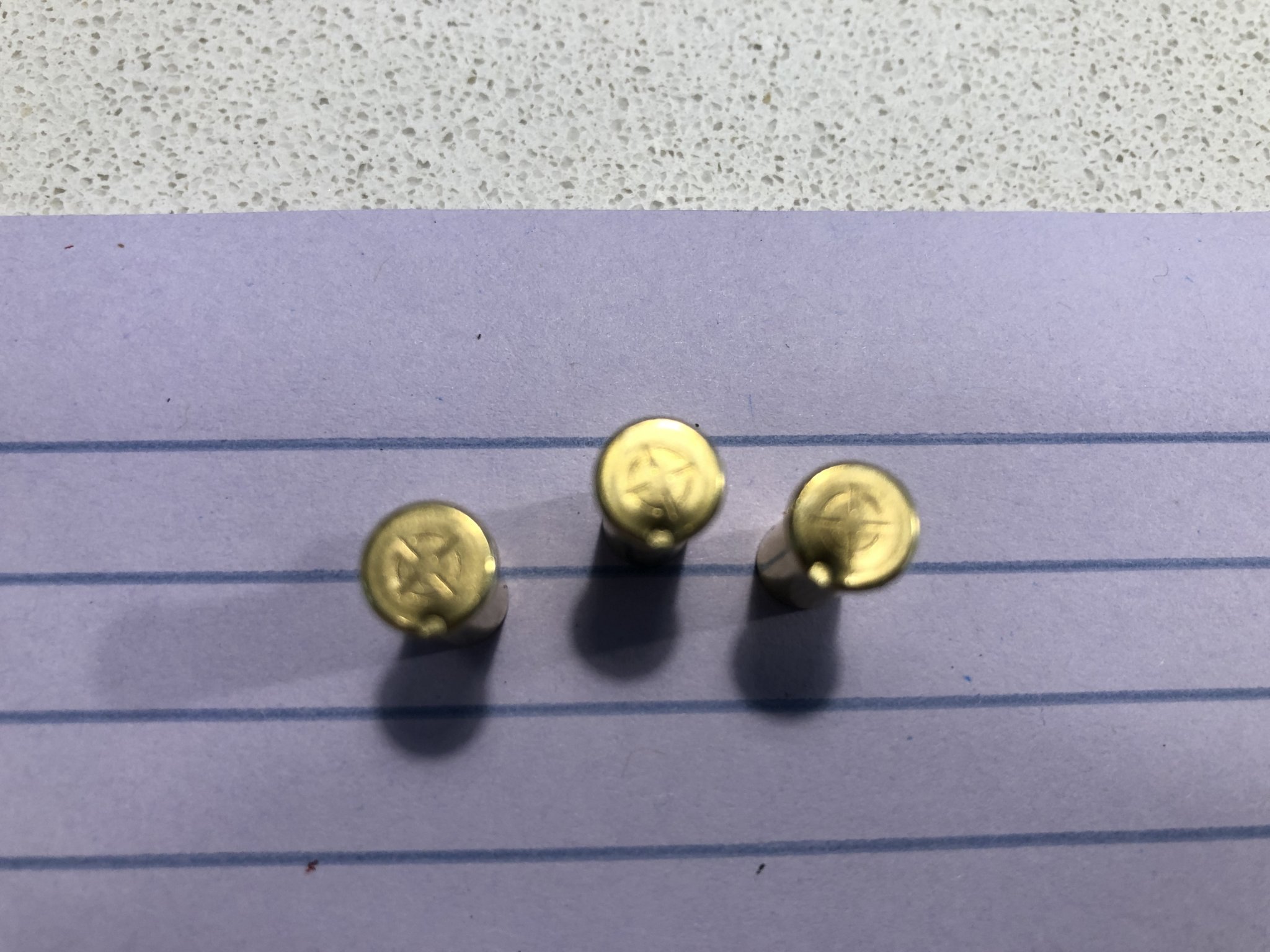

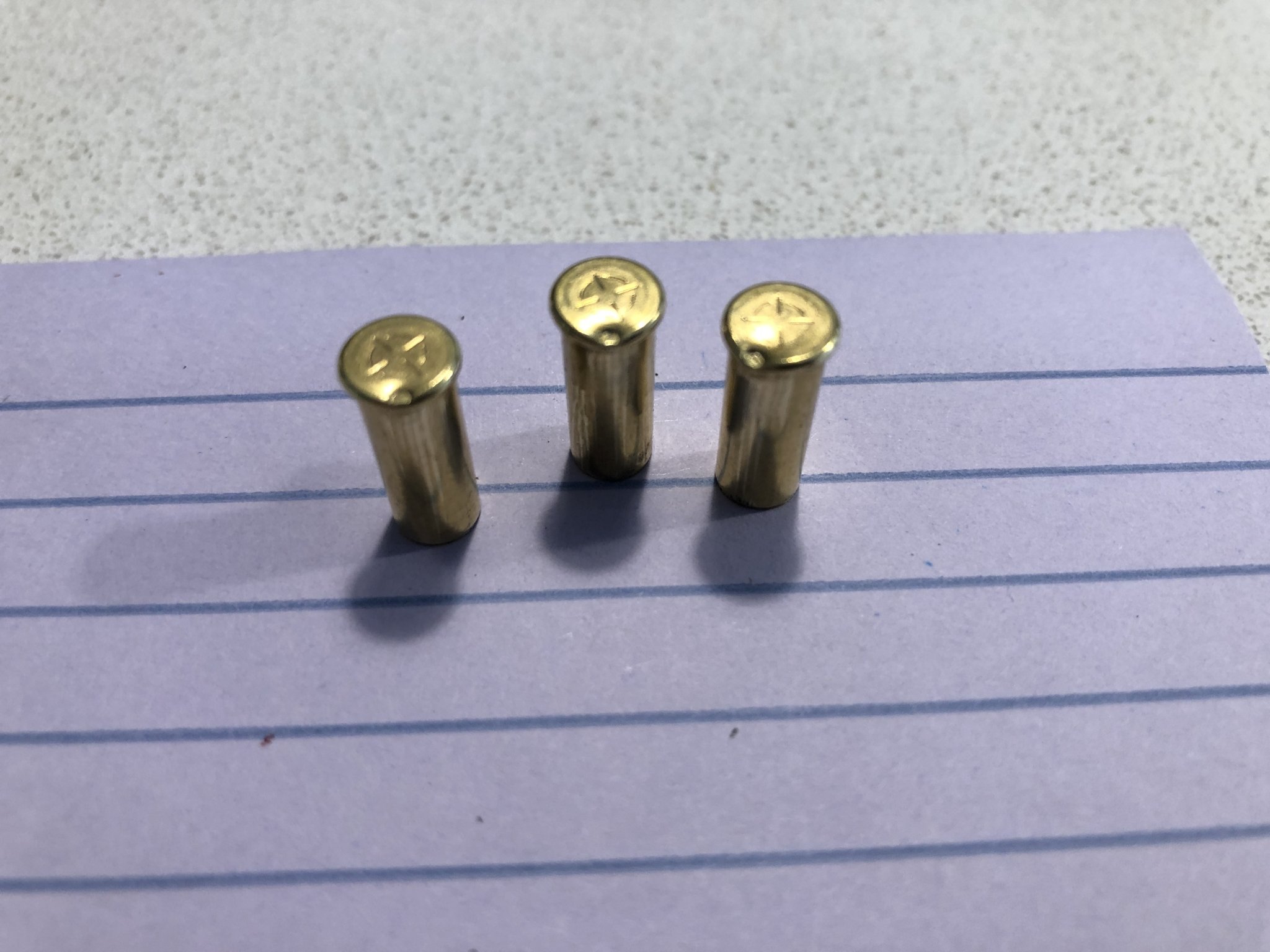

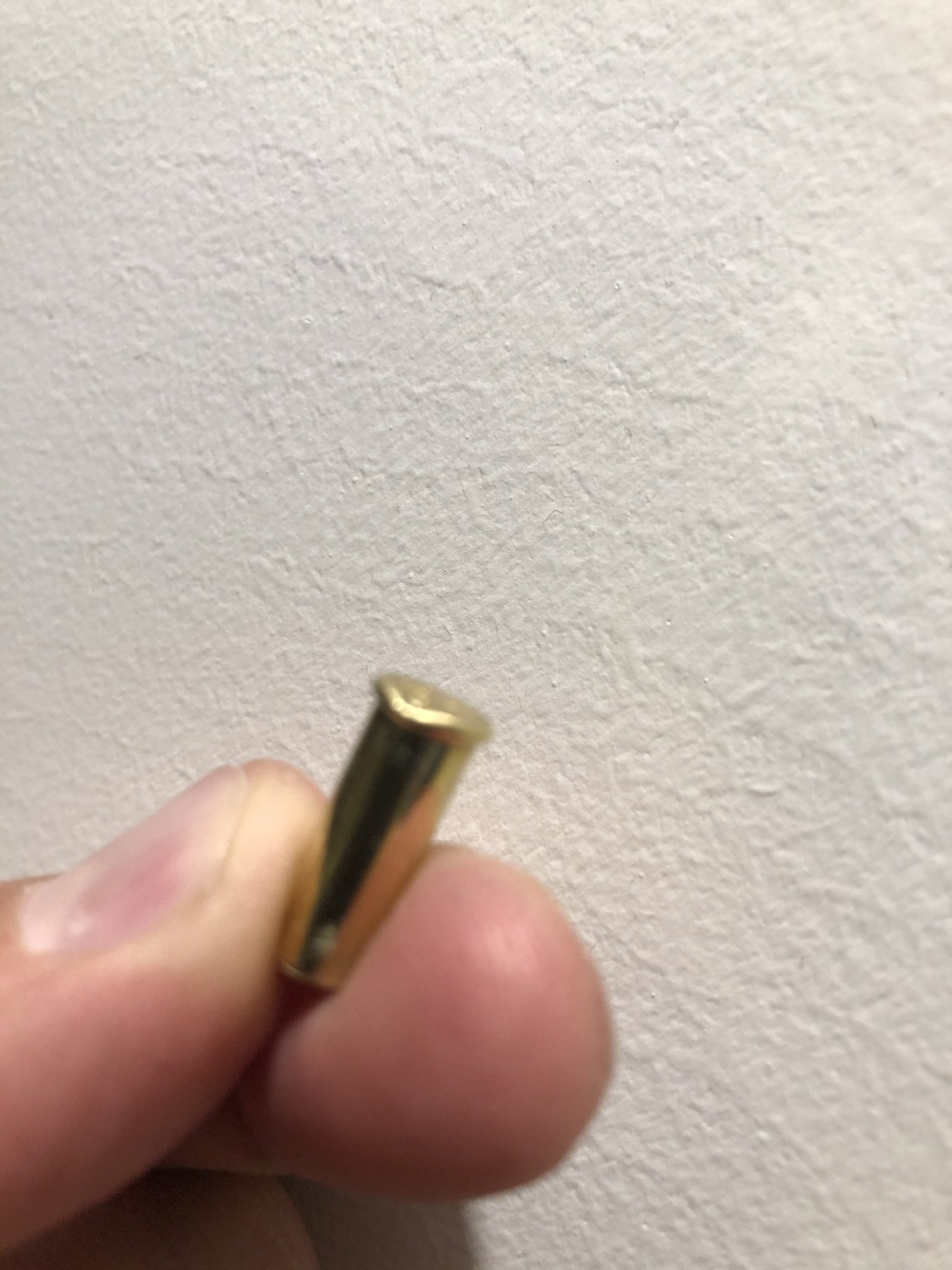

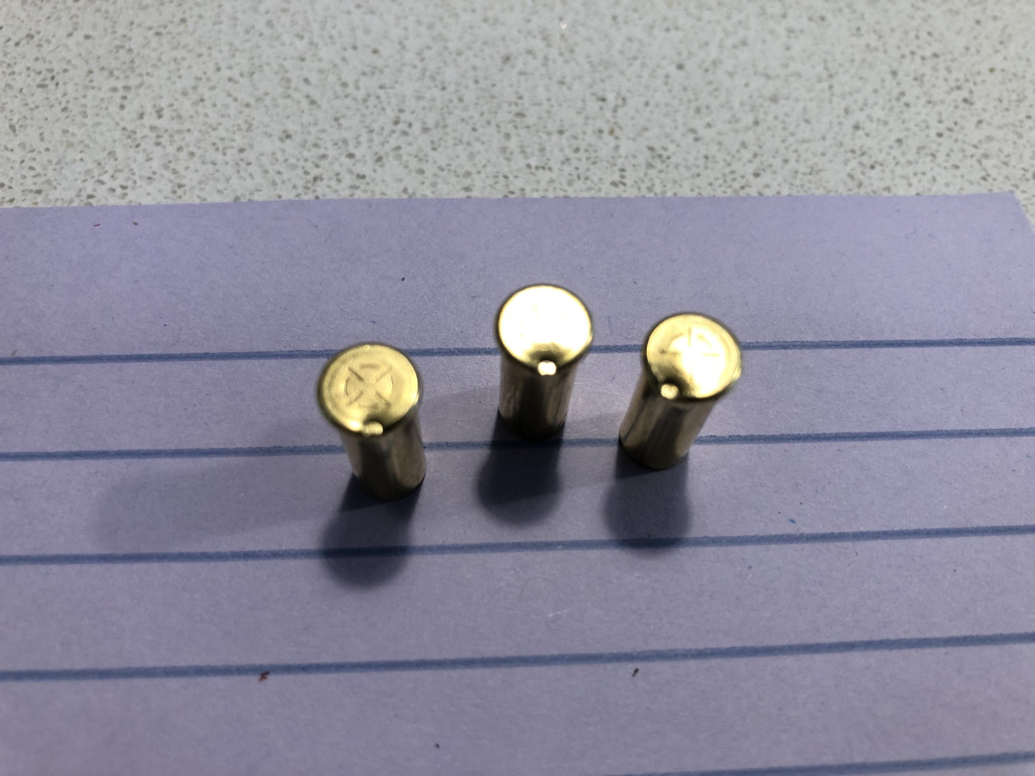

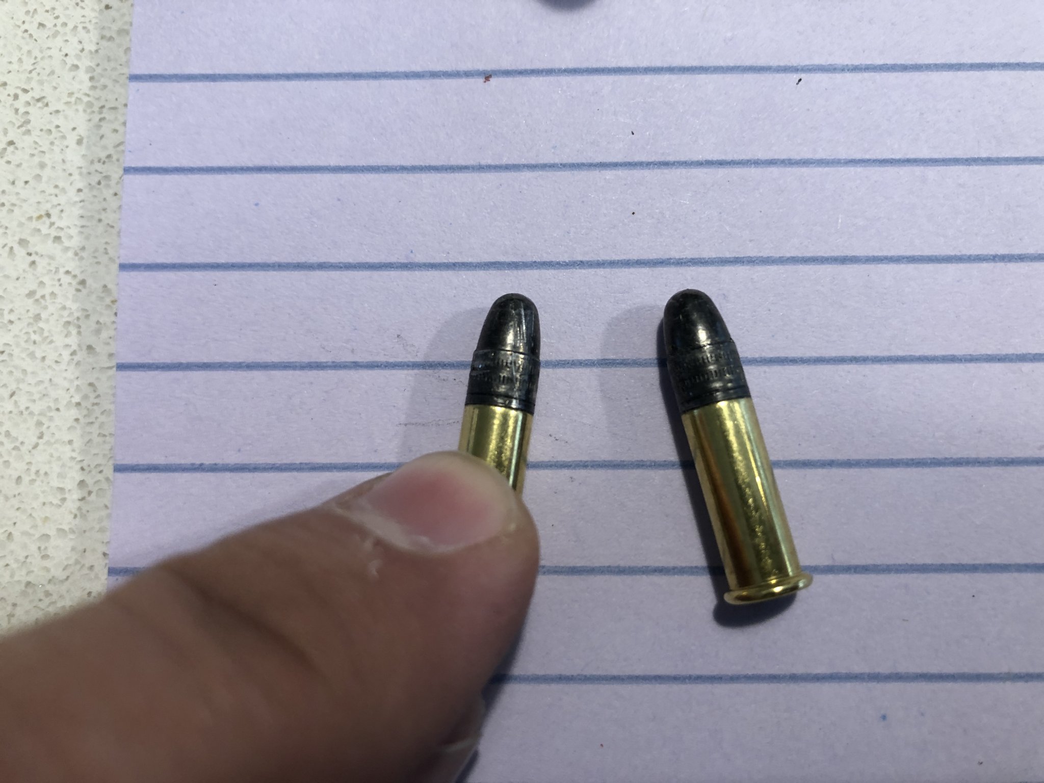

Well, I finally got to the range today to try my new IBI 22LR barrel with a stack of SK ammo. And then I had three fails to extract in a row and that's the end of that for the time being.
Sigh.
I was able to load and extract 22LR ammo just fine without firing it, but once fired the ammo would not extract AT ALL. Had to push it out with a rod, so after three in a row I was done for the day as I didn't want to mess around with things on the line.
I had measured the rim thickness of the SK ammo and the depth of the recess in the bolt and found them to be pretty much the same so I mounted the barrel resting against the bolt face. Perhaps this was too short a headspace? I will probably get a headspace gauge and try that, but that is a several week endeavour since it will be coming up from the US.
Attached are some images for you to ponder:
The three rounds I fired off. So, I think I figured out the issue - the IBI barrel is upside down, so the feed ramp is on the top, which is where the firing pin is as well. I suspect, based on the saddle shape to the rim of the cartridge that the lack of support to the rim where the firing pin hits is allowing the case to deform such that the extraction is compromised.
This would explain why @Kisssofdeath had no problems with the combination and I did. I'm going to see if IBI can swap me a barrel with the correct feed ramp.
Really hard to make out but the ammo itself that was loaded and extracted is slightly gouged but not horribly so. A feed ramp in the right spot would help with this.
I'm also going to try to lay hands on a 22LR extractor to see if that helps.
I need a beer.

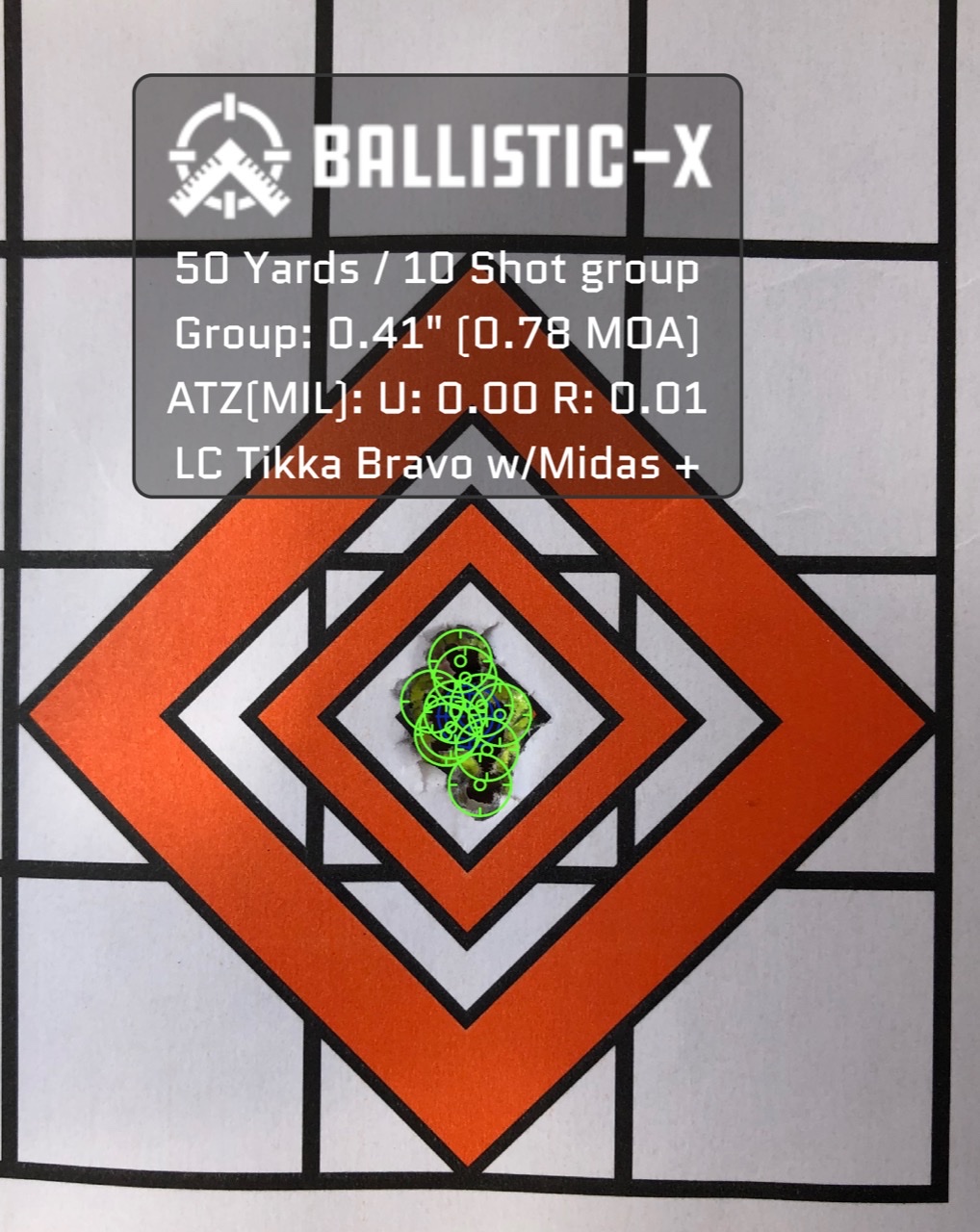

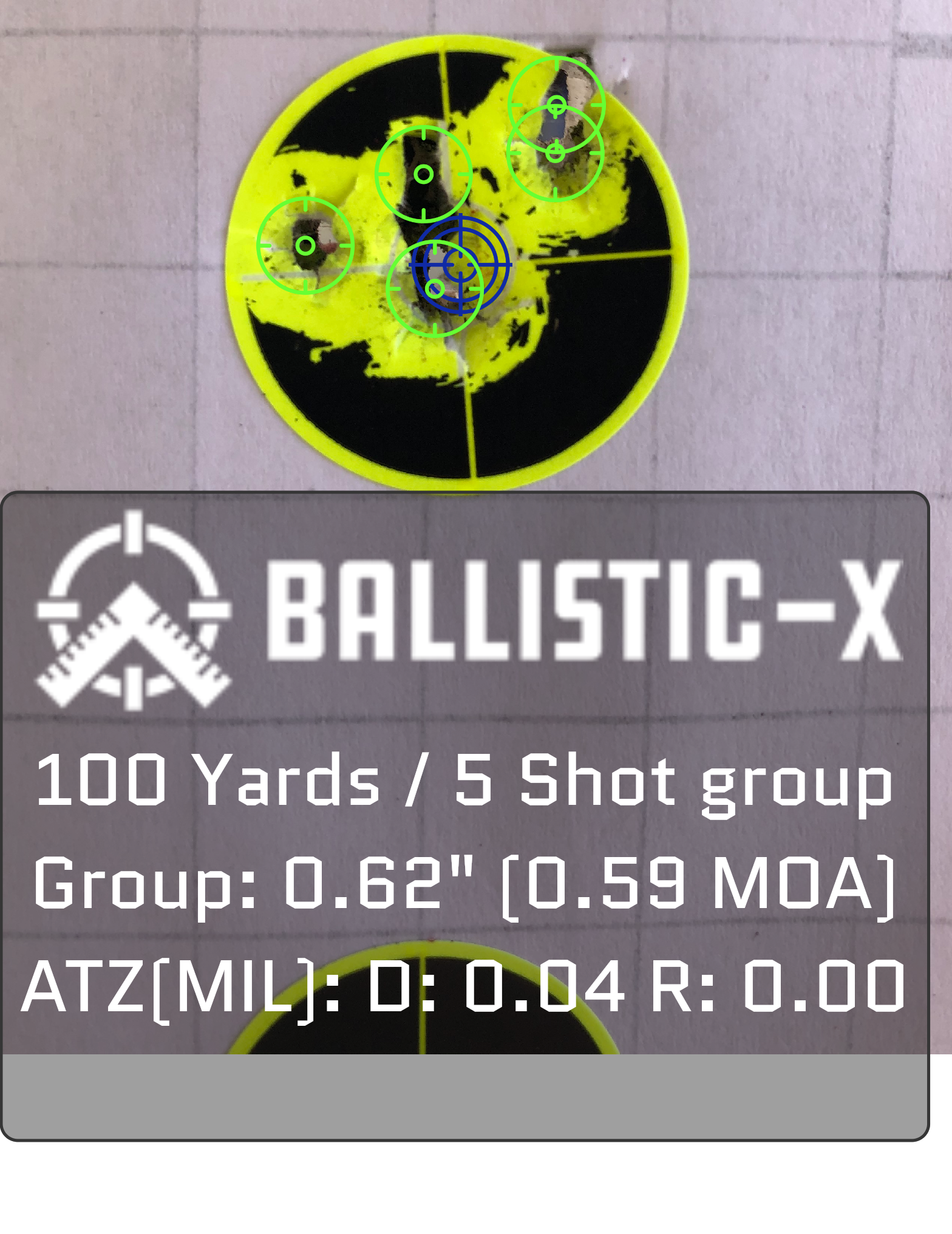

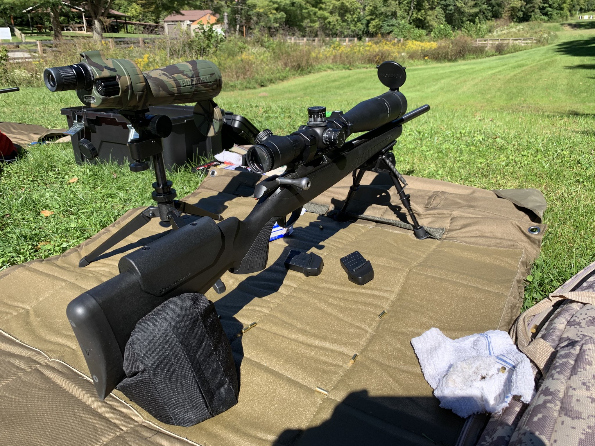

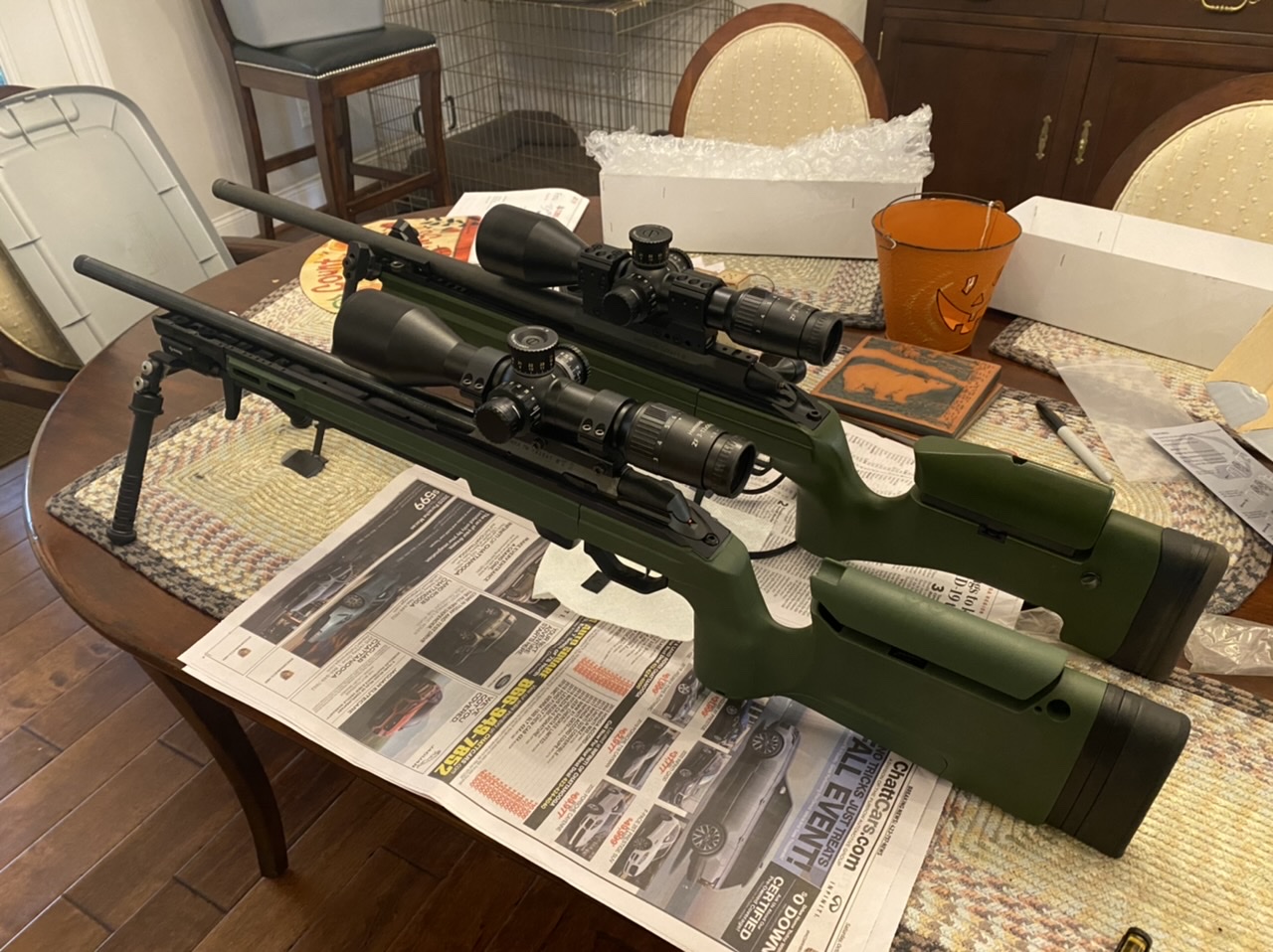

I set up my T1X to be a trainer for my Sako TRG. I dropped it in a KRG Bravo stock (Sako green of course) and mounted the same 3-12 scope in an AI dovetail mount. It feels VERY similar to my TRG.
I got out this past weekend with a buddy and put 140 rounds through it. I was tickled with the way it shot. A pleasingly consistent 10 round group at 50 yards off a bipod and rear bag. I also shot some 5 shot groups at 100 yards, one inch circle targets. I love this rifle!

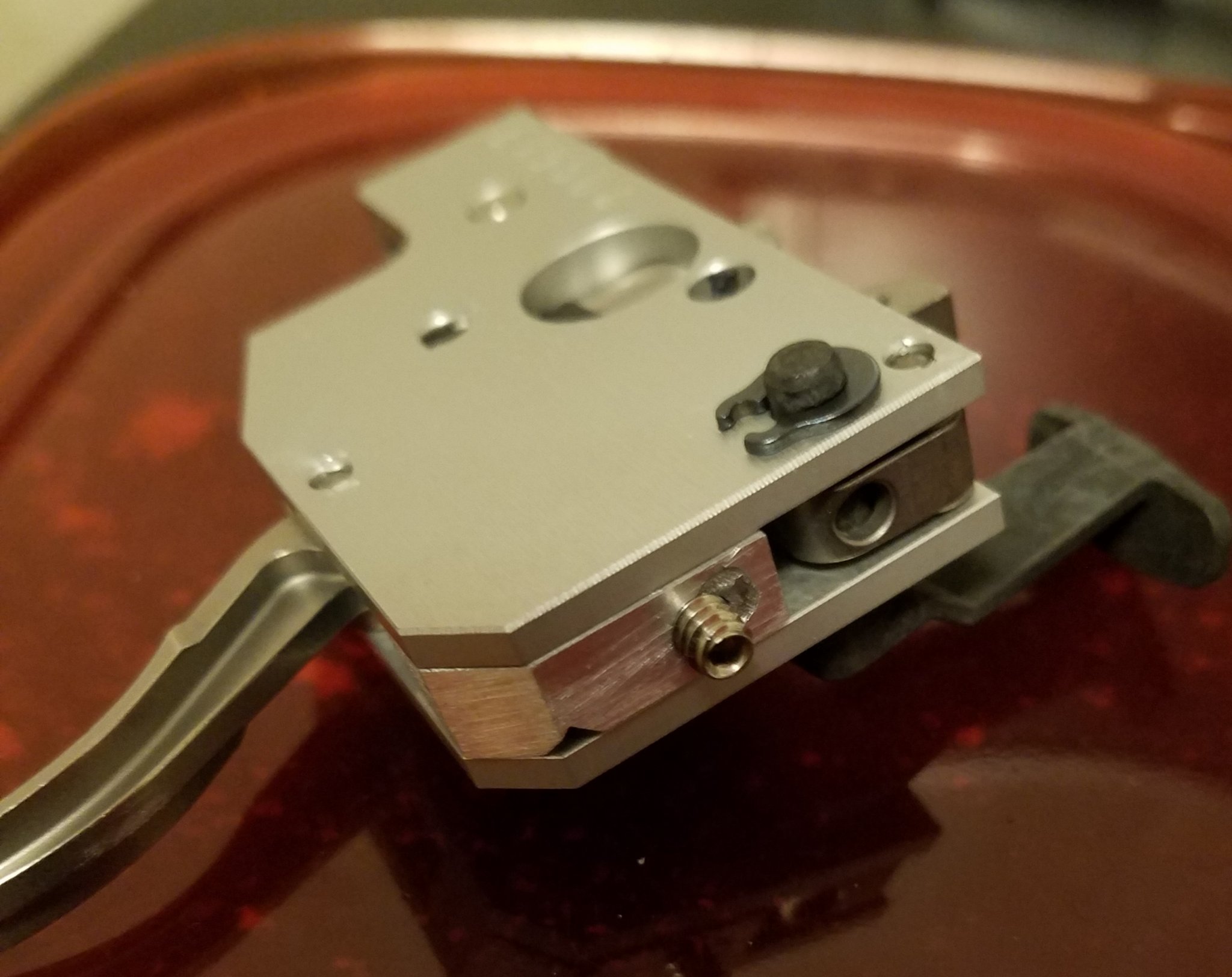

Thought I would share a sear adjustment I added to my T1X trigger, this is the second one I have done first one got me down to 8 oz, which I use only from the bench. I still need to drill for tension pins. A over travel adjustment can be added as well by drilling and tapping another 6/32 hole for the adjustment screw.
Maybe you should offer a trigger service. I've not been able to get mine below 19 oz without problems
I thought about it, the triggers are all a bit different, some will go lower then others, I do think it will improve any of them, one has to remember ,these triggers are not really designed to go that low and I would never use one for anything but bench use, I think if you keep the pull around 14-16 oz most would be safe.
I installed the trigger after I added the sear adjustment block, got the pull down to 8 oz just like before, I tested it quite a bit and no slam fires so far, may take it to the range today for the real world test. One thing of note, sometimes you have to stone the safety bar where it contacts the trigger to get it to function, takes just a few thousandths to correct it, this is due to the trigger being pushed forward by the adjustment screw I didnt have to do that on the first one I did. Be safe.
