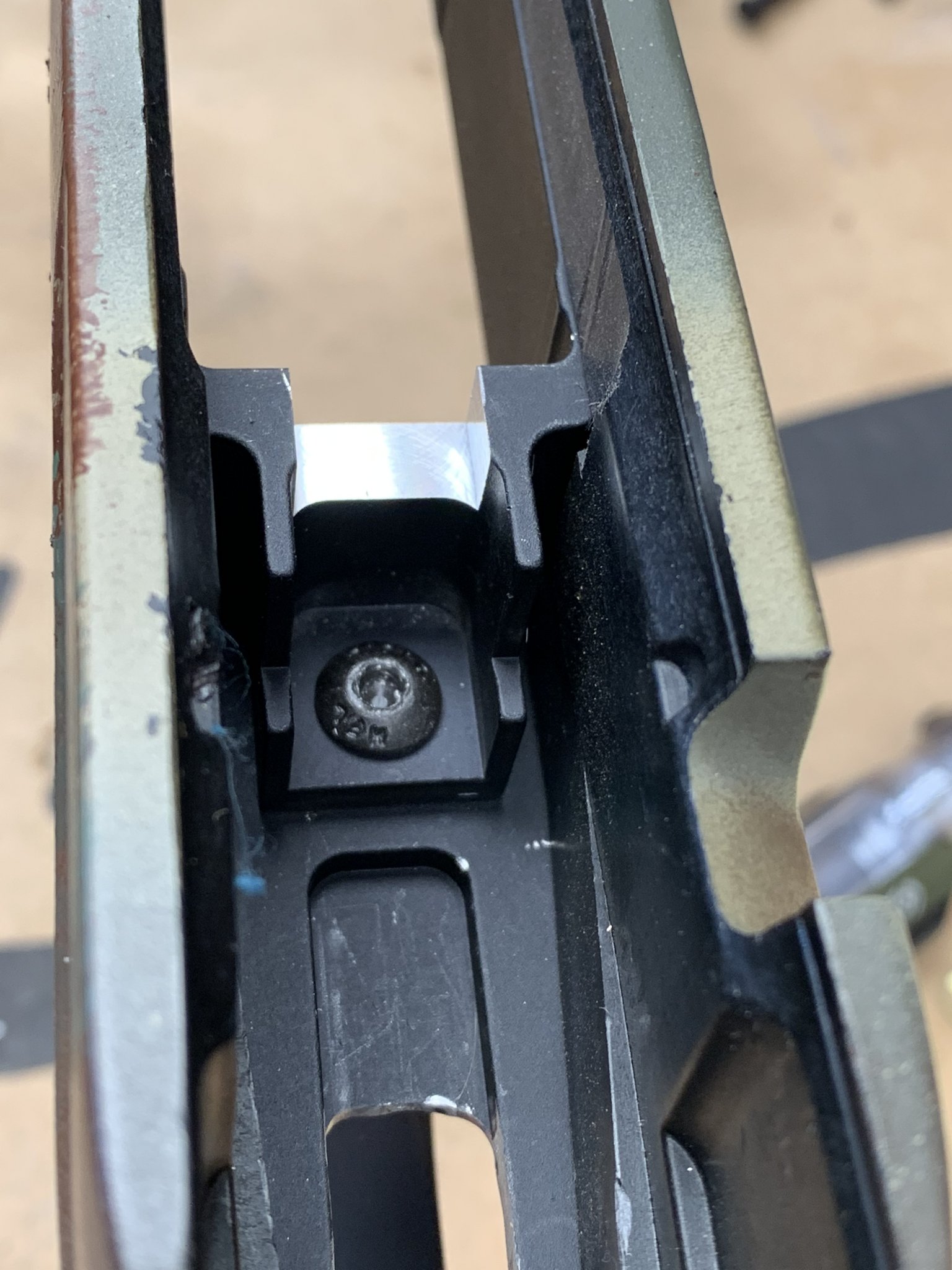

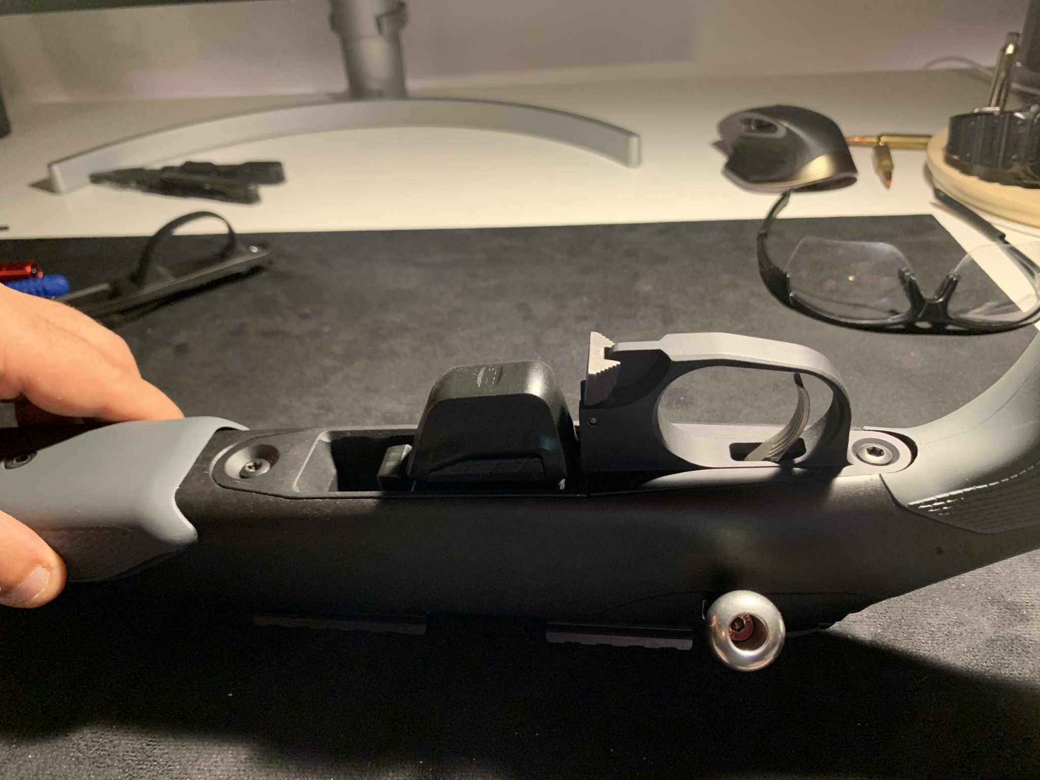

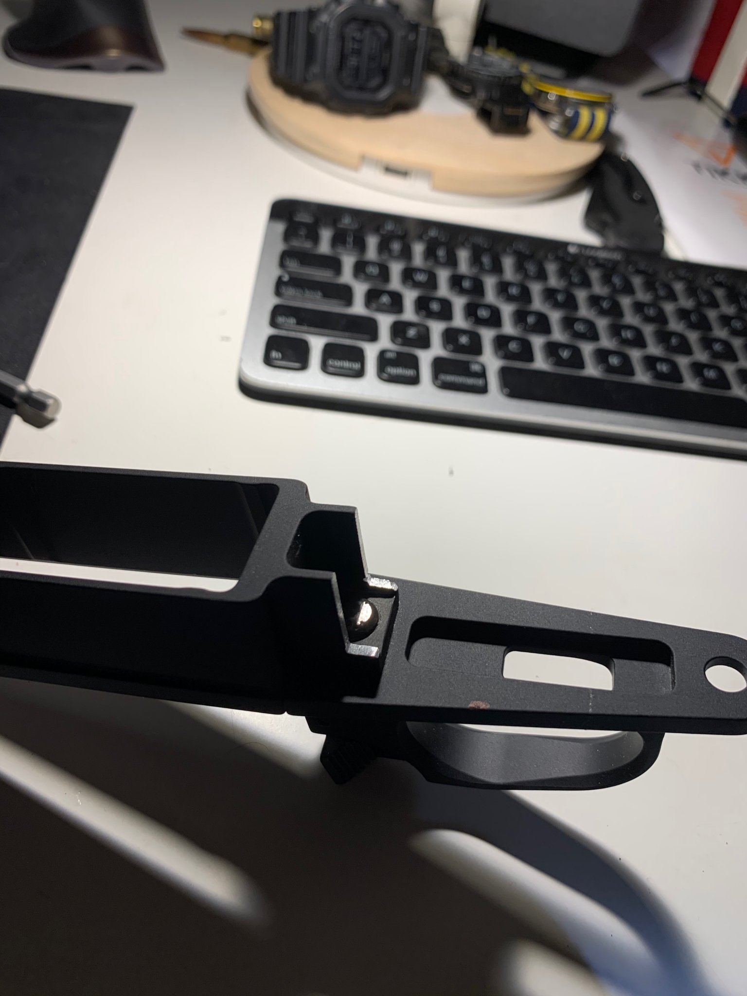

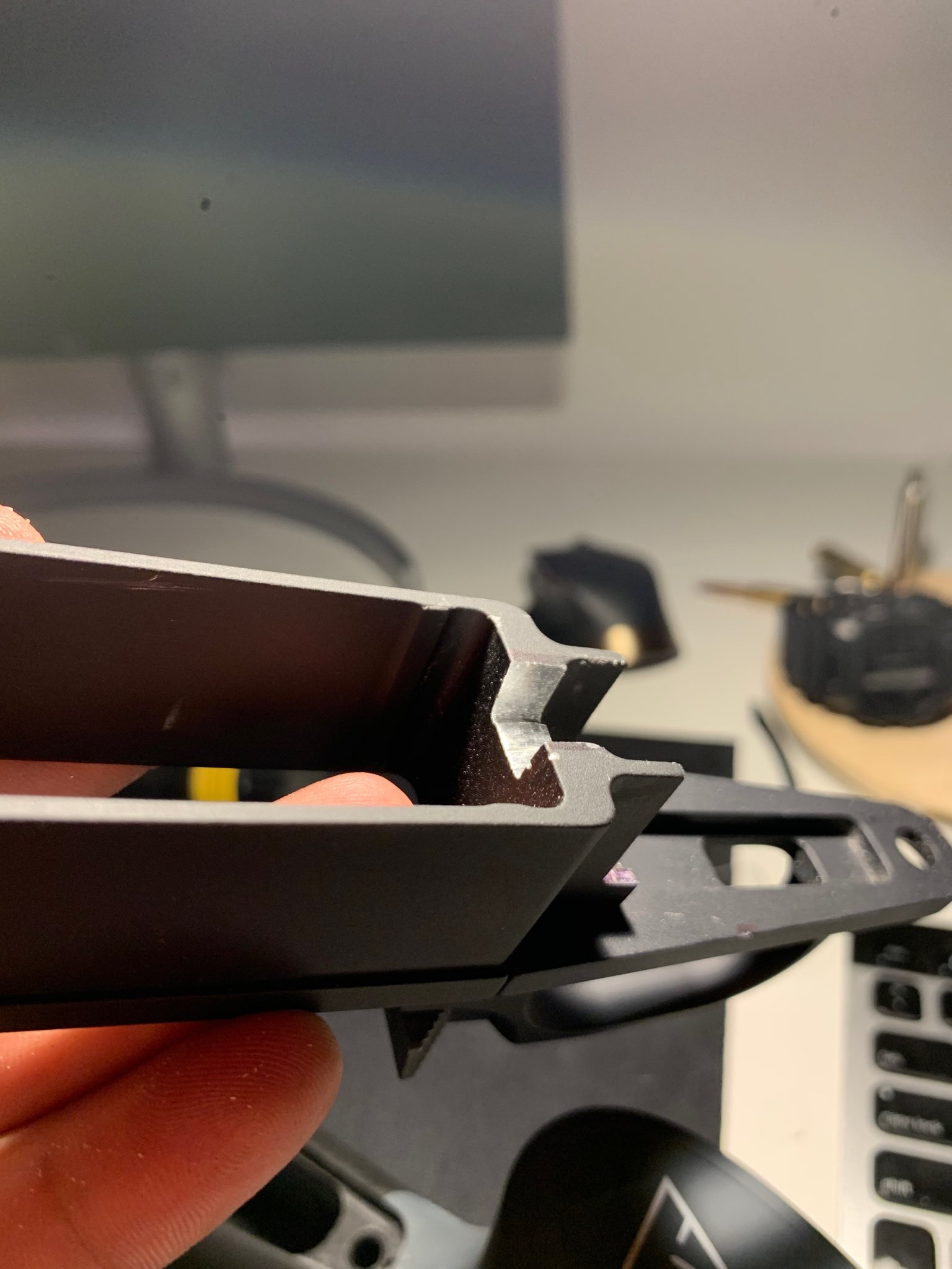

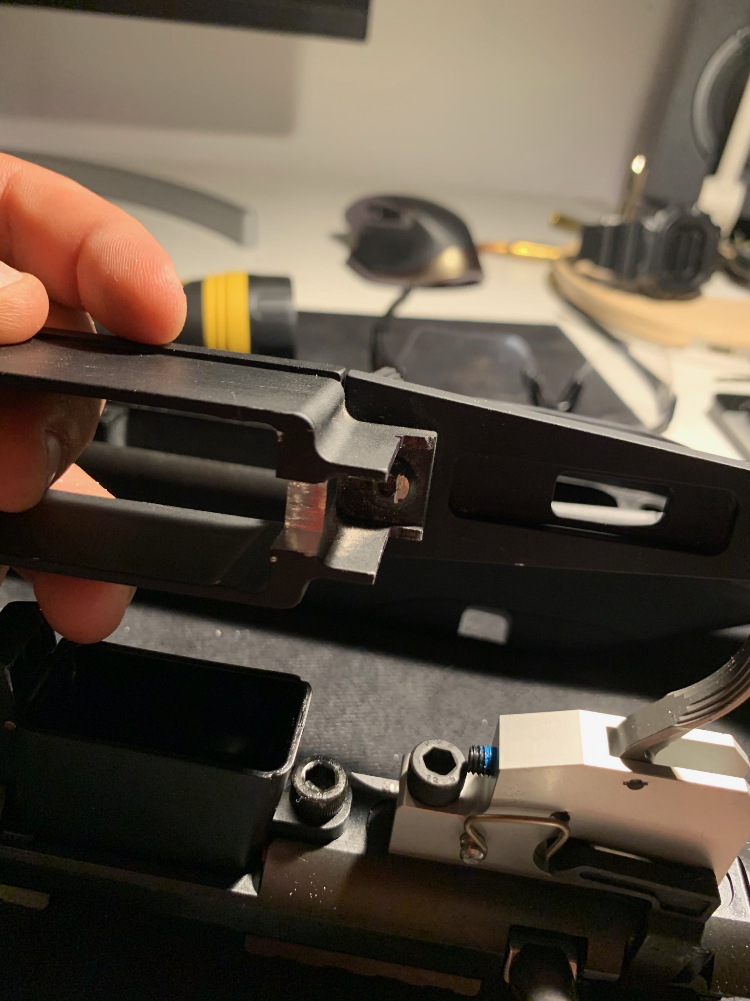

I tried swapping the CTR Bottom metal for the Plastic Trigger assembly on the T1X last night.
There is an Allen bolt that attaches the .22LR Magazine well to the action that interferes with the rear face of the CTR magazine well on the T1X.
It's gonna take a little work to mate the CTR Bottom metal with the T1X action.
It may be a simple as swapping the standard Allen bolt for a button head bolt or it may require grinding a slot in the original Allen bolt for clearance. I haven't delved that deep into the conversion yet.
how did you pull this off.... I have a T1X that I want to put in aT3X stock so that they are the same in feel... the bottom metal profile looks different? my T3X is in a Supper Varmint stock with adjustable cheek rest ... and I want T1X to live in an identical stock.
I had to file down the aluminium CTR bottom metal, to creat a channel for the Allen bolt to clear.

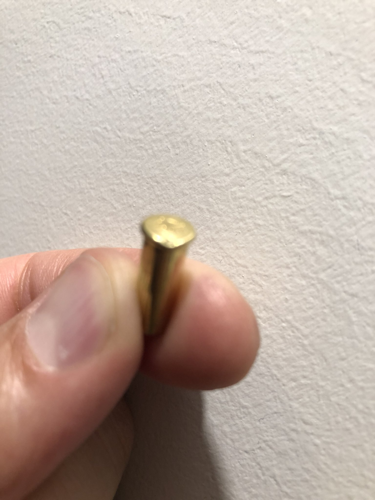

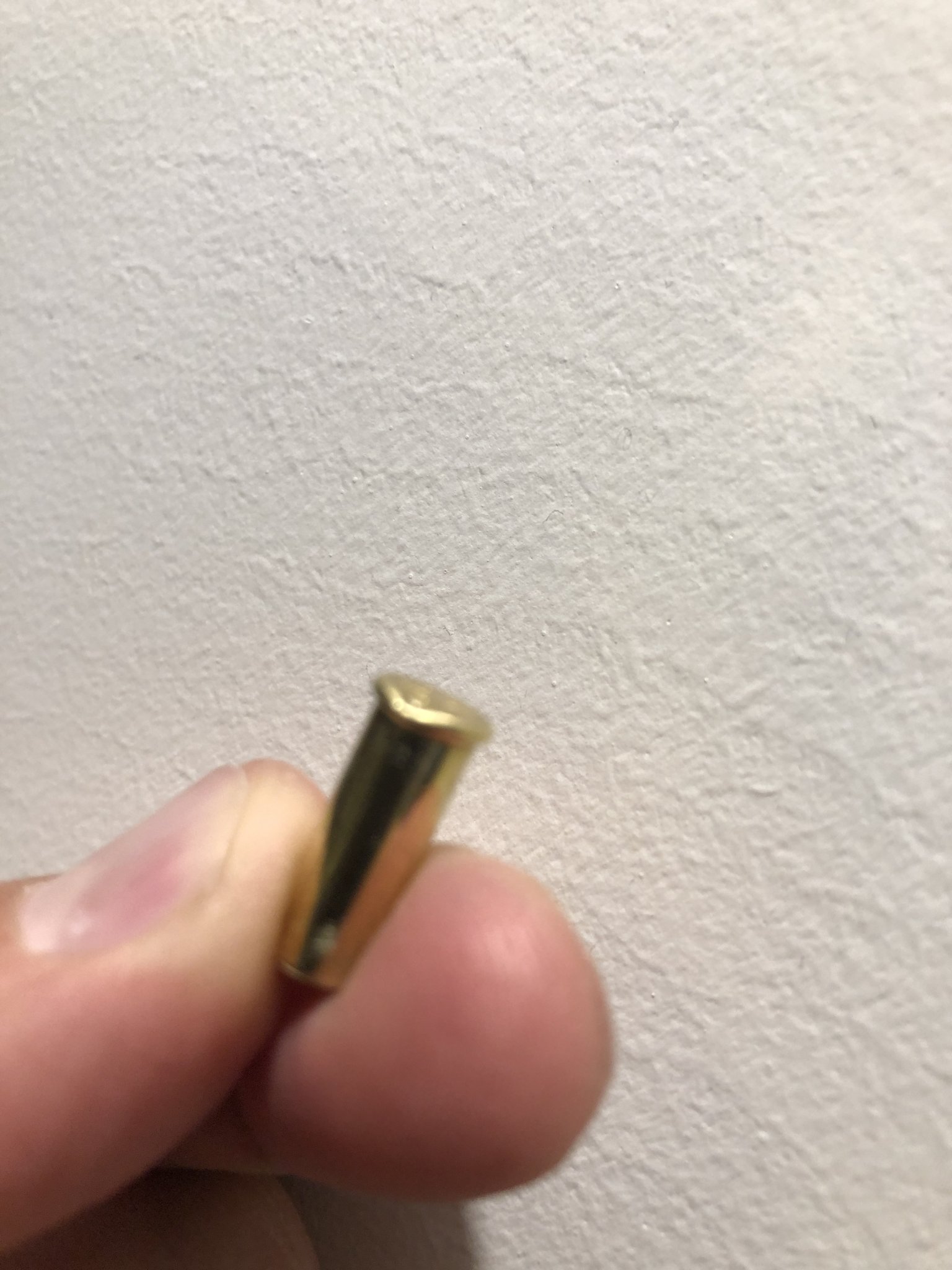

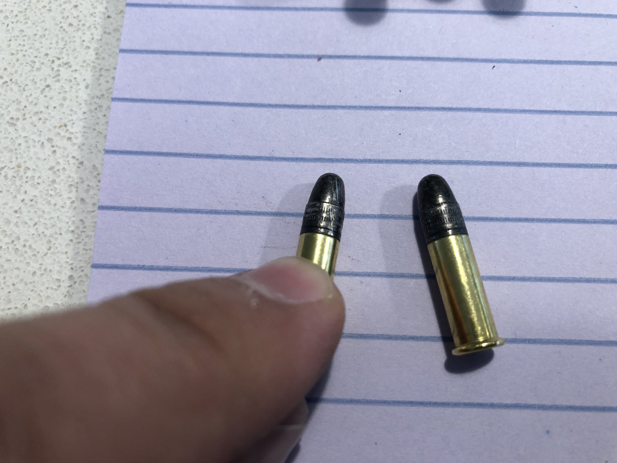

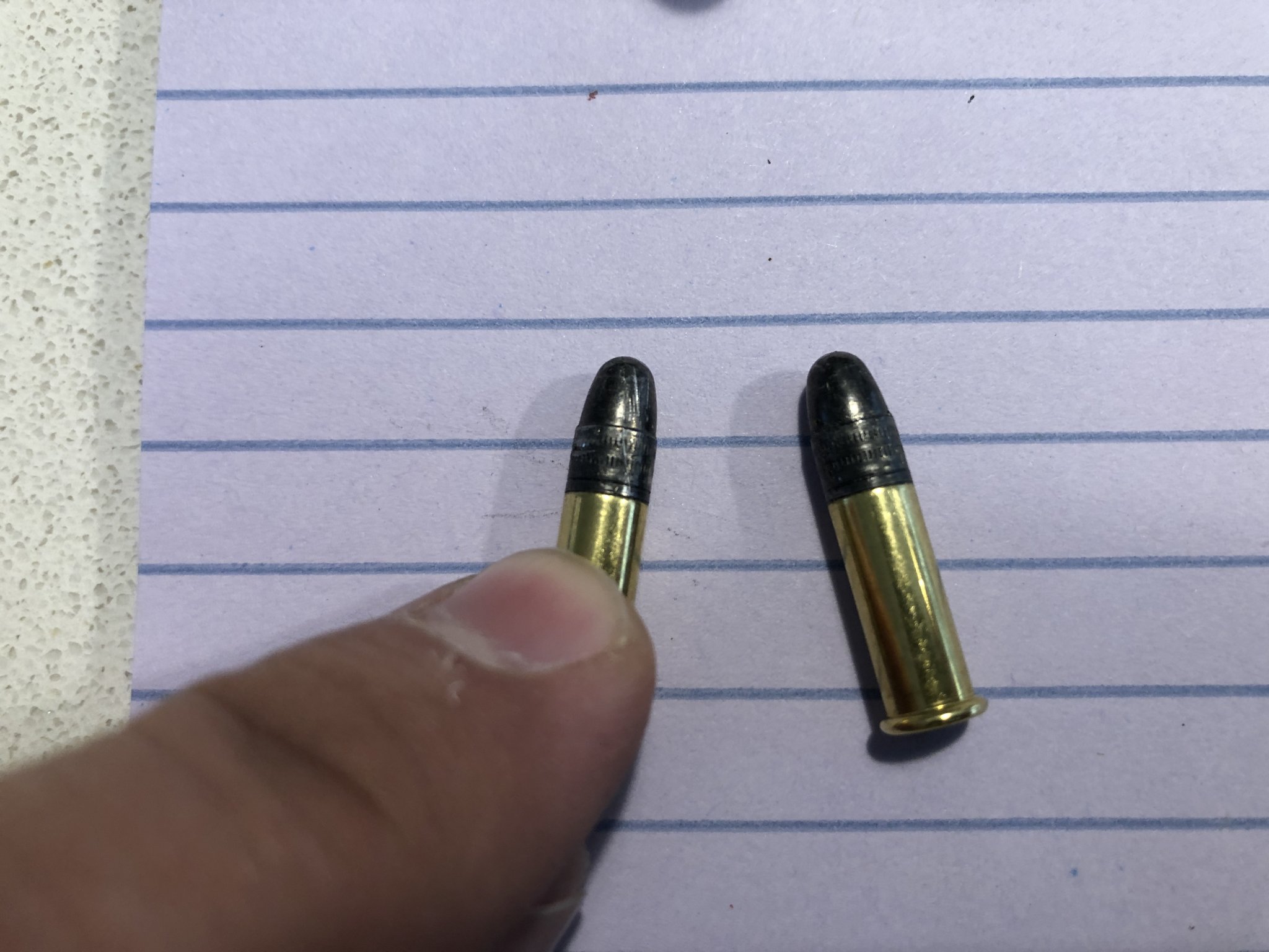

Well, I finally got to the range today to try my new IBI 22LR barrel with a stack of SK ammo. And then I had three fails to extract in a row and that's the end of that for the time being.
Sigh.
I was able to load and extract 22LR ammo just fine without firing it, but once fired the ammo would not extract AT ALL. Had to push it out with a rod, so after three in a row I was done for the day as I didn't want to mess around with things on the line.
I had measured the rim thickness of the SK ammo and the depth of the recess in the bolt and found them to be pretty much the same so I mounted the barrel resting against the bolt face. Perhaps this was too short a headspace? I will probably get a headspace gauge and try that, but that is a several week endeavour since it will be coming up from the US.

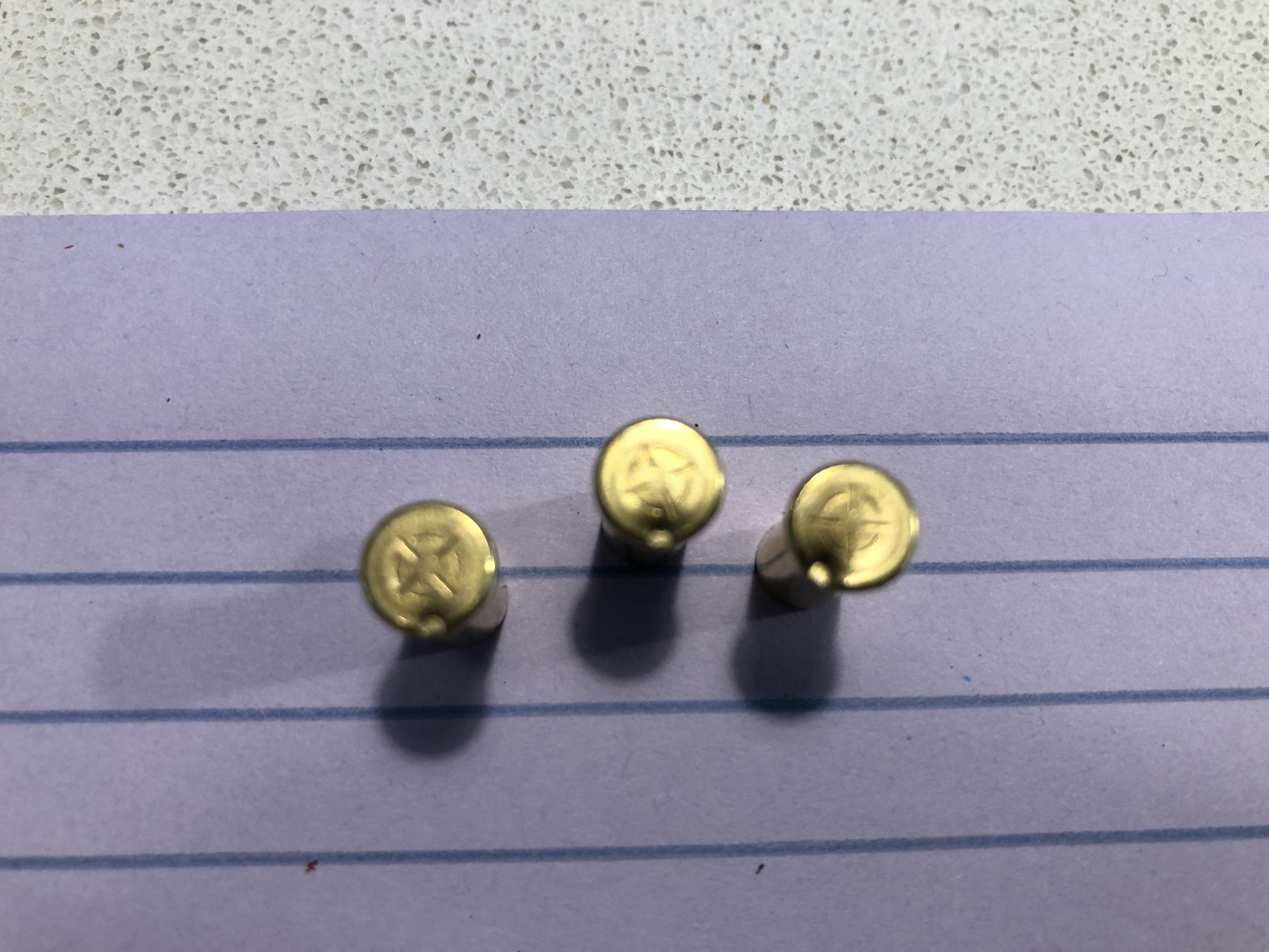

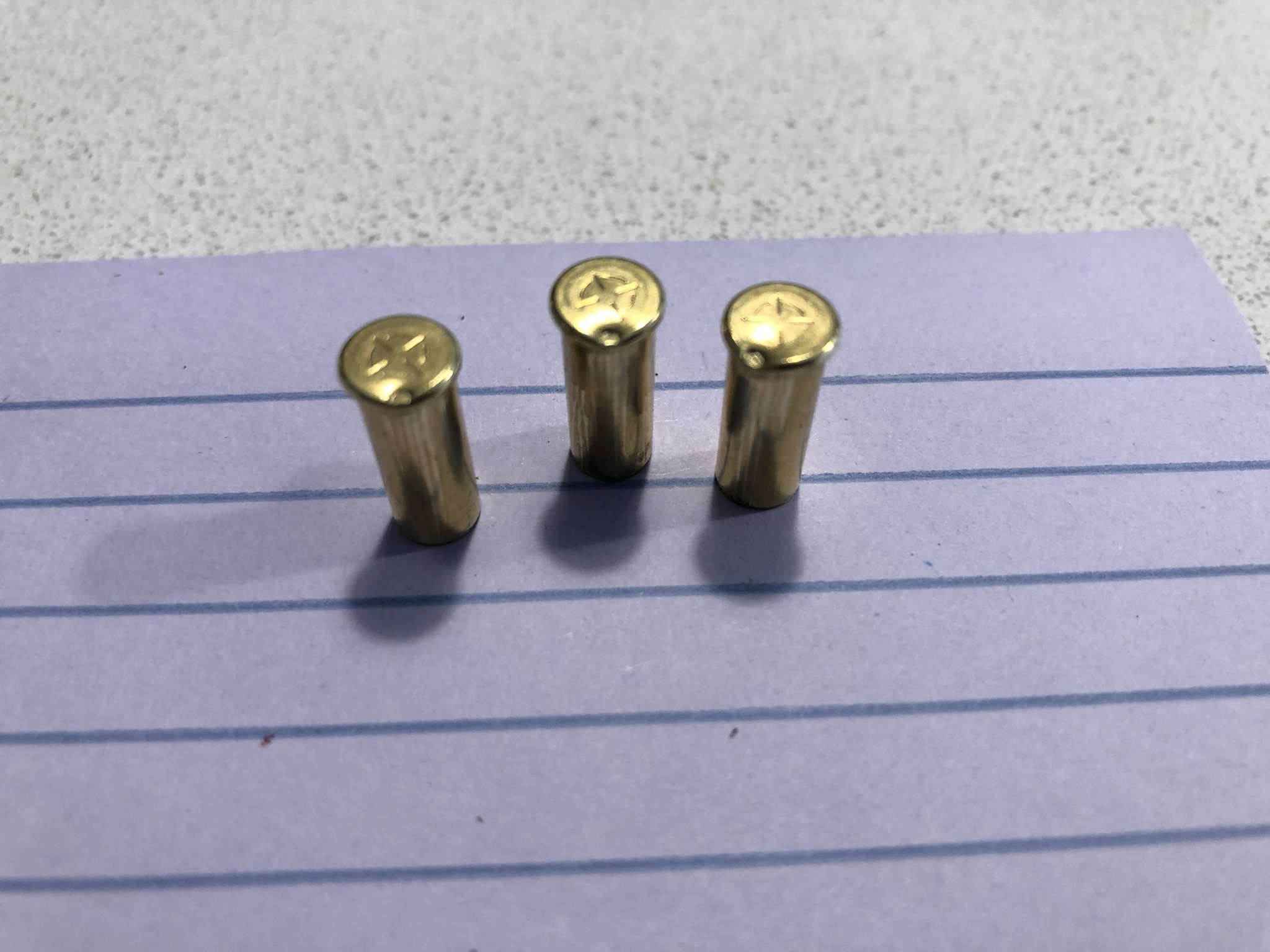

Attached are some images for you to ponder:
The three rounds I fired off. So, I think I figured out the issue - the IBI barrel is upside down, so the feed ramp is on the top, which is where the firing pin is as well. I suspect, based on the saddle shape to the rim of the cartridge that the lack of support to the rim where the firing pin hits is allowing the case to deform such that the extraction is compromised.
This would explain why @Kisssofdeath had no problems with the combination and I did. I'm going to see if IBI can swap me a barrel with the correct feed ramp.
Really hard to make out but the ammo itself that was loaded and extracted is slightly gouged but not horribly so. A feed ramp in the right spot would help with this.

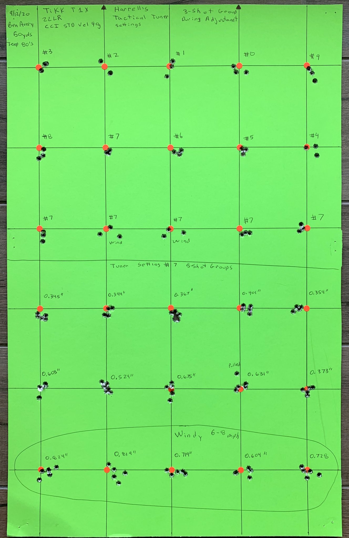

Anyone use a tuner on a t1x factory barrel?
Here’s mine using a Harrell AR15 Tuner. I initially used it primarily as a thread protector. I need more time to tweak it, but pretty satis so far. Definitely one of the least expensive options for tuners 😁
i have a regular harrell's tuner on my 10/22 build...that i've swapped to my t1x. it hasn't really shown any difference on my .92 fedderson barrel, but on the tikka..it most definitely changed things
im going to get a 24" barrel on my 10/22 and move the tuner back to it...so thinking about getting one of these 1/2x28 tuners for the tikka.
The Tikka’s 0.720” barrel seems to work better with a tuner 👍🏼
Tuners work better with longer smaller profile barrels. They will still work with a short thick barrel like an MTU but there will be less nodes and lesser effect because of the harmonic differences.
I intend to play with a tuner on my T1x. So far the tikka has performed very well in stock form with factory 20” barrel and stock. So much so that I use use it as a loaner at matches. That has caused at least one person to go and buy a T1x for their own use.

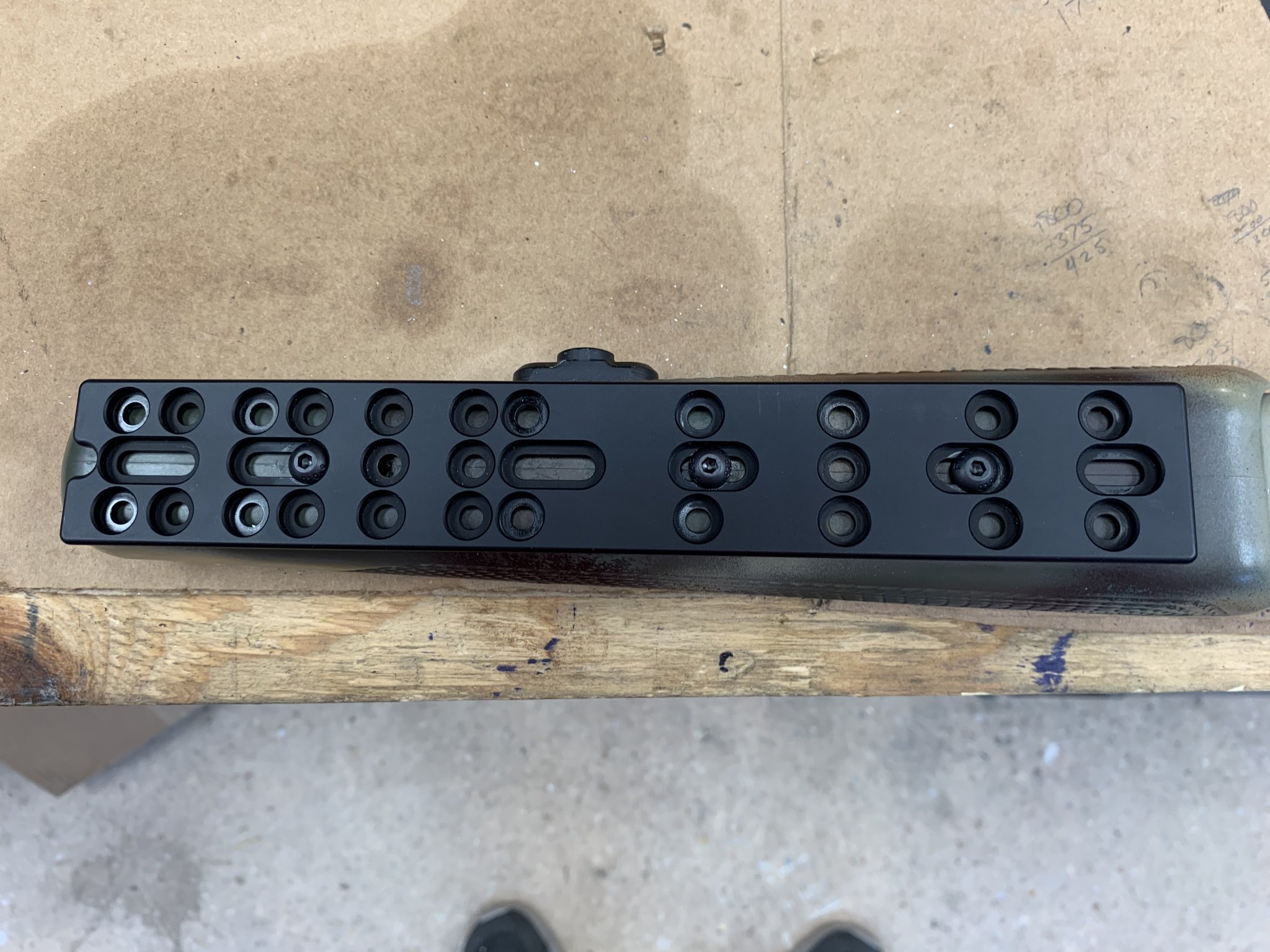

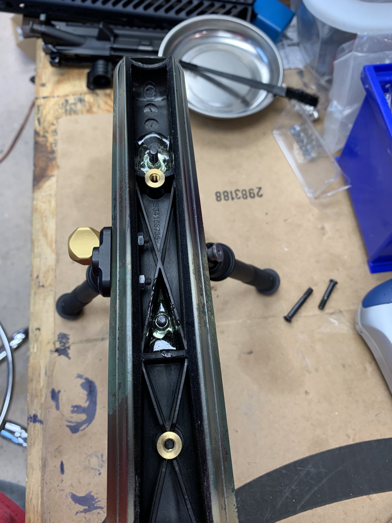

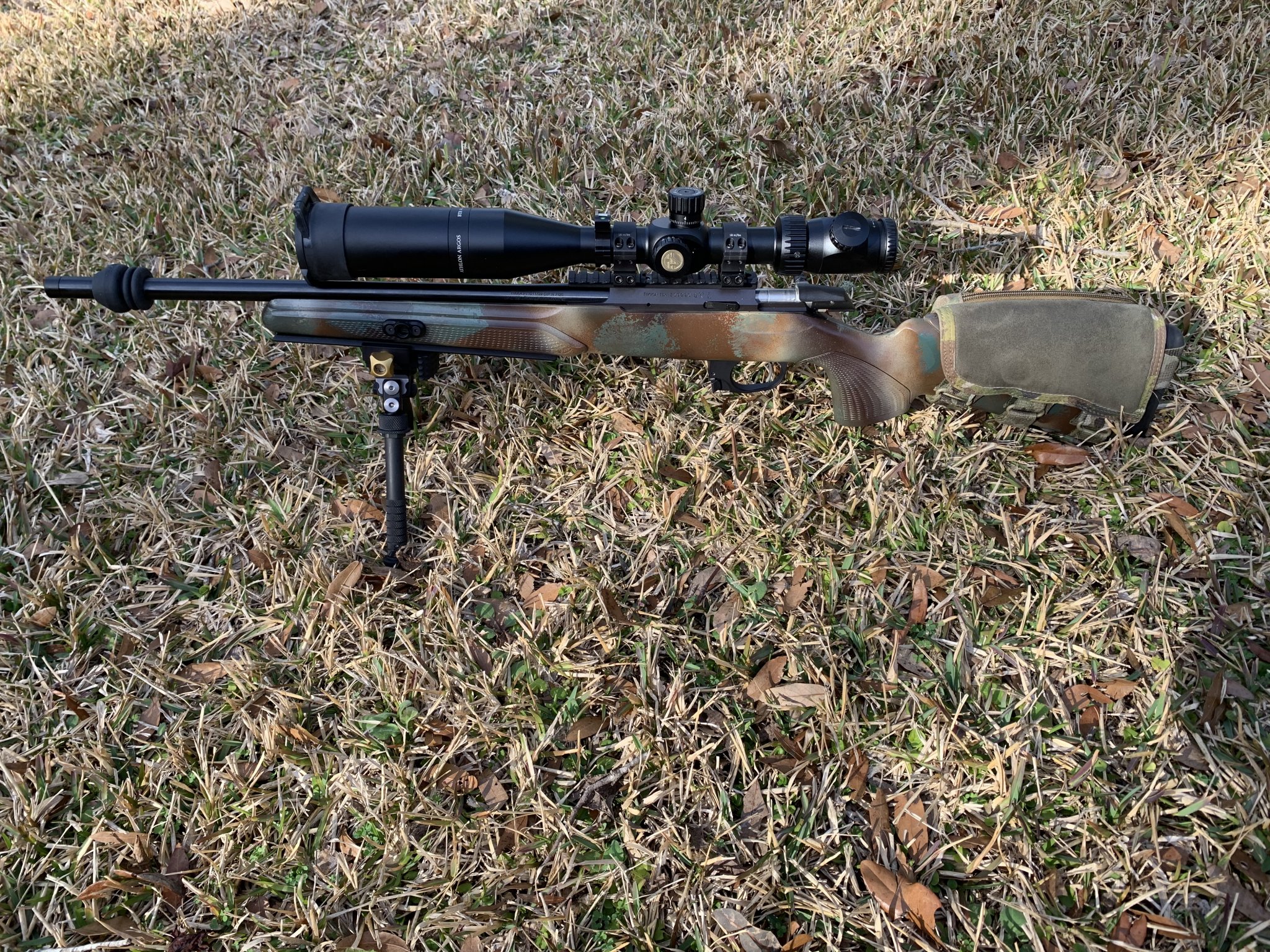

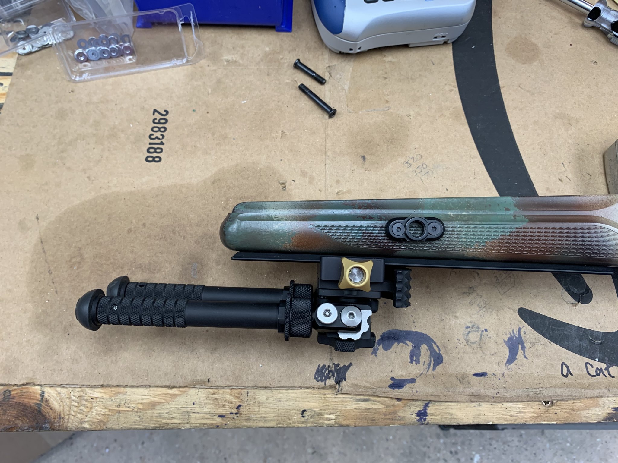

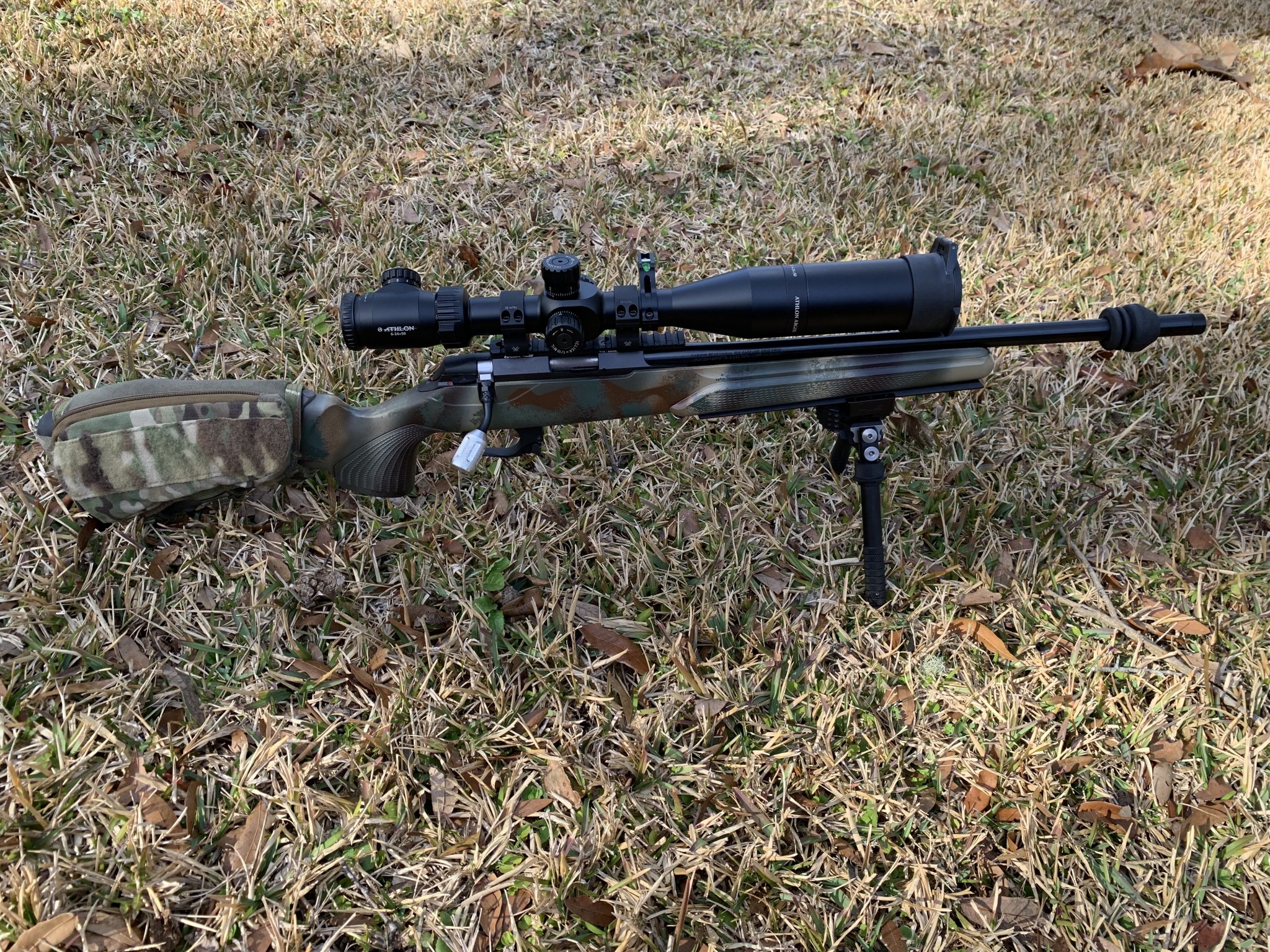

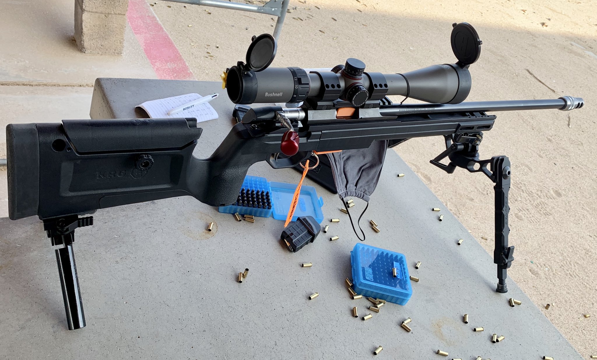

I borrowed the KRG Rail off of my Bravo for my "T1X in a T3X CTR Stock" gun
I had to mill a notch in the CTR bottom metal to clear the Allen Bolt that attaches the T1X Magazine Well to the action
The Rail as Installed with the Tikka Varmint Style Forend accessory
Interior of the barrel channel - I used Tee Nuts with epoxy and opened up the end of the stock to ensure that there would be no contact between the stock and and the barrel even if the bipod was loaded heavily.

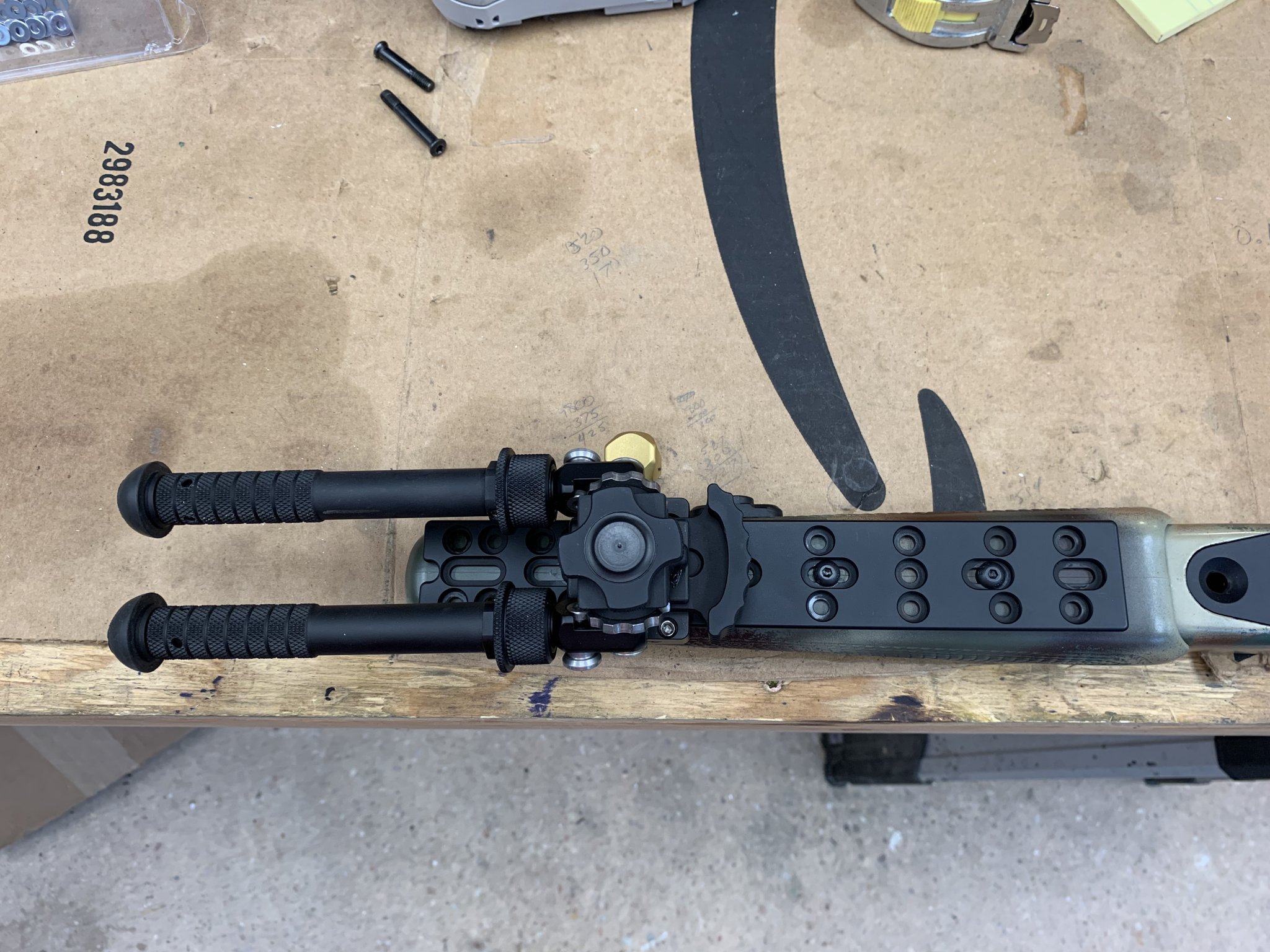

Area 419 ARCA Clamp and Atlas Bipod
A 10" Area 419 ARCA Rail and Rear Barricade Stop is probably in the near future for this rife and one for the Bravo as well.
A set of Vortex Defender Scope Caps and a Magnification lever are on the Buy List this week.
