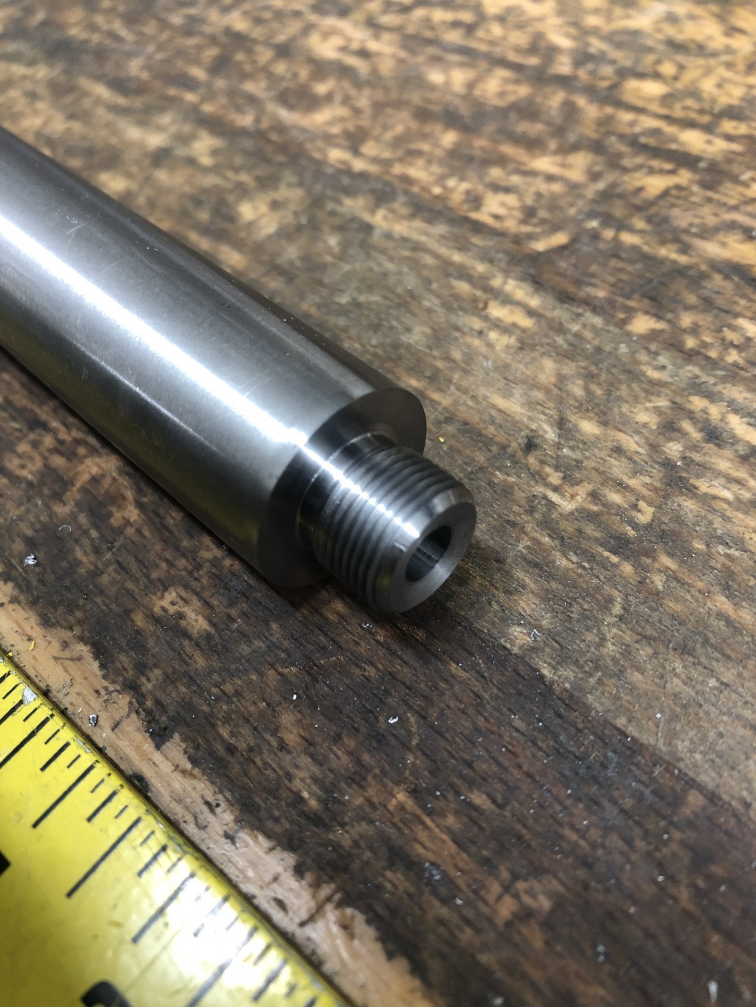

You don't have to go 5/8-24. 9/16-24 works as well. That is the minimum that thunderbeast recommends on their thread spec page. They do recommend a minimum od of 0.660.
I would also recommend @LongRifles Inc. for threading. $100 for a thread and crown and very fast turn around times. I think my 22lr rifle took 2 weeks including shipping.
Not putting suppressor on this one just a possible brake. I've heard of others putting 1/2-28 but they never mentioned the caliber. Thus me wondering if itll be enough meat.
From what I've seen the wall thickness is a little too thin on 1/2-28 for a 30 cal. I've heard reports of muzzles bell mouthing.
Just call up LRI and discuss with them. You may not be wanting a suppressor or be able to get one but LRI does threads the right way. The reason why I brought up thunderbeast is because they published a thread spec with measurements and class of fits (the spec of class 3 fit at the bottom. Means stuff to machinists.) If everybody measures and cuts to the same rules everything should fit the right way. Don't just cut til the muzzle break goes on. Cut to a standard. You still want good threads (on size and concentric) for a muzzle break too.

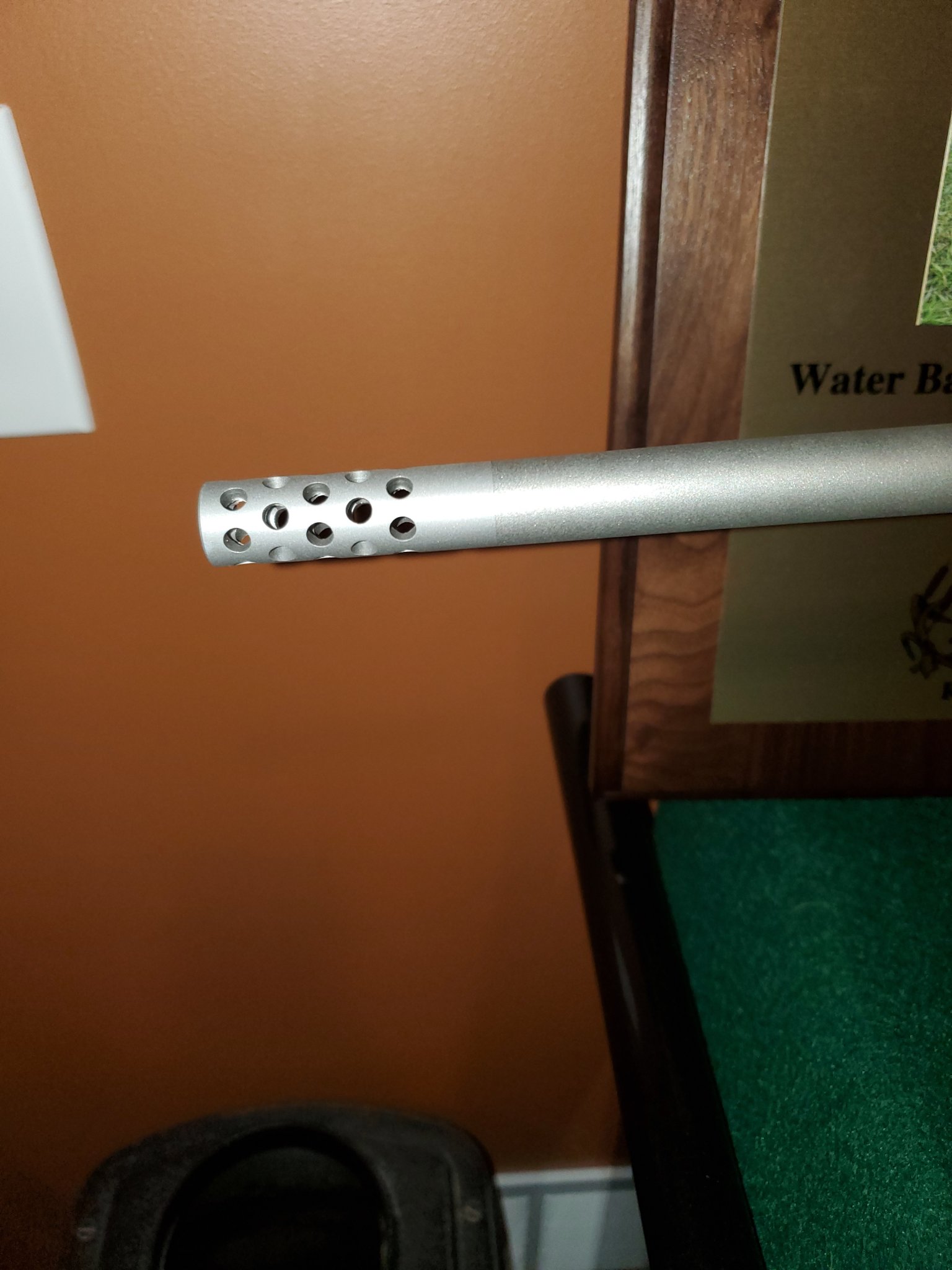

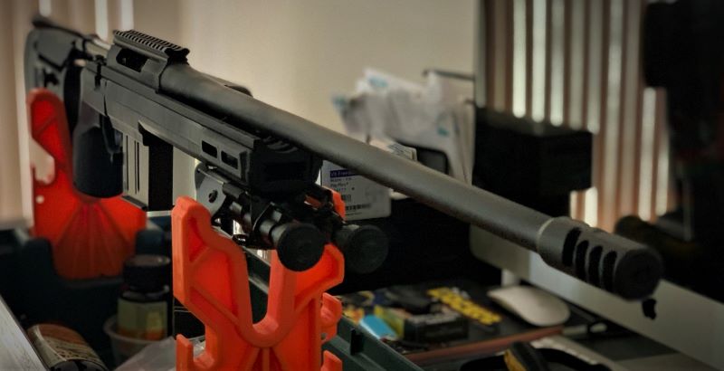

i sent my mate to my smith with his tikka 308 lite. my smith spun up thread on his barrel and installed a 3 port brake he (my smith) makes. no barrel shortening needed and he got his barreled action ceracoated while there. if a smith tells you it cant be done, find another smith.
i'll see if my mate can send me a pic of his tomorrow as he works nights and its night here.
finally got a pic of his 308 lite with a brake my smith makes. crappy pic but it sits nice on his barrel. i'll be installing the same brake on my 6.5 to replace the factory brake that came with my LA105. i'll get a better pic of it when i see him next. this thing i couldn't spot my shot when it didn't have a brake. i'll see how it goes with the brake when i get behind it.
