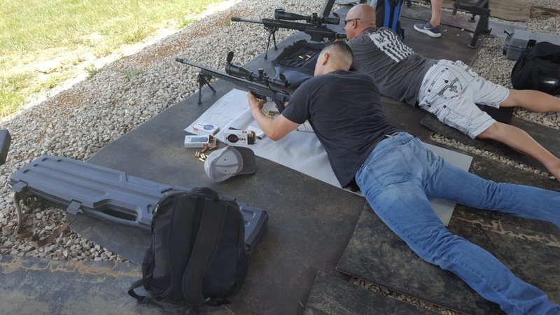

Yes, yesterday I was able to handle both. My CTR in the McRees G10 which is light and the Tac A1. The TIKKA chassis is great but heavy in comparison. the guy to the right in the shorts had it and we were both shooting out to 800. My brother was on my rifle in the jeans. The big difference just depends on if you mind a little extra weight, if we are just talking chassis.
Sorry, forgot the picture of both.

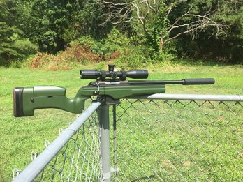

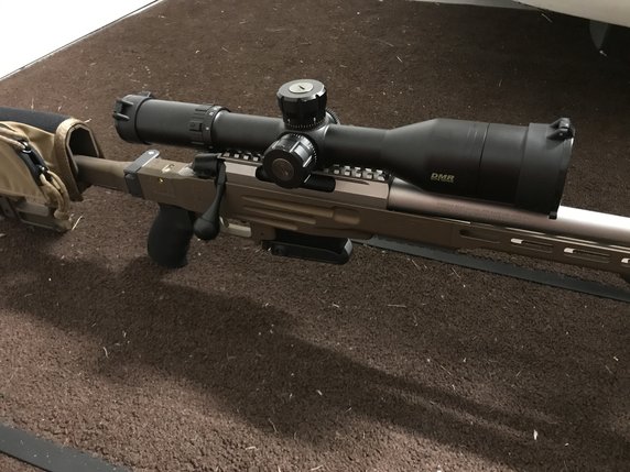

First Tikka just came in. Steals can be found on these right now. Scope and rings are being changed out shortly. Not sure on rings height, it will have a Bushnell DMR.

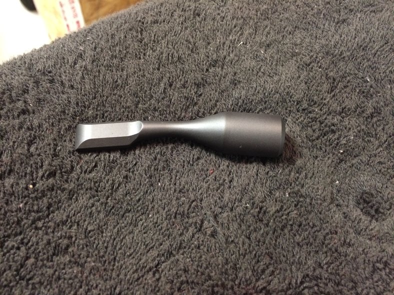

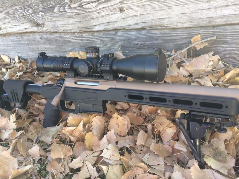

I don't actually make the entire knob I modify and thread the factory knob. Mine are actually threaded and capped with 416SS ends and then machined to final finish. Makes for a sleeker, cleaner looking knob I think. I got tired of all the big gawky gear shifter knob that everybody is selling. I mean, come on, we're cycle a silky smooth Tikka bolt; not shifting a truck transmission. Just my two cents and personal taste. I only make mine out of the factory bent knobs. IMG_1135.JPG
I find the factory Tikka handles to have a bit too much 'slop' for my liking though in regards to fitment. Hence why I CNC my own styles from scratch. Cerakote can 'gap fill' to an extent. Im talking small gaps..

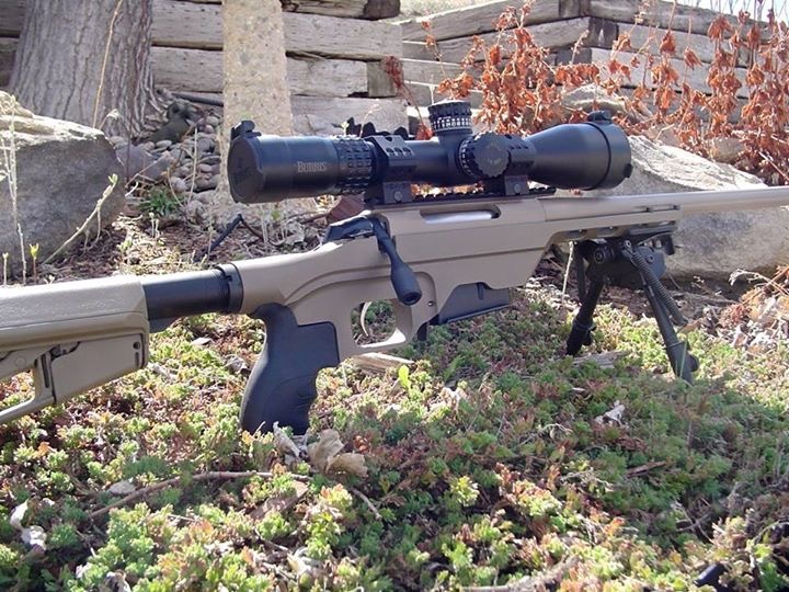

Nice work though, and nice rig. Burris scope good?
I just picked one of these up. What ammo are you shooting? I have yet to buy brass, bullets, and dies.
Hand loads. Lapua virgin brass, 140 Berger Hybrids, CCI BR primers, and 43.6 grains of H4350. This load averages 2683 in my rifle and is a hammer. Its strange but the load only shoots .6 or so at 100 but will shoot 1 inch at 300.
