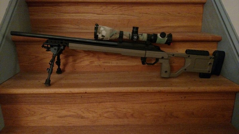

This is a one-off carbon prototype I made as a test bed. We can chop and change things to see what we or others like and what not.
It has a slightly shortened forend of our Multipurpose stock, same pistol grip as many like that, comb is lower by maybe 10mm making it easier to bore sight, has the same back adjustable cheek and butt pad spacer system as our E-Tac4 stock. Cheek raiser angles and position in regards to the action as well as the clamp arrangement is the same as an E-Tac4.
Hope to get the production version if it goes ahead down to 800 grams. ~28oz. As in pic.
At the moment I am not sure if the side on view is not a bit boring, handling is fantastic. I shot a crow off that flat bed at 425m with cheap American Eagle 50gr hp and 4 foxes one night under the lamp.

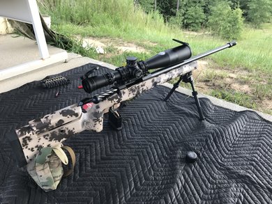

my CTR 308 stainless ready for the next hunting season. with 3-20 PMII and carbon E-Tac4ctr stock
