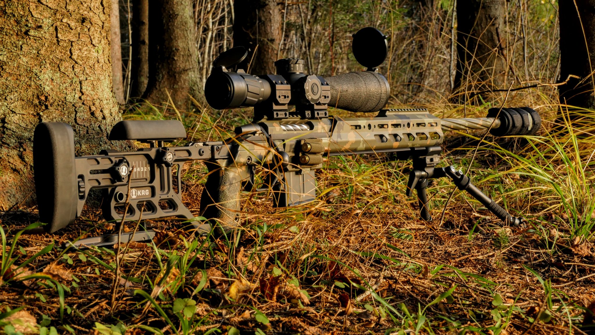

Got my barreled action back from Tim over at Solid Accuracy today. Barrel looks awesome and can't wait to get it to the range, hopefully tomorrow. Will get some better pics once I get outside.
Tikka T3X CTR
Criterion 26" straight bull barrel chambered in .308 win tac
Hellfire brake
Anarchy Outdoors bolt handle/knob
KRG Bravo
Area419 Arcalock rail/setup
Midas Tac 5-25x56 APRS3 MIL
Vortex PMR rings

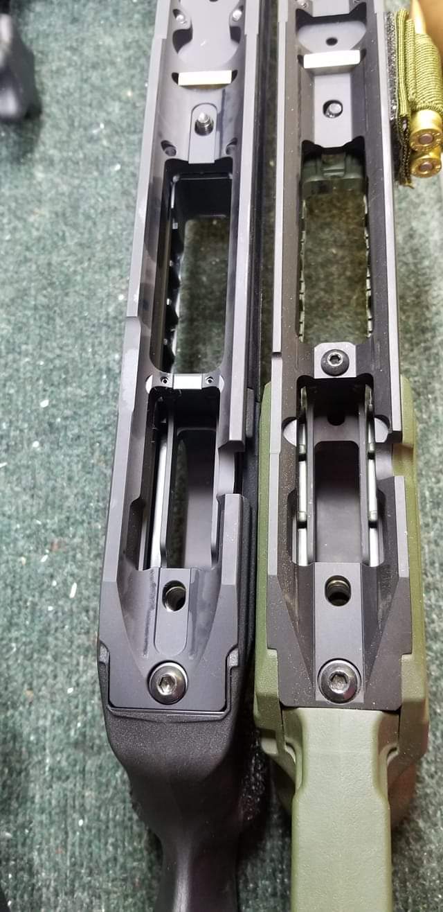

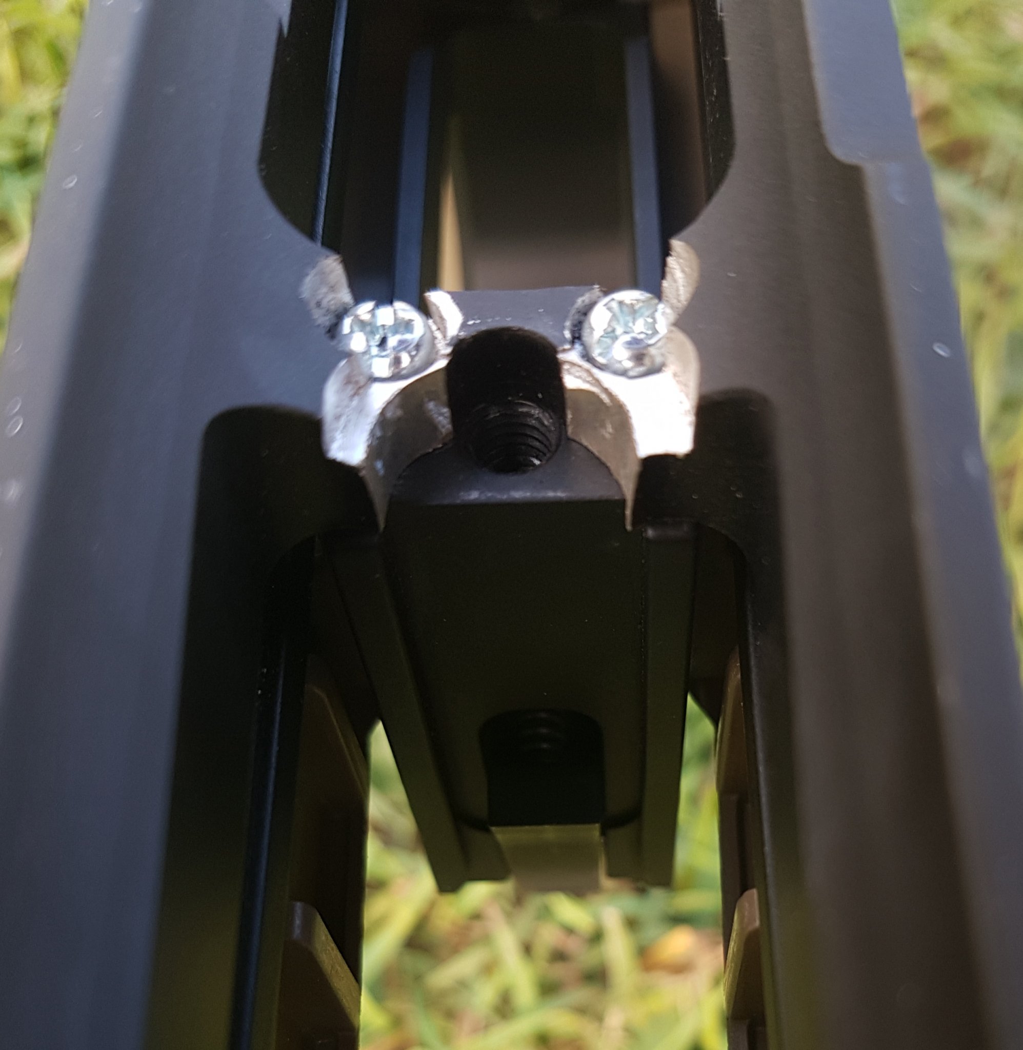

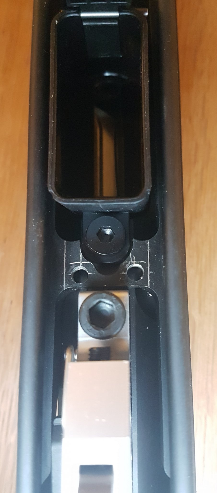

@Massoud question on the tikka stock. I have a t3 bravo, and am getting a t1x 17hmr. Can I retrofit the t3 stock? Or so I need a whole new t1x bravo?
Lol this has been posted a few times now. Im currently using a t3 bravo on a t1x. You need to change how the trigger guard on the bravo mounts as the internal button head screw is in the way on the t1x magazine well. 2019052.jpg20190525_170902.jpg201905252.jpg68489905_10216416412616307_6836455799032643584_o.jpg

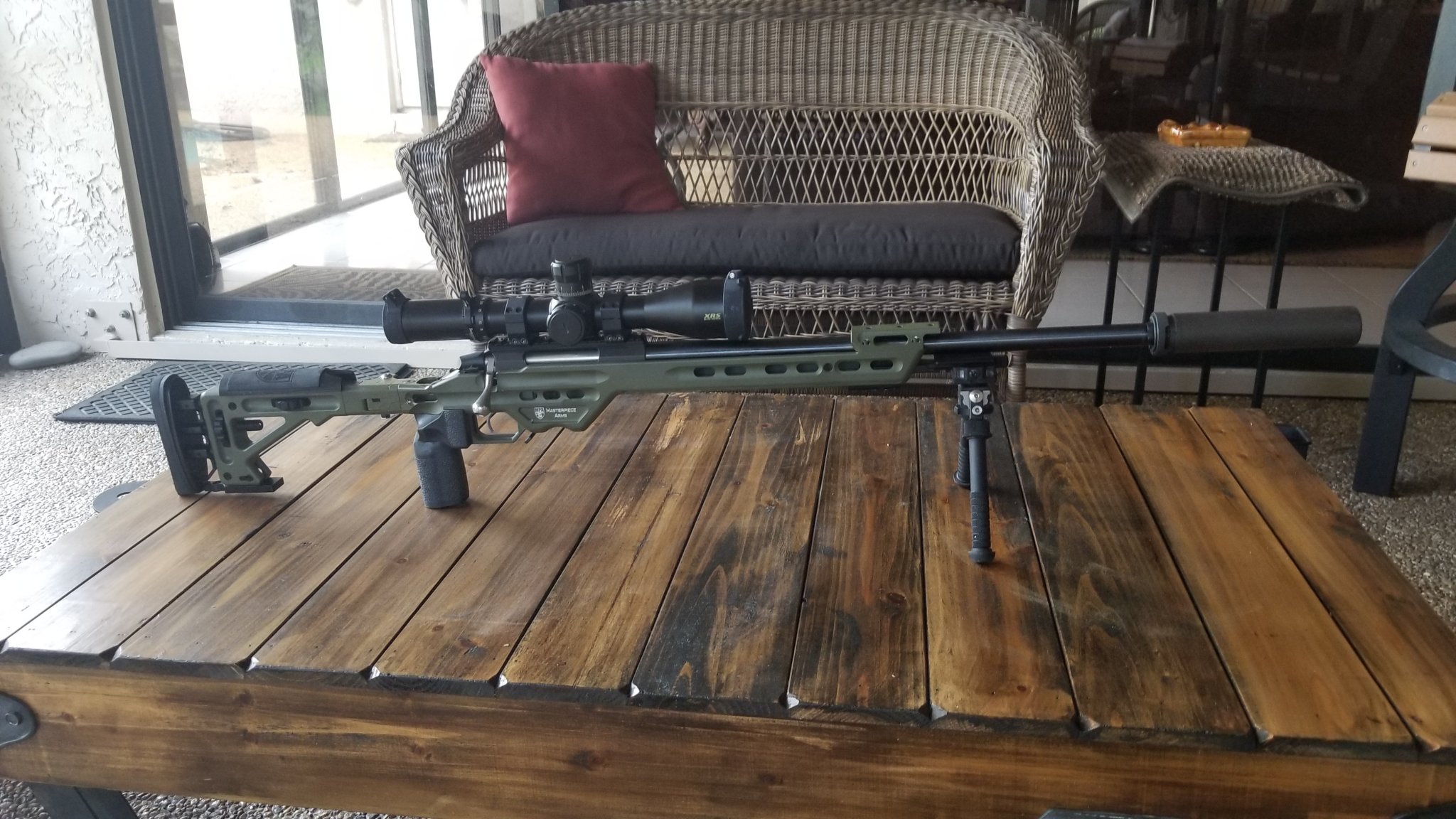

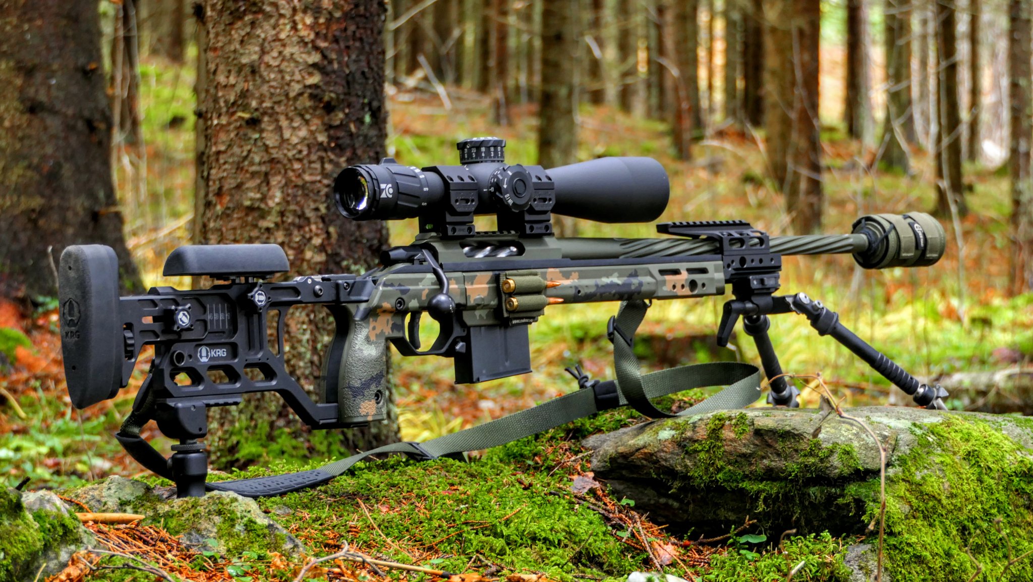

That is a Tikka T3X CTR 260rem.
Sterk swept bolt handle and Atlasworx bolt shroud.
Ensio Firearms spiral fluted bolt and barrel.
KRG whiskey chassis, custom cerakoted with Finnish army M05 camo pattern.
Audere 2-piece rings.
ZCO 527 scope.
Ase Utra Sl5i suppressor.
ColeTac Metal phyton cover and 2 ammo holder.
Atlas CAL bipod with Boscabel titanium spiked feets.
:p, thanks man.
ZCO 527 scope.
Thanks bro. That is one sweet ass rifle.

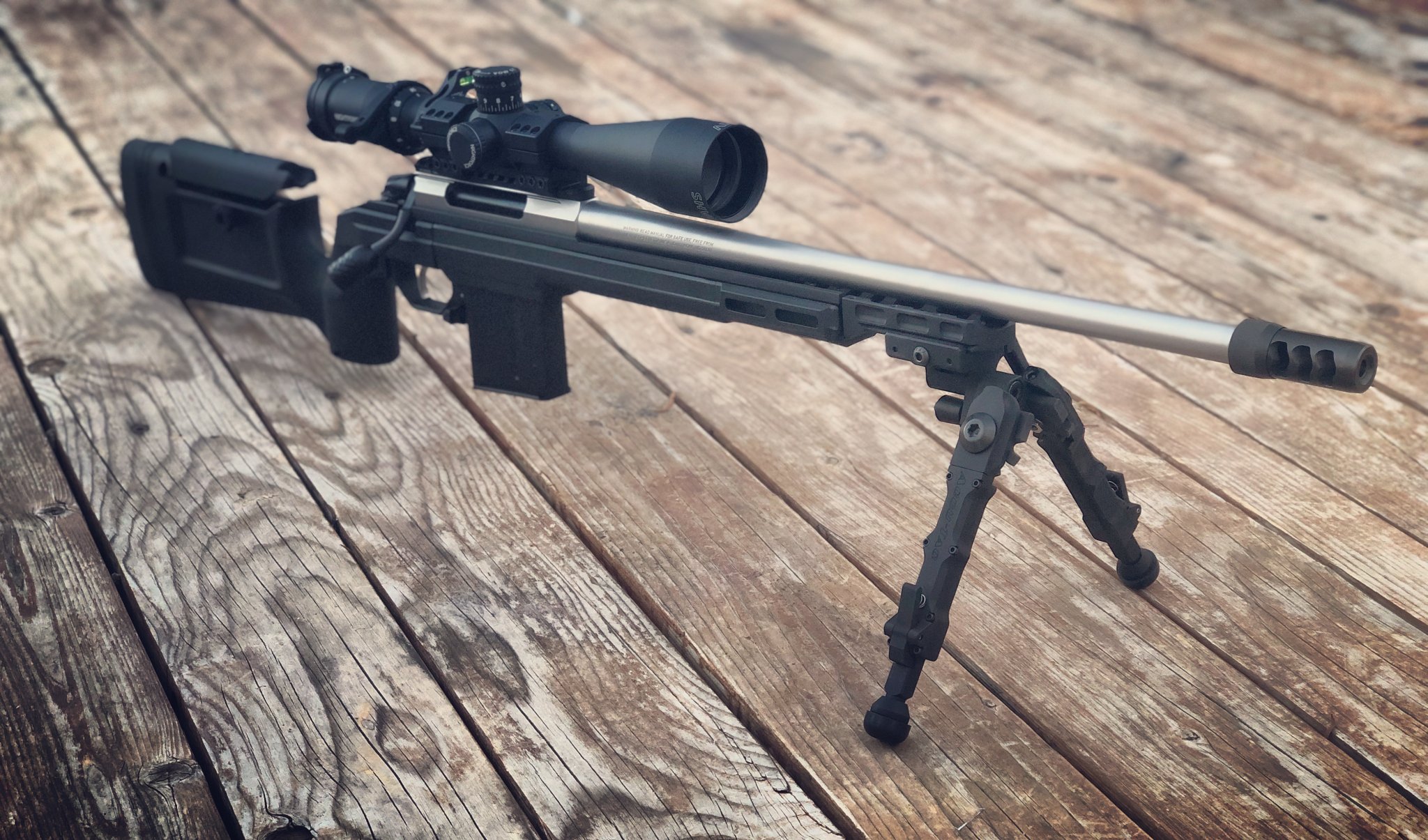

This is a rifle of mine I like a lot. I got a used T3X Varmint 223 off gunbroker that someone had cut back to about 21" and threaded. I dropped it in an MPA chasis and been shooting 1/2 MOA with Federal GM.

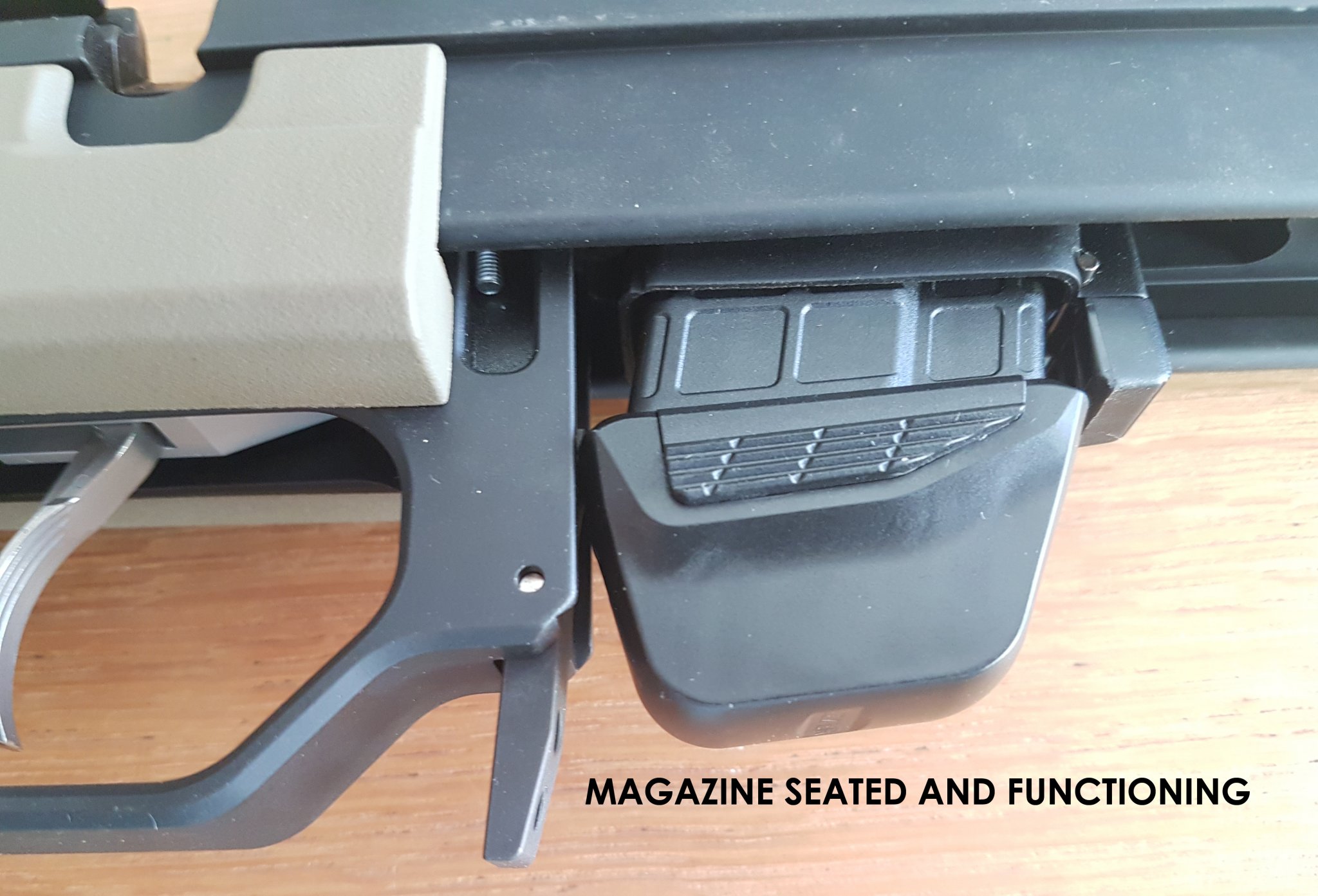

Has anyone tried running a Tikka in 223 AI with CTR 223 magazines? I’m considering it but would love to know if it will cause any feeding issues.
I would also like to know if anyone has tried this, thinking of doing a 223ai build and running CTR mags but wondering how they feed. Anyone with feedback?
I was going to start a separate thread but I’ll just ask here. I have a T3x lite in 223 that I plan to put in a bravo chassis, should I get the CTR bravo and use the new 223 mags or go AICS and use MDT mags? COAL isn’t super important to me but reliability is, I’d rather not pay the ridiculous price for CTR mags but I’ll suck it up if the MDT is inferior.
I use the MDT poly AICS mags in my Tikka Varmint. I had to file down the feed lips to keep the bolt from dragging, but I have 3 and they feed great. Loaned one to a guy at a match that was shooting a Rem 700 and they worked fine in his rifle too.
Not sure if it is caliber specific but my CTR mags, in 6.5, feed flawlessly in my TAC A1
Appreciate the info! But yes it’s kinda caliber specific, the 223ai has a bit different case specs than the standard 223 and sometimes has difficulty feeding out of mags without some modifications.
