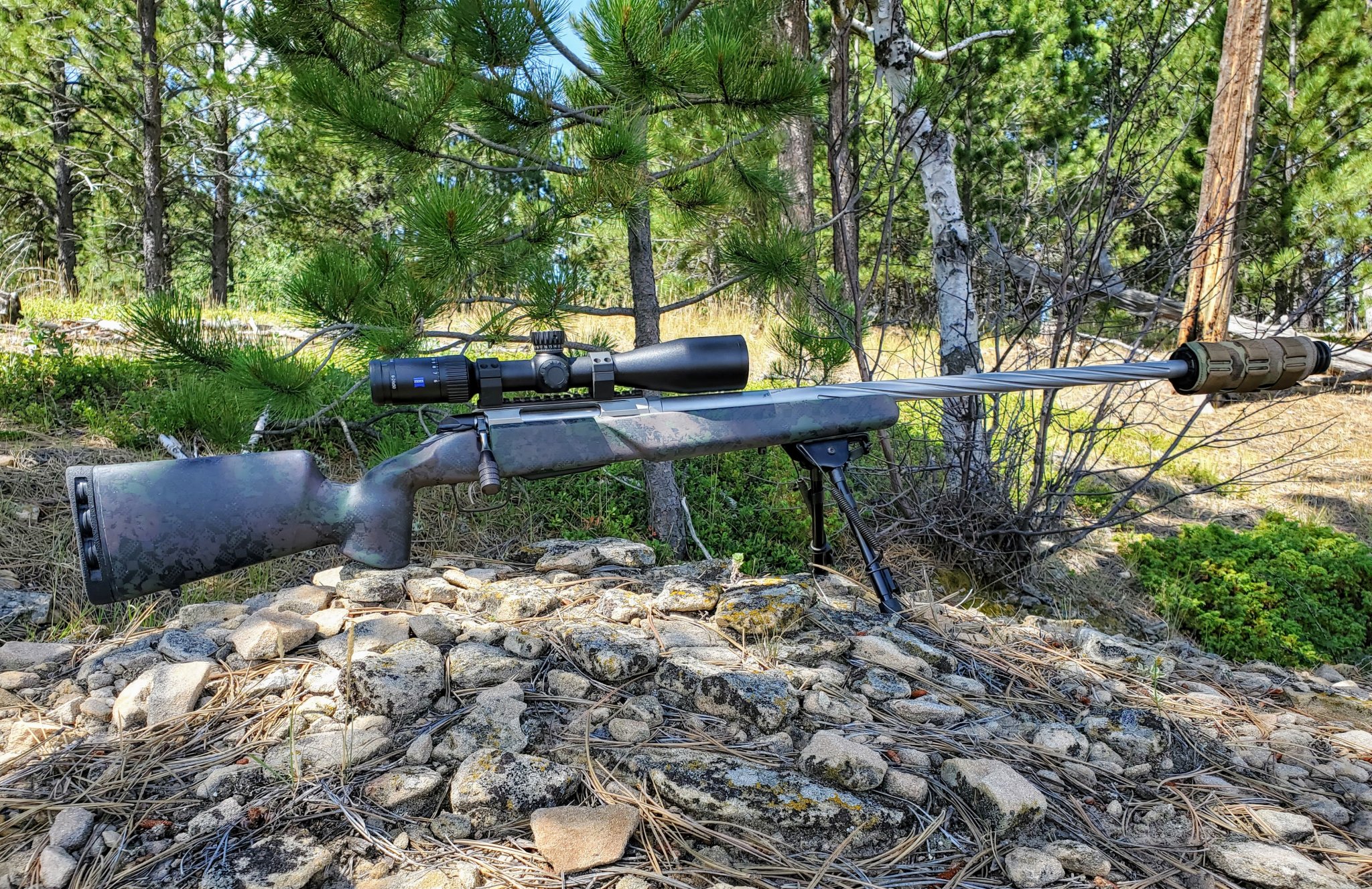

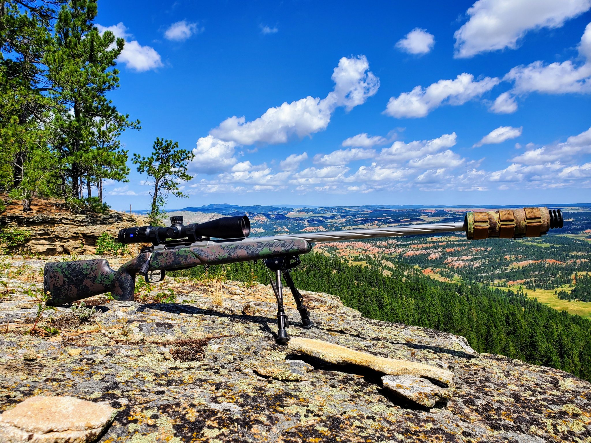

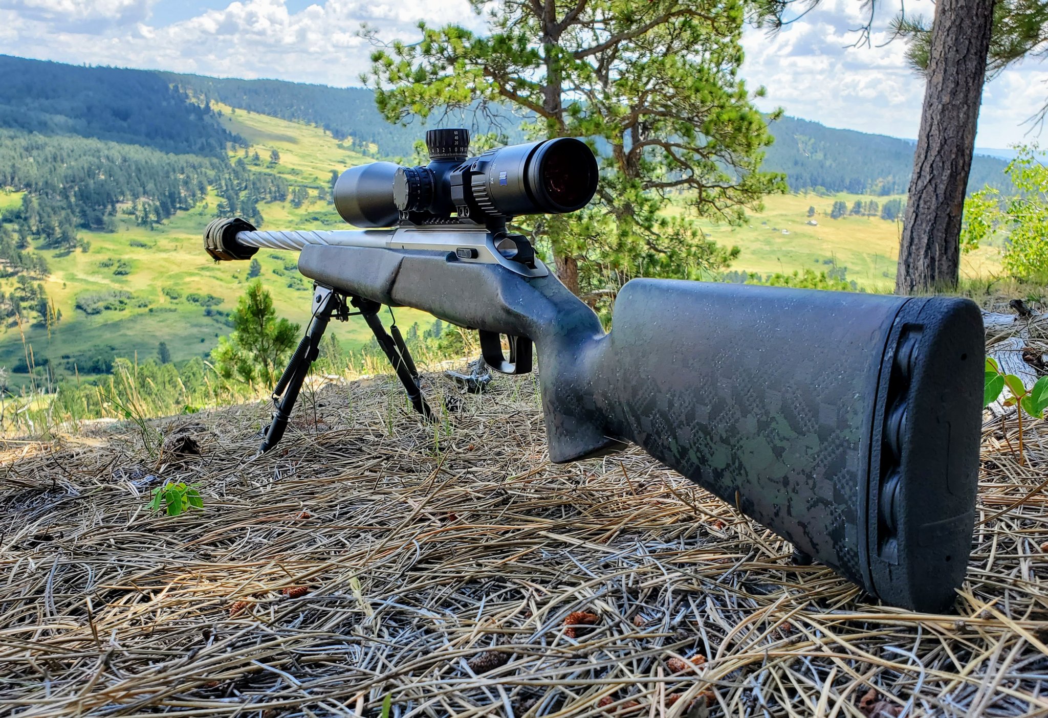

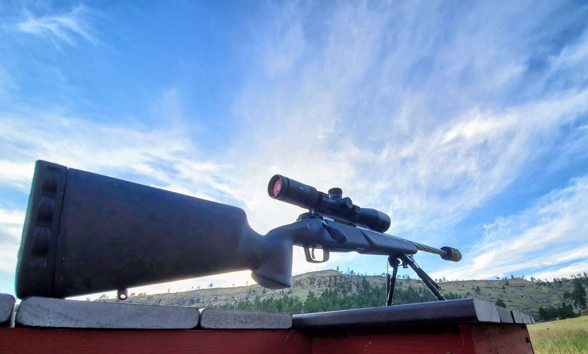

3 deer over the weekend with Tikkas. 2 with my 270 Superlite in the Northwoods and 1 with my 260 CTR on the farm.

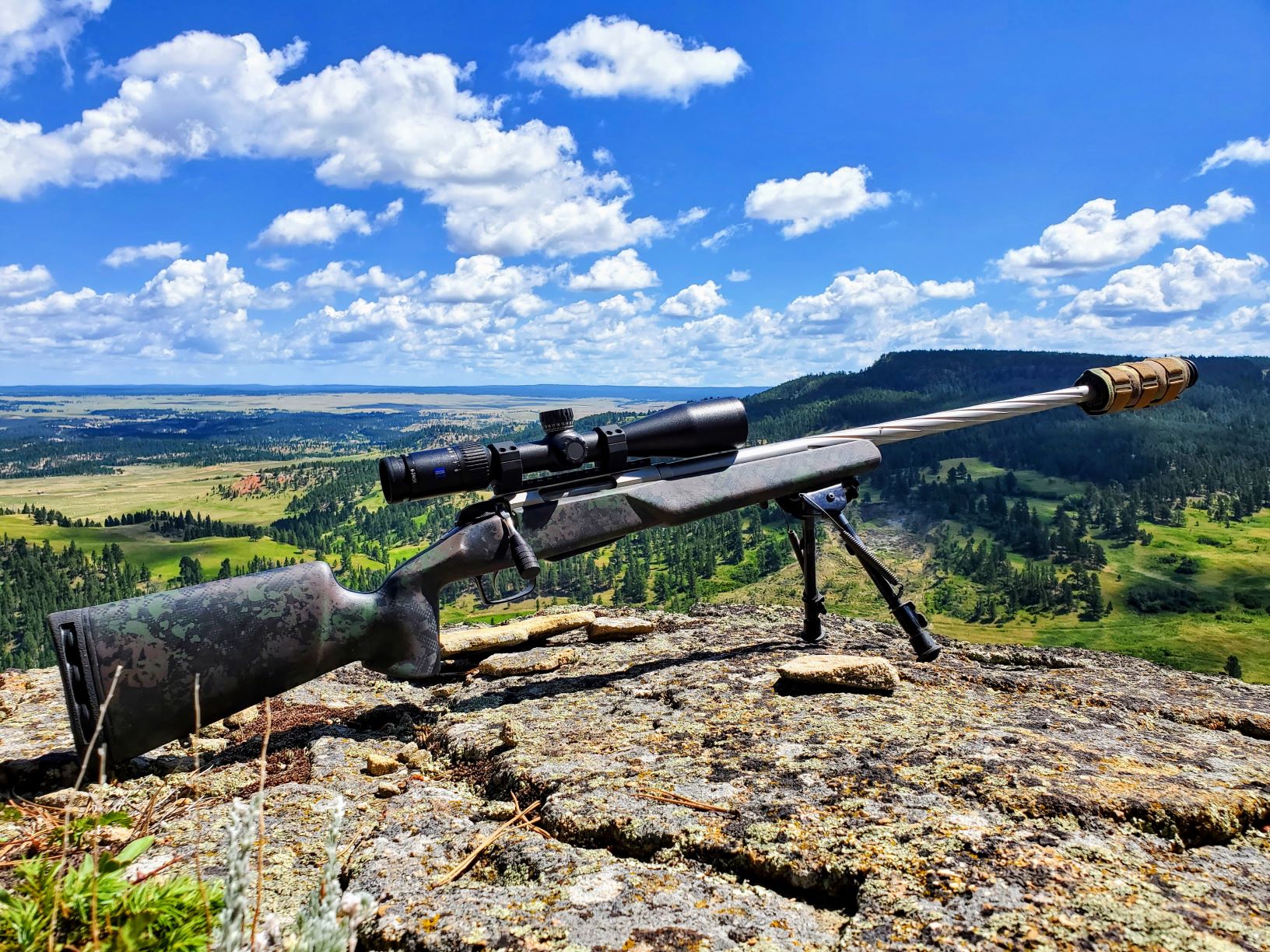

Since Luke asked, my first Tikka build:
Tikka T3x Lite Stainless in .270 Winchester
26" Preferred Barrel Blanks Variable Shoulder .800 Varmint in 6.5-284
Iota Outdoors Eko, no bedding
Mtn Tactical Bottom metal
Mtn Tactial 20MOA rail (I think...can't recall for sure if it was Jason's rails or one I had previously)
Stock Trigger with Mtn Tactical spring
Glades Armory bolt handle (another "I think". I've had it around for a couple of years)
Zeiss V4 6-24
10.3lbs with Zeiss 6-24 in Seekins rings
The rifle shoots far better than I do, turning out several half inch 4 and 5 groups at 200yds during load development, pushing Hornady 140 BTHPs at 2900fps. My chosen "target" load is pushing 142SMKs at 3015, and turning out .35moa, while my "hunting" load is just as accurate, pushing the 130gr Sierra Tipped GameKings at 3144fps.
The Eko stock checked in at 32oz, and is a great fit. If I had it to do over again, I would have gone with a lighter contour and a shouldered prefit rather than the variable. My idea at the time was to be able to switch barrels easily. Since then, I've learned that the shouldered prefit is just as easy to change and likely more repeatable for precise headspace. I've also learned that the rifle is fantastic from static positions, but a bit cumbersome for spot and stalk with the can. With the light stock and heavy, long barrel, the length and the balance are just a pain when hunting.
At 400yds and quartering hard away, that whitetail took a 130gr STGK in the last rib on the near side, passed through the vitals, out the first rib on the off side, and we found the jacket lodged in the neck muscles just under the hide.

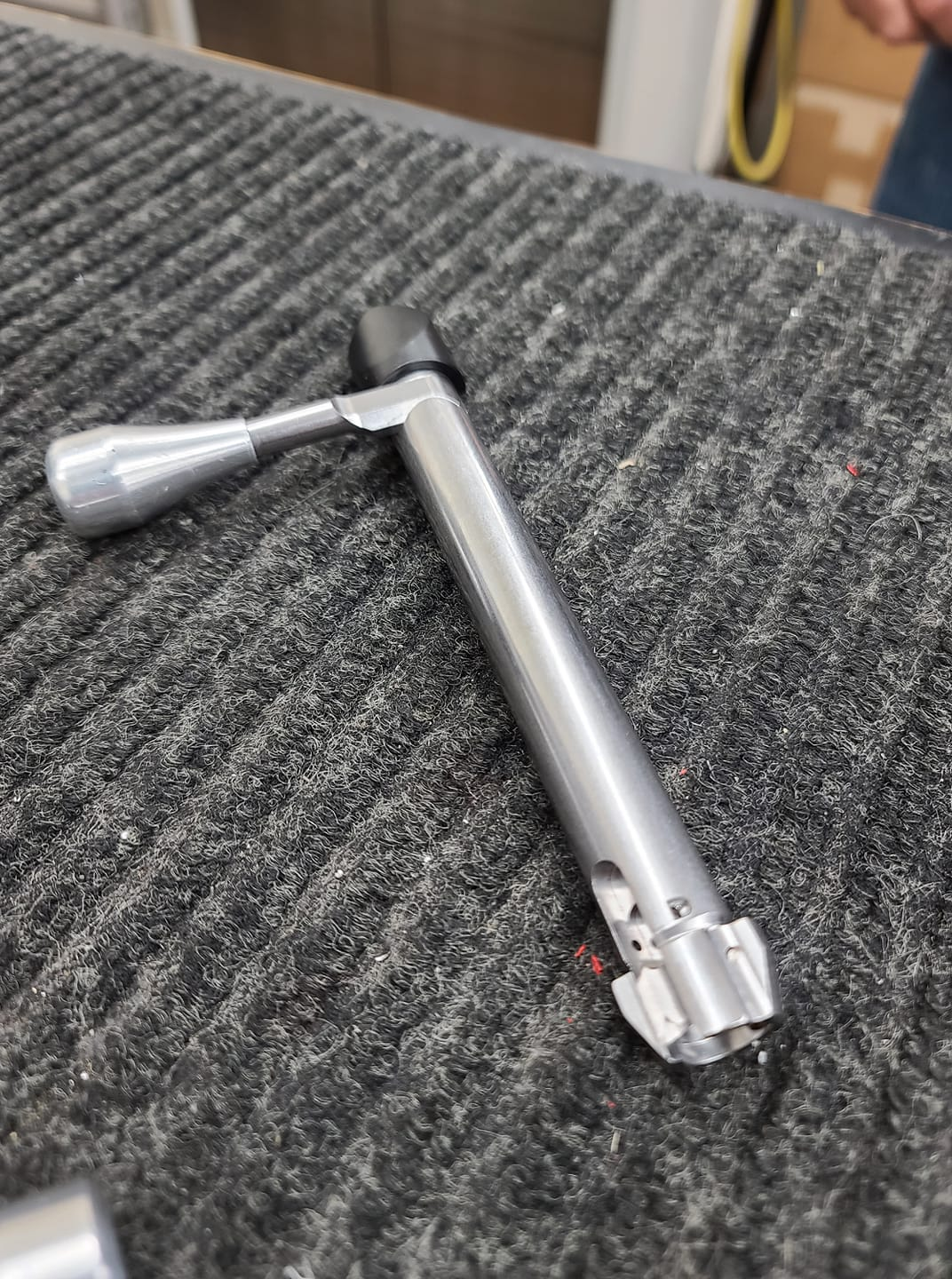

Asked for and now delivered:
LRI is happy to announce that Tikka replacement bolts are now a thing.
Details:
tainless bolt body and handle
Complete fire control
Bar stock machined bolt shroud. -No plastic or Zinc casting
.480 and .545 diameter bolt faces available We might do a .590 for Lapua and/or a .390 for 223 stuff later
RIGHT HANDED only. Sorry Lefties.
M16 style extractor
We have inventory on the floor. I'm currently working on the extractors and they'll be done hopefully this week. They still have to go to heat treat but that doesn't take very long.
Price: $375.00 for the complete drop on bolt. These will only be sold as complete units.

I am sure the answer to this question is yes, but will these bolts headspace the same as the factory bolt and allow use of prefits?
See this link:

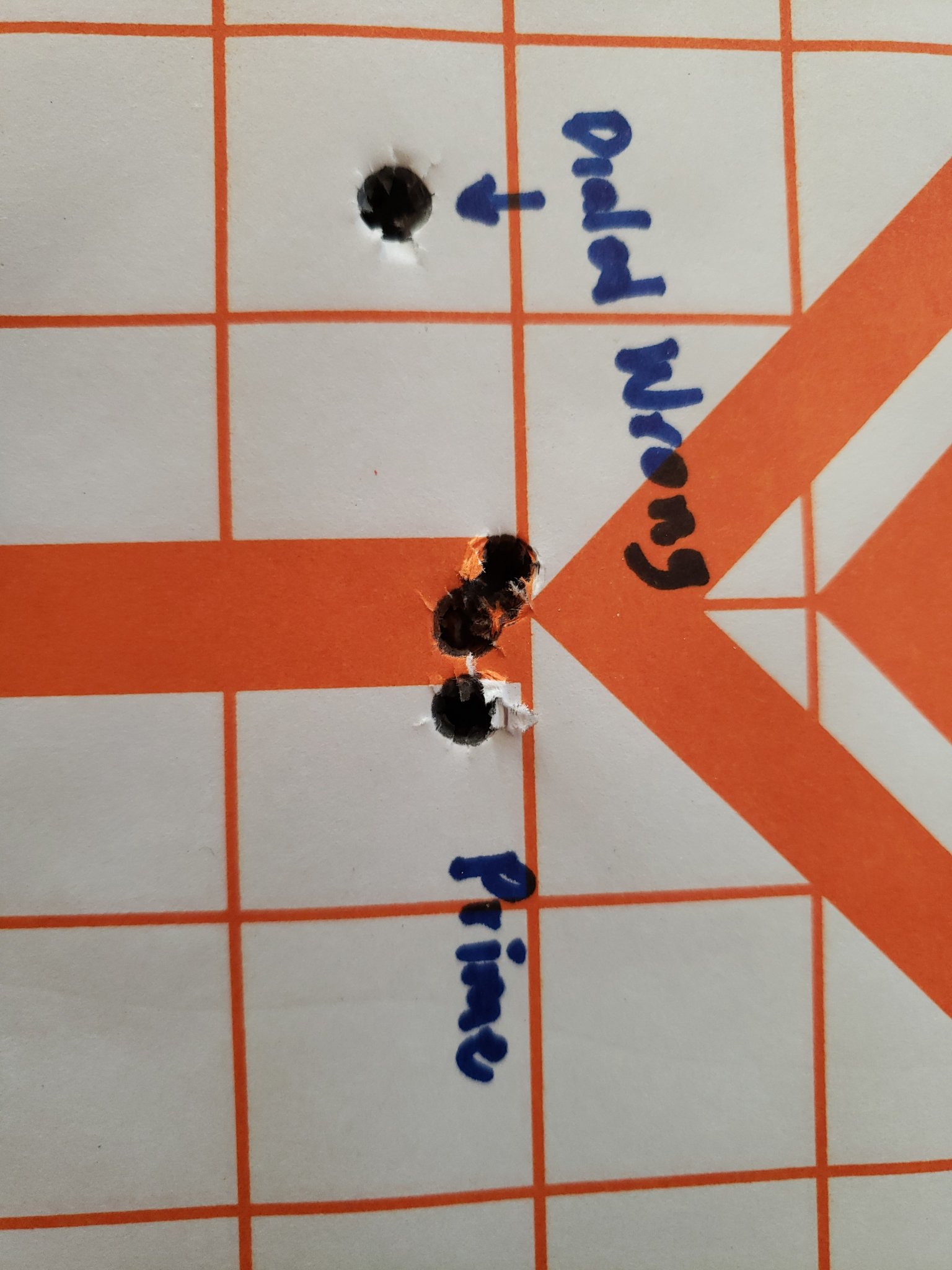

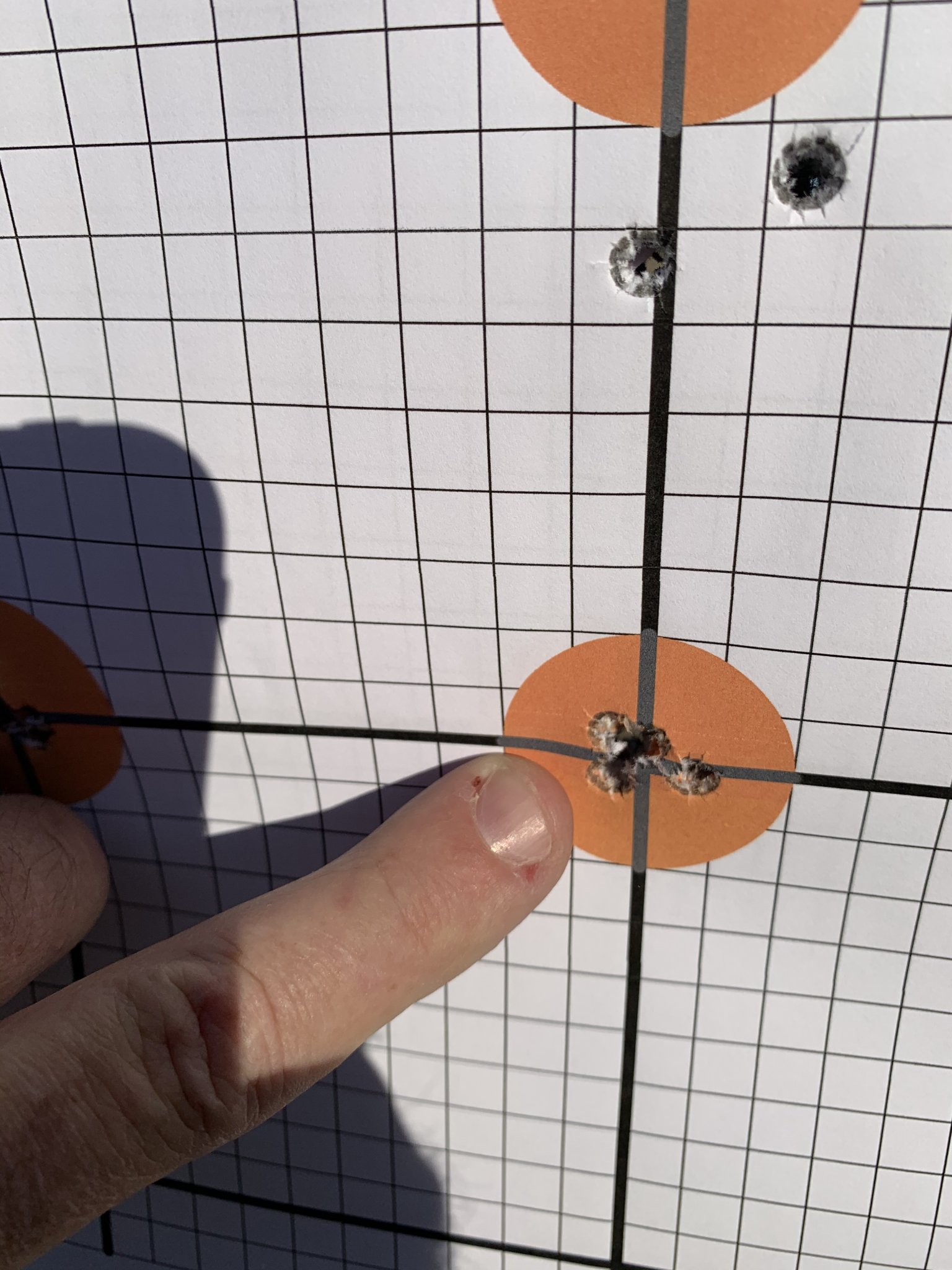

Here are 5 shots with prime doing deer season zero verification with 20in .260 CTR stainless. First shot out left is cuz I mixed up my left from right. Corrected and piled the last 4 in what you see. Shot off a cheap bag and no rear support.
Perfect, thanks. I’ll verify mine likes it as well and get a case on the way. Appreciate the info.

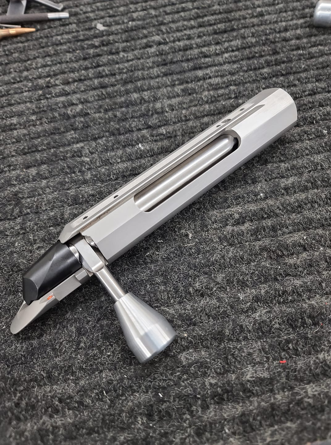

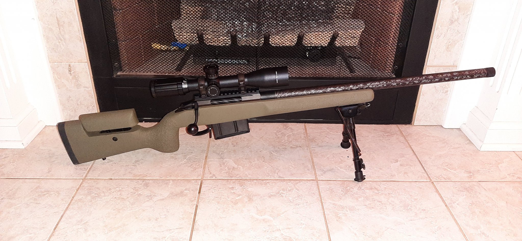

Just got this little rig back from the 'smith. Andrew Delikat (AD Arms) did me a solid deal on rebarreling this T3 with a 24" Sendero profile Proof Carbon barrel in .308 with a 1:10 twist as well as fluting the bolt and making sure it was all square.
Chamber is off my PTG .308 Bisely 150 reamer with a 0.170" freebore to handle Berger 200.20X at a case-capacity optimized length.
Scope is a SWFA fixed 16x I had on a 20 MOA base. Should be good for the long shots with all that elevation available.
Gonna whip up some loads and get her lined up.

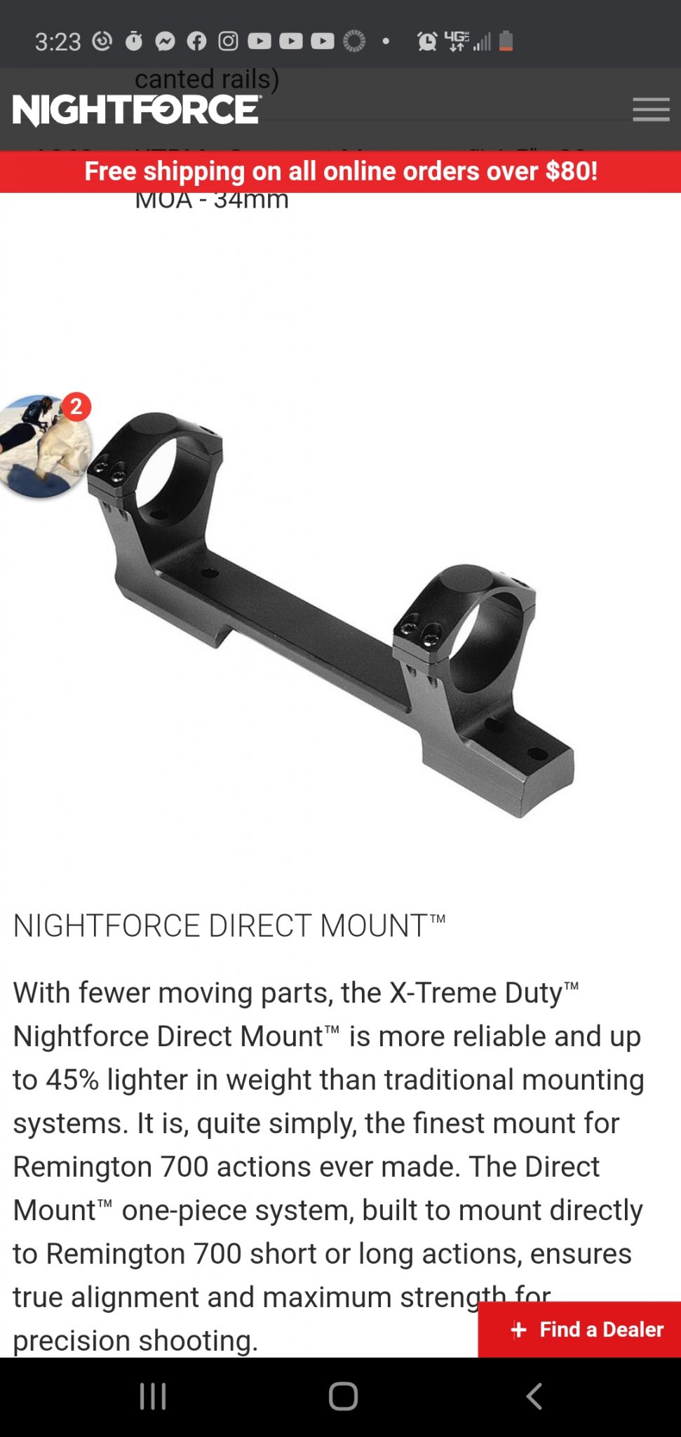

Thanks man! I think im gonna go with the alphahunter. Don't you need the dovetail receiver for these spuhr mounts??
T3s have a dovetail receiver and the Spuhr hunting mounts fit them like a glove. There is also an integral lug in the mount that mates to the receiver. Swapping them around I typically need .2 mil or less adjustment.
ETA Khuber's already there
Badass, im out of town and couldn't tell if my receiver had that or not from the pictures. I was unaware that is standard
