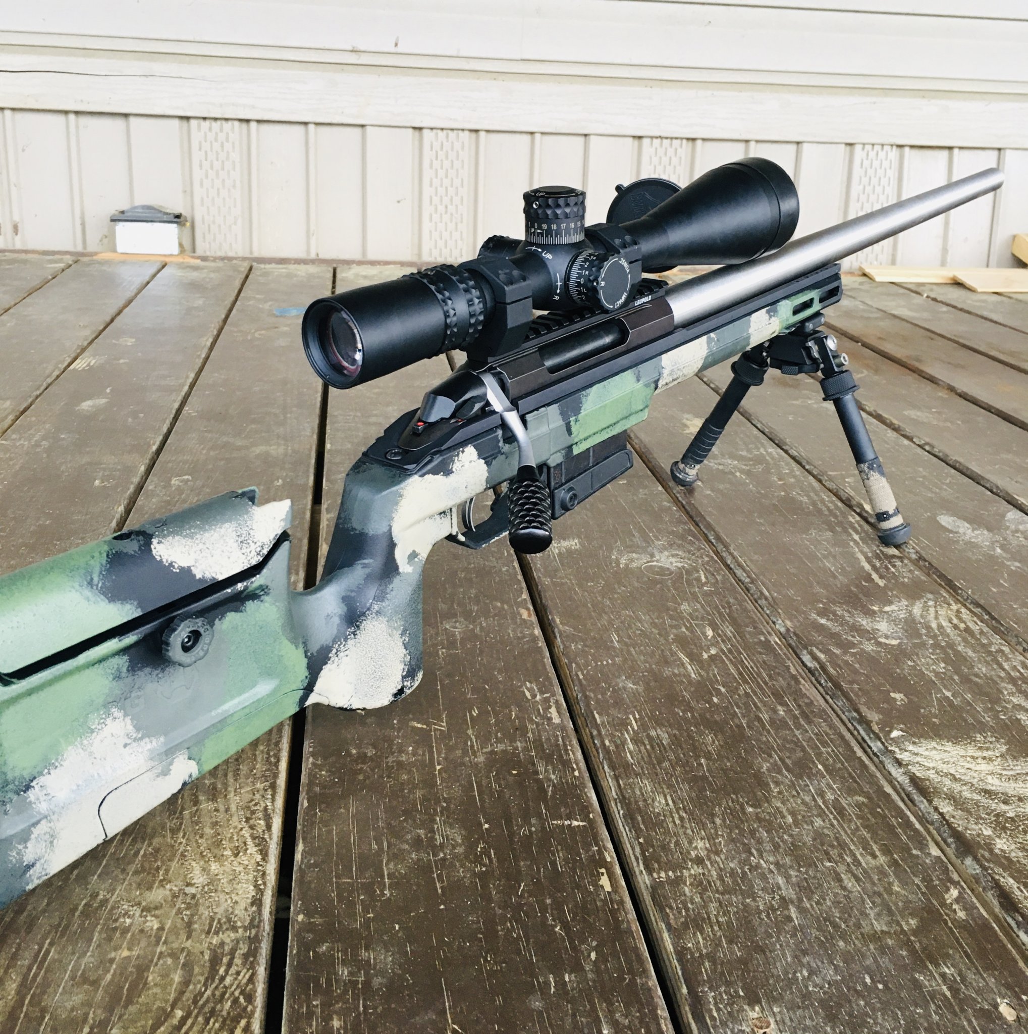

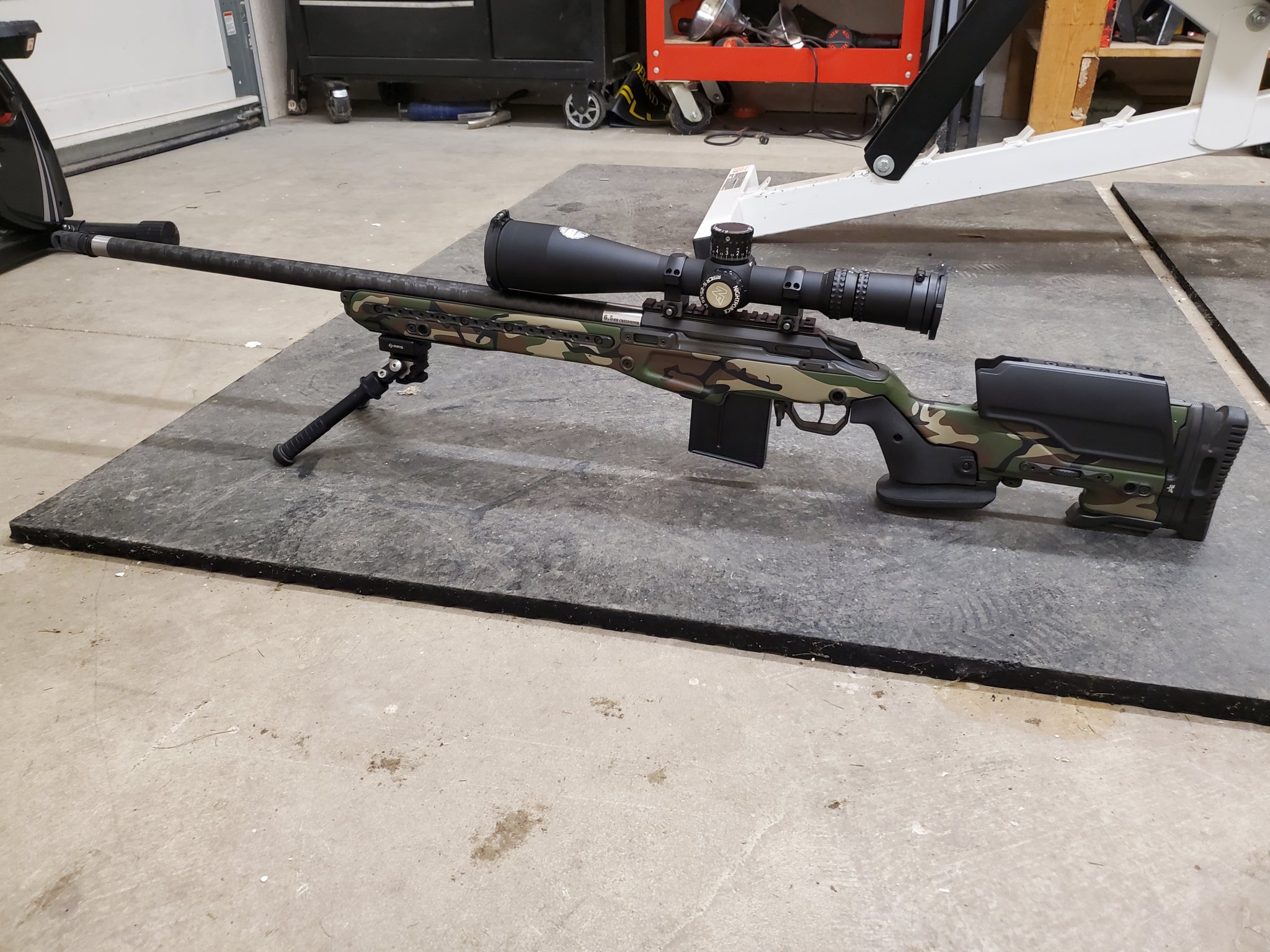

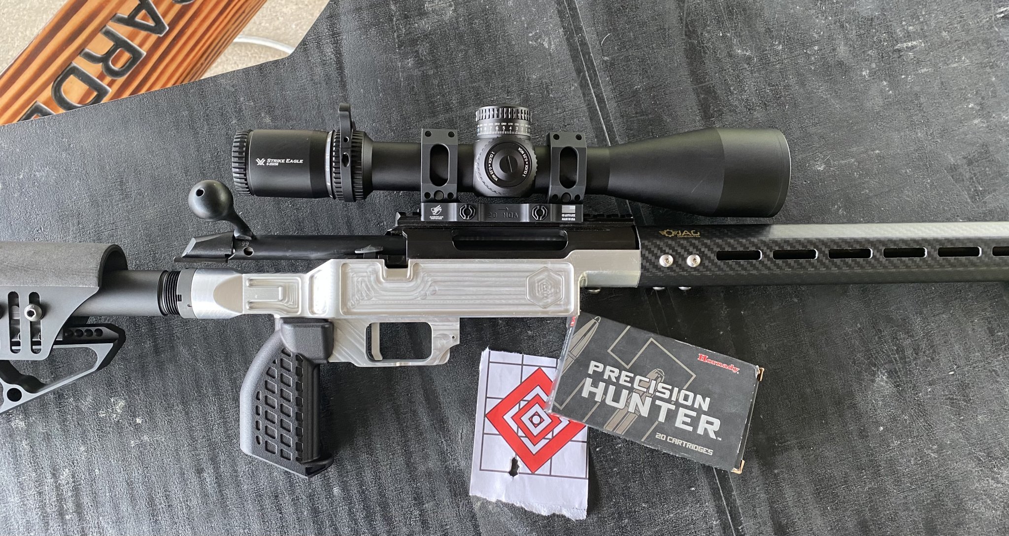

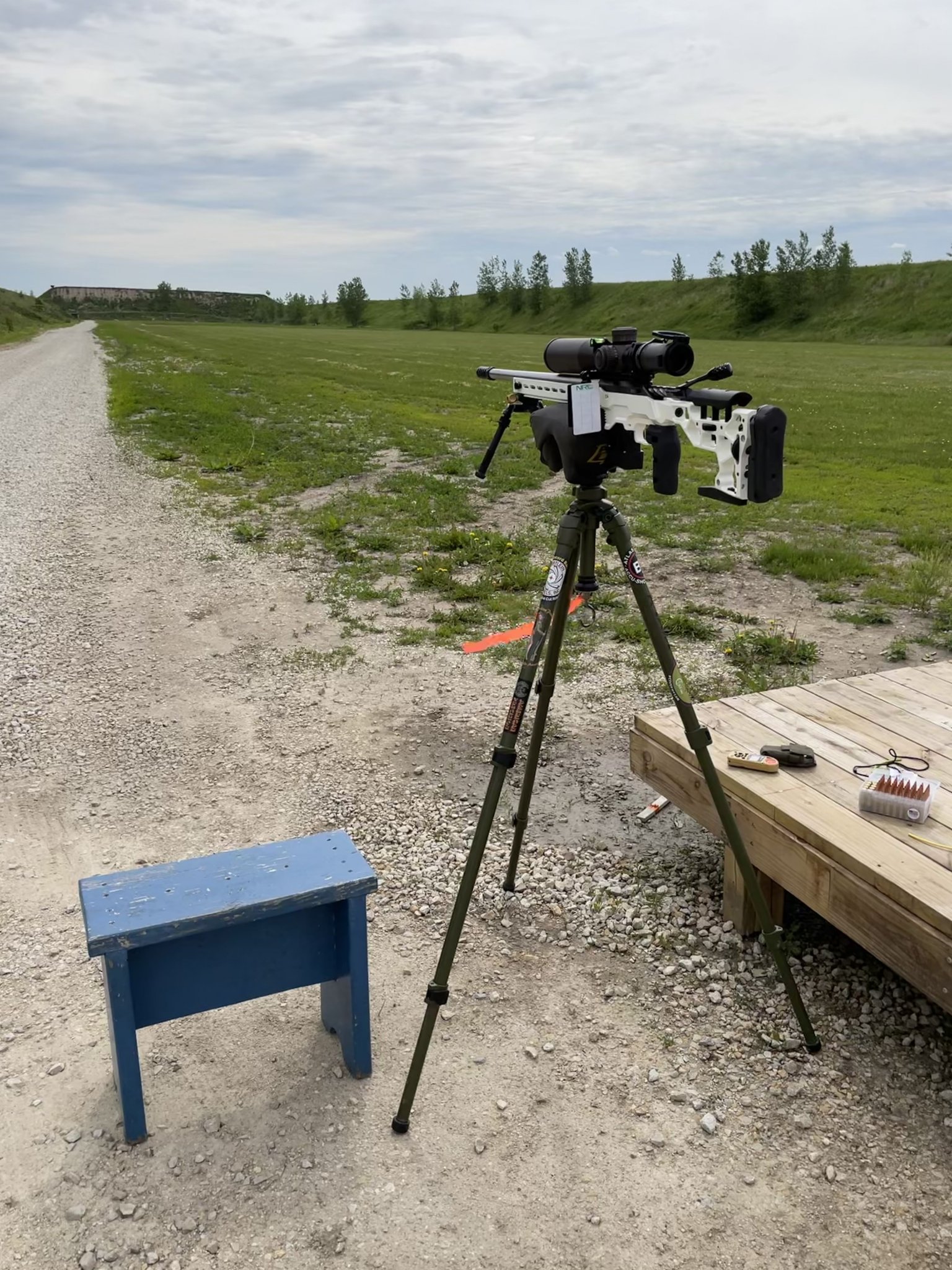

Got out to test my new prototype chassis this morning. I’ll be damned if this isn’t my favorite center fire to shoot. Loves 143 ELDX. It’s just a 3 shot group (I know, drag me) but I’m a little short on Ammo at the moment so conserving until I can get more serious testing in.
Reactions: GrumpyOleFart

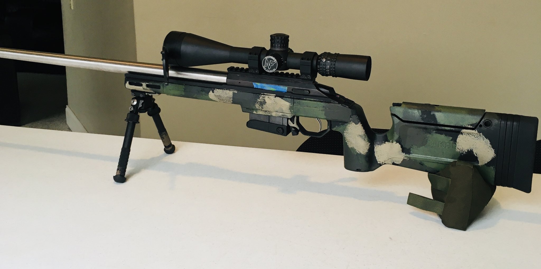

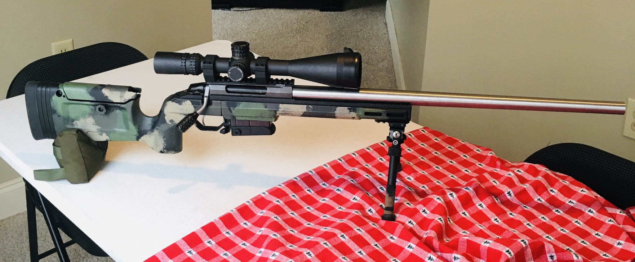

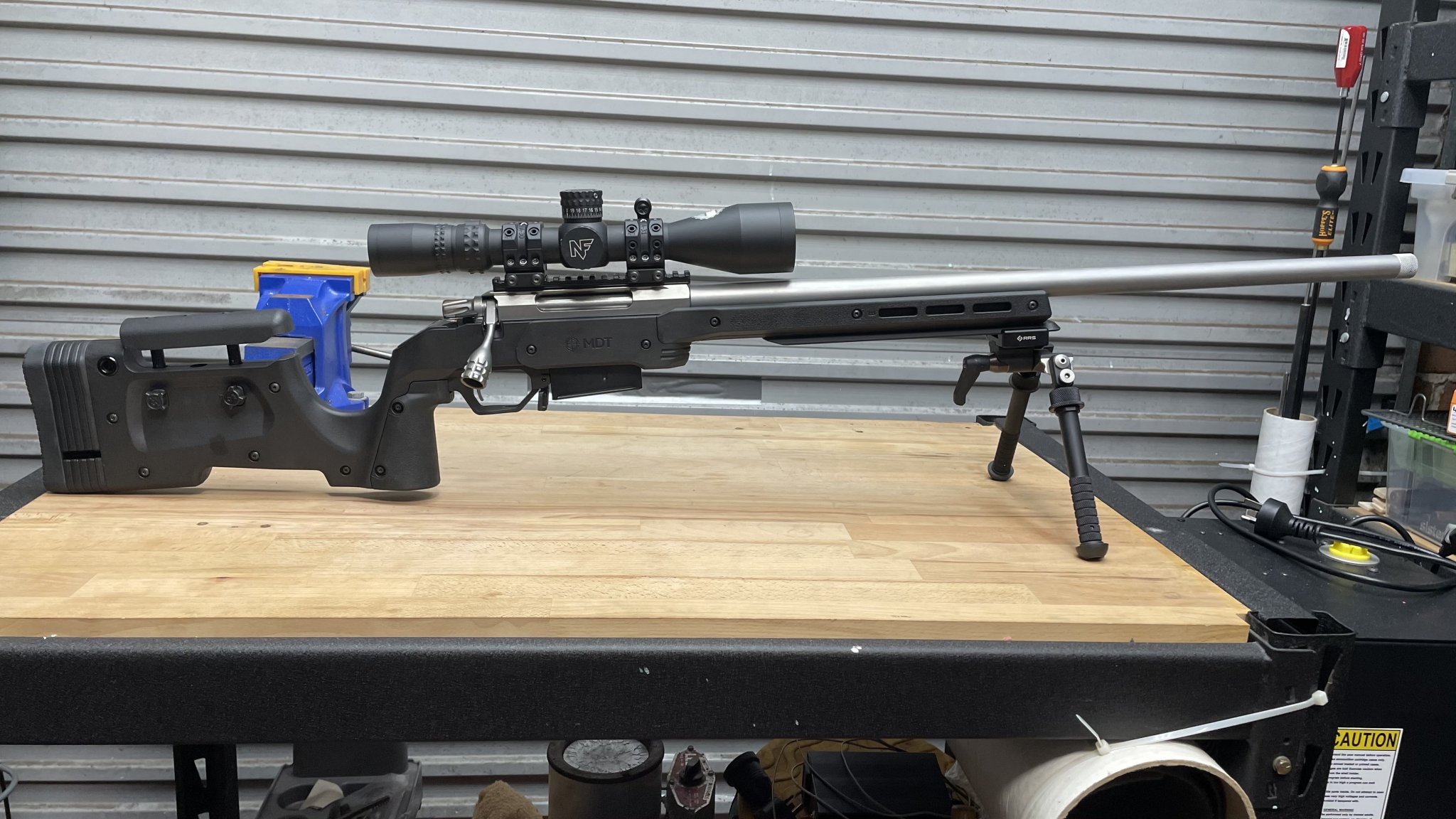

Had this Tikka T3 for about 4 or 5 years now. Started life out as a Tac A1. This last year I dropped it in a MDT ACC, upgraded to the Timney T3, replaced the factory barrel with a PVA 26" Rock Creek in 6.5 Creedmoor from @bohem. It has 2,100 rounds down the barrel and is still hammering tiny groups. I've never actually had a chance to measure groups beyond 100 yards, but yesterday the 600 yd range was dead. Target is a 12x20 IPSC. Put my first 5 shot group on the center right above the water line. Put my last 4 shots on the head box, which I think is 4"x4"

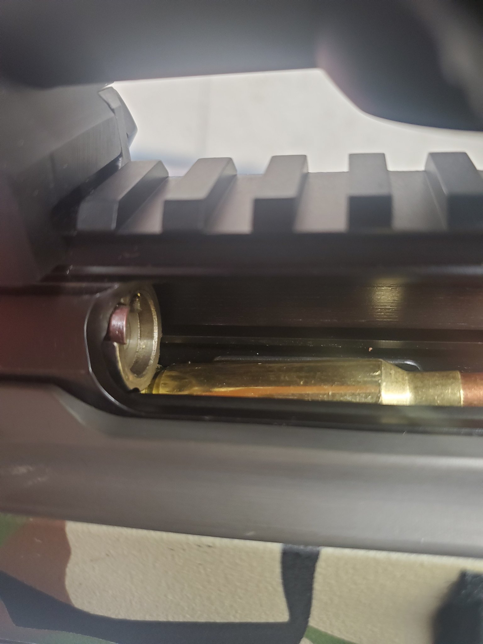

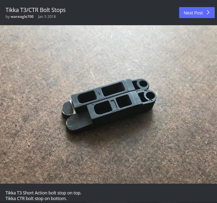

So just in case anyone else buys a Jae tikka chassis, I found something out tonight. If you drop a t3x action into a jae, your bolt won't go back far enough to catch a round.
Also, I am fully aware of the 2 mag adjustments that the chassis has. But that only adjusts mag fit and height. Not forward and back placement. So after looking at it for awhile I noticed that it will only work if I replace the bolt stop with a long action stop.
So luckily Midwayusa had some and I overnight aired one just now (I leave in 5 days for our pdog hunt).
Has anyone experienced this? I thought I would put this up here since I searched the crap outta the issue before I talked to my buddy.

I'd say you'd find that the stock is made with the same distance from the rear action screw to the rear of the magwell as a Remington 700. I made a bunch of stocks for Tikkas the same way (obviously with a different trigger/bolt handle inlet and recoil lug/front action screw location) and it works fine but needs the long action bolt stop. I ended up moving the magwell forward so the front was close to the feed ramp, it worked a lot better for the shorter cartridges like 223 or 6BR.

Glad to hear that I made the right decision ordering that new long action stop. Crazy that I couldnt find a single mention of this online anywhere.

What caliber? I'm guessing 223 or started as a 223.
I remembered this post from a while ago.
Well it must be something that Tikka does in your countries overseas.
I can tell you 100% that my 6.5CM T3x CTR came with a mid length bolt stop.
Pictures I shot of my bolt stops including my CTR T3x.
Other people have confirmed that not only their T3 but also their T3x CTR came with the mid size stop.View attachment 7173666View attachment 7173667
Here is another Picture of the Mid size CTR stop....
I bought it new a few years ago as a T3X Ctr 6.5cm. Then I had it rebarreled with my 6.5cm bartlein carbon. Thanks for the thread link, I will have to compare my stop to the photos. Once I found out the issue, I was able to find alot of threads (on different forums) that had a bunch of ppl modifying their stop. But that was generally to utilize long action mags and load longer oal.
I could have filed down my stop, but rather just expedite ship a new stainless one that I know will work.
Not something you want to find out 5 days before leaving for a hunt across the country, lol. I guess that is what I get for swapping my manners to a new chassis so late in the game.

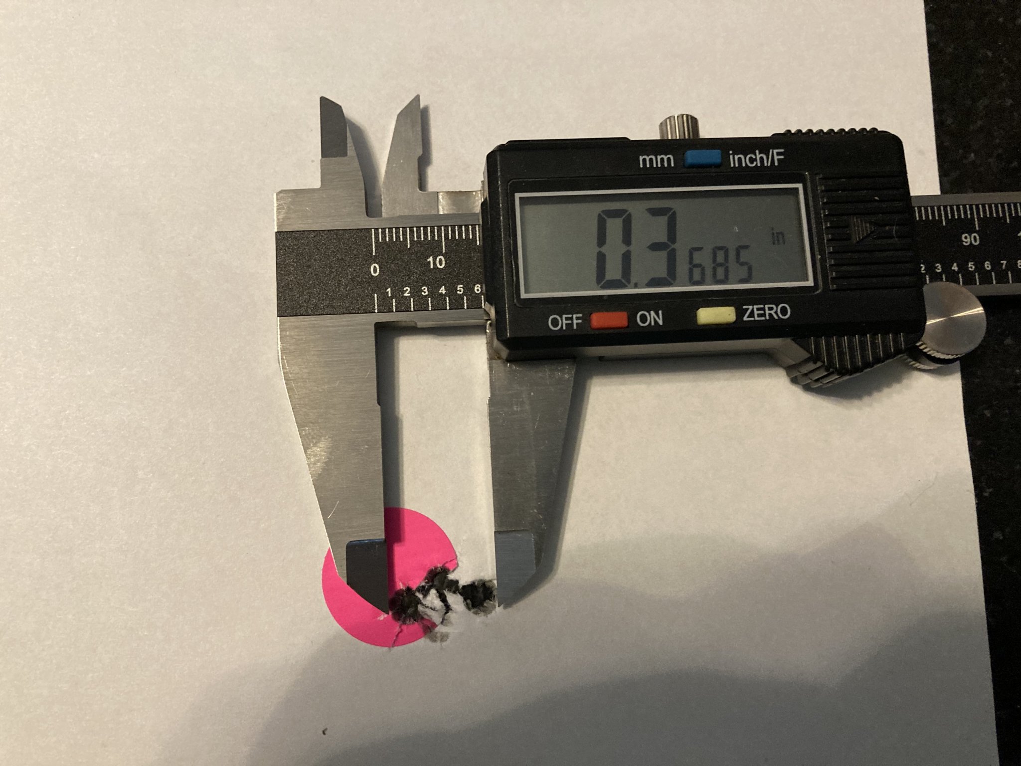

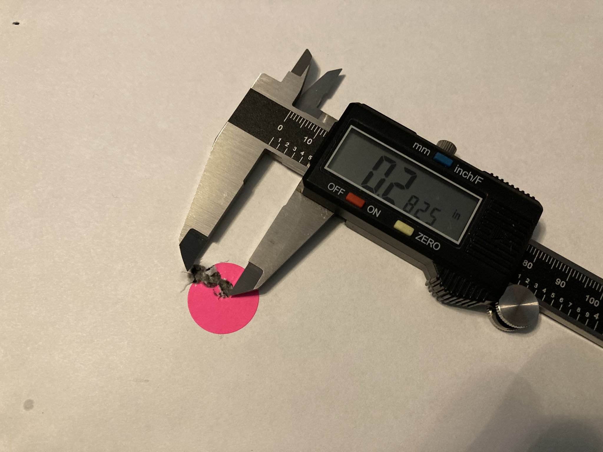

Mounted up the new glass the other day and went and zeroed today. Went well other than I noticed brass was hitting windage turret and bouncing back into chamber. 😳 I was runnning it kinda slow so will test some more before I change anything
Was thinking of cleaning but think I’m gonna wait after measuring. 150 rounds since last cleaned, 5 shot groups.
T3 varmint 223
LC brass
77 SMK
24gr Varget
REM 7 1/2
