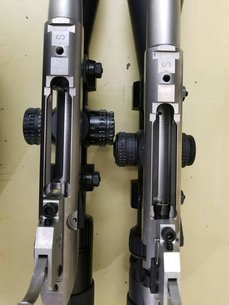

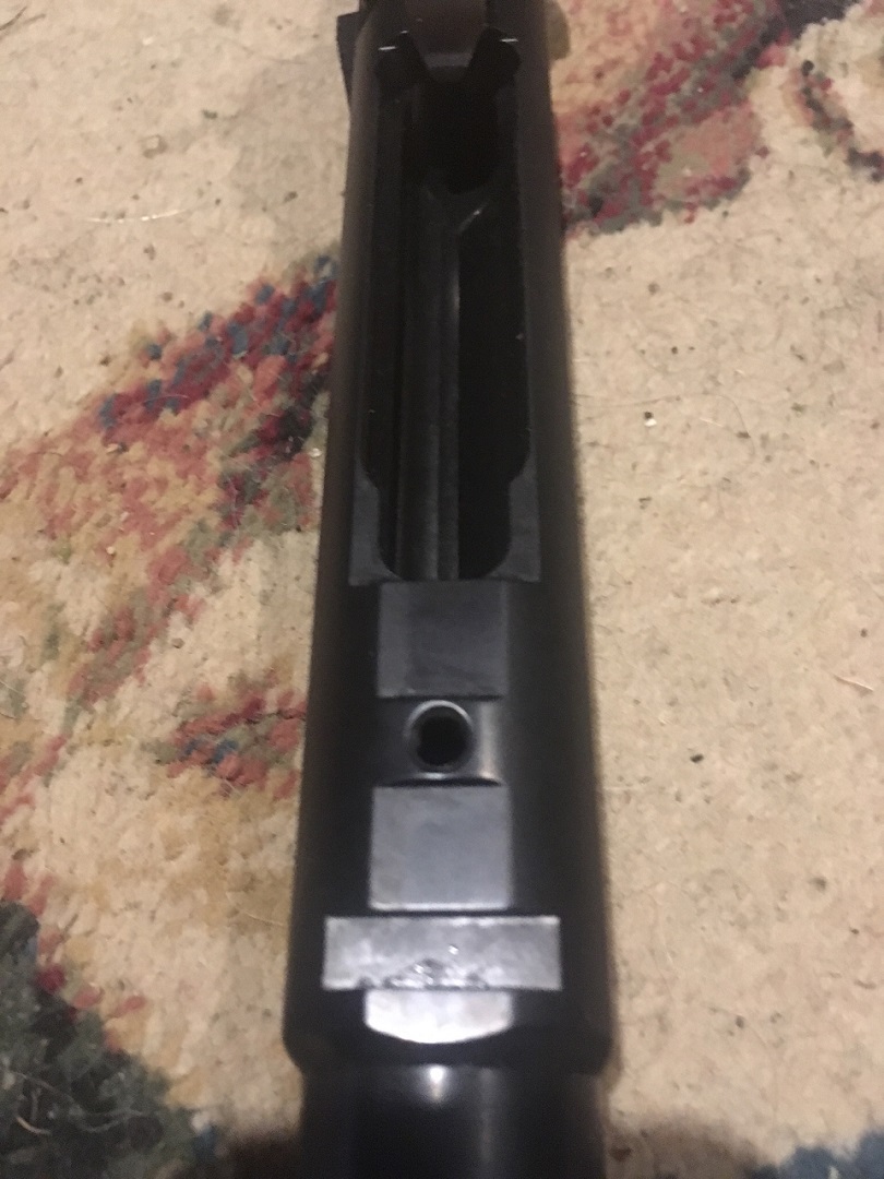

Fine let's solve this with pictures. Who has an older original T3 and who has a confirmed T3X? Take the barreled action out and take pictures of the bottom of the action.
Found this pic from @dannySH in a different thread. Standard t3x left and a ctr on the right (guessing t3x ctr).
So are these both T3X just one is CTR and one isn't? I'm sure the argument in question is T3 vs T3X.
Here is my olderT3 without the cutout. Just to confuse things a bit, you don't need the cutout for a 223 since the mag is slight;y different. The 223 CTR mag doesn't have the feed lip bump. I got a mag today and it works. Also page 113 shows the difference.
Reactions: Eric_F
I have a T3 CTR and a T3 Lite that was a 270 that I used for a switchbarrel match rifle build. Both actions are the same on the bottom like the two above. The CTR even had the magazine retainer clip on the trigger screw that is used with the plastic single stack magazines.

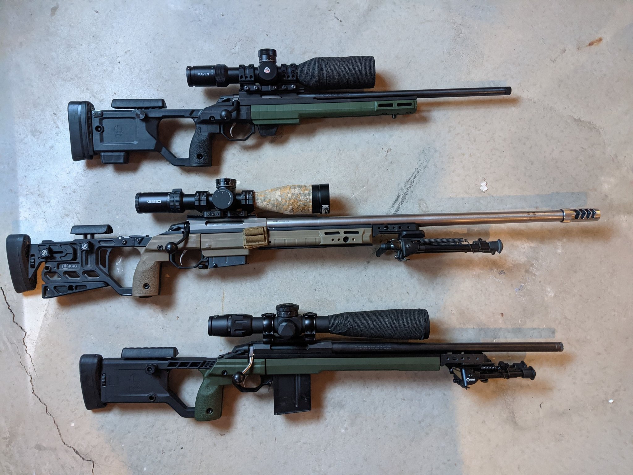

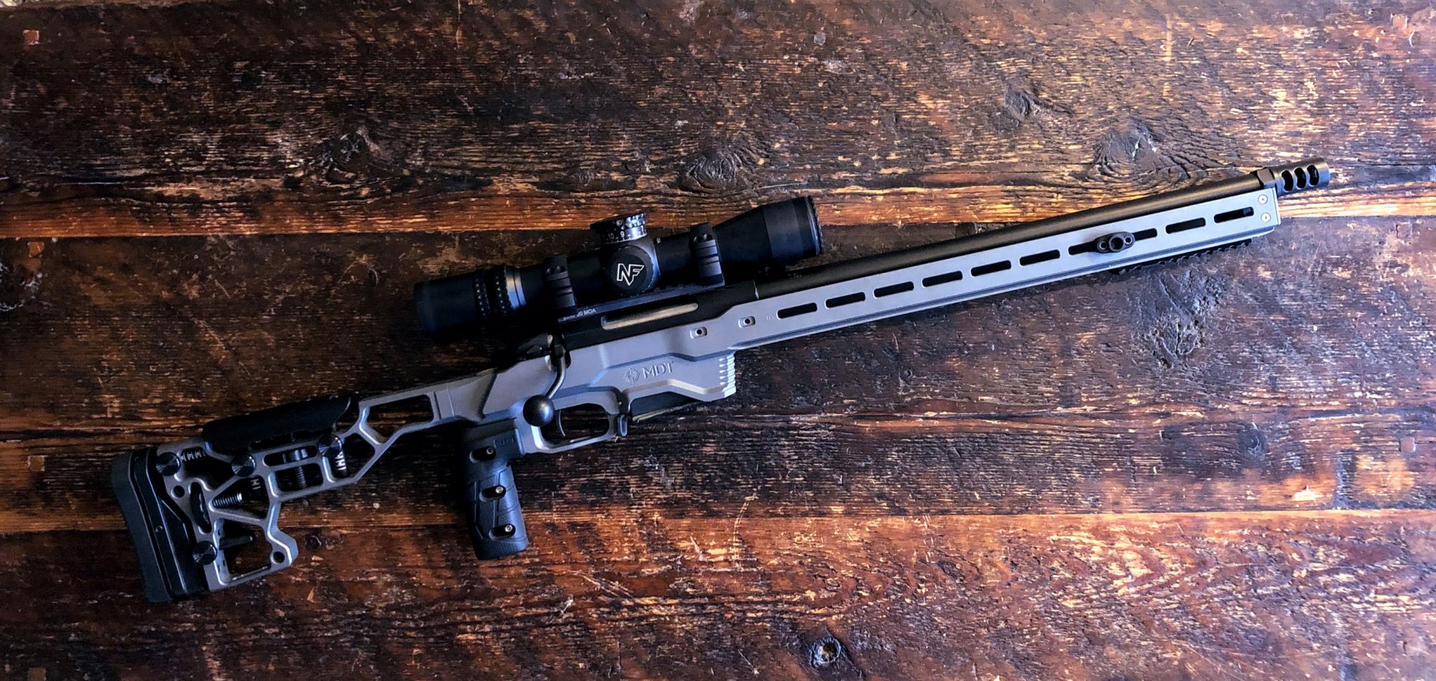

Got my T1X into a bravo at last, and swapped the stock with an X-Ray stock so I can have matching ergos across all my rifles.
I modded the W3 to take the CTR mags and it's feeding so much smoother than with the AICS mags.
Bottom rifle is a CTR that I'll be switching out for a trainer rifle in 6.5 Timberwolf (Norma Dasher necked up to 6.5) once it's back from the Smith.

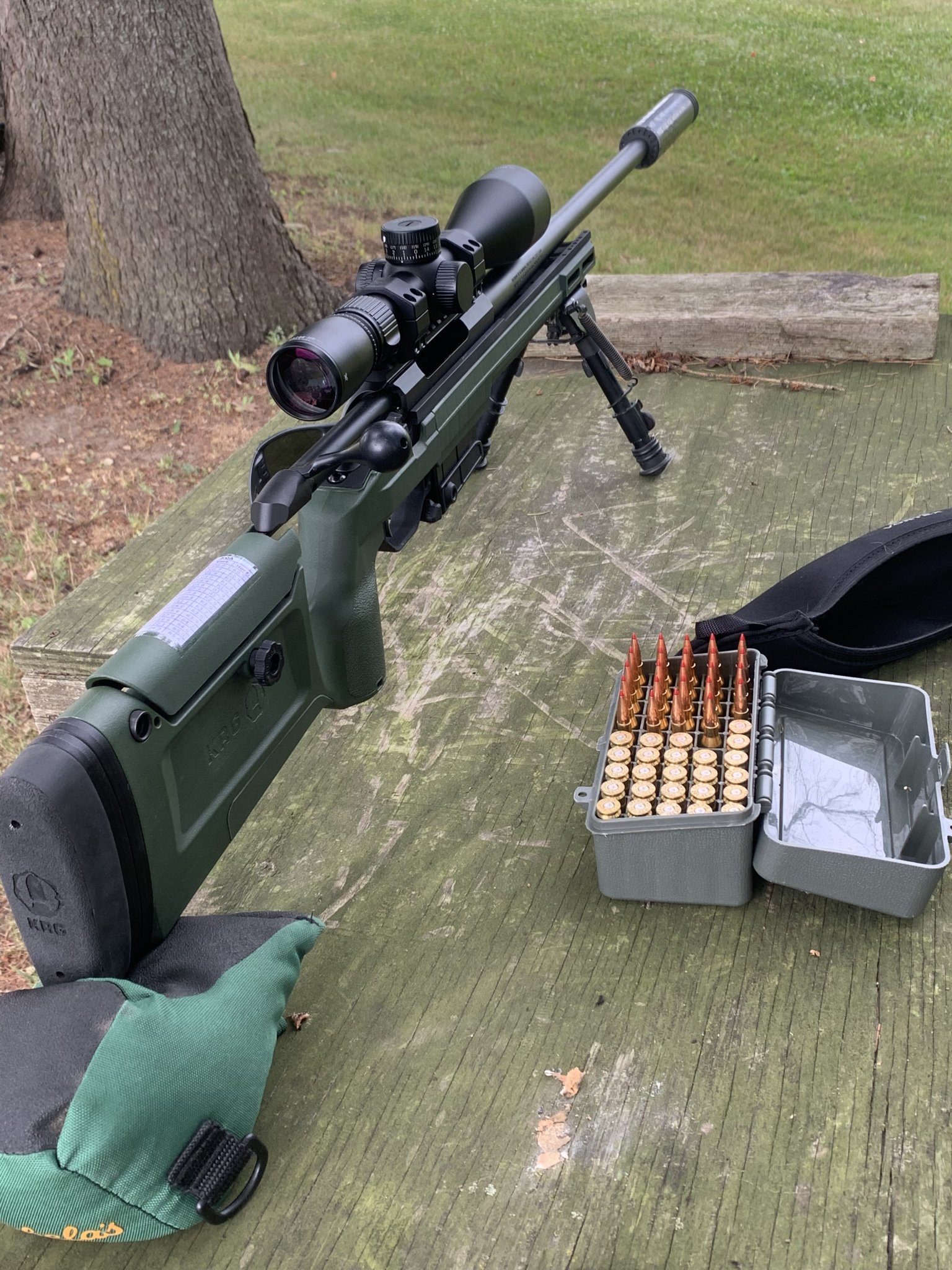

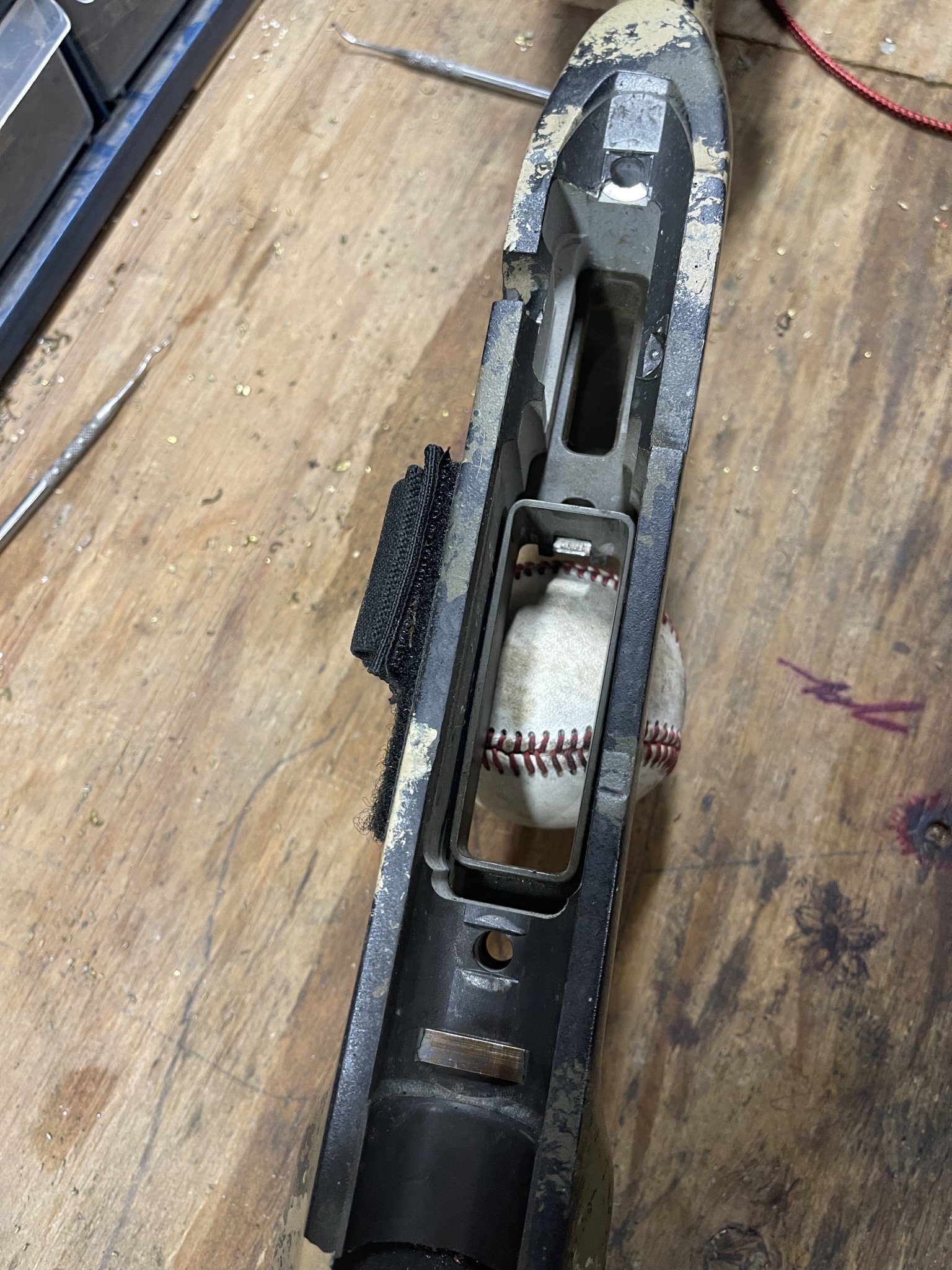

The Phoenix stocks are pretty good. I had the chance to shoot to 1K yards a couple weeks ago. The package performed, shot very well. I didnt do any bedding. I did remove paint off the top of the bedding pillars because it was messing with torquing the action screw
List of complaints on the phoenix
Paint on the bedding pillars
Magazine is extremely tight to seat
The but pads, while soft and squishy, aren't very durable, I tore the original on a Saturday. Props to grayboe though, I had a new one on the following Wednesday.
Overall, its a very good stock IMO for what it offers and at the price point it comes in at

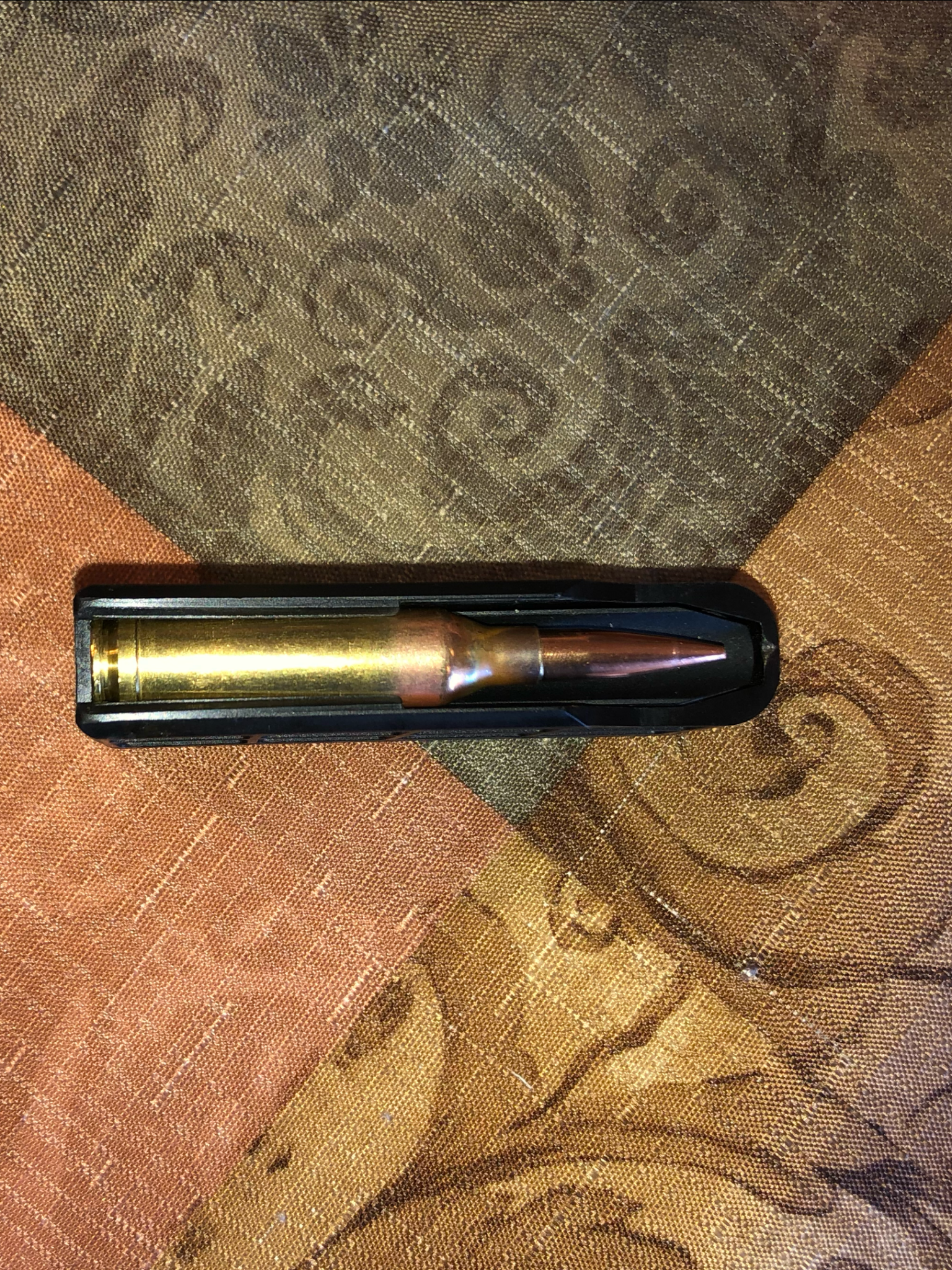

Does anyone have a tk varmint.223 in a KRG bravo how does it feed with .223 acis mags? Or should I go with the CTR and get the KRG Bravo CTR?
I have an old school T3 ( Non X Model ) .223 in a Bravo that I have been using MDT Polymer mags.
So far, feeds like a champ with the OEM Barrel and the X-Caliber barrel that's on the action now.
Reactions: K80/6.5
I have one in a Bravo and use the MDT polymer mags with zero issues.
FWIW - I'm trying to get a Super Varmint in .308 in a KRG X-Ray and will use the MDT mags also.
