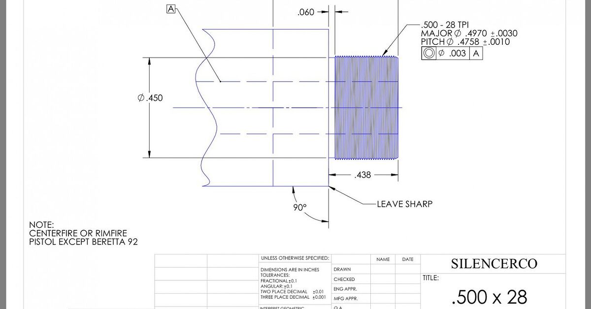

That is specific to the TBAC takedown FYI. There isn’t really a 1/2x28 standard, and a majority of rimfire pistols use shorter thread lengths. Would have been fine with a different 22 can.
When I had one of my Savage 22's threaded by @LRI they called and asked how long I wanted the threads. Glad they did. I have a 22td.
I think they generally have the longer 1/2-28 on 223/5.56 guns vs rimfire. That way you don't put a 22lr rated can on a 5.56 and blow it up. Now if you're using a 22 conversion kit that might be annoying.
Reactions: carbonbased
I cannot speak to an industry standard. But I don’t think it hurts to stick to shorter threading on rimfires. Attached is some info which supports what I said:
Right, I'm just saying that the issue you had is specific to the TBAC.
It's not. Common practice, centerfire is longer than rimfire. By about .200" iirc
Silencerco ships with a spacer for incorrectly thread barrels.
Again, I’m saying it’s an issue specific to the TBAC because of its design, where the longer threads bottom out in the blast chamber. I haven’t come across another 22 suppressor with the same issue.
I understand that there are differences in 22 thread dimensions.
