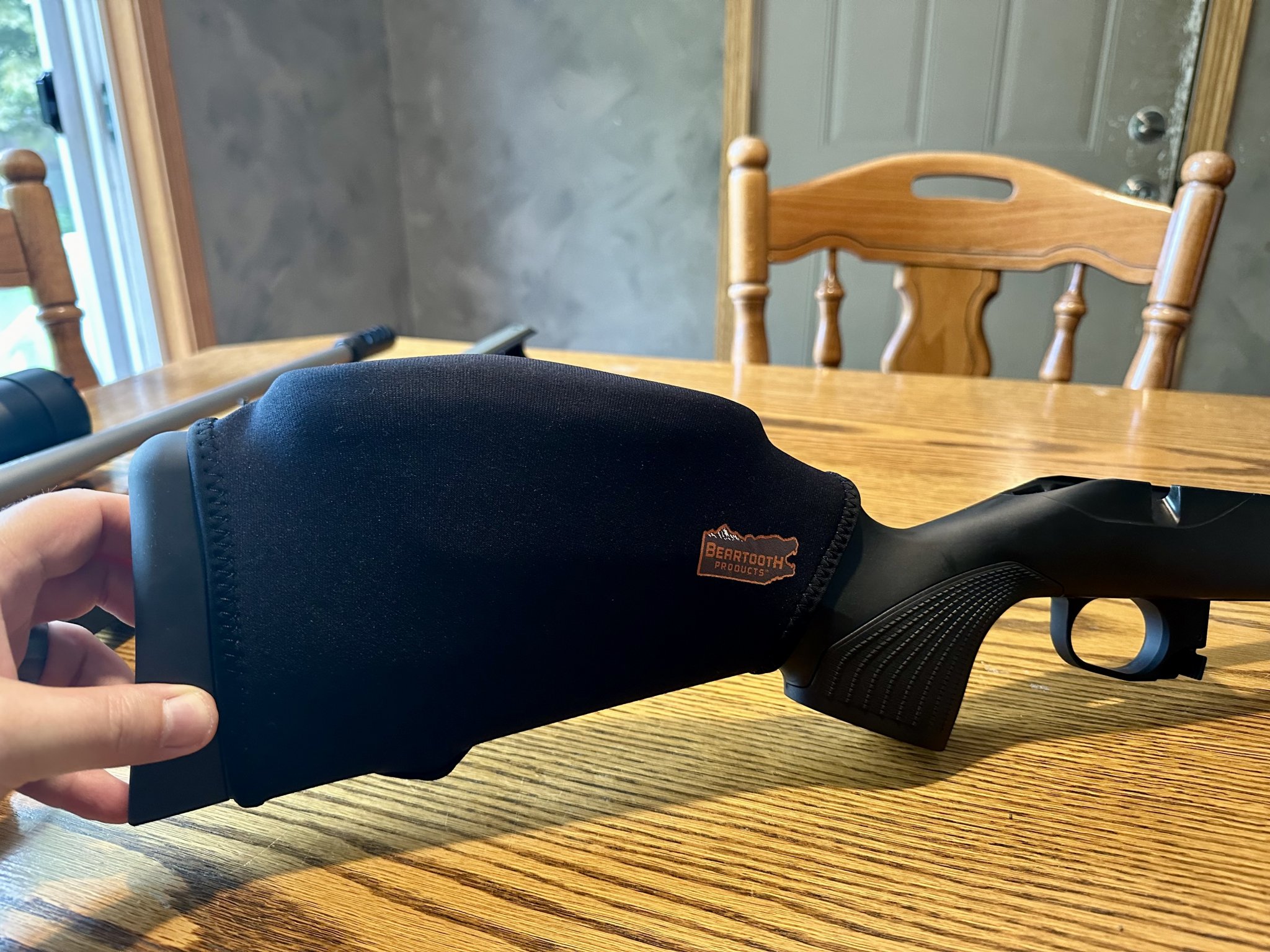

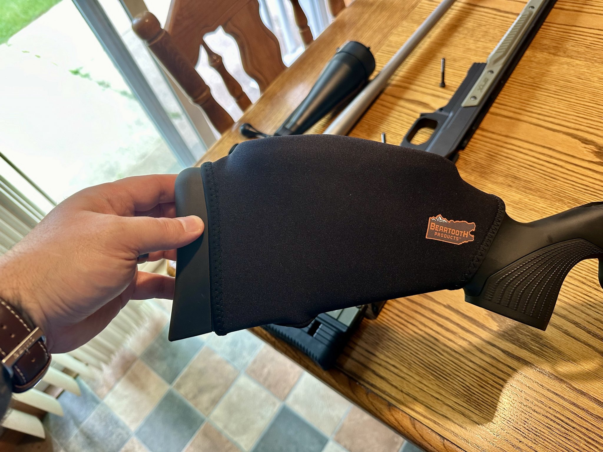

I bought a CTR, and I had the same issue. You can try to mess with your scope ring height. I ended up getting a Beartooth comb riser from Scheels. It was under $30. A little bit of a pain in the ass to put on, but not too bad. And it worked pretty well.
It gets in the way of removing the bolt. It gets in the way of popping in your bore guide. And it gets in the way of the cleaning rod. The good thing is that you can push and shift it to the side, out of the way. But the bad thing is that it can shift a little bit on you while you're snapping in with a good cheek weld.
Overall, I didn't mind it, and it was helpful. I knew I was eventually getting a different chassis, though, with an adjustable cheek riser, so that's probably why I didn't mind it so much.
A tip for installation, if you do decide to go with a Beartooth: Once you decide you have the height stack you like, tape them together. It's significantly easier to put them in (the stock cover is really tight).

The Beartooth appears to get mixed reviews, due in large measure to the fact that apparently it`s a " bear " to fool with getting it on and just generally working with it. The Triad Tactical Pack looks interesting. Maybe when the time comes I`ll just look for a gun with an adjustable comb out of the box. Too bad that that would leave the CTR out of the running. An interesting thing is that Tikka makes a CTR with an adjustable comb, they just don`t sell them in the US.

Yep. Don't blame you there. I would've likely eventually switched had I not known I was getting a different chassis. Some people love it, some people hate it.
I hope you find what you like, particularly w/ an adjustable stock.

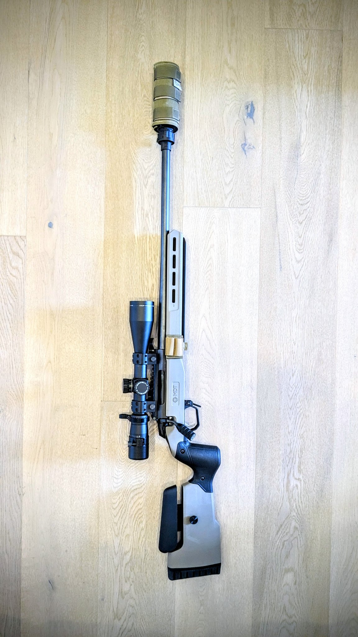

As @spife7980 says, man, a chassis is just so sweet. Easy to add Arca or pic rails, weights, whatever. Nice upright handgrip.
For Tikka CTR-only mags, KRG makes a Bravo version for $400. I have one and it’s sweet. Add their $$$ adjustable LOP or cheaper $50 polymer tool-less buttpad height mechanism (use the included spacers for LOP) and you’re gtg.
But $400 is $400.
