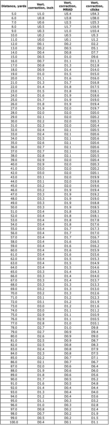

I generally zero at 25 then move out to 100 to fine tune windage. I have an indoor 100 yard range at my disposal as well.

If possible confirm windage zero past 25 on dead calm or indoors. Dialing up from 25yds is also great practice for centerfire matches. How many times do people get lost in the dial or forget.... gun handling and manipulation is the reason for a 22 trainer. It's too easy to cheat position but handling and dialing are key points.
Break the zero in two parts. Elevation and windage. If we take the conventional wisdom that 22lr is 1/4 scale 308, would you zero for wind at 200? Especially when it is windy, like it is often here in CO?
I zero at 50 yards for elevation since that seems to work well for scaling to centerfire. I 'zero' for windage at 15 yards to make sure that the zero isn't messed with by the wind at all. It takes a bit to make sure it is actually zero'ed. I shot ten shots, or I chase the last shot so that a left-right bias becomes be pretty clear.
That's what I do now, and it seems to have fixed my windage seemingly not being right - because I had wind built into my zero.

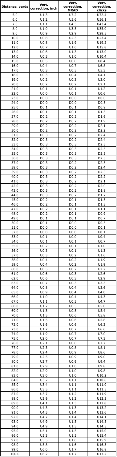

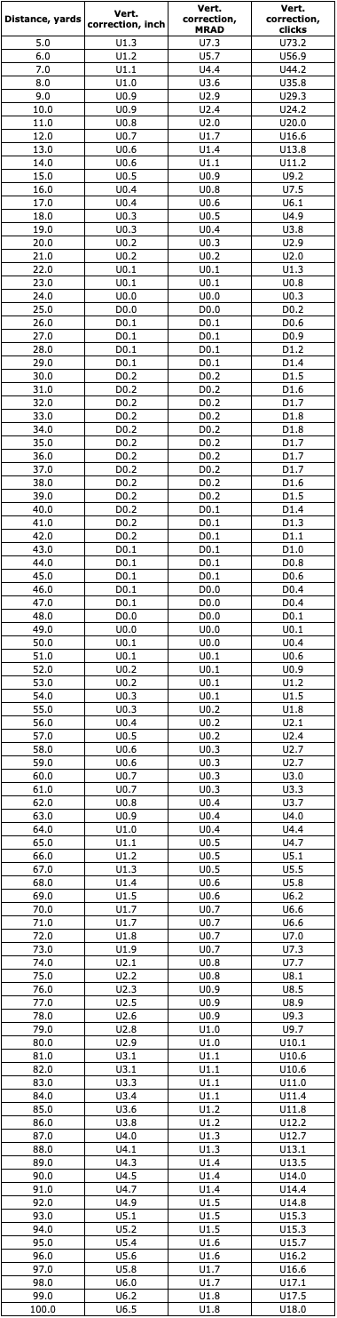

For some people that missed the zero chart. Theres a difference when zero is at peak of bullet trajectory height and when its crossing the zero still going up and then dropping back down...
yeah I noticed that, its interesting because if we extrapolate that out to equivalent centerfire distance it just doesn't line up. but does it really need to transfer over? I'm not really huge into the rim fire side of things so my thinking could be way off.
