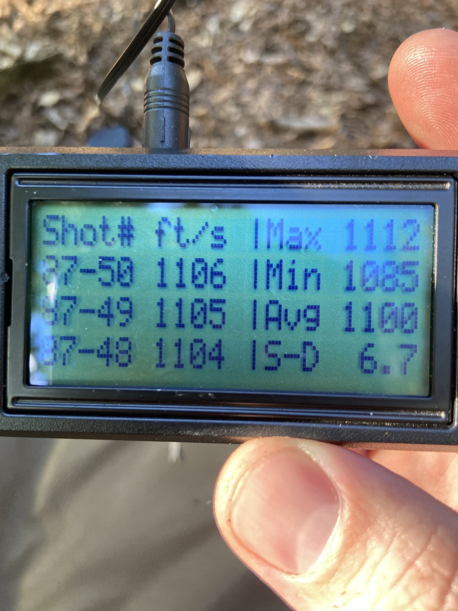

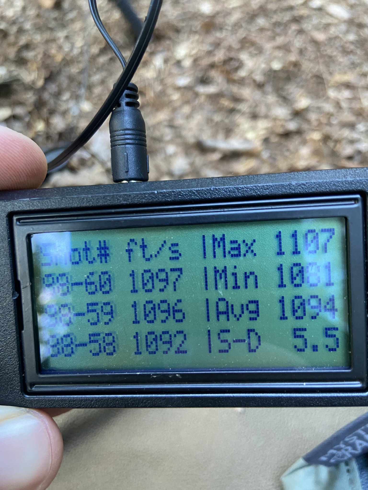

What’s the typical velocities and sd’s you guys see when checking ammo. I tried non lot tested sk standard and center x today with good results.
View attachment 7374574View attachment 7374575
That's fantastic. What are the ES?
I have SDs of 8.9 but an ES of 42. One series had a ES of 46. That's A LOT for .22lr and the distances we're shooting at. Considering moving to Midas for matches.
