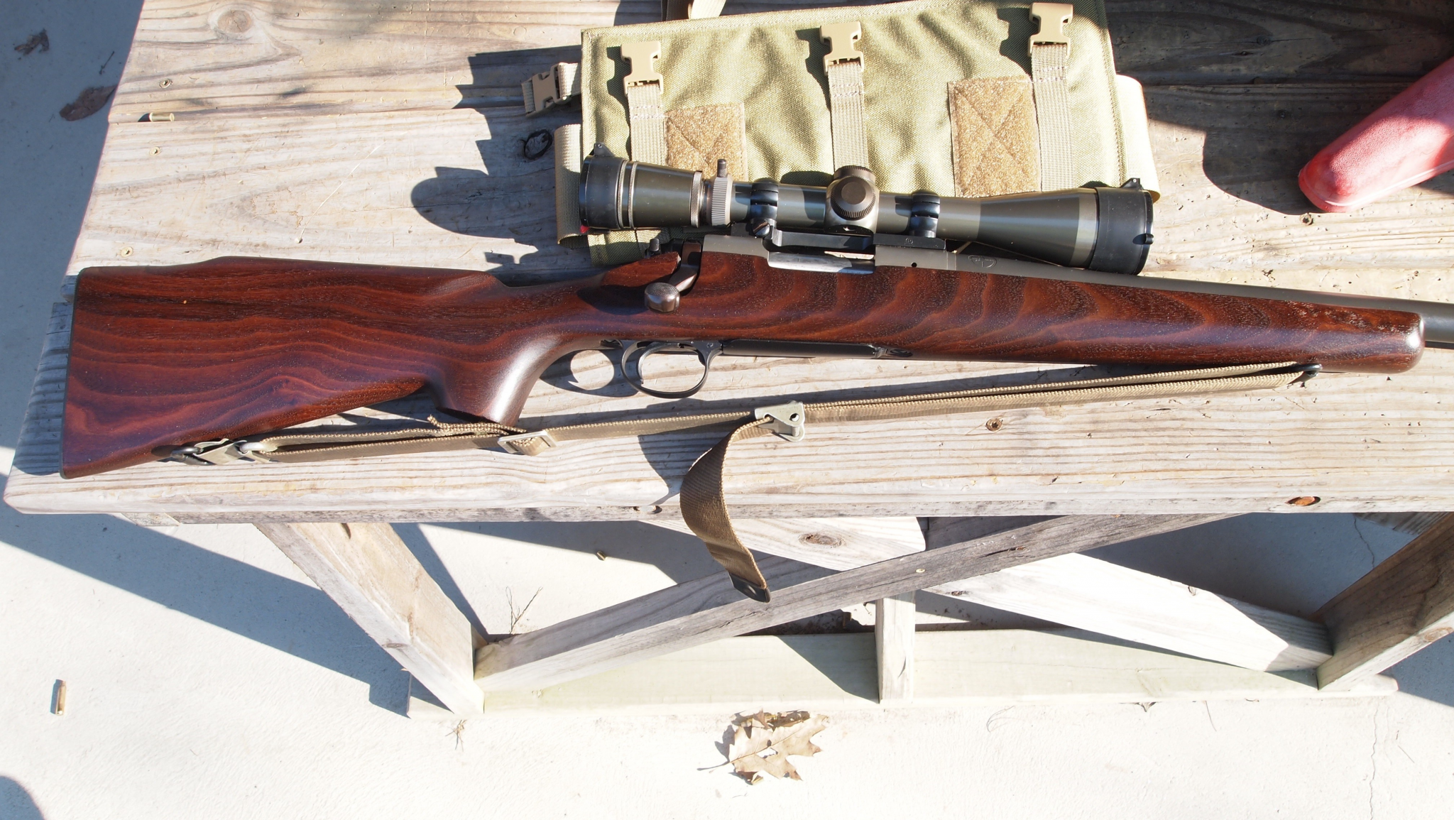

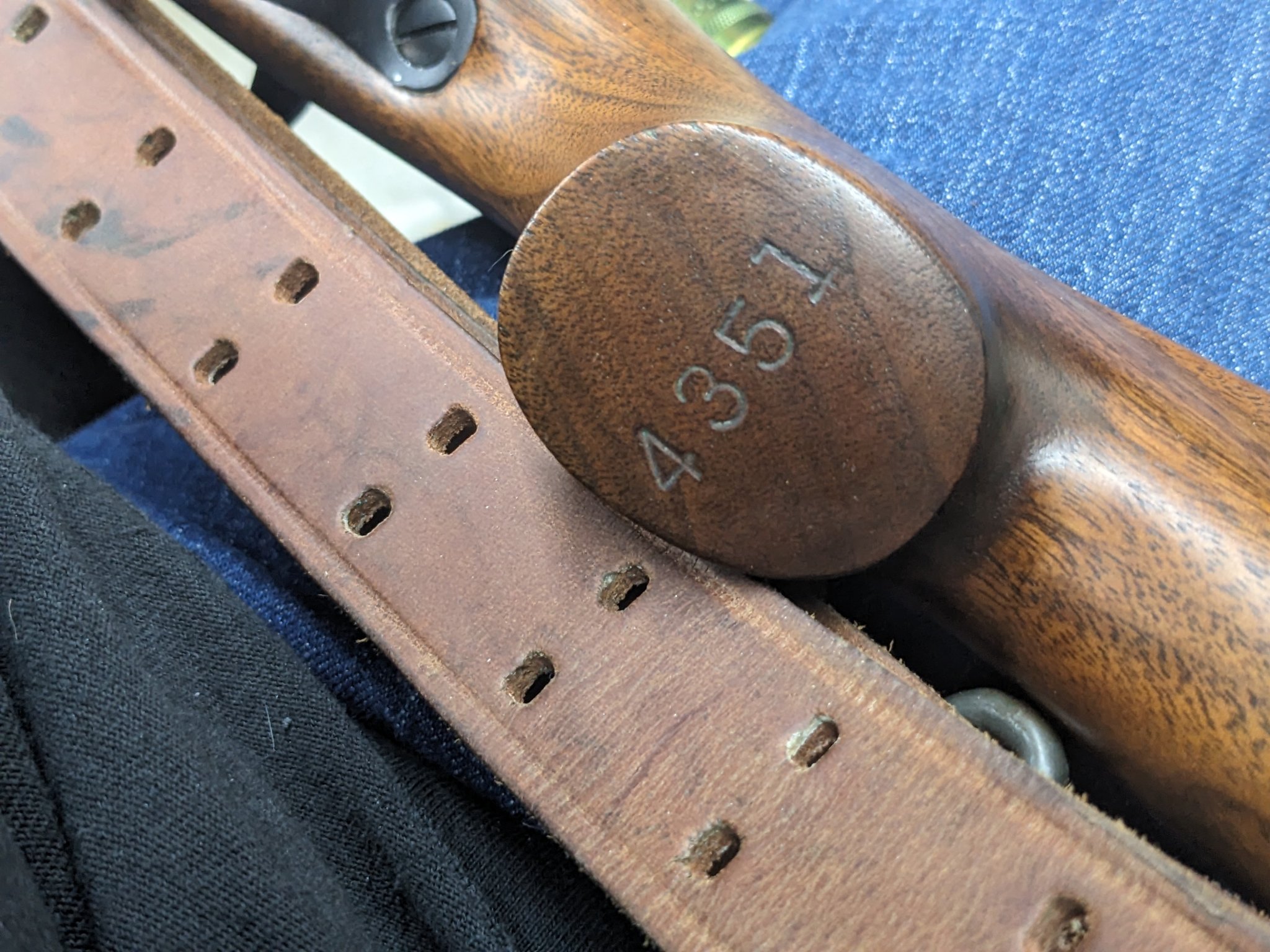

I have a .223 M40 I built on a Dep Taylor stock and used only pure linseed oil on it.
It did come out dark until it gets in sunlight than it shows a deep red.
The stock is kind of grain boring where it counts on the wrist.
Not a looker but functional and of the type the mil favored….
I’m thinking about using that Real Milk Dark tung Oil.
Good stuff.
Haven’t used dark but the regular stuff gives better weather protection than linseed while both are little better than nothing.
There are others that give more depth/protection but for ease of maintenance and being able to freshen up there is nothing better than PTO or cold pressed linseed oil in my mind.
Pair it with parkerizing and you have the only finishes endorsed by God in the Bible.

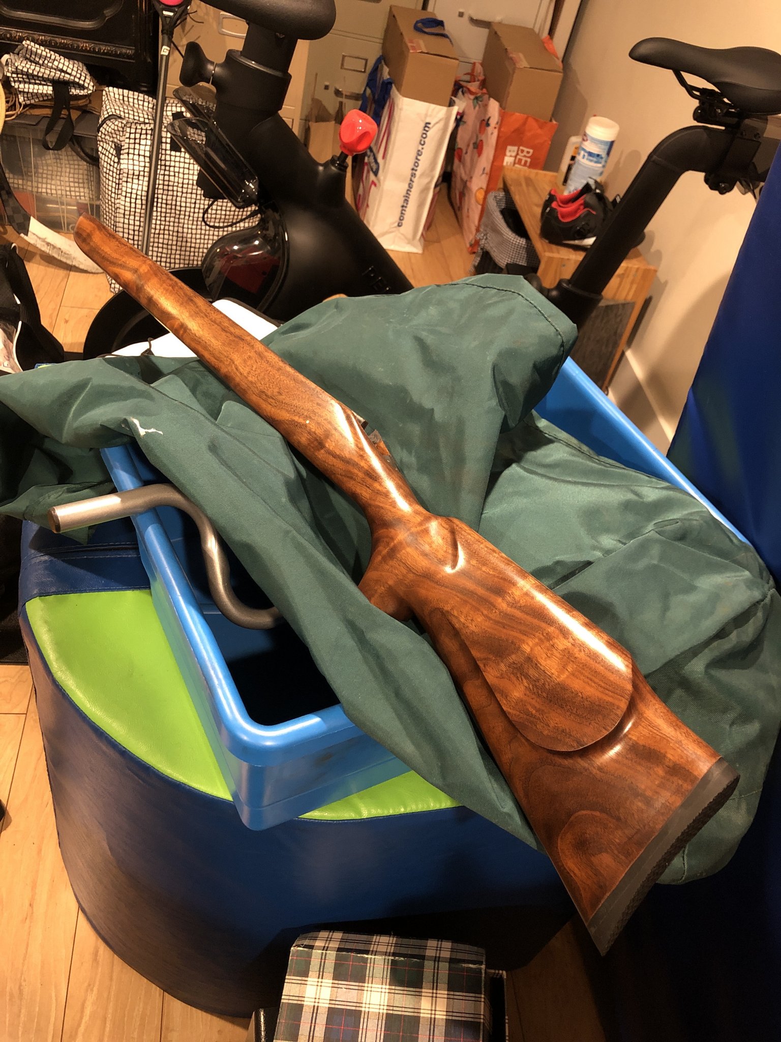

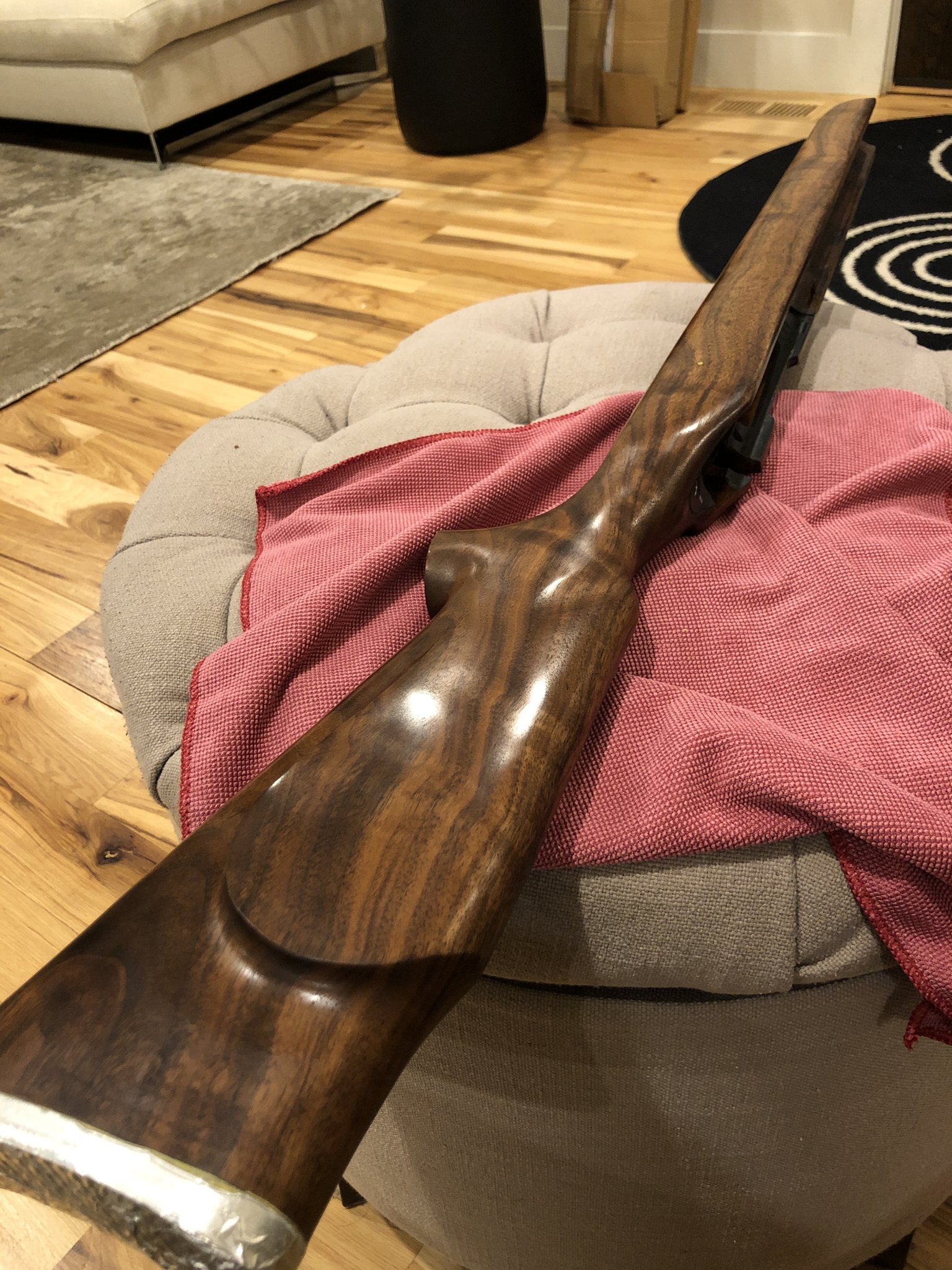

Phil, the wood grain in all those stocks is beautiful!! nothing like full grained walnut.
I used triple boiled linseed on mine,when I get a chance, I'll get a photo up
Real Milk Paint Dark Tung Oil…
Then mix 1/3 beeswax, 1/3 Turpentine, 1/3 Linseed or Tung oil. Melt the bees wax in a double boiler. Remove from the heat and add the linseed/Tung oil and Turp. Let it harden up.
Tom’s 1/3 mix.

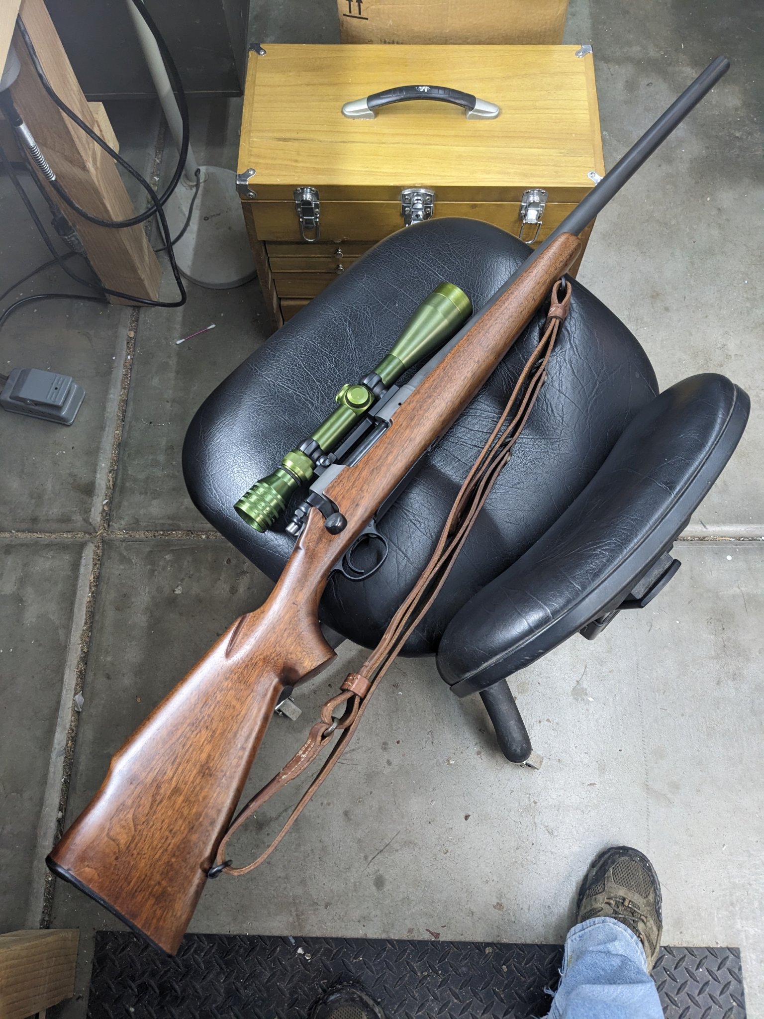

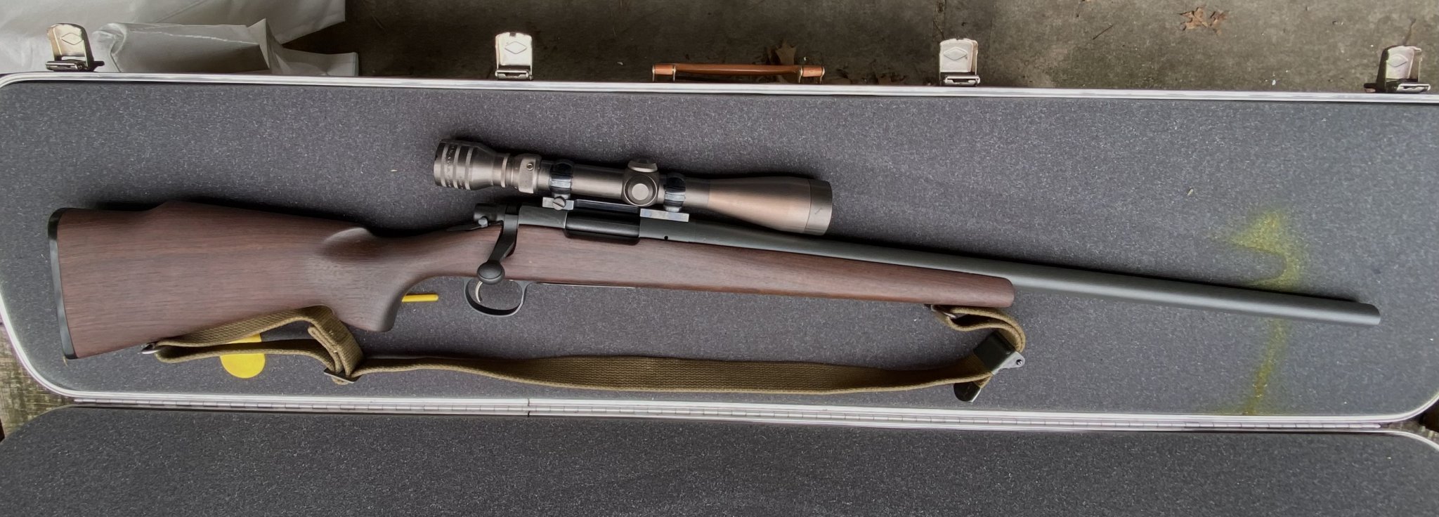

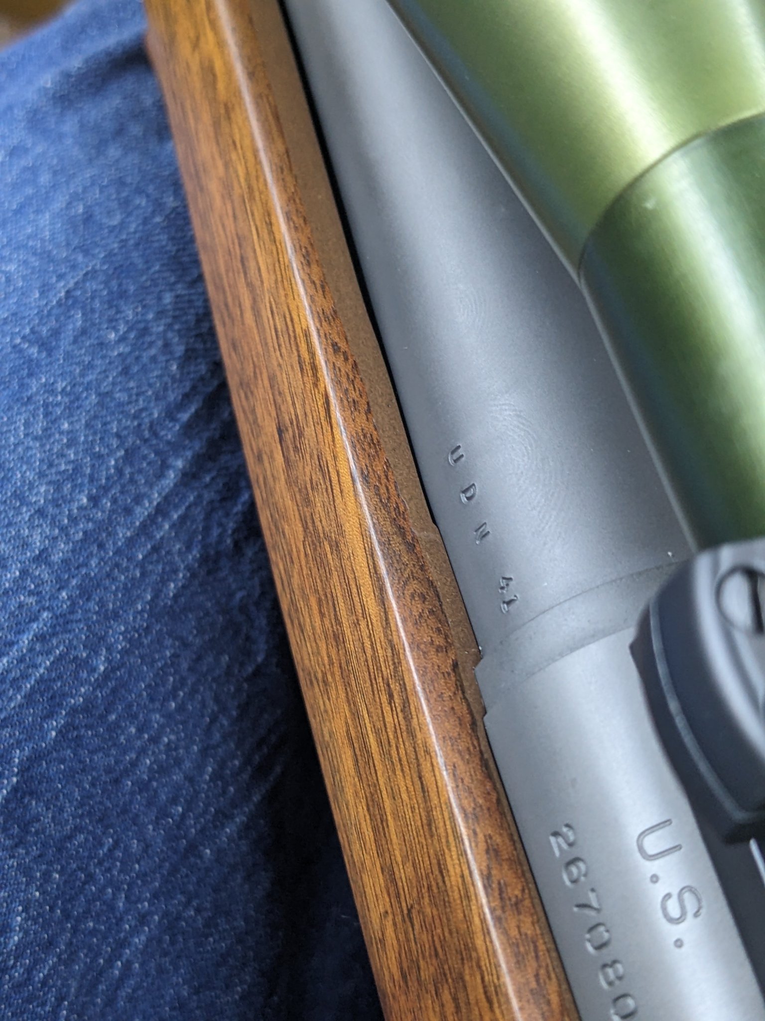

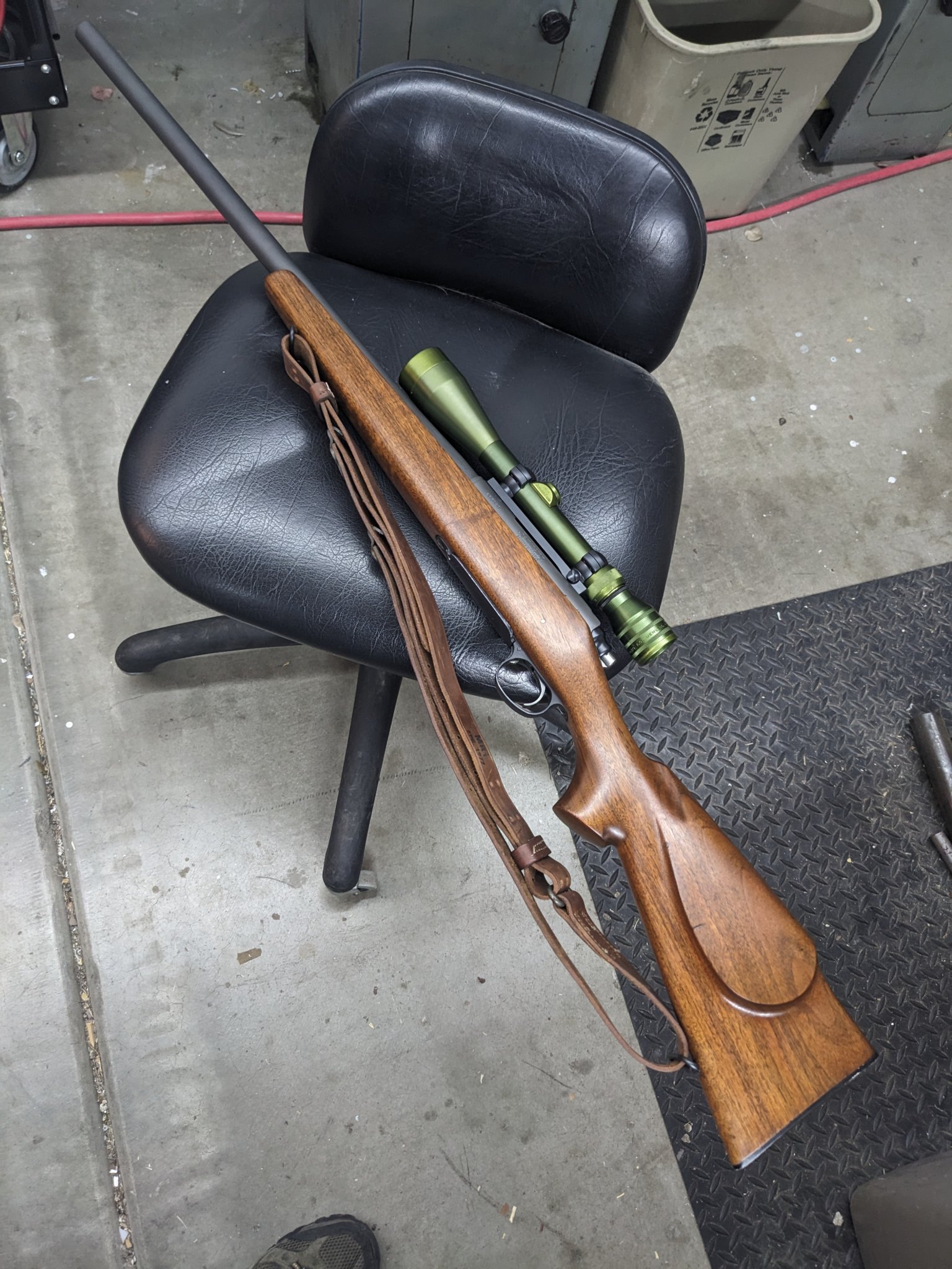

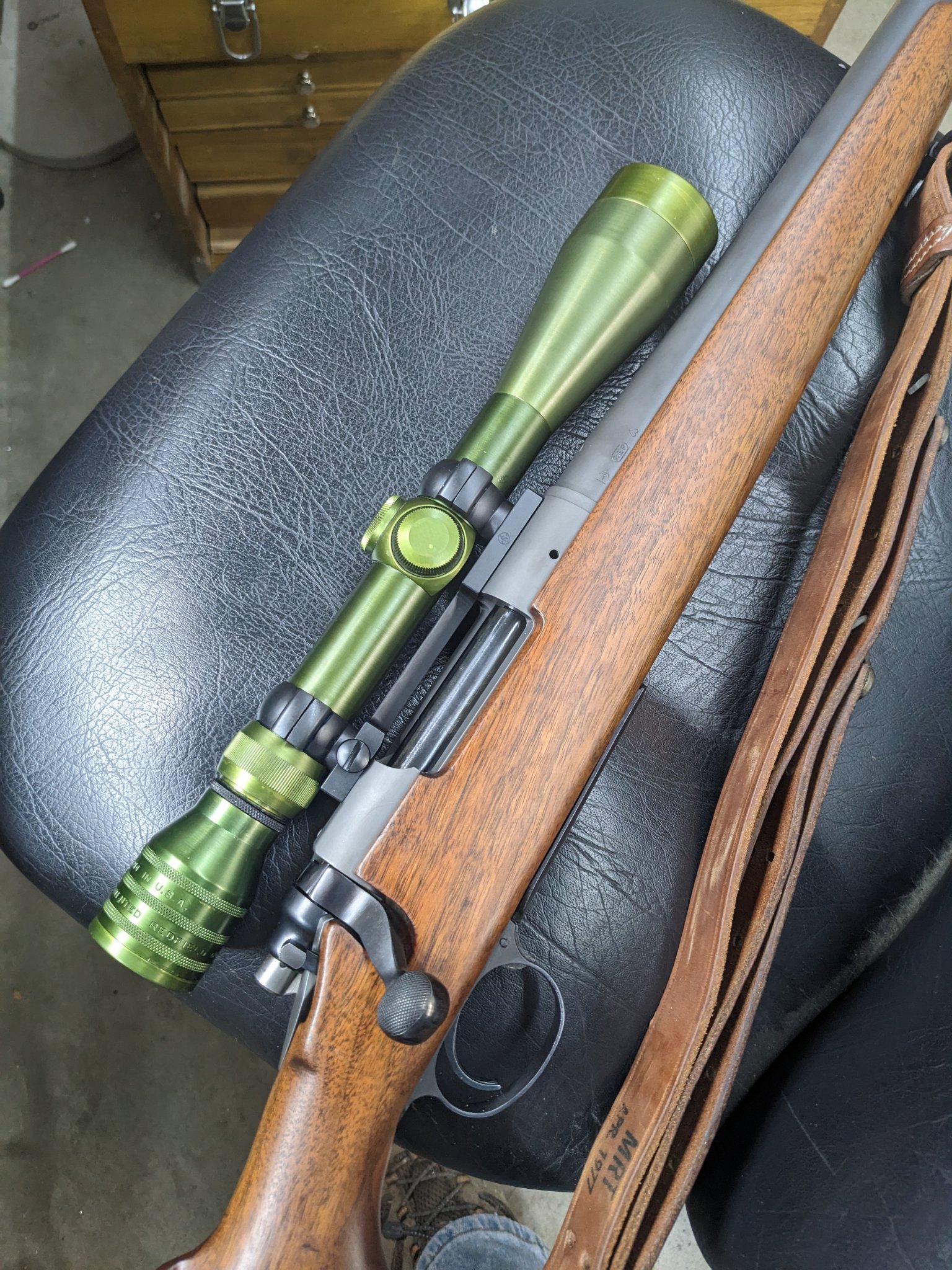

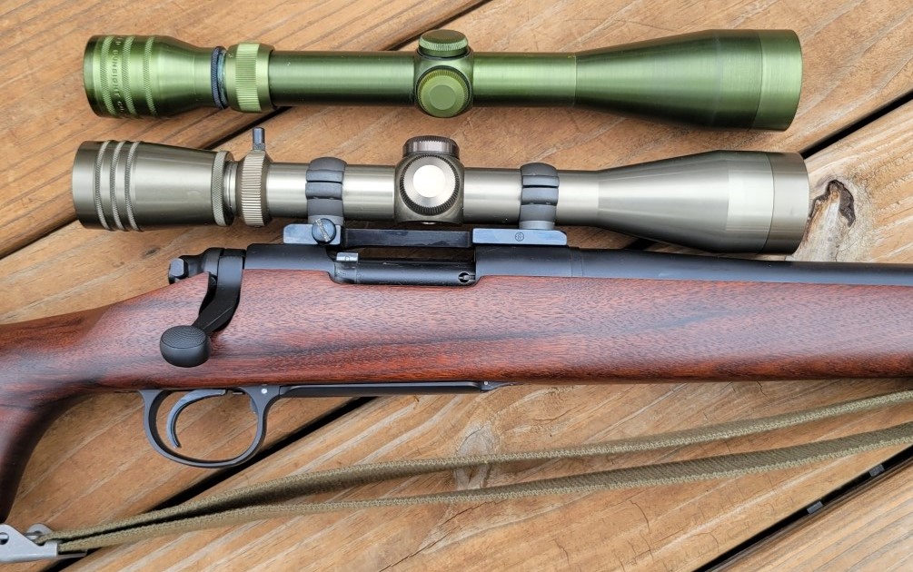

I finally finished my M40 with one of Toki's scopesView attachment 8176155
That's a very nice build! I see that you've got a square corner Redfield base that has a matte finish (rings too). Please tell us about the base and rings you're using, I'm really curious about the matte finish and how you chose that over the polished blued finish. If possible, please give us a rundown of the parts and anything else about the build.
Have you had time to zero the scope yet? It looks great on your rifle, Toki is doing a great job with these! At some point I'm going to need to borrow one of his scopes so I can photograph it and document it for a project I'm working on.
Reactions: HogsLife
Thank you, I appreciate it. The mount isn't genuine, it's a badger ordnance repro, I just added the R. I'll never afford the real stuff, so I clone it as best I can.
The action is a 6-digit, so the bolt and bottom metal, etc are correct. I did my own clipslotting.
The stock is a real M40 stock I got cheap because the barrel channel had been hogged out badly. I had to bed the whole thing to build it back up.
The barrel is Douglas, with proof marks and date code I added.
I haven't shot it yet, waiting on the stock for my M40A1 so I can take both out.

Well done man. Beautiful build !

Great work! Did you find and use Badger’s 306-69 for 6 and 7 digit R700 actions? Or a 306-69B for R700s with a letter-prefix and later actions? If the latter, any issues on fit and zero’ing the scope?
Reactions: fe1 and USMCSGT0331
Thanks, I'm not sure which one it is, I bought it used. I did the check where I screwed down the front and checked the back with feeler gauges. It was a nice fit.

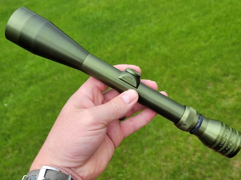

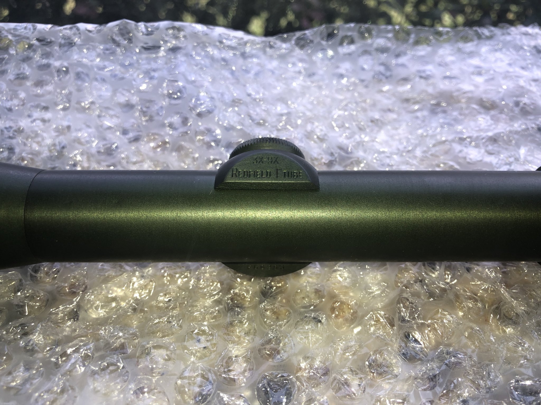

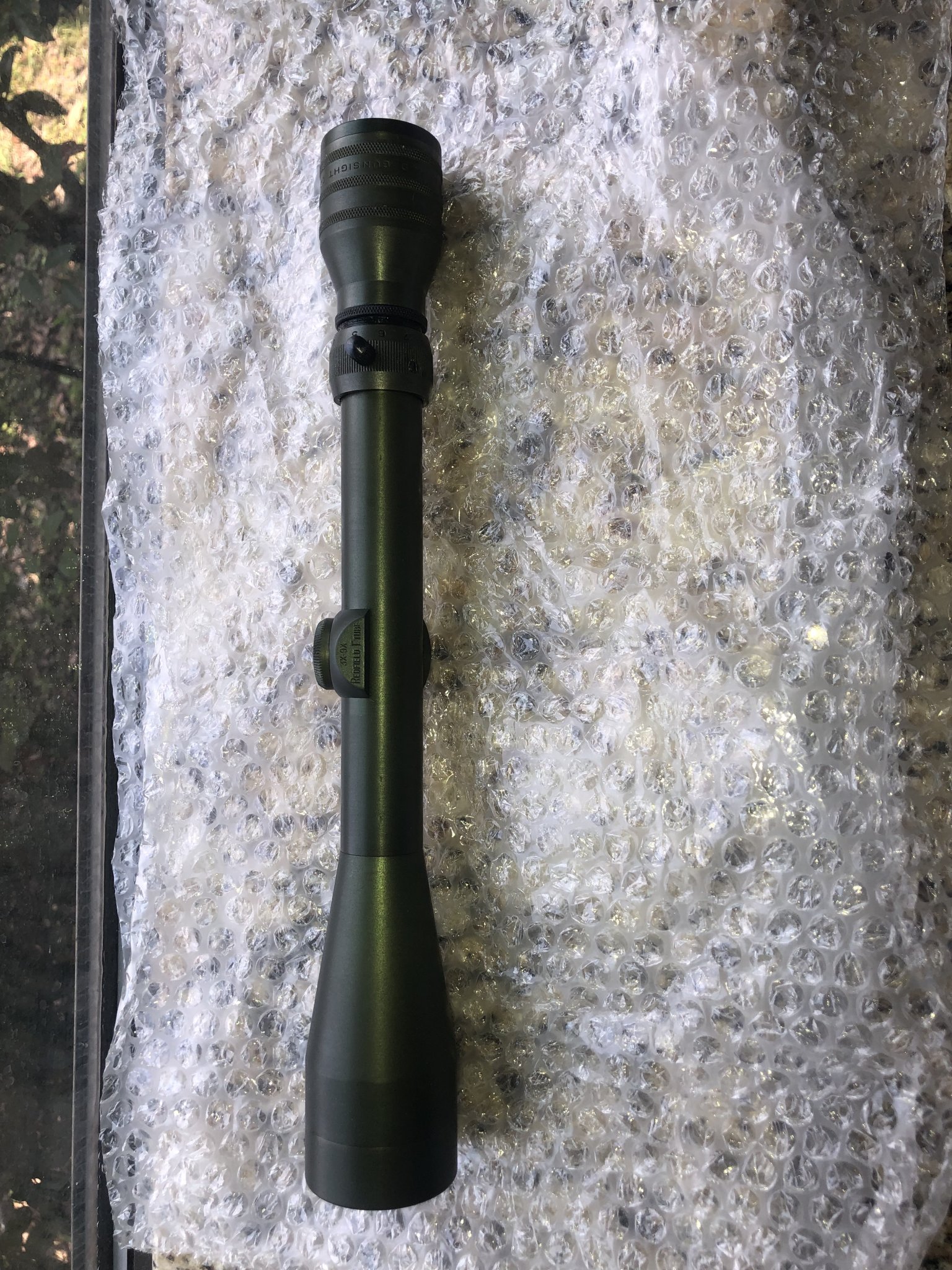

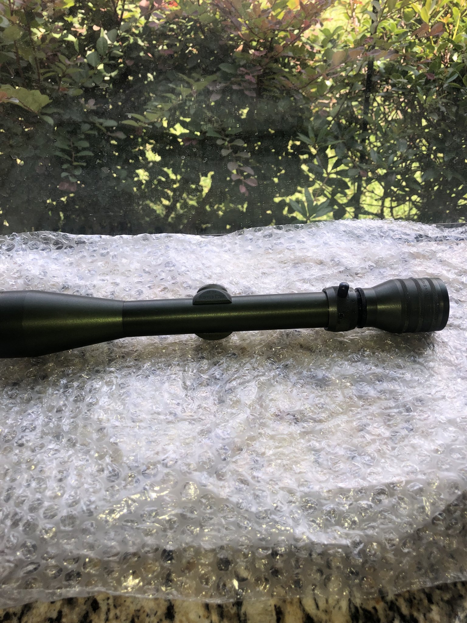

I received my green scope today and it looks great! Anxious to try it out. The photos are close, but the color changes a lot with a flash on it. It is actually a darker, deeper green. Thanks again

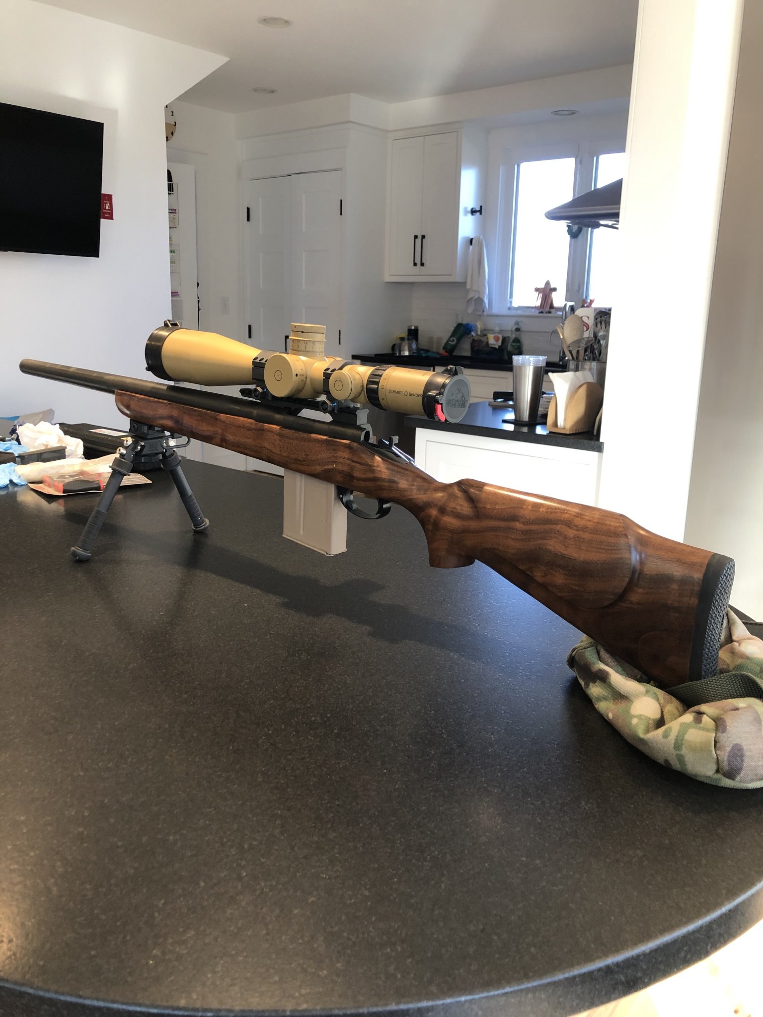

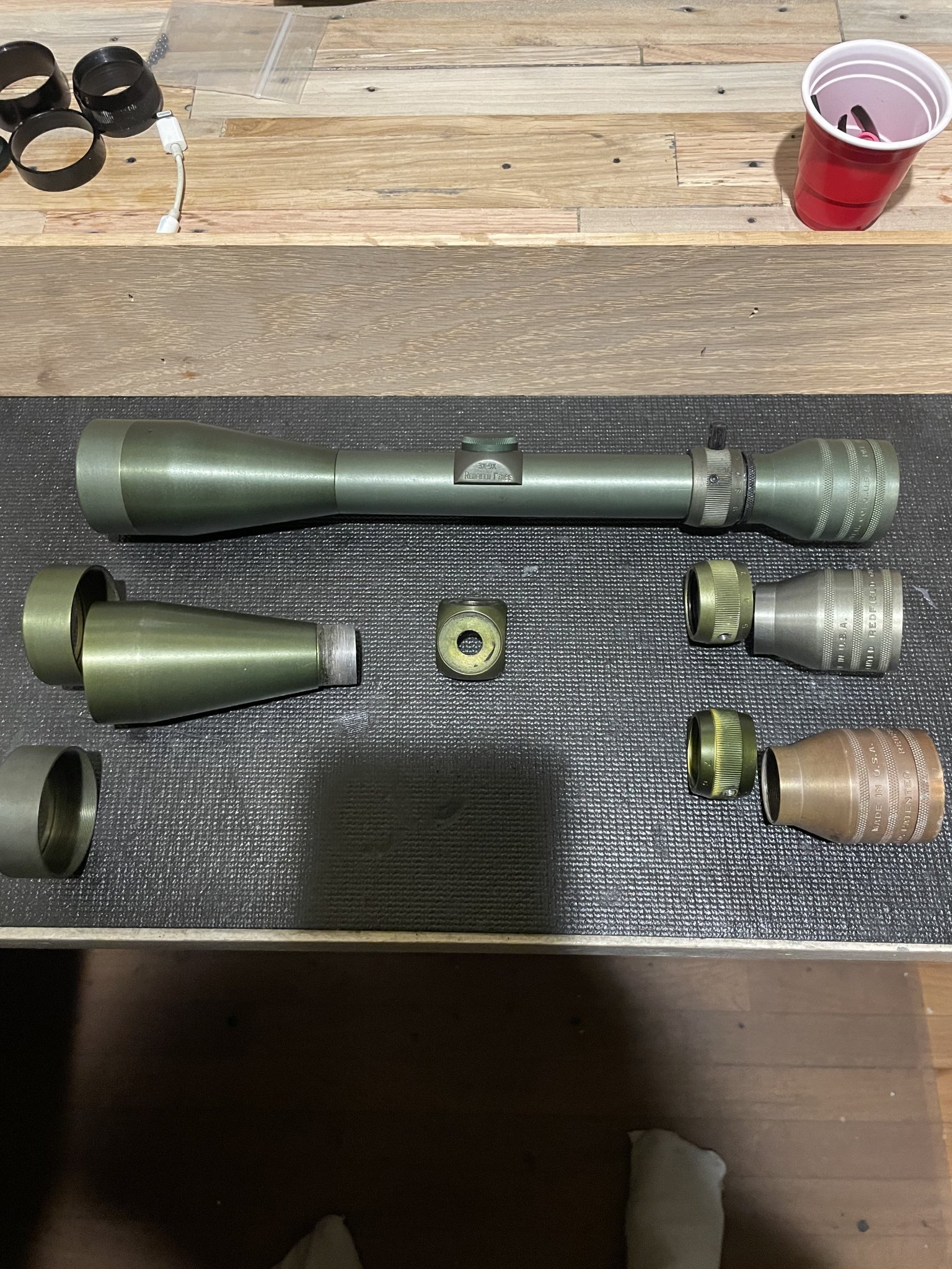

Different color variations I’ve been playing with. These are all anodized with the same dye, I use a few processes to “oxidize” the ano before it’s sealed in a boiling bath of nickel acetate.
Top one is an Accurange, some minor cosmetics, but probably sell it.
