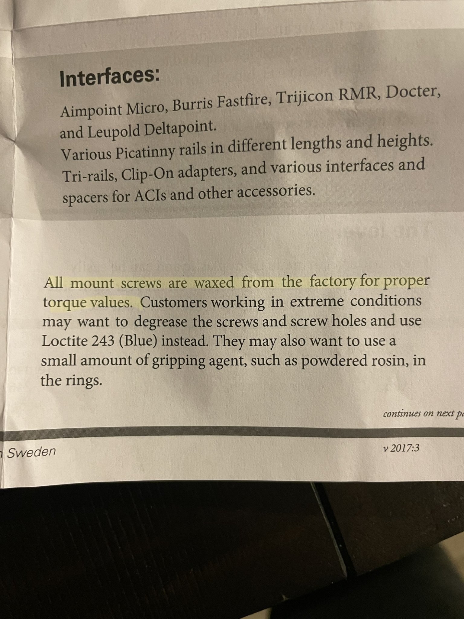

This is a steak thread. Please take the nerd talk to the bear pit. Torque specs may also be discussed in any other board in which it does not apply. Reloading comes to mindPop quiz: given an equal applied torque and fasteners, which creates a higher clamping force?
- dry threads
- lubricated threads
Go...............
Lubed. Lubed generate more clamping load on whatever you’re screwing together. Dry a lot of that torque is eaten up in the threads rather than transferring to clamping load.Pop quiz: given an equal applied torque and fasteners, which creates a higher clamping force?
- dry threads
Go...............

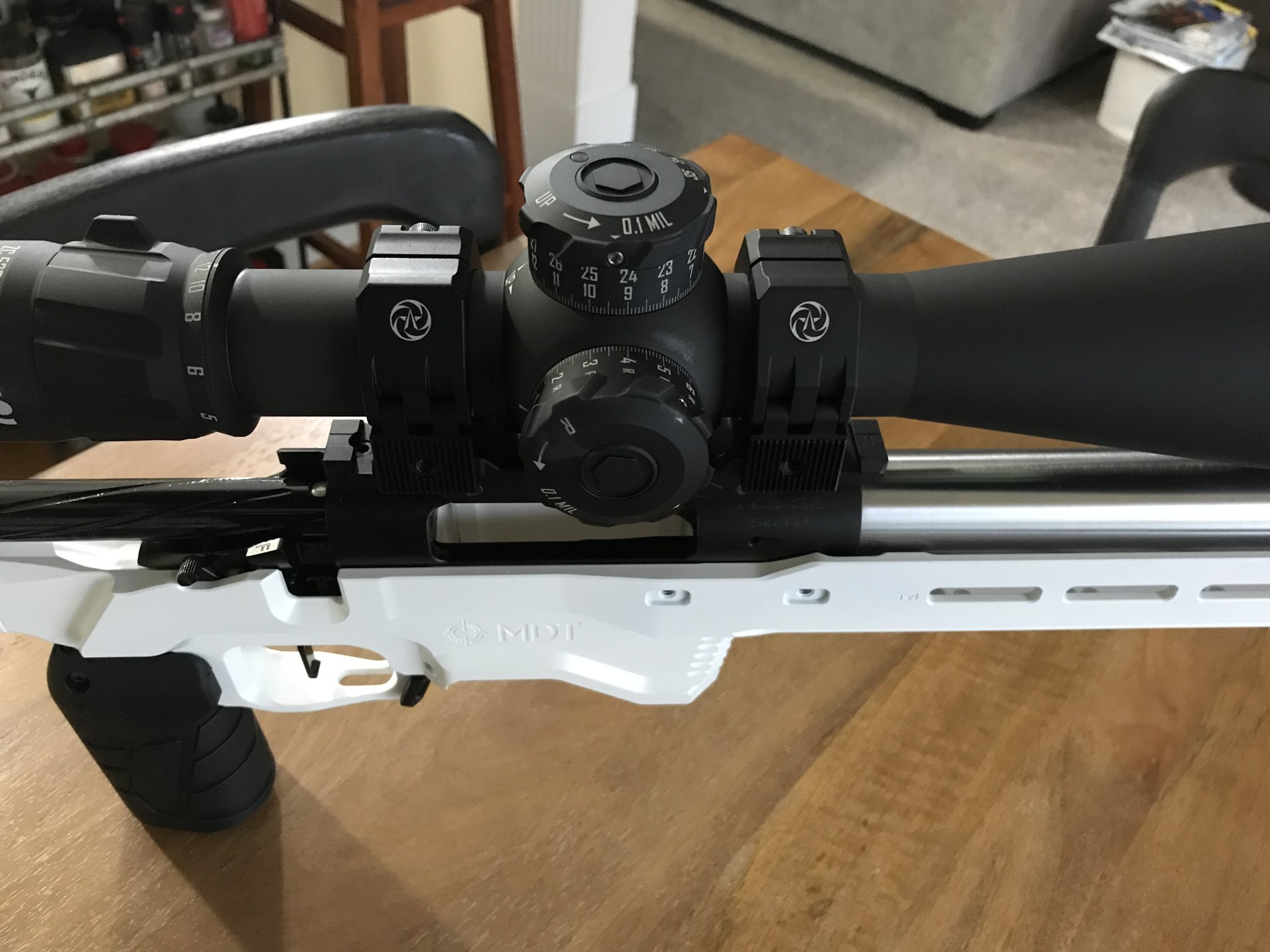

But what do you torque to?Well you folks can keep commenting on the torque setting and a ZCO, I am going to go out and shoot mine today![]()

My apologies for the absence on this topic this week. We've been going through a few items and have obviously been very busy catching up from SHOT. I've spent some time consulting with our engineers and looking at some design stuff and just haven't been on here as much to check in on things. Again, sorry for the absence.
It is quite frankly impossible to provide one single specification on ring cap screw torque values to cover every single type of rings design and application. If we had to give a single number to cover as wide a variety as possible, our official recommendation would be 25 inch pounds. I understand the sticker in the box says 20, that's already in the process of being changed. There are just too many variables to take into account such as lubrication on the screws, screw size, number of screws, etc. to provide recommendations on every situation possible.
We will also go ahead and say that at no point do we recommend going to 55 inch pounds even on the ARC rings. We have been a huge fan of their rings since day number one however we prefer to use 35 inch pounds on these rings. That is our official recommendation for these rings specifically for our products.
Common sense ultimately must prevail here. The ARC, Spuhr, Etc. rings are widely popular and in use throughout the country without any issues on our scopes. They are a great match to our products and we recommend them all very highly.
