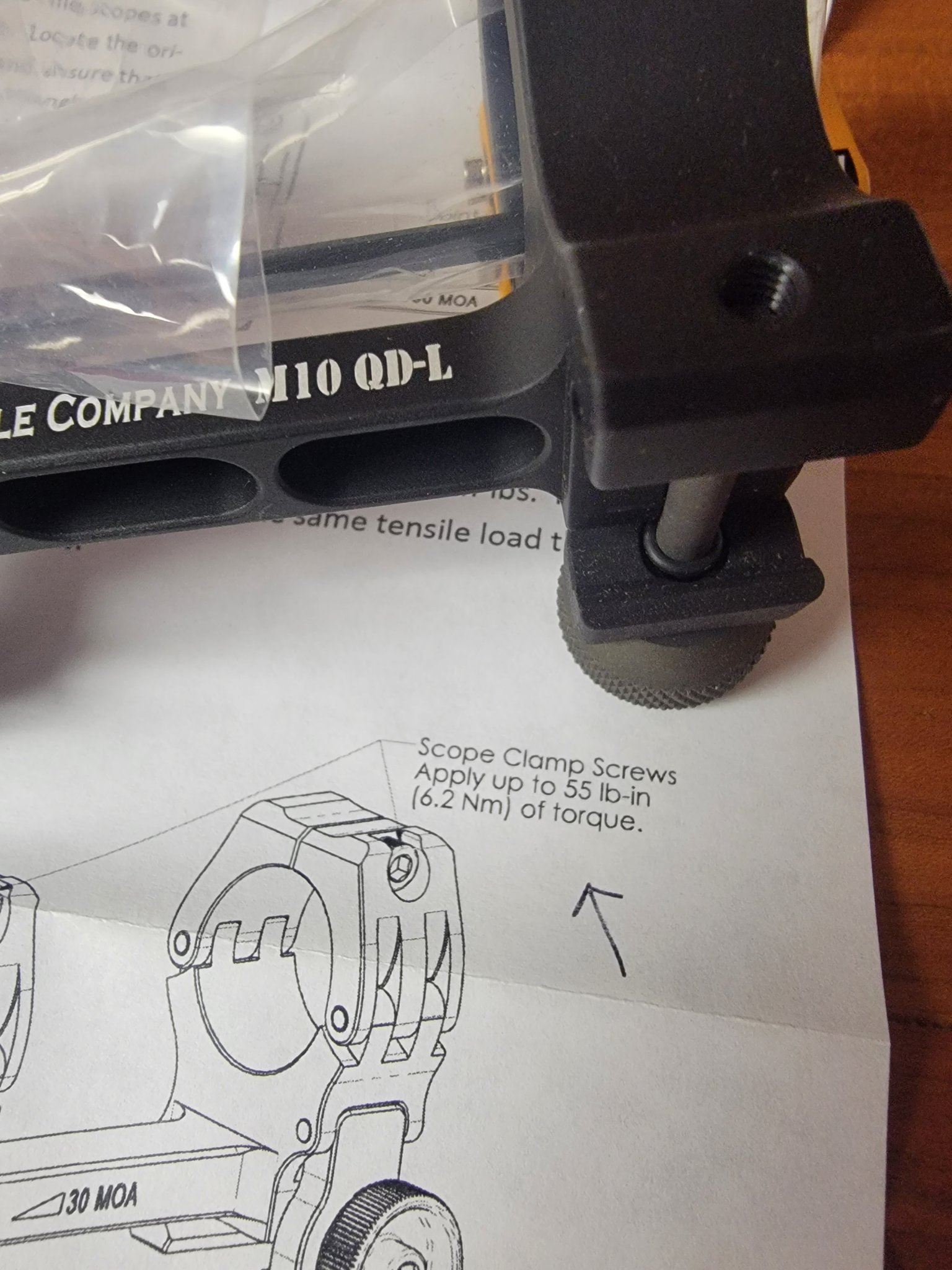

to me the instructions read tighten rail clamp screws to 55. In the photo it clearly shows the rail clamp screws are the bottom ones.
I will admit I could be wrong be cause I do not own a set and I am not positive.
You are right that 55 lbs is the correct torque for the rail screws. It's also the correct torque for the ring clamp screws.
So I uploaded a good crisp photo showing the 55in-lb on the rings. Sadly the forum smudged and down rezed it to garbage.
Any how, any machinest or engineer knows that smaller screws with finer threads generate more clamping force for the same torque than bigger screws with coarser threads. Ted uses one bigger stronger screw. He provides the correct torque to properly torque the scope.
