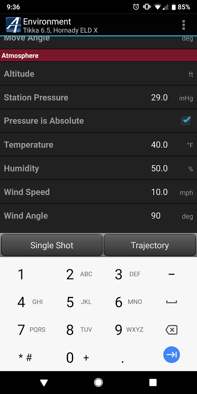

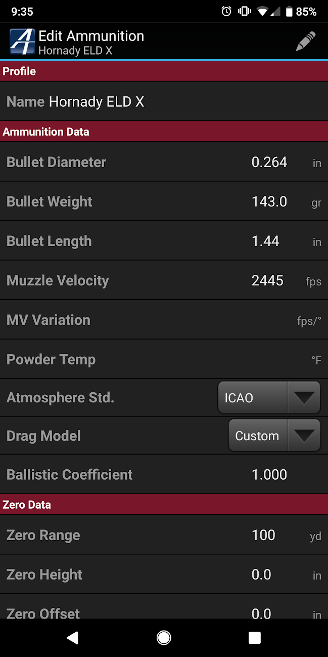

Went out this weekend, great day little to no wind. Had issues with the .300WM but using my 6.5 had the same data mismatch.
Steps performed:
Re-zero
Re-chrono
Check scope level with a tall target and a 6ft level
Tall target tests show my NF elevation tracking at 100% up to 30 MOA (did not test windage as I typically hold for wind)

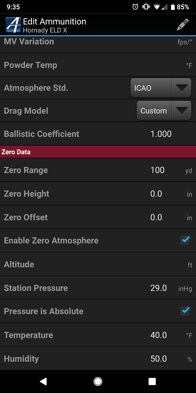

Entered data into Strelok Pro and AB - both gave different results varying 0.5-1.25 MOA depending on range. Strelok was right on within 1 click of perfect out to 800 and AB was always off.
Using a 143gr ELDX with the AB DSF for this bullet - I was able to tweak the MV to get it to line up better after getting back home and playing with the numbers but never got it to match perfectly with what I was seeing. I feel like I have to be doing something wrong with data entry in AB to be that far off.
Ideas?
Post screenshots of your data pages or include all the information you are using.
We need to SEE what you are doing because you are only giving us a partial story.
We need everything, Actual Dope, Ranges, and then Inputs being used. AB could be 100% and you just have one thing screwed up.

What is your actual MV not the corrected MV
Besides what Strelok Predicted, what is the actual elevation at the target, in other words did you write it down.
2400fps is super slow I hope that is what the software did, being that slow your BC is definitely not gonna work. So the Custom Curve will be off, as I am sure the Custom Curve is based on a standard MV and not something 200fps + too slow
This was a load with virgin lapua brass and a very light charge of 39gr IMR4350 just because I had it laying around to fire form brass and get used to the new rifle. I will be doing a full load workup with RL16 shortly.
I do not have the specific elevation at the target but the range weather station reports 1124 ft, the station pressure I wrote down was from my Kestrel 2500 with reference alt set to 0.

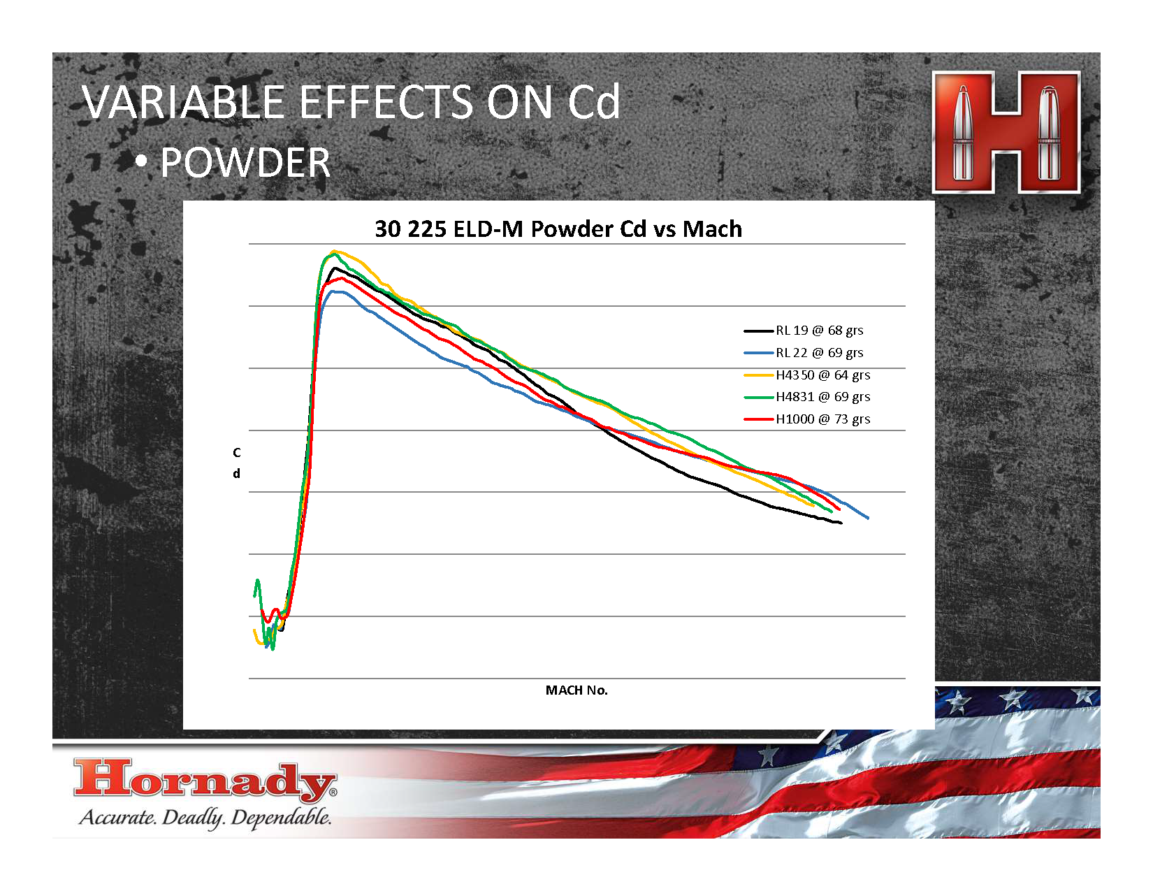

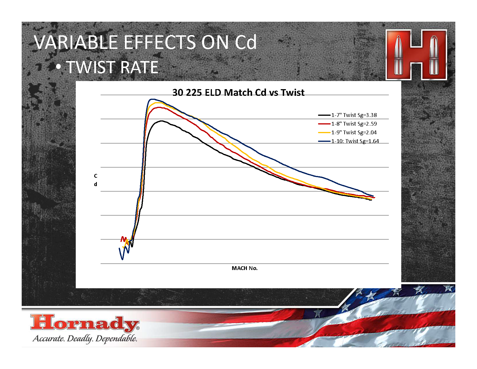

For me,

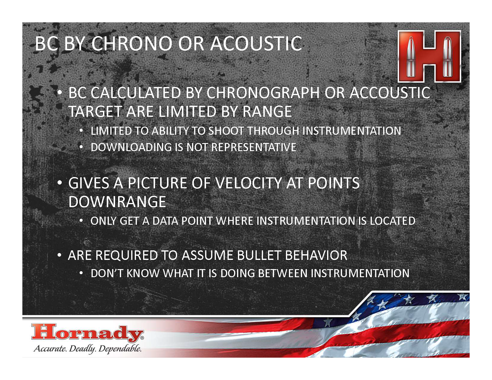

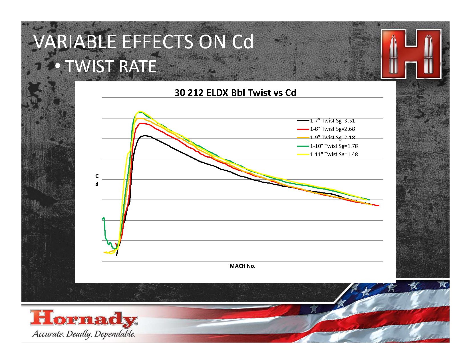

I look at what Hornady has done, having spent several days in NE with them, and getting a class on their methodology, I want to tune the BC. Here is part of my justification for it, the Curves as outline in the Hornady Data:
Twist Rate Curve Spread

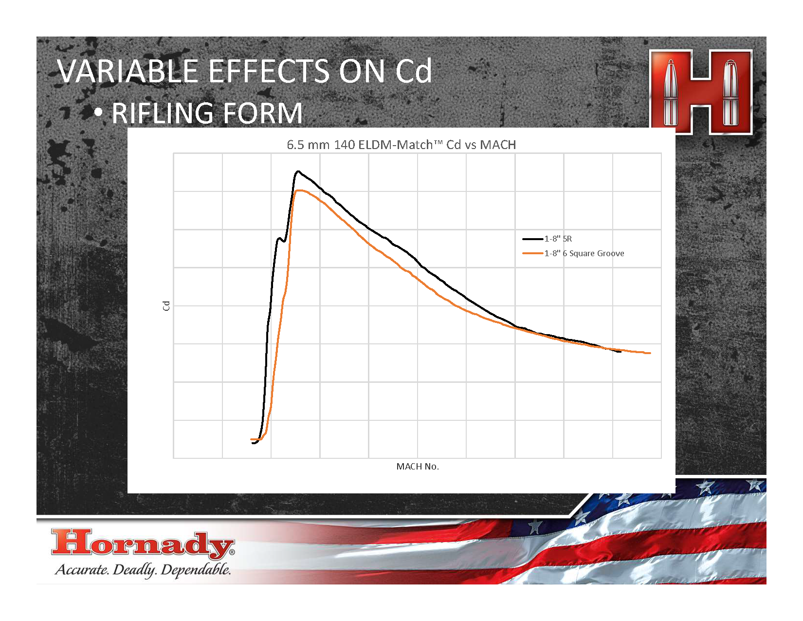

Rifling Effects

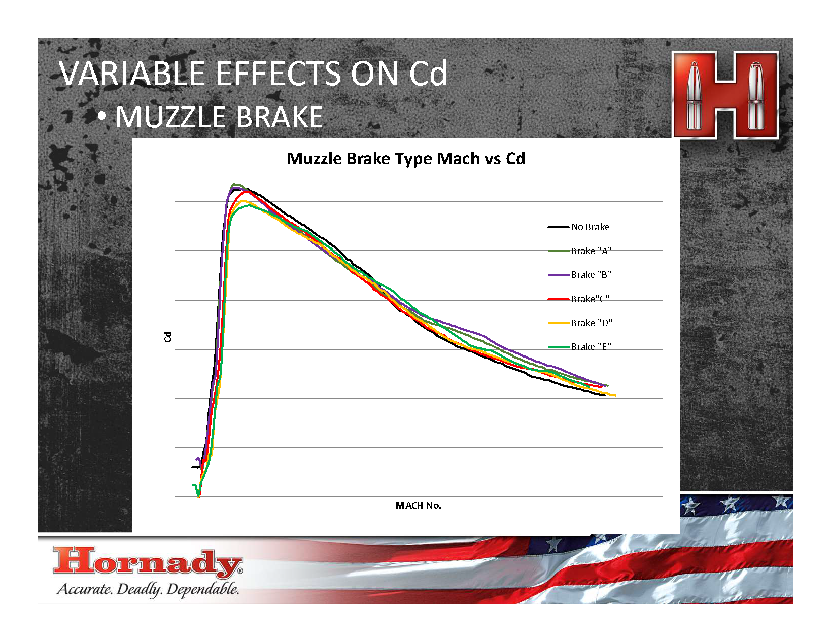

Muzzle Brakes

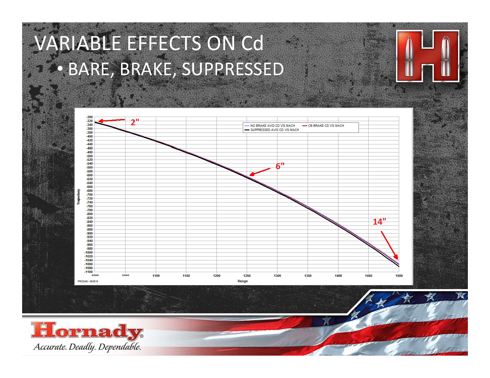

Powder Charge
Other factors,

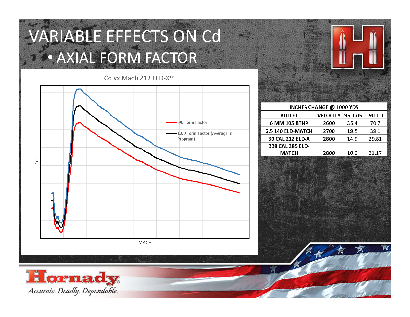

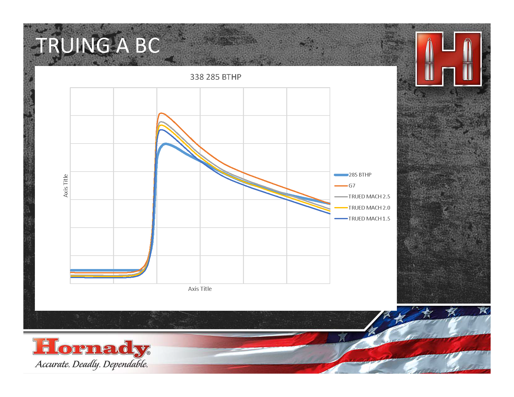

They have moved to the Axial Form Factor which changes the way we address it, but at the same time they talk BC over MV

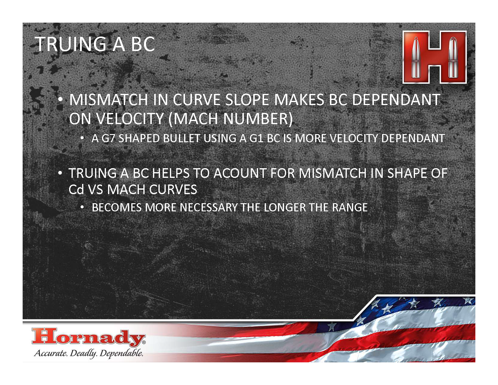

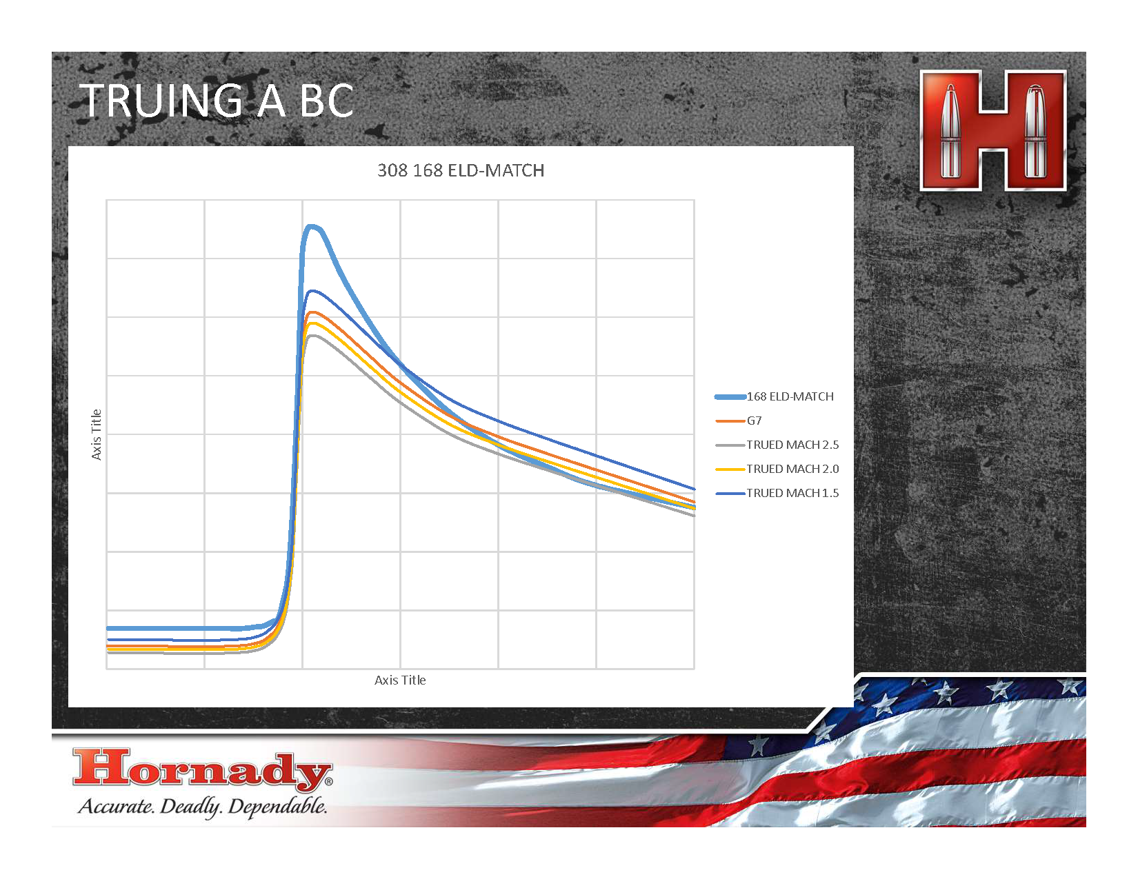

So they go into truing of the BC
Using just the MV is a working solution but limited in my opinion as these variations will change thus causing issues down the road. MV is not something that stays exactly the same.

For me,
Rifling Effects
Muzzle Brakes
Powder Charge
