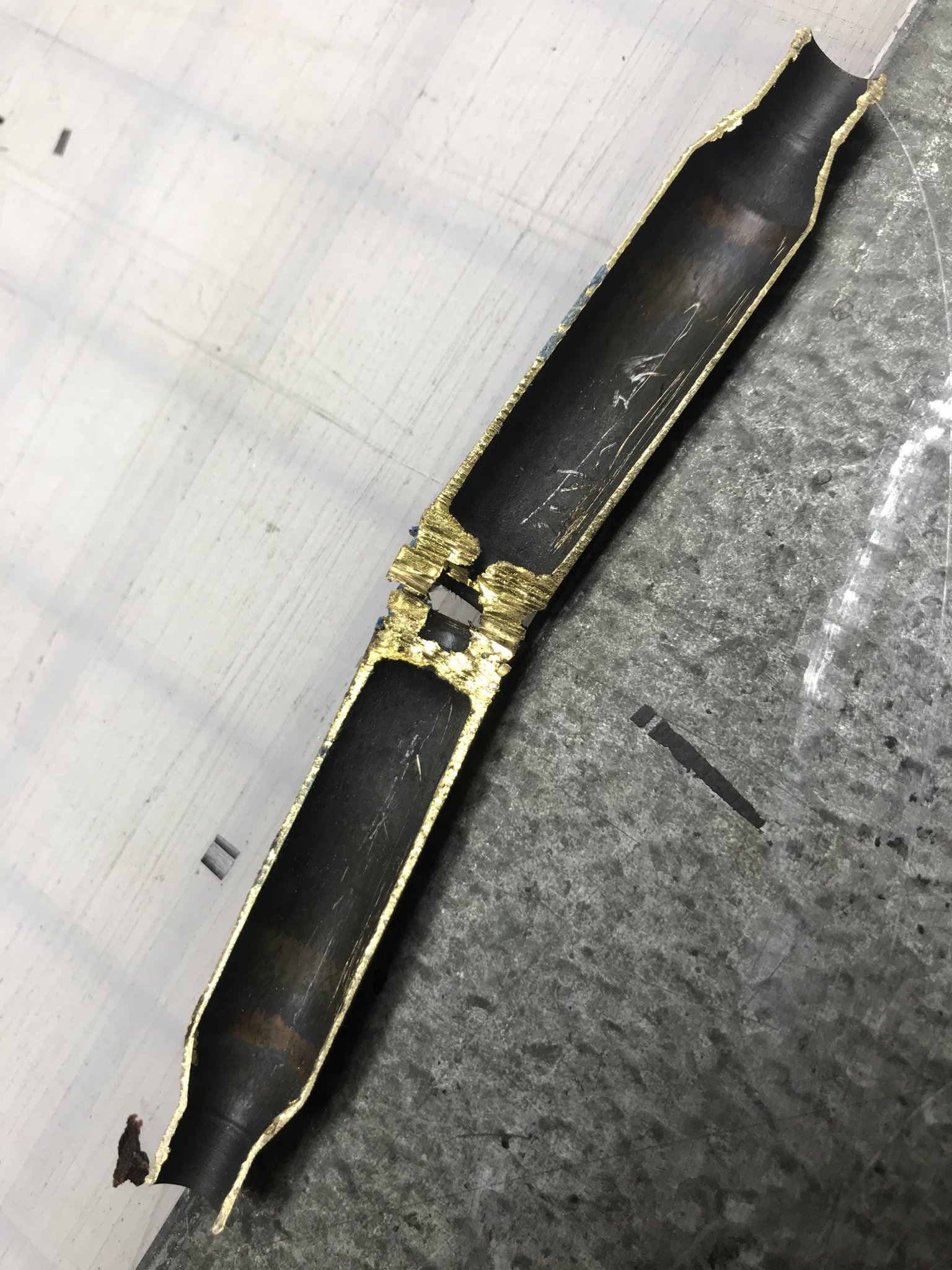

I can show you case that finally gave up the primer pocket after 39 firings and maybe went through a tumbler 6 times in its life.
Carbon inside was amazingly light.

Yeah, that carbon on the inside of that brass DOES look a lot lighter that I would have thought. I would have thought the walls of the body would have looked more like that of the neck.
