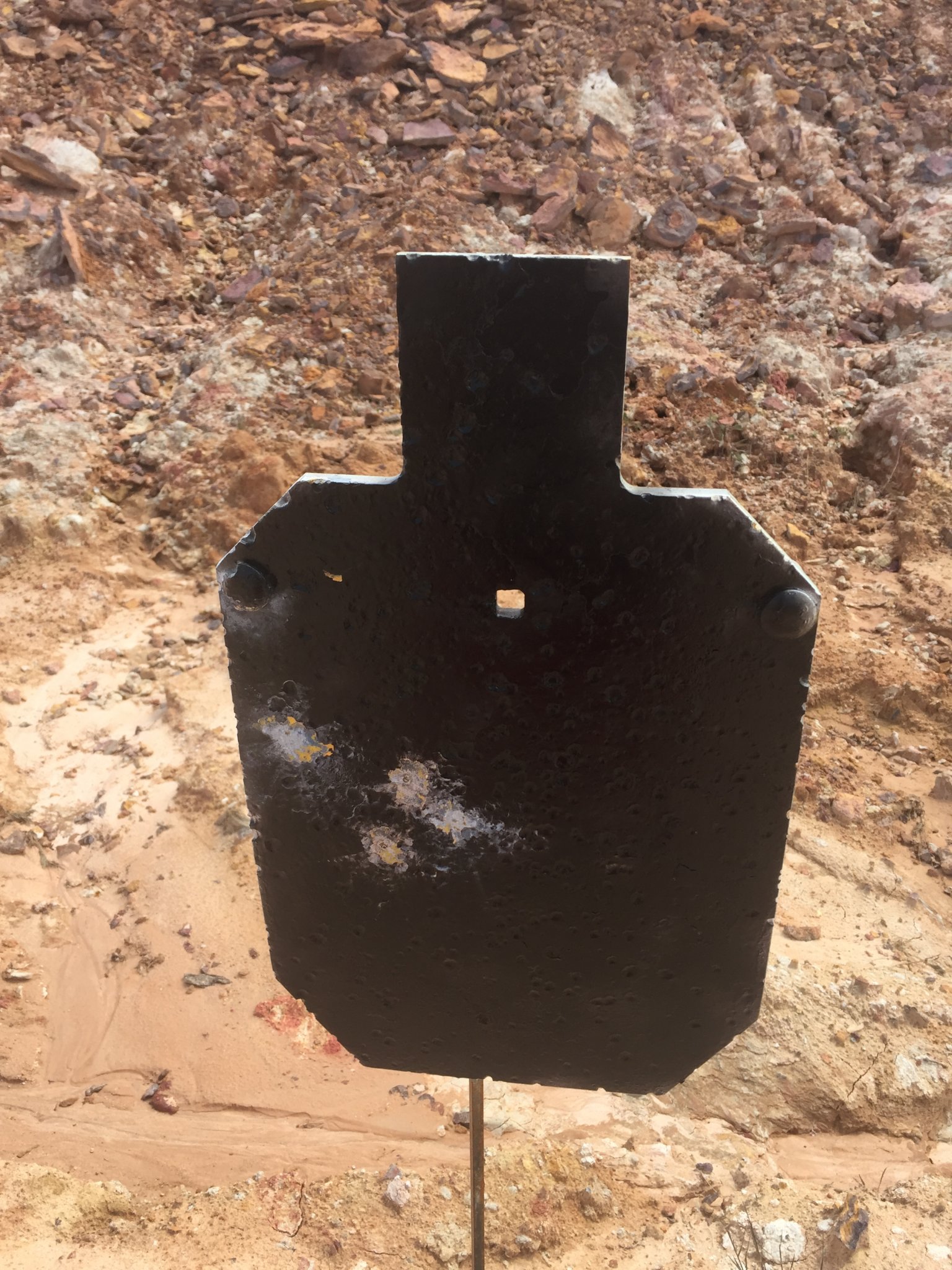

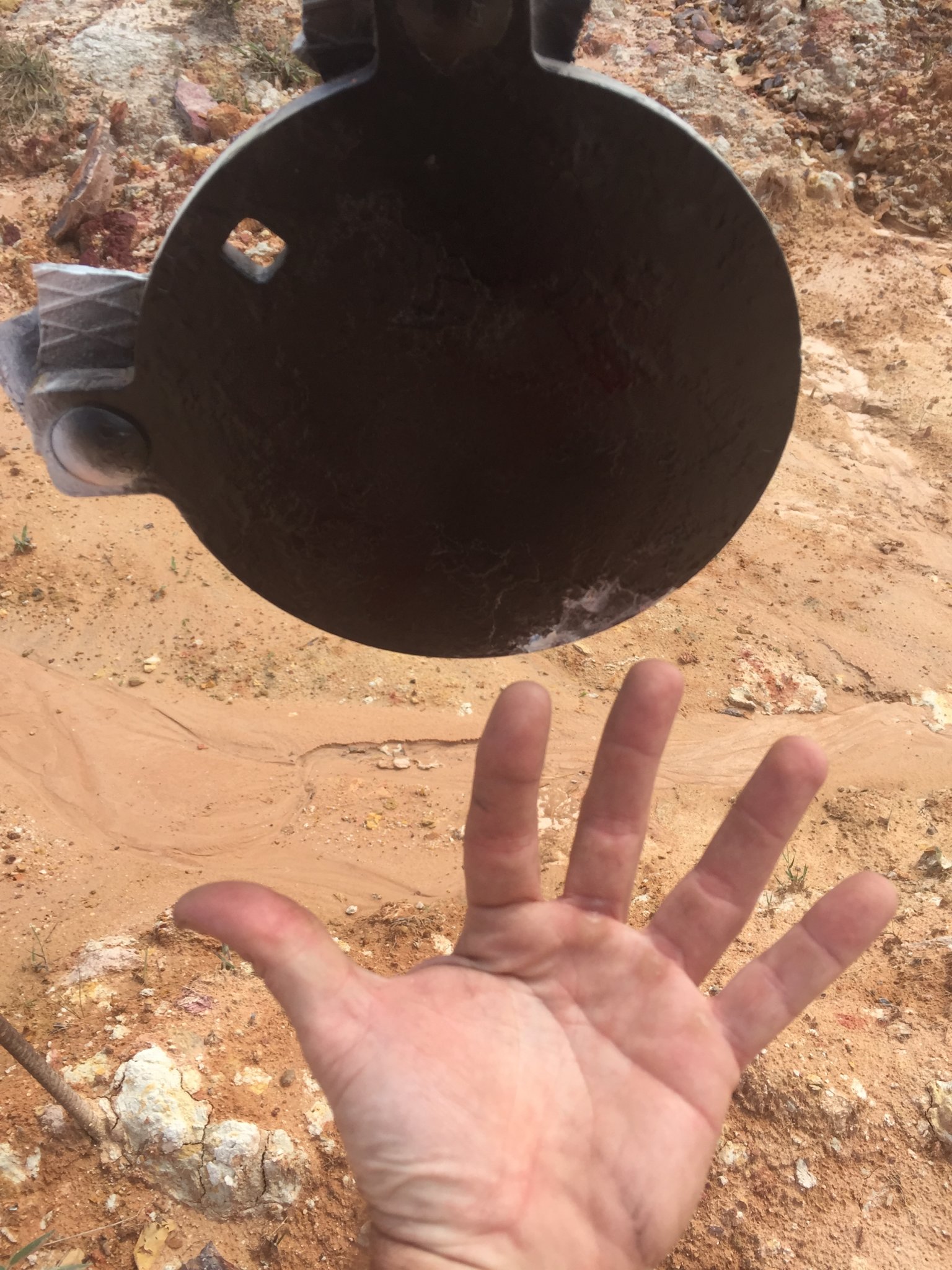

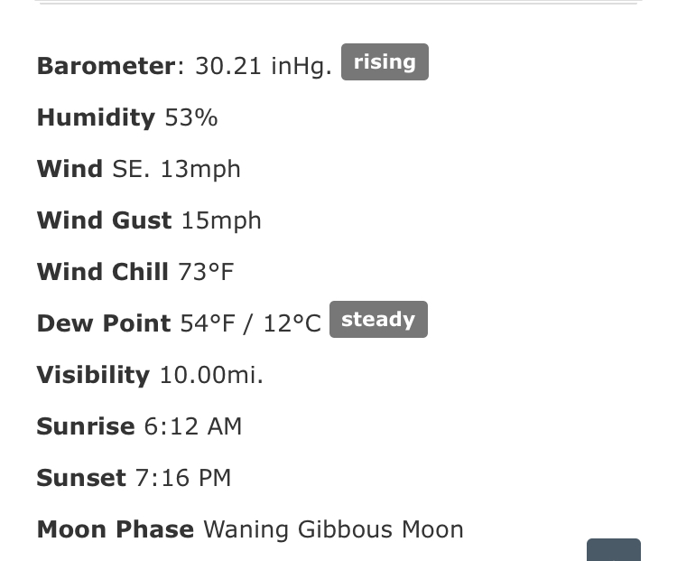

Went shooting today. 16” semi auto .308. I have no clue what distance its zeroed at. Started shooting at 280y and working out adjusting as I went. Below is a C zone sized target at 1060
Weather. Wind was a hard read, those berms do weird stuff.
Even caught the very edge lower of the 10” plate at that 1060.
I do not know at what yardage the scope zero is , shot a new load today so I doubt its the same as last time. Likely with in .5 mil at 100??? Maybe??? If you wana jerk you self off over your zero distance I got lots of popcorn.

Is your point to not worry about where your gun is zeroed, just go shoot it?
Side note: Id love to have that type of access to many targets and ranges to 1100yd, thats awesome.
Trying to figure out the wind was moving the bullet around a hell of a lot more than a few clicks difference in zero.
