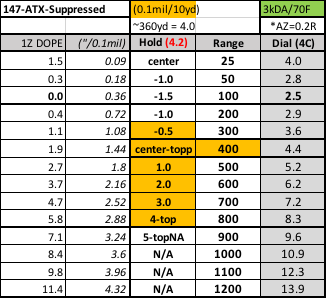

Essentially you'd take your scope/rifle/bullet [gun] and zero it at 100yd.
Create a workable ballistic profile.
Spin turret to ~380yd data (reasoning has a longer explanation but essentially its to offset the 4-800yd drop being <4.0mil - mainly the 4-500 split being less than 1.0mil).
Then slip the turret and set it to read 4.0mil (using center dot, POI should be ~3-4" below POA for a 400yd target) - "low at 4.0"
*fine tuning method depends on DA/F variability expected to encounter with gun system, but above gets you in ballpark. I normalize my DA's then normalize my DOPE accordingly, set scope to that; based on environment just add or sub a click or 2 for same [Holds] (4.2/3.8); outside of 800yd the changes are more drastic requiring updated [4C Dial] numbers.
(4C = 400yd Center; 1Z = 100yd traditional zero)

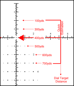

Objective is to be able to either:
A) All holds - with turret at 4.0, hold elevation in reticle (0.1mil/10yd; big 1.0 hashes represent 100yd intervals)
ex.1 target at 678yd - hold below main horizontal stadia 2.8mil
ex.2 target at 500yd - hold below main horizontal stadia 1.0mil
B) All dials - using only center dot for elevation, spin turret to equal range to target/100 (use main horizontal stadia for wind holds)
ex.3 target at 678yd - dial 6.8 on turret
ex.4 target at 500yd - dial 5.0 on turret
On targets 'inside the kitchen' or 200-800yd roughly depending on MV/BC and current environment. That is 'match mode' essentially.
If you have targets outside the kitchen you can easily retain the same accuracy of a 100yd traditional zero by simply creating a DOPE card (and those numbers are equal to your 100yd zero data + [4C Value] (which is what your turret reads when center punching a 100yd target))
*shown below

Armband DOPE
(my own recently gathered DOPE )

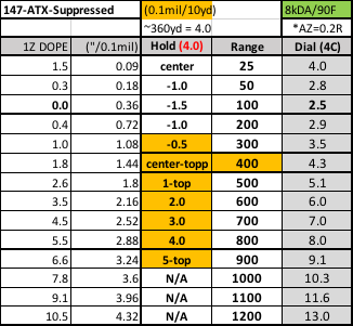

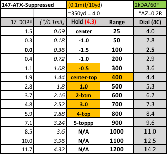

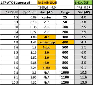

Only other consideration is drastic changes in DA and temp to a lesser extent. This is where the 4.0 hold correction factor comes in (the 1-2clicks up or down thing mentioned above. Look at the data card I have for a match in Iowa estimated to be @2-3kDA and compare it to my 8kDA CO card.
CO-8kDA
(IA-3kDA left, IA 2kDA right)
(notice the red value - that is the DA/F alteration required to keep the [kitchen/4C holding zone] lining up the same way as CO)
That way my holding procedure remains the same no matter where I go.
*And again, the dial on numbers remain just as accurate as a 1Z system.
