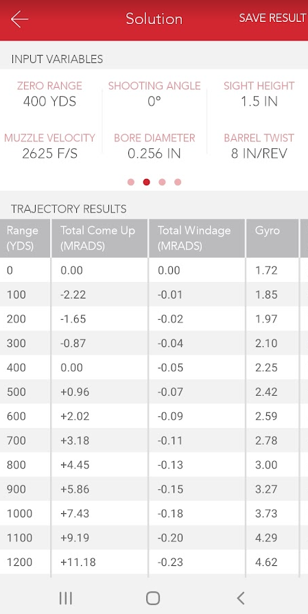

Anybody out there that has TRIED a non 100yd zero before on a bolt action rifle (notice, I never claimed it to be superior/inferior) - why was it worse than 100yd?
My fear is that everyone who has so far commented is such an 'under-thinker' it is actually surprising to me.
All the beer-drinking deer hunters in my area just throw a Budwieser can down on the ground at about 10 feet and adjust until they hit the center of the top. Does that count? They sure shoot a lot, but don't seem to bring home many deer. Their excuse is usually brush getting in the way.
I hear ya, but thats why I landed on 400yd; the math works out very nicely (most cartridges between 80-180gr and 2500-2850fps with 400yd zero will fall within [3"] at 300y (-1mil), 200 (-2 low side) 100 (-2 high side). Turret at 4 when zeroed at 400 makes yardage =turret (so holding and dialing becomes the same numbers, pick a technique dial or hold) out to 700yd (7.0) with at most 5" (assuming only 1 of the extremes I set out is used)...for a cartridge on the extremes of both limits I set (say 3000fps/200gr ie Norma you could change to a 700yd zero and things can work in a similar way but Id say remove those from this conversation for now because I haven't thought much about those as much yet).
So for mid range engagements it can be precise enough on 10" targets and very quick. For longer range you just dial on the normal turret DOPE (which as we all know is the same delta as any yd zero - just write it down). For ultra precision inside 400yd can dial the DOPE with same delta as any yd zero - just write it down and use like the 100yd DOPE most already have.
If I had access to a range like GG Juan Id do all this and tape it because I think it has a use/potential - especially for normal 6.5CM/.308.
BUT yes it IS the same solutions if you go by barrel angle....why some people dial wind (apparently Feniks), some hold - could argue ones faster, could argue the other is more precise. But user preference is all were really talking about.
I encourage ppl to show me just their ballistic solver results set up for their gun with 400yd zero and see how close you are when you fall inside the limits I set and at most use 1 extreme. But if somebody who has the access wants to try a real run and show how precise OR imprecise it is real world Id love to see that too.
Just a trend I noticed and ran with it.
So you haven’t done this but just think like it sounds like something that would work?
Sounds like a loaded question - should I even bother responding at this point?
I successfully got a bunch of ppl engaged over a supposedly "dead" topic
Then I explained the real motivation behind the original question. I did get zero info I had expected to get - but got info that has some value nonetheless I suppose.
That said, Id be willing to bet that it works very closely to the way I described, taking into account theory vs reality.
What more do you want? You have to start somewhere in order to get anywhere....
If youre a diehard 100yd zero till you die fan - like many on this thread - then why act like you even give a damn about anything I say past that?
I said be productive - plug in one number into your own ballistic profile and tell me where your numbers come out. Am I asking too much - really I just wanted to see you guys prove me wrong at 'my own [game]' so to speak since it seems to be what y'all thrive on. Give it a shot.
It'd be much less wasted time on comments with little to no real insight - does anybody still continue to think I dont understand how a 100yd zero works, or how its all the same just different ways of 'slicing the cat?'

I don't have the access to that kind of target package.
All I asked was for you to plug in one number on your profile and see...post the results.
You know about Kraft Drill I assume...its the same thing - using multiple people [datasets that aren't your own manipulated ones] to get a better grasp on the underlying physics.
Id say Im asking even less than Kraft Drill. Plug the number 400 in and check the results 1-700yd then post.
If thats me asking too much work from you guys then Ive been thrown through another loop here on the Hide that I didn't see coming. I did a lot of work on this already everything I can up to reality - so right now the phase is can others replicate my theoretical results with their specific ballistic profiles, what are the limits then, where do the numbers start to break down? Because tryDOPE and truDOPE are different - I used all tryDOPEs on different calibers/bullet weights but you guys should have truDOPE and that is more valuable to me as of now (as it should be).

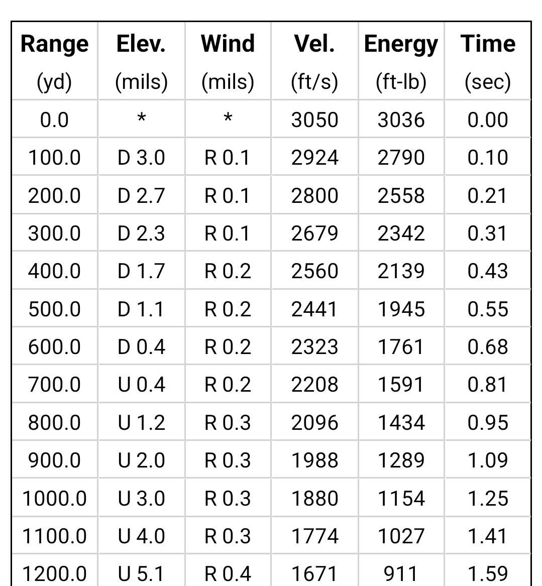

Range
(y)
Velocity
(fps)
Energy
(ft-lbs)
Elevation
(mils)
Windage
(mils)
TOF
(s)
100​
2691​
4022​
1.64​
0.09​
0.11​
200​
2585​
3710​
1.29​
0.18​
0.22​
300​
2481​
3418​
0.69​
0.27​
0.34​
400​
2380​
3144​
0.00​
0.36​
0.46​
500​
2280​
2887​
-0.76​
0.46​
0.59​
600​
2184​
2648​
-1.57​
0.56​
0.73​
700​
2089​
2424​
-2.44​
0.67​
0.87​
800​
1997​
2215​
-3.37​
0.78​
1.01​
900​
1908​
2020​
-4.36​
0.90​
1.17​
1000​
1820​
1838​
-5.41​
1.02​
1.33​

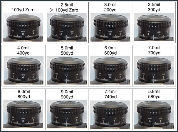

Speed Drop. This is some valuable information for long range shooting.
Speed Drop (UPDATE)
Finding your Speed Drop Factor
Its already been done. The trend has been found, set, studied, filmed, used, applied and published. A Kestrel Elite will even calculate this effective range for you. This google sheet will calculate this for you.
_________________________________
I'll quote myself:
"Most rifle calibers have a portion of their bullet flight where the relationship between the drop of the bullet and distance traveled is consistent. A zone where every 100yds of distance is an additional 1mil of elevation. As an example, if our data says 500yds = ~2.5mils, 600 = ~3.5mils, and 700 = ~4.5 mils we can start to see this consistent relationship between distance and come-up. For every 100 yards traveled the come-up is changing 1 mil. As the bullet gets further away and starts to slow down more quickly, this relationship will start to change and will no longer be a constant value, but in the ranges that it works we can use it to our advantage to quickly calculate our come-up."
__________________________________
For most of our competition calibers its 400-800yds. For magnums is 700-1100 yards. (For bb guns is 25-50 yards.)
No, none of them/us zero at 400yards (or the start of thier speed drop range) to make this work. We all, still, zero (check point of aim = point of impact) at 100yds them move caps to make this work. Or Dial down to our 100yard dero (2.5 mils in the photos below) to check zero at 100yards using the main stadia lines.
You can set your turret to 4mils for 400 yards or you can slip it the same as your speed drop factor and 4mils will equal your 400 drop.
This is the same thing you are trying to show us you found out about.
Still POI=POA check is at 100yds because we are shooting 1-1.5 MOA targets, not full IPSCs.
Honest question - Why would you not dial down to your 100yard zero and check it there?
Example = your 30hate with 100yard zero has 2.8 mils up for 400yards. So you dial up 2.8 mils then slip your caps to 4.0 mils (IE your idea of a 400 yard zero and setting) You can dial down to 1.2 mils and use your main stadia to zero at 100yards. (you can still use speed drop and zero at 100yards without changing your caps)
Ive read that specific thread and applaud you for writing it. We've established that the ballistic (barrel angle) will be the same no matter how you manipulate the scope for each range. Im doing it a tad differently.
-2mil hold at 100yds (400yd zero, turrets aligned to 4.0 @ 400) is within 3" on a 100yd target. I suppose that is 3MOA but it is in all fairness outside of the "sweet spot" zone as you know - so for ultra precision in that zone Id just dial whatever my specific DOPE is on that gun (say -2.3) so DOPE would read as "1.7"....dial to 1.7 and you are hitting that 1" sticker.

But if I plug in what you told me I get
100 = -2.0
200 = -1.5
300 = -.8
400 = 0
500 = 0.9
600 = 1.8
700 = 2.9
800 = 4.1
900 = 5.3
*but im using theoretical data not a profile thats been tested at the range - so if your data is real world Ill defer to your numbers.
Pretty darn close
