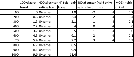

but yes my next goal is to actually shoot this style with the layout described and see real world results.
0.2 mils off of the established (-2.0) mil hold for 100yd makes the difference 0.2mil which is .72 inches not 7.2inches

You know about Kraft Drill I assume...its the same thing - using multiple people [datasets that aren't your own manipulated ones] to get a better grasp on the underlying physics.
Id say Im asking even less than Kraft Drill. Plug the number 400 in and check the results 1-700yd then post.

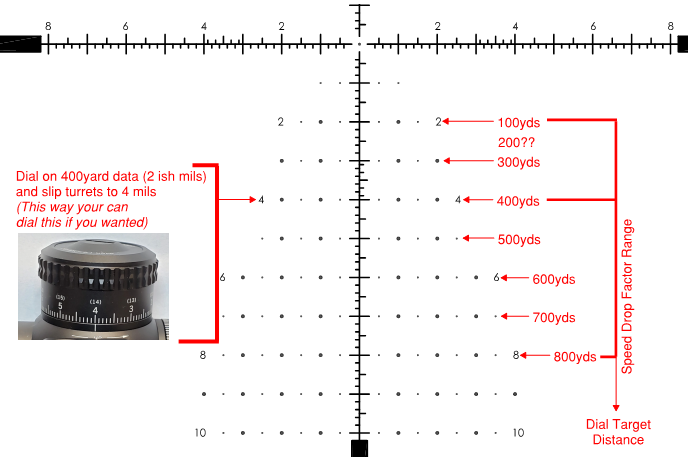

the intention was more for UKD targets in 3-700yd zone that need to be hit quickly (no looking at DOPE card, no real thinking at all just put at correct mil hold and send - it'll be rather close from data so far
for clarity - This is your intention?
no,
2mil above center of reticle is 100y
2mil (1.8 but 2.0 for quick less precise) above center is 200
1mil above is 300y
center of circle is 400yd
1 mil under that would be 500y
2 mil under center 600y

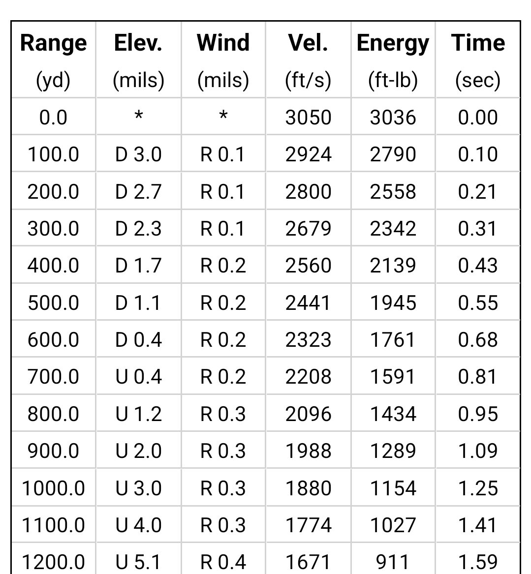

3mil under center 700y
from there the trajectories get too much spread to be even kind of accurate so unless your specific cartridge hits money at 800 I consider past 3 mil under center to be no go zone for holds,
instead use the turret to dial specific DOPE and hold center of reticle using horizontal stadia for windage - which is just an adjusted number based on the delta you would already have from 100yd traditional DOPE.
so if 100yd data tells you 6.7mil @800
you'd add the delta between 400 and 800 for 100yd traditional DOPE (mine is 400-2.2; 800-6.7) so turret at 800yd target with 400yd zero (because turret would be set at 4.0 to correspond with distance in that 5mil range - above center 2, below center 3) holding at center of reticle would specifically read 8.5mil on turret
So 800 in new system would be the 4.0 that is the new 400yd center "zero" (really I only mean it to represent the center of reticle - for designing purposes) 4.0 plus delta of your 100yd DOPE from 400y to 800yd (4.5 for me - [2.2-6.7]) = 8.5 on turret and its considered a non-hold/high precision shot so the rule would be use center stadia for dialing shots/high precision.
but inside 700yd you would just hold most everything other than 100yd groups which again would then be a "high precision shot" and you'd dial and thus use center of reticle [100-0.0; 400-2.2]=2.2mil so 4.0-2.2 = 1.8. You would dial to the 1.8 mark on turret and that is your high precision, center hold answer.
In the end you would just have pic below as your "data" so you have removed any confusion from conversion - I got lost a couple times too so just made an excel sheet for simplicity - that is one of the big points to doing this simplicity in quick engagements 10" target 1-700ish, with the ability to dial when higher precision/more time is needed/available.
Another way to do convert your data quicker now that I look at that excel sheet is just add your 100yd HP turret solution (1.8mil for me) to every number you've already collected for traditional 100yd DOPE.
Further - if you hated holds and really wanted to use horizontal stadia you can dial the turret to corresponding yardages between 300-700yd under most circumstances. 580 = 5.8, use center/horizontal stadia for precise wind hold

Was asking for people to use their confirmed DOPE in their own ballistic solvers for more realistic data because I haven't shot your guns; but would like to use your real data - not the theoretical data that I already have used in multiple calibers to make the conclusions Ive already made.
Its an inbetween step between all only my theory (tryDOPE many calibers) - all only my reality (actual DOPE used on real targets with my system in place on the scope)...
Want to gauge how the system works for other peoples realities.
Im actually a fun guy in reality!
This stuff has all been looked at and tried 100x over.
It doesn’t work except in rare circumstances where it lines up.
Otherwise, we would be telling people to zero at 100, then dial to 400yd dope, then slip turret to zero and adjust in 1 mil increments for 100yd increments.
Doesn’t work consistently. Not even part of the time.

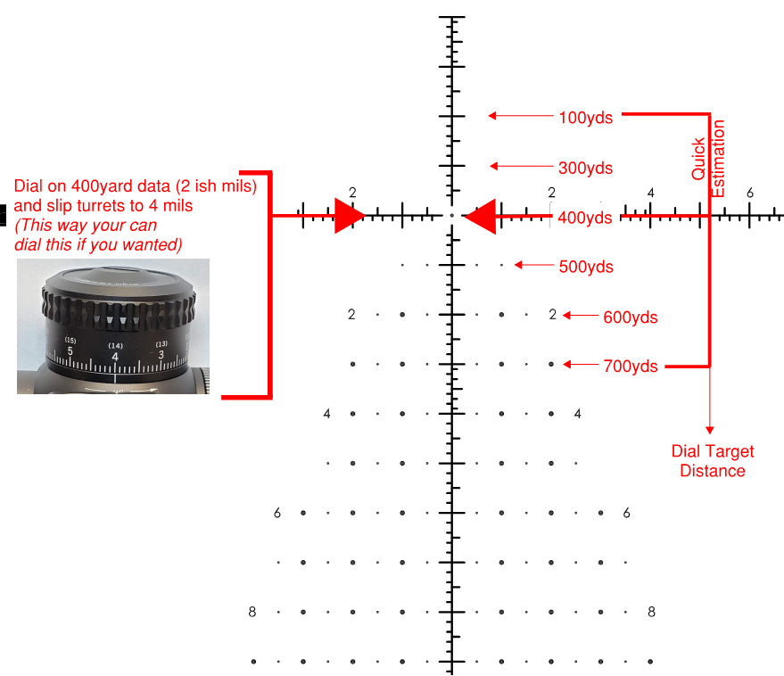

no,
1mil above is 300y
So, This is what you are doing.
It's still the idea of Speed drop but adding the holdover/holdunder to it and your using the 400yd dope as your speed drop factor. Its the same system but being applied a little differently. If I could, I think I would (personal preference) still dial under my speed drop factor so I could holdover 3mil = 300, 4 mil = 400, 5mil=500 etc then be able to dial my normal dope for anything over 800 like the speed drop article shows.
