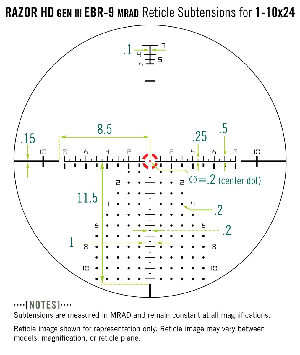

So, 1 MOA dot in the BDC reticle and 0.2 mrad dot (~0.7 MOA) in the mrad tree reticle.
The segmented circle seems to be a little smaller and thinner than the one in the FC-DM reticle.
@verdugo60 is this alogn the liens of what you were looking for? This dot is 57% of the size of the one in the Nightforce.

Actually if you’re looking at area that the dot covers instead of linear measurement, this dot is about 1/3 the size of the one on the NX8.

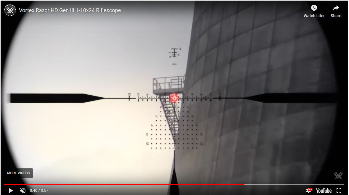

I felt kinda dirty watching that video. Like the scope was designed for Timmy's that suffer from delusions of mall ninja combat. I just want to do civilian things with it but now I'm worried I don't qualify to own one.
Yeah, that video was a little Paul Blart, but oh well.
And why can't we just have regular numbers instead of the goofy sci-fi style ones in the photos?
Yeah that video was pretty cringeworthy.
They could've found far less mall ninja examples of the intended use.

Yes Sir, this might be Exactly what I was looking for, so far so good on the reticle.
