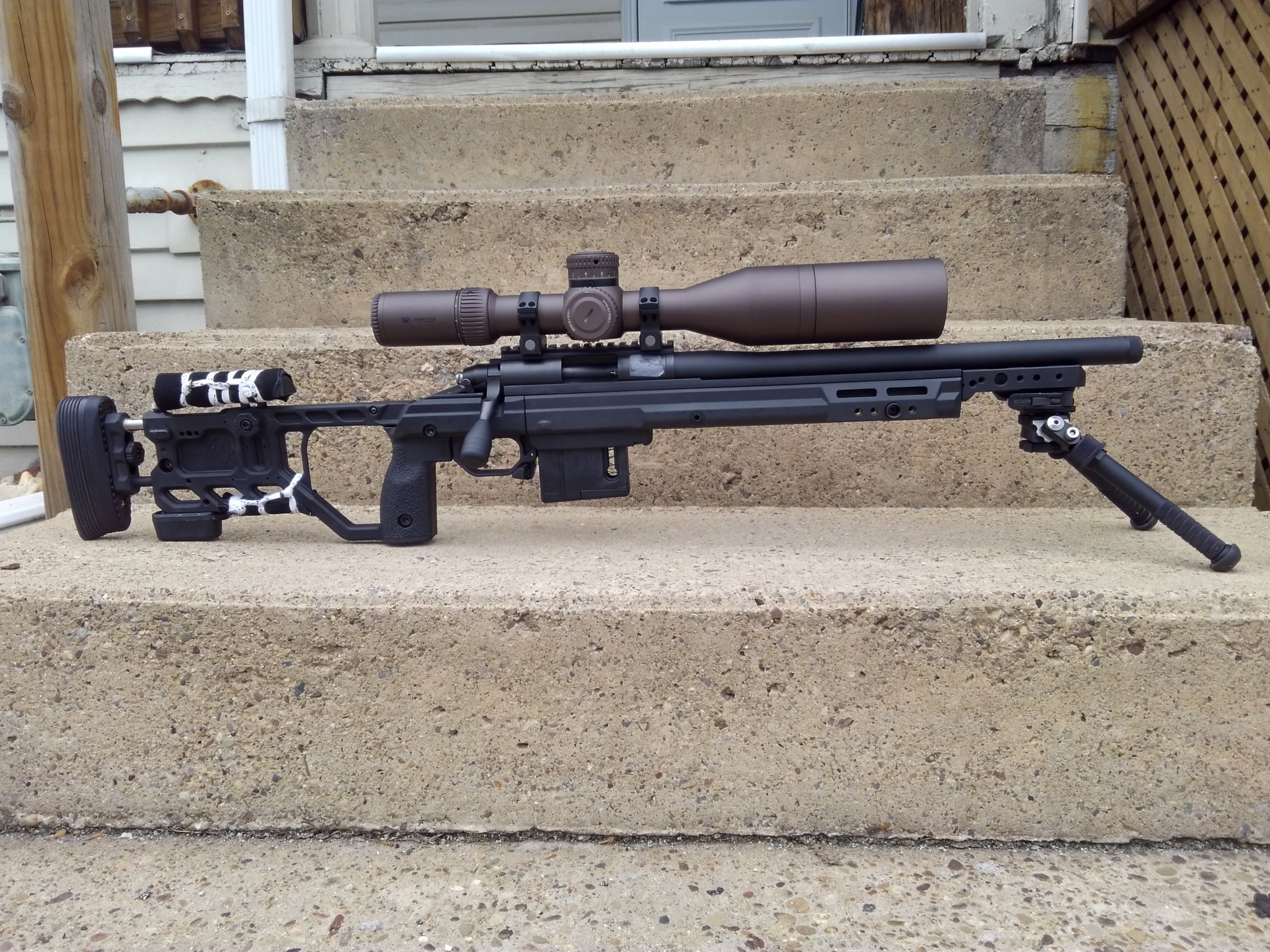

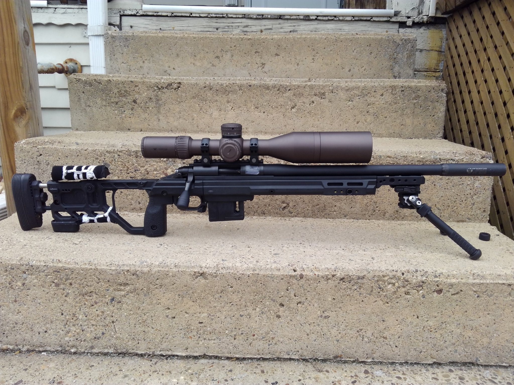

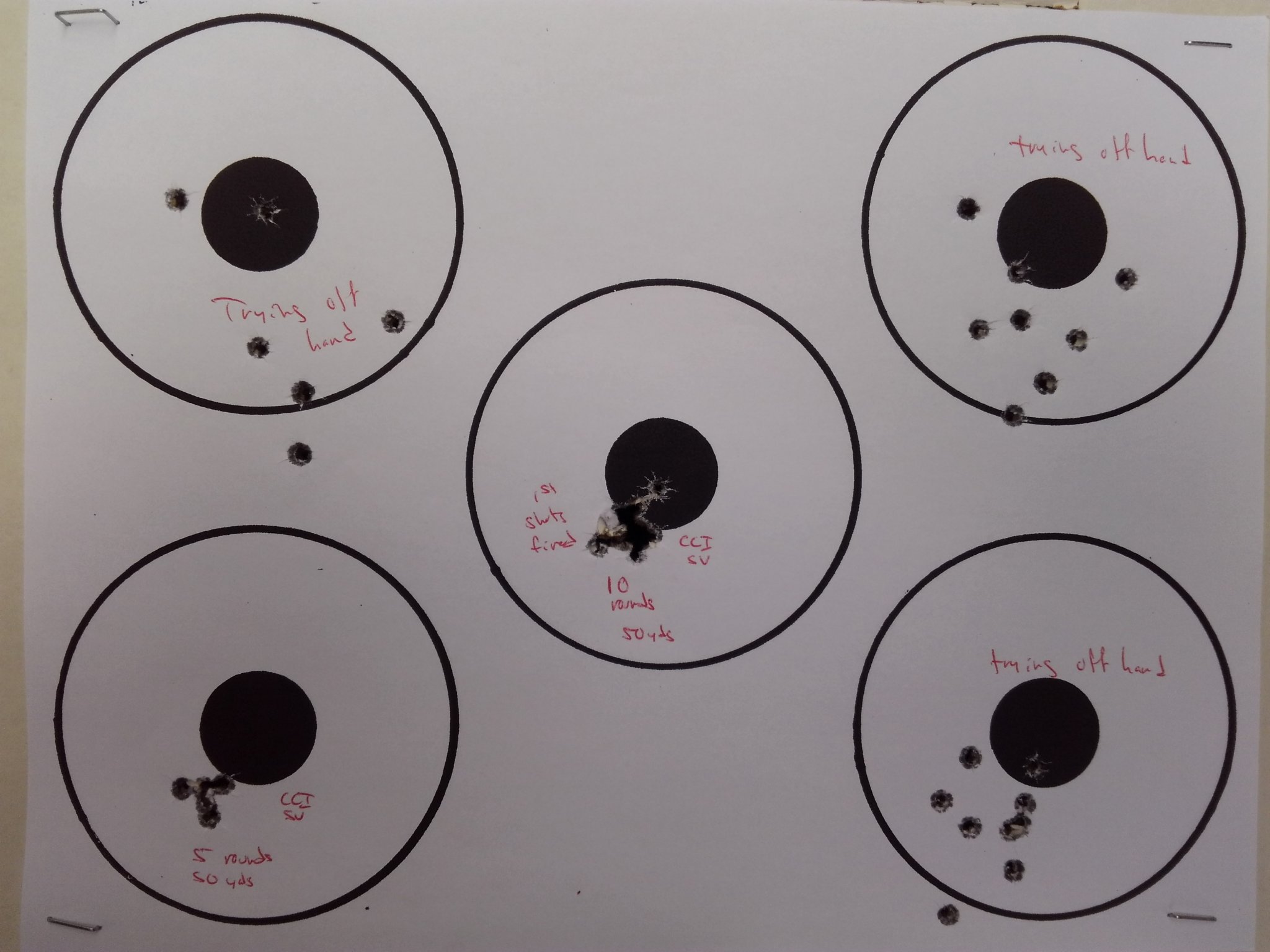

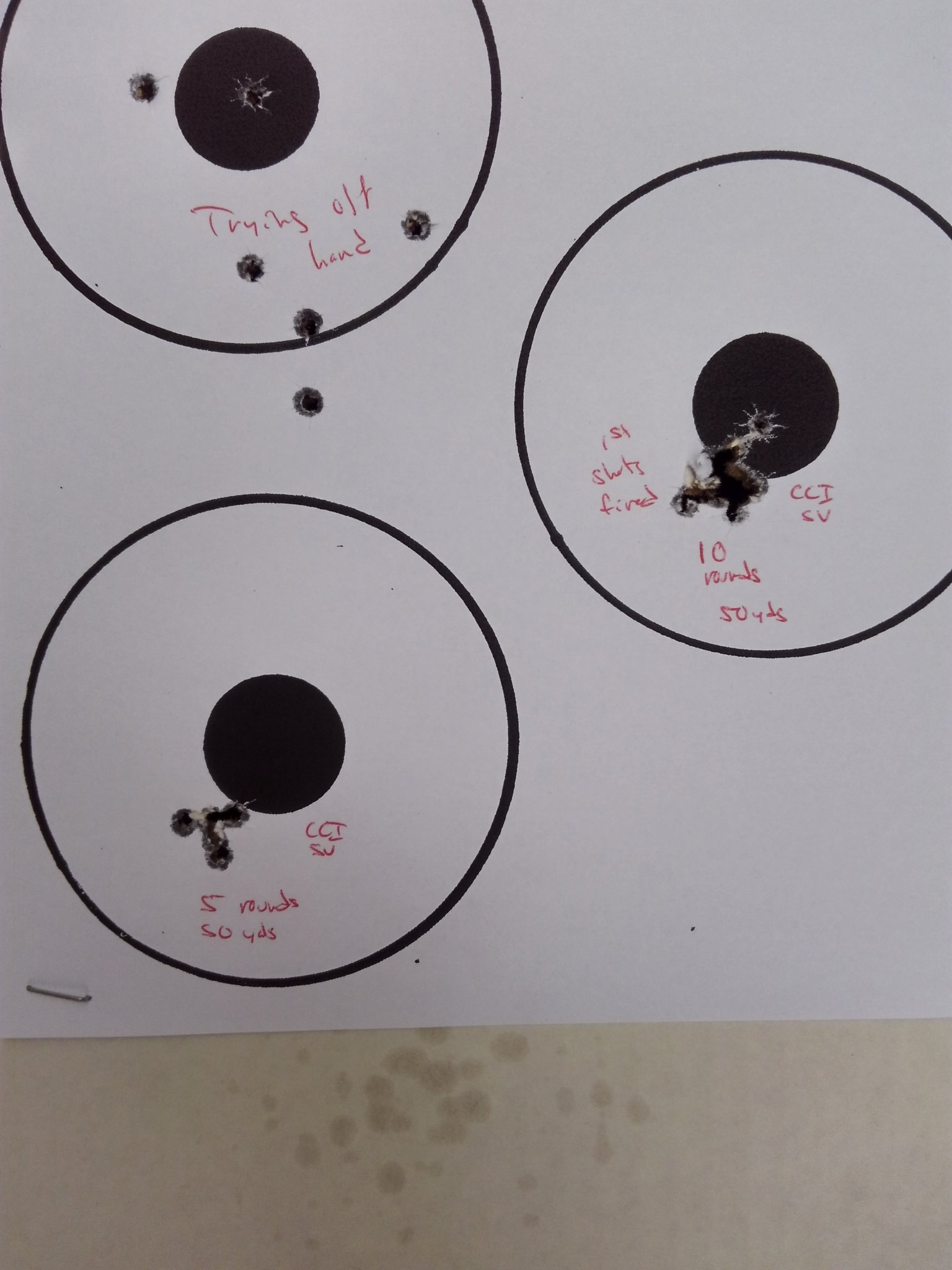

Took it for a spin real quick. I really wasn't in the mood to do any real testing and shooting. I'm too sore and tired from work the last few days to really give a shit lol. The only groups I shot are shown. I really wasn't even concentrating too much. The 3 large groups were me trying to shoot unsupported from the sitting position. The other 2 groups aren't too bad. I'm pleased so far.i didn't even rezero the scope. I just left it were it was when I pulled it off my 308.

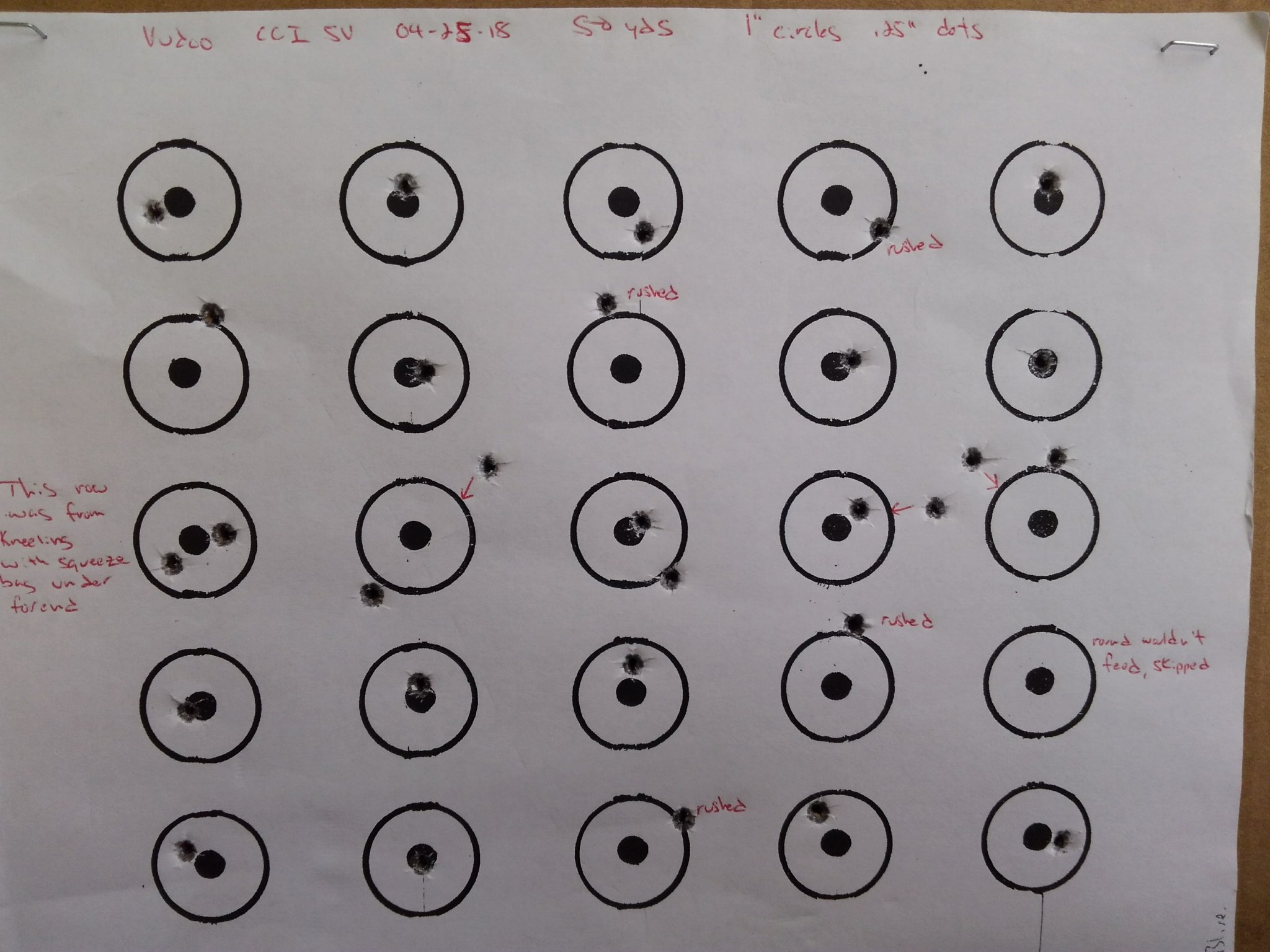

I put 300 rounds (cci sv) thru it this evening. There were times that the bolt won't close completely. I don't know if it's ammo related or what. The round will chamber, but the handle won't close. I have to really pull hard to get the round out, almost forcefully. We'll see what happens the next few times I go out.

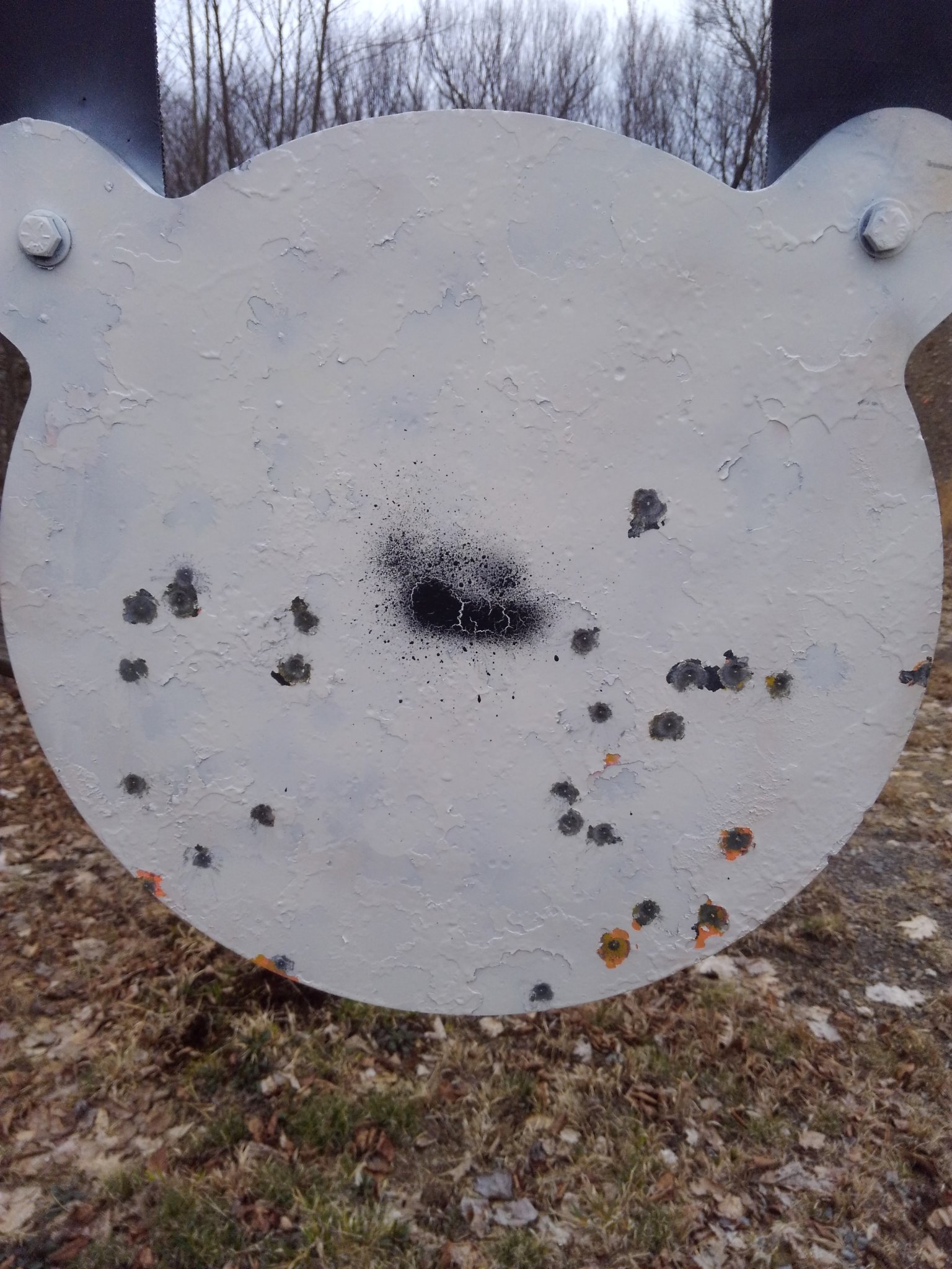

I spent 100 rounds dicking around at 50 yds then moved out to 300. It was breezy this evening. What was weird was 1/3rd the rounds we're 1.5-2 mils low. Next time out I'm taking my magnetospeed to get some data and see if the speed was causing the rounds to hit low.
I wouldn't say the groups were cherry picked as they were the only groups I have fired so far. The steel plate is 18" and at the 300 yard line.
If the bolt face gets dirty it will cause the bolt to close hard...your rifle most likely just needs some cleaning : )

We run Mikes "Ravage" chamber. It is good with 95% of the ammo out there but it is tight. As few rounds as you have through it at this point, i would be surprised if it was dirty. I suspect the CCI SV has a dimensional issue though it gets shot fairly often by our customers. I have personally had trouble with some CCI SV and not with a different lot. I have also had issues with Winchester. I measured both when the troubles occurred and can say rim thickness was all over the place as was overall length. Try something different to confirm and let us know.

Blew off work today, no wind.
I only have 400 rounds thru it. I shot 350 the first day I had it to get it "seasoned" or whatever you wanna call it. I cleaned it over the weekend, got the scope properly zeroed and shot this. Not too bad. I'm pleased so far.
You owe it to yourself & the V-22 to try some SK ammo - from Std+ to Pistol Match to Rifle Match. I bought a single box of the CCI SV from a gun shop this past winter after hearing so much about this ammo from guys on RFC & here. Was very disappointed with it in both my 40X repeaters & the V-22, at both 25 & 50yds. I've been spoiled by the accuracy of SK in the custom bbls of my three bolt repeaters, and am not about to spend precious $$ on ammo with less accuracy potential than these grades of SK. I know some shooters are of the opinion that they can't afford to buy match grade ammo for 25yd plinking or practicing on larger (2 MOA & up) targets. But from my perspective, I can't afford to spend money on ammo that doesn't have the quality to take advantage of most of the accuracy potential of my rifles. SK Std+ is the minimum I will shoot, and it has almost always produced more fliers than either Rifle or Pistol Match from SK. However, if you've got the time to test, select lots of Std+ will produce fewer fliers and rival the accuracy of Rifle or Pistol Match. Compare the cost of SK to the CCI SV - there's not that much difference, especially when you consider the increase in accuracy.

At 300, you can really see (and hear believe it or not) the inconsistency with CCI SV. Sometimes I'm on, and sometimes I'll hit 2mil low. The plate at 300 is 18", and it looks like a pepperoni pizza shit gun pattern, no really consistency at all.
I'm getting ready to hook up the magnetospeed and record so data.
The CCI SV is pretty inconsistent as we have all been told. I'm not really in the mood to shoot groups today, so unfortunately I won't have data on the poi change caused by the FPS. Plus, I don't feel like rezeroing with the MS on.
I shot 60 rounds over the MS:
1144 hightest
1064 lowest
1086 avg
14.3 sd over 60 rounds
1100-1120 had quite a few in that range
1075-1090 was the norm
This probably explains why at 300 it looks like a shot gun pattern.
