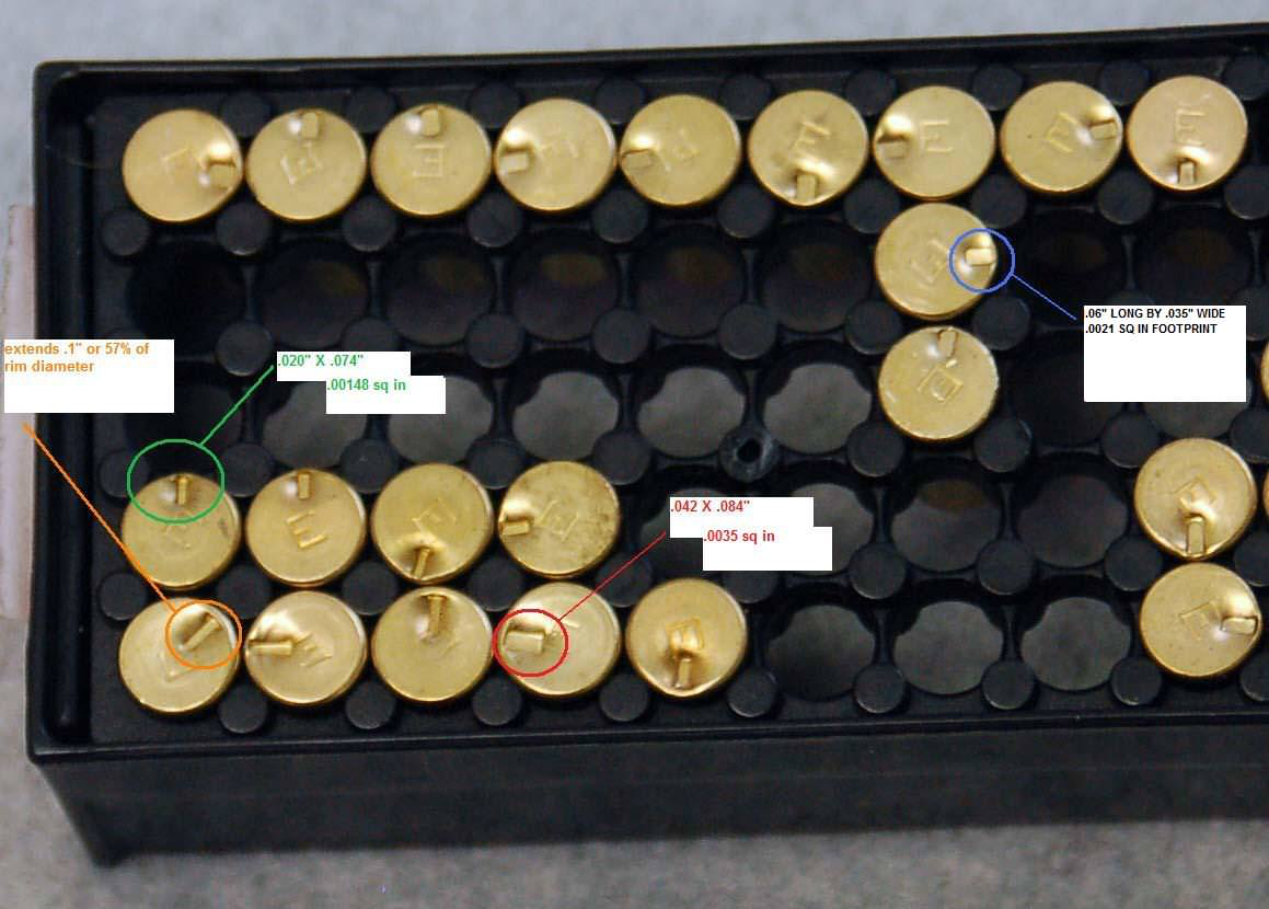

Because I love to tinker and good is never good enough I did a little firing pin modification/reshaping to the Vudoo. I have previously done the same to my CZ and had good results. Here is a link to the mod: http://www.rimfirecentral.com/forums...d.php?t=602579
And here is a pic of the progression of the reshaping of the firing pin strikes.
So now that you voided your warranty LOL. What group size changes did you have before and after and using what ammo. Now I want to go see what the factory strikes look like. Is case one. left one the factory
I'd be interested in a more controlled study. The reason I say this is, based on the nature of the modification, the area being struck is smaller, but the energy in the system is the same. Without making certain accommodations in the modification, results will vary. Given the inertia in the fire control, I keep the spring rate as low as possible, but still provide a very short lock time. The challenges associated with an across the board design for who-knows-how-many-intended-uses, ALL ammo has to ignite reliably, which is one of many reasons I strike across the case rim.
Yes the left one is unmodified strike and progressively shaped the pin with final result on far right.
FWIW here is a photo pulled from the referenced thread on rimfirecentral showing spent casings picked up from after a Class 1 BR national match:

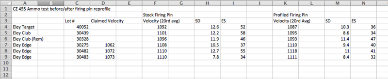

I did a before/after CZ firing pin re-profile test early last year and posted the results on the old Scout site. I don't think the post made it over (at least I can't find it) so I'll re-post the results here. Velocity measurements were done with a Magnetospeed V3 and the temps were in the 70s, if I remember correctly. Sample size was 20 round of each lot, before and after. The result was about a 10-15% improvement in ES/SD:
VERY good info....

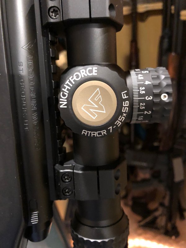

Wow, that's a very nice scope! That's a bit more than I want to spend though. I was thinking of a FFP scope at first but I only shoot paper targets at fixed distances in my back yard so a SFP scope probably will be better for my use and a expensive FFP might be overkill. But I only have SFP scopes so I figured it might be interesting to get a FFP scope just to see how it's like. I've mainly been shooting at 25-40X at the targets I use. I can't quite make out the smaller dots with less power with my old eyes.
