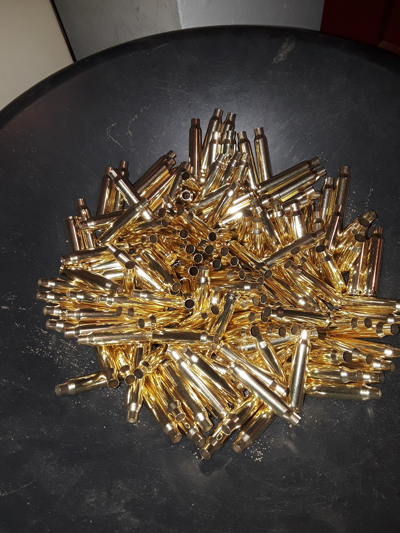

Wet tumbling what a difference WOW

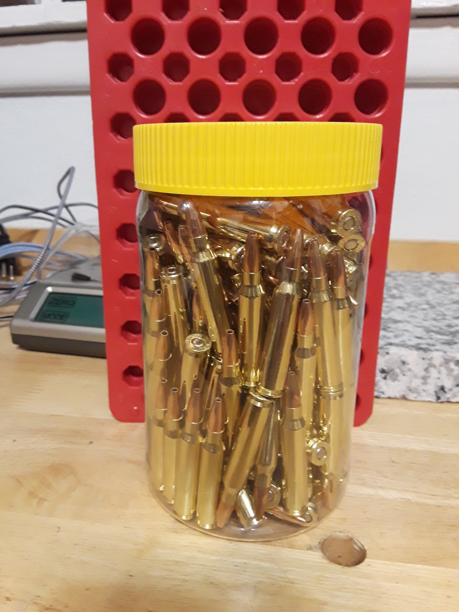

I’ll speak up here, 260 rem Norma brass, once fired, dry tumbled, re loaded with a 136 scenar on top. Let it sit for over a year, got a new barrel and bullet needed to be pushed back a bit so it wouldn’t be jammed into the lands. Tried pushing it back .030 with my Redding micro seater, and it would not budge. Deformed the bullet before it would push it back at all. Had to use an inertia hammer to break the bond on that whole lot of ammo before I could push them back.

I have not pulled any down after storage for a year but have shot plenty of them with no changes noted.

I wet tumble,15 minutes without media and its gtg, mho.
Just because your dishwasher runs for an hour+ doesn't mean your wet tumbler has too.
No peening, no rolled case mouths!
Sometimes I use a brass cleaner, sometimes just a detergent.
AND always make sure the tumbler is filled to the top with water! It serves as a buffer.
Oh yeah, you still have to DRY the brass lol 😆
Did I mention that I hate listening to a dry tumbler running for hours and hours!
